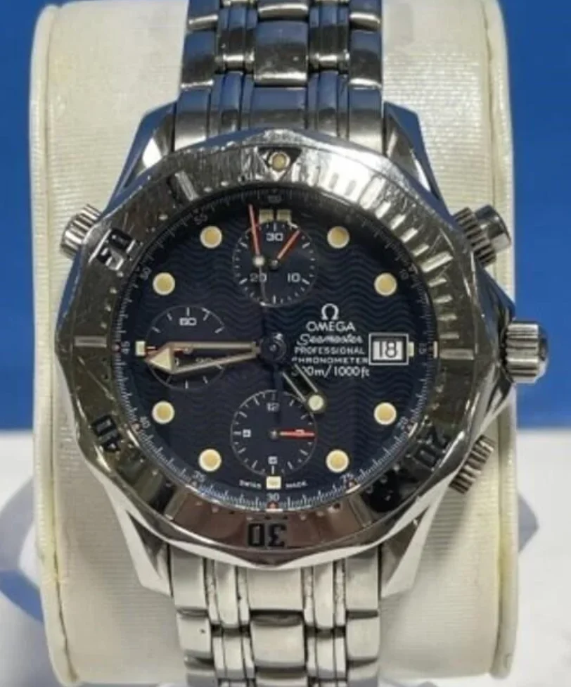

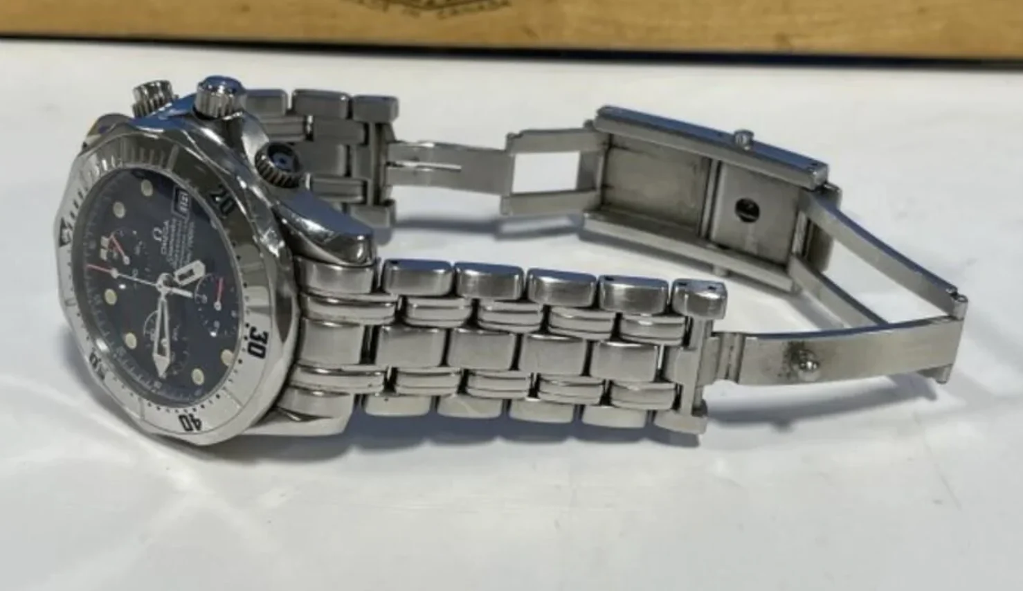

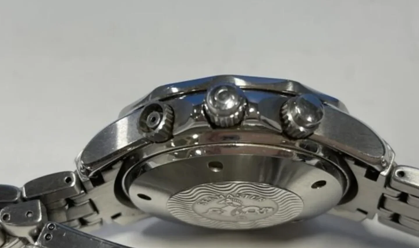

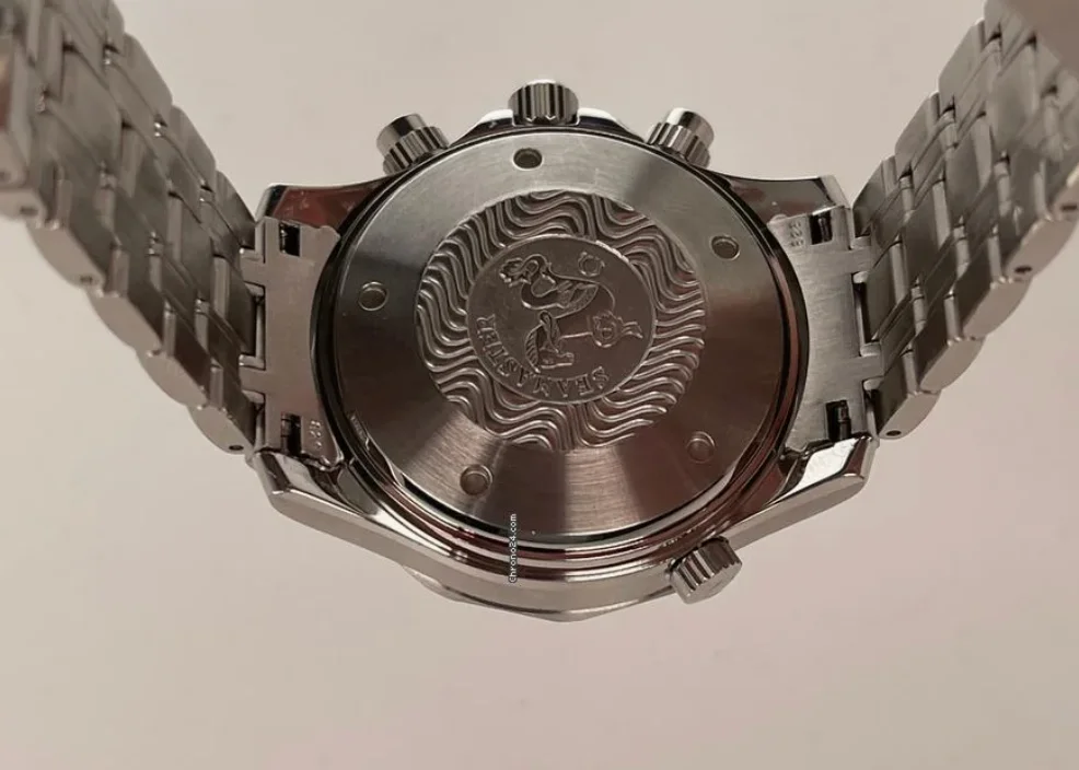

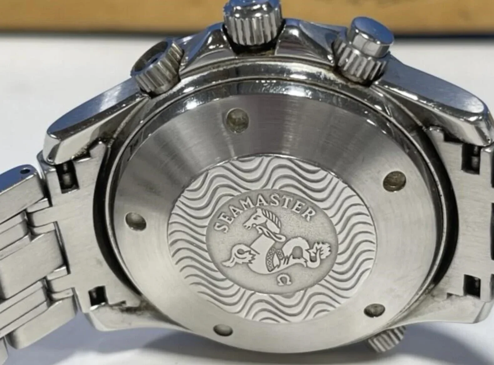

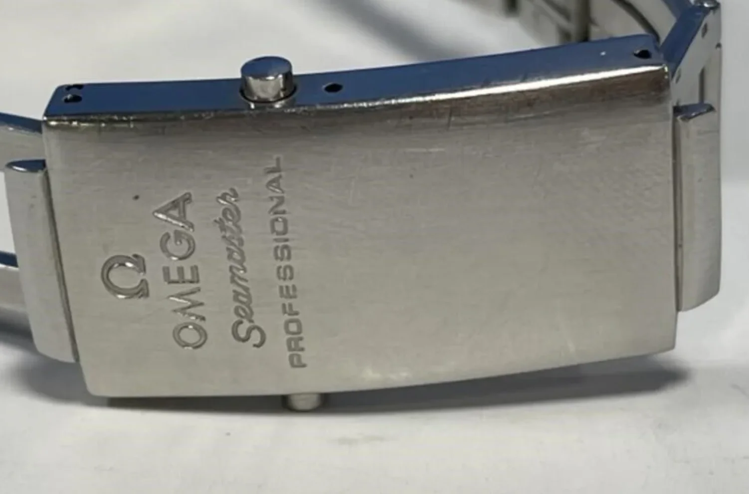

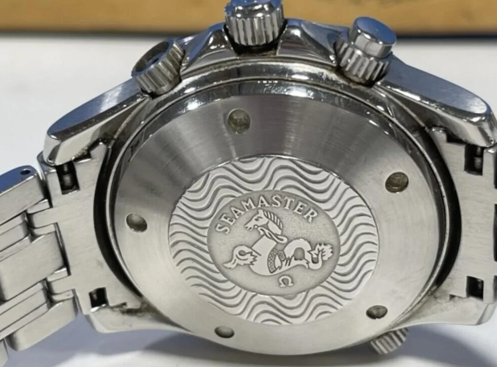

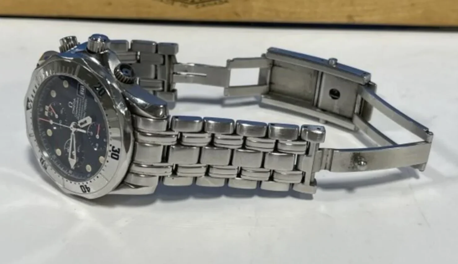

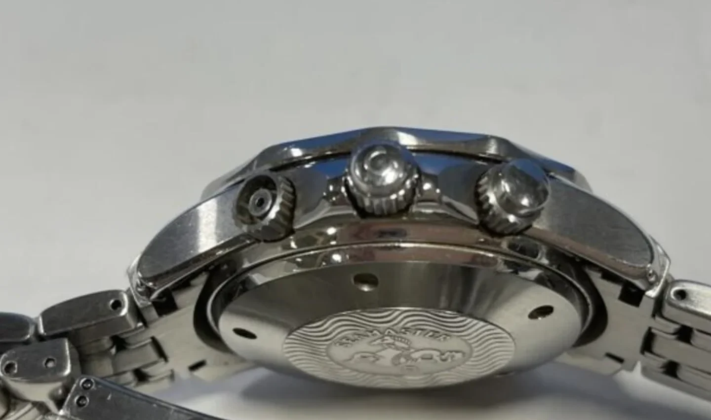

My cousin's wedding is coming up, so I wanted to get a nice watch for it, I saw this Omega Seamaster for sale at this auction house. I called, and they said no COA comes with the watch, and they haven't opened it and will not authenticate it, I attached some pictures please let me know what y'all think any help is appreciated.

Well, there's a pusher missing in all of the photos except the last photo, so is that last photo supposed to be included?
I don;t see a serial number on the back of the lugs - not sure if it's been photoshopped out, or if it's physically been removed...

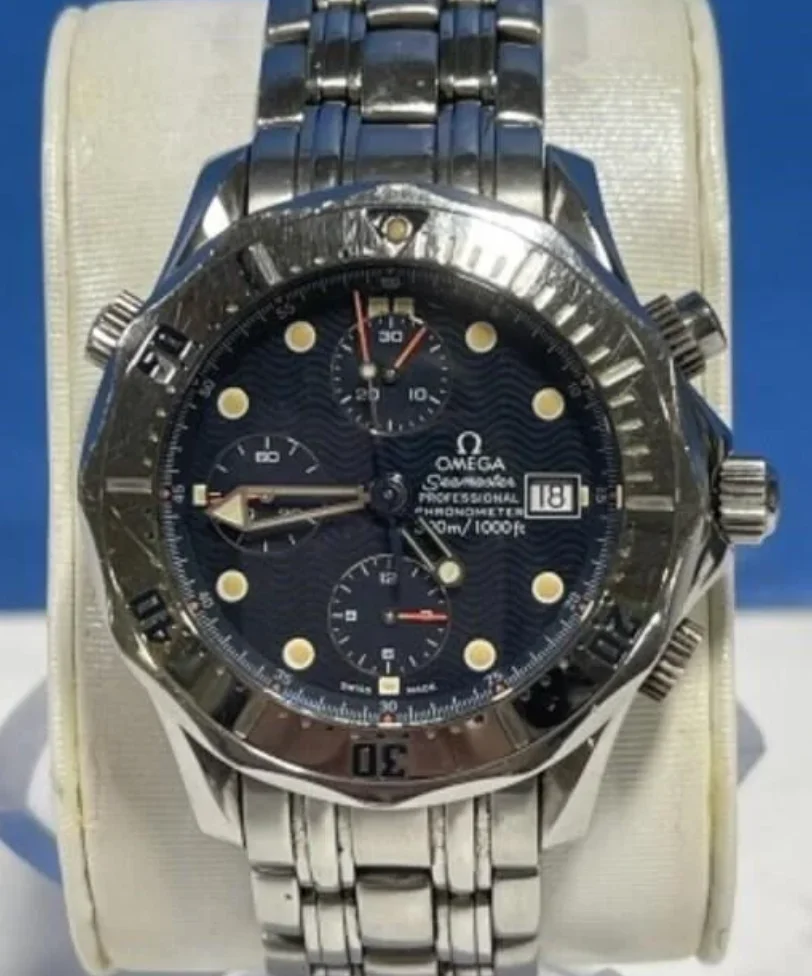

The watch overall is in rough shape, but I'm not seeing anything that would indicate to me that it is obviously a fake or anything. It's going to need a service right away, so consider that in what you are willing to offer.

And keep in mind that a factory service could take a long time, so if the wedding is coming up within the next 6 months, this might not be a good choice for a gift.

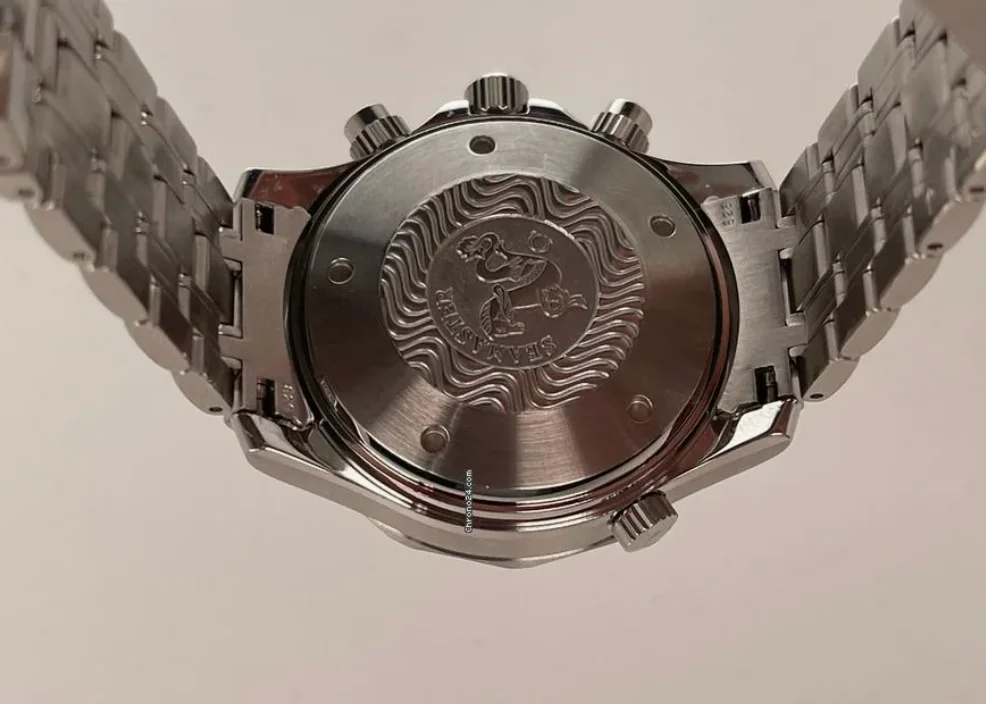

last photo is definitely a different watch , picture is taken from chrono 24 , end links have a number as the rest don’t , case back position is different ....

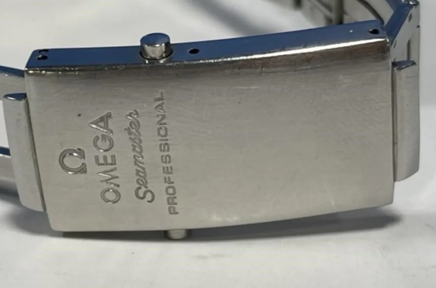

Hard to tell for sure, but based on the 4th photo the bracelet may be extremely short. Extra links can be acquired, of course, but seems like there are a lot of red flags on this one.
