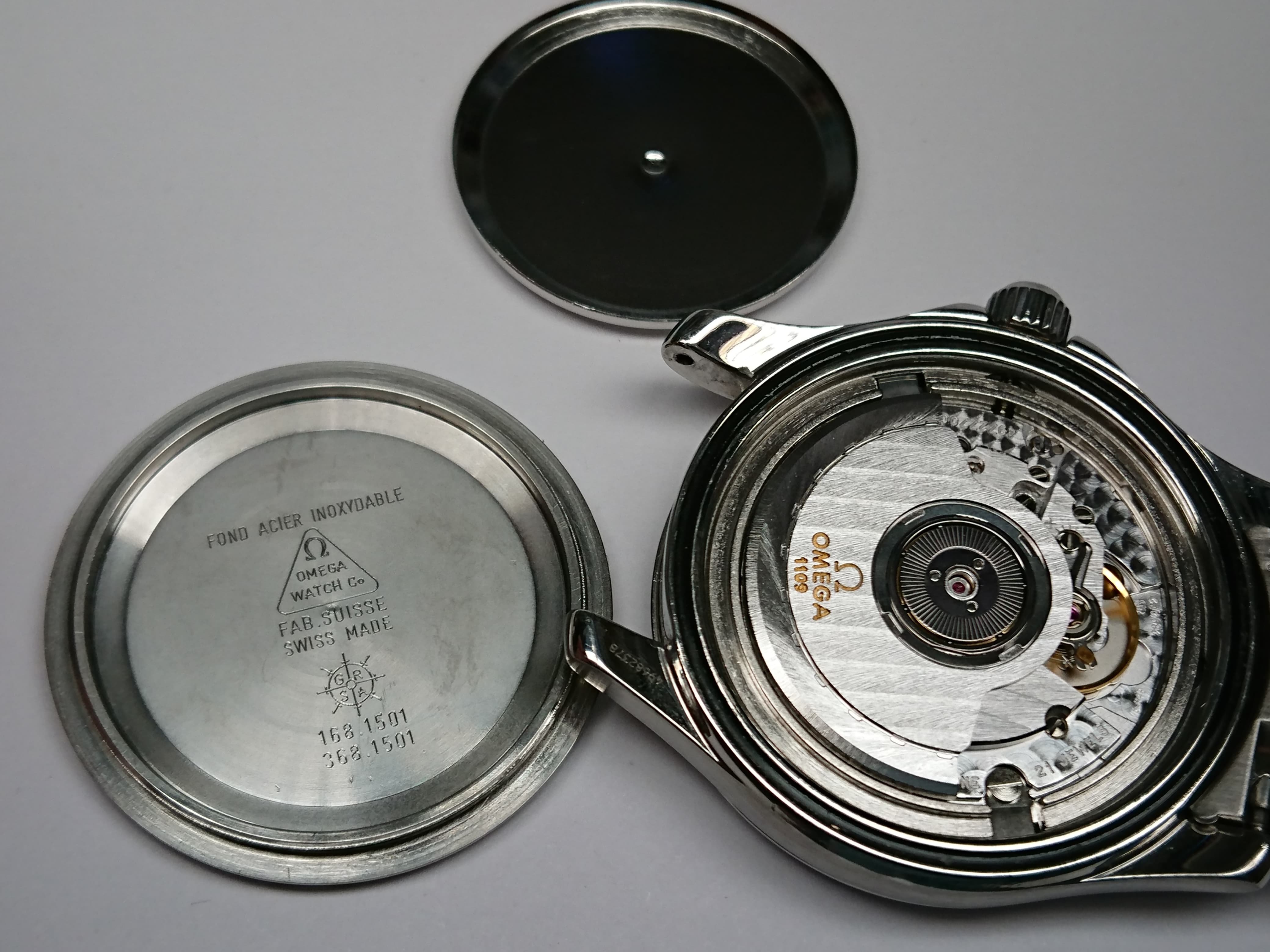

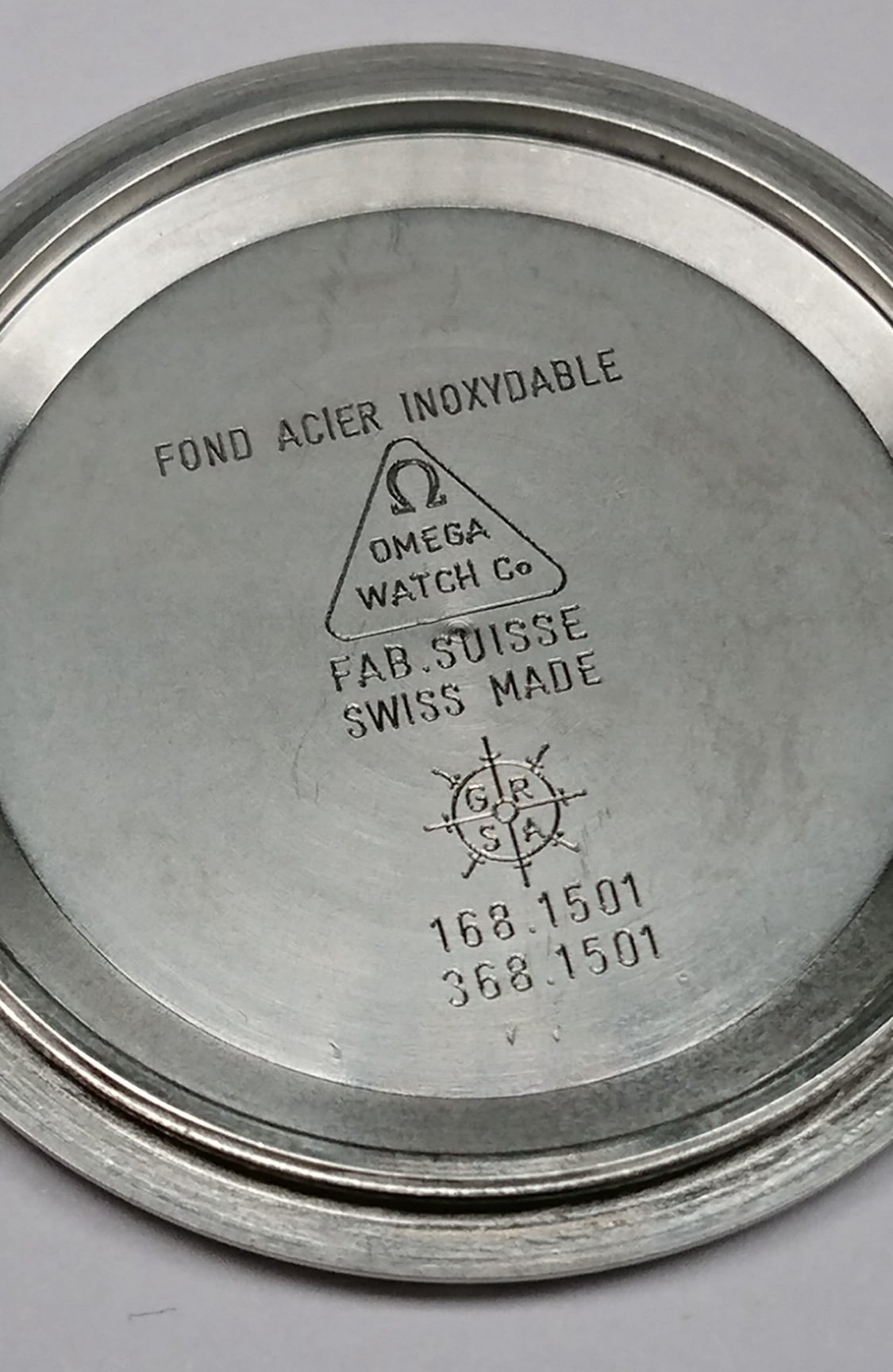

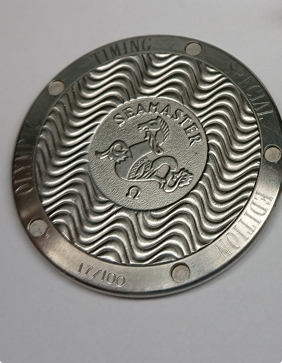

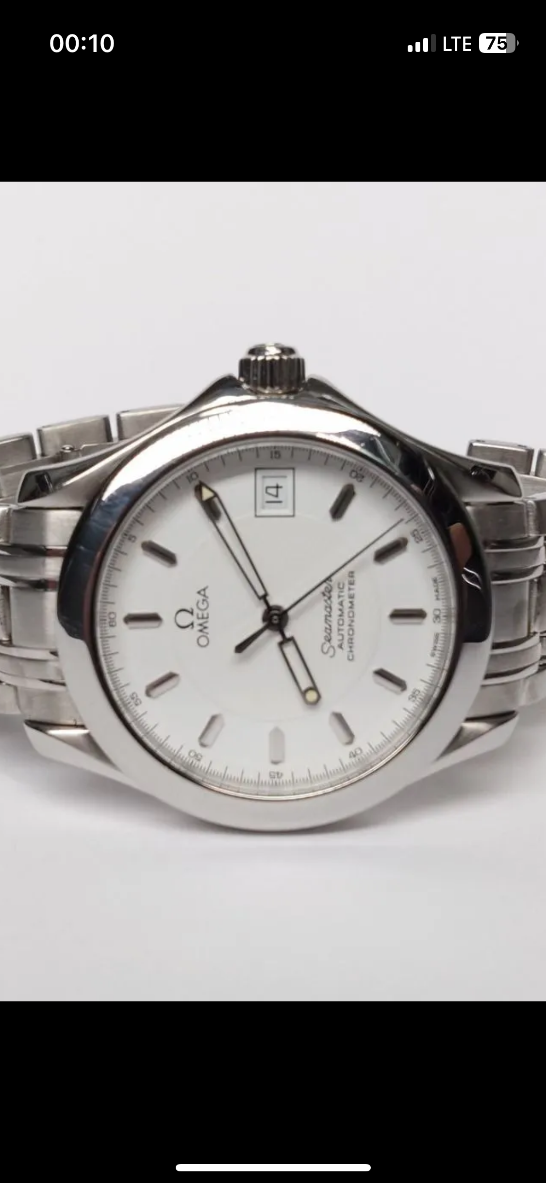

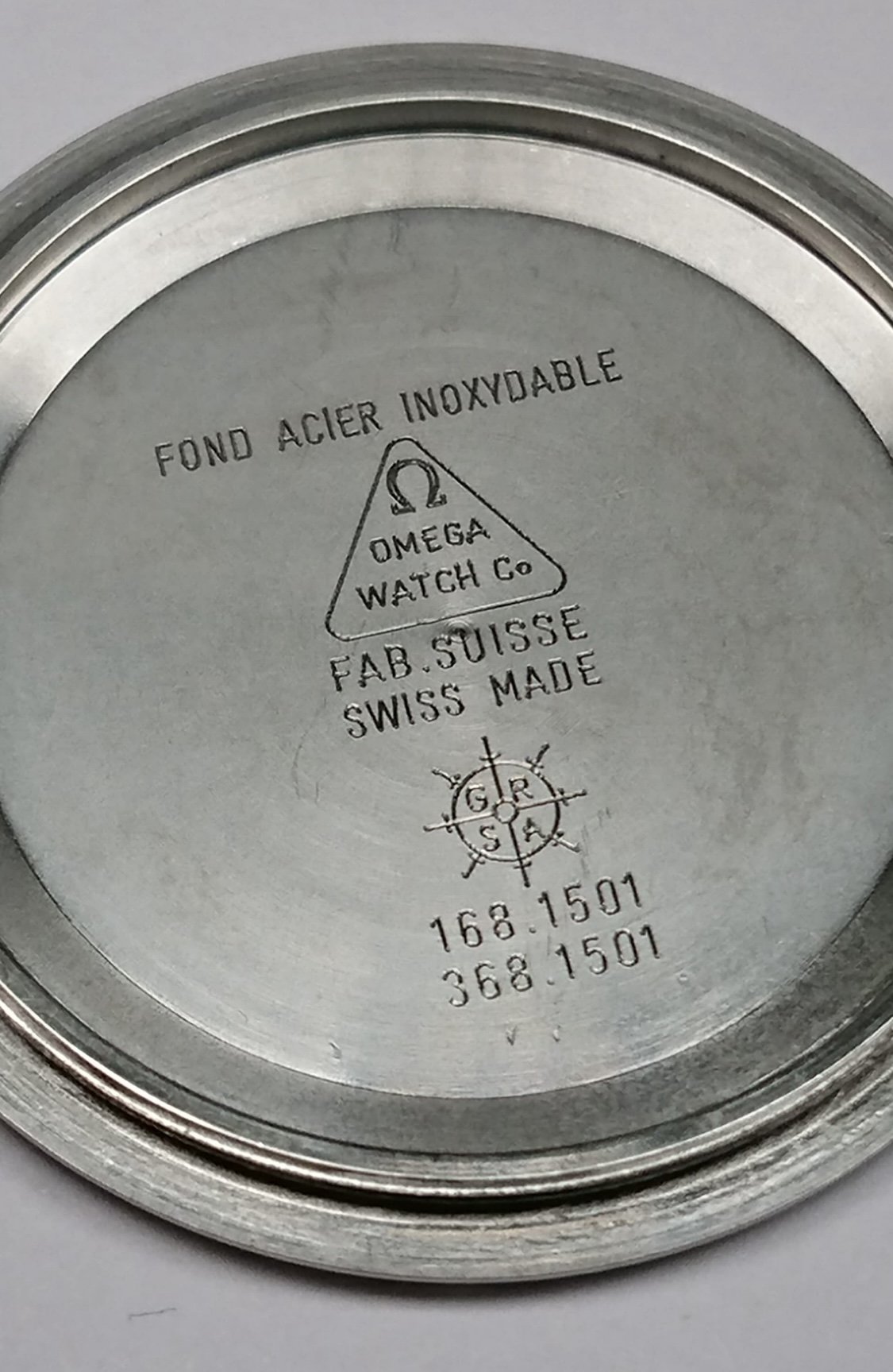

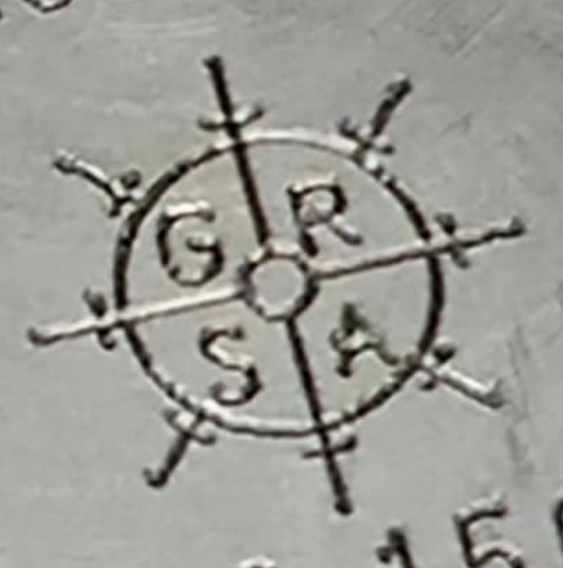

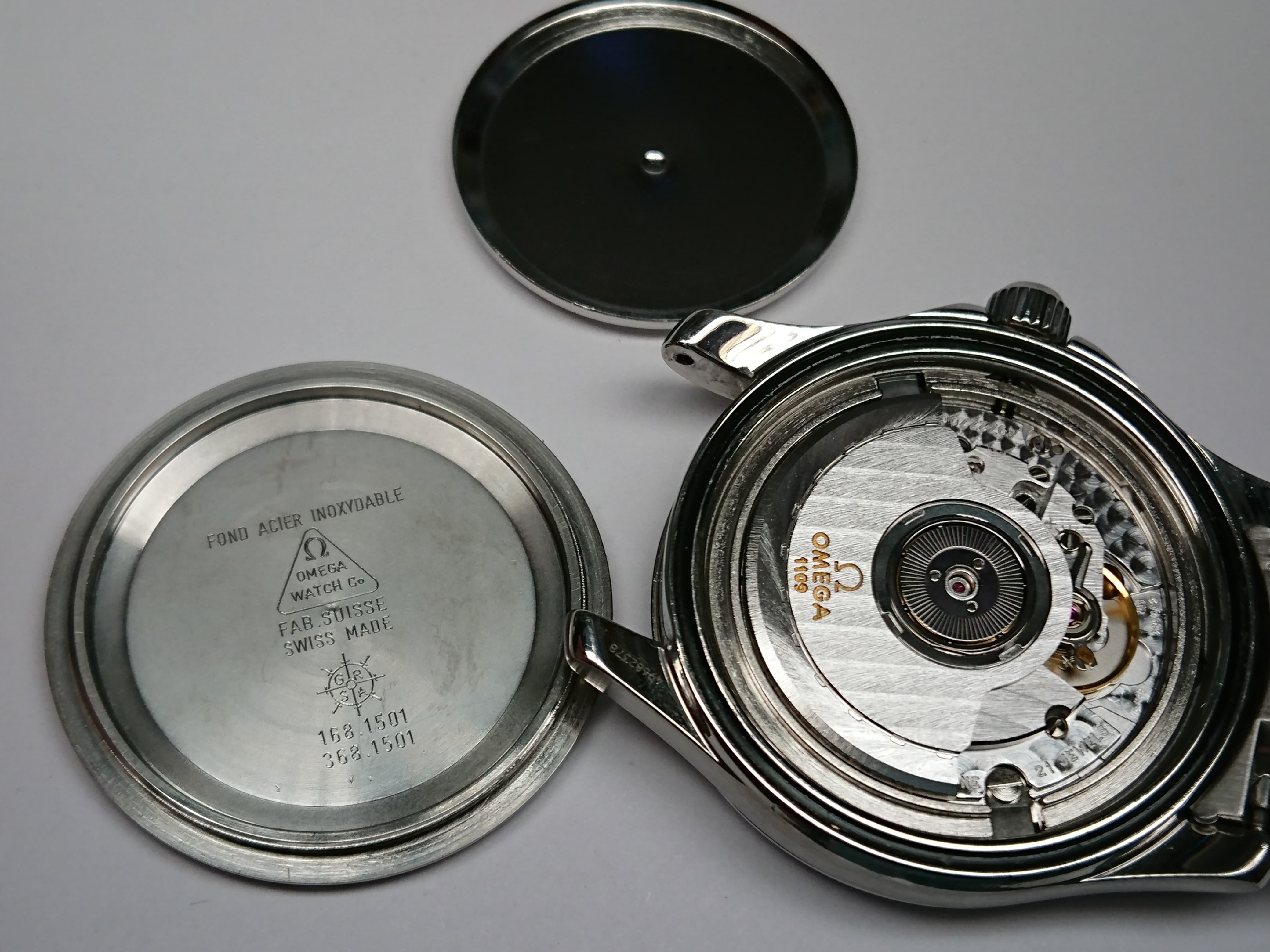

Good day, dear forum members, I have acquired an interesting specimen for my watch collection. No matter how much I searched for information about them on the vast expanses of the internet, I couldn't find anything that could shed light on their history. Under the hood, there's an automatic chronometer caliber 1109 (ETA 2892A2). By the way, the number on the mechanism itself is in the series 49727xxx, while on the lug of the watch case it's 49682xxx, a difference of 45 thousand. I've read somewhere that this can happen. Additionally, there are two references written inside the cover: 168.1501 and 368.1501. I read that this practice might be for the American market. Also, I have a question about the hallmark; maybe someone can tell me what it means? But the most interesting thing for me is the inscription on the back cover of the watch: OLIMPIC TIMING SPECIAL EDITION 17/100. Perhaps it was released during the Olympic Games, limited to 100 pieces. Upon enlargement, it's noticeable that the inscription is not amateurish; the boundaries of the engraving are clear. Maybe someone has encountered something like this before. I attach a photo. I will be grateful for any information.

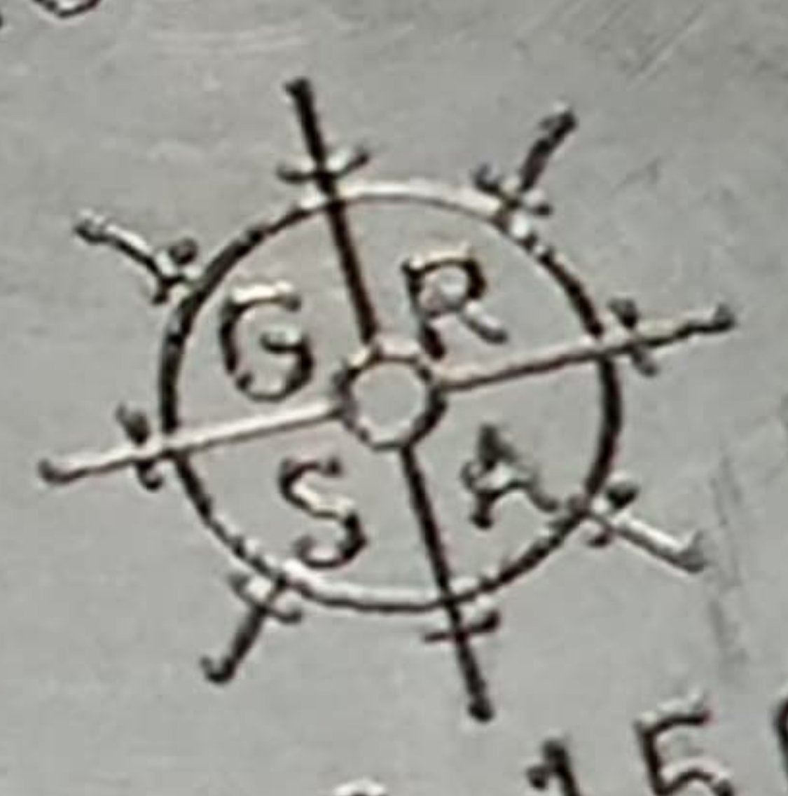

At face value it's a fairly humdrum SM 120m with some interesting caseback markings. The GRSA engraving is just the casemaker, they make those for Speedmasters too so don't fixate on that. The fact the movement and lug serials don't match is not good news at all. It means at some point your movement has been swapped. I suspect the engraving might not be factory, but perhaps it was done legitimately by a third party by the behest of an Olympic related body so might not be total fiction. The mismatch of movement and lug serial rather kills any additional value the rarity (if genuine) adds IMO. Wear it for what it is rather than looking too closely would be my advice.

I don't fully understand the point you are making but there is never a legitimate reason on a recent Omega for the movement number and number engraved on the case to not match. If they don't there has been monkey business. This is not a historical watch lost in the mists of time, its from the 90s.

If this is really the case, then it becomes a little sad that the watch has lost its authenticity.
Maybe I should ask the Omega official for information, maybe they can clarify something about this. If the watch is certified, they may have movement information.
