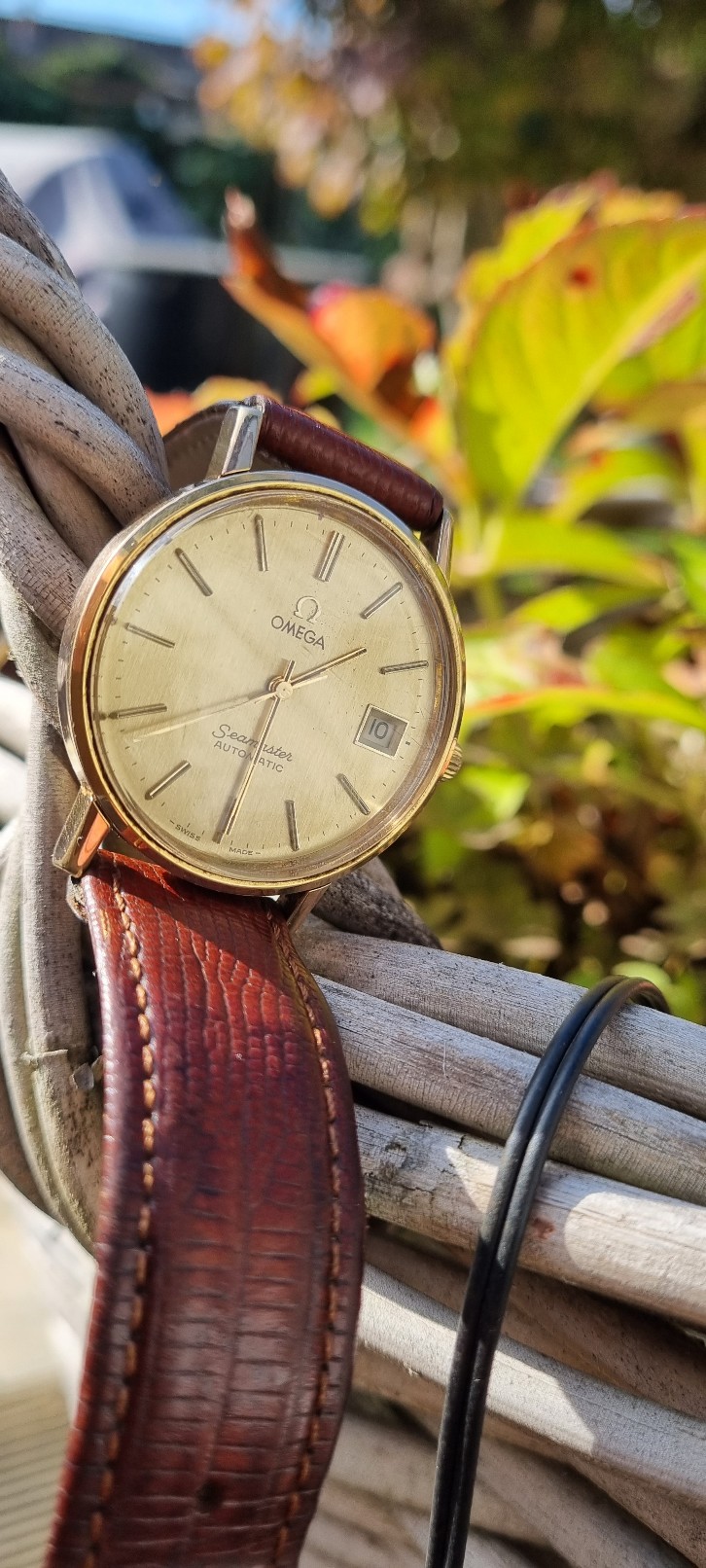

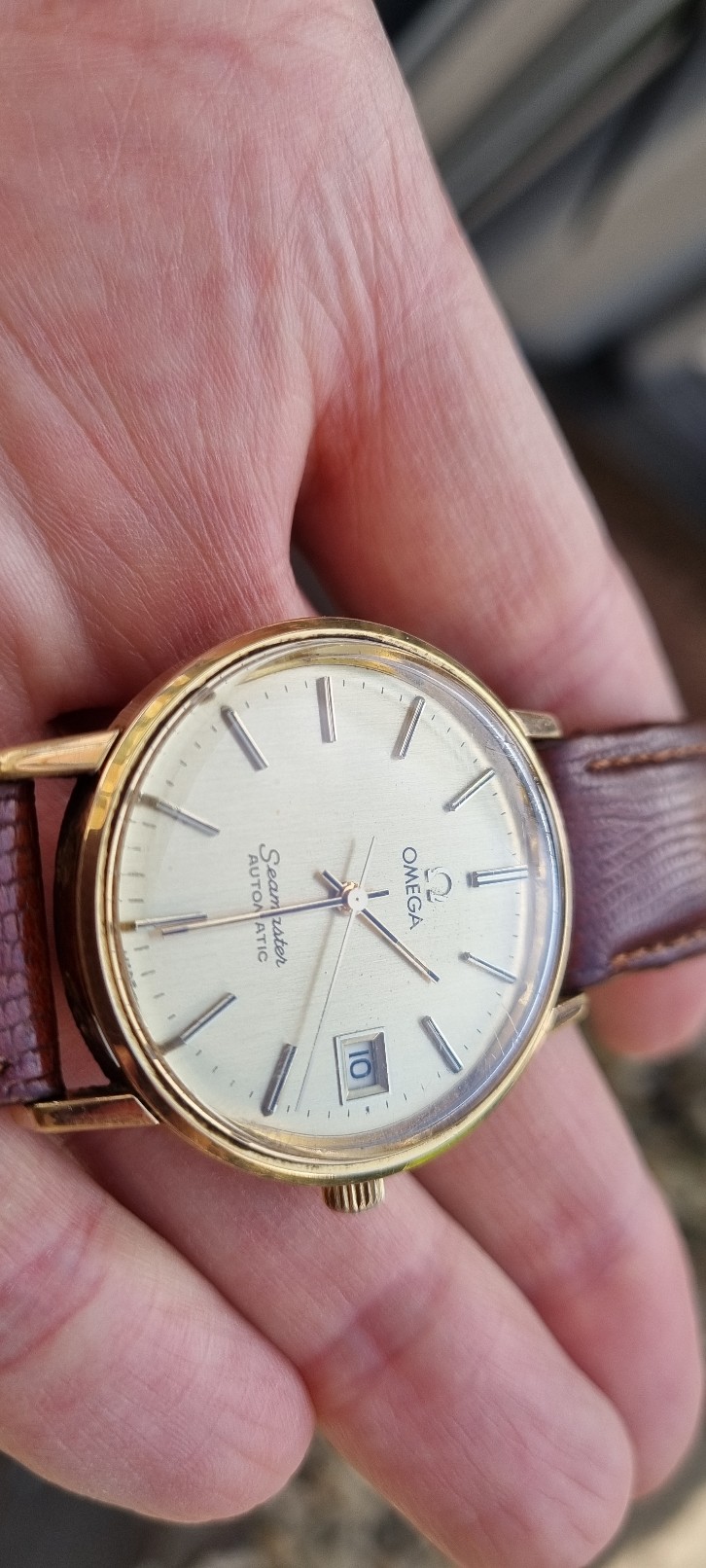

Hi my friends,
From my grandma i got this, in my opinion,nice omega watch.
I hope u can help me, to identify model, age, value and non fakeness 馃榾
Thx and best wishes Warto
568
389
Need pictures of the mechanism and the inside the case back for give you a proper answer .........
13,556
23,503
70鈥檚, possibly 80鈥檚 with 10xx movement. Genuine but little value, say couple hundred of your chosen currency.

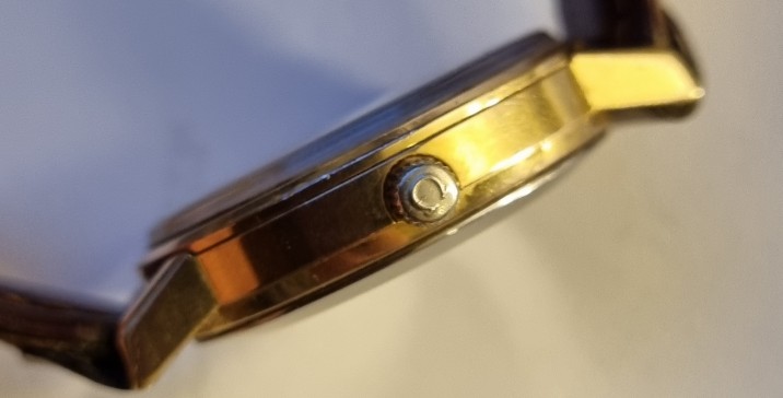

Many thx for your fast answers. I will make some add. Pics. But i think i can bot open it alone? Is the back pressed oder screwed.
I have look a long time in the internet, but i did not find any similar watches.
Location is good old germany 馃榾
13,556
23,503

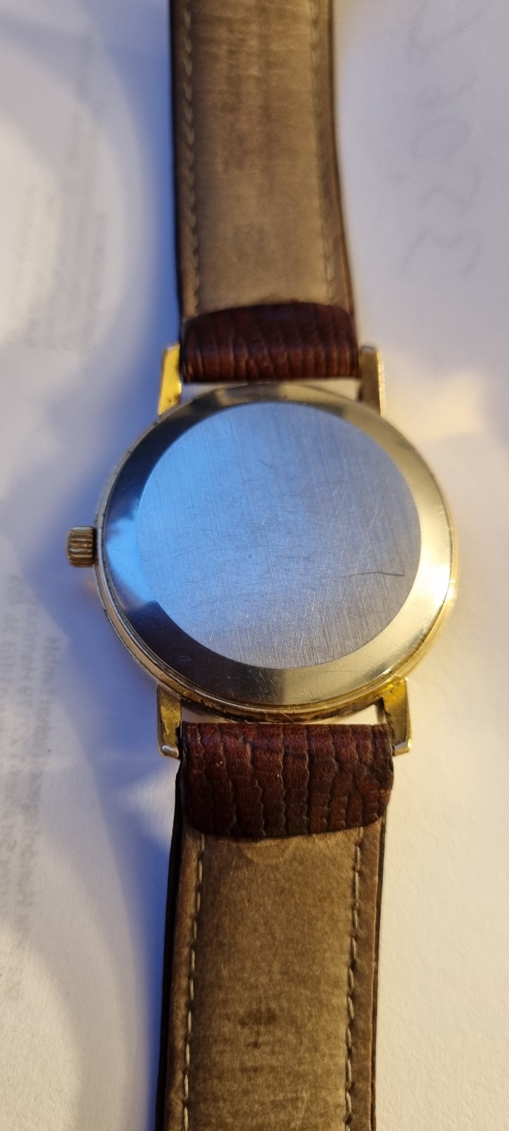

You鈥檒l need to show a picture of the back for us to see how it鈥檚 attached.
13,556
23,503
So looks like gold plated case with friction/ouch fit case back.
I assume there鈥檒l be a very slight notch somewhere on the case back to allow access for a case knife.
13,556
23,503
Are you looking to open it yourself? If so, are you confident you can do so without damaging it and ruining the sentimental and numeric value? Do the have the tools to correctly replace the caseback?
If you haven鈥檛 done this before it would be much better to get a watchmaker to do it.

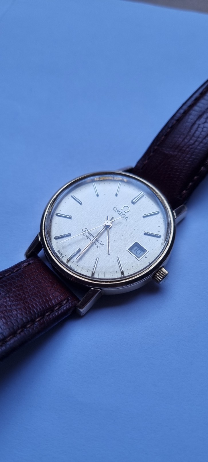

10,804
16,814
Nothing shown changes the original Davidt diagnosis here. This is a late 1970s/early 1980s 10XX movement gold plated watch. Worth as already indicated a couple of hundred but maybe needs that amount or more spending to get it working properly so from one POV, net value is unfortunately nil if you were to service it. This is not a problem if there is sentimental value and it is a keeper, more so if the intention is to flip it. My guess is model 166.0202 or similar.
7
Many many thx. The watch works perfectly and smooth. But i will give it away for prof.cleaning.

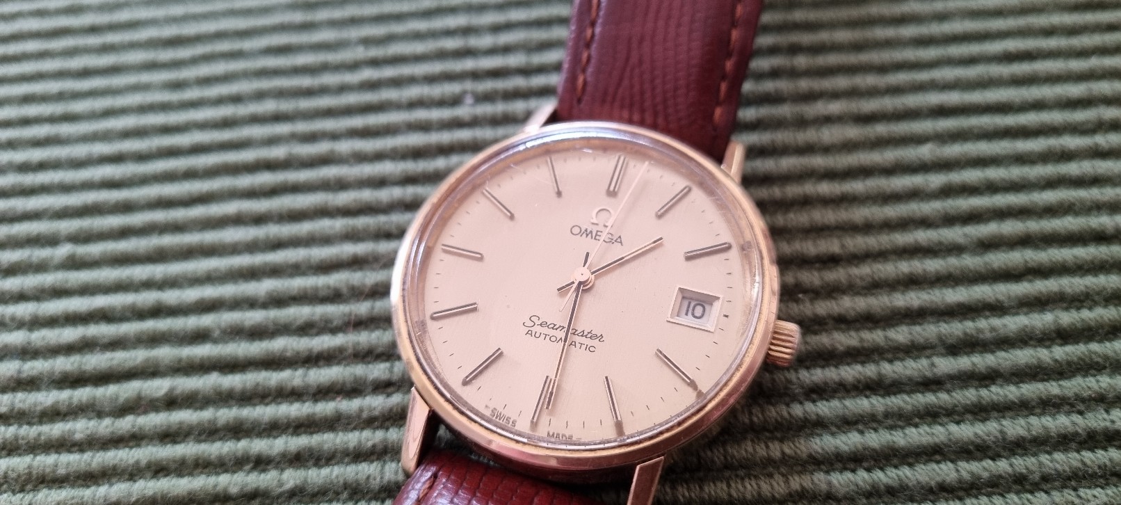

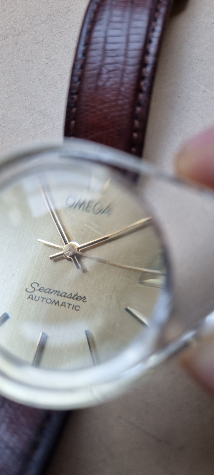

9,588
27,706

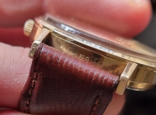

The 20 Omega means gold plated?
Yep, that's Omegas way of showing that it has a 20 Microns thick gold plating. It's a very decent gold plating, thicker than you'll find on most 'fashion' watches.
10,804
16,814
I wouldn't go as far as decent. 20碌m (or 0.02mm) It is the minimum seen on Omegas, other plated models have used up to 80碌m. The thickness of the gold layer on the gold capped models is more like 200碌m. It used to be suggested by pocket watch makers like Dennison that a micron lasted for a year of wear so 20碌m was a 20 year case. This watch is now 40 years old (but presumably not worn every year!) so could be assumed to be fairly worn and indeed the lugs look pretty brassed.
9,588
27,706
I did compare it to fashion watches, not gold capped vintage wrist watches, pocket watches or similar.
"Decent", I find, is a fairly accurate description.
