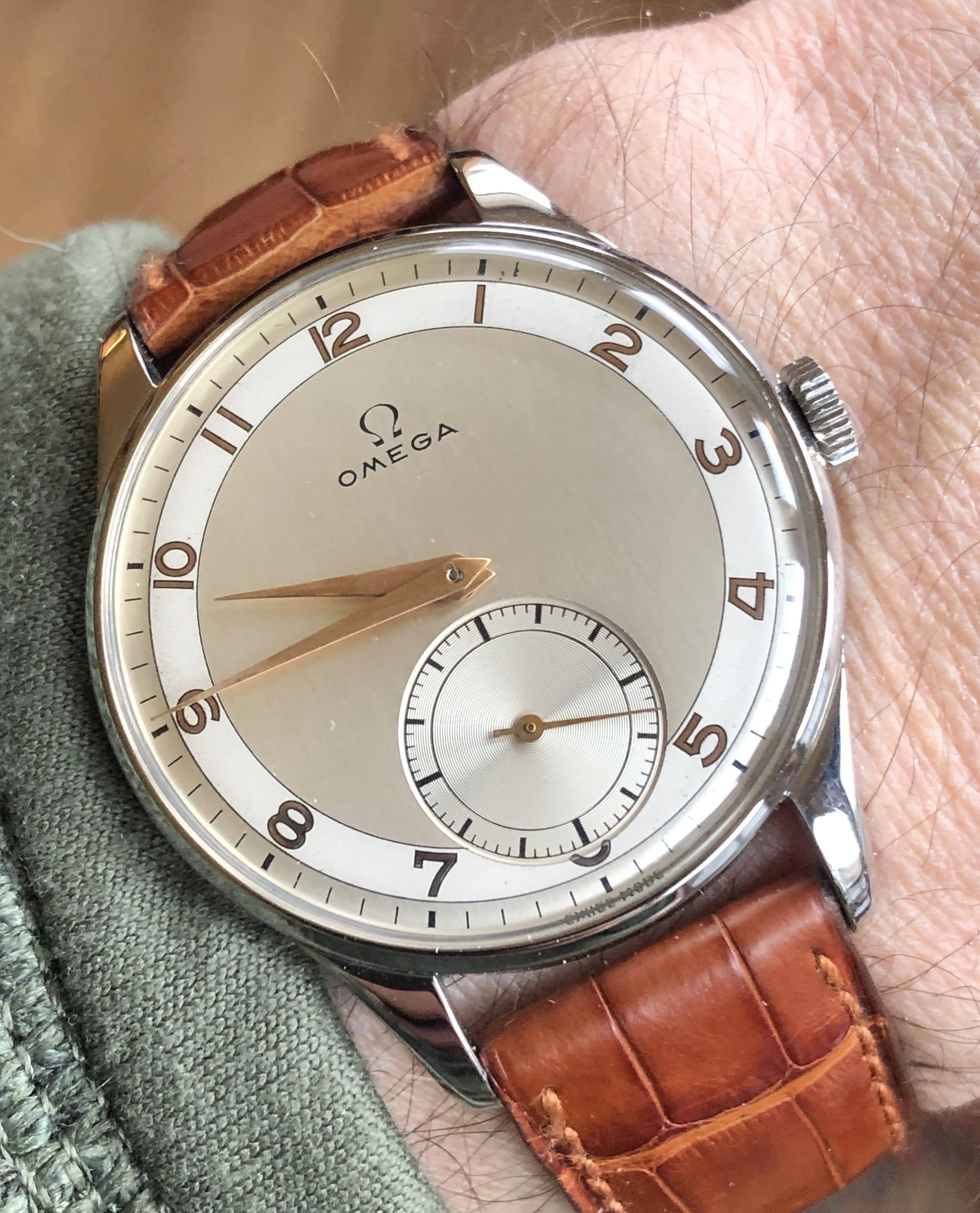

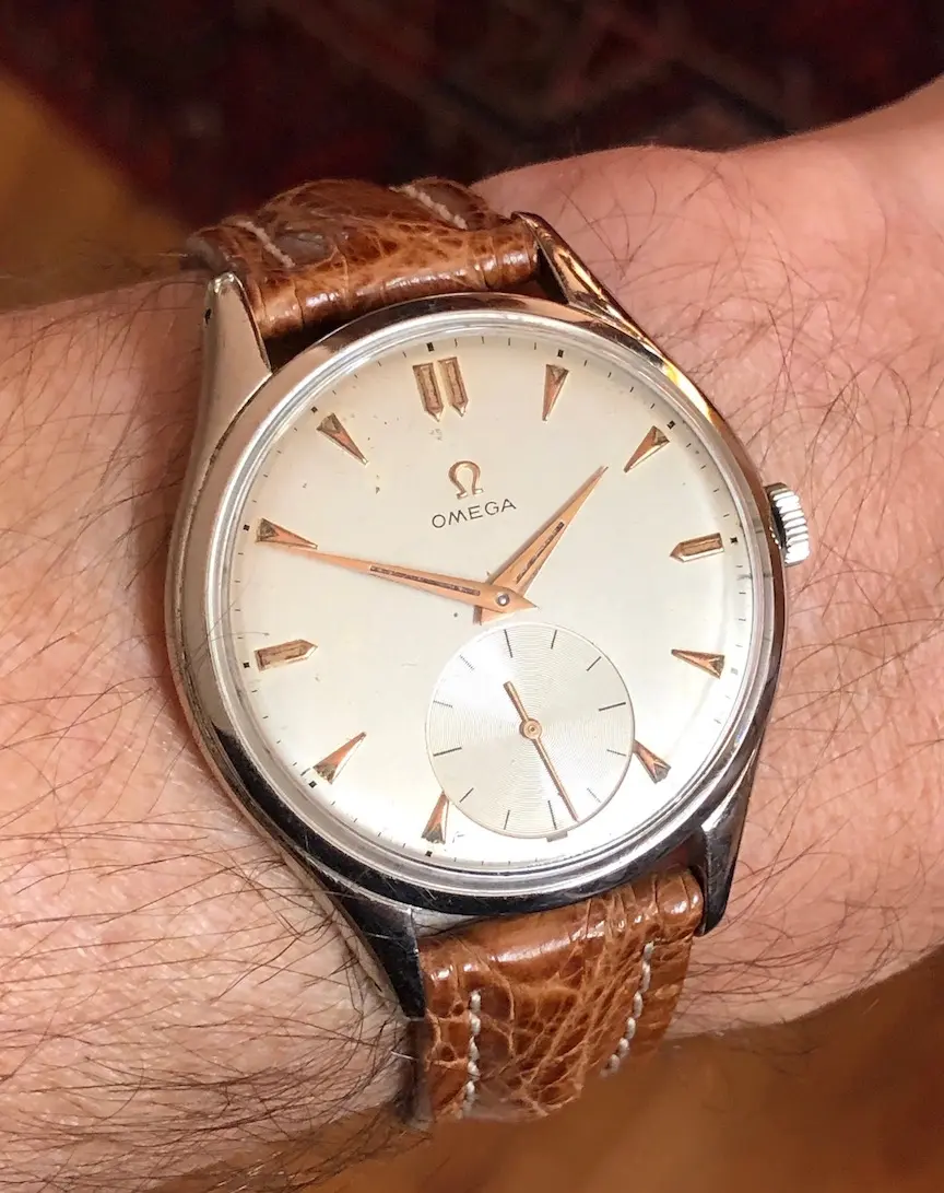

While I loved the 30 mm movements (both Omega and Longines 30L). Parts are getting harder to find for the old Omega 30 mm movements.
If one parts supplier is out. Pretty much all will be out which men’s the secondary market
Had some 6 series movements and nice quality

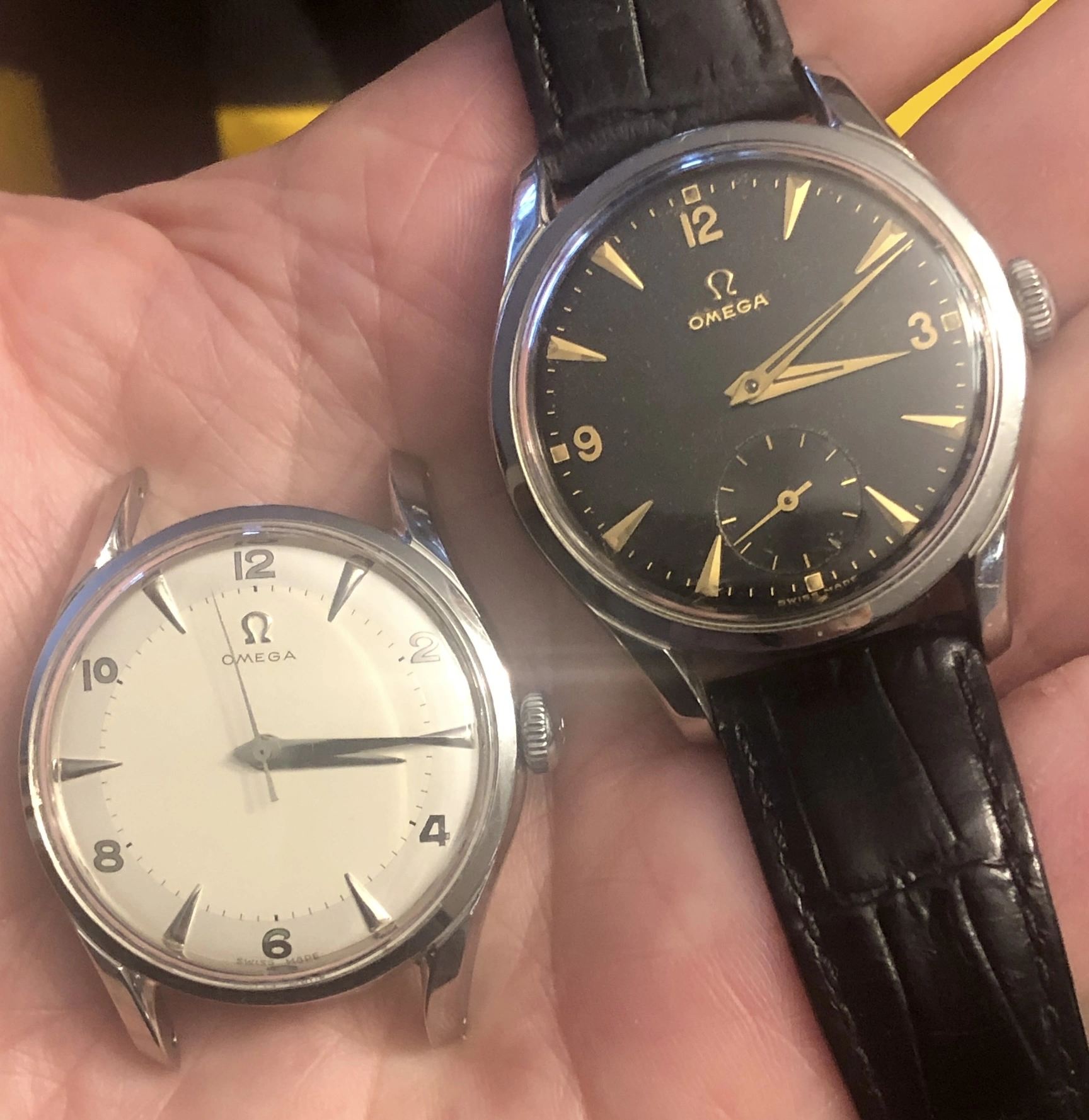

Cal 601 is a good movement and the 30mm calibers are great time-tested movements - I don't think you can go wrong either way. There are tons of dial options with the cal 601, especially if you like the 135.011 case/lugs, including technical dials, Seamaster companion dials, etc.
Personally, I generally prefer watches with the 30mm movements. It's not the movement per se, just that many of the references have a more classic vintage look to my eyes. Another nice thing about the 30mm movements, is that you can find them pretty easily in larger cases. There's nothing wrong with 34-35mm, but 36mm is really a sweet spot for me. And of course there are the true jumbo references that are 37-38mm.

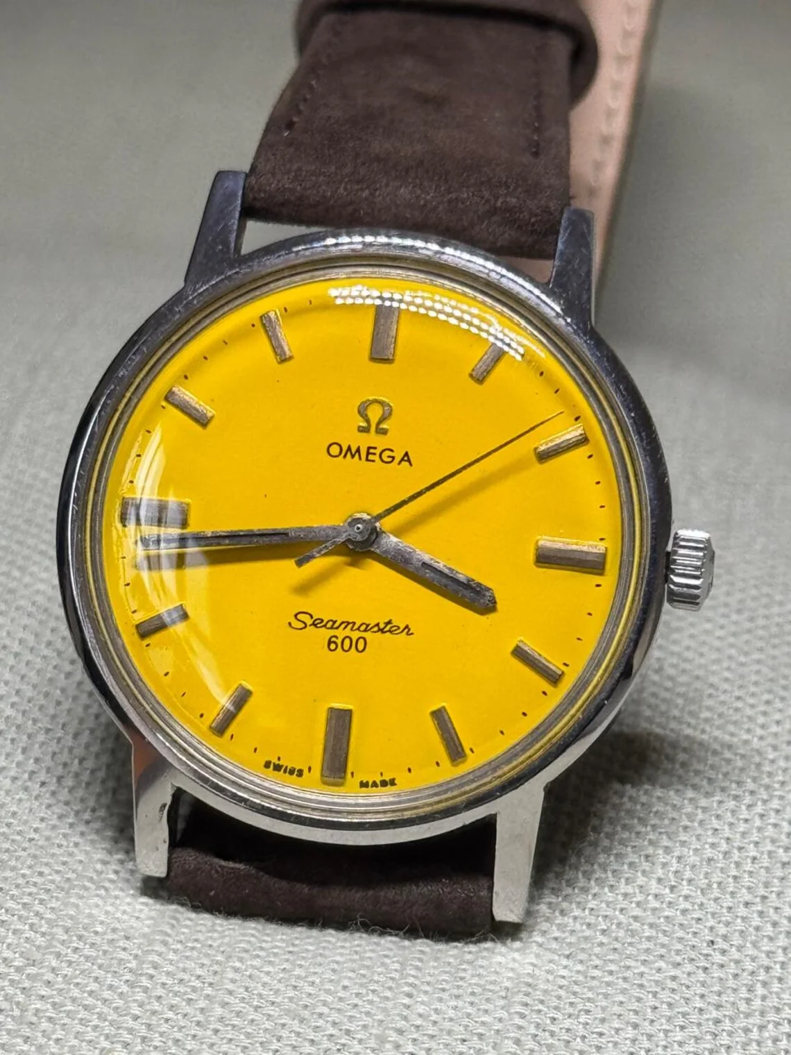

...any thoughts on this? refinished? cool?...not so much?
As @Davidt said. This, the initial two, and pretty much all colourful dials (from these references with 5xx and 6xx movements) are complete fakes. I once serviced one of those with a vibrant blue dial - it was literally cheap spray-paint.
You'll probably have to live with silver, champagne, or black dials (already rare and often fake).

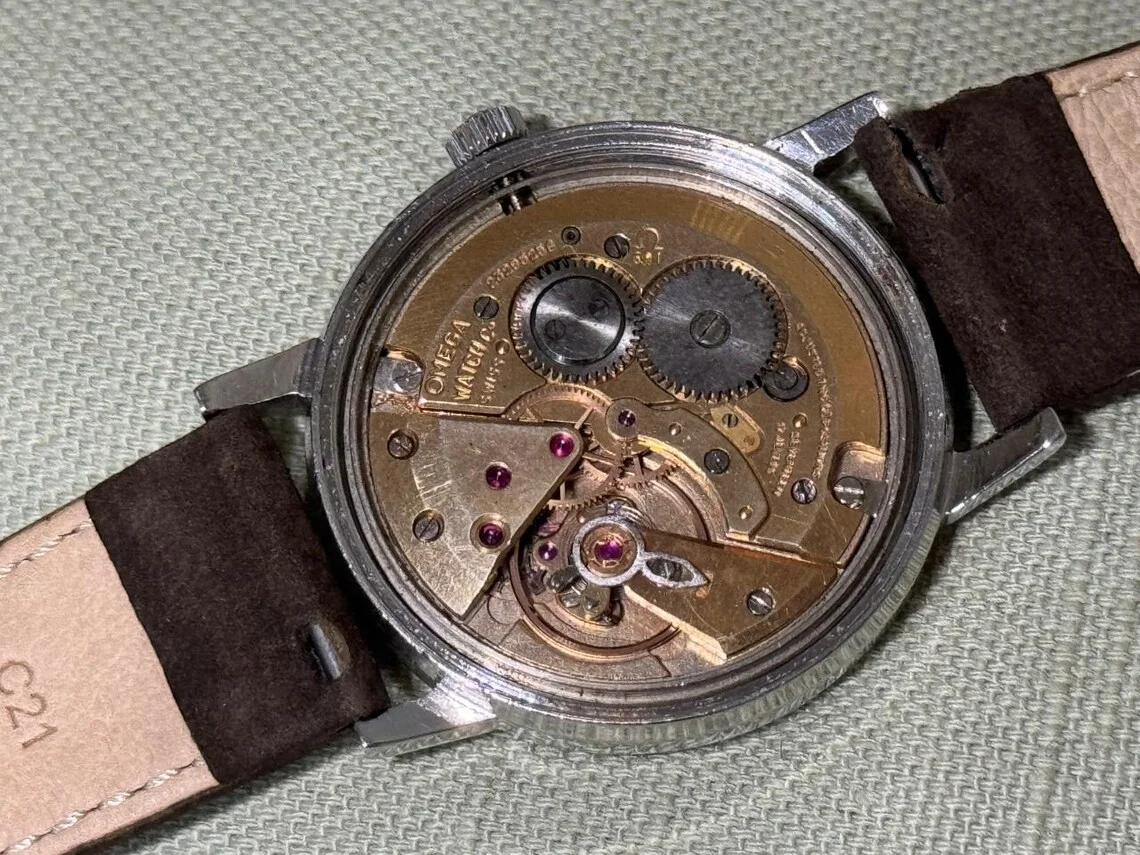

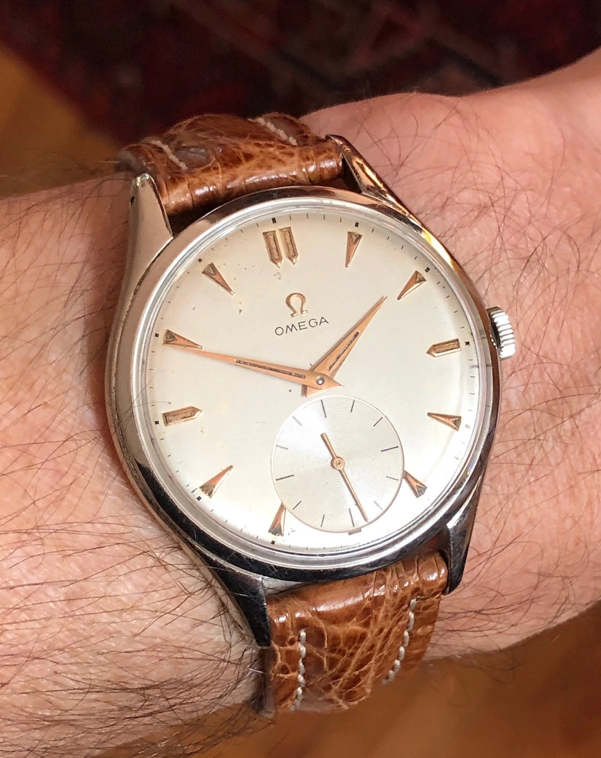

These are two very good movements. If you want a more modern, discreet movement with a higher frequency, go for the 601. If you want a movement with more character and presence, then without hesitation, choose the 286, which is a larger movement derived from the 30T2, a design from the 1940s. Personally, I would choose the 286 without hesitation, if only for the pleasure of winding the legendary 30mm movement .

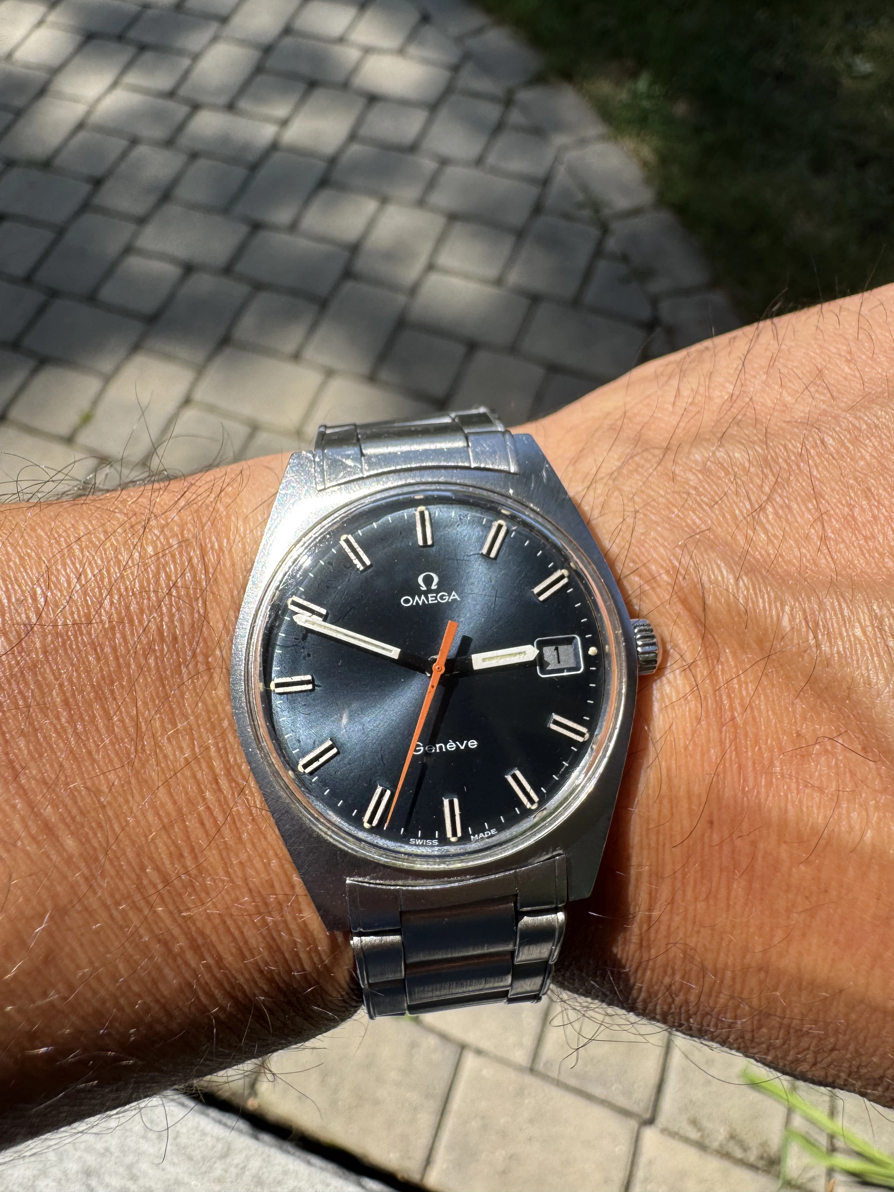

I personally like and recommend the 135.041 with a cal 601.
Here is my similar (has date) 136.041 manual wind. I don't wear it too too often but it does serve well as a daily vintage wearer and I like the rivet bracelet.
