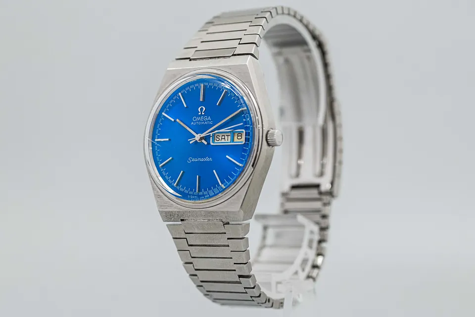

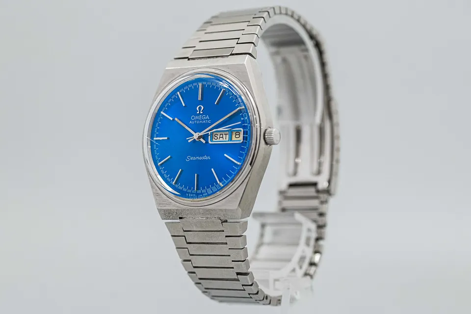

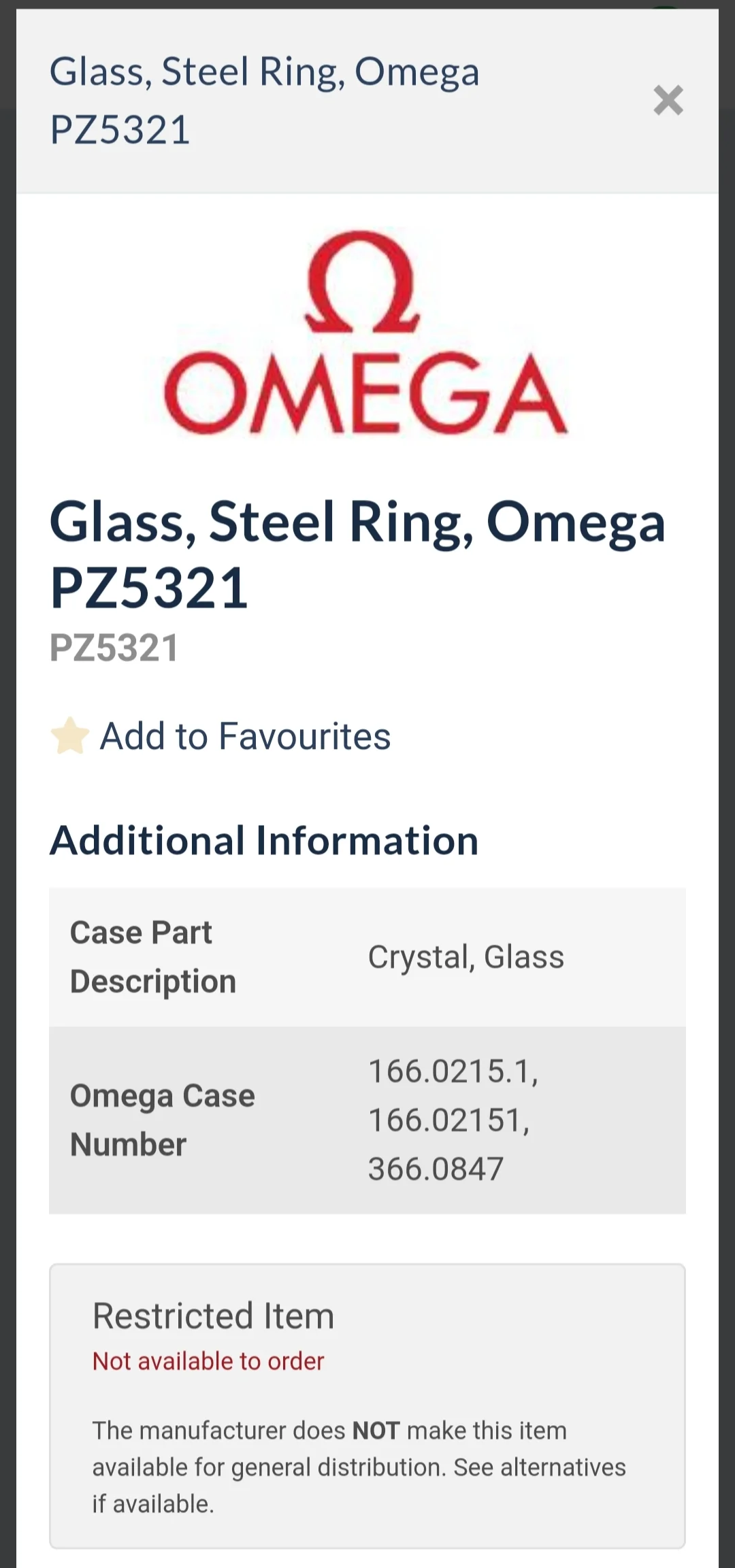

Hello! I need a little help finding a crystal for a omega Seamaster 166.0215.1
How do I know the part number or where can I find a sapphire replacement?

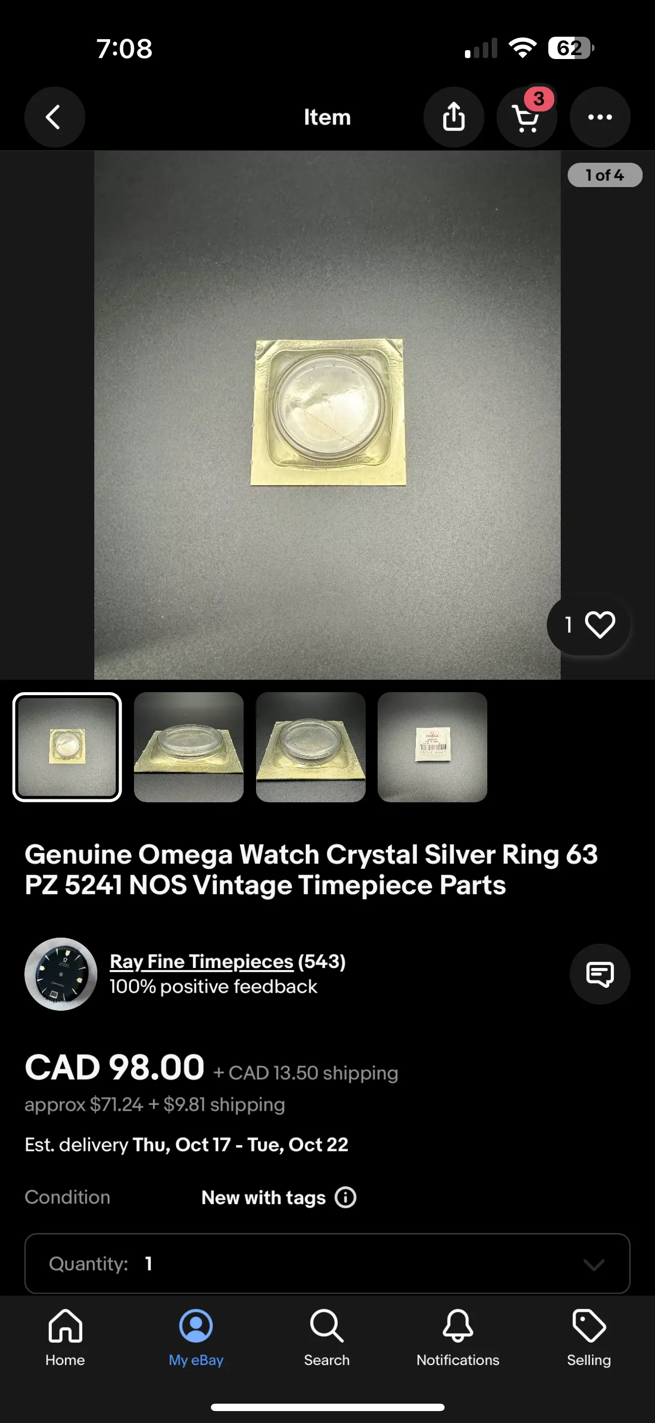

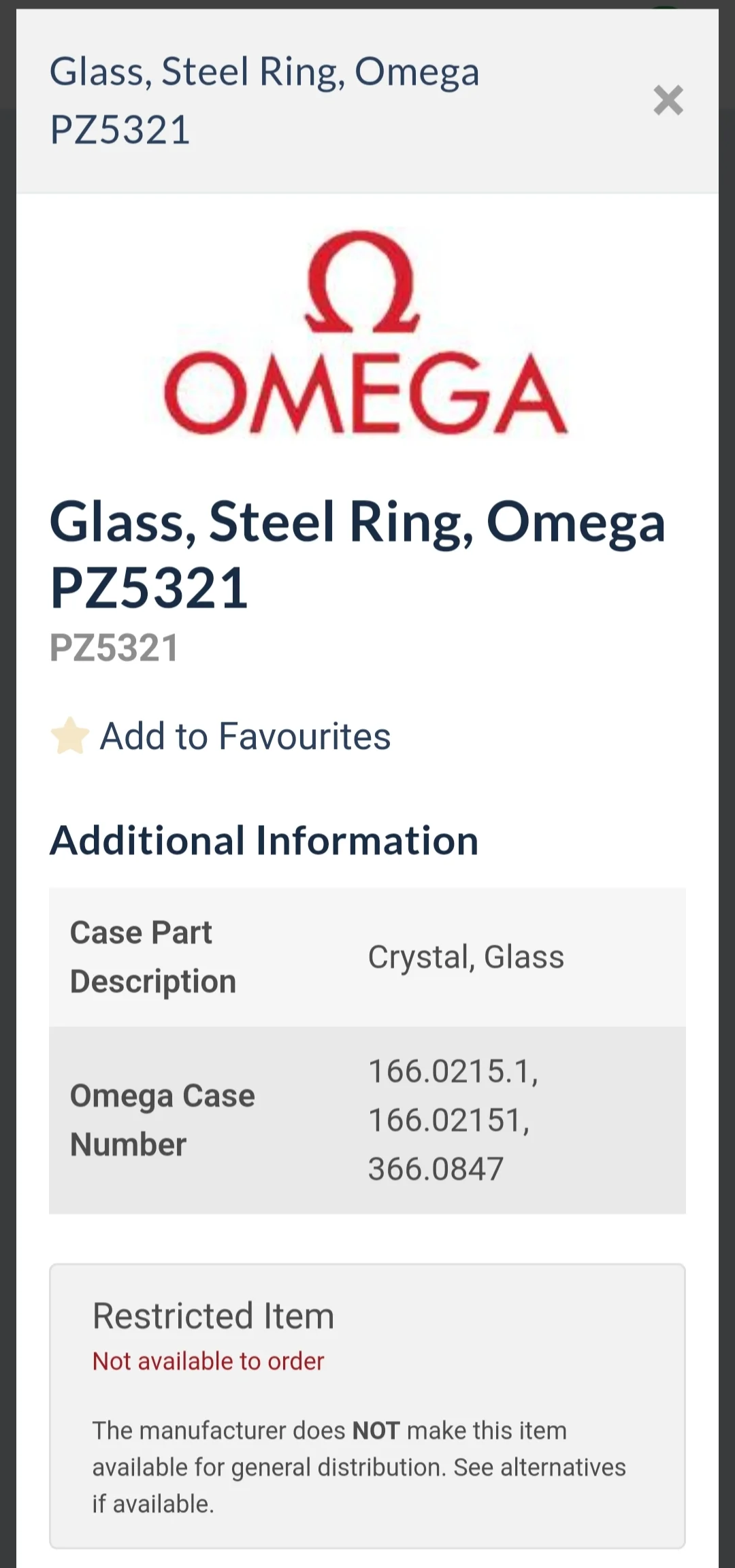

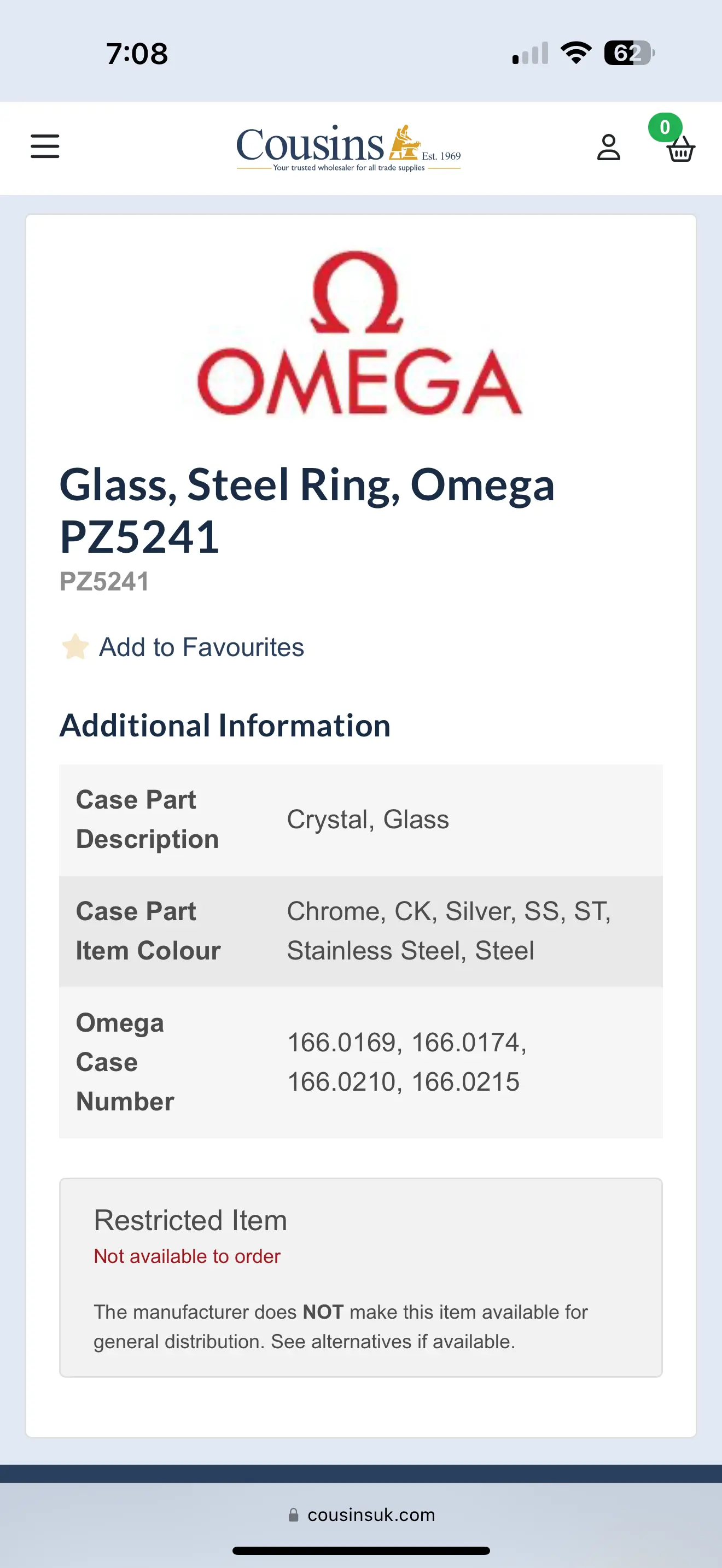

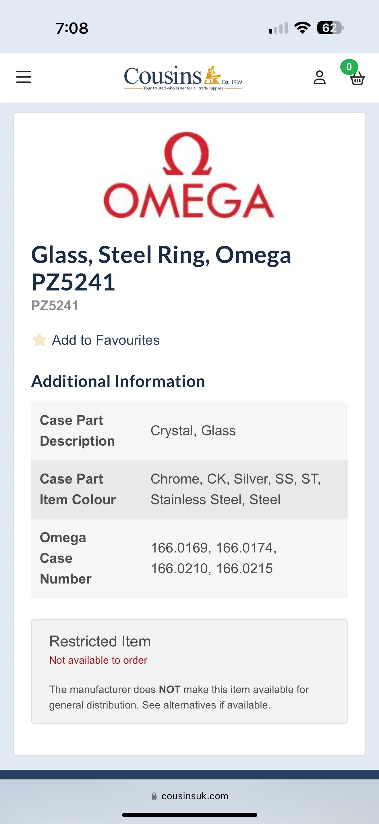

This should be what you need
Thank you so much for that info! Any advice on where could I find one to buy?

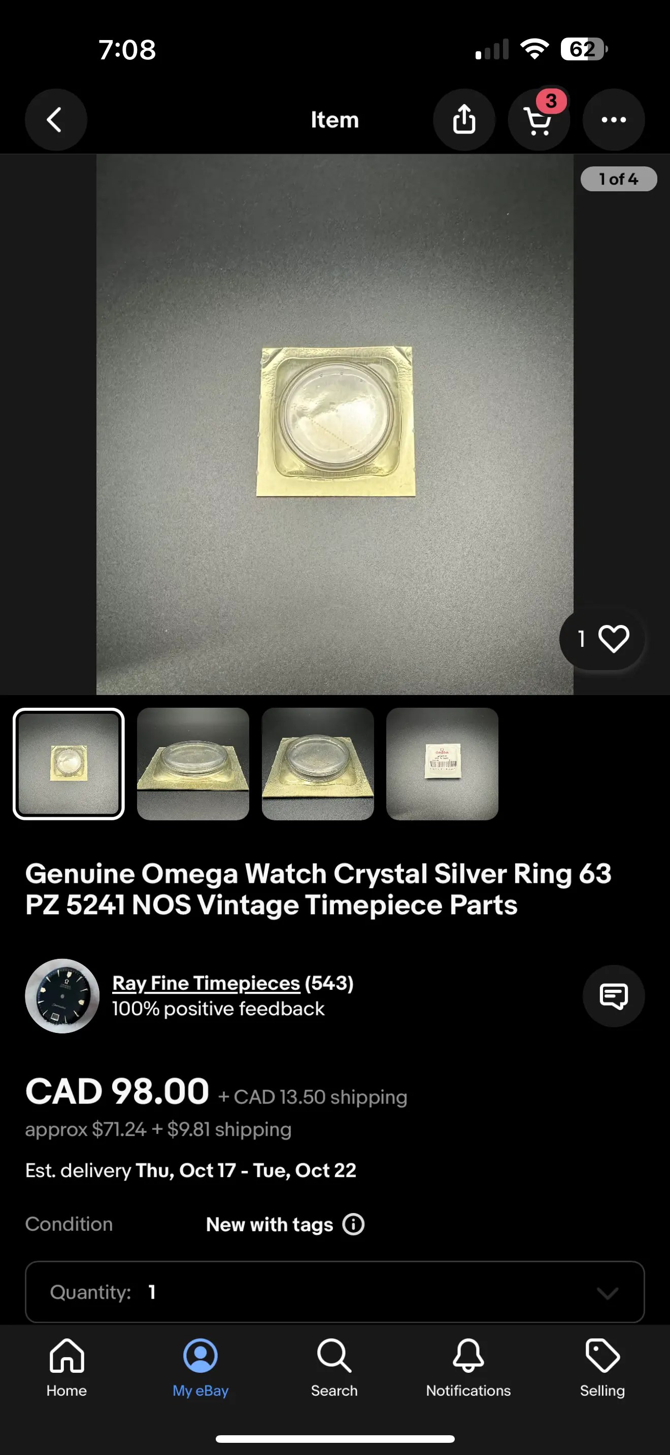

Yes that what I would like to try to do! You have any idea where can I find one to buy?

Yes that’s what I’m trying to do, and upgrade it with a sapphire aftermarket one. Any idea where can I find one to buy?
