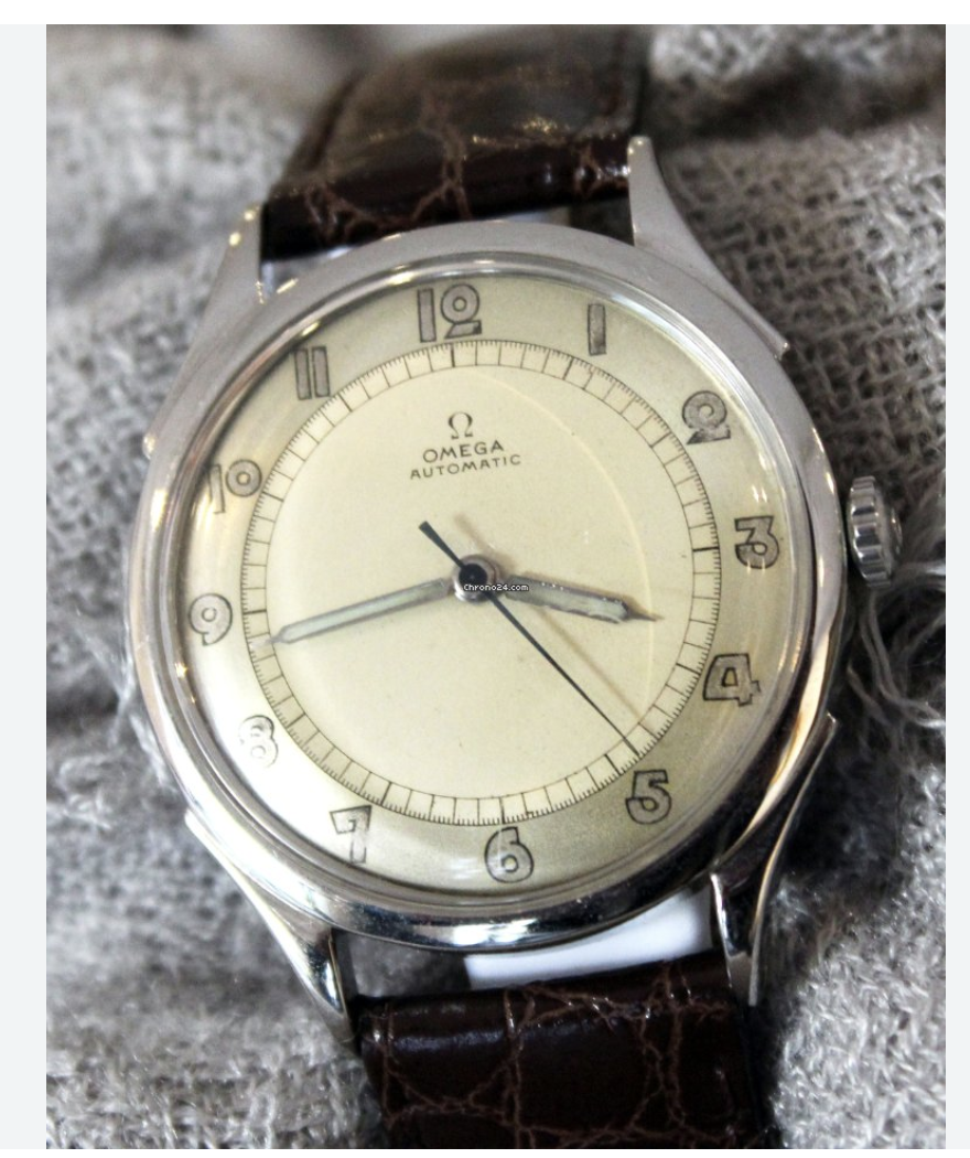

I repaired some old watches from my dad. I would wear those only very carefully due to the heirloom aspect.
But now I am interested in vintage Omega watches, especially ones from the 40s. If I got one, I would like to wear it more as an everyday watch.
If I got a 1940's Omega watch fixed up, would it be suitable for use as a daily driver?
I love the look, but much of the attraction to watches is the function.
https://www.chrono24.com/omega/omega-automatic-vintage-watch-bumper-caliber--id16136899.htm

I'd be very worried about water resistance, even wearing it in the rain, as cases this old often have little to none

Sounds like a perfect case for a nice looking redial with little collector value. Wear it and don’t worry so much about it. Plus, 99% of the people who see it won’t know its not original.

Yes, it could work, as long as you don't mind being careful with it, and having it maintained properly. But as mentioned above, if you can find one with a shock-resistant movement, and at least a modestly water-resistant case, it will be easier to care for. These features existed in the 1940s, but were more common in the 1950s.
The watch you linked does have a water-resistant case, and if the seals were replaced, it might be somewhat water-resistant, but you would still want to avoid getting it wet (even when washing hands). And certainly some cal 351 movements had Incabloc shock protection. I don't know if they all did, and the movement is not shown for that watch.

Thats a great point. Something to think about. I actually have a Baltic watch now which looks great, but i am feeling the itch for something a little more real...
Maybe Ill try to talk this redone watch price down..

So I dug in a little about Incablock. Thank you. Im also looking at other brands of the 1940s to early 1950s era:Longines, Zenith, Eterna, Omega, Cyma, Marvin.
Between these brands were some seen as more reliable than others?

I'm not as familiar with Marvin, but the the first four are all top-notch. Cyma is a bit less well-known, but still a very good brand.

I have a 1960 Eterna that runs great. Problem is, I had to do it myself; 2 local watchmakers sort of gave up on it. (and charged). From my internet reading, I don't get the feeling the company is supporting their old watches.
My father's vintage Omega was recently serviced by Omega-Switzerland. They did a great job. Expensive, though. And the vintage watches are maybe 2x other watches from the period.
Somehow I have grown an affinity for this time period, and I think the sizes are good too. If I get this next job, I;m gonna pull the trigger!
Thank you for the advice.

As long as you're careful there's no problem wearing a vintage watch as a daily.
My daily watch until very recently was a one owner Ed White Speedmaster. I probably wore it 4-5 days a week, with other watches in rotation for the other 2-3 days.
It was serviced and I was careful washing my hands, in the rain etc and never wore it to the beach or anything, but apart from that I had no issues.

I wear “trench” watches regularly and have never taken any more care with them than any modern watch. They’re not really all that delicate when you have an office job. Shoot a gun, wash the dishes, you’re fine.

Your trusted watchmaker, to whom you will hand over any vintage watch you buy for service, will let you know whether the piece is water-resistant enough for daily wear. That's pretty much the extent of commentary I get from mine—"keep it out of the rain and you're good to go" is the most dire remark I've ever gotten, usually because the crown bushing is worn out. Unless you have a physically challenging job, the biggest danger your watch faces is getting dinged by a metal doorframe.

Smacked my Omega trench against a door handle at the store, and broke the glass crystal. The rest of the watch survived.

Though, to be fair, the Speedmaster was known as an exceptionally tough watch.

Same- I am just very conscious about keeping hands at a downward angle when washing, not splashing too much etc- it becomes second nature. I did get caught in a horrible summer thunderstorm recently while on a day trip to Philly (day started sunny and mild), while wearing a 40's snap-backed chrono (might as well have open holes where the pushers are). I put it in my shoulder bag which does have some waterproof protection inside. I was soaked down to my underwear, but the watch was fine.

If I know it's going to rain I might wear a modern Omega or similar but most of the time I'm wearing some sort of jacket and generally a water-resistant (heh) one, so the watch is usually covered.

My professional job is just typing on a keyboard. At home (where I work these days) I have 12 and 16 year old boys and a dog, so there is the occasional ambush Nerf gun battle, football to catch, or loose dog.
I am looking for a good watchmaker. I'd rather not send out, but I will if I have to. I have had bad luck with two: one in Hong Kong, one in SF Bay Area. Good luck with Grand Central Watches in NYC (sent in the mail). I am located in SF Bay.

I can definitely recommend Nesbitt's in Seattle. At least it's short-ish trip? I mailed my watch from the Milwaukee area there and they mailed it back.
