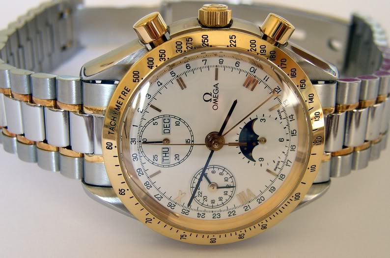

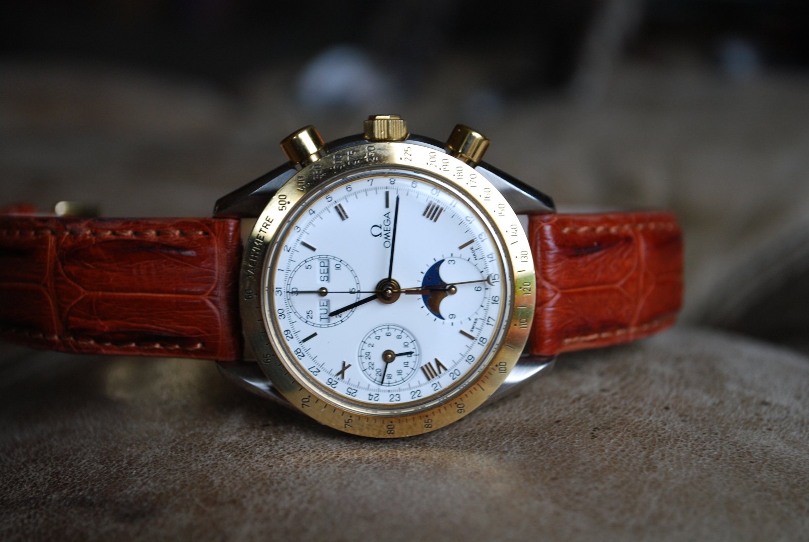

Dennis, really helpful, thanks. I didn't realise the 7750 went into these...
The 7750 makes for a nice wearing Speedmaster.
