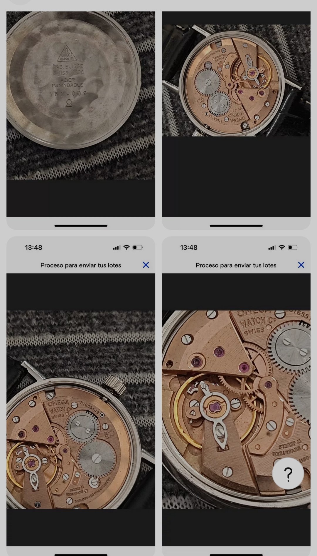

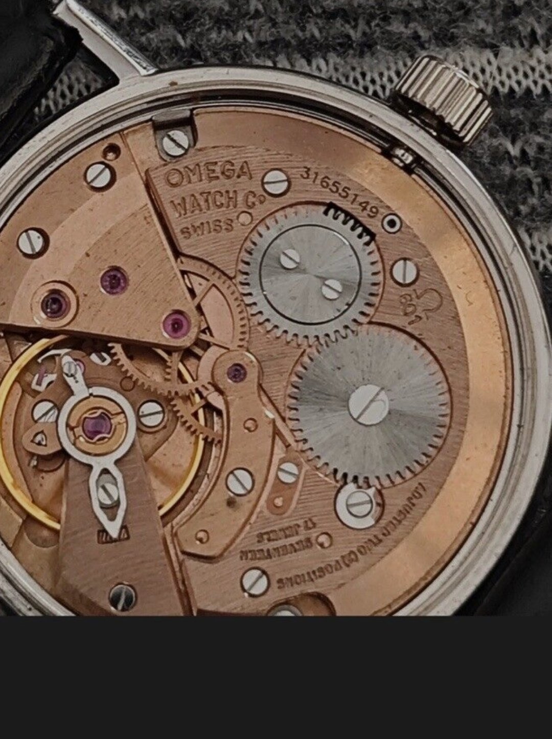

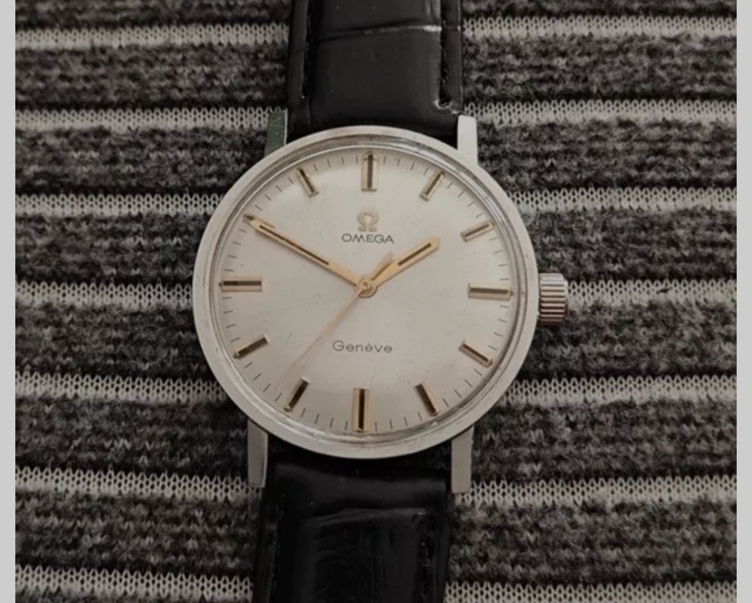

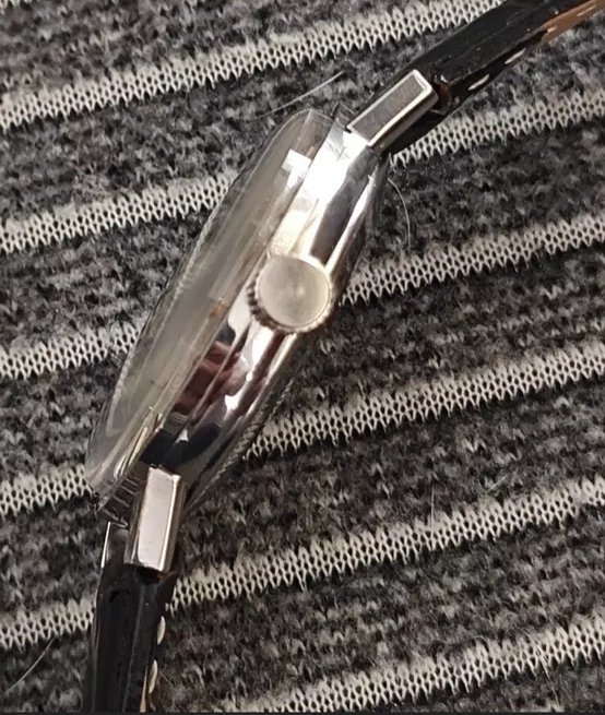

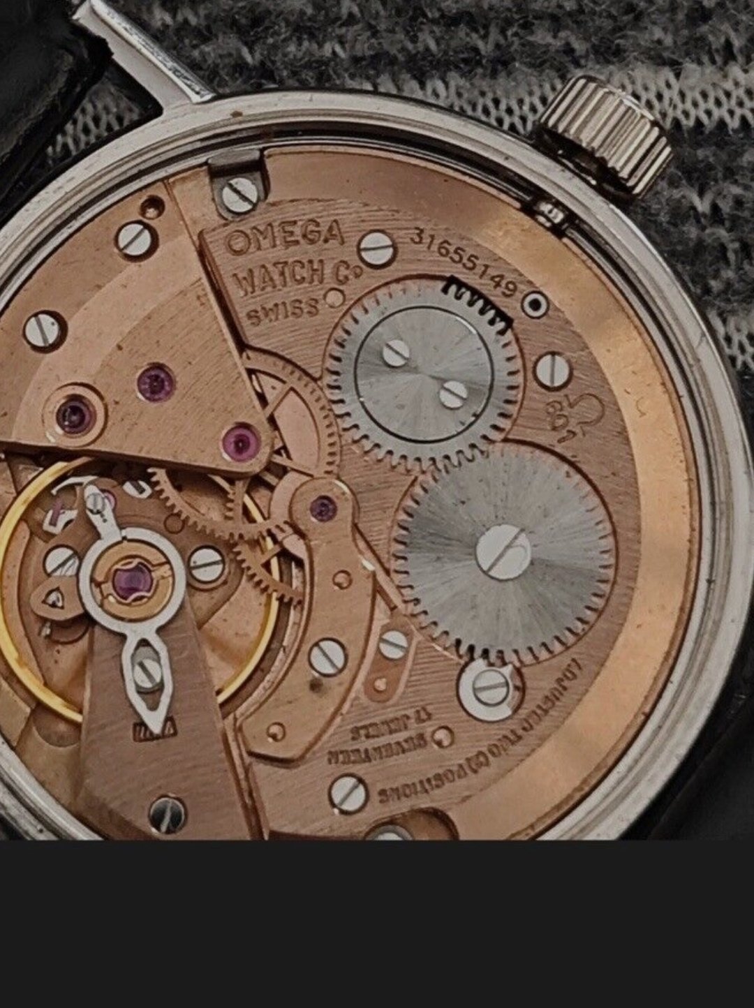

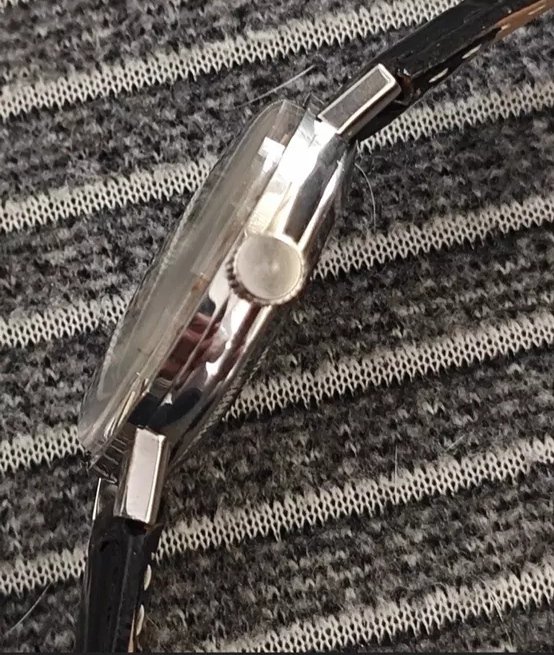

Hello everyone, I am looking to buy my first Omega and I want a 601. I am relatively new to Omega and just found a listing which seems very bizarre.
The caliber is 601. However the caseback says 162.009 which is an automatic watch with a day.
The dial looks fine, except for the Ω which seems fat and there's little space between the two horizontal lines at it's bottom.
The crown is obviously non-genuine, the strap too.
Thanks.

Backs can get swapped.
Automatic backs are deeper to account for the rotor. Crystals can be higher to account for date.
Dial photos are too blurry for any evaluation.

I’d say the caseback (and crown) have been swapped at some point. Not hard to find a nice Omega with 6xx so I’d pass and wait for an original one

Btw, do you think the dial is fake(repainted)? The omega letter seems messed up to me on this one.
13,522
23,461
I think the dial is fine. EBay and the forum is the best place imo. You won’t get the absolute bargains on the forum you sometimes find on eBay, but there and gone bargains require experience, otherwise you’re at risk of buying a dud.

Thanks for all the comments. So... do you think this is just a legit 131.019 with a fake crown and wrong caseback? Is it worth buying for 340€?
13,522
23,461
Thanks for all the comments. So... do you think this is just a legit 131.019 with a fake crown and wrong caseback? ?
Yes.
No

We can’t give a price for this watch as there is only one, out of focus picture of the dial. It looks like it might have staining, but perhaps it’s shadow.
If it has staining on the dial, plus wrong crown and wrong caseback, it might be worth £150 to someone, but that someone wouldn’t be me. I wouldn’t pay 1/2 of that for it as it could be a time consuming hassle and at the end of it I’d be left with a non original, average watch.
