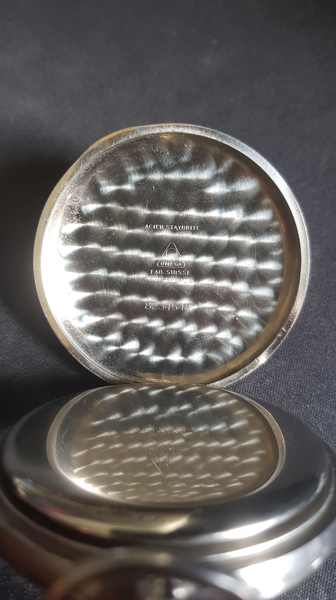

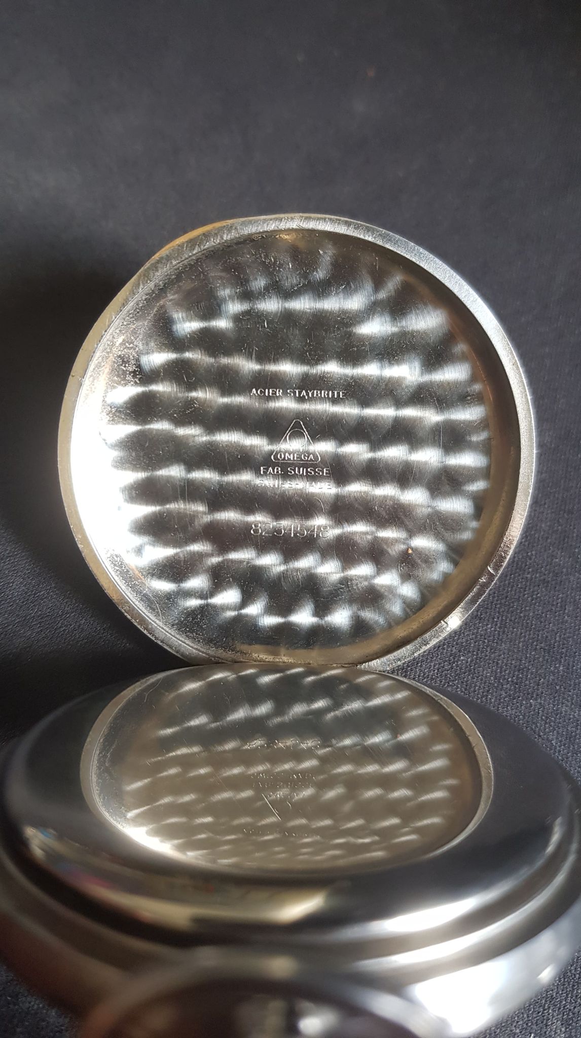

The case is made in steel (Acier Staybrite) and the serial number is in the 8 million range. I don't know if it's safe to share them, thus I hid the end of the one on the movement (It's in the 5 million range).

Here's some pics of the case if you want:

Regarding service, anybody on this forum would recommend that you should have the watch serviced, if you plan to run it (why not?!): finding a suitable watchmaker at a reasonable cost is a separate query, depending on where you live - but the watch should be a routine service for the right watchmaker, nothing complicated (not just a battery-changer!). As you describe, the movement has probably seen no lubrication for many years.
I agree with your comments about the dial being ‘more modern’ - but it corresponds with dials of other calibres from this period (as described, my guess is about 1936) and is indeed a later dial than some 43.15 VERYBEST.
Regarding value, as described this was a special calibre - but some of these watches were cased in 18 carat gold. I don’t think you should expect big money! I can’t give you a figure (which isn’t the style on this forum) - but it only needs two people who have an interest… The attraction of an Extract is to confirm the ‘authenticity’ - about which you asked. It looks authentic - but (assuming it features in the Archive - there are some gaps) an Extract would at least confirm that the movement and case started life together and give you a date. I doubt that Omega Heritage can offer more than that anyway.
