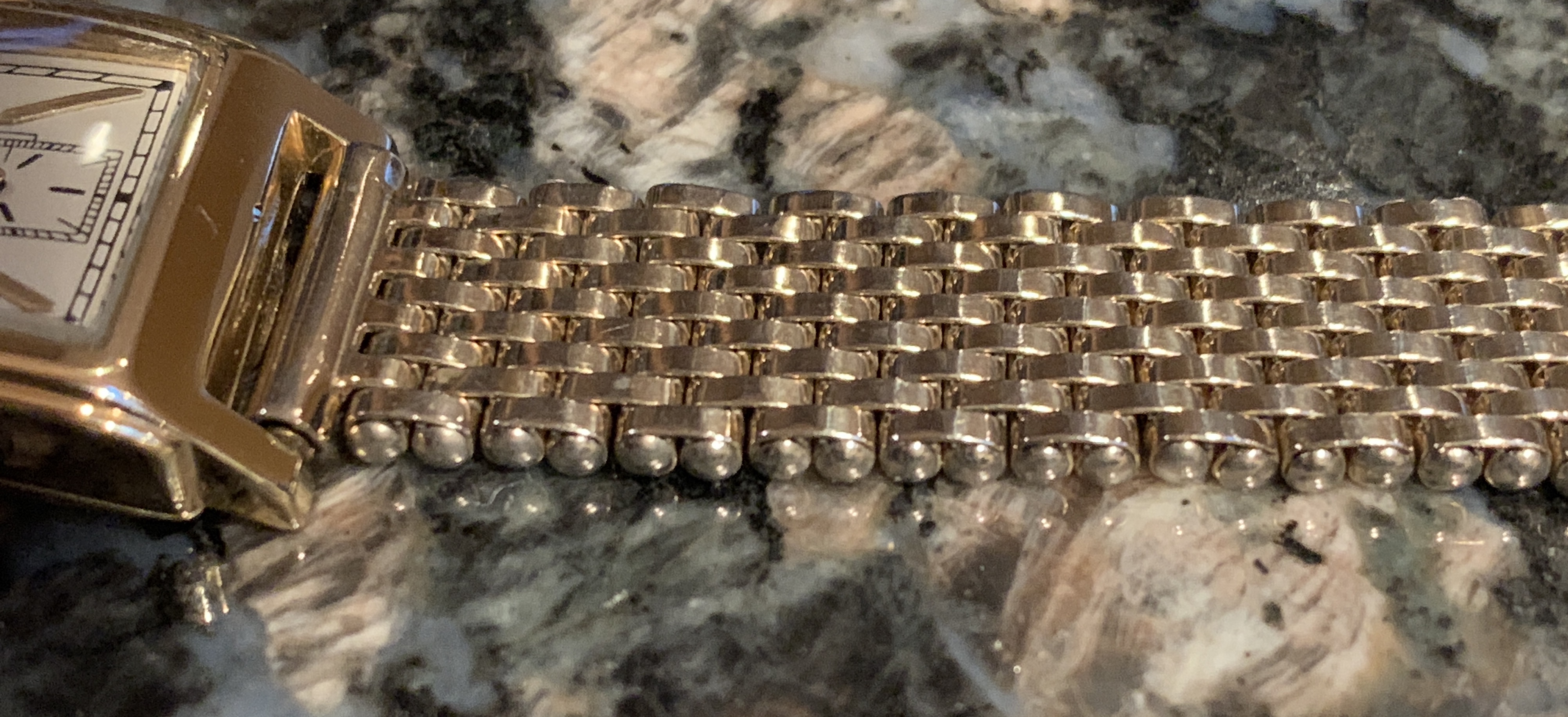

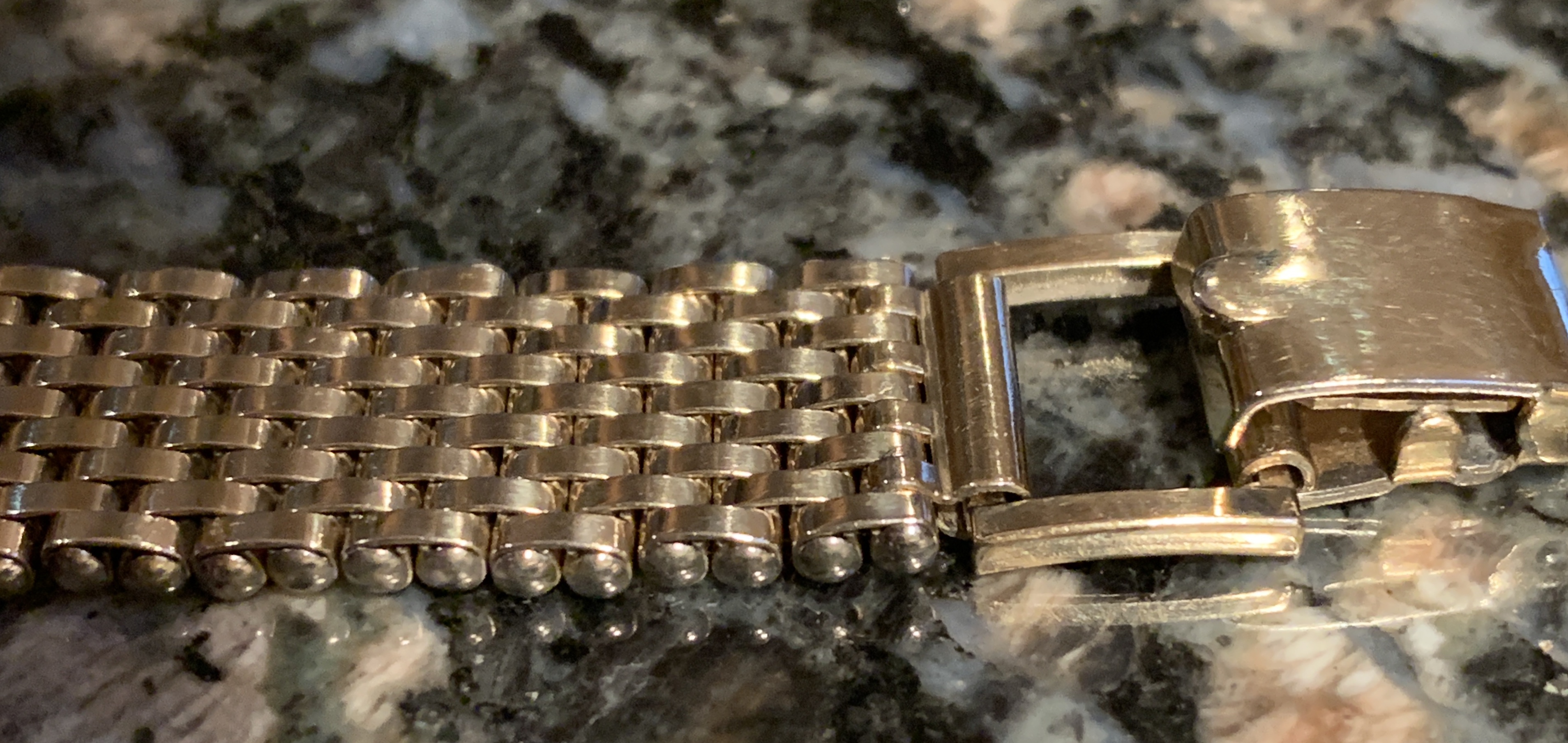

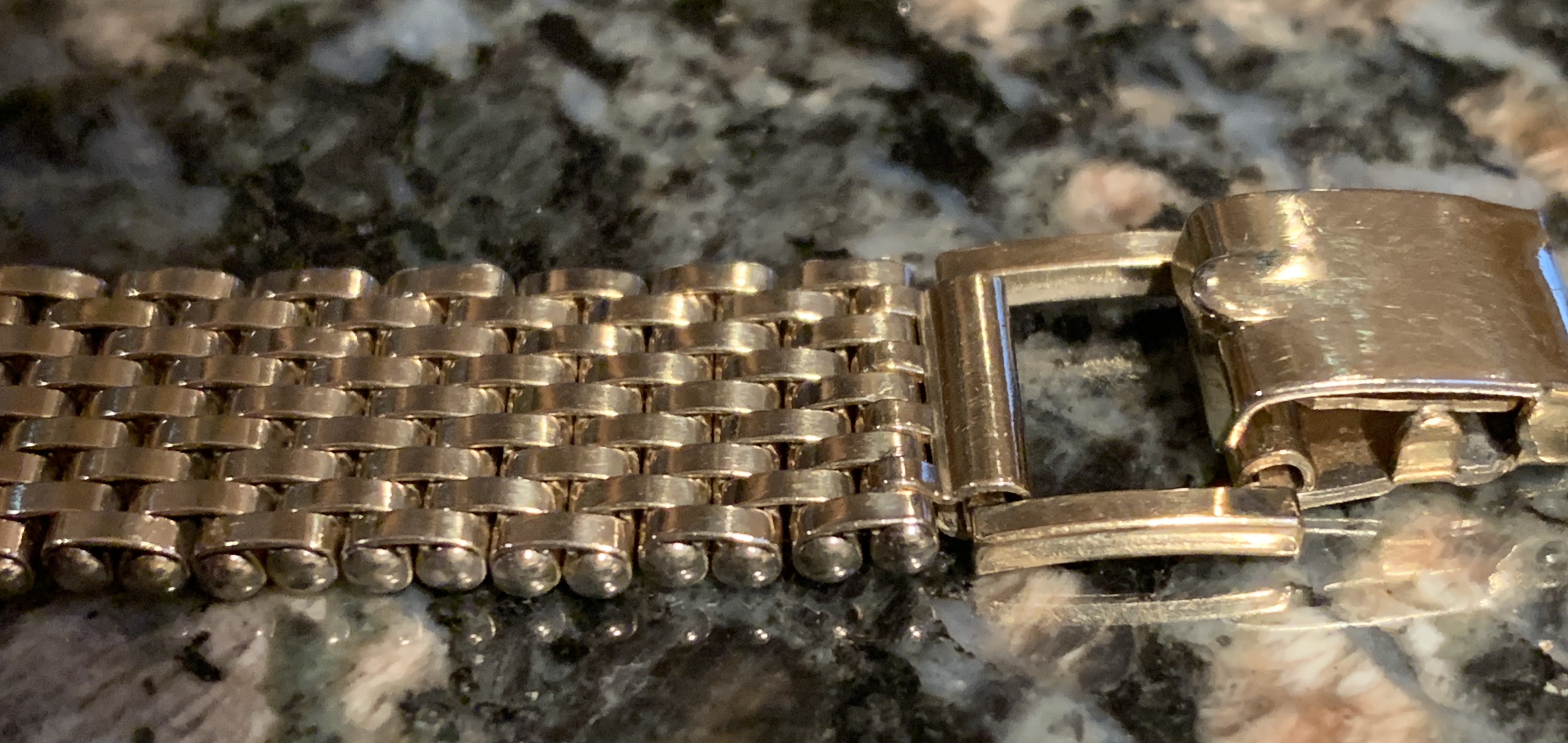

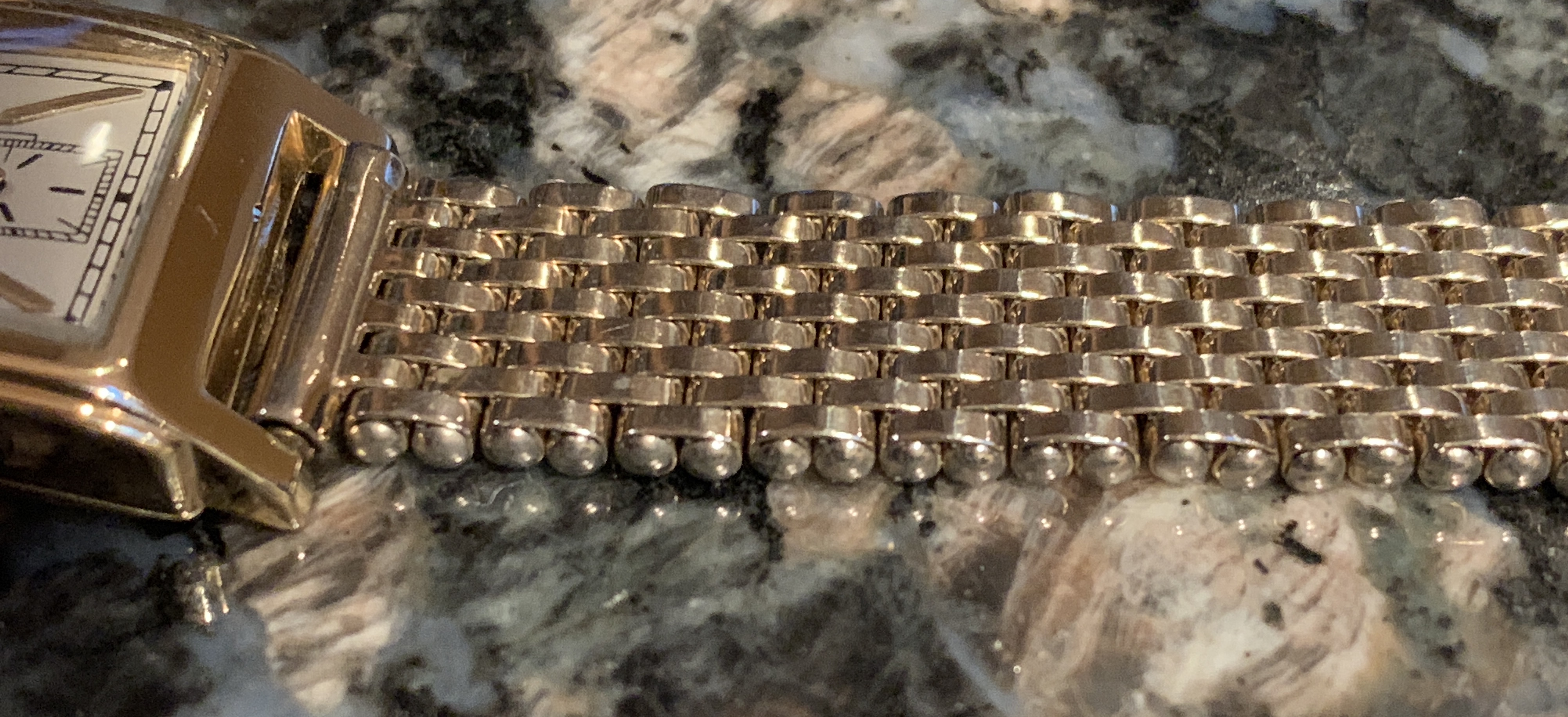

I have a vintage Hamilton watch that came with a Duchess bracelet (1940's - '50's ?) with a basketweave mesh. It's a bit too long but I'm not sure how to shorten it as all the links seem to be "riveted".
Any tips?

Normally you would need a pin extractor tool to be able to pull out those domed pins.
https://www.uhrmacherwerkzeuge.com/augusta-pliers-for-watch-strap-shorten-pin-extractor-125mm
Managing to pull out one, you end up with a long pin and its shorter part.
You then can calculate by how much you need to shorten the band and preferably mark it.
Pull out the second domed pin. Check if the length you ended up with is okay on your wrist and if so, you then need to insert the longer part of the pin through the links and hammer in the shorter part.
If you do not have this pin extractor tool, an end cutter should do the trick. Just don't press hard as you'll cut through it.

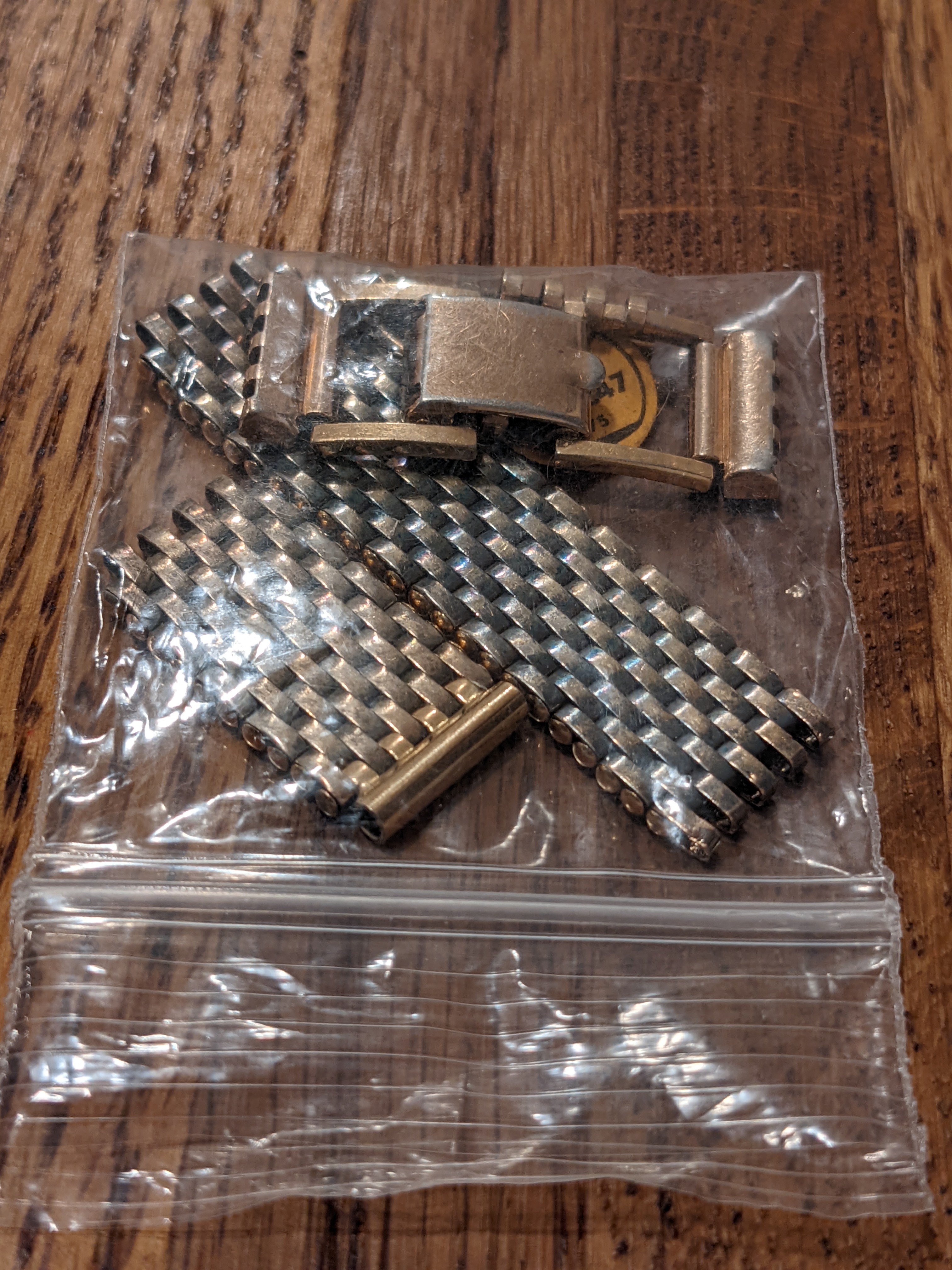

I just combined two of this style here: https://omegaforums.net/threads/sizing-1940s-gold-filled-kreisler-basketweave-bracelet.141794/
Pins in my Kreisler were closer to 1.4mm. I tried 1.5mm t-bars but they were too wide.
I used a single 999.020.18 pin, cut to length (~12.5mm):
https://www.jewelerssupplies.com/wa...fold-clasps-1-20mm-individual-999.020.18.html
I used the insert from a 906.037.01 to assist in cutting:
https://www.jewelerssupplies.com/t-bars-906.037.01.html

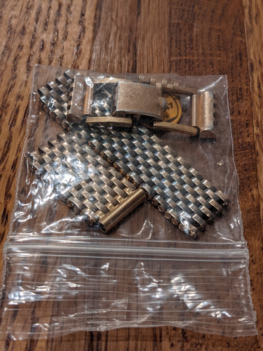

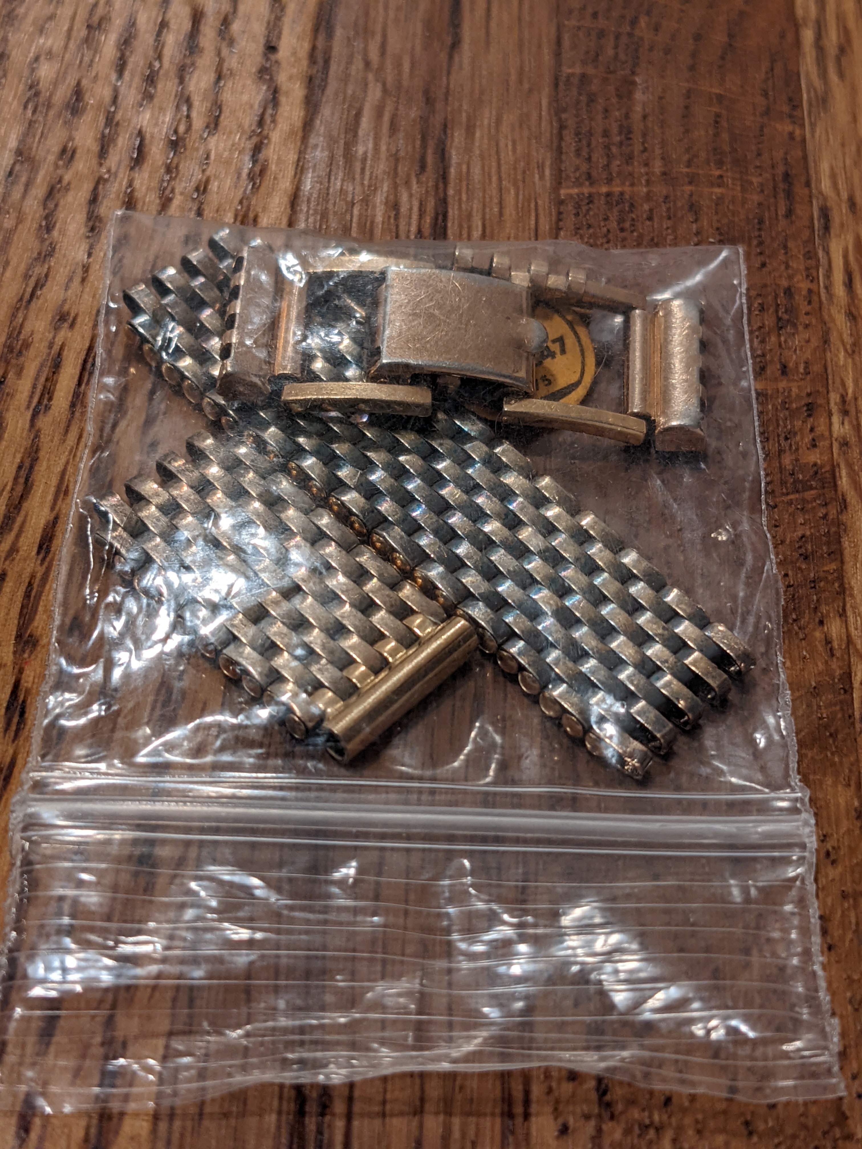

The one replacement pin is in the middle of the 12 side of the bracelet, size and shape of the head are very good IMHO:
pxl_20220228_234830471-jpg.1377591
Let me know if I can provide any additional info, or if you need any parts. I have more of the pins above, a section of basketweave in rose gold plate, and a fold-over (non-deployant) clasp.
