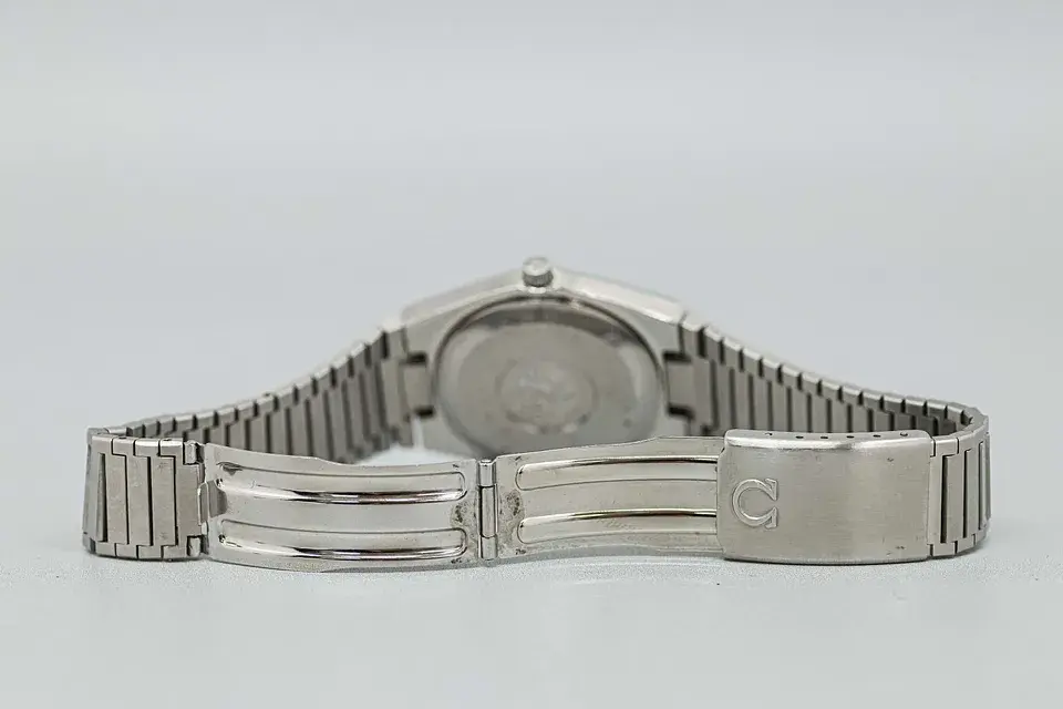

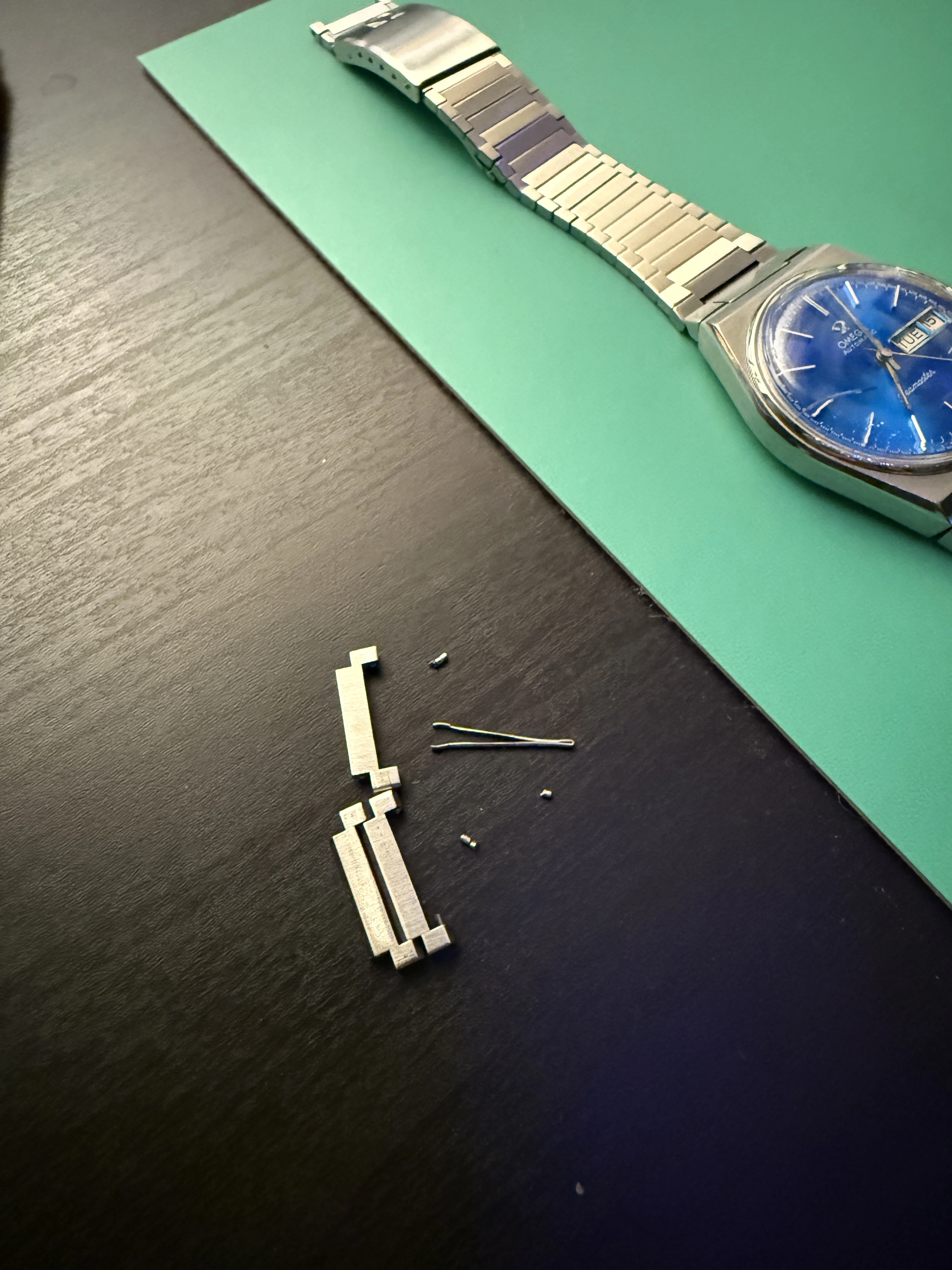

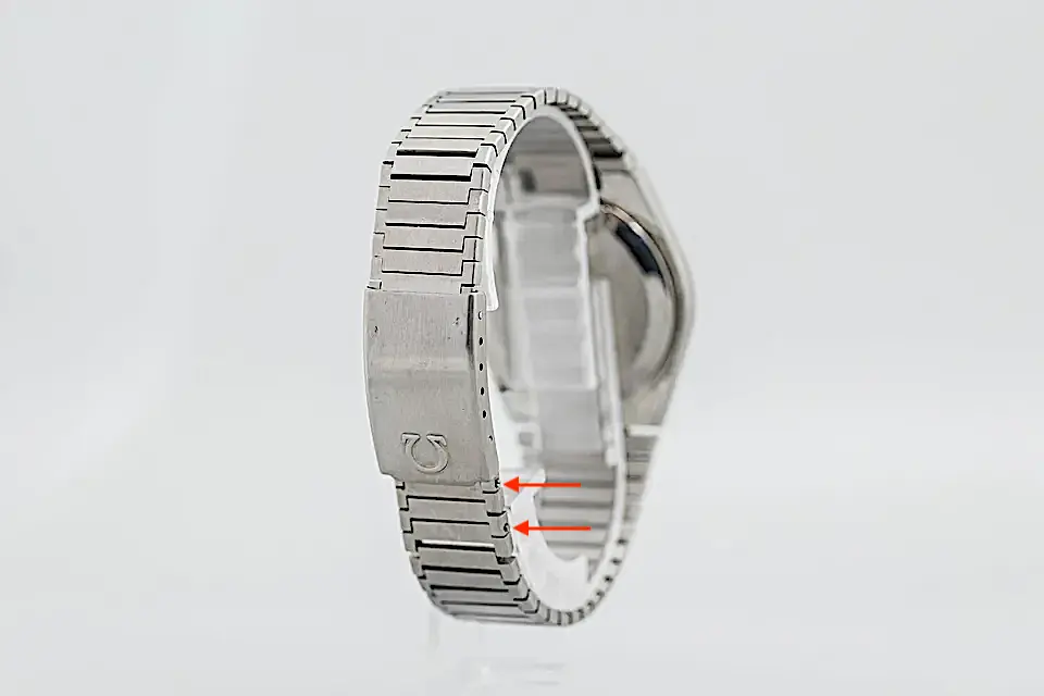

I need a little help understanding how this bracelet works to get it adjust it…
18,840
39,182

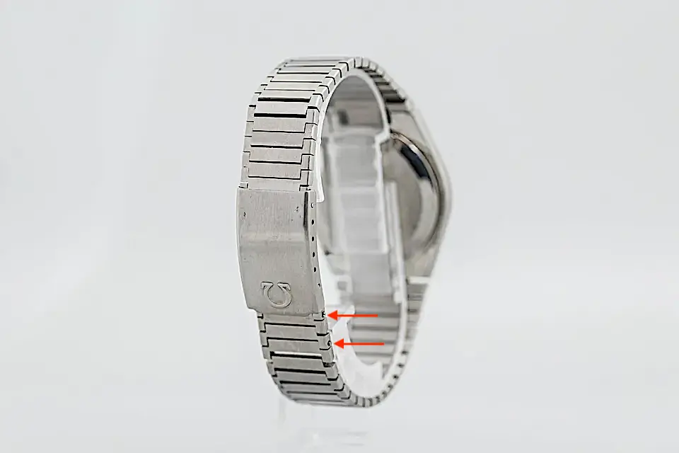

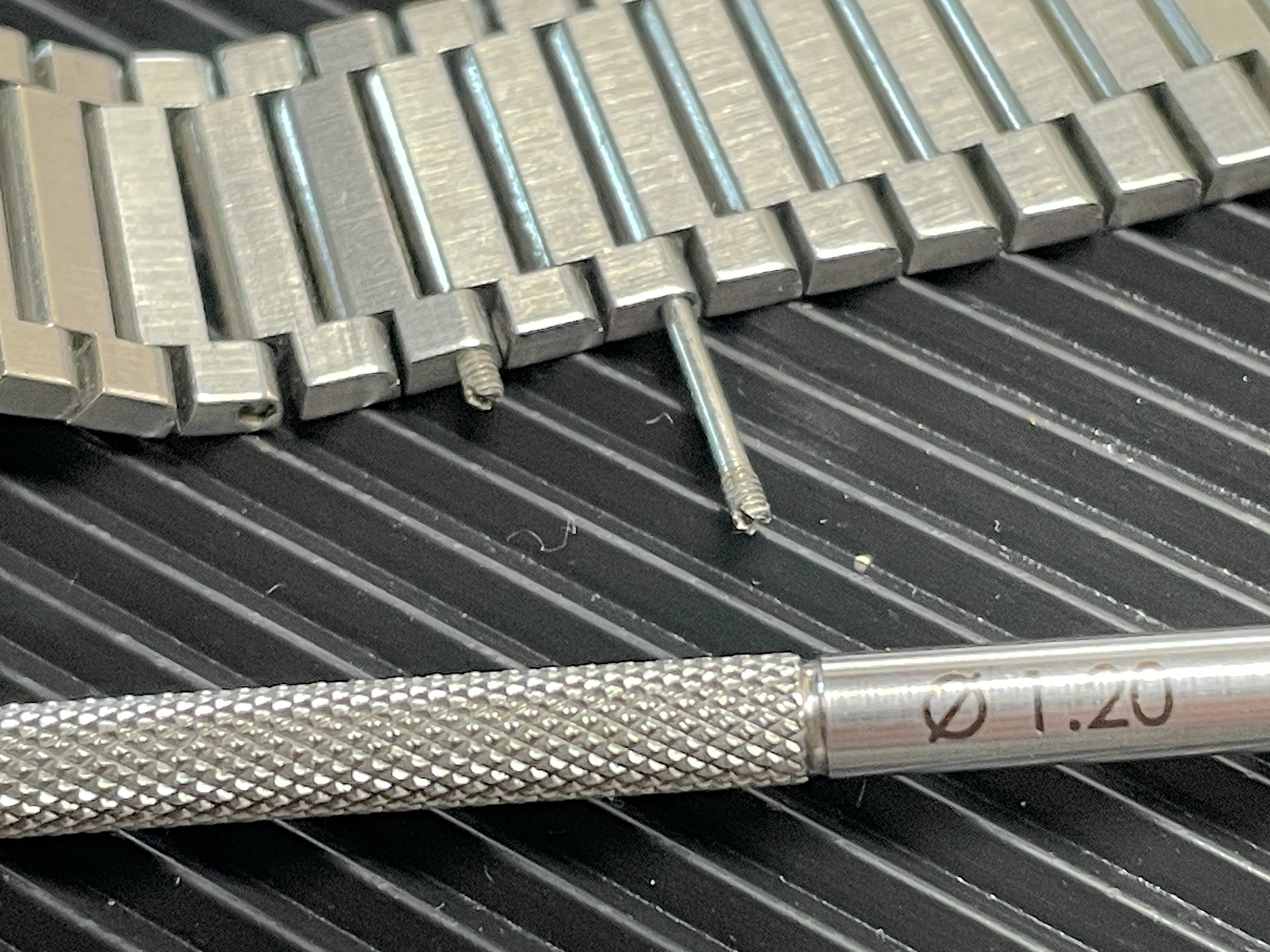

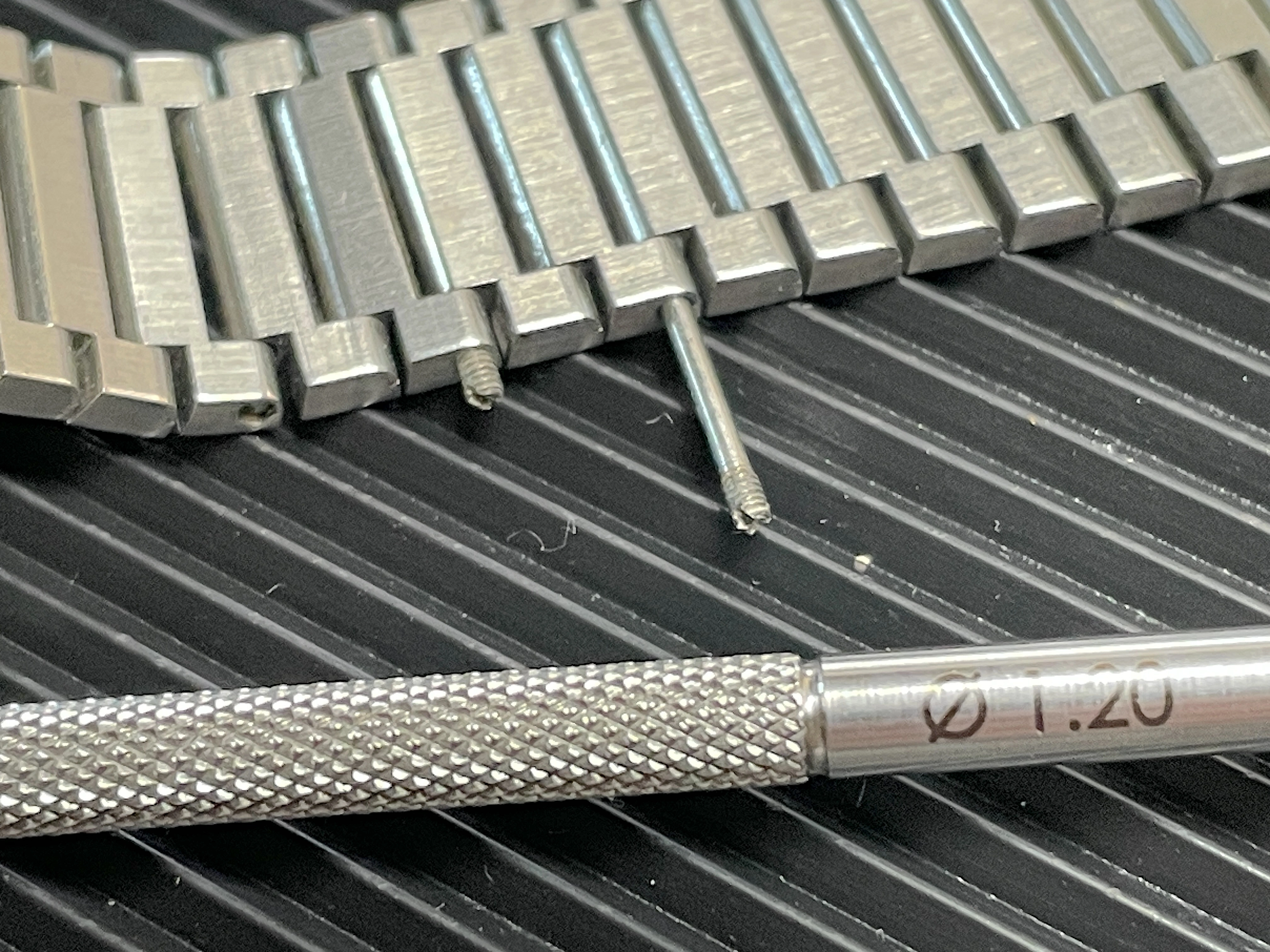

Look along the edges until you find holes with cross tip screws in them.
Get a 1.2mm screwdriver and remove the pins as needed.
Install the pins, tighten up, all done.
23
Mine doesn’t really any like that? They are all flat no holes at all…

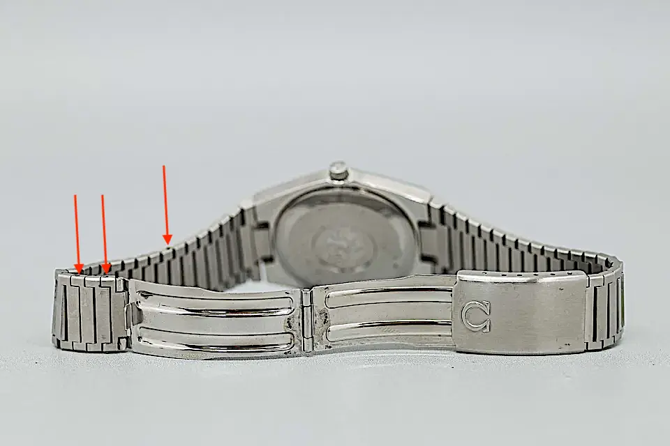

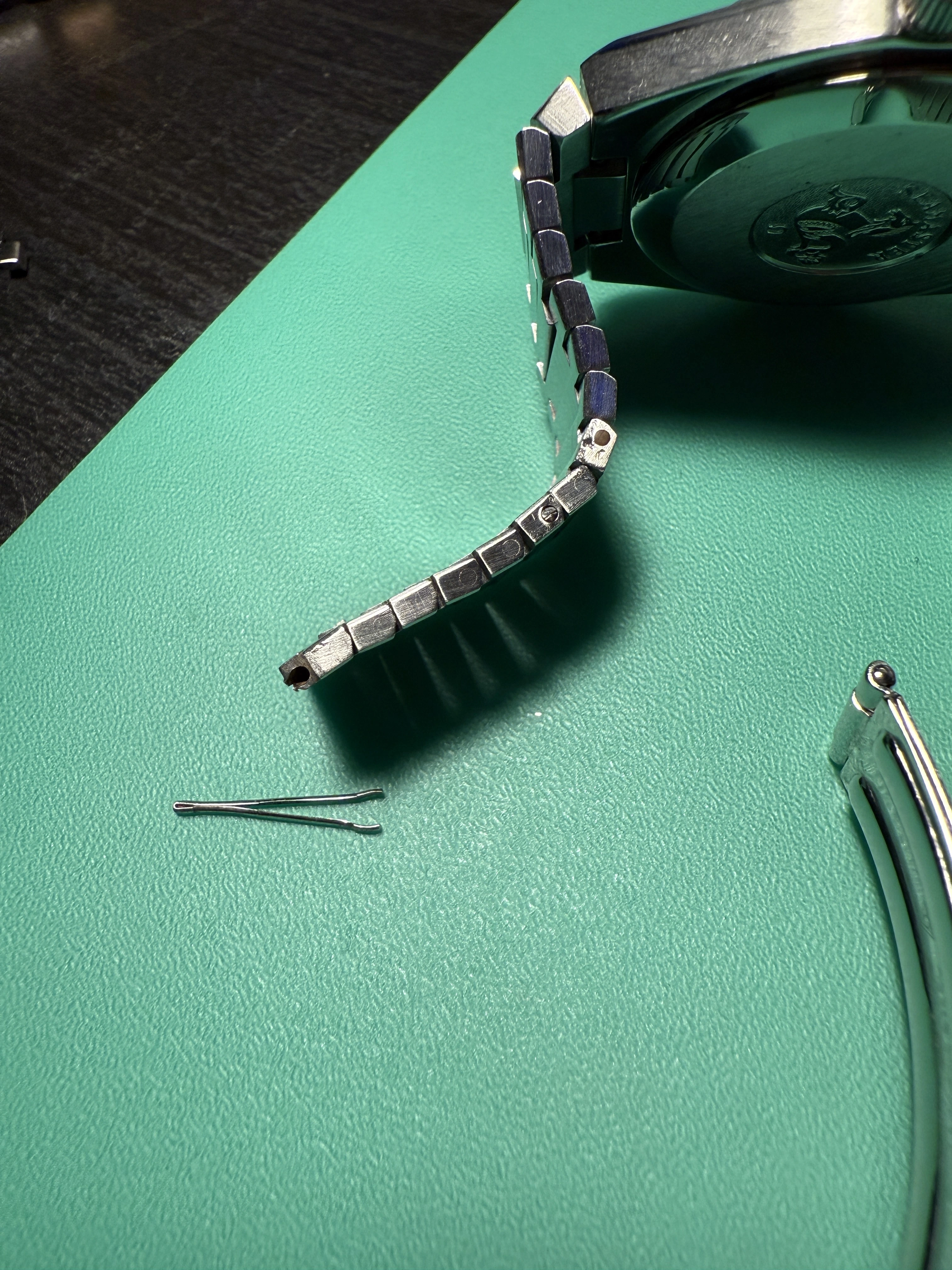

I can see at least three, they may have been replaced with split pins.
23

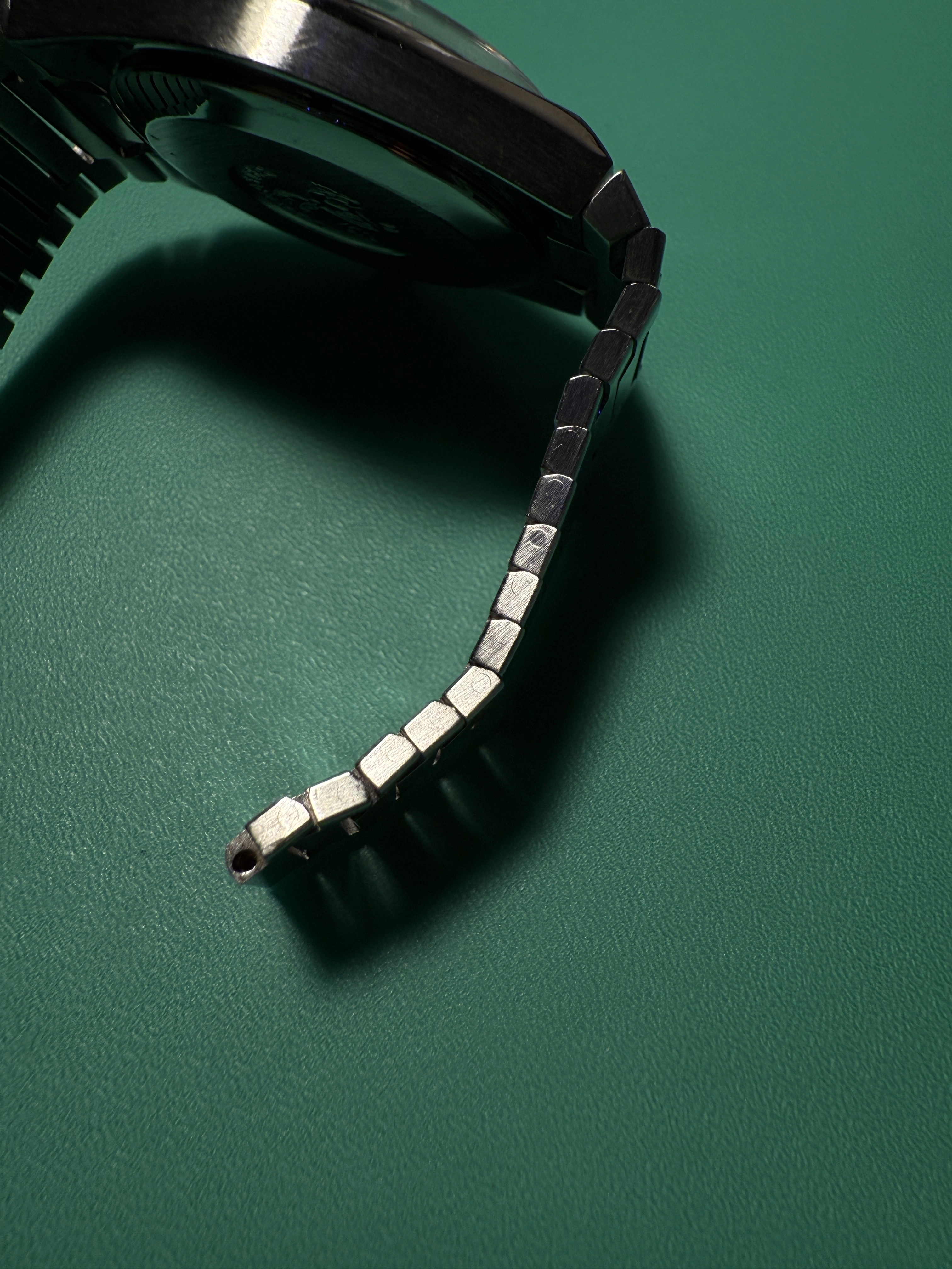

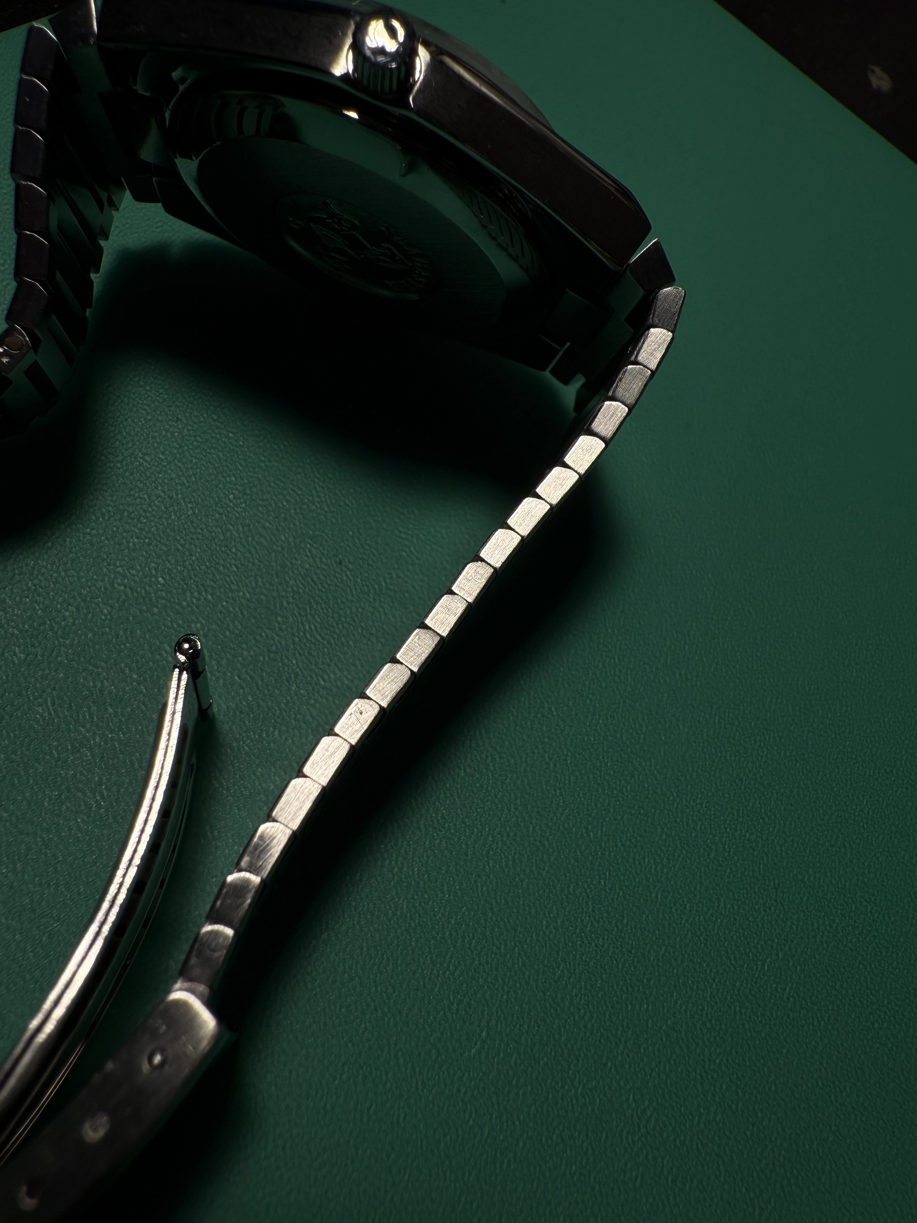

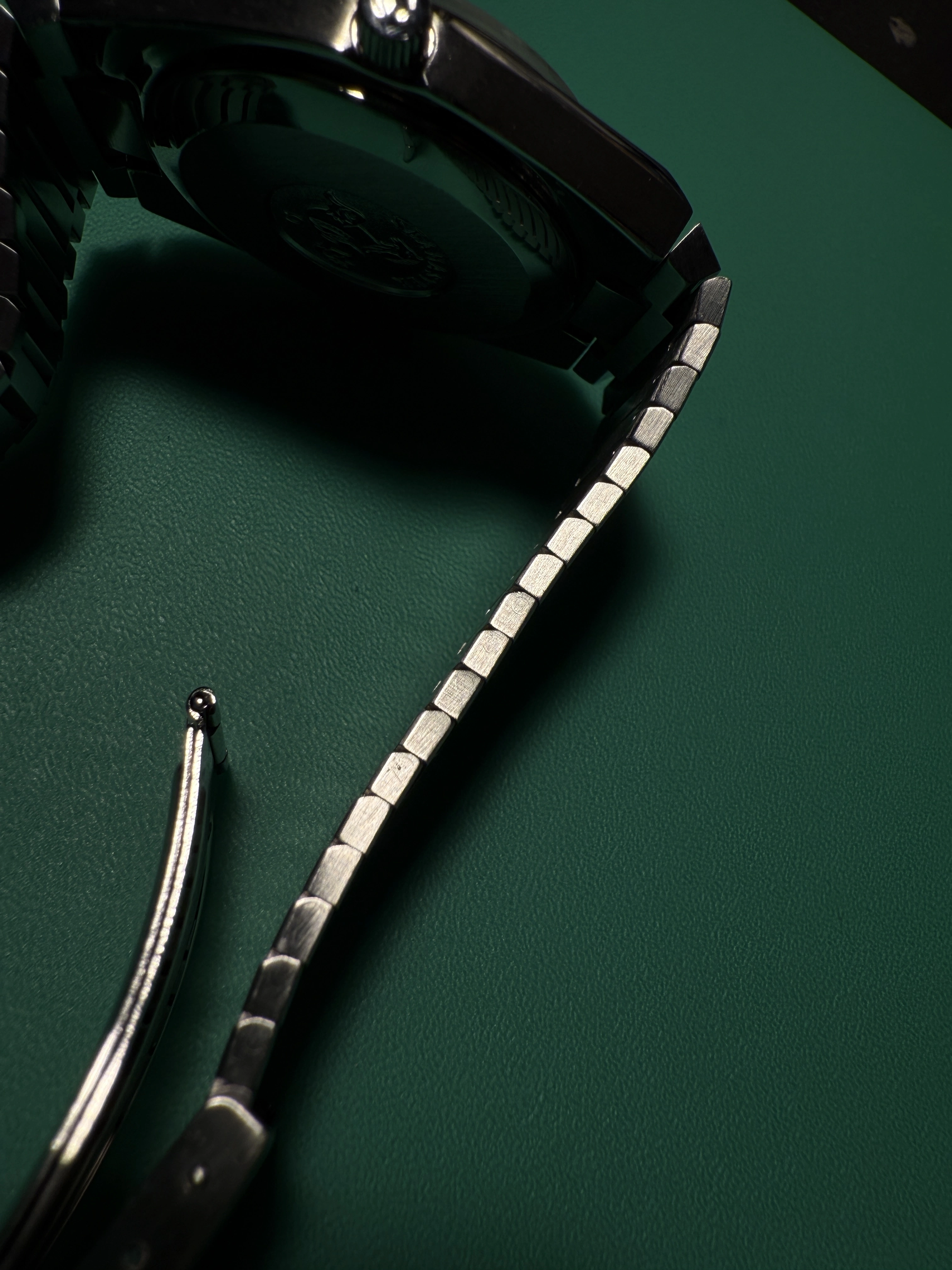

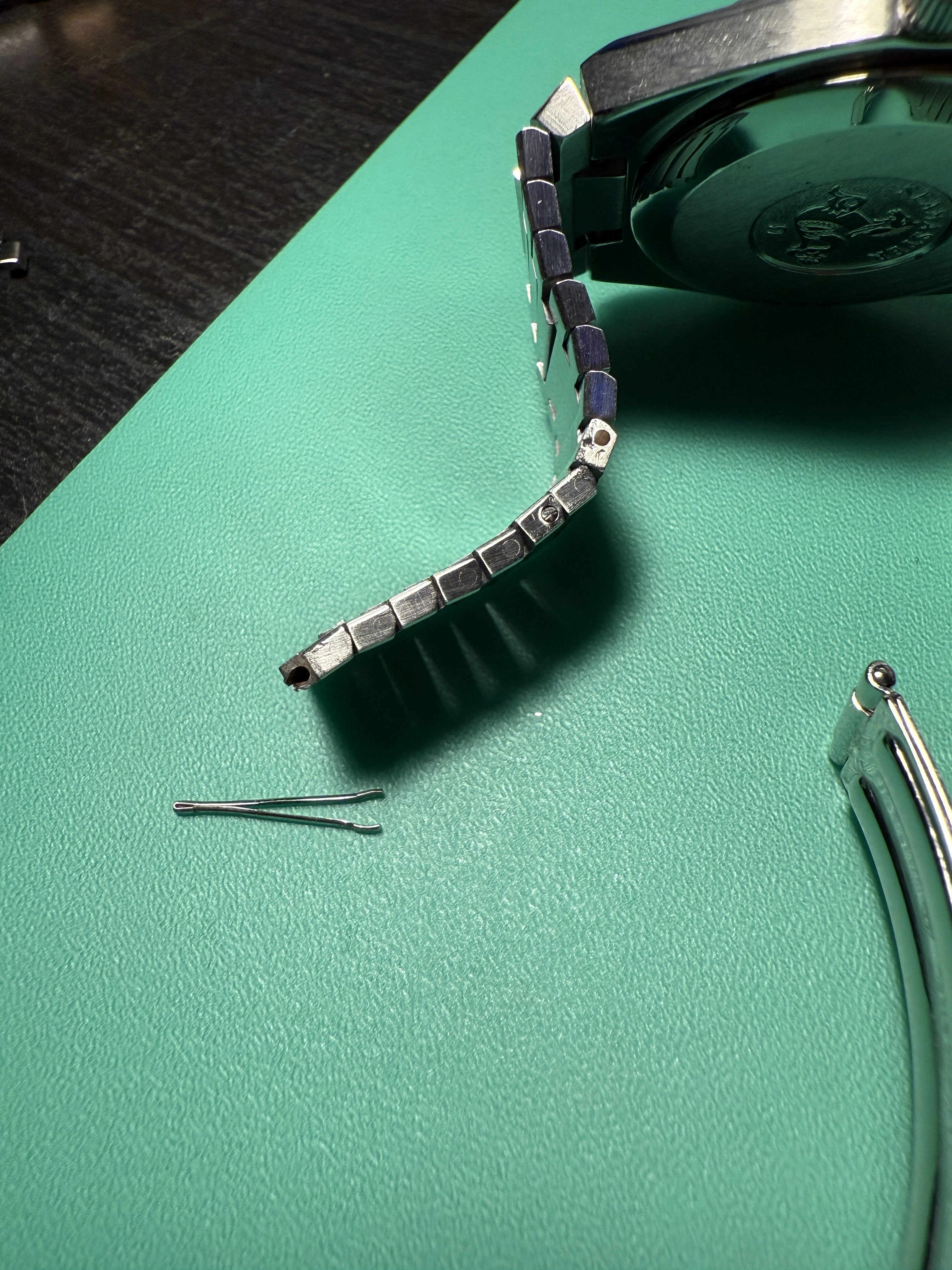

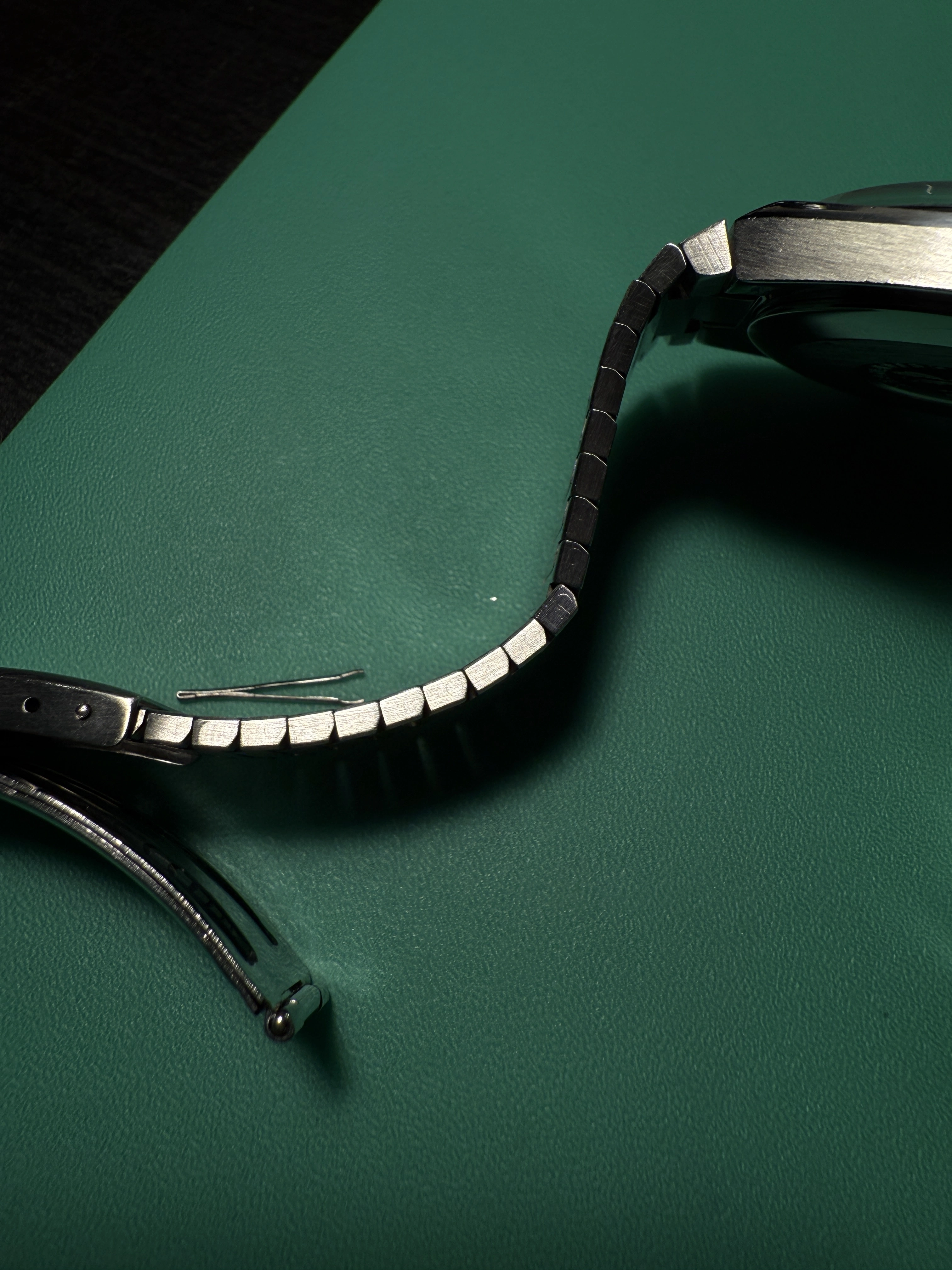

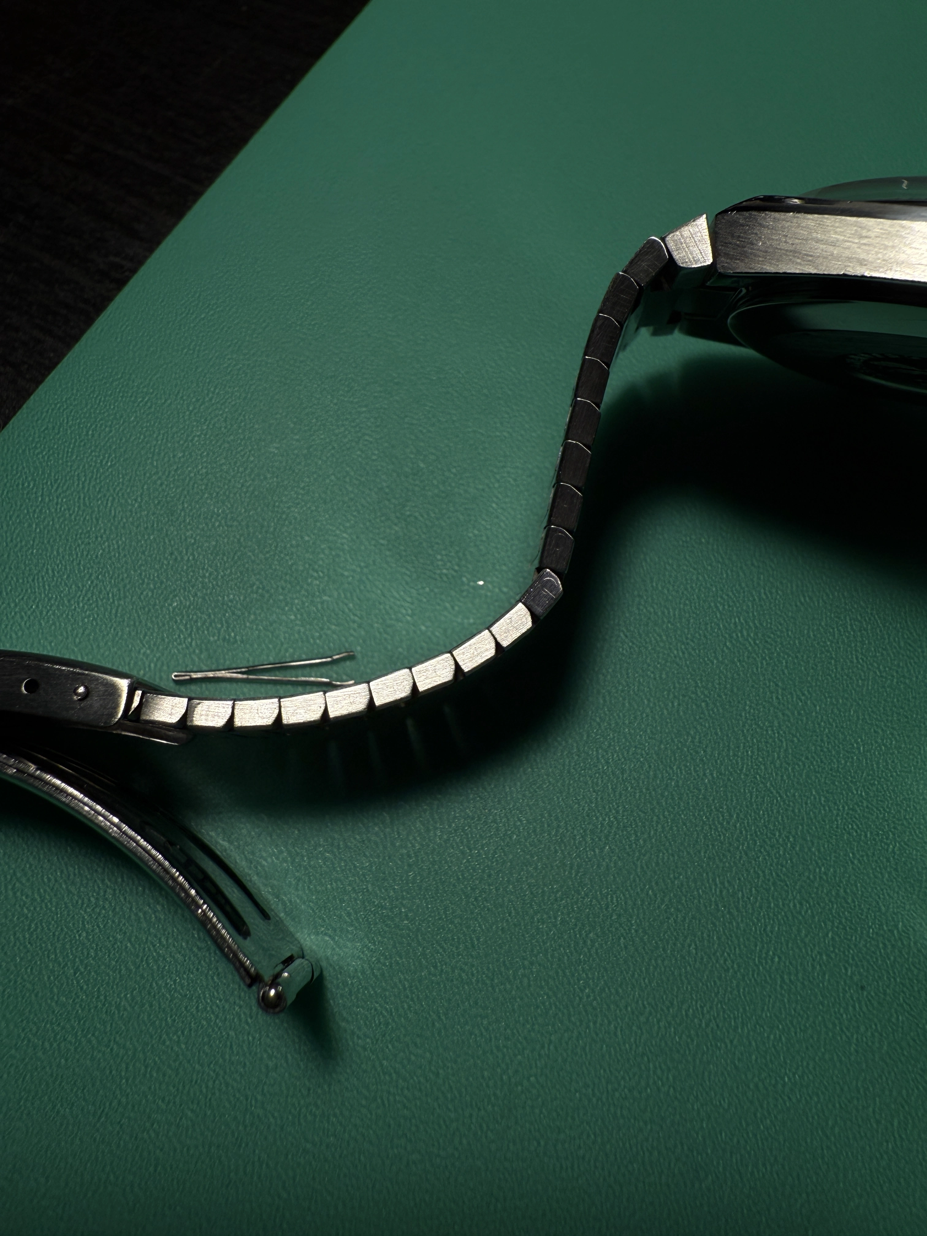

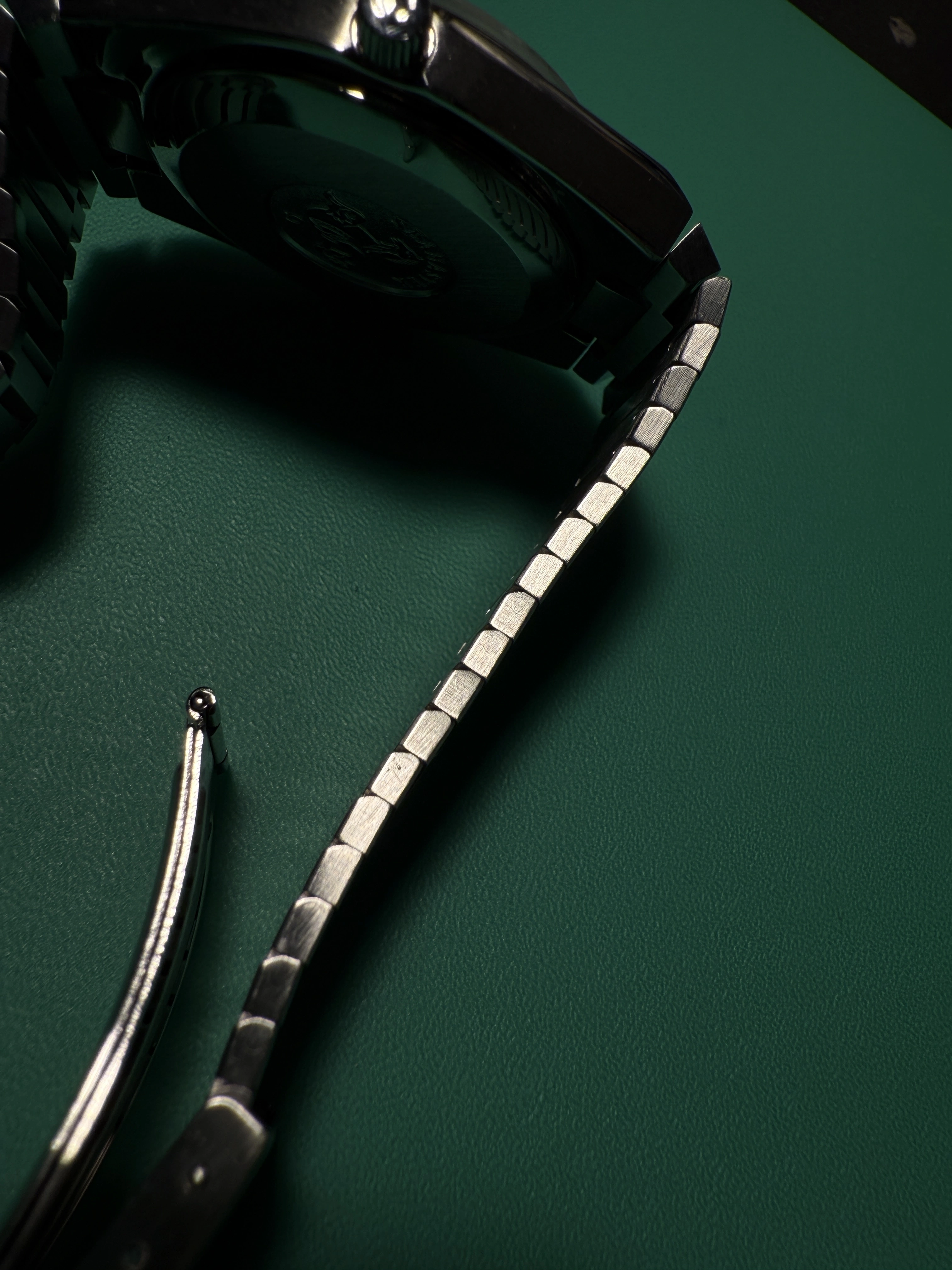

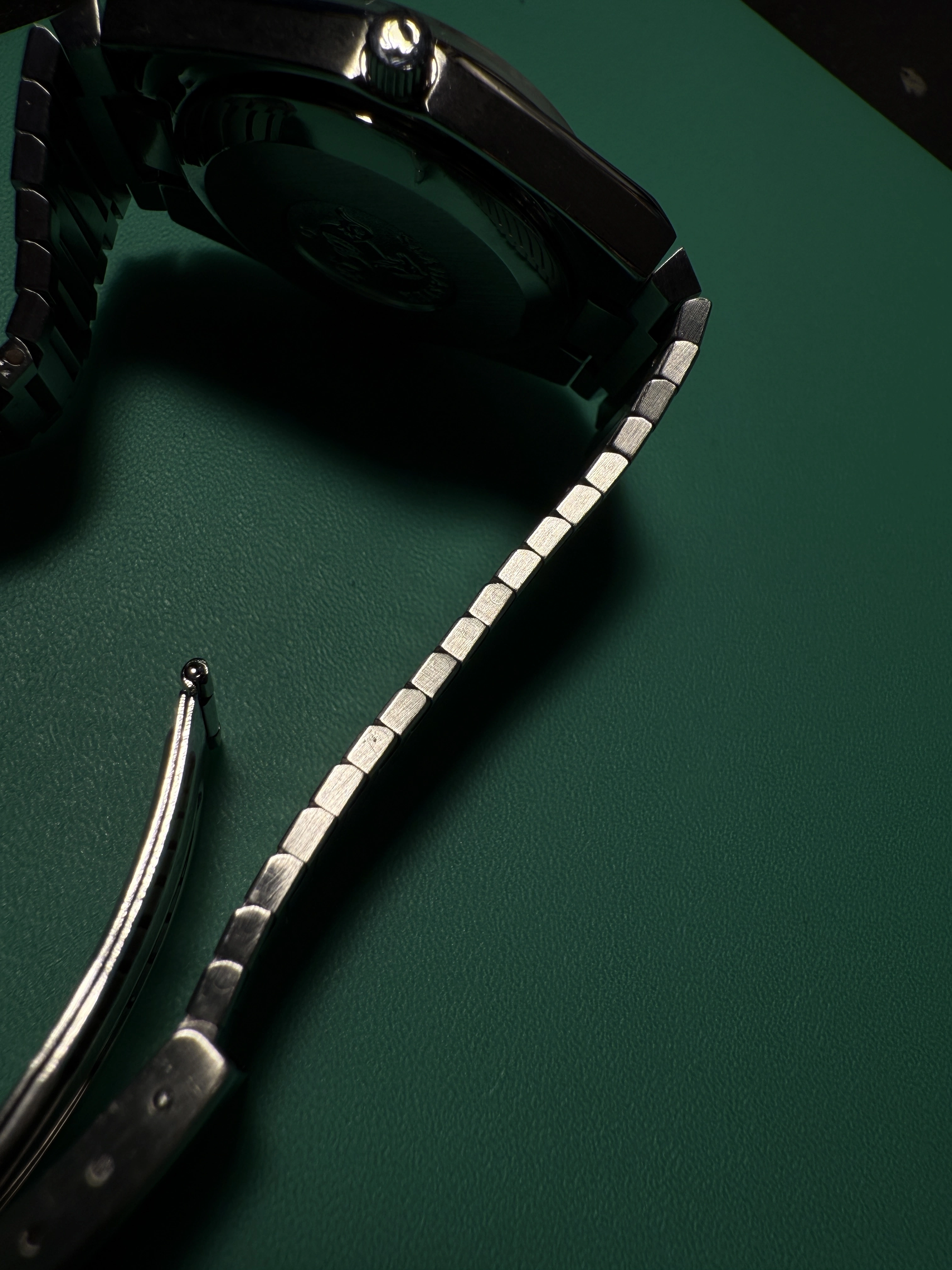

Well I could only remove one and it was replaced by a pin, the other ones are stuck, can’t really resized it to fit my wrist at all

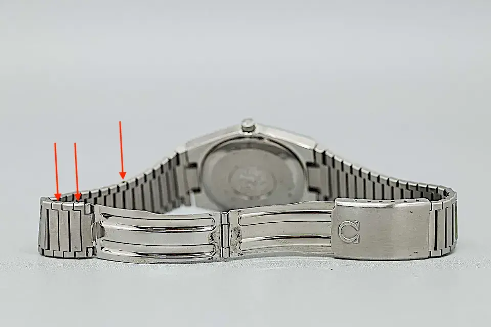

Are you trying to go a little tighter??

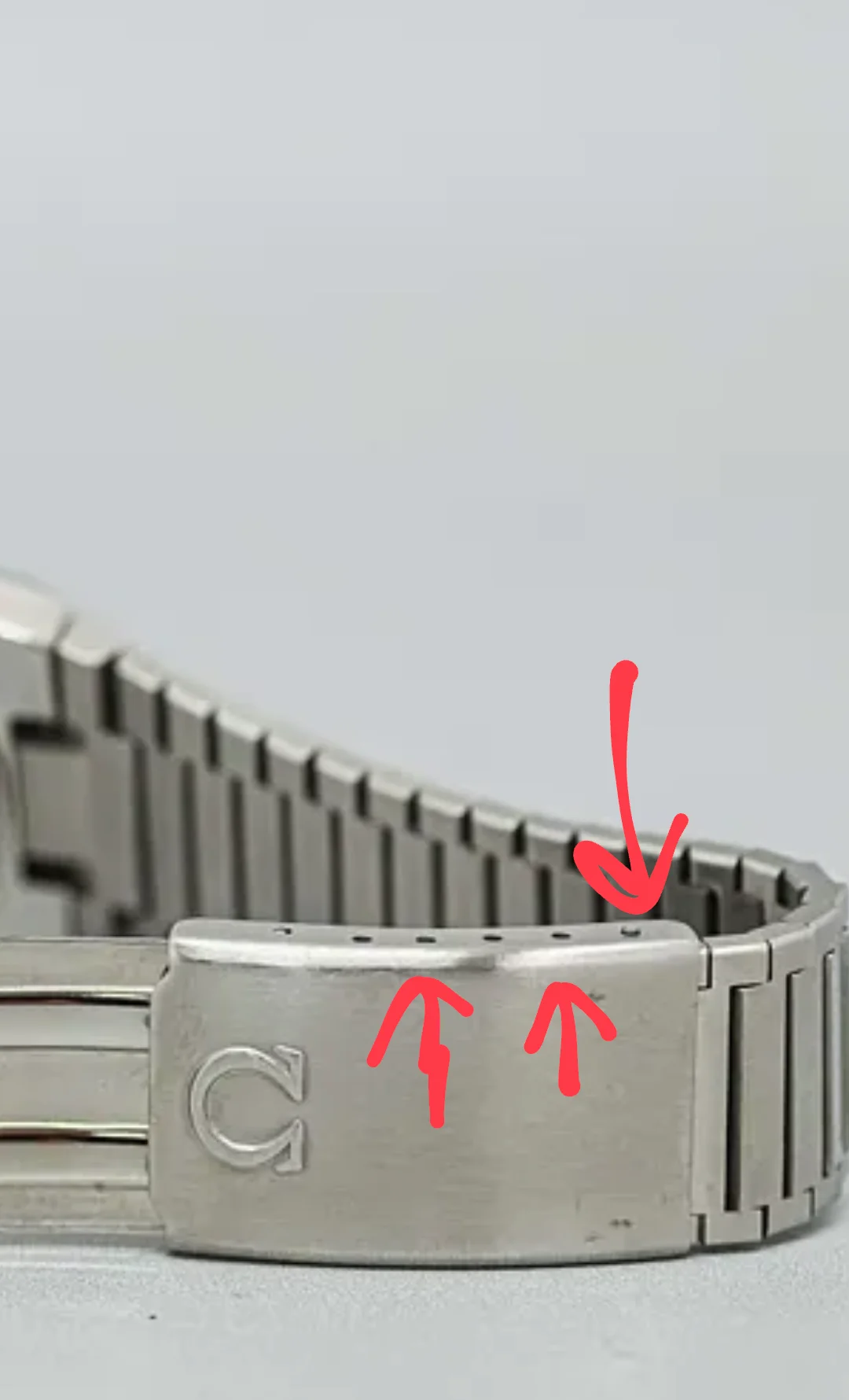

23

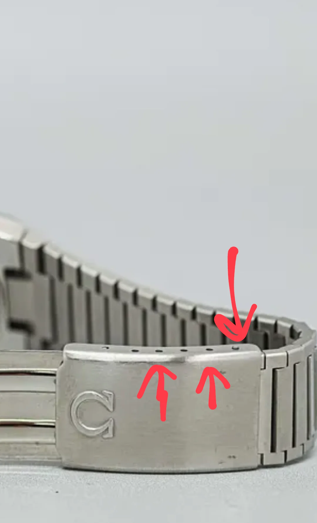

Have you tried adjusting it here ? Just ping that pin out and move it up
Yes of course! Hahaha still too big

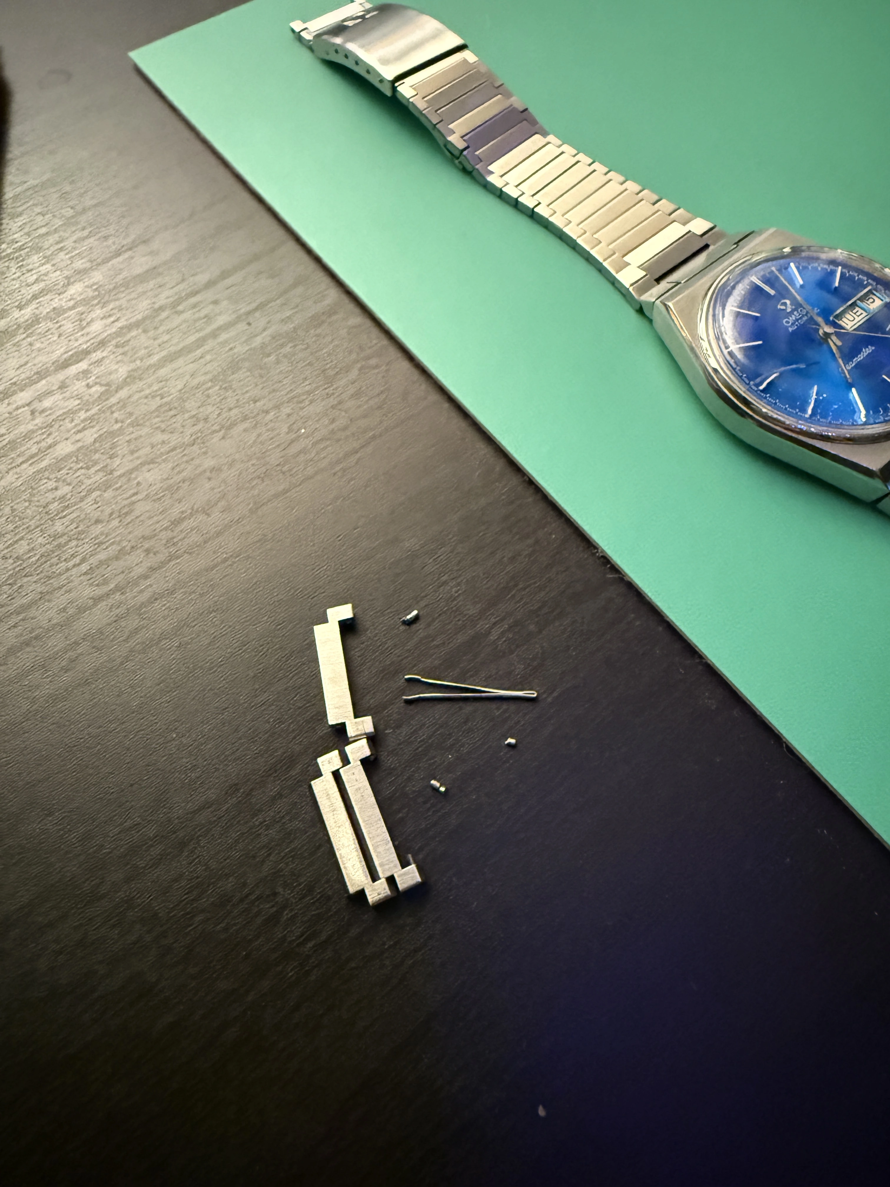

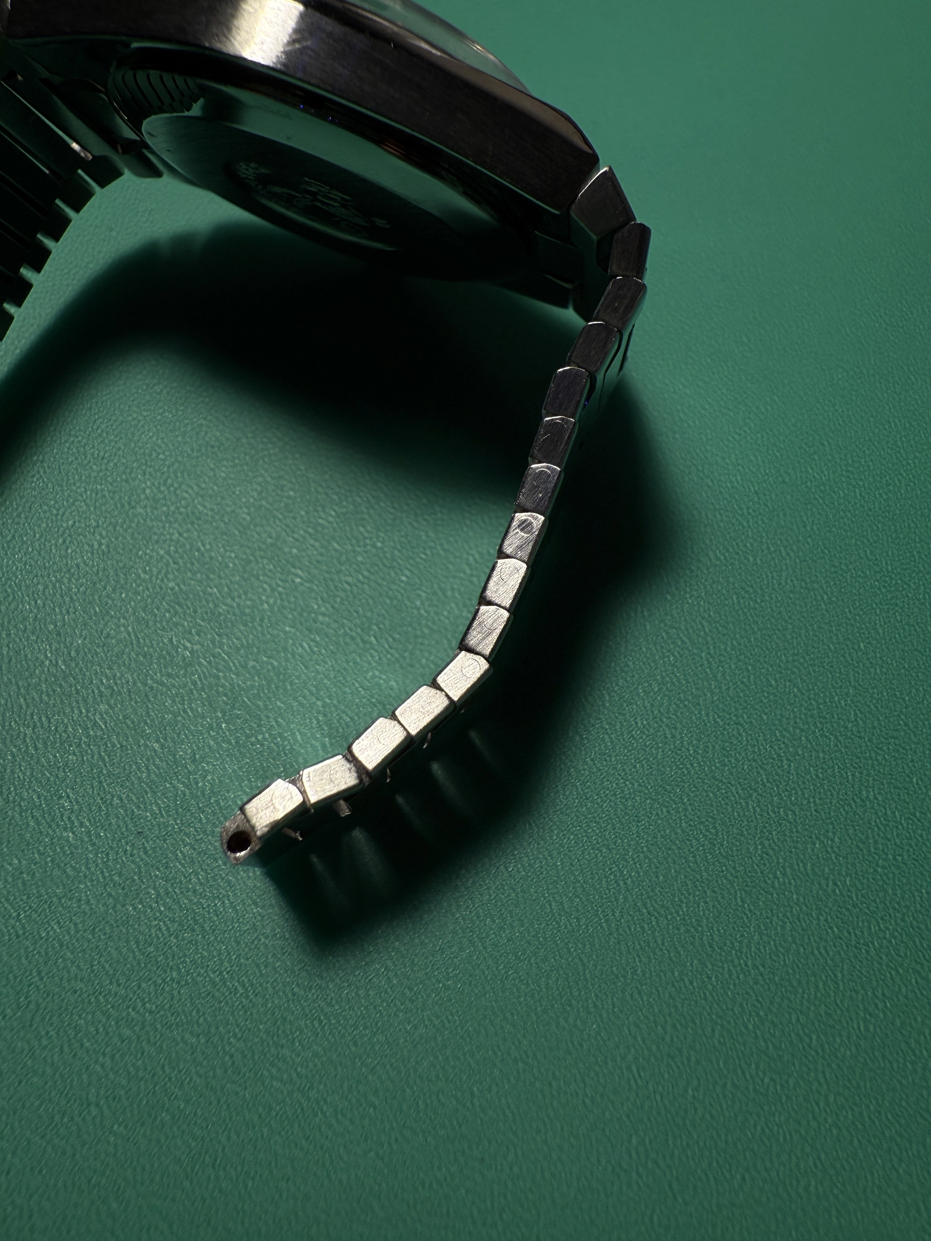

Thank you for your quick responds! I just order one on chrono24 for $275, looks in mint condition, this one broke while trying to remove one of the stucks pins and it’s not in the best condition as it seems on the photos there are some bend links…
