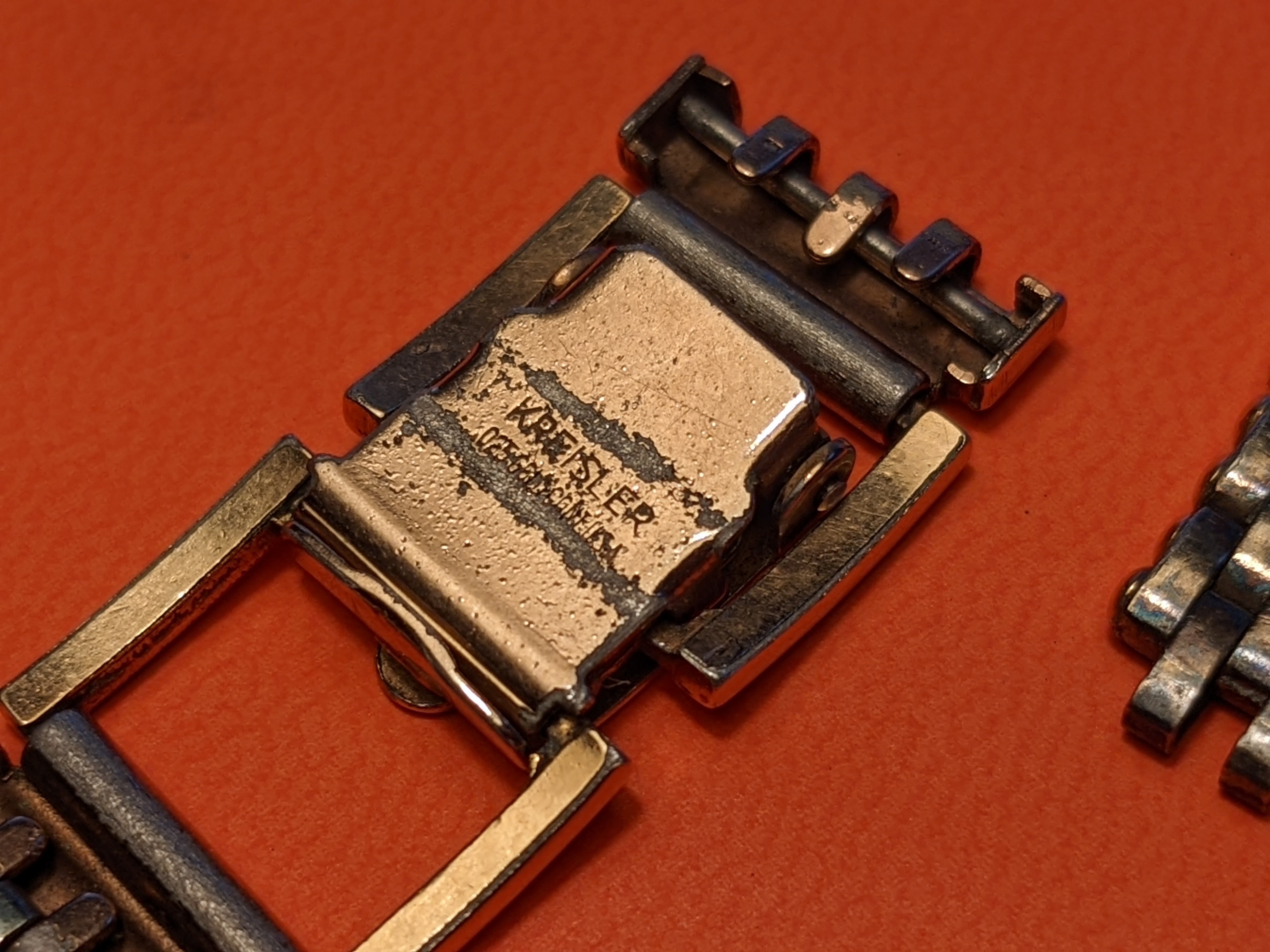

I recently picked up a couple of these Kreisler Basketweave bracelets from the 1940s. I'm planning to combine them into a longer bracelet for wear, but it seems they aren't built for easy sizing. I'm guessing the original instruction was to cut rivet heads to remove links until achieving the desired length. I can't seem to find how to remove rivets or links without damaging one or the other. I have some extra length, so I could potentially go that route, but I'm hoping someone might have another idea as to how to size this.

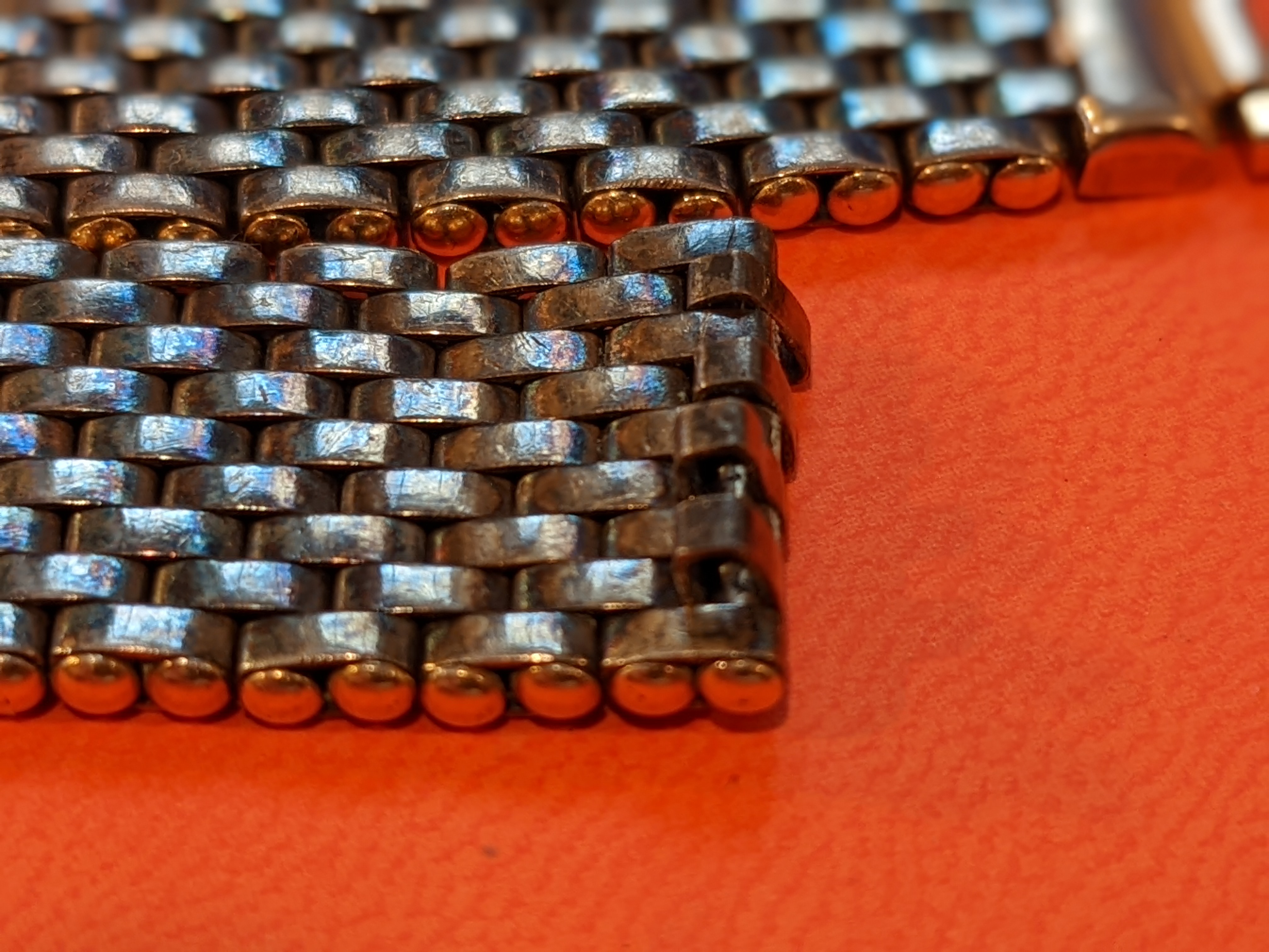

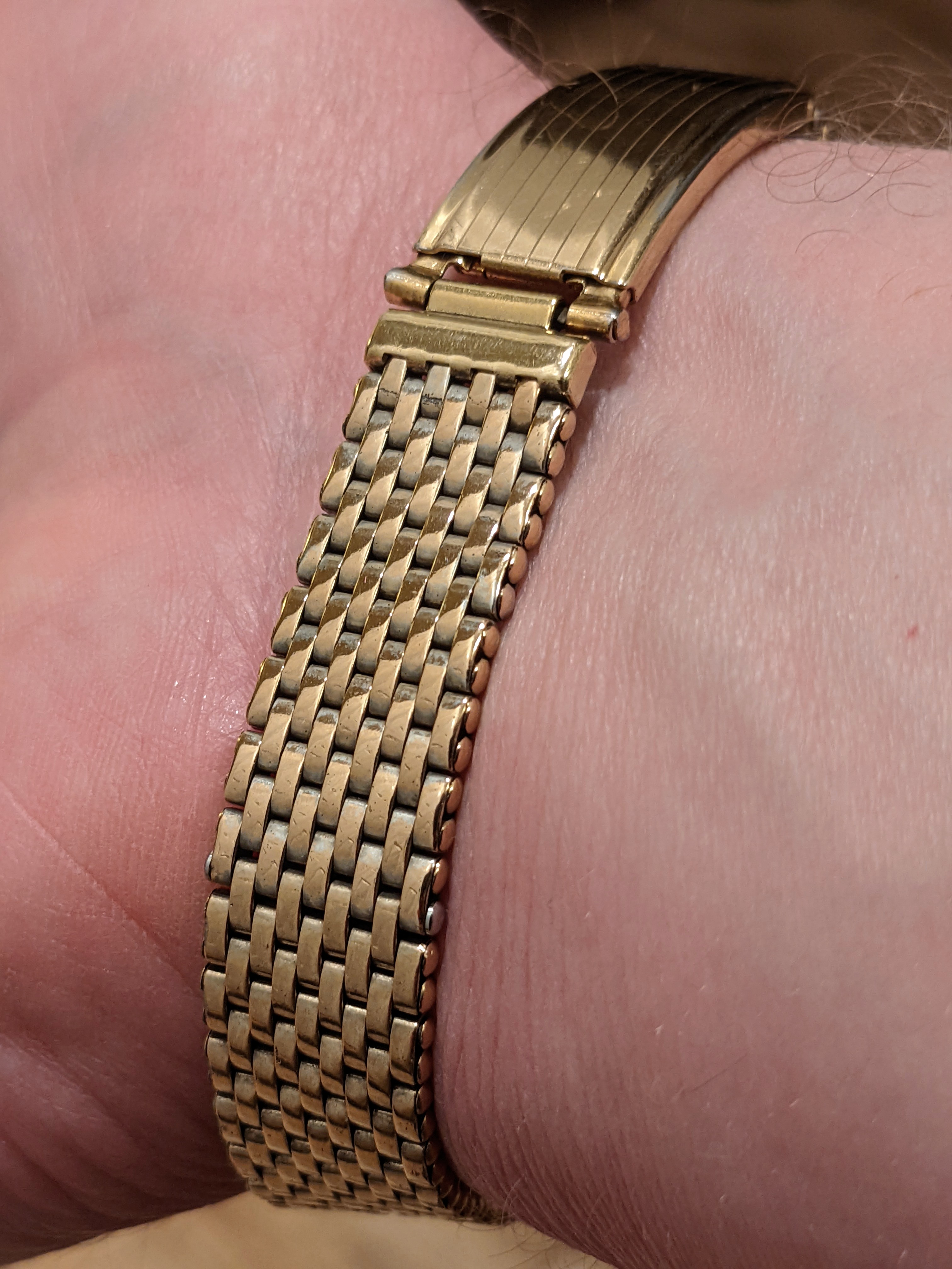

I took the pics below after removing the clasp from one side. The links look at though they have a seam along one edge, but the seam doesn't run through the link; you can't spread the link to remove it.

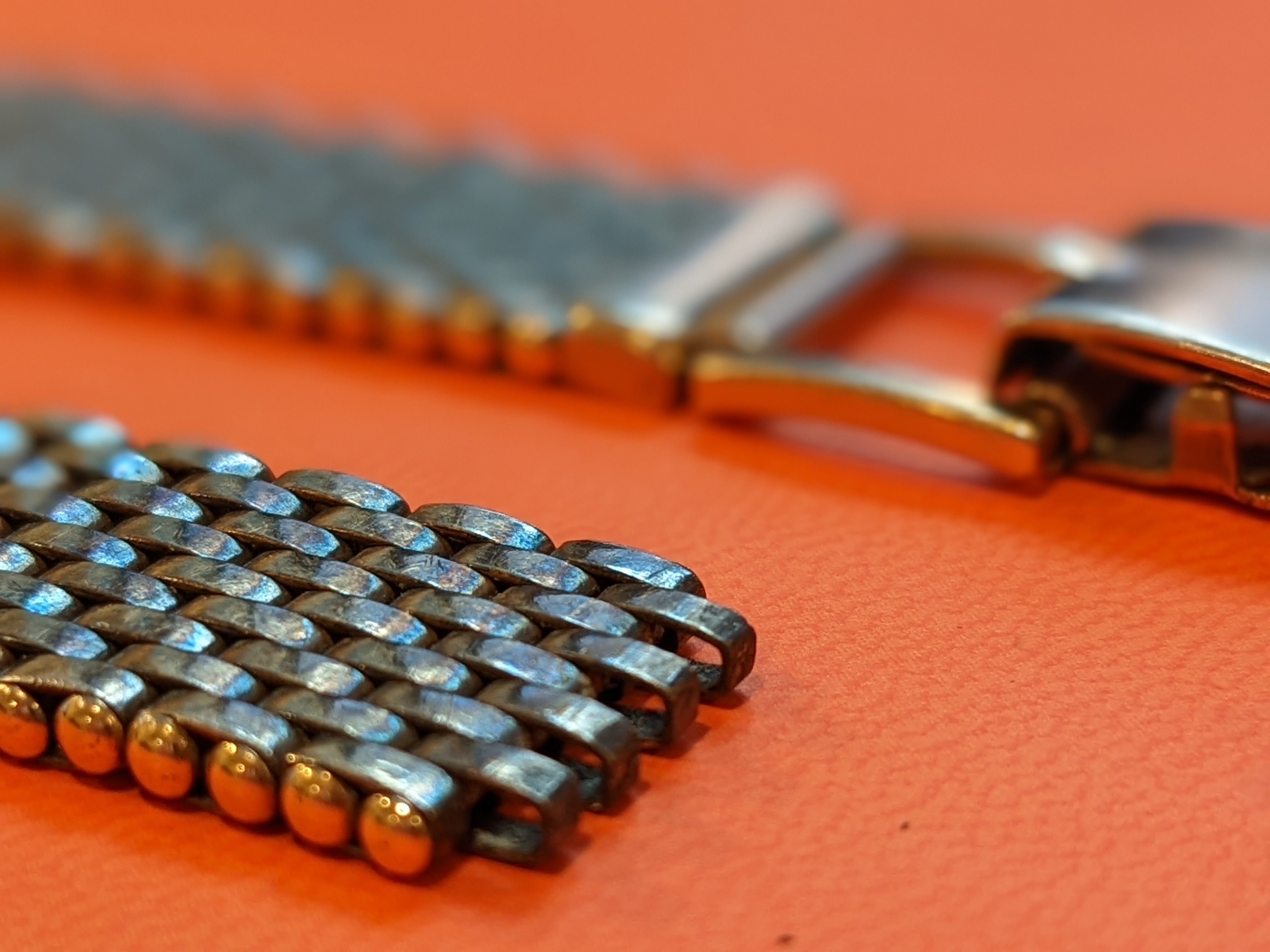

Later I removed the end link from the other end, to see if I could more easily coax out a rivet from the end with outside links. After reshaping the rivet head on one side, and pulling at the outside link, I was able to drive the rivet past the outside link.
I had hoped that by getting the rivet this far, I would be able to separate it in the fashion I've seen done with Gay Frères style rivet bracelets, but to no avail. With the rivet free to slide side to side, it's apparent these rivets are truly riveted; there's no seam for removing a head.
It looks like I'll need to reshape the head until a rivet will freely slide past the links, then recreate the rivet head to reassemble. I'm reluctant to cut links, but if I sacrifice a few, it'll be easier to reshape rivets as above once outside the weave.
Anyone have experience adding length to a bracelet with this type of rivet? Have another method I haven't thought of?
Thanks in advance!

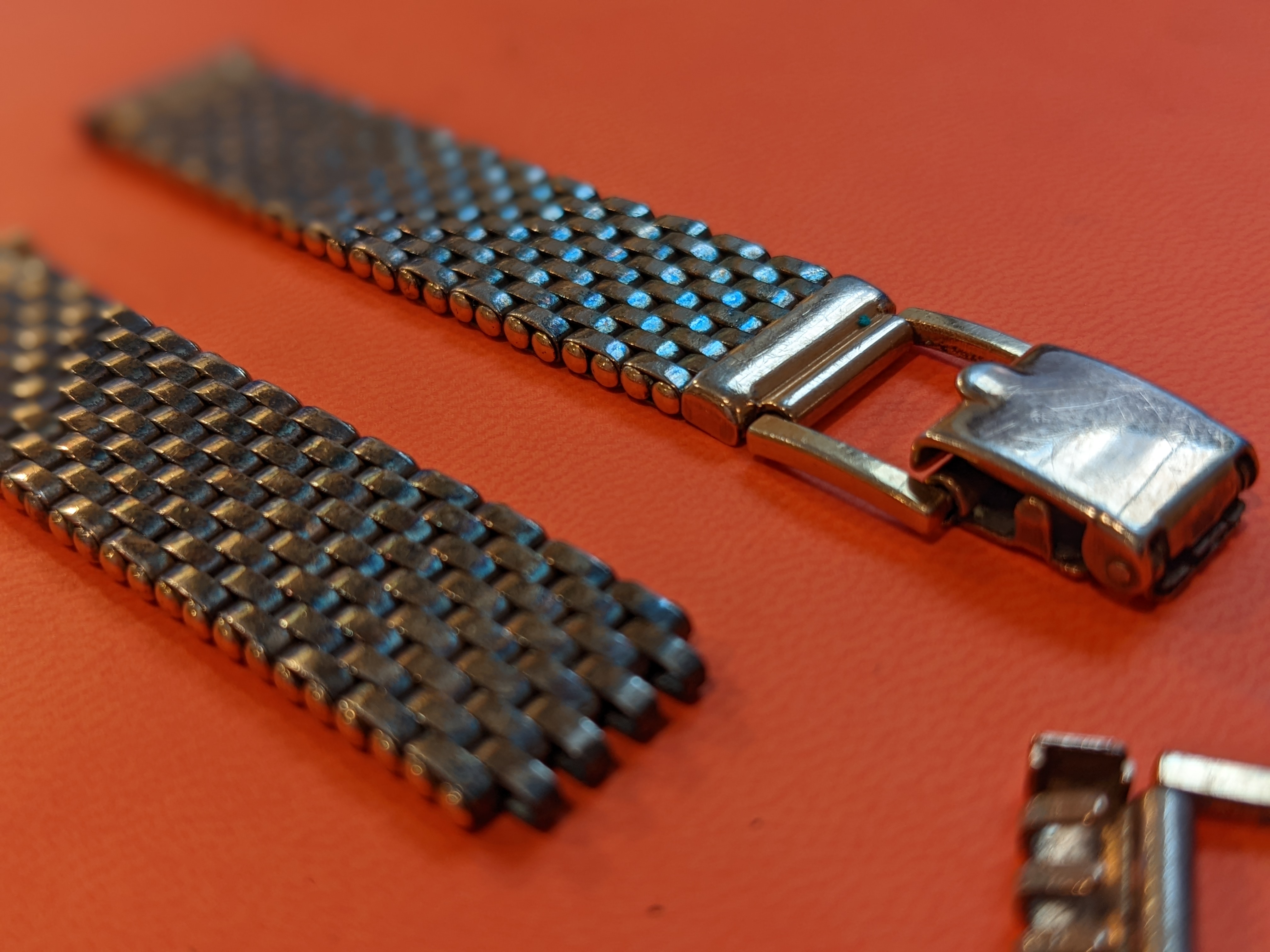

Many watch material suppliers provide a bracelet part called a “rivet pin”. These are available in at least two diameters and many widths, and the pin is basically a stainless steel tube, with “plugs” (they look like a small rivet) that can be driven into the tube, one on each side. Open the bracelet, remove the links, position the links where you need them, slip the tube through the bracelet, then using a small hammer, drive one “plug” into each end of the tube. Is there insufficient accommodation within the buckle to enable you to adjust the bracelet to fit?

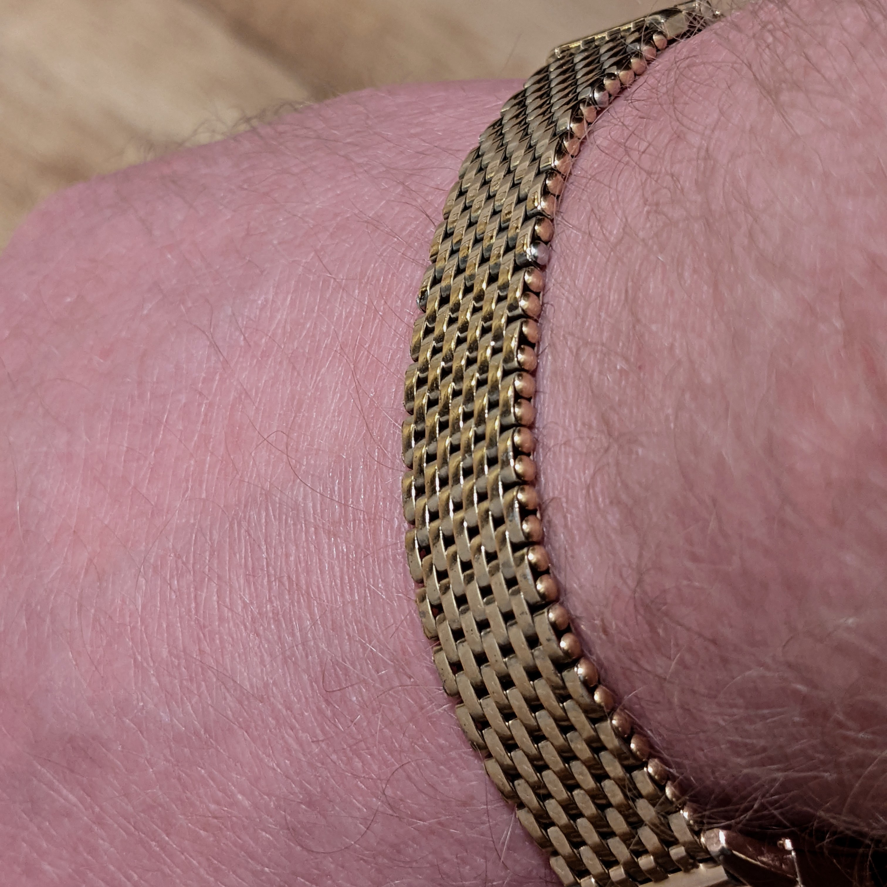

Thanks again for your help, @Canuck , I was able to splice the bracelets with a single rivet pin. The steel color pin is visible in the middle of the long side but it's not that noticable IMHO.
Here it is with a polish following a baking soda bath.
