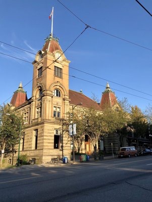

My NAWCC chapter maintains the clock in what is now a community hall (but a post office back in the early 1900s) in exchange for free meeting space. I just joined last fall, so I didn’t get an opportunity to wind or “help” with any maintenance before the zombie apocalypse hit. They are planning to install an electric winding system in 2021, a handy but (I imagine) not a universally applauded advancement. So I haven’t seen the clock, but I have seen the even more famous urinal. It’s been creating awkward moments for 104 years now...

And the hall
