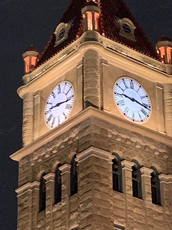

A lot has happened to this clock since I last worked on it, ten years ago. Today was our third day of diagnosing why it behaves the way it does. Lousy cell phone photo, but I forgot my camera.

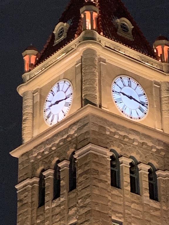

This is a picture of the clock taken at 9:15 on Thursday night at which time it was running. It quit at 12:25 A M on Friday! When it quit, it had run for 11 hours and 40 minutes. It’s not a question of IF, it’s a question of WHEN!

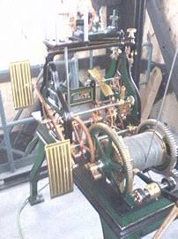

Can you explain the function of these paddle wheels (govenor)?

@JimInOz . The rate at which chime or striking clocks “bong” is governed by those paddles. By turning the paddles full broadside, the striking can be made to slow down. Turn them 90° so they are not broadside to the air, and the clock would “bong” unreasonably fast. This clock uses a double three -legged Gravity escapement (as on the one in the Parliament Buildings at Westminster, erroneously called “Big Ben”) Which requires the use of a second, smaller fan as shown in the pictures you uploaded. Thanks for putting that article up. That's the very clock.
