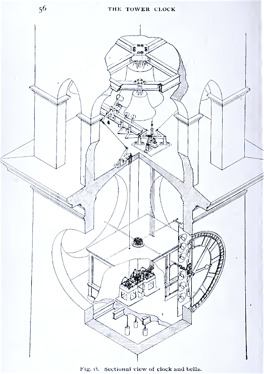

Threads on this forum often lead down a rabbit hole.

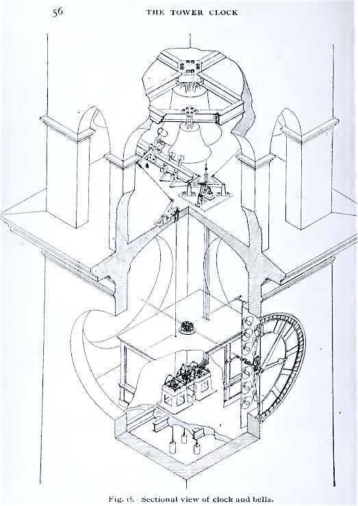

Prompted by Doug's clock, I went on a wander through the www. Among many interesting things I found this.
http://www.survivorlibrary.com/library/the_tower_clock_and_how_to_make_it_1903.pdf
I'd say it is very close in design to Doug's clock and aside from the technical facts, I enjoyed reading the text just for the sake of the way it was written in the style of the time. A bit like reading De Carle.

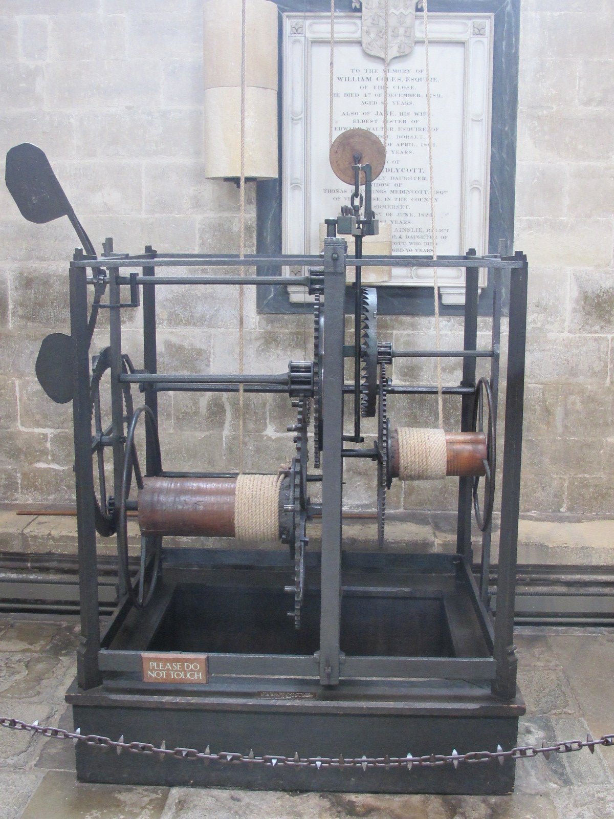

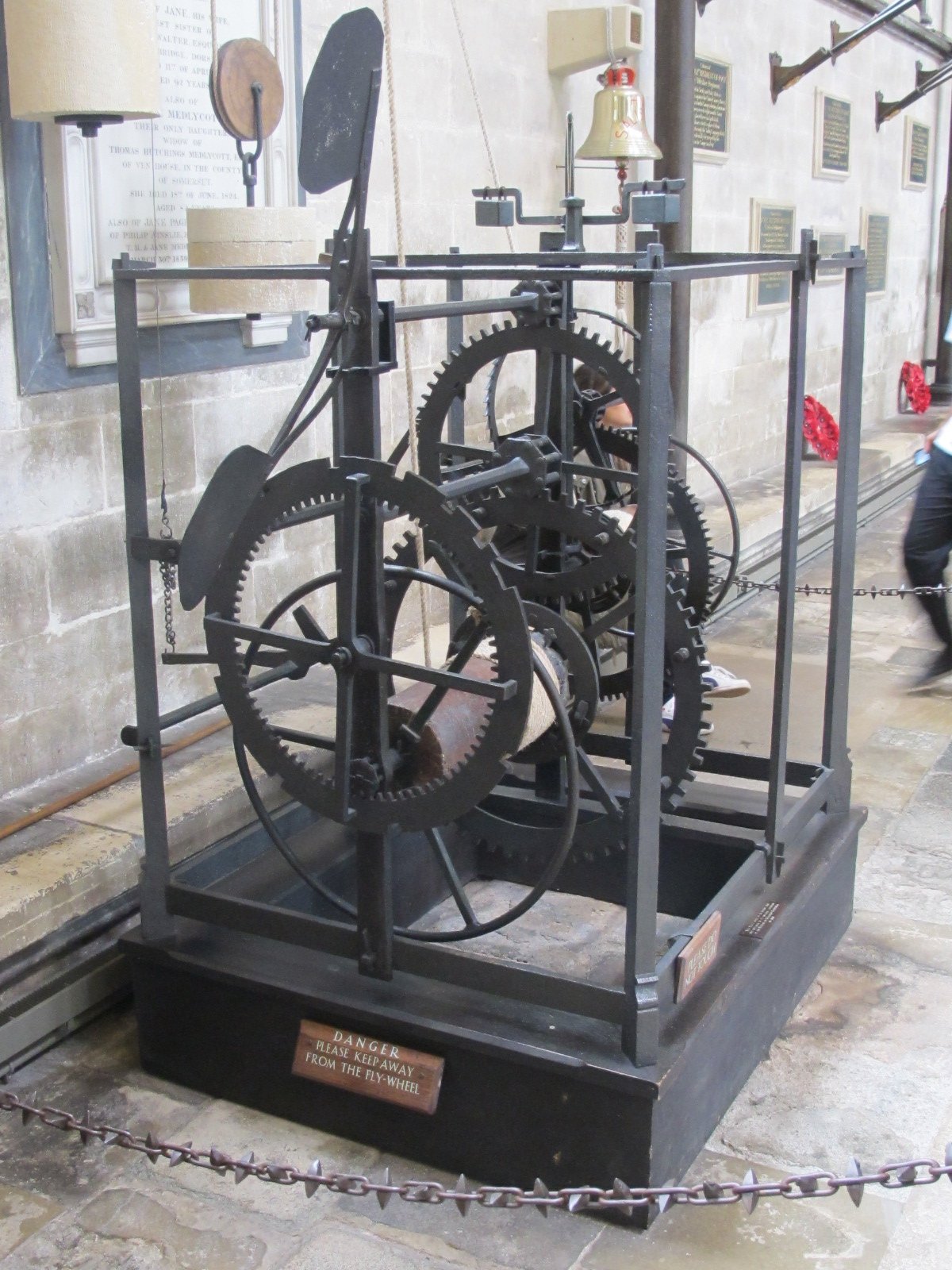

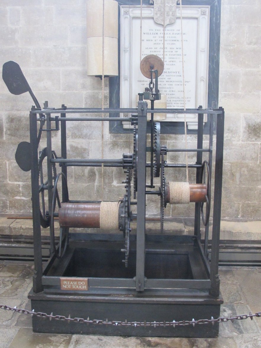

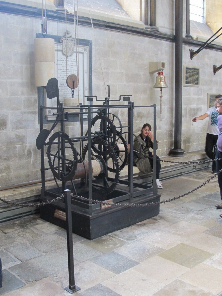

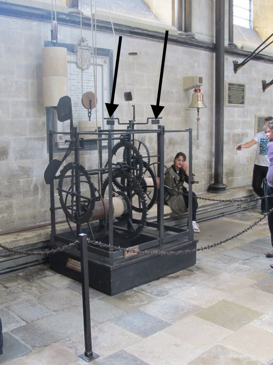

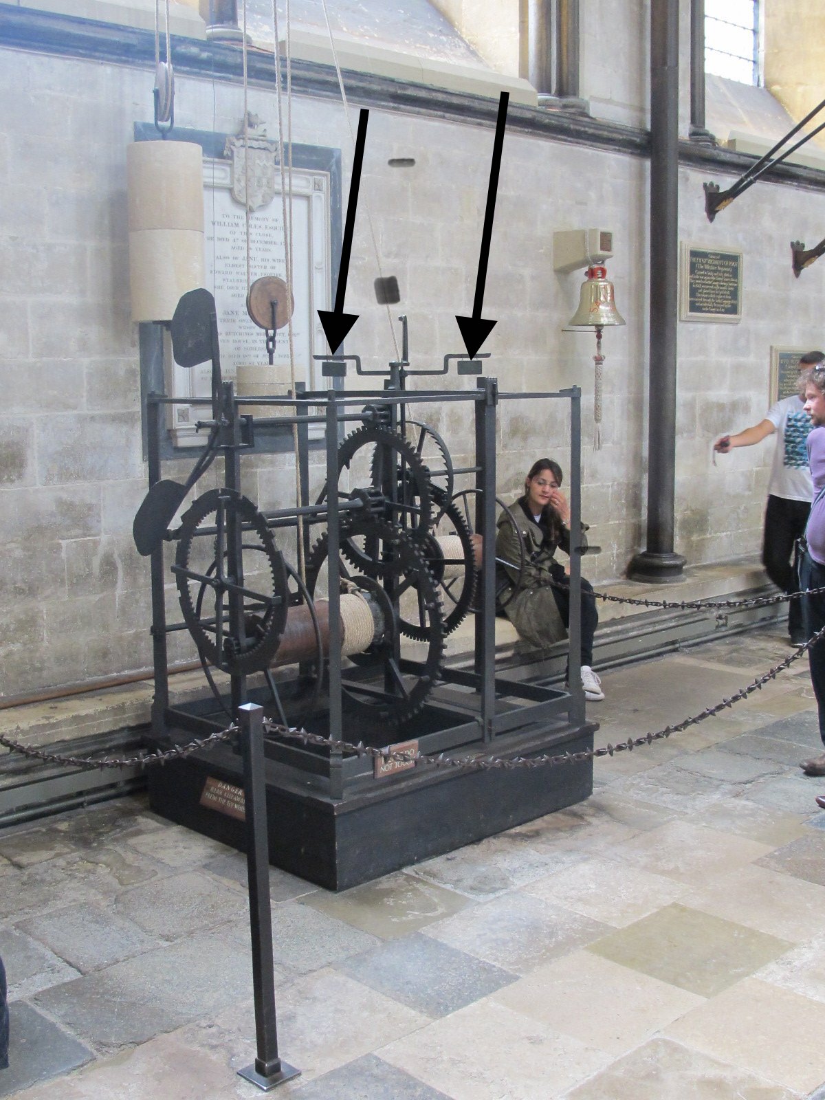

A number of years ago we visited Salisbury Cathedral and saw what was claimed, and accepted by Guinness Book of Records, to be the oldest working clock in the world, dating from 1386 or thereabouts. They already used "air-brake" paddles to control the bell strike, but without any apparent method of regulation that I can see because the 2 paddles are fixed perpendicular to the air-flow. Perhaps they removed metal from the paddles until they were satisfied with the strike rate and left it at that.

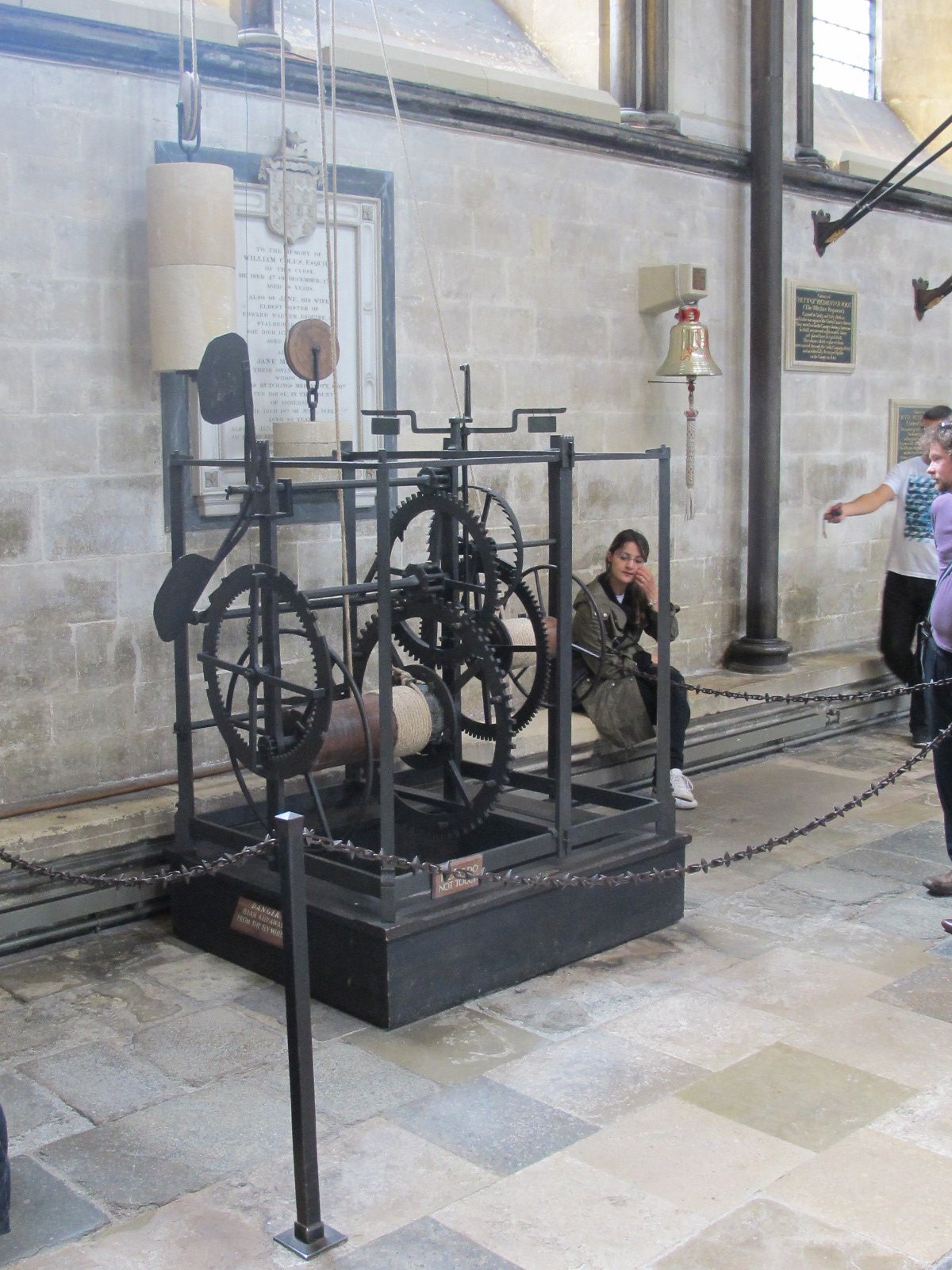

The Salisbury clock (above) was built using “verge & foliot” escapement as you see it in the picture above. The escape wheel on this type of escapement has been called a “crown wheel”. This clock had been converted to a pendulum model with crown wheel, some time in the past. But it has been restored to the original configuration, as the sign indicates. Regulation of the verge and foliot escapement on this clock was done by moving the two weights on the foliot (see pictures) outwards to slow the clock down, or inwards to speed it up. Clocks with verge and foliot escapements were notoriously inaccurate. As the sign indicates, it originally did not have a dial or hands. It’s sole purpose was to ring a bell to call the faithful to mass.
15,743
47,136

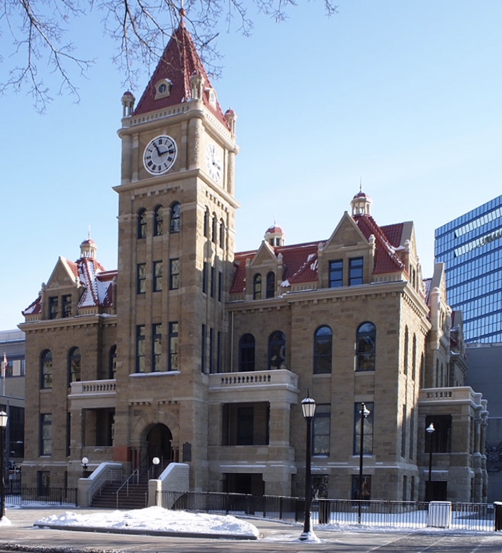

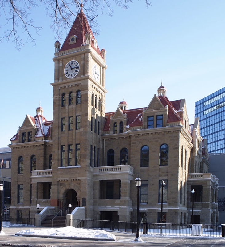

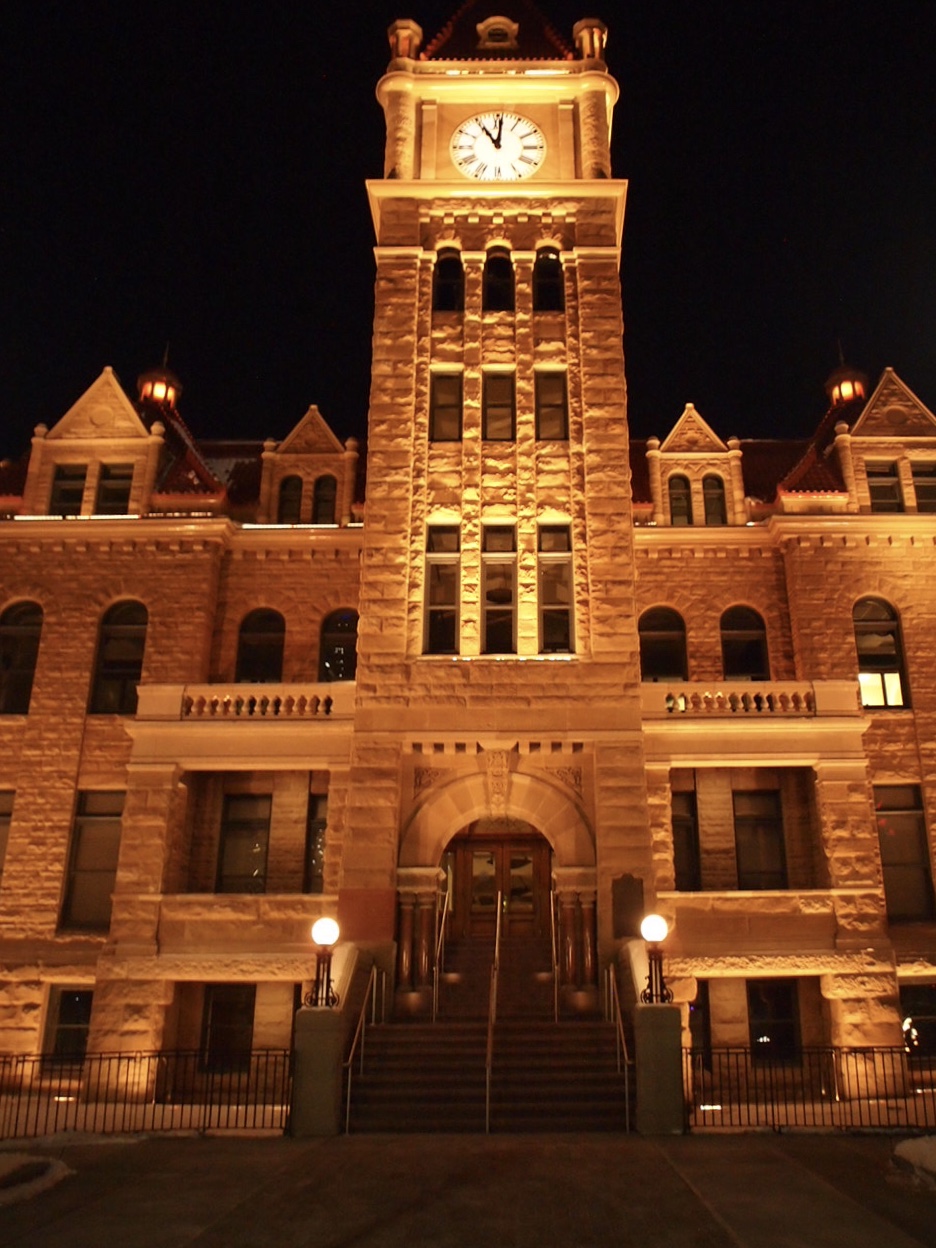

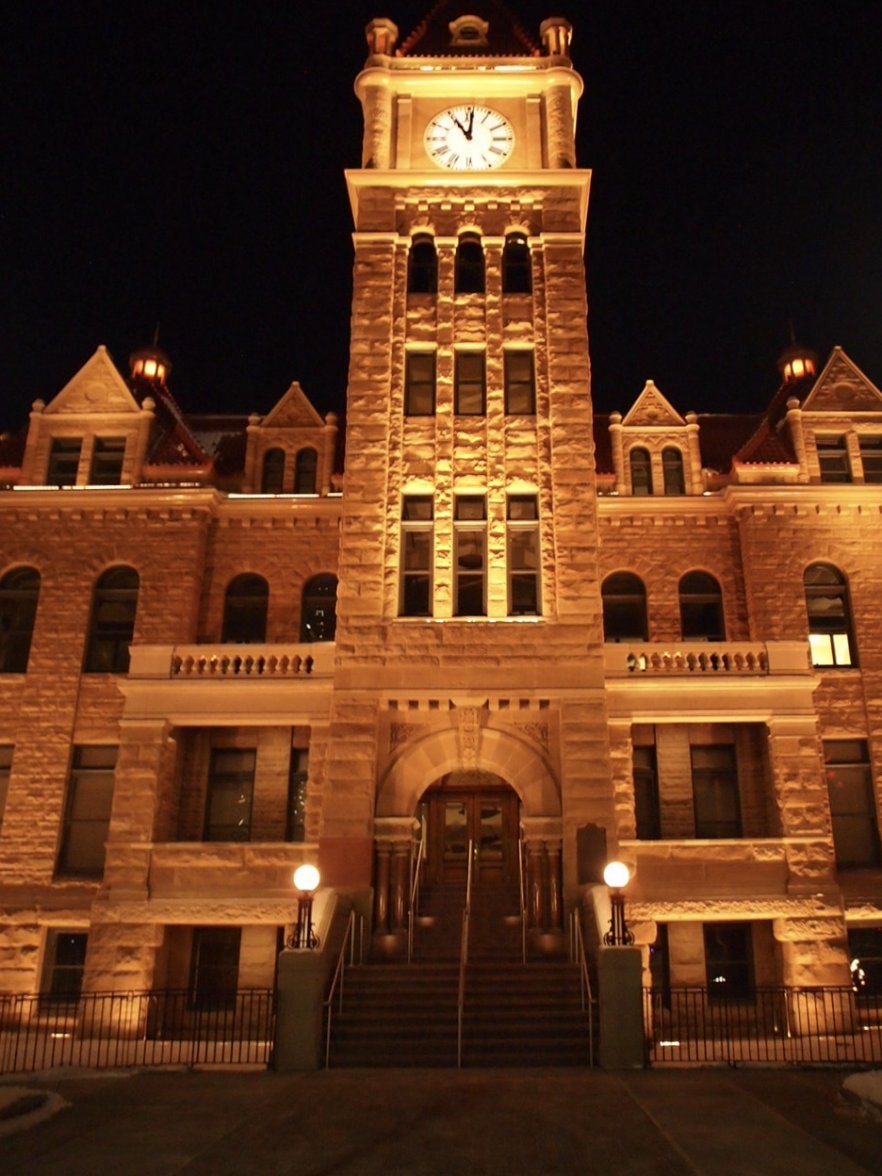

Our 1910 sandstone City Hall after a 34 million dollar restoration. Approximately 15% of the sandstone has been replaced, and a lot of the sandstone has been removed and turned around. This picture was taken al 11:14 on Sunday morning. Clock running fine after a 42 hour run, and on time! Patting myself on the back!

Congratulations on the clock repair!
Beautiful building.
Guessing sandstone isn't the most durable material for the weather up there. That's a lot of repair.

Our city is like many cities. Structures far younger than our a City Hall are regularly demolished and replaced with something more up to date. Few of us have to look very far to see old buildings that have survived far newer ones.
There have been a number of previous attempts at stabilizing the sandstone over the decades. Sandstone absorbs moisture, and the freeze and thaw cycles eventually leads to chunks falling off the building. Some of the techniques involved in the past salvage attempts have actually made the problem worse. This restoration involved importing sandstone from around the world. The building was built in 1908-1910, using local sandstone. Those sources have dried up. It is an honour for me to have been involved, even though my efforts have been minuscule.
