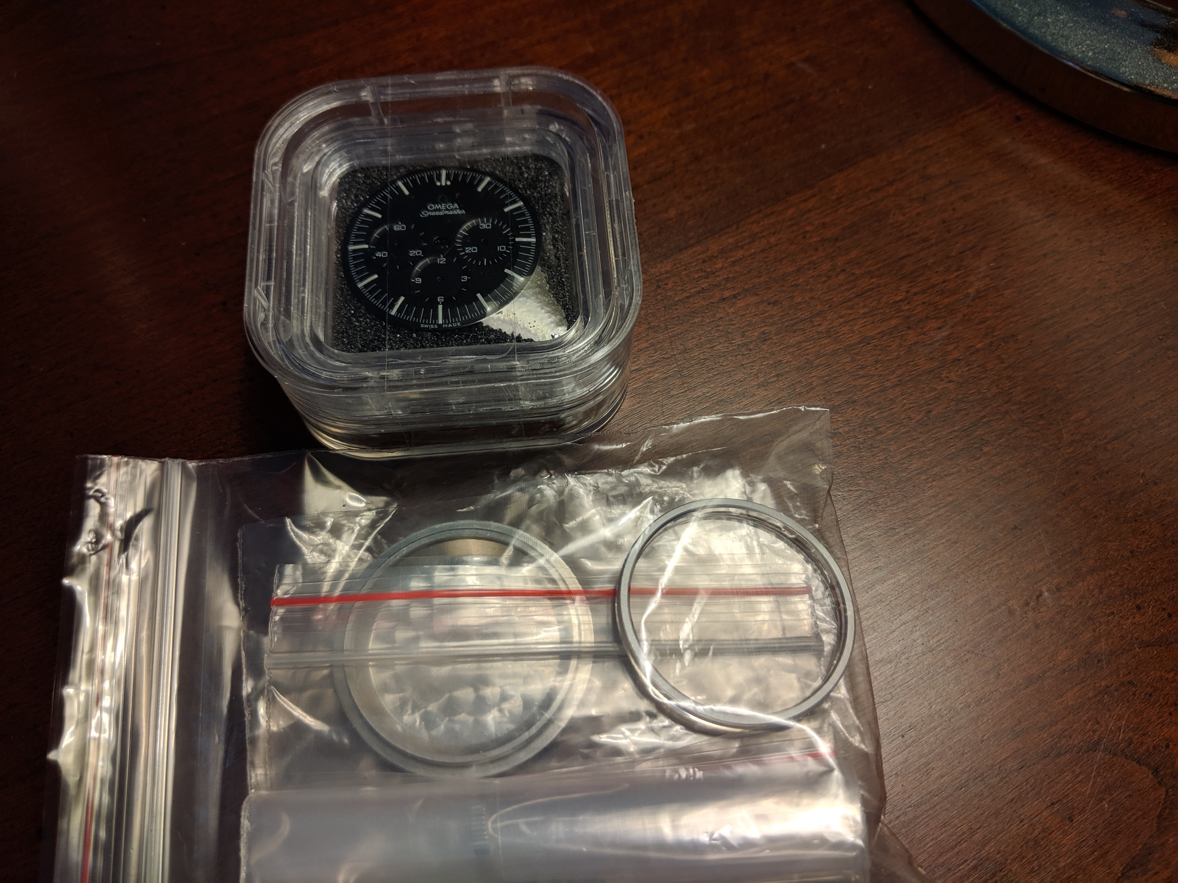

Just to put this to rest about the crystals...they are not a "straight swap" as I will show:
The standard acrylic crystal for a Speedmaster Pro is this:
063PW5139 | GLASS PLEXI BLACK RING D34.13 H5.1
So the diameter is 34.13 mm, and it presses directly into the steel case opening as armoured (tension ring) crystals do.
The sapphire crystal for the FOIS is the same as with the regular sapphire Speedy Pro:
062SL5005 | GLASS SAPPHIRE AG1S MET D34.2 H4.65
So the diameter here is slightly larger. But this sapphire crystal is held in the case by a crystal gasket:
298EN5189 | CRYSTAL GASKET Ø35 T0.57 H0.85
The thickness of the gasket is 0.57 mm, so that is on the radius. If you remove the sapphire crystal and gasket and tried to install the acrylic crystal directly into the steel case (the way a tension ring crystal is supposed to be inserted into a case) the crystal would not seat in the FOIS or sapphire Speedy Pro case as the case opening is far too large.
My guess is that the gasket has been left in the case (or hopefully a new one installed) and this is what is holding the acrylic crystal in. Given that the interference fit on a sapphire crystal with hard plastic gasket is quite small (2-3 hundredths of a mm in the designs I've done so less than the difference in crystal diameters above), I'm not sure I would be confident that this arrangement is as secure as an acrylic crystal in a case that was designed for it. Not only on the diameter, but the depth of engagement into the case. The gasket above for the sapphire crystal is 0.85 mm tall, and the depth of engagement in an acrylic cased Speedy is about 1.15 mm, so the crystal isn't seated as deeply either from what I can see.
Anyway, it's not a "straight swap" as people keep saying it is - that's my main point here. To me that means being able to remove the sapphire and press the acrylic straight into the case as it was designed to be installed.
It definitely looks nice though so I can understand the interest in this mod. 👍
Cheers, Al
I'm going to guess the gasket was left in place. Here is a photo of original parts I was given. It's case back, sapphire, crown, and dial. No gasket. Hands were throw away.
Your input is always appreciated. Thanks for that info. If I ever send this watch to you for service please let me know what you find. It will be a few years until then tho. 😀
