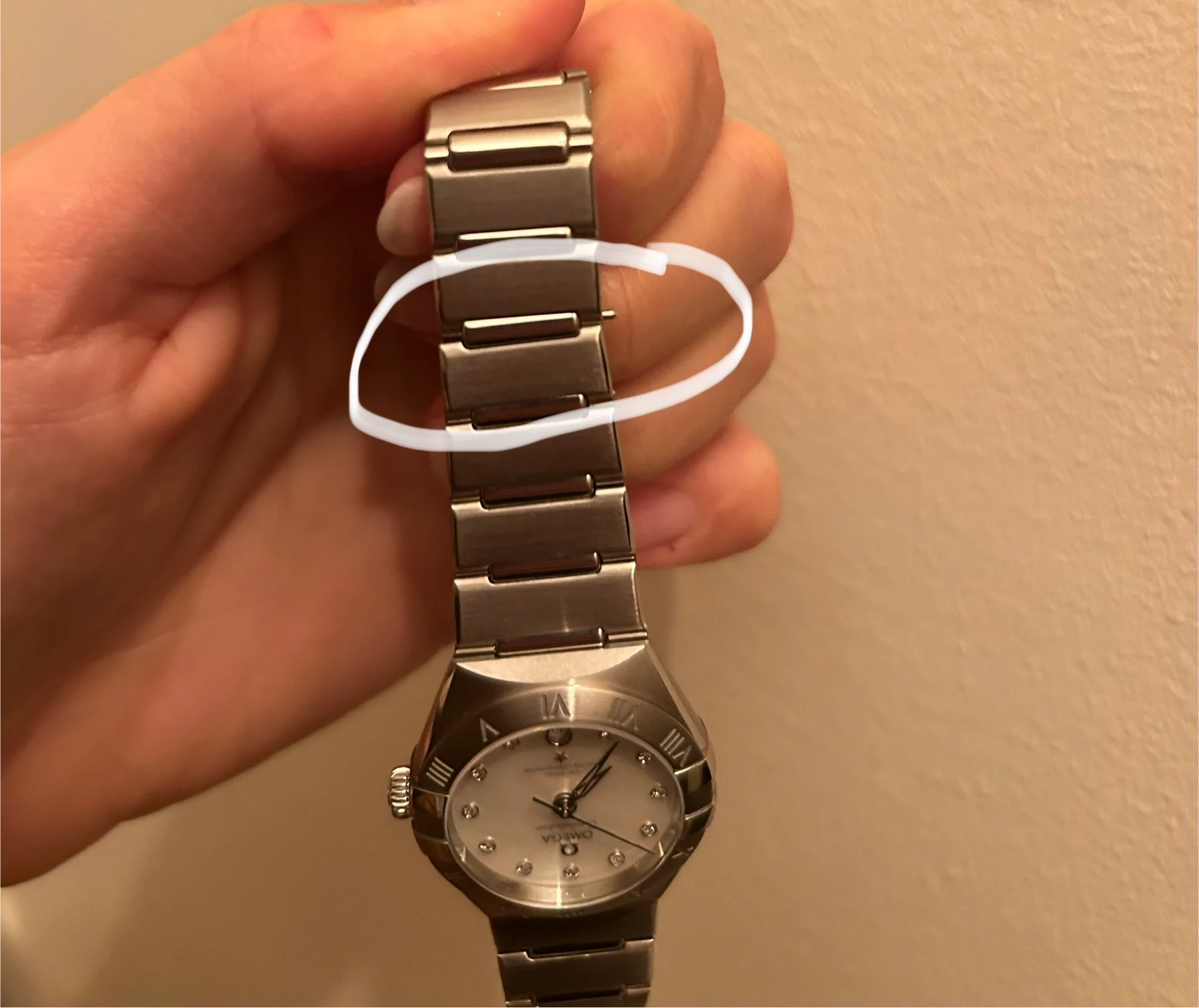

I bought my first OMEGA after having considered a few different models/brands over the past few months. I wanted an automatic watch that was feminine and small - the constellation 29mm fit the bill perfectly.
For various reasons, the OMEGA store I bought the watch could not shorten the bracelet (it was at an airport) therefore I went to my local OMEGA store a few days later to get it fitted. Until then, all good.
I walked out of the store with the new watch on my wrist, extremely happy. Within an hour, I noticed multiple of the pins were loose and sticking out and I then took a closer look at the watch and noticed a new scratch on the casing, clearly done by a pointy metallic object.
I returned to the store the following day, very unhappy and they aplogised for the service and sent off my watch for repair and polishing. The repair of the bracelet took over a week and I decided not to polish the watch but to retain the right to do so at a later date.
When collecting the watch, the OMEGA staff reassured me that everything had been tested and fixed and apologised, again. I wore my watch for a couple of hours and noticed some of the pins sticking out AGAIN. At this point, I am furious. This is a brand new watch and OMEGA effectively let me down 3 times: first selling me a faulty watch, secondly scratching the watch when adjusting the bracelet and thirdly, not repairing the bracelet correctly.
They are now offering to replace the bracelet entirely - is this sufficient? It will take weeks for a new bracelet to arrive and then the watch will have to be sent to the workshop, again. I'm so unbelievably dissapointed in this brand.
Photo of the watch after everything was "repaired".

Missing gaskets maybe?
As for your question: "They are now offering to replace the bracelet entirely - is this sufficient? "
-I guess so. Unless the scratch is too obvious/profound (not shown in your picture).
18,851
39,205
That's what I suspect.
The "installer" lost the tiny centre tubes that the main pins are pressed into, therefore the pins are allowed to simply slide out.

As pointed out your bracelet has a 'pin and tube' arrangement to join the links together. It's a fiddly system but it works, but what happened in your case is an incompetent technician lost the very small tube and just reinserted the pins sans tube, that is a recipe for disaster. You are fortunate the pins didn't fall out which would have let the watch fall off your wrist. The service you received is terrible, especially their not catching the missing tubes. They might not even be aware of the tube and just reinserted the pins. In your case you will have to get to a competent person who knows how the system works, either an Omega boutique with a good technician or an independent. Do not take it back to the dealer, they don't know what they are doing.
