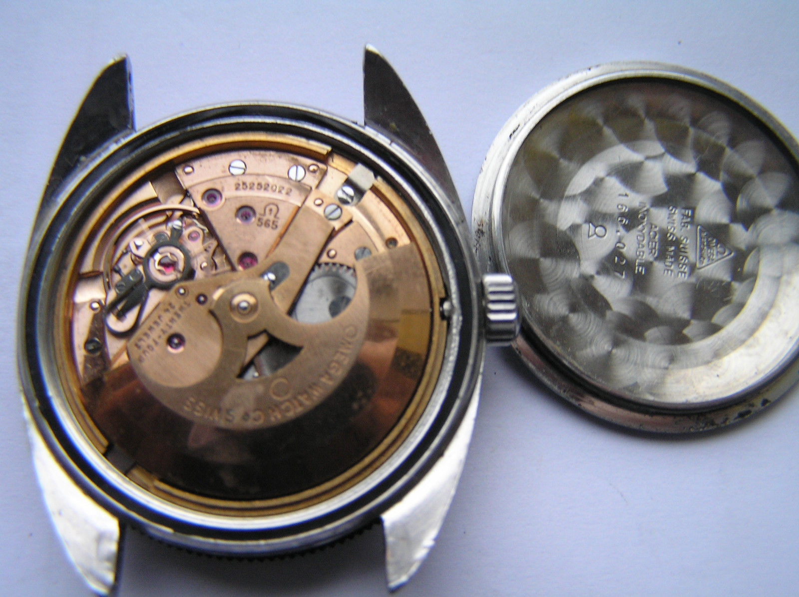

like i said ... if possible ... a PEEK at the GUTS of the watch would help .... see what the movement is inside and and the inside of the case back will also add more information for any one here trying to help u ..... if possible take a photo

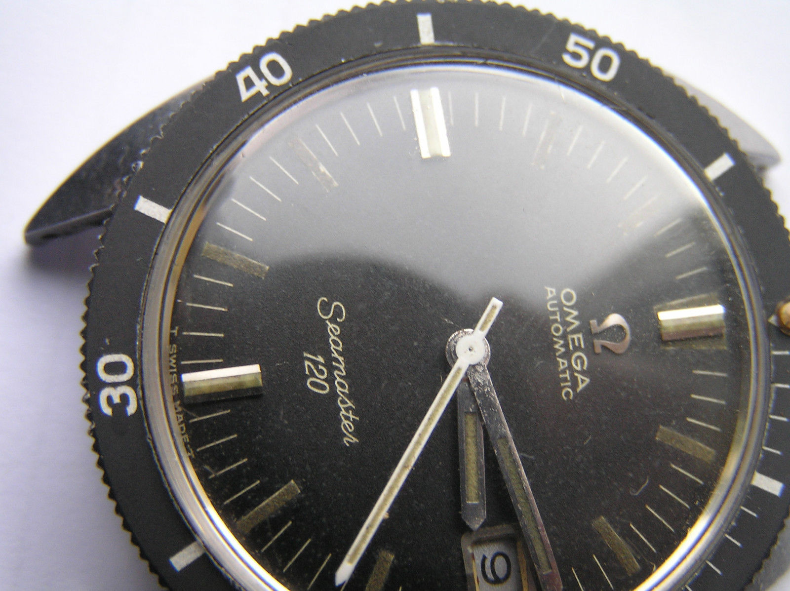

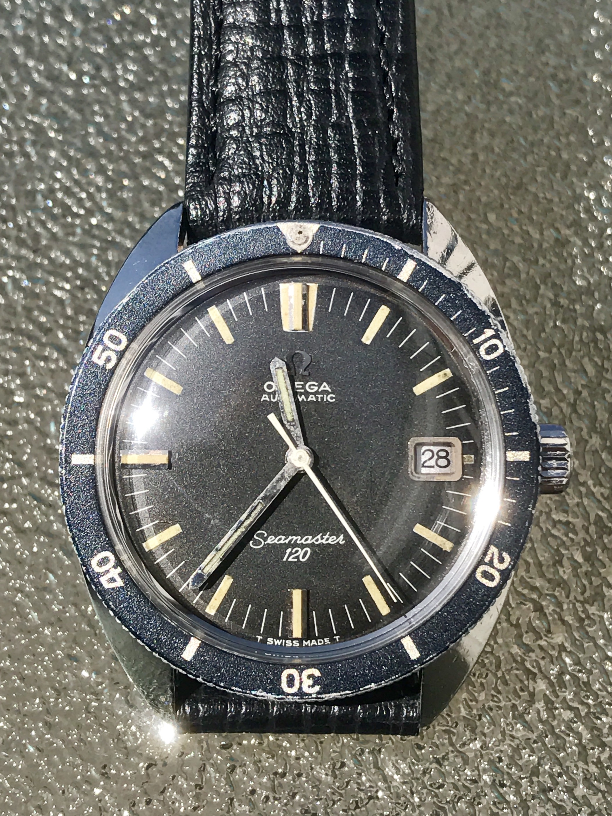

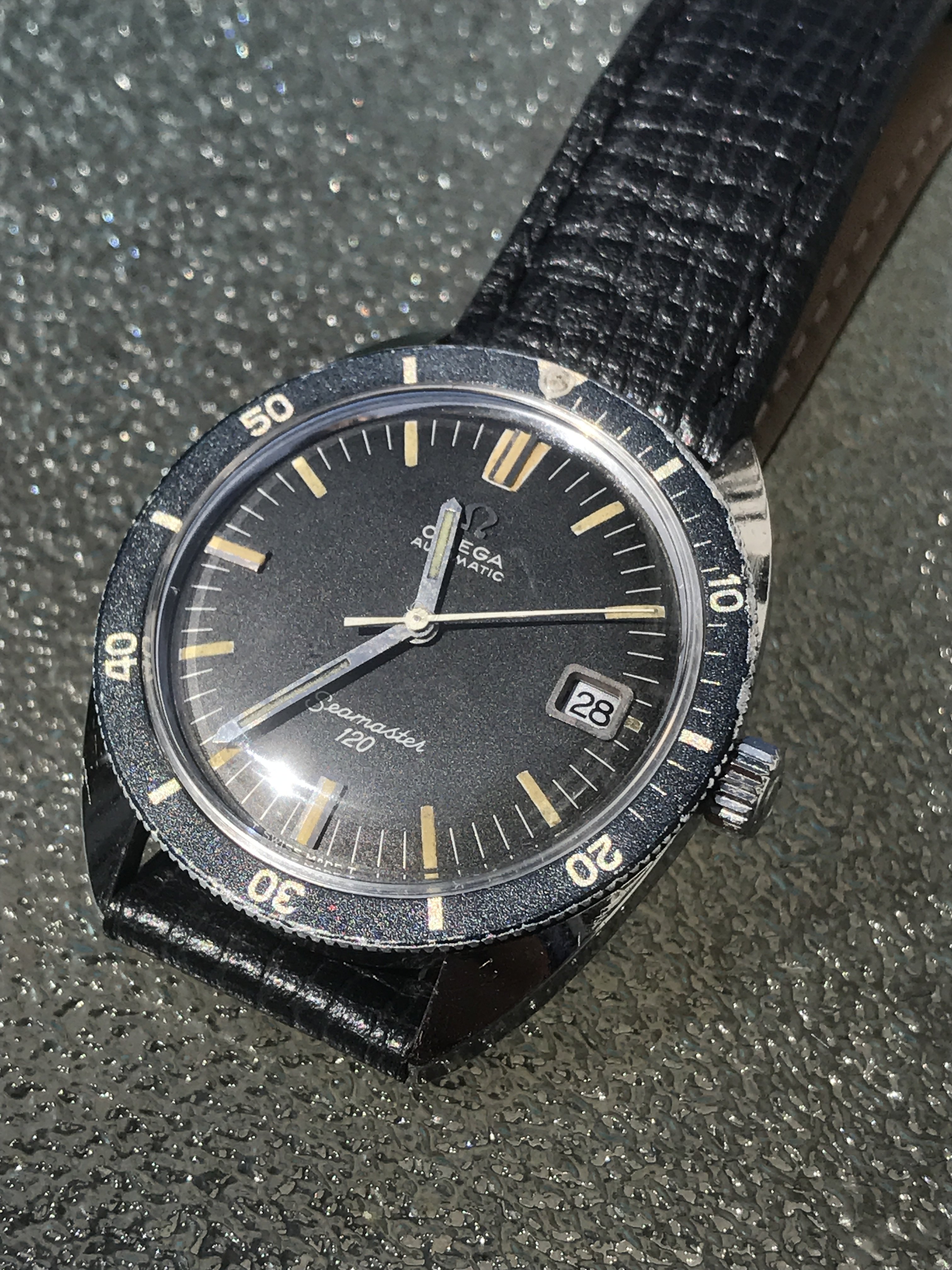

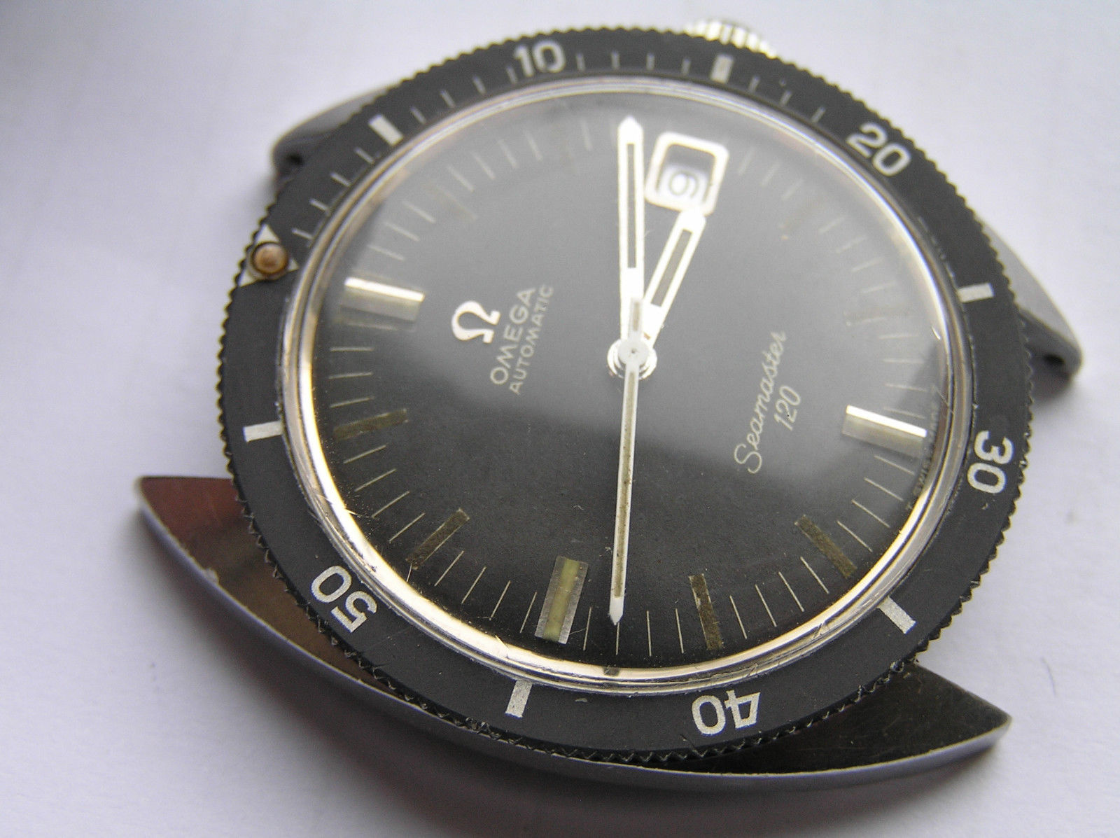

Anyone got any views on this one? Seems to be the slightly rarer 166.027 with lumed second hand.
My concern is that the lume on the dial shows signs of deterioration - but the bezel (apart from lume pip) looks in pretty good condition - that's a bit of a red flag for me (should it be?). The engraving on the case back has also been completely polished away as well. Though the engraving on these was pretty shallow in the first place. Crown seems fine and the case has the 3 & 9 notches. I understand black numerals on a white wheel is ok for this ref.
I thought I had these 120s pretty sussed out but something just seems odd with this one. Any advice would be appreciated.
Many thanks
13,555
23,503
I think it's correct and largely original but the lume would put me off.
I've got one of these on its way to STS at the minute for a full refurb. I think they're lovely watches but I'd wait for better lume.
3,689
18,156
second sweep hand is not appropriate for watch ........dial is in bad shape ... but also legit .... bezel seems appropriate and good condition case back is polished ..... dials do pop up now and then ...

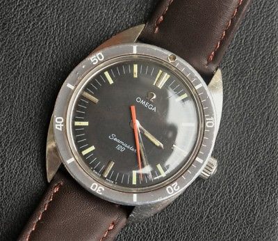

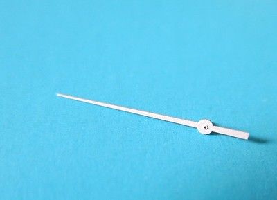

I've seen photos of a few Seamaster 120s with an orange seconds hand. Can anyone confirm whether these are correct or not? At first I dismissed it as an incorrect replacement but I've seen photos of at least three with this seconds hand.
3,689
18,156
these red second sweep hands were used on CHRONOSTOP and GENEVE models of the same era .... they are Omega hands ... BUT NOT ... WERE NOT ... used originally on this model 120 ...

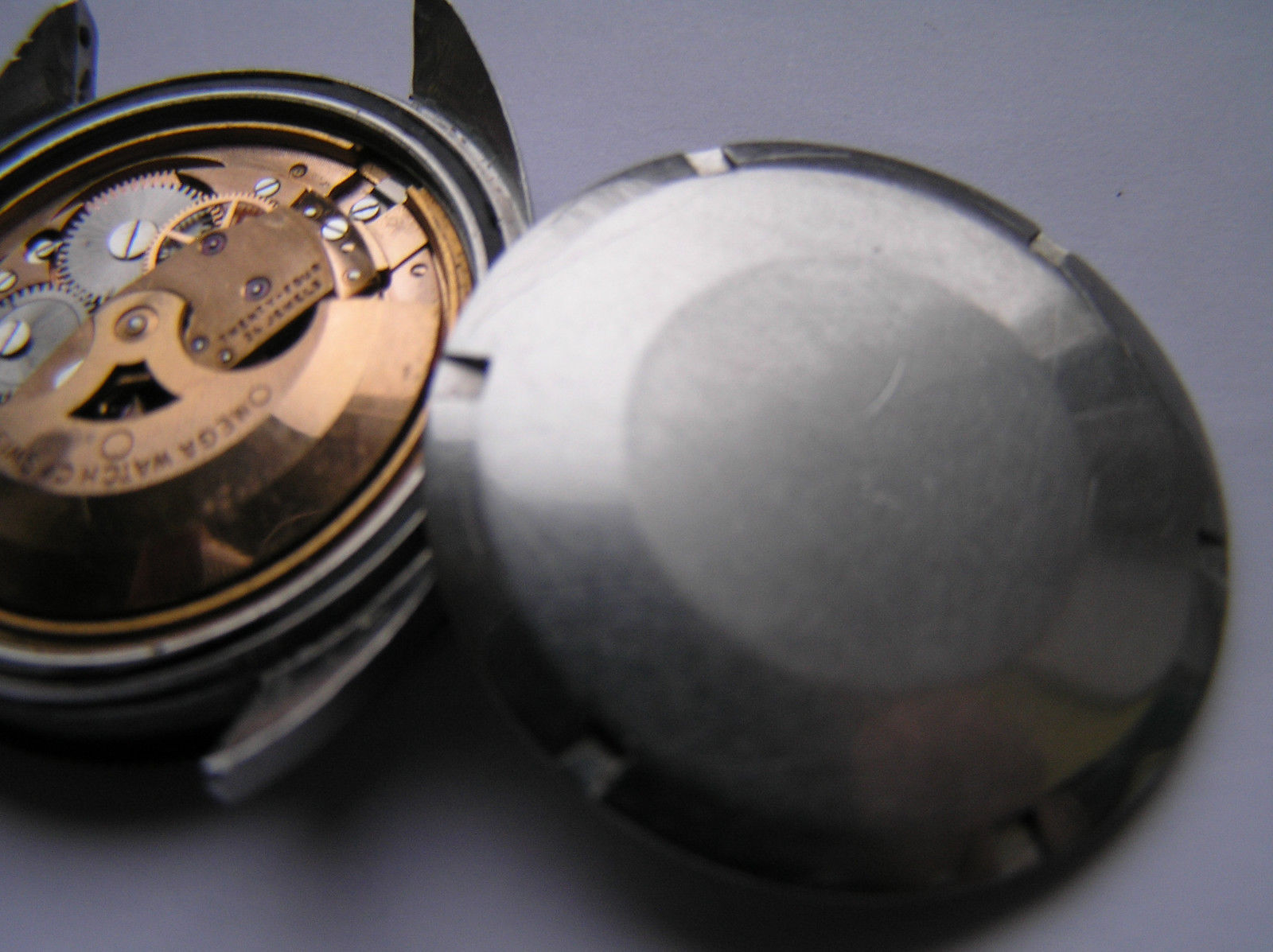

All original legitimate cases have notches at the 3 and the 9. This notch may be missing on bogus examples.

No case notch at 3 o'clock and 9 o'clock.

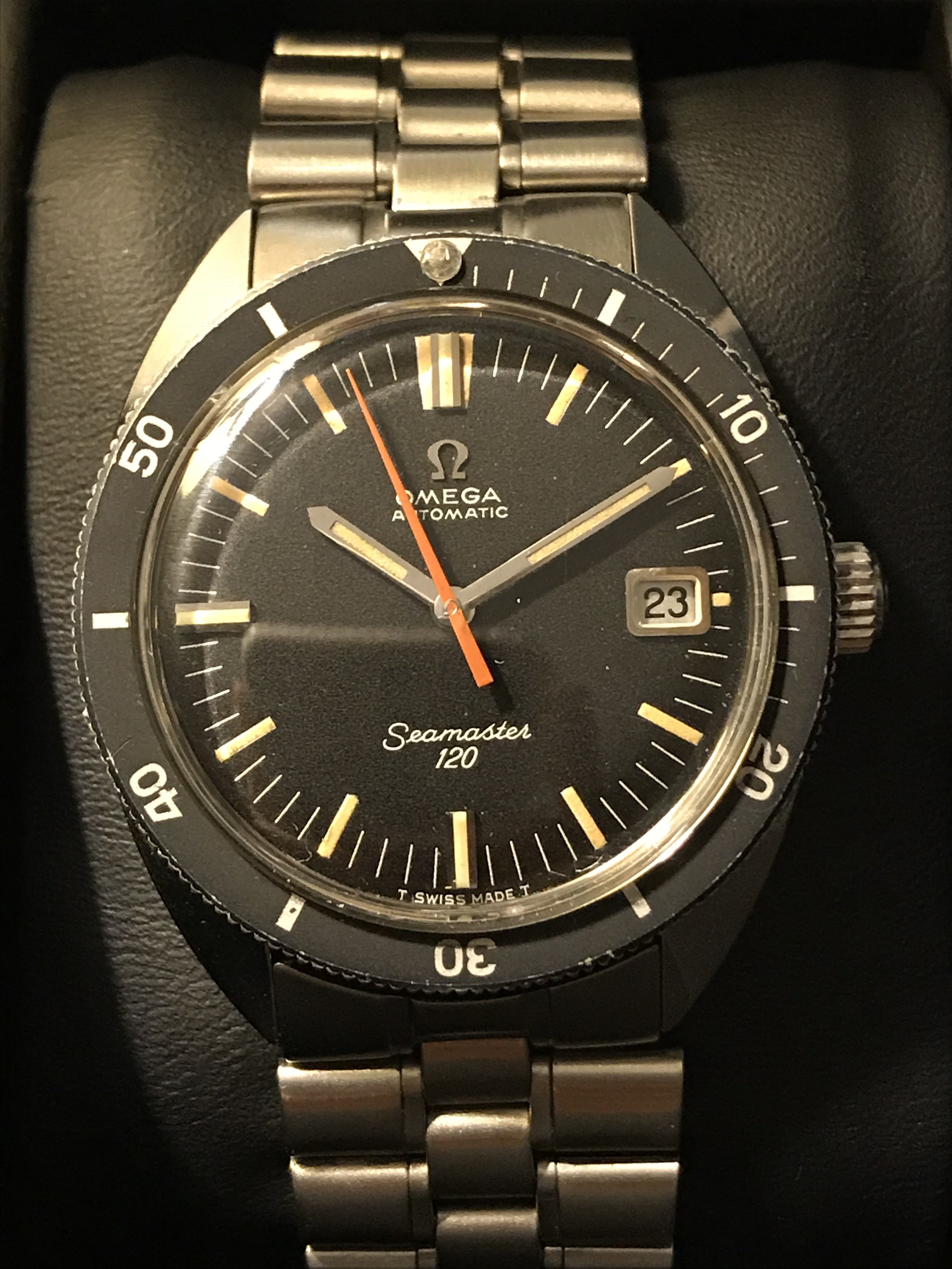

Here is my SM120
Originally came on a 1067 bracelet dated 2/67, swapped for a tropic strap for now. I purchased with the intention of keeping the bracelet and flipping the watch but I enjoy it to much to let it go. Dial is stunning in natural light even though it is missing some lume on the dial. Bezel no longer turns, no big deal to me.
Has the "unique" lumed second hand w/ lume color matching the dial, as seen under UV.
500
966
