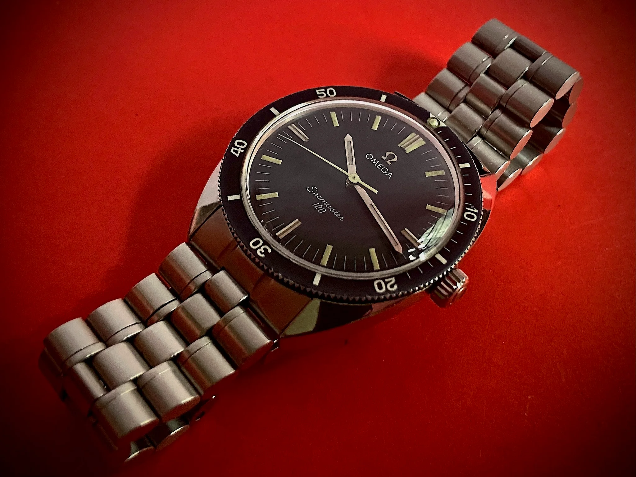

My Early Seamaster 120 Divers. What to look for and what to avoid.

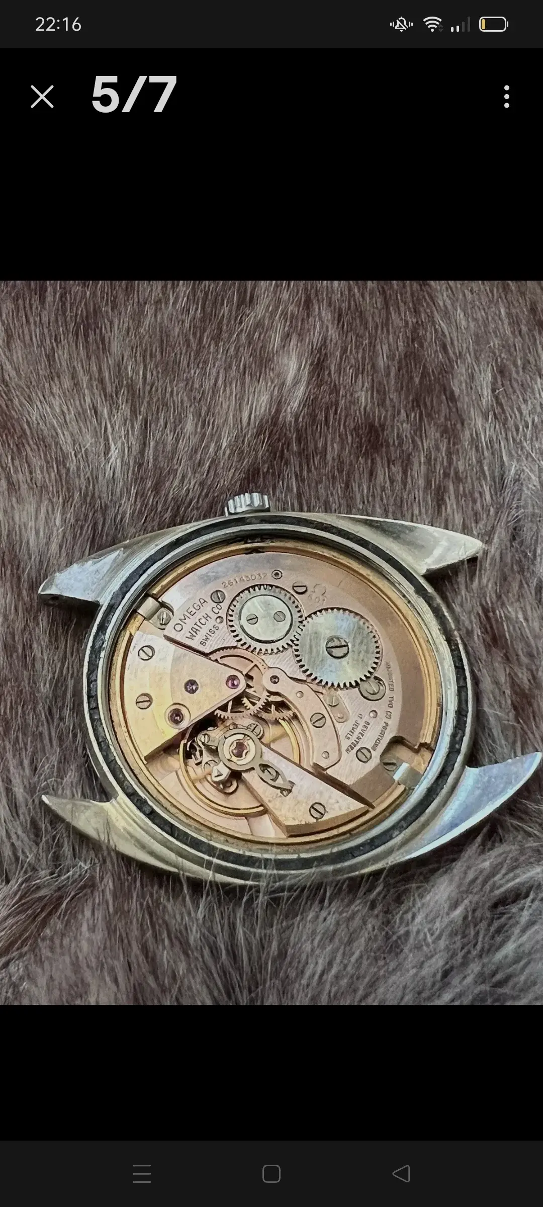

Since it has the 561 cal and the 'adjusted 5 times', it is more likely it is a total movt transplant.
However, it is just possible theses parts have been transplanted into a similar Omega movt.
Try the date thing I mentioned - it might point towards a probable solution.
211
689

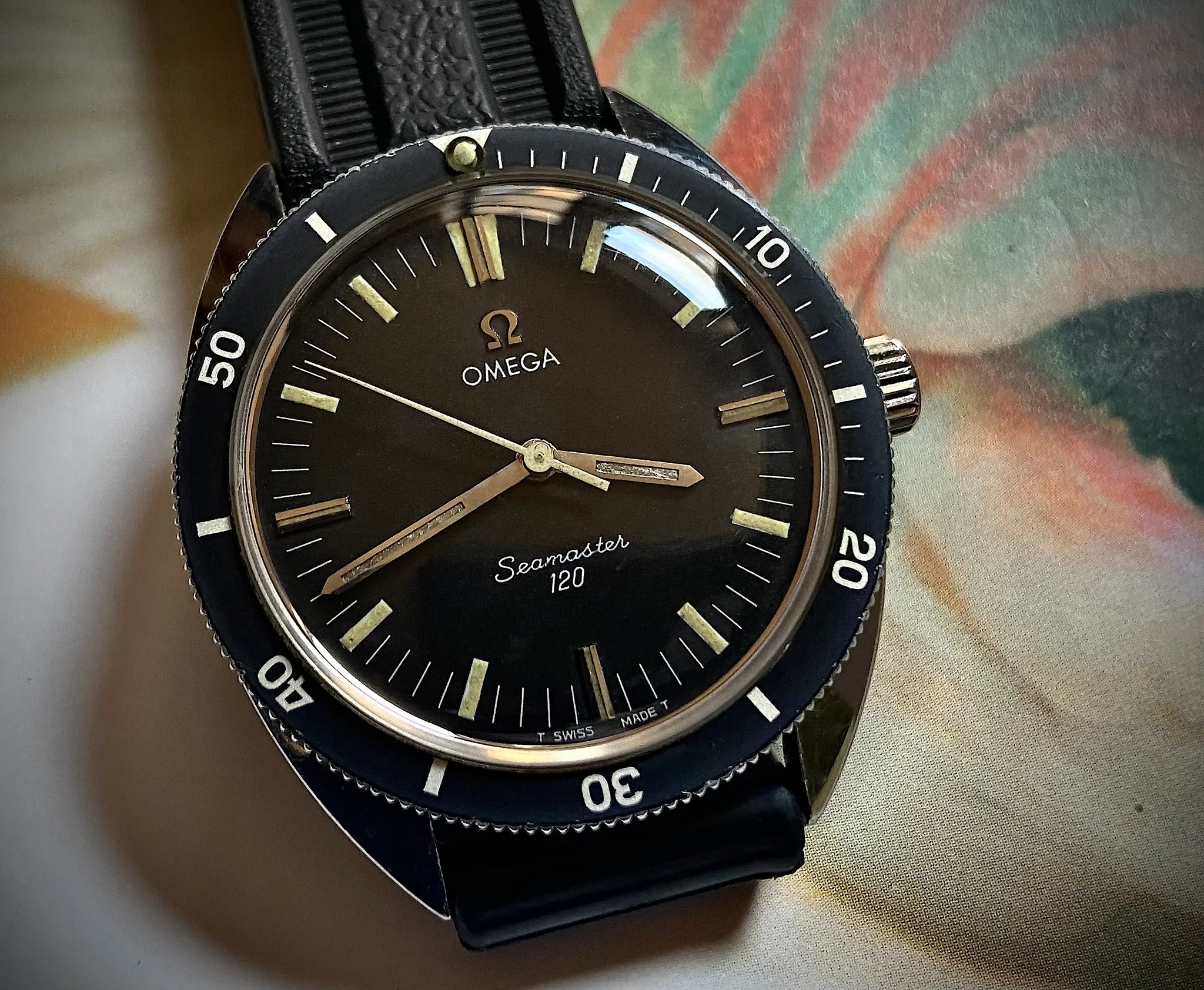

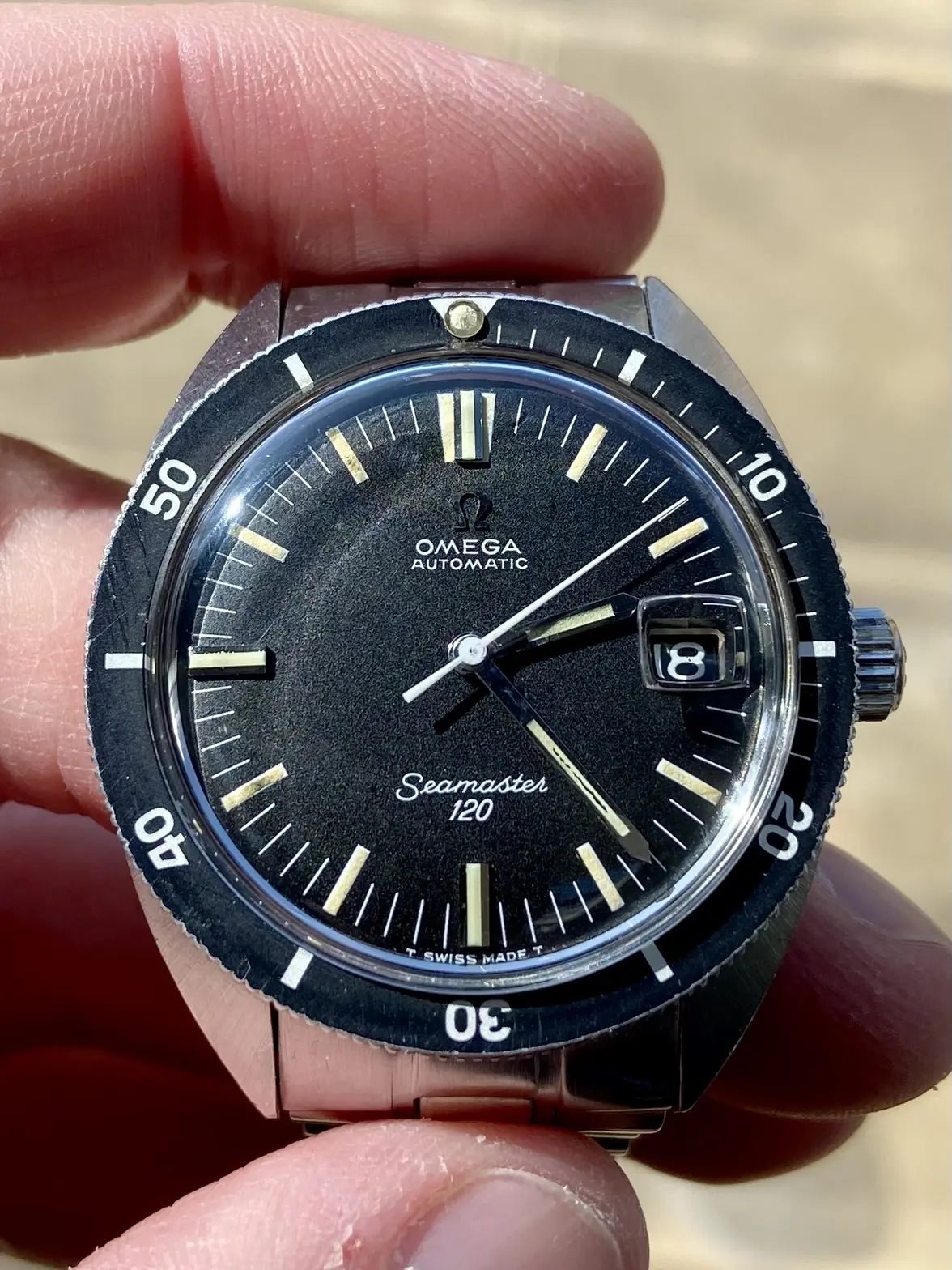

Yeah, no quickset, just the swirling around from 9-1.
Movement swap. Does it impact the value / originality?
6,832
10,502
I don't really follow SM120s but as a 'frankenwatch' it is bound to affect the value quite significantly if someone is looking for an all-original watch.
13,555
23,503
It obviously impacts the originality as it’s almost certainly not the original movement. This in turn will have an impact on value and also how sellable the watch is. I.e. it will sell for less than an original example but will also take longer to sell

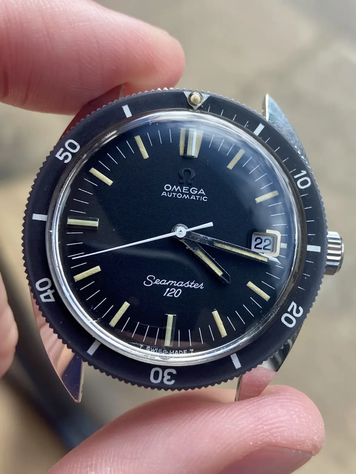

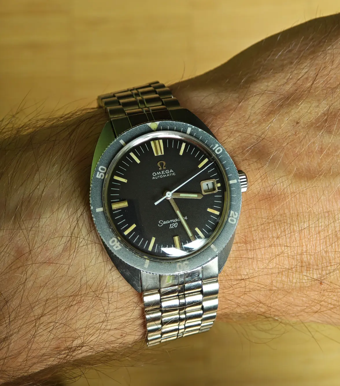

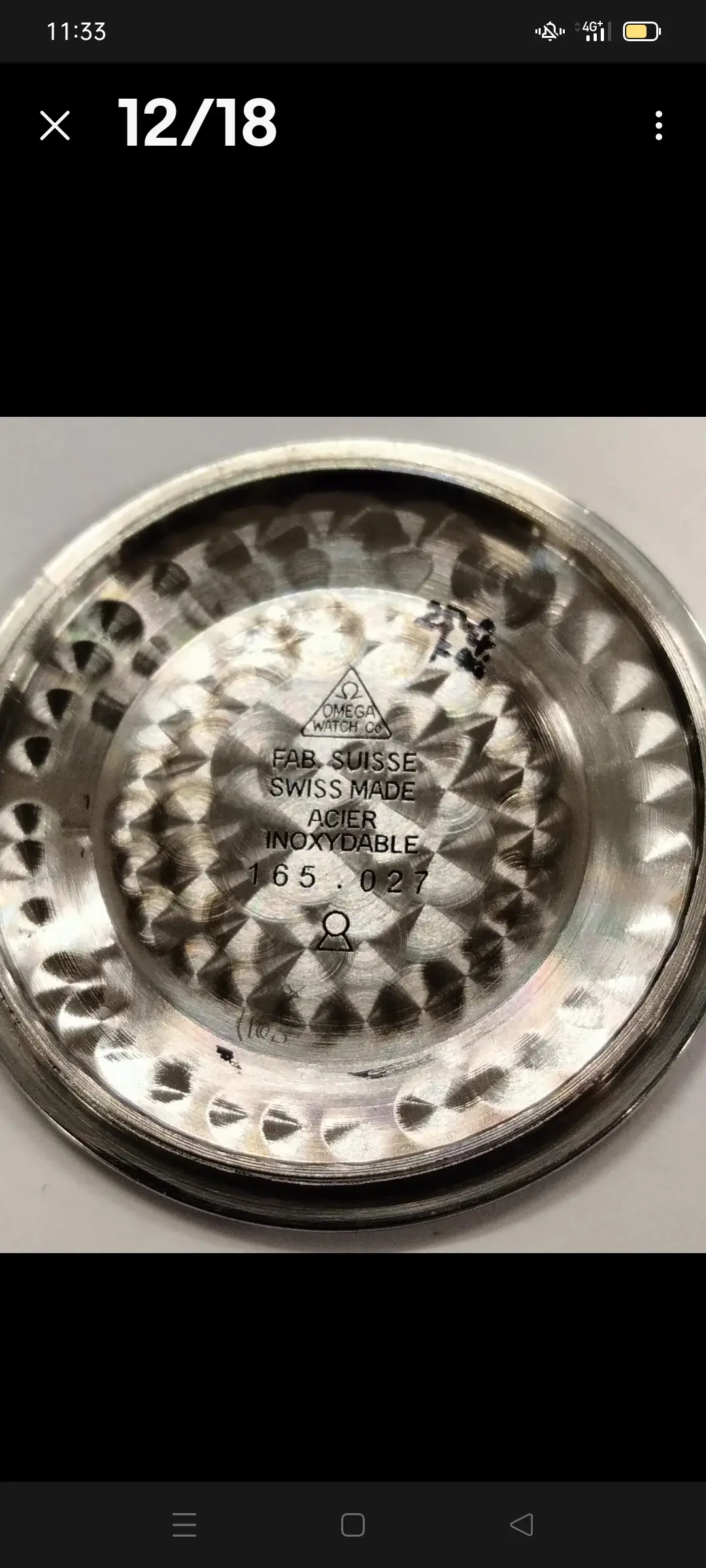

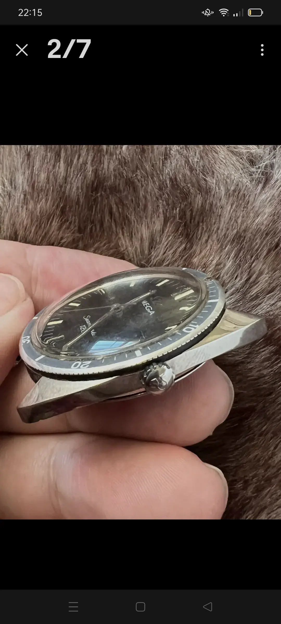

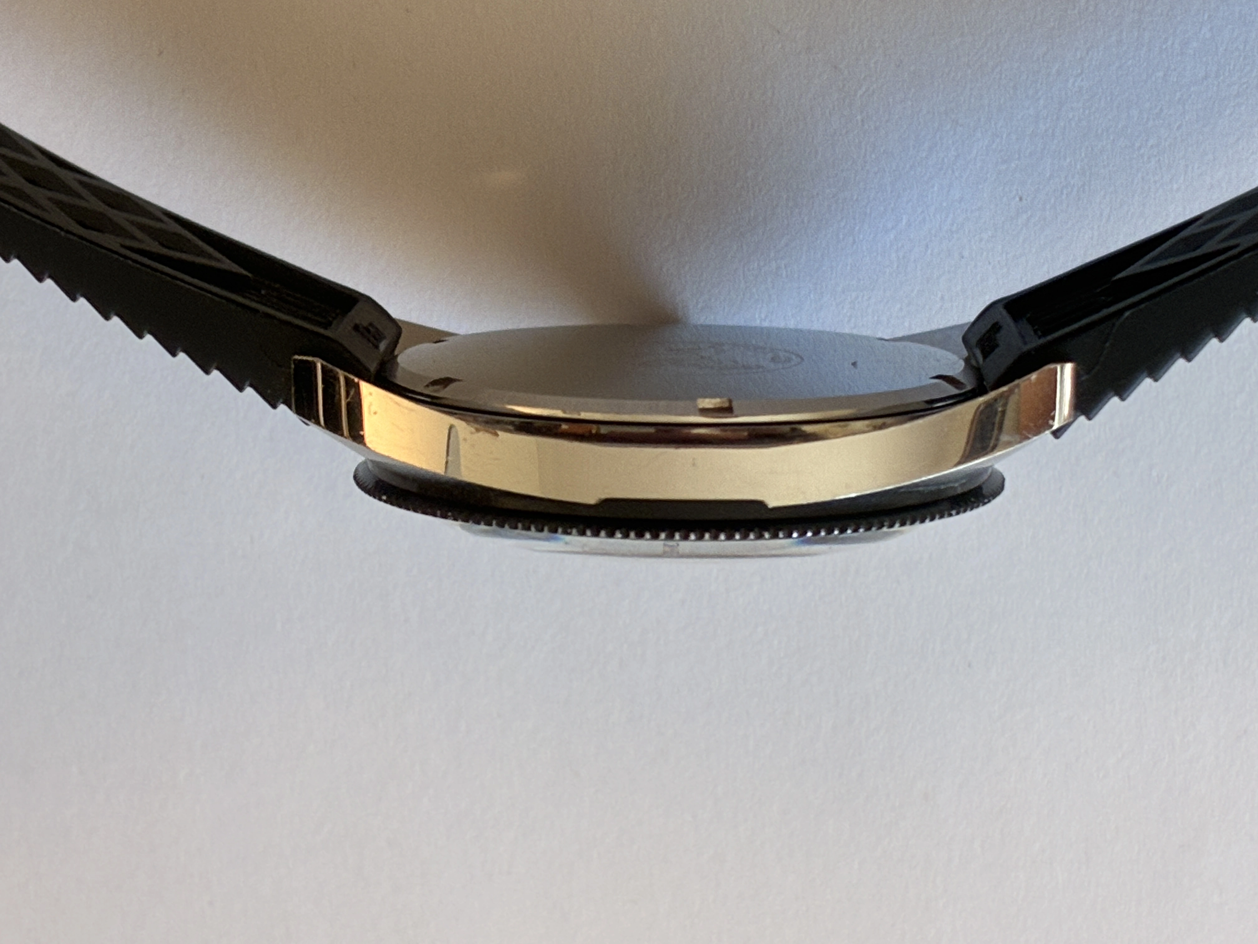

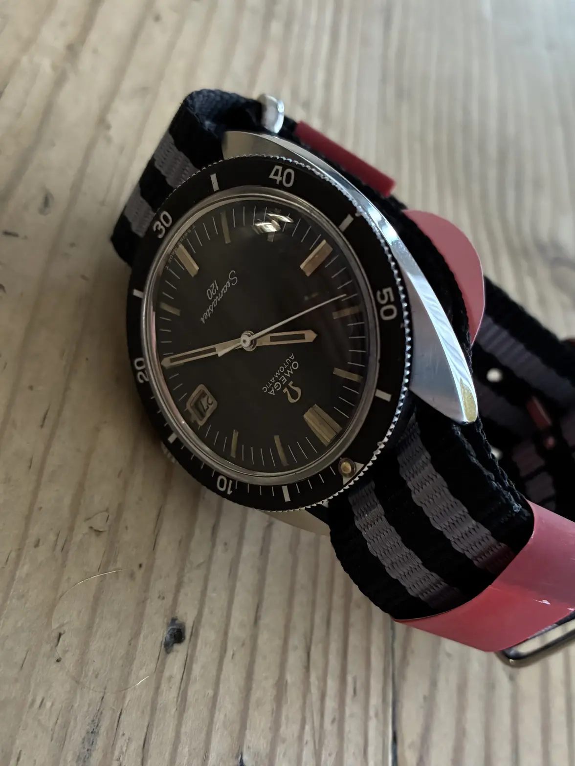

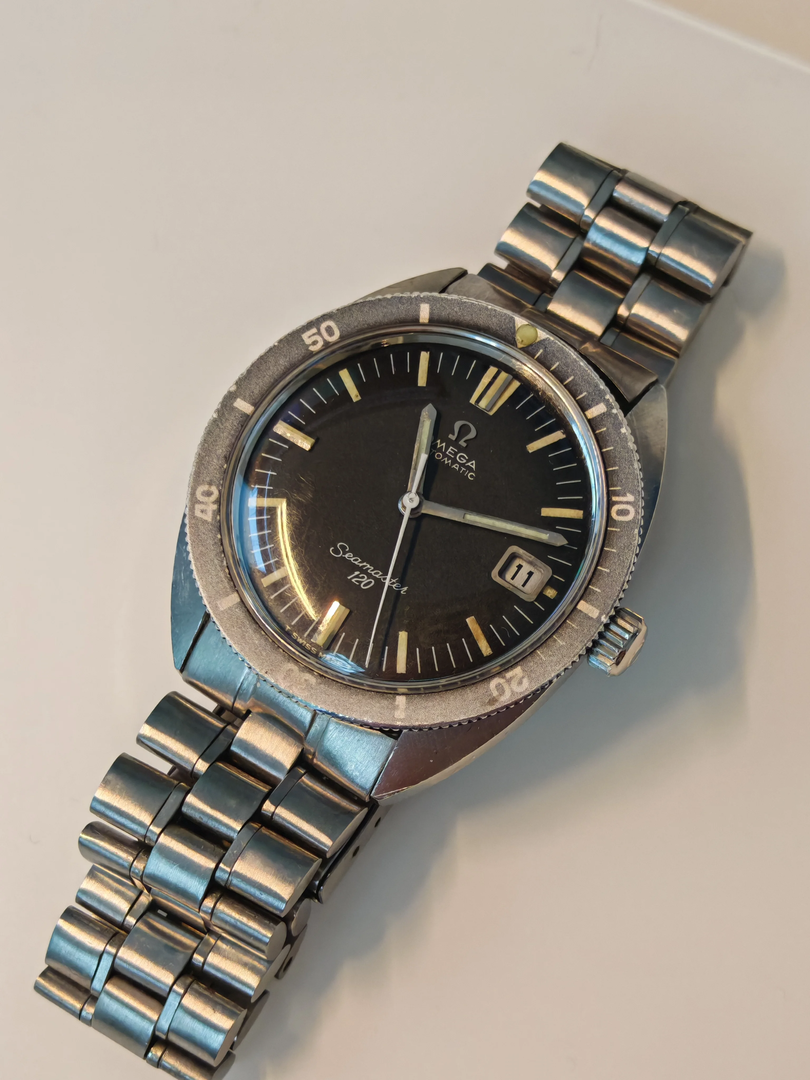

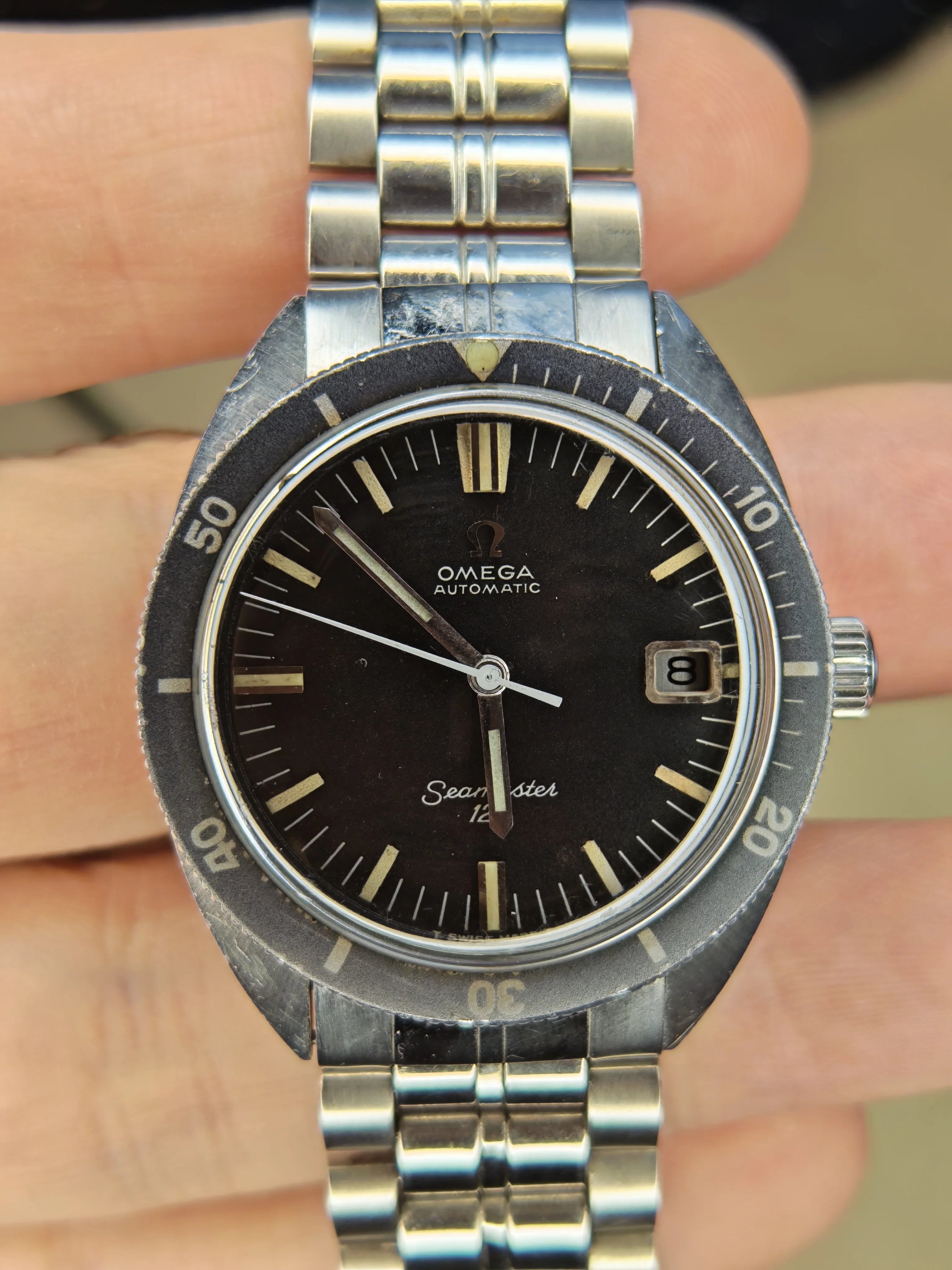

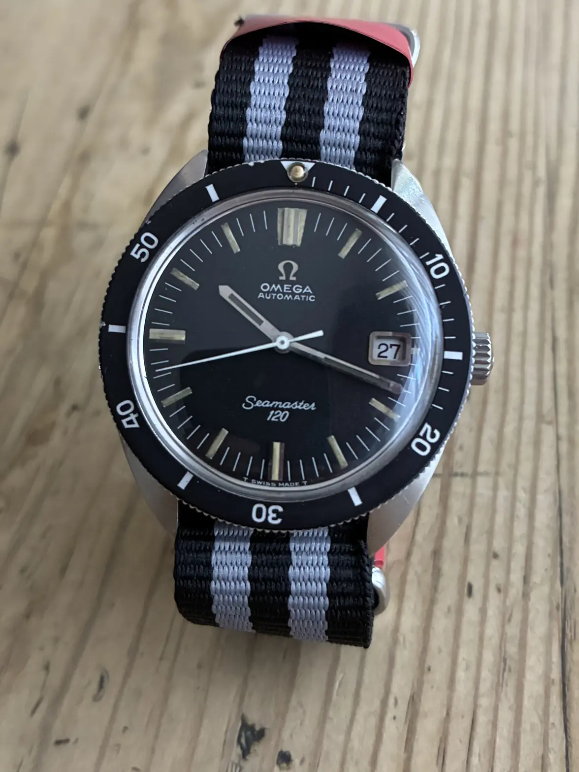

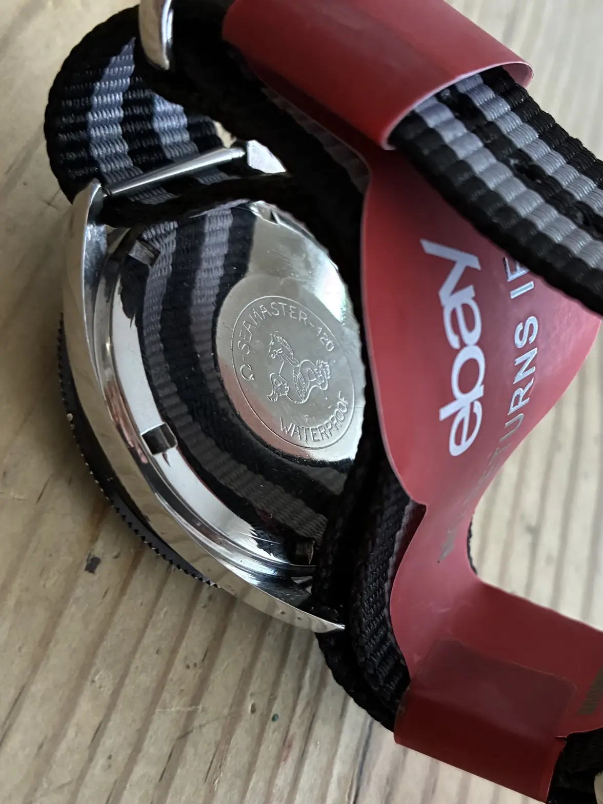

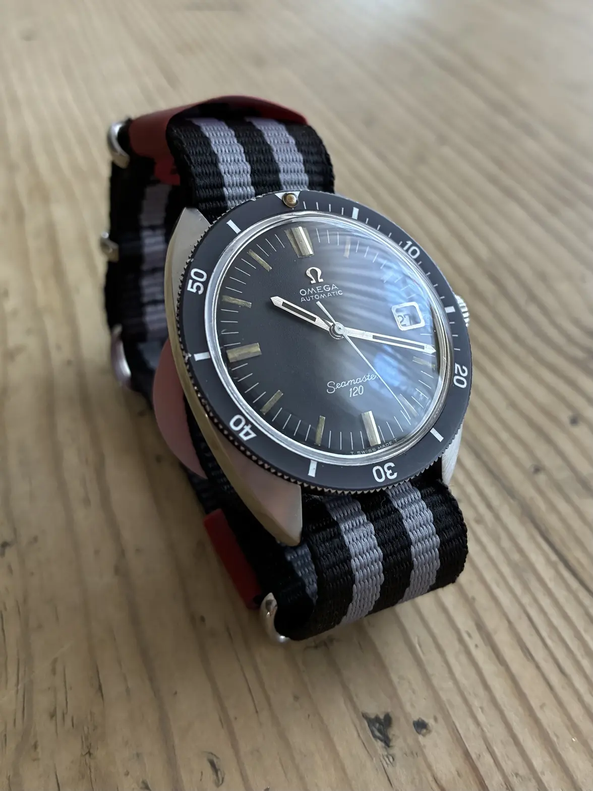

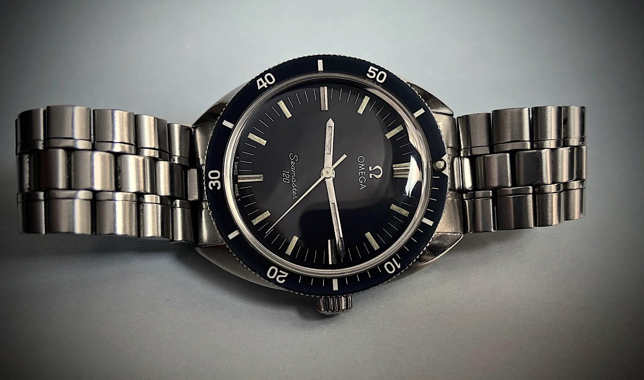

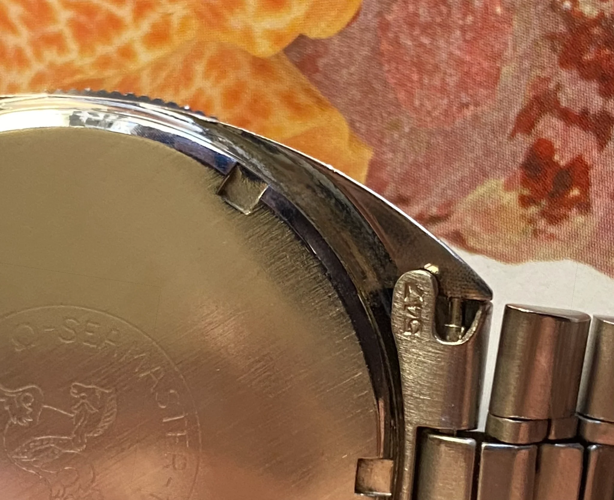

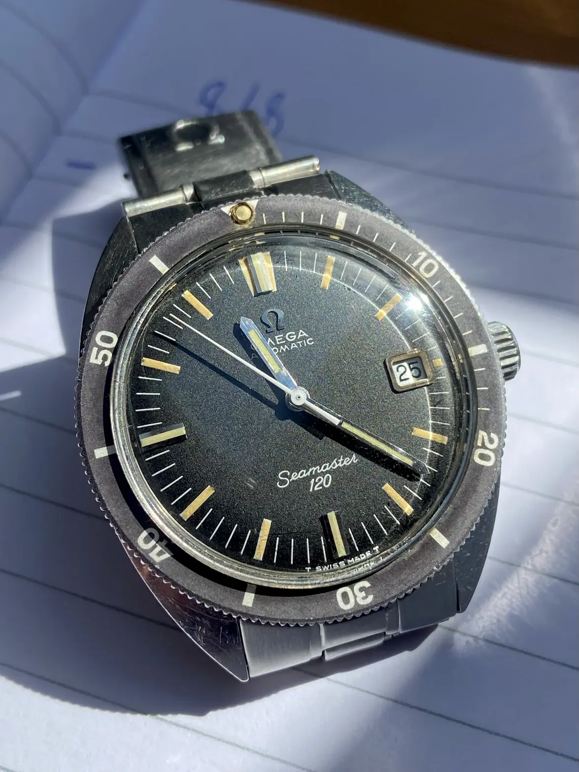

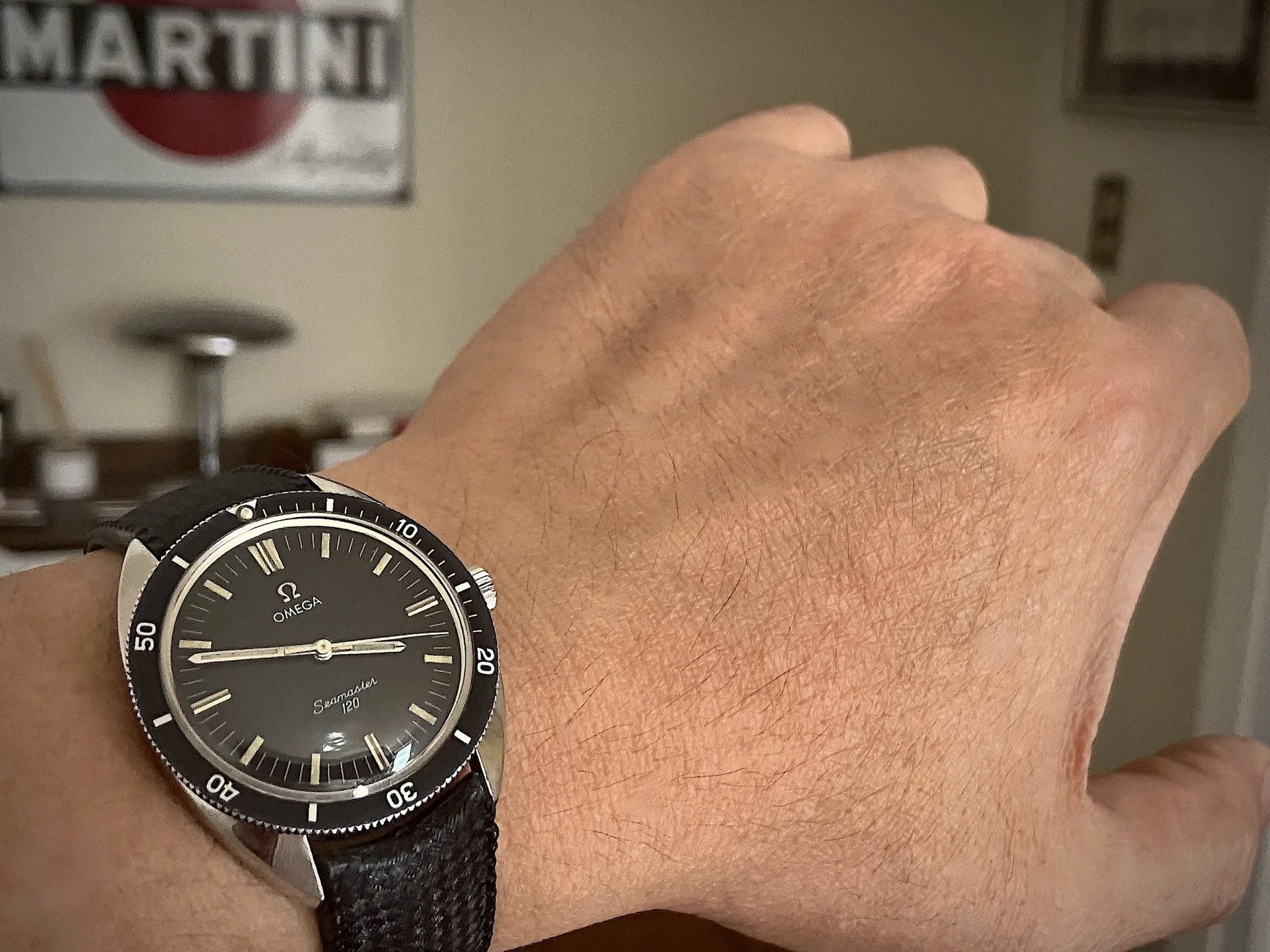

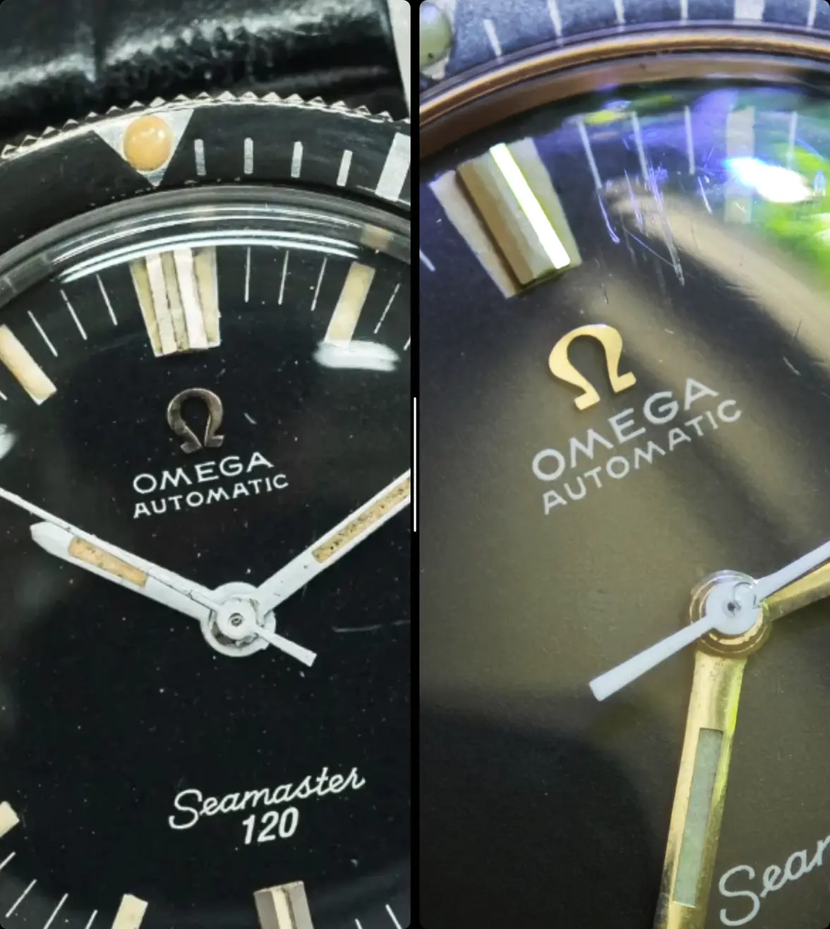

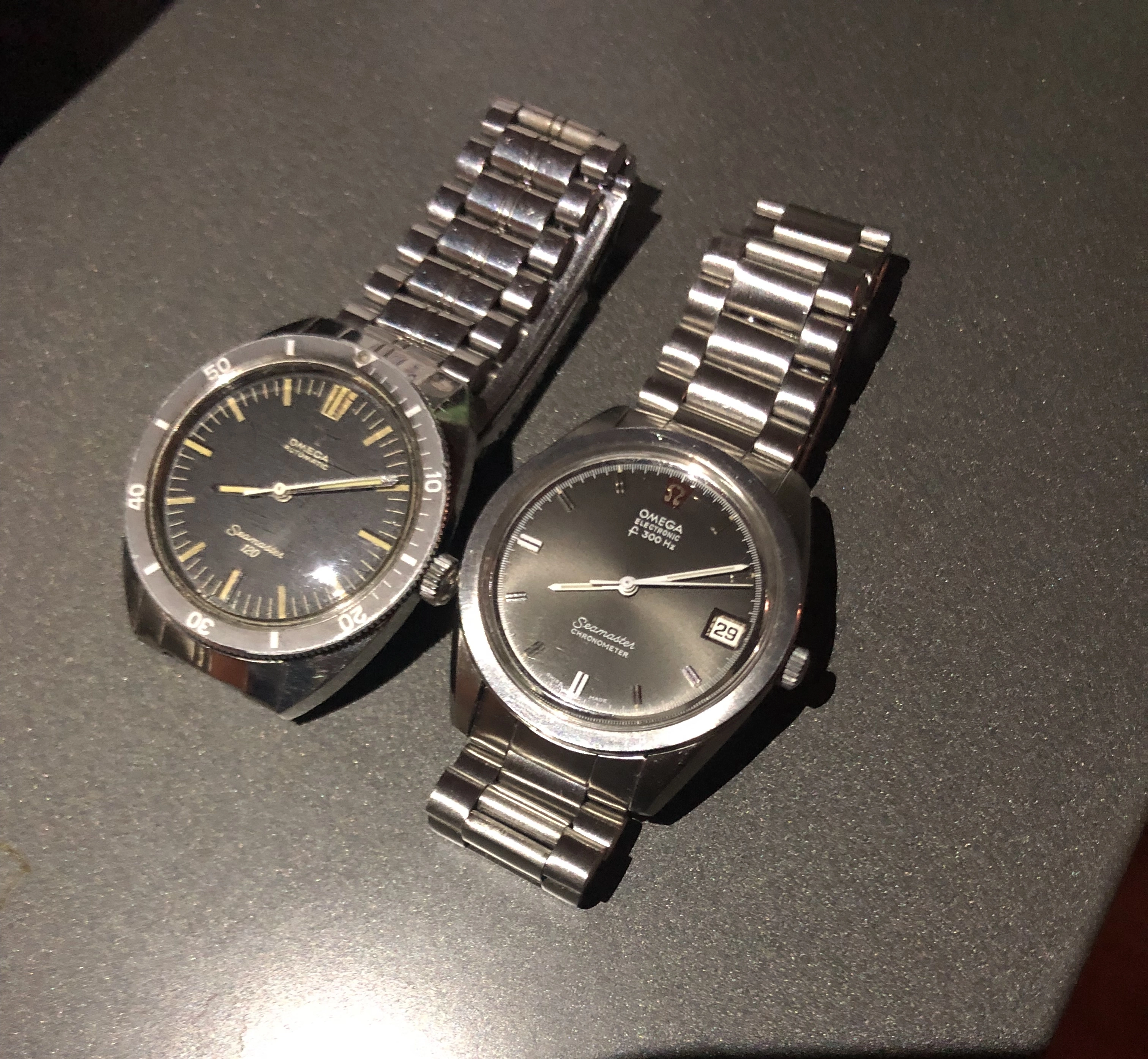

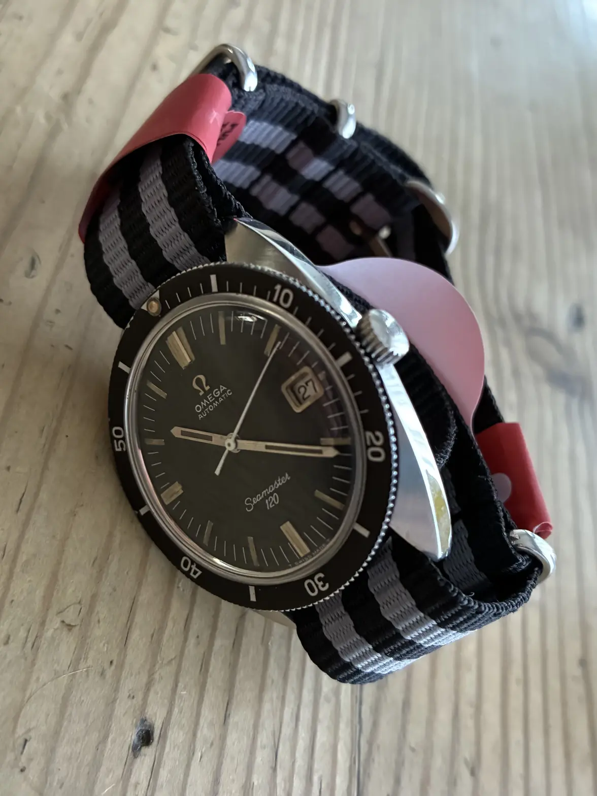

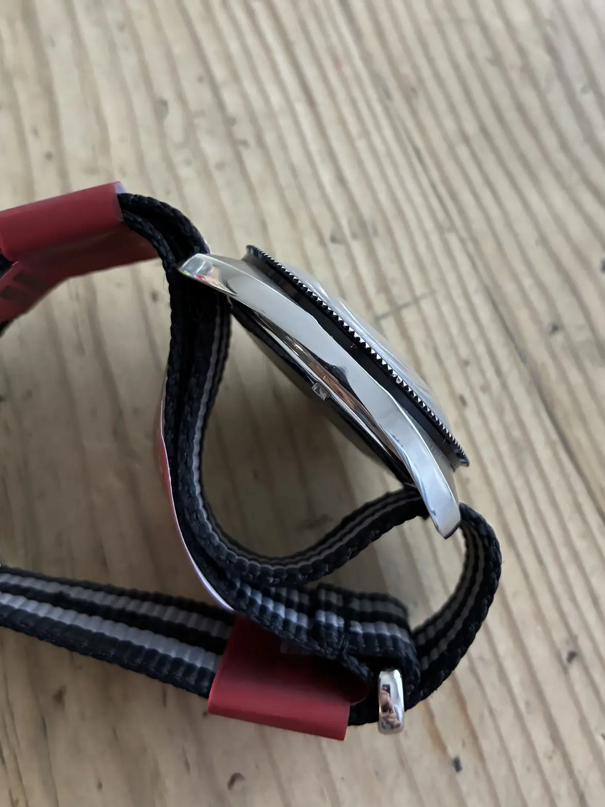

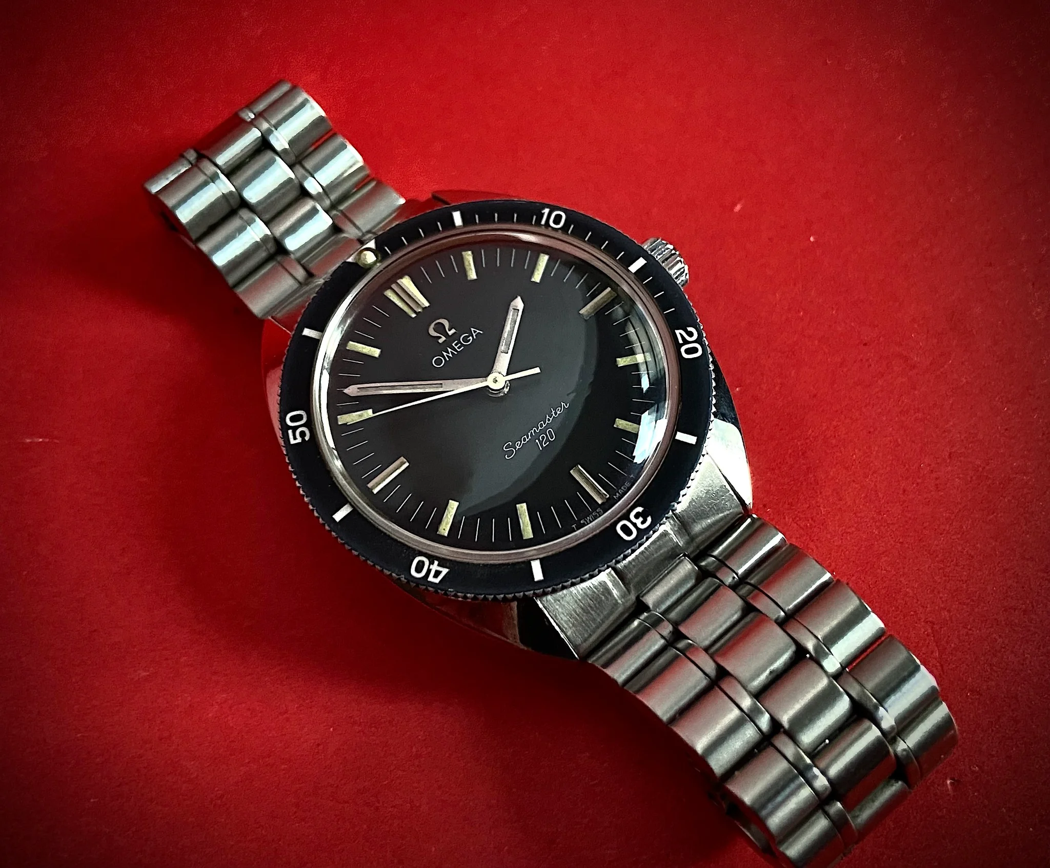

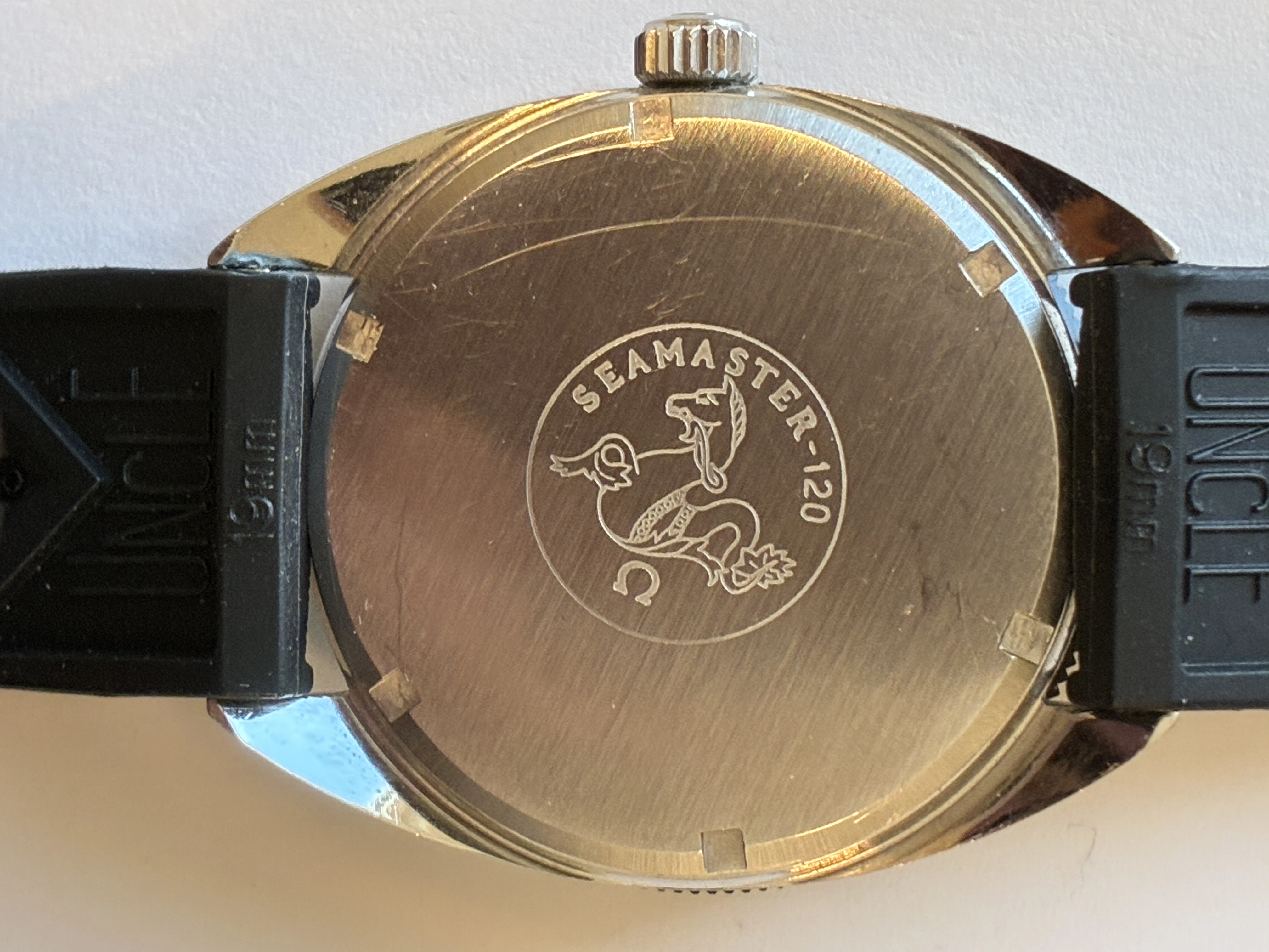

I have a question about my SM120. Bought it a couple of years ago and it had an official Omega service. This is it:
This photo show a lot of smudges and hairs, i took it under a real bright light.
These are on another bracelet (both original Omega and corresponding the watch age):

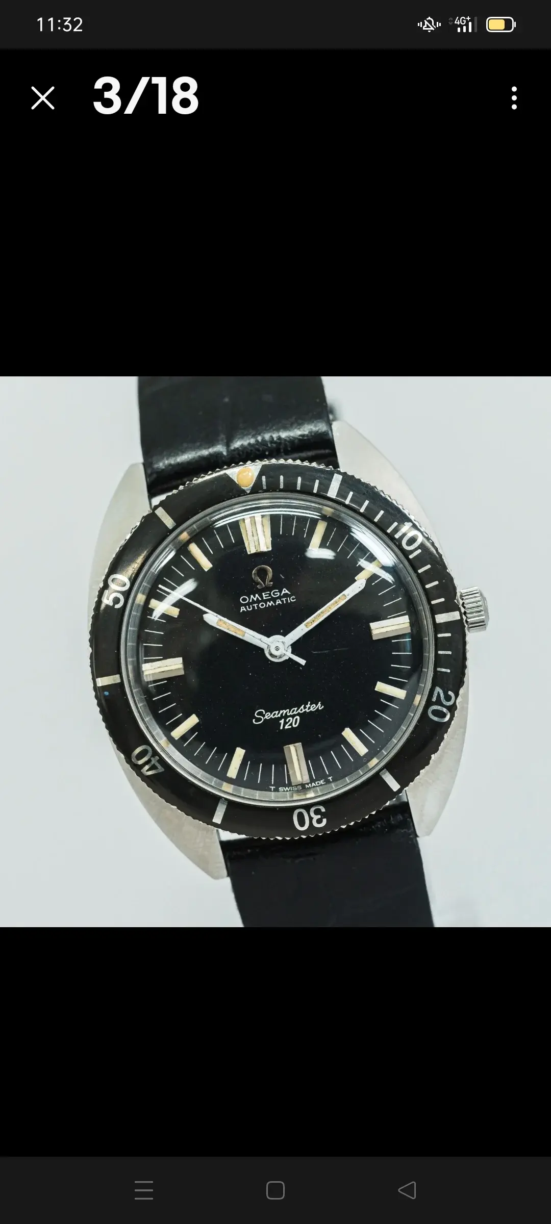

I know this watch is delivered with the 565 movement. But, mine is with the 561 movement. The watchmaker said: well, the watch is almost 60 years old, its quite possible someone just replaced the movement 50 years ago. Movements were easy to order, Omega wasn't that strict with parts back then, so maybe someone even liked the 561 more because of the COSC. We don't know. It was in there, we serviced it.
Is this a logical explanation? Or is it even possible that some 565 were equiped with the 561 movement? Its quite dull, because the quickset isnt working on the 561.
Happy to hear your responses!
561 is not a quick set movement and is Chronometer ( used in chronometer seamaster or Connie). just a fyi
3,689
18,156
The caliber 561 was not used in any automatic Seamaster 120 from the 1960s. which were introduced in 1966, the 120's featured manual wind movements such as the calibers 601, 611, and 613, or later automatic calibers like 554 and 565.

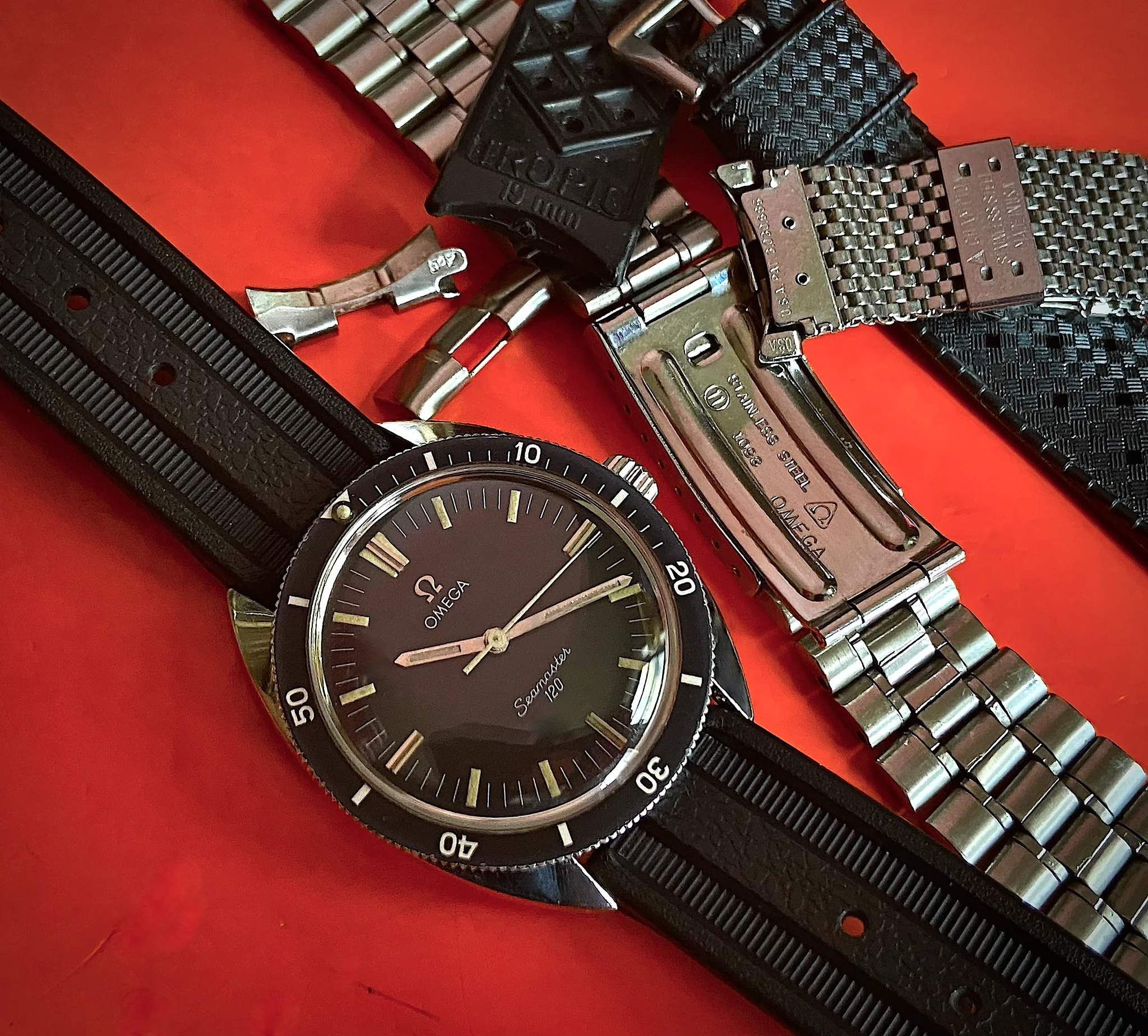

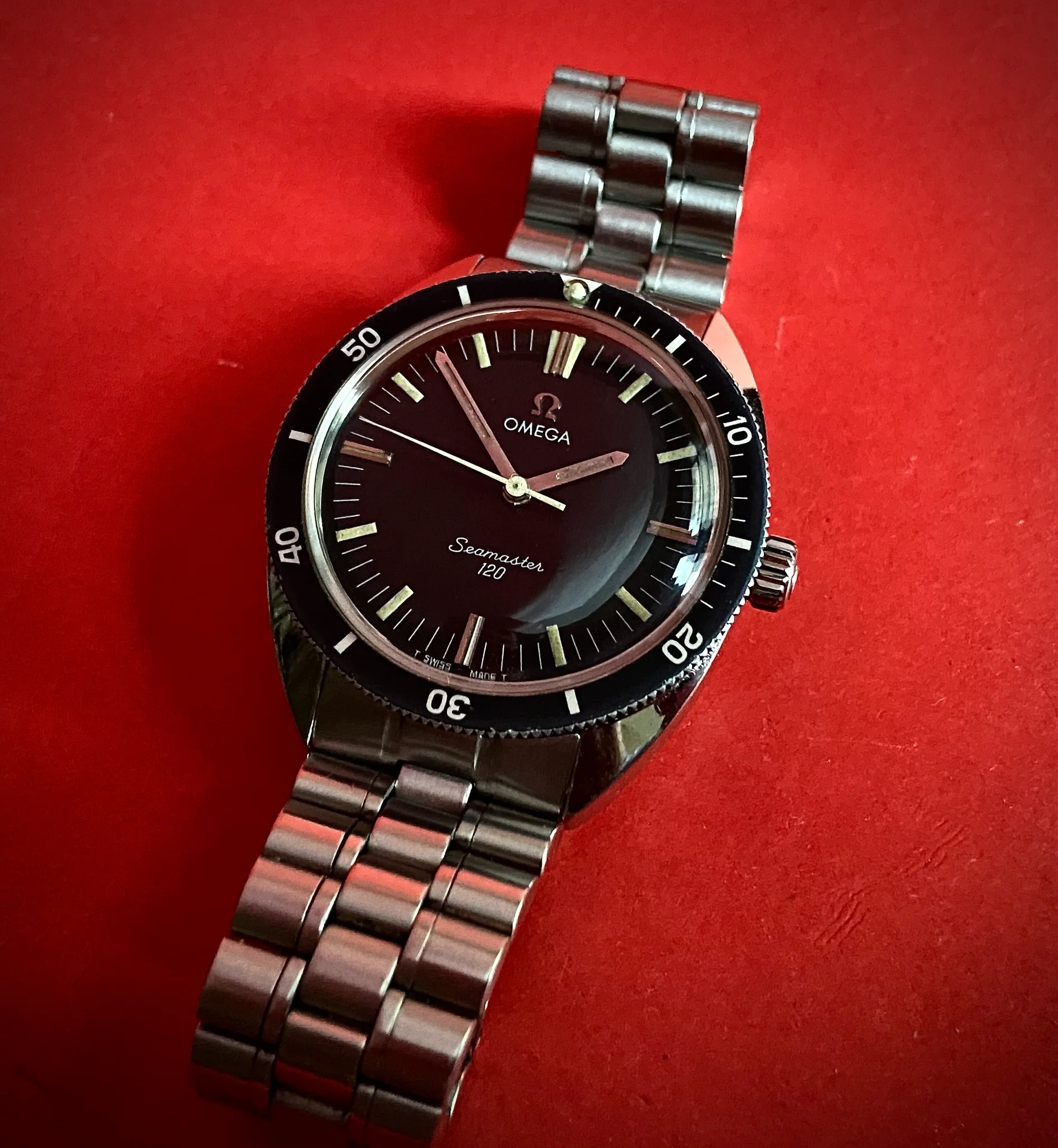

MANUAL WIND VERSION
circa: 1967
OMEGA SEAMASTER 120 SKIN DIVER
OMEGA branded single crown with screw down case back watch case made by Ervin Piquerez S.A aka: EPSA case ref.# - 135.027

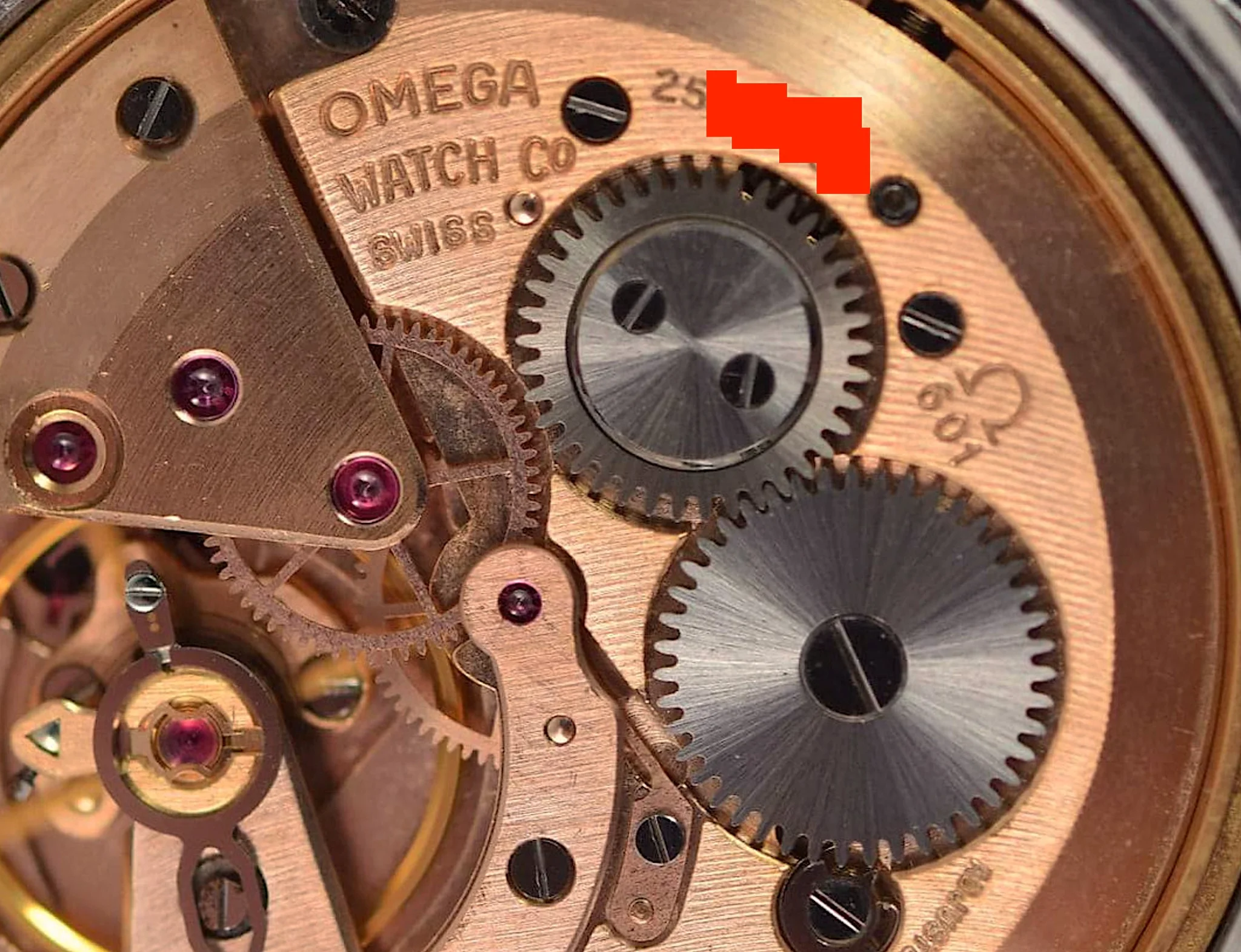

Mvmnt: OMEGA CALIBER 601 MANUAL WIND / NO DATE complication POWER RESERVE 48 HOURS.

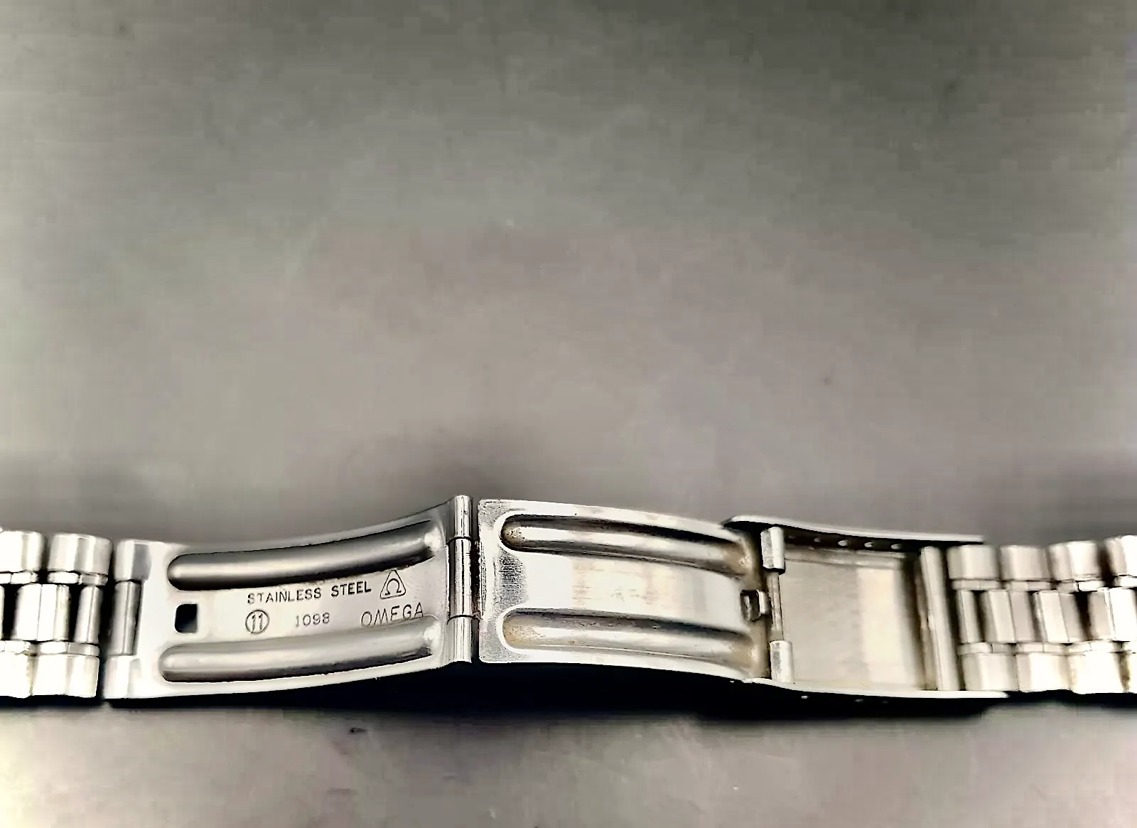

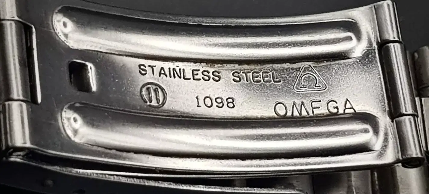

Correct Stainless Steel Bracelet - OMEGA SS bracelet ref.# No.11 OST- 1098, Ω and 19MM ref.# 547 end links.

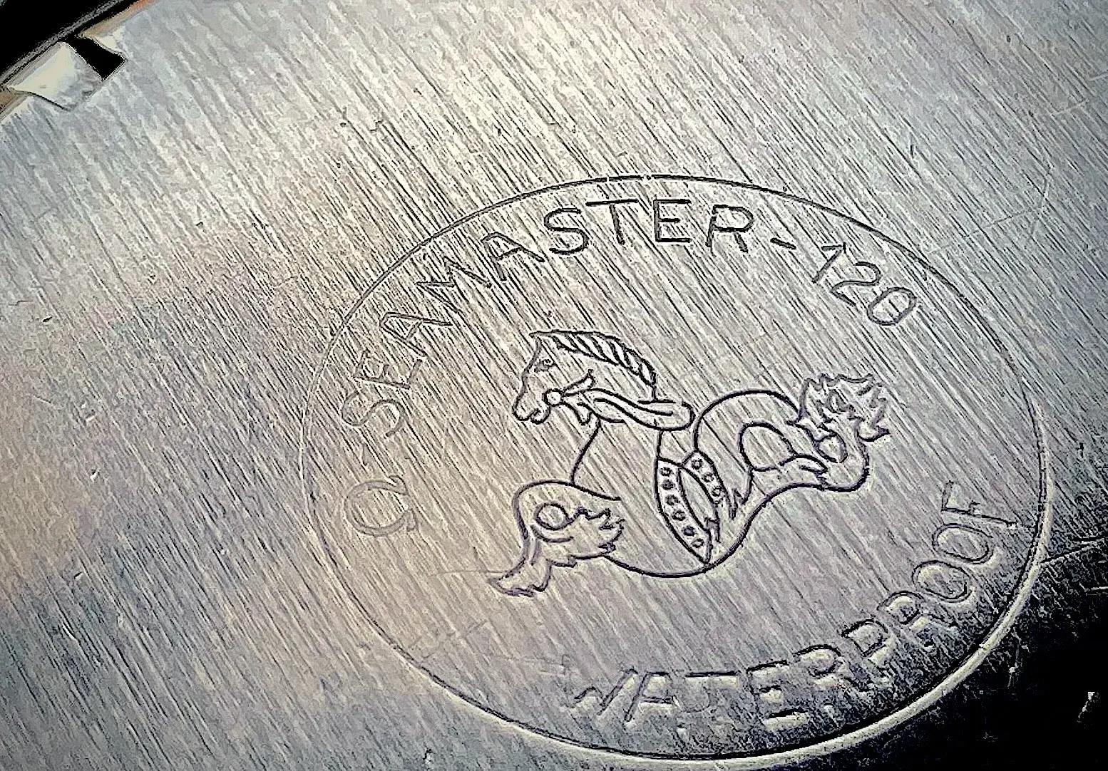

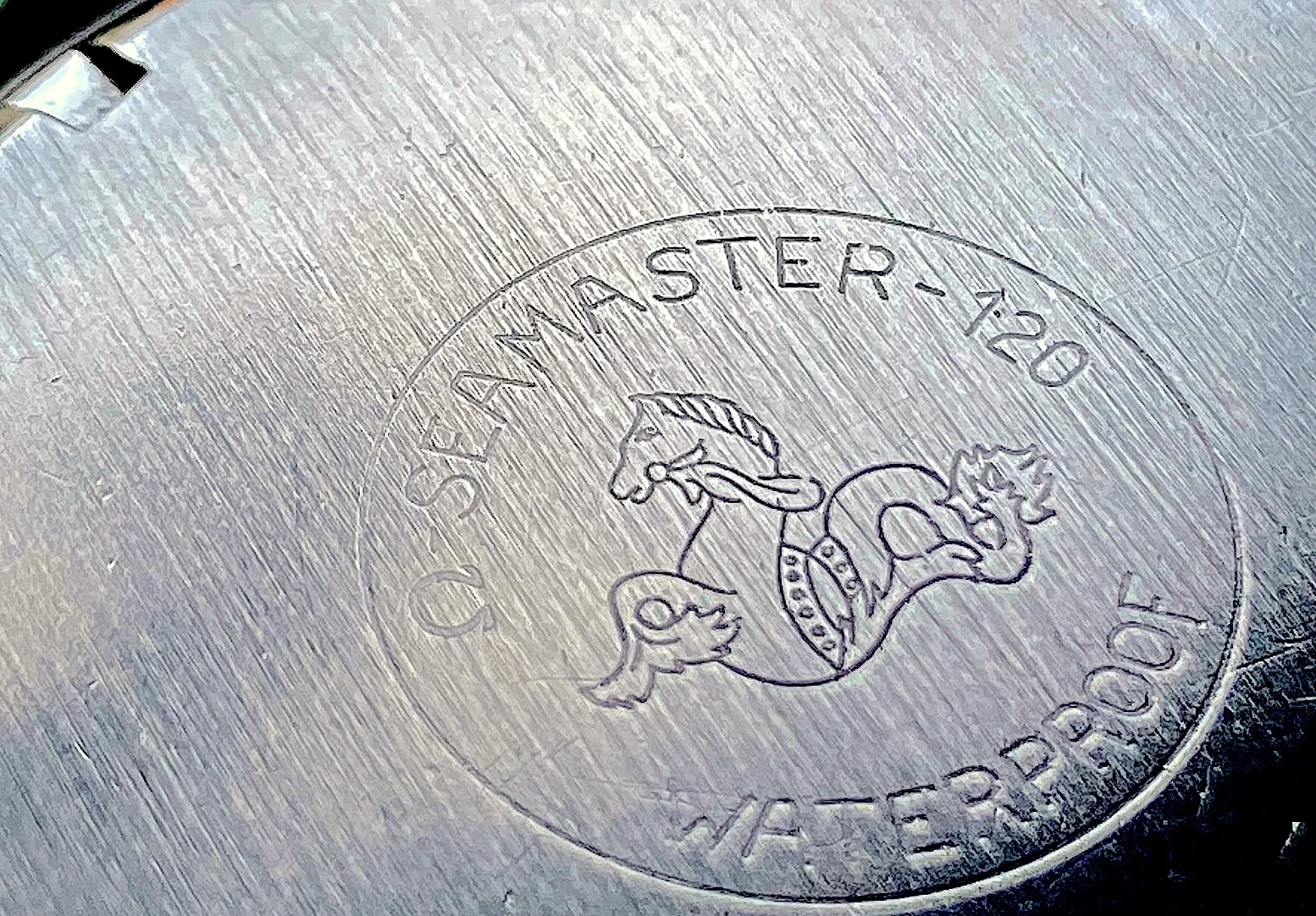

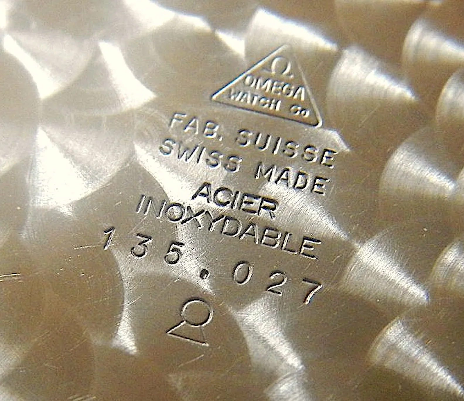

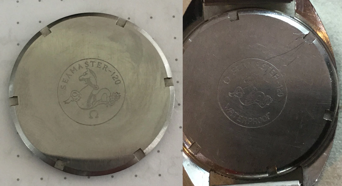

THE CASE BACK for Manual Wind ...

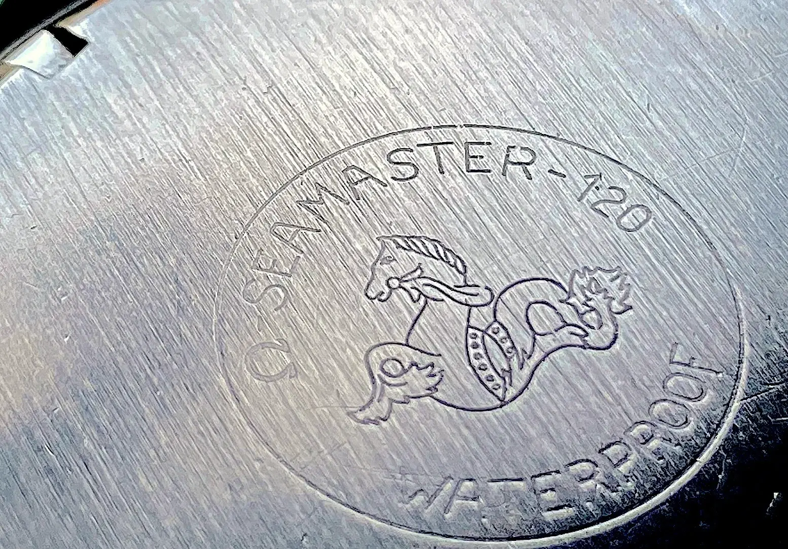

Case back is CHEMICALLY ENGRAVED, not etched or stamped. The chemical engraving results in a lightly-etched Hippocampus (Seahorse) symbol, along with the Omega logo and the text "SEAMASTER 120 WATERPROOF". The engraving should be shallow, and DEEPER ENGRAVINGS are indicative of fakes or Frankenwatches.
The case back
of the manual-wind references is FLAT, unlike the domed case backs of the automatic models.
OMEGA FACTORY BRACELET ref# 1098 and ENDLINK ref# 547

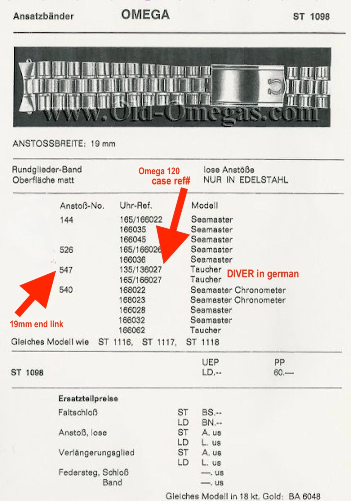

for both the manual wind and automatic models of the Seamaster 120 Skin Diver line is the Omega No.11 stainless steel bracelet, reference 0ST-1098 and 19mm end links, reference #547 based on Omega catalogue images.
Despite seeing many examples today on different stainless steel bracelets this is the accurate pairing seen on official Omega catalogues.

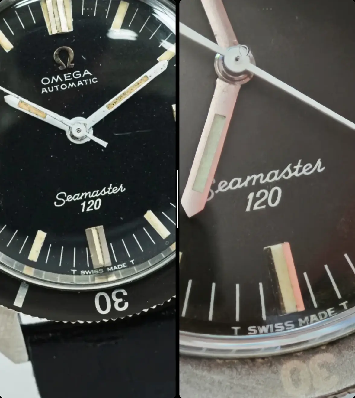

with BLACK DATE WHEEL are around BUT ...
There is no documented evidence in official Omega advertisements, catalogues that the Seamaster 120 with a date complication was ever factory-equipped with a black date wheel. No verified proof has been presented in advertisements or official Omega materials, and such a feature remains unconfirmed. Therefore, the presence of a black date wheel is considered non-standard based on official Omega materials, adverts, vintage catalogue. The images that are around / posted are potentially indicative of aftermarket modifications.
if anyone has found official Omega documentation that show an automatic Seamaster 120 with a black date wheel please share it with us ...
SAFETY RED (orange?) SECONDS SWEEP PYLON / BATON
The Seamaster 120 also came with a safety RED (orange?) seconds sweep pylon as evidenced by an image from the Omega catalogue introduction for the SEAMASTER 120, image is shared below. It should be noted in the catalogue image the safety red seconds sweep baton/pylon is exactly the same as the white colored baton/pylon.
There have been 120s' that have a SAFETY RED PYLON installed from an Omega Geneve Admiralty model it is an elongated triangular RED pylon/baton. This could be a sign of aftermarket modification such as a watch maker repair job - cannibalization for parts no longer in production, and or a franken watch.

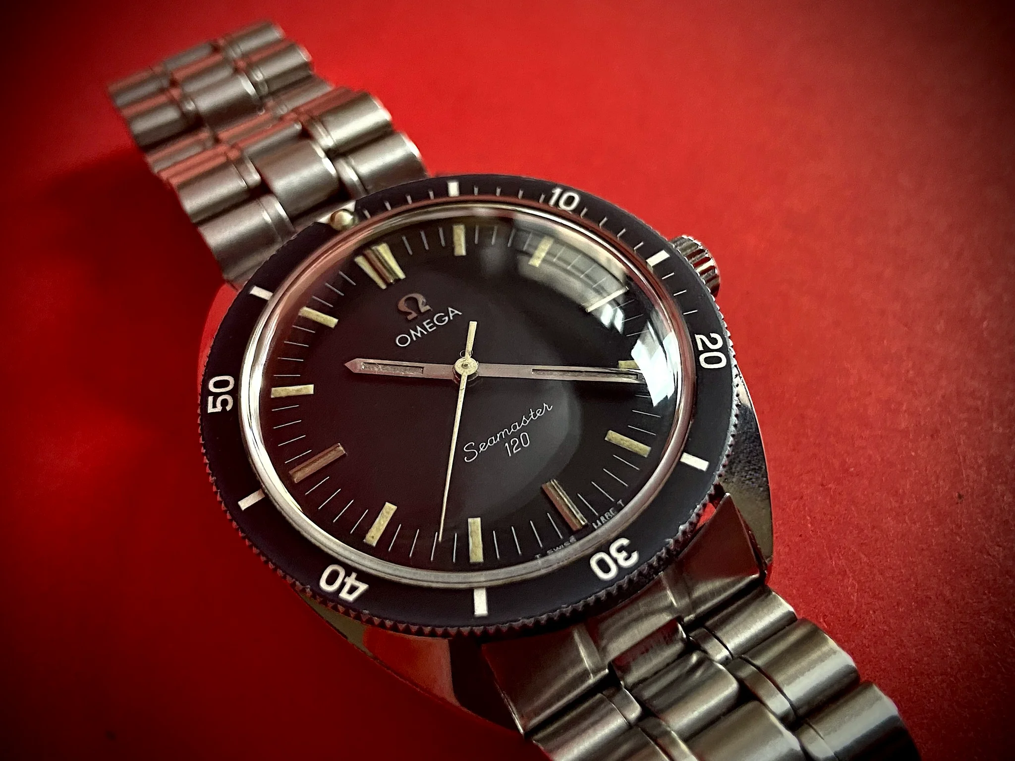

The Gentleman's SEAMASTER 120 came in 4 models:
Case ref.# - 135.027 ....... Manual Movement, No Date, Caliber 601
Case ref.# - 136.027 ........ Manual Movement, with Date, Caliber 611 / 613
Case ref.# - 165.027 ........ Auto Movement, No Date, Caliber 552
Case ref.# - 166.027 ........ Auto Movement, with Date, Cailber 565

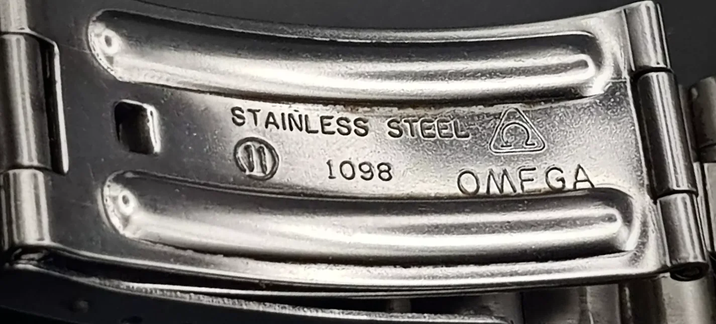

*** 19MM SS bracelet ref.# 1098 ref.# 547 endlinks

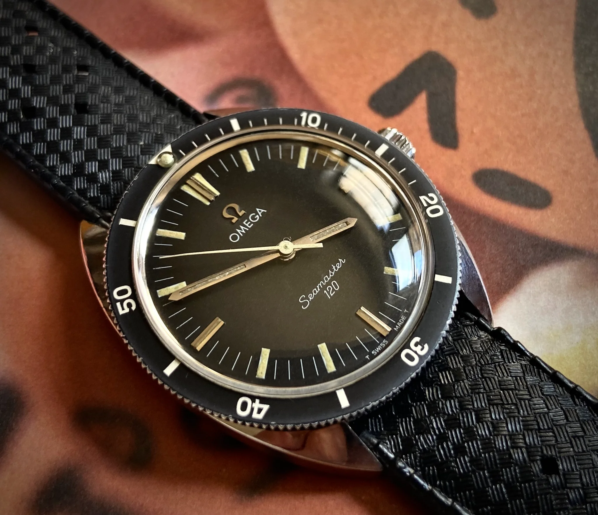

*** 19MM Best Fit Swiss Tropic MOD DEP rubber diver strap
*** 19MM Corfam both smooth or perforated style
this is a water repellent synthetic material designed to mimic real leather

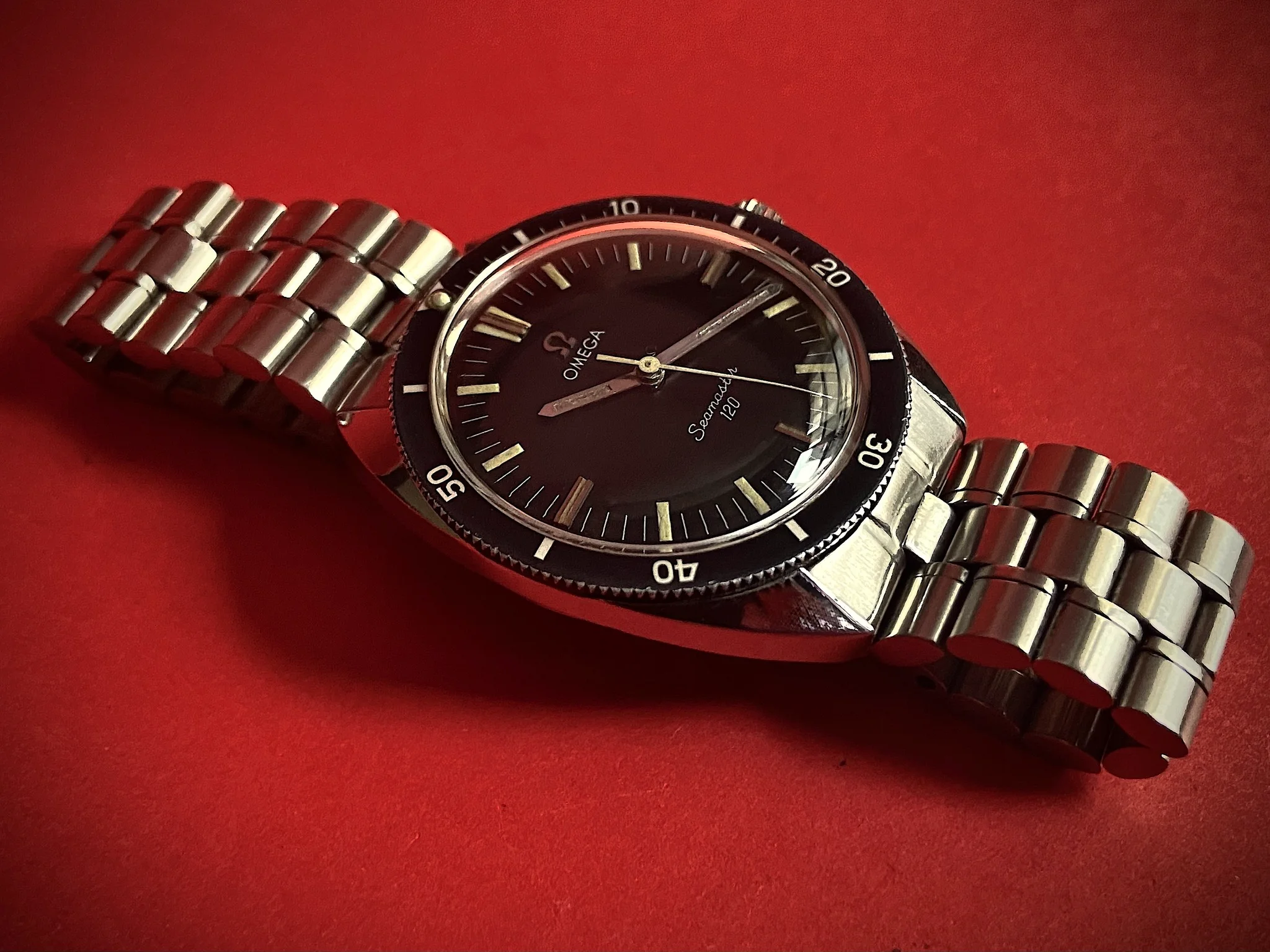

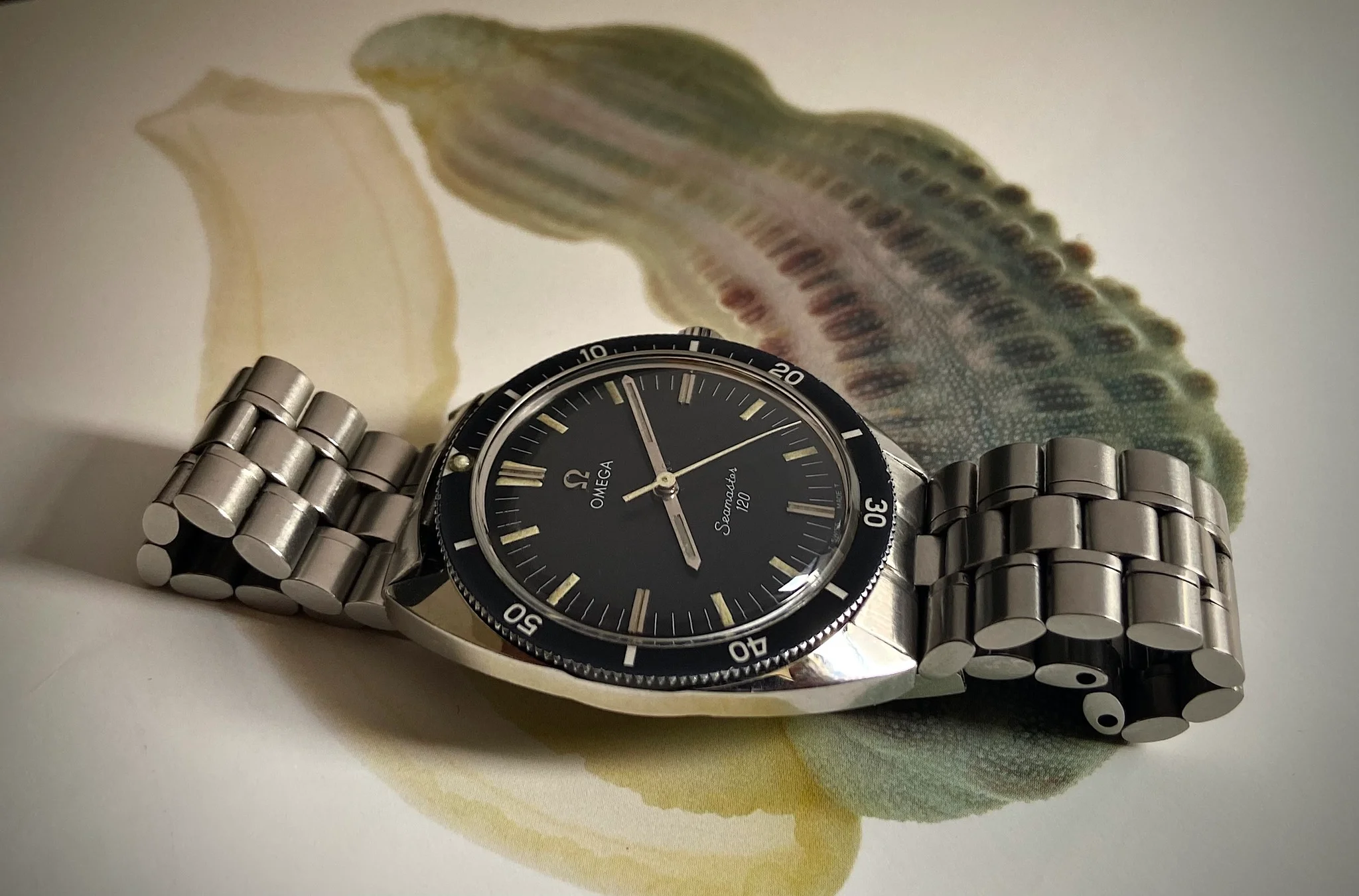

The 120 if purchased with a stainless steel bracelet would have came from OMEGA paired with a Omega branded stainless steel bracelet made by JB Champion USA ref.# 1098 No.11 and 19MM ref.# 547 curved end links. OMEGA bracelets MADE BY JB Champion USA will have a small triangle with an Omega logo inside.
THE 0ST-1098 Stainless Steel bracelet and the 19MM ref 547 endlink
used on the Omega Seamaster 120

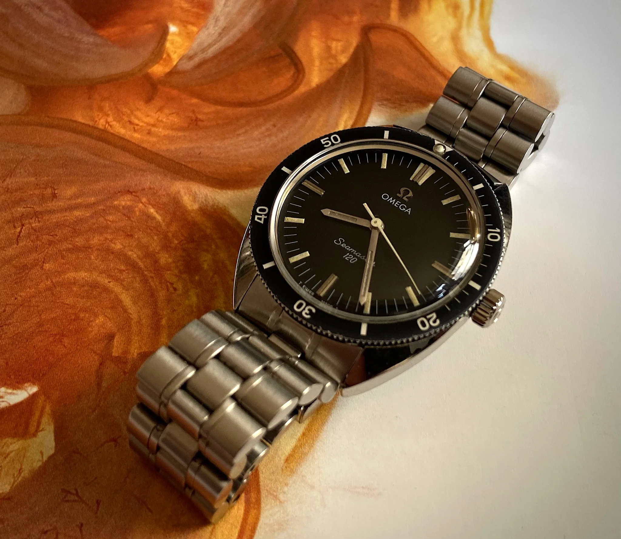

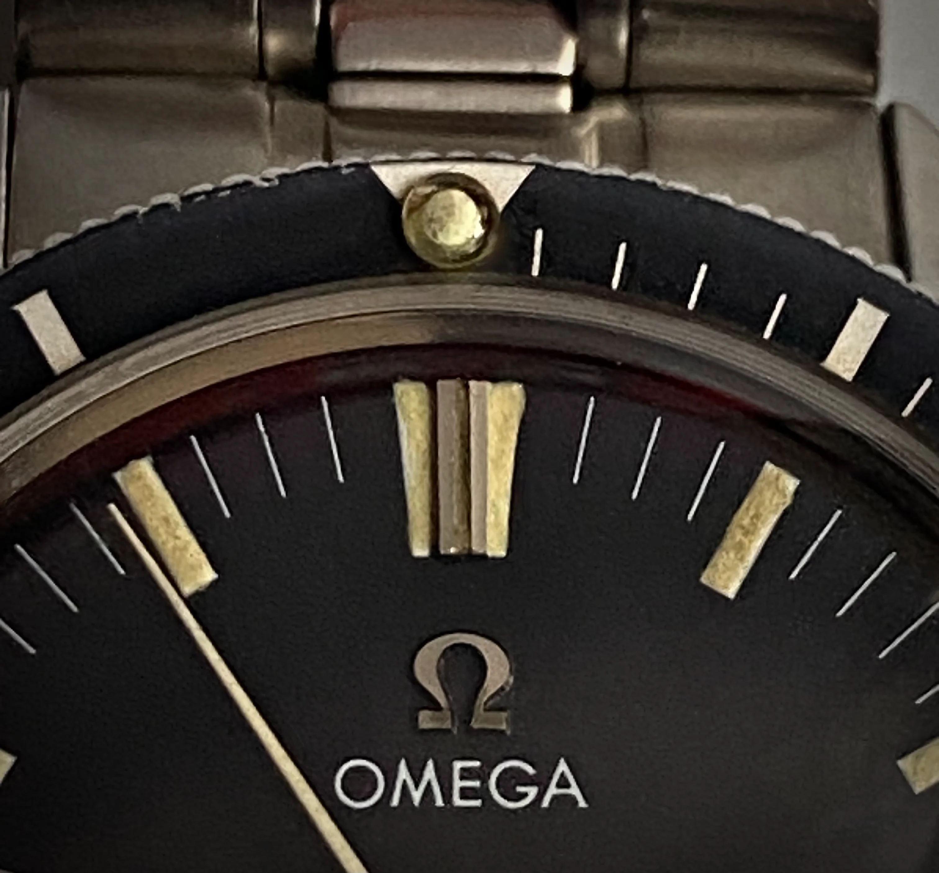

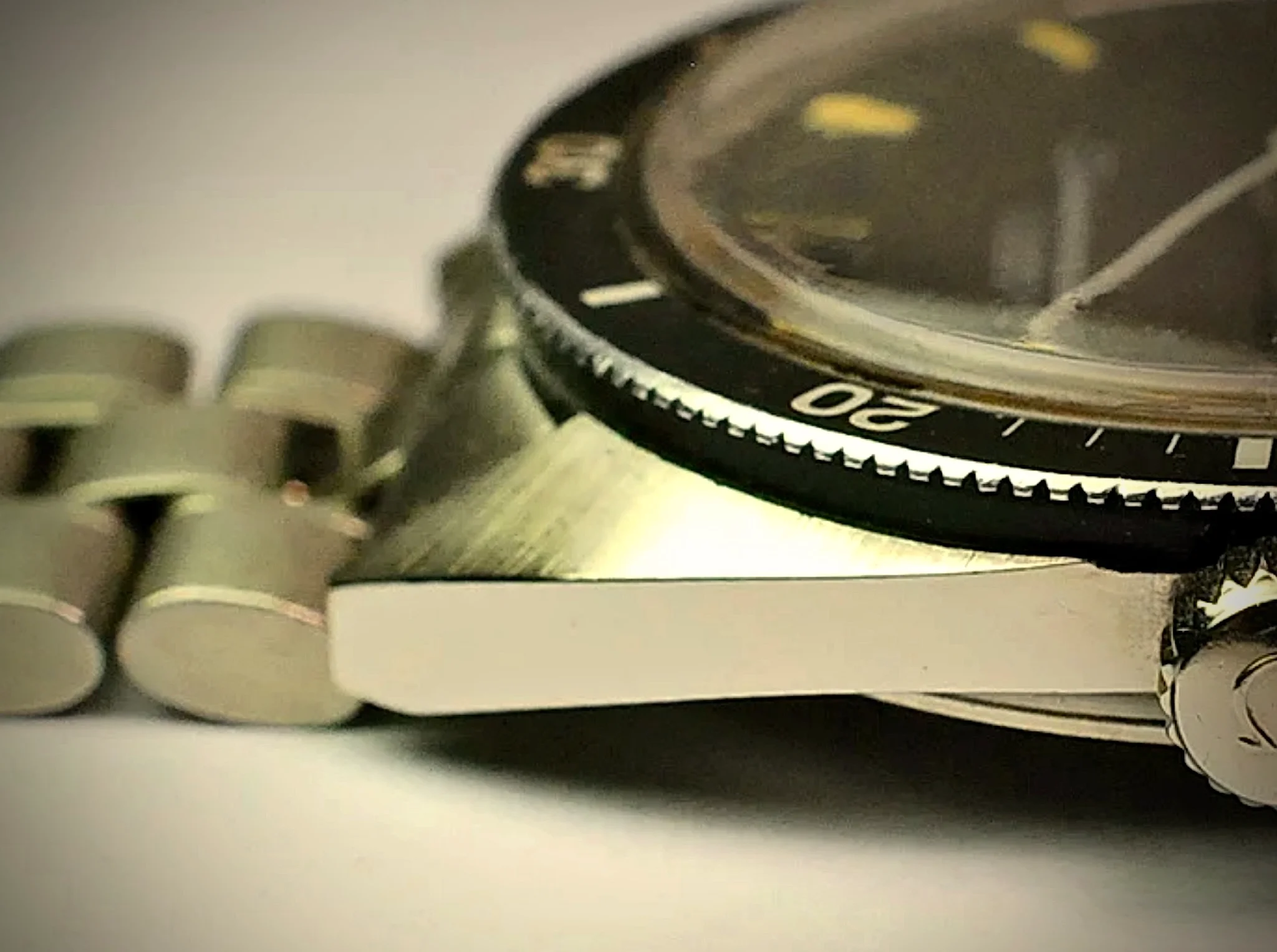

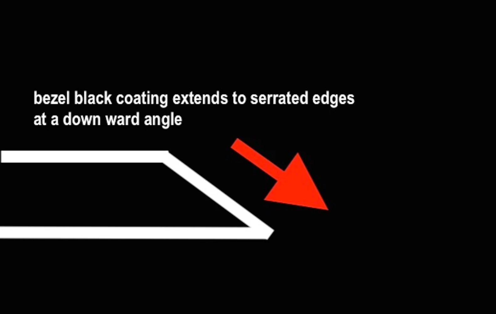

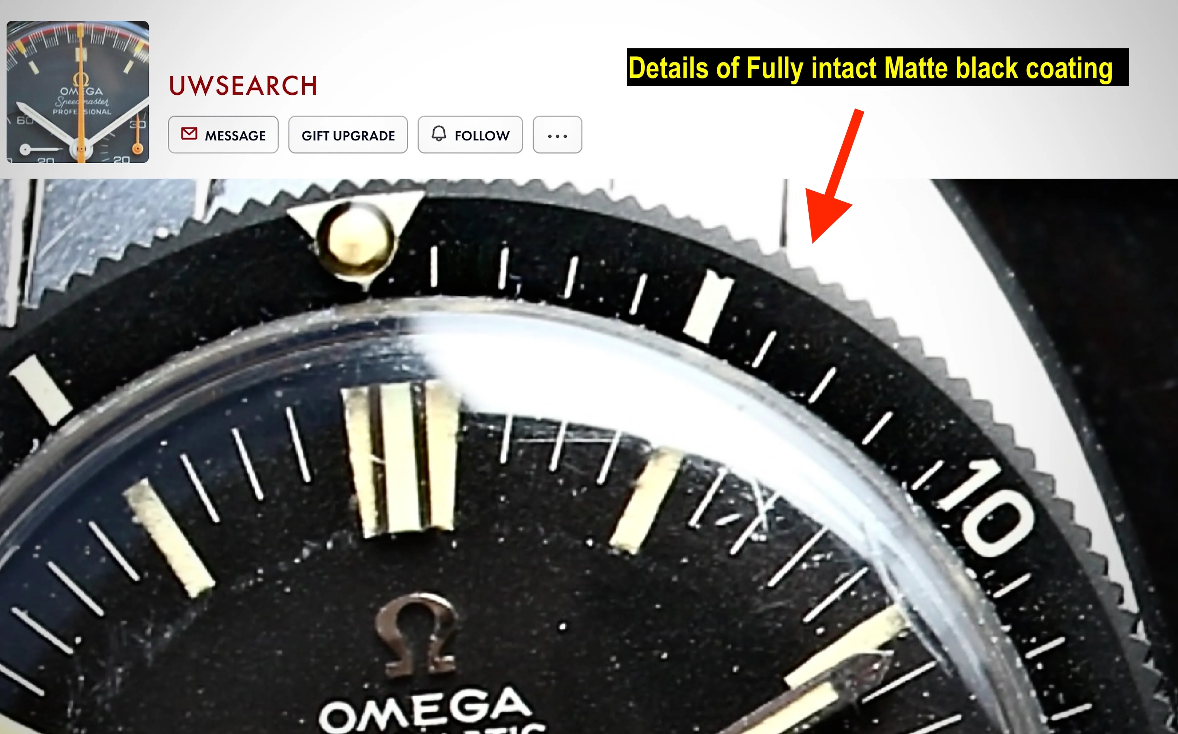

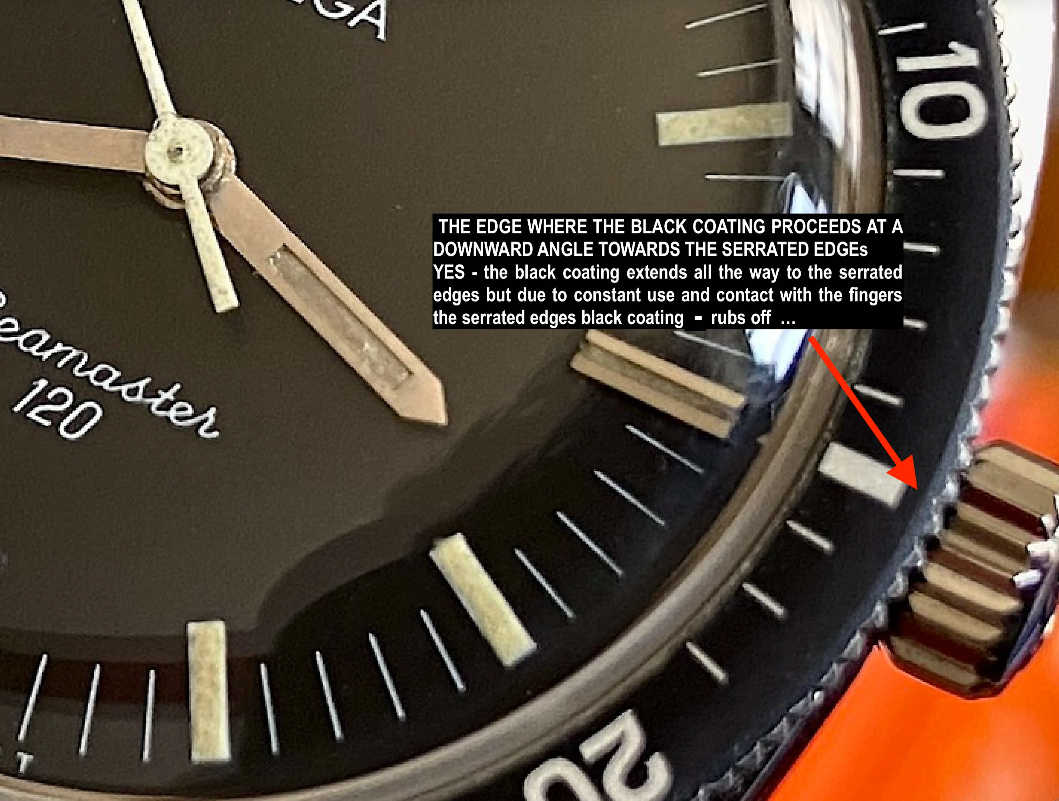

BEZEL surface when it was new was entirely black including the serrated edges ... The aluminum bezel inserts matte black coating stops short of of the edge and tapers at an angle to the serrated edges. Due to age and use most bezel will have this worn off exposing the metallic surface.
BEZEL WITH FULLY INTACT MATTE BLACK COATING
note the downward slope towards serrated edge
photo from - UWSEARCH

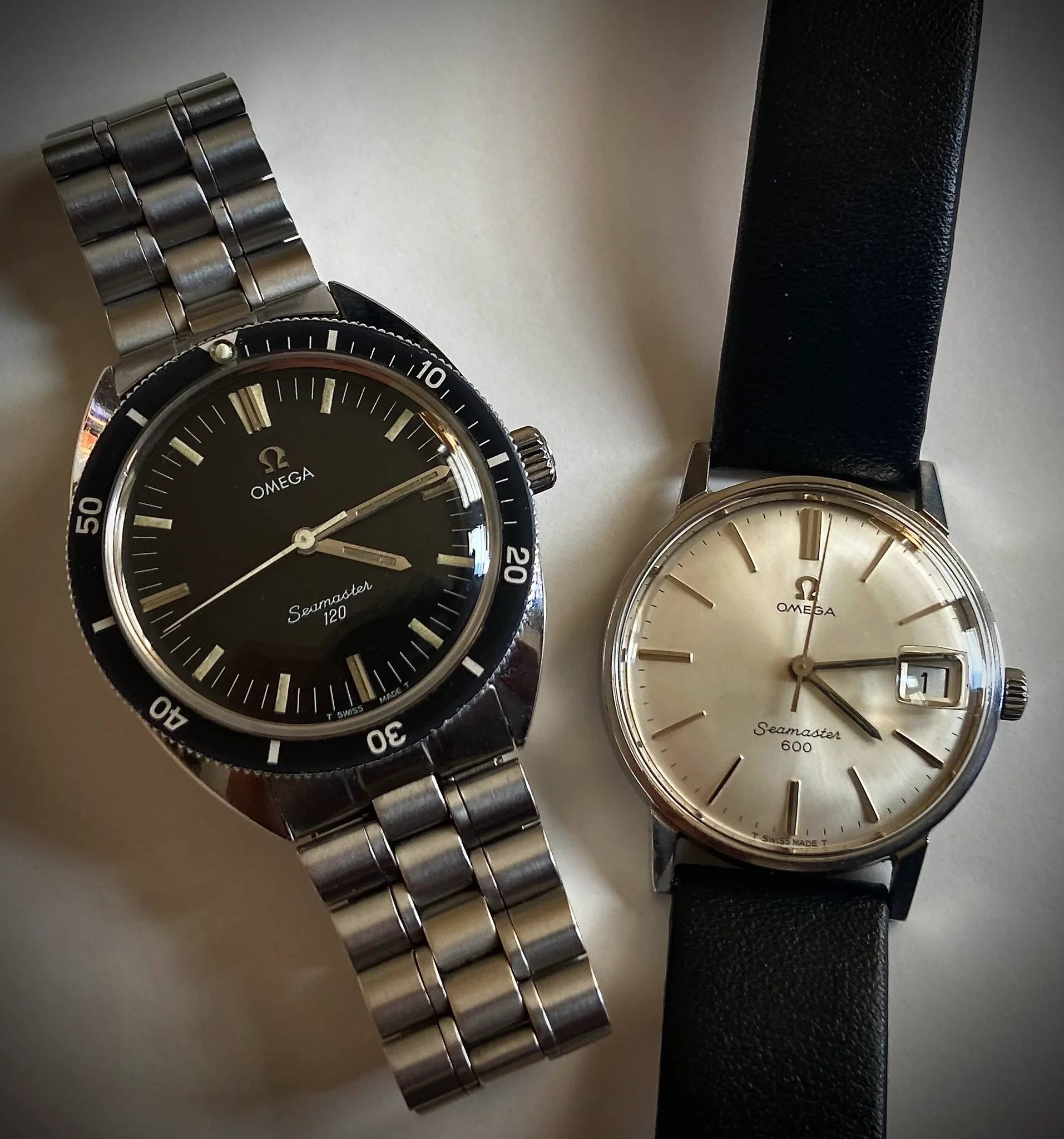

Original white second sweep pylon/baton length stops 1/4 (+/-) short of the edge of the dial markers. It's tip is slightly curved towards the dial. New or Factory replacement hands are longer.

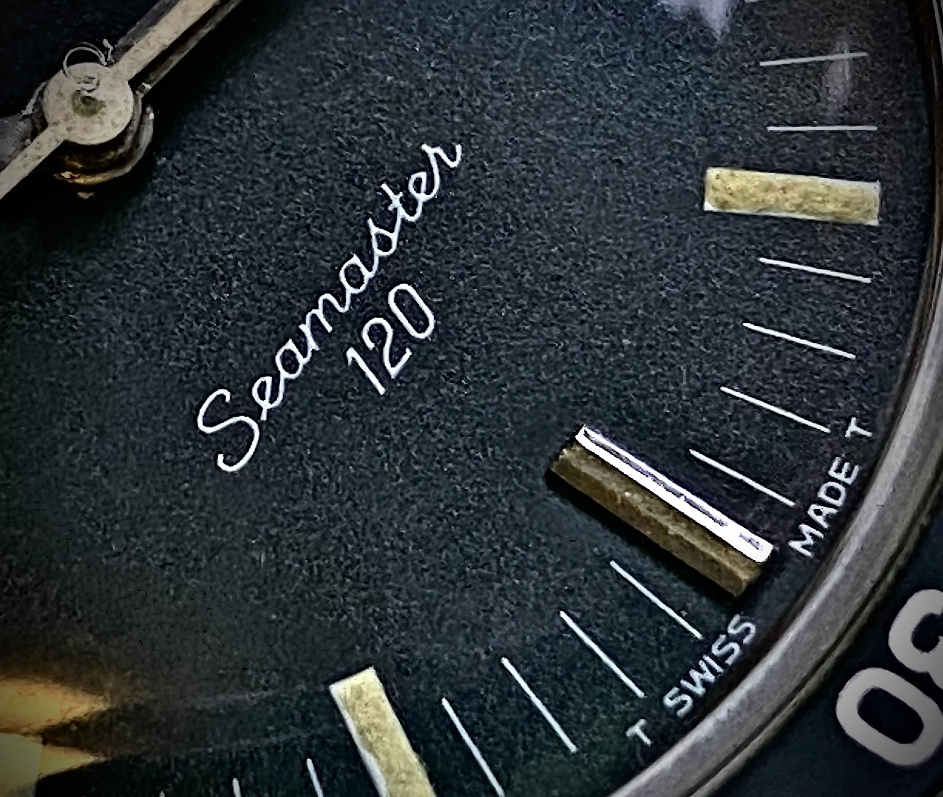

alongside a 1964 OMEGA SEAMASTER 600
16MM-19MM JB Champion USA expandable band aka: NASA bracelet on a 7 1/2 inch wrist

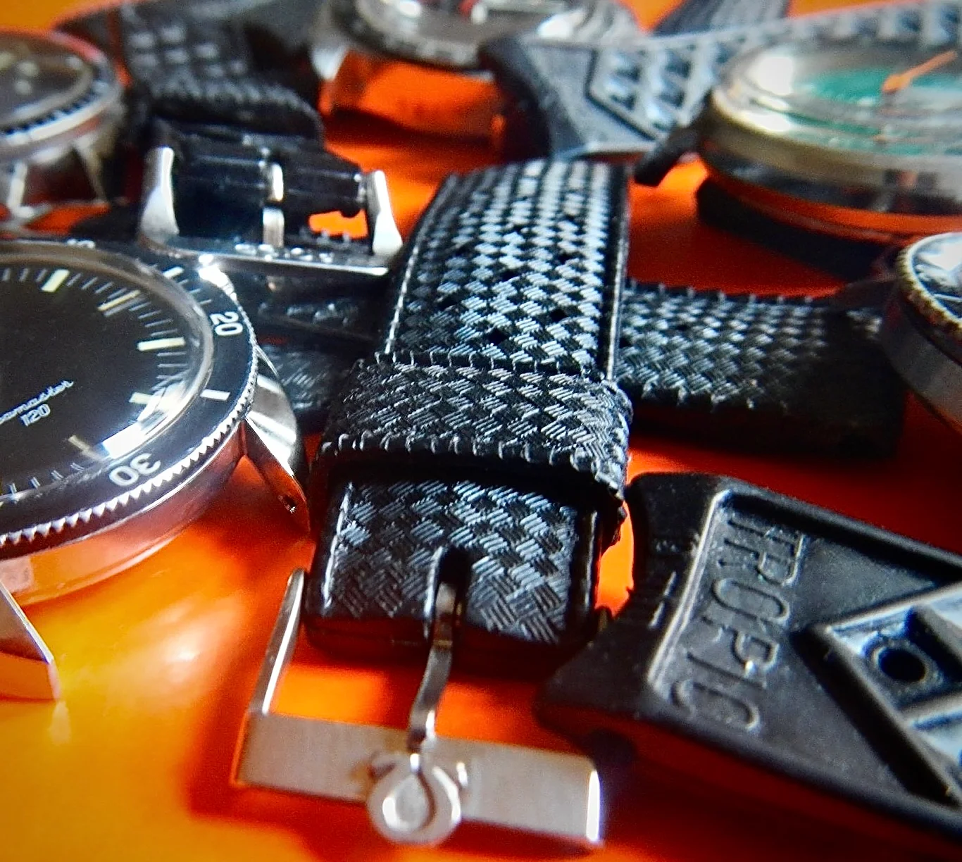

19MM BEST FIT Swiss Tropic MOD DEP diver strap

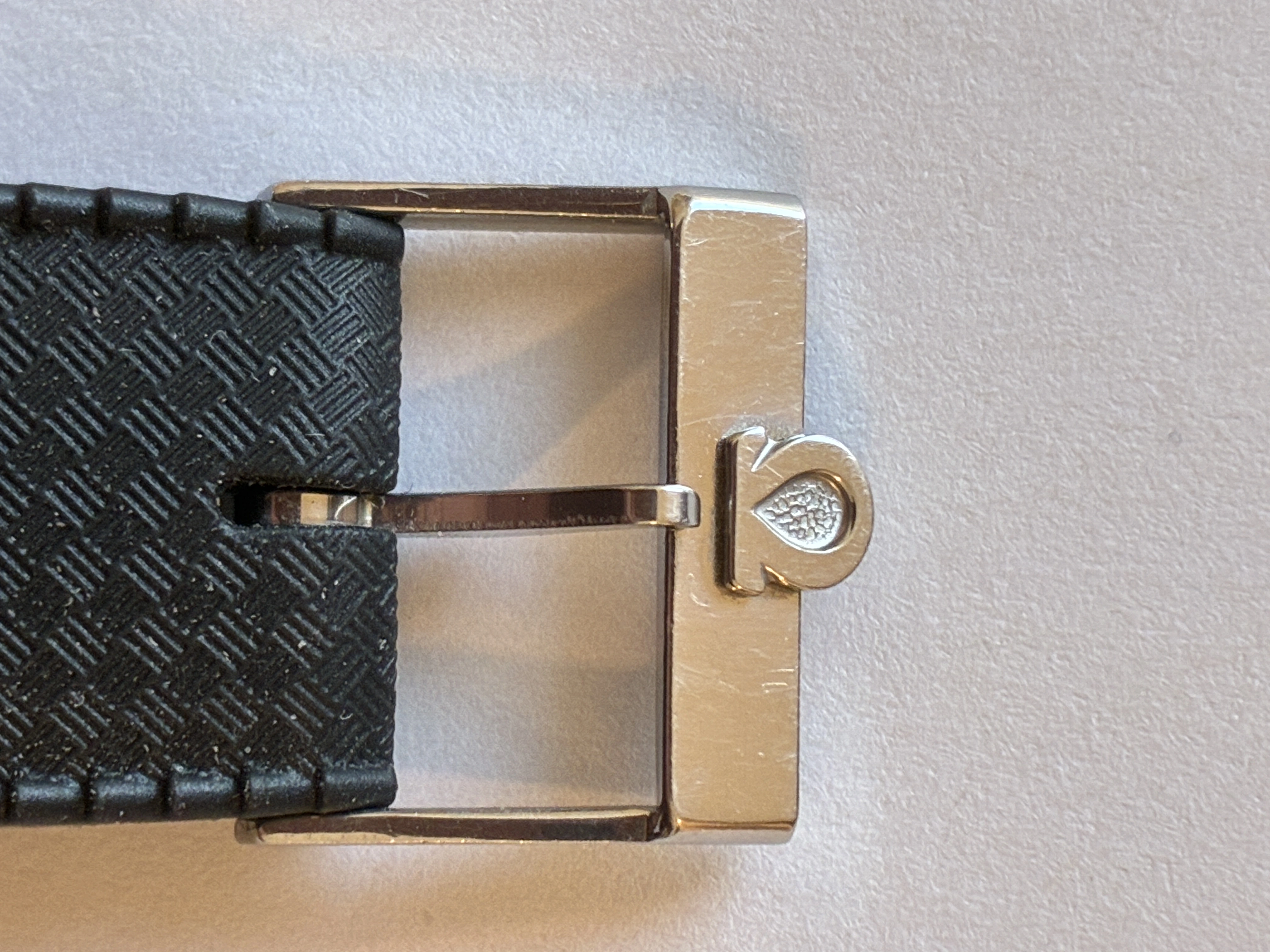

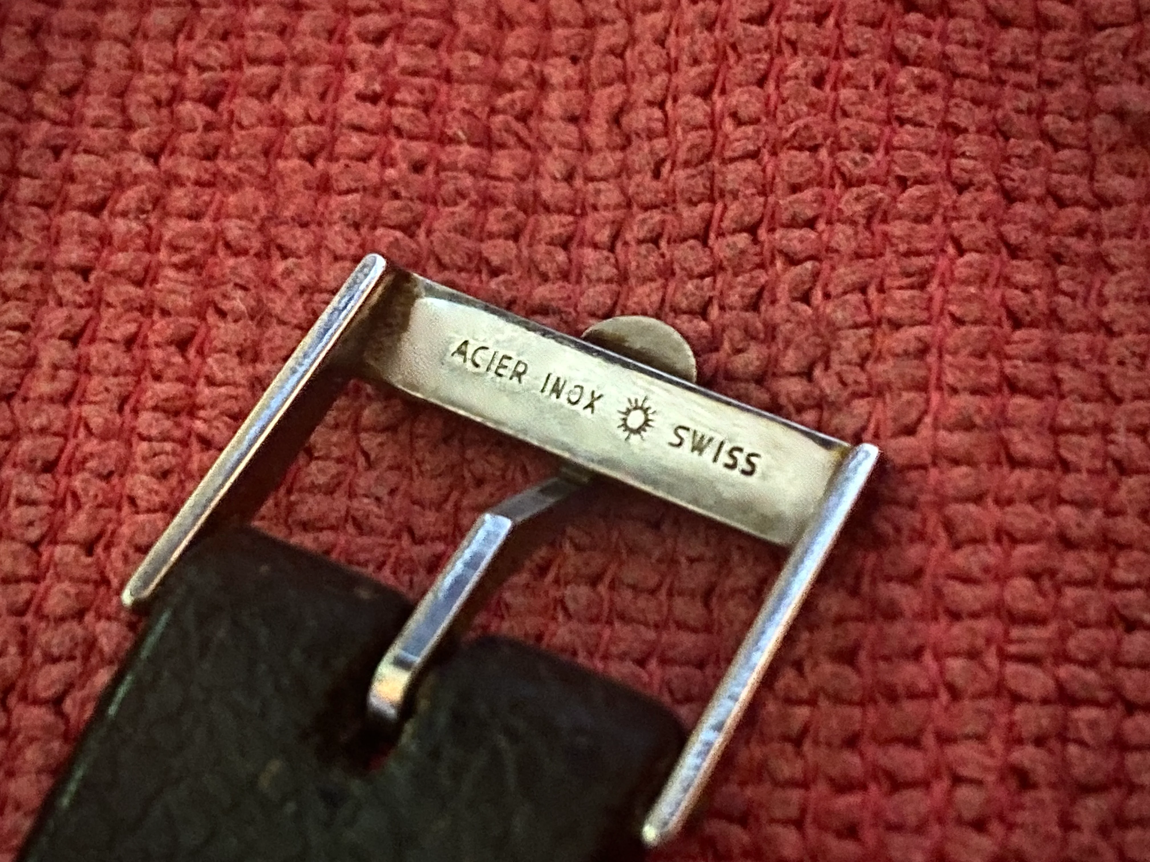

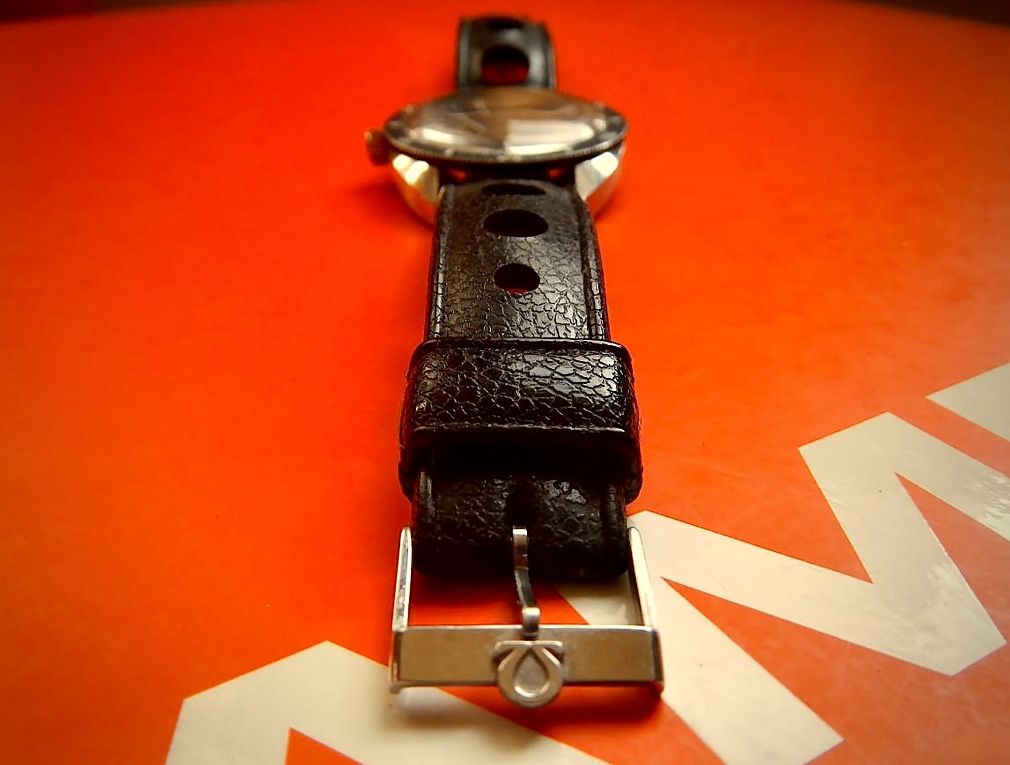

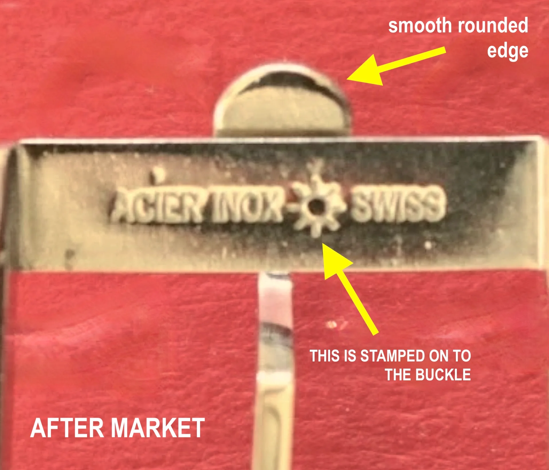

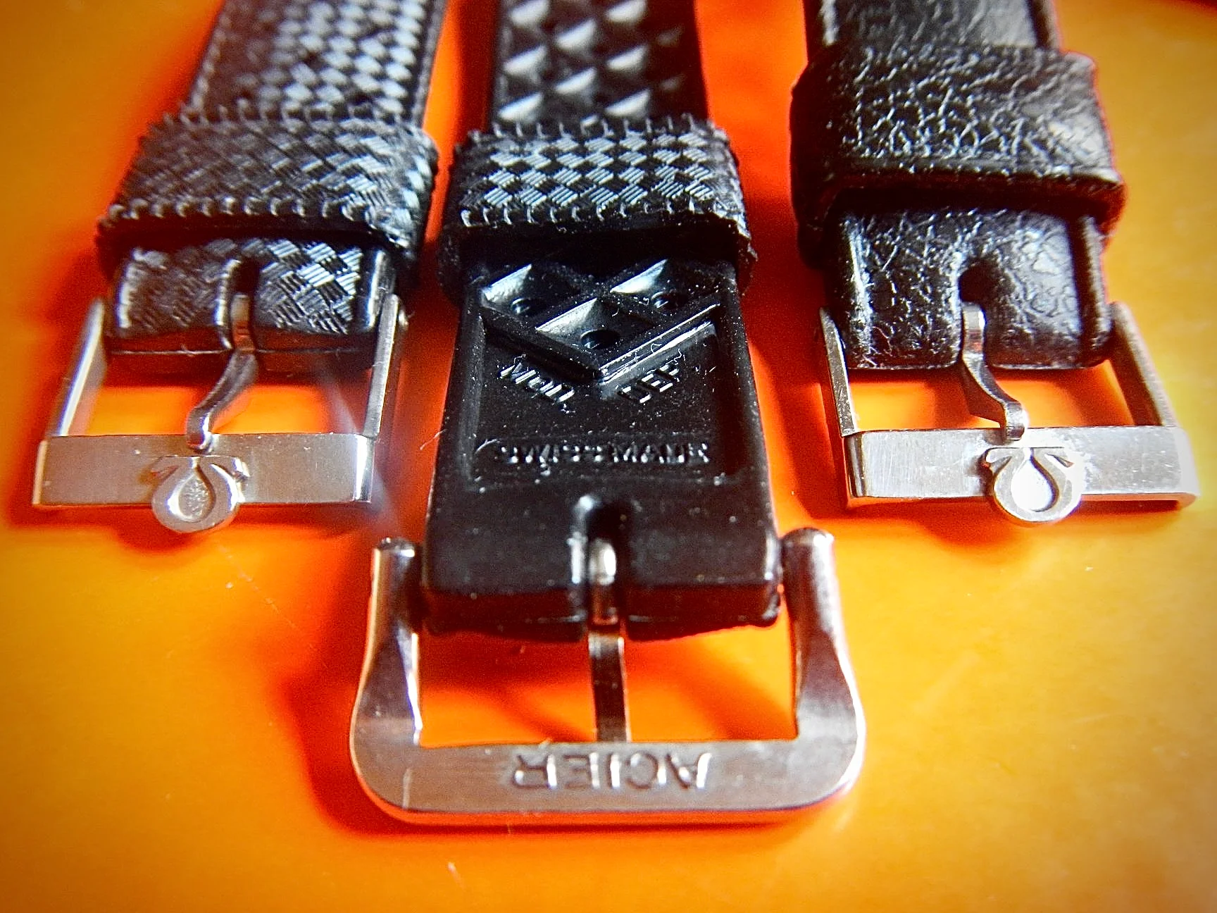

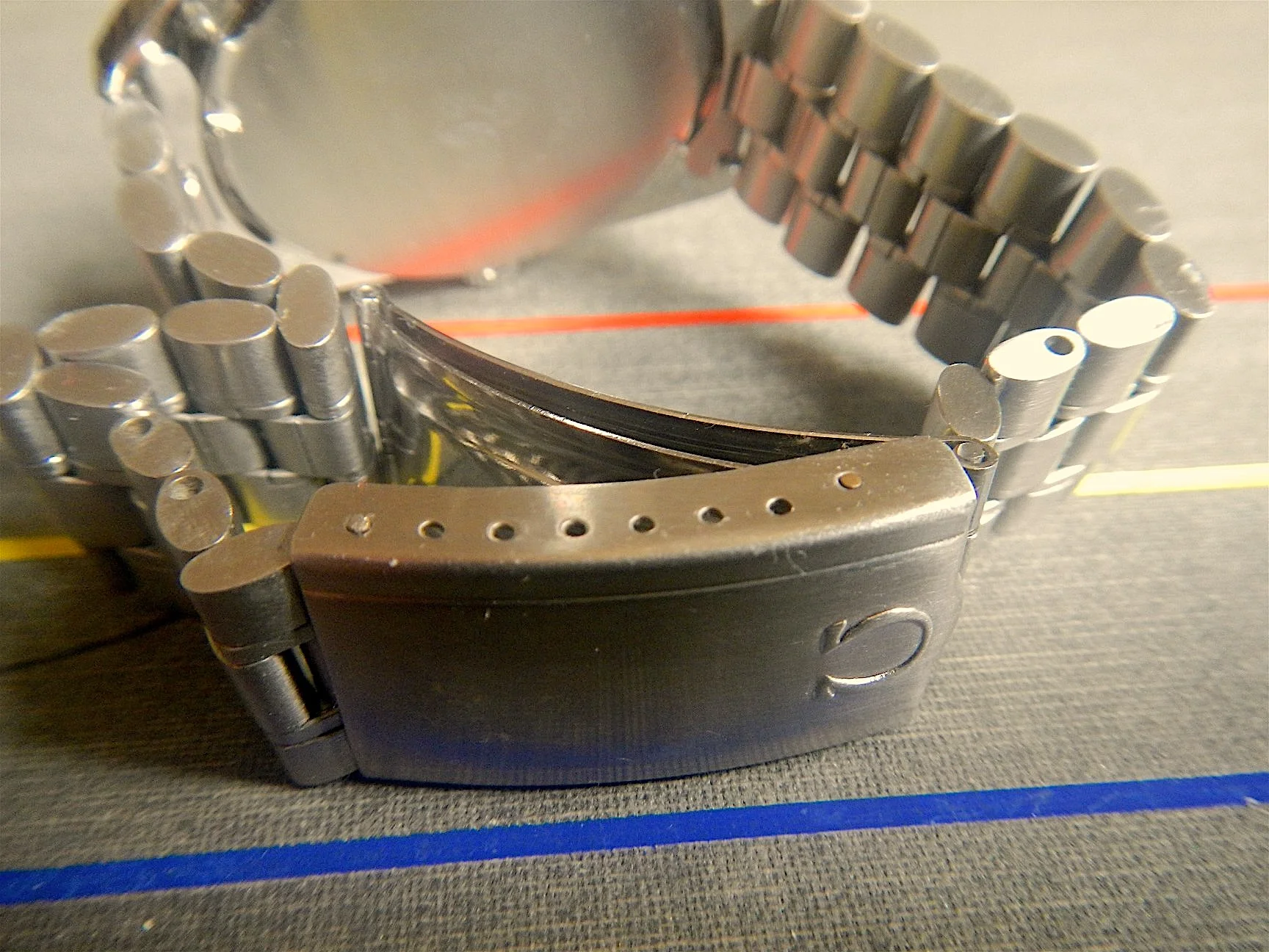

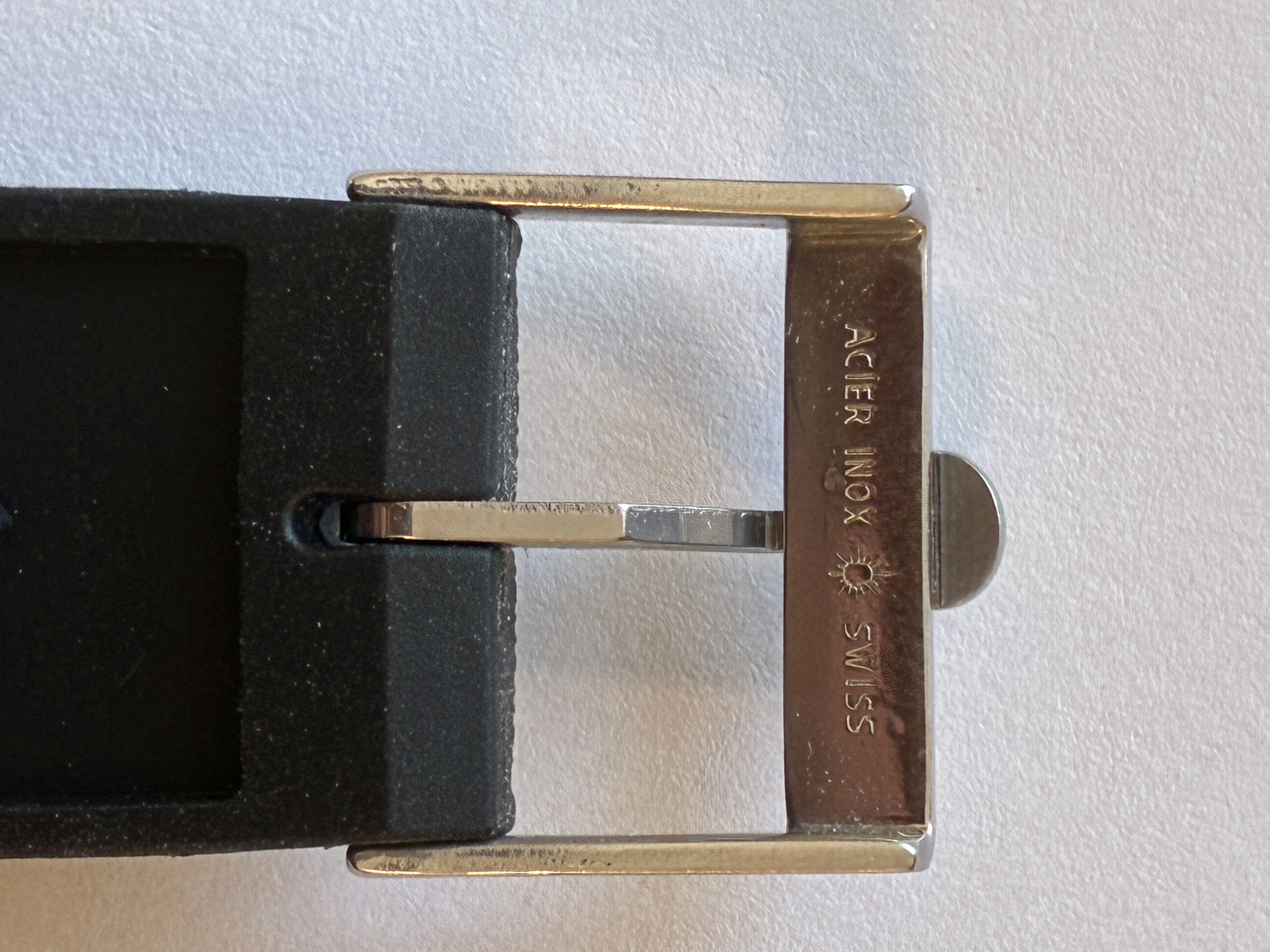

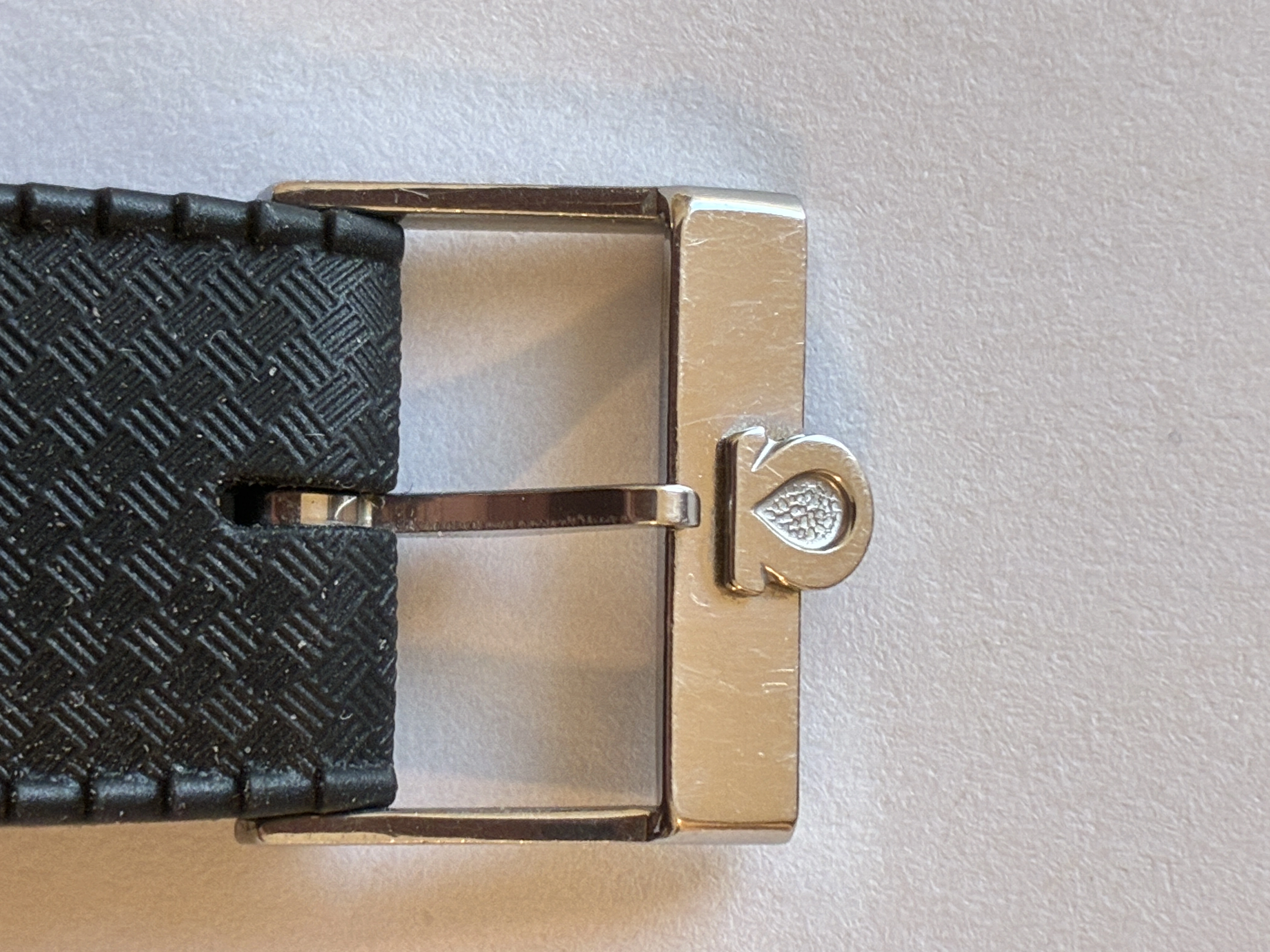

VINTAGE BUCKLES from the 1960's and 1970's
OEM Omega buckles
that would have been paired with vintage (on the left) Best Fit SWISS TROPIC MOD DEP diver strap and on a (on the right) vintage TROPIC STAR diver strap, these would also have been used on Omega smooth or textured CORFAM straps.
The LOGO HAS SHARP DEFINED EDGES which has slight raised textured surface inside
again ... IT's edges are NOT SMOOTH and ROUNDED
Details on buckle are NOT HAND or MACHINE STAMPED
it is hand etched unto the buckle.
The LOGO HAS SHARP DEFINED EDGES not smooth and rounded

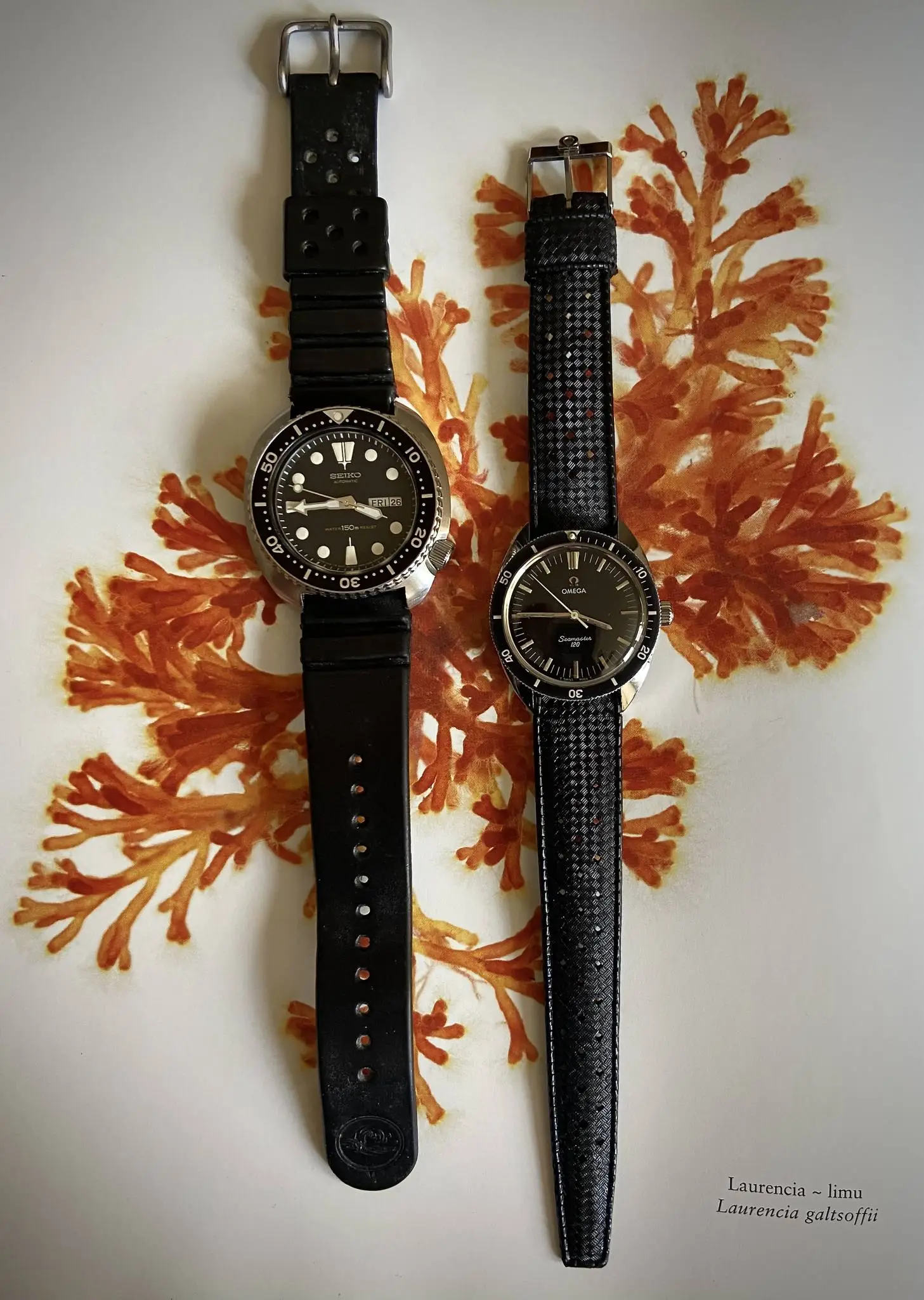

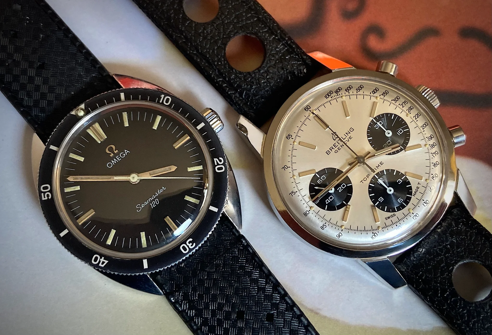

along side a 1968 BREITLING GENEVE TOP TIME MK2 mvmnt. Venus caliber 178 (WOG)
along side a 1973 BULOVA DEEP SEA 666FEET DIVER CHRONOGRAPHE variant B
along side a SEIKO caliber 6309 case ref.# 7049 aka: Turtle
along side a 1966 HAMILTON 600FEET Aqua Date

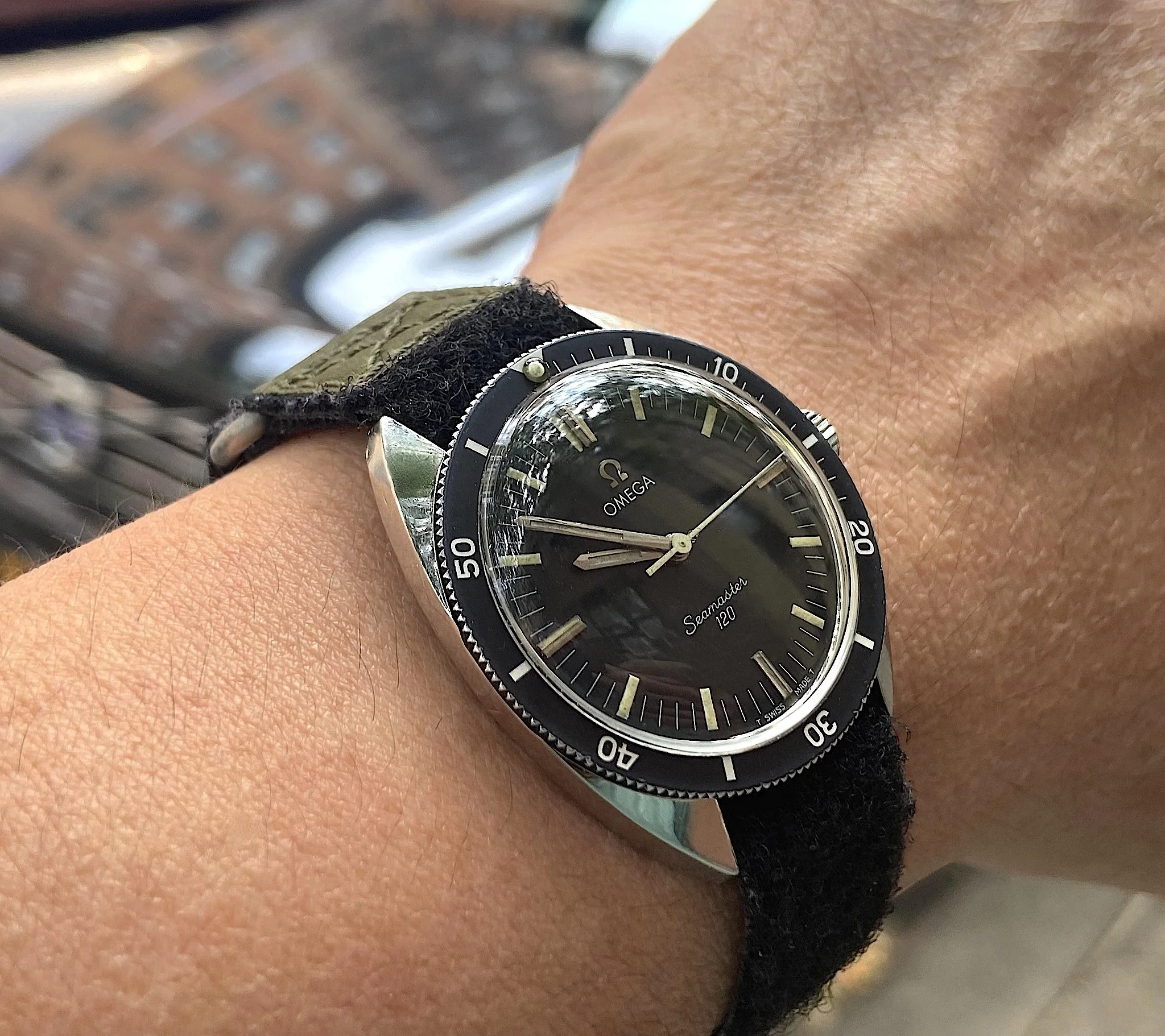

19MM UNCLE SEIKO version of a Seiko XGL-731 diver strap aka: Tire Tread strap

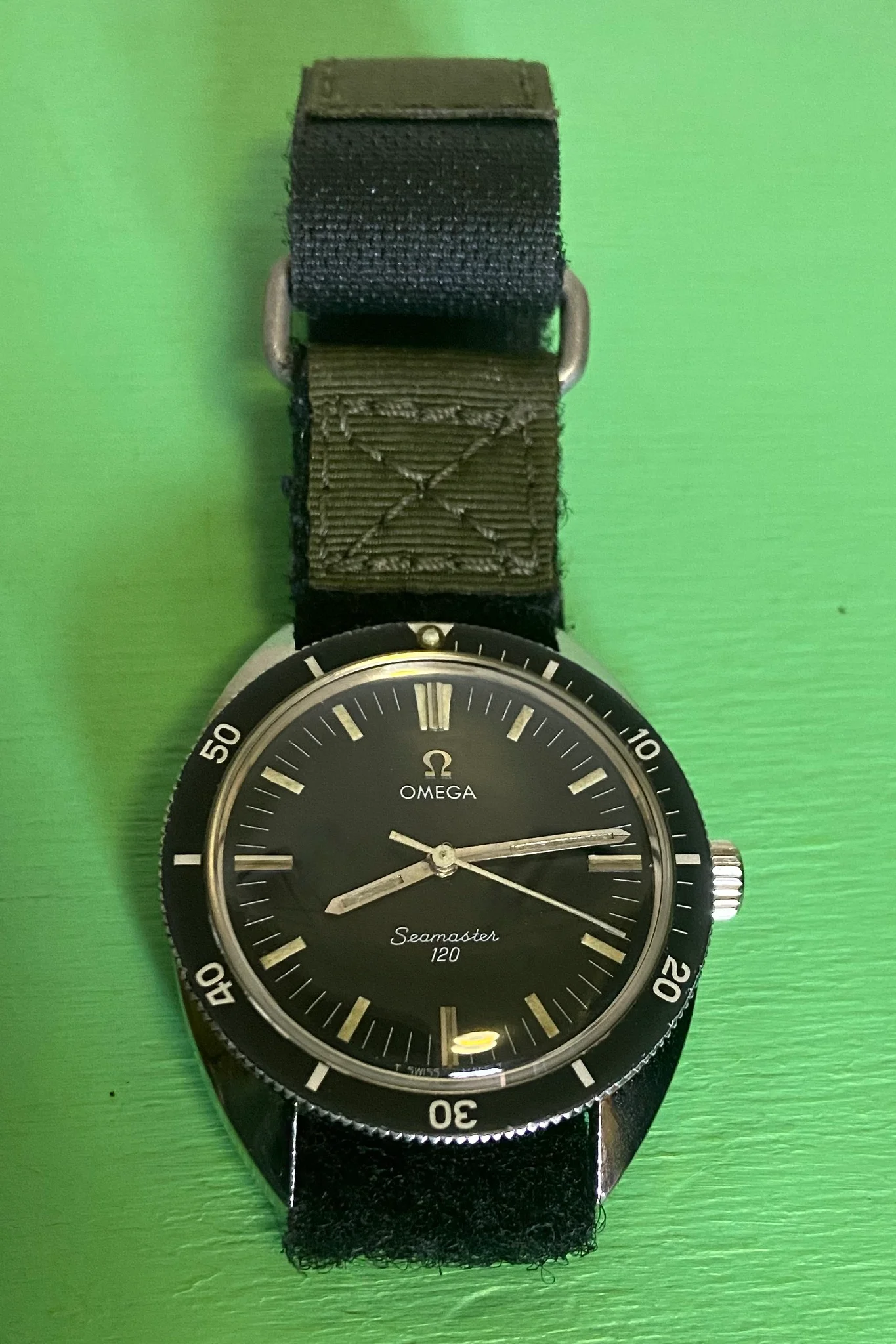

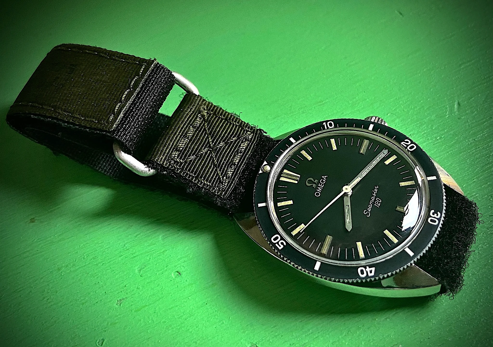

Paired with a KIZI Hook and Loop (velcro) strap

Watches are paired with 0ST-1098 SS bracelet with 19MM ref.# 547 end links

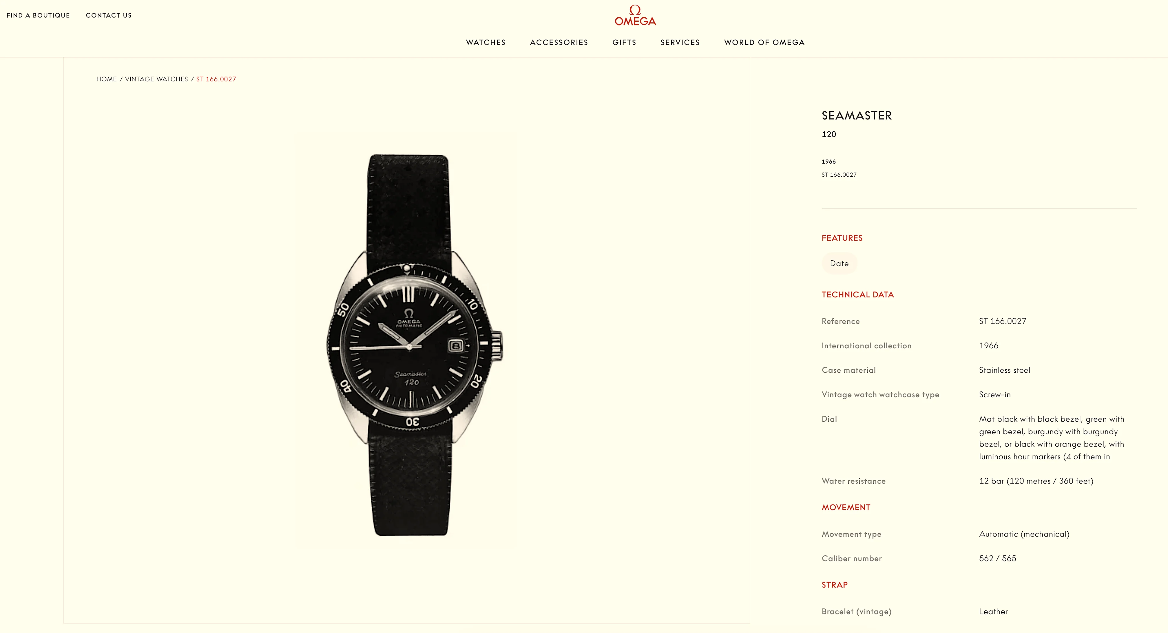

OFFICIAL OMEGA WEBSITE
1966 SEAMASTER 120 automatic with date
dive depth rated @ 120 Meters (393.7FEET static)

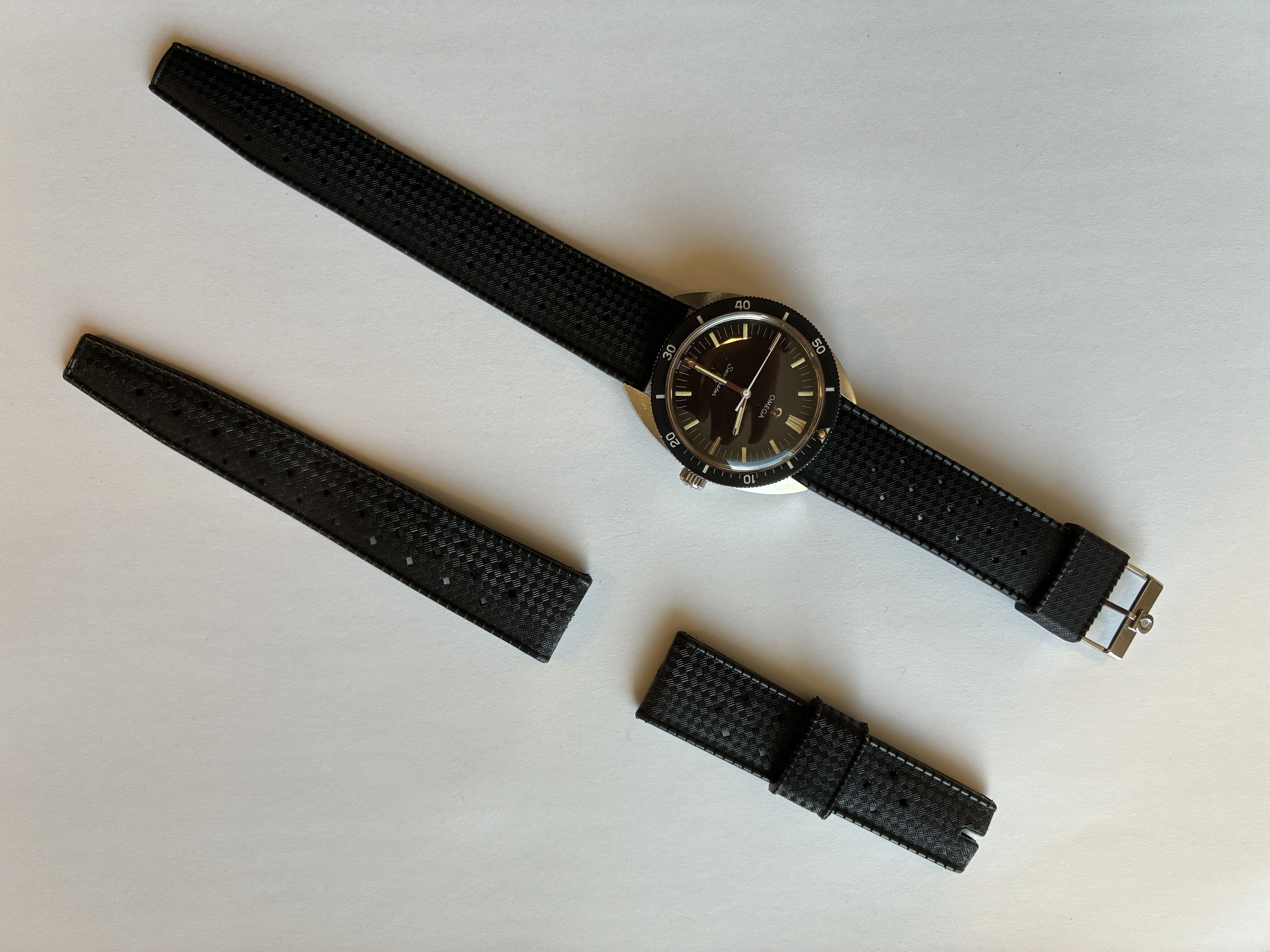

OMEGA CORFAM straps both textured and Smooth

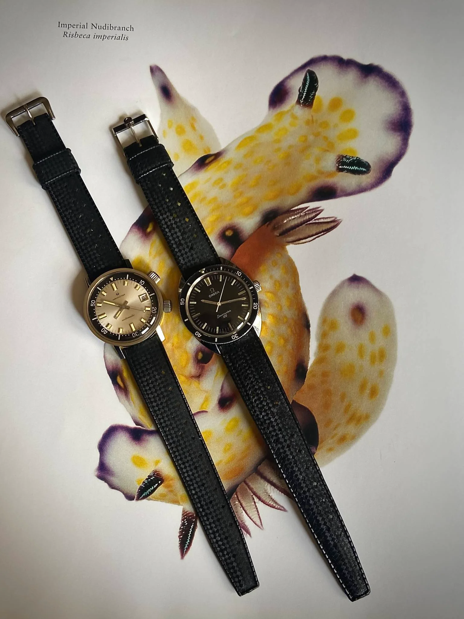

Ladies version with a Green bezel

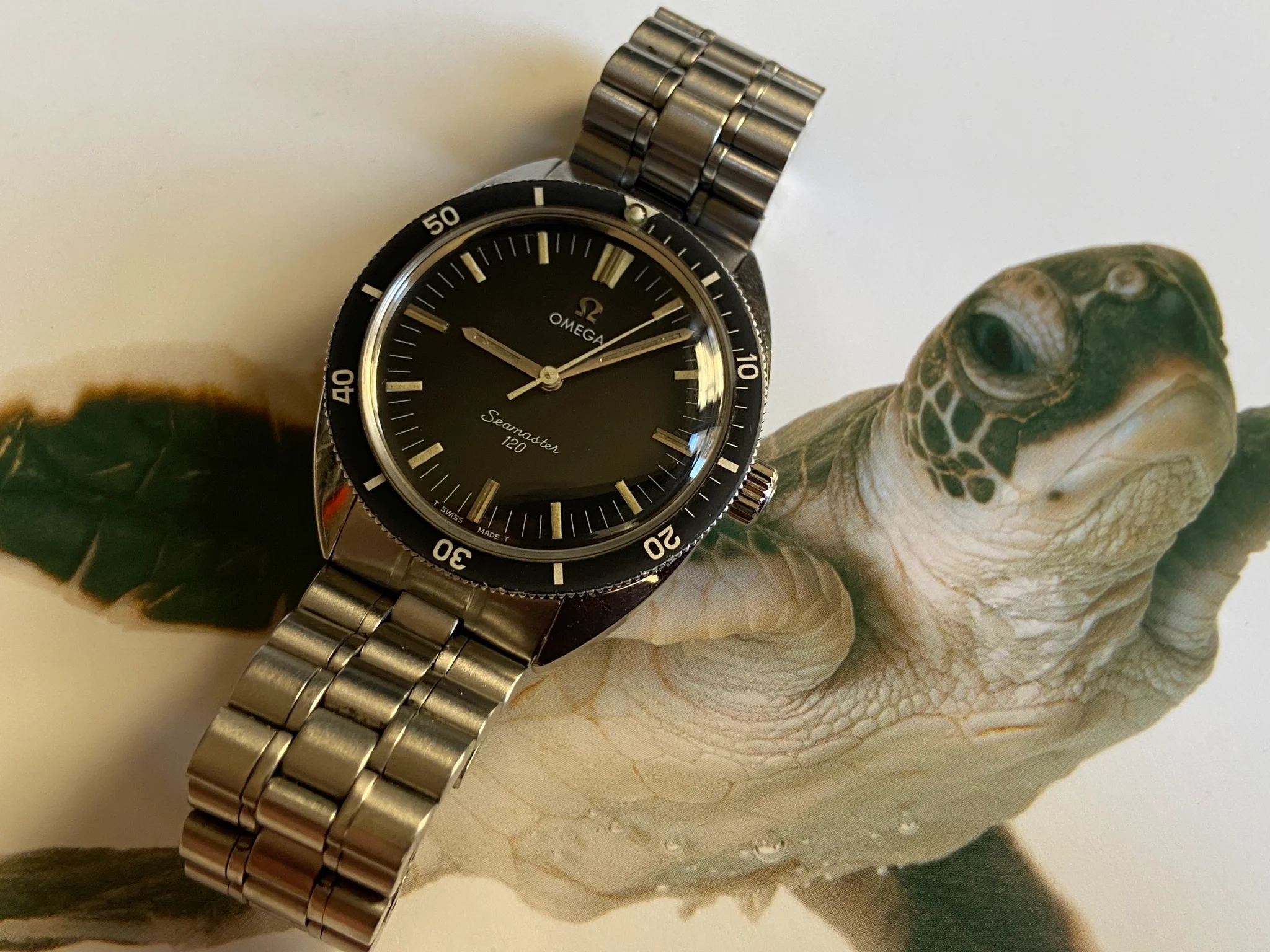

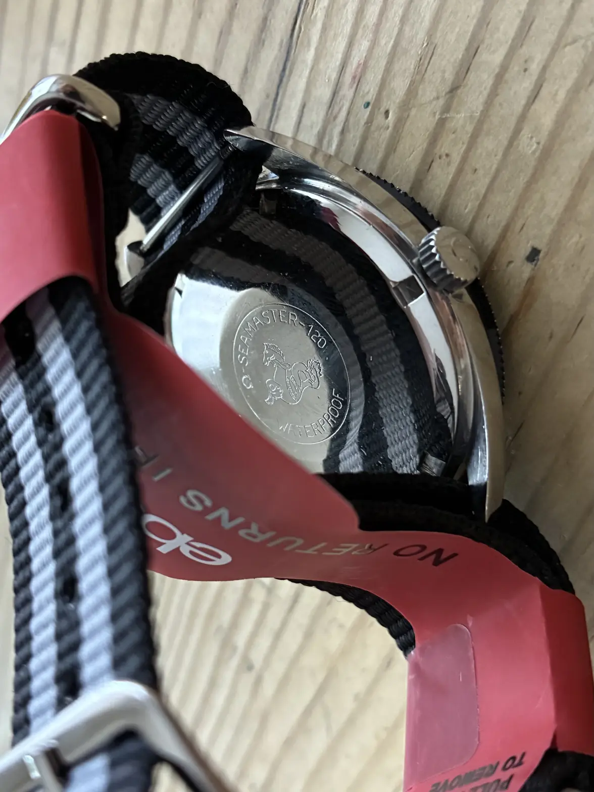

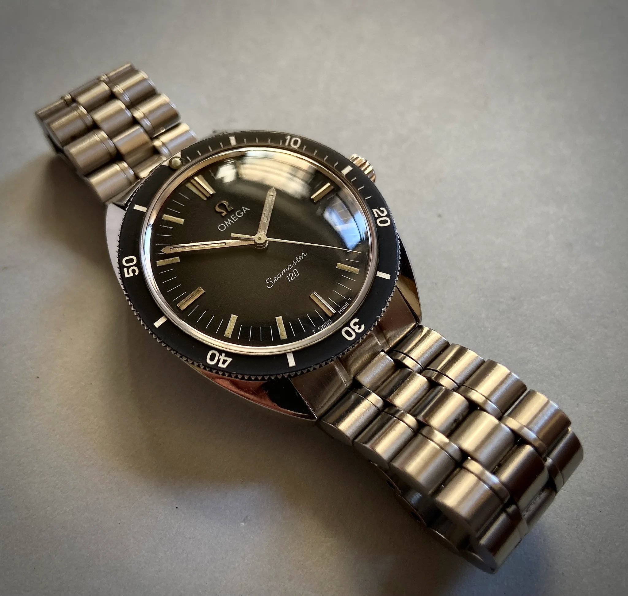

OMEGA Seamaster 120 Skin Diver Case Ref.# - O026ST-135.027
mvmnt. Omega manual wind caliber 601 no date complication.

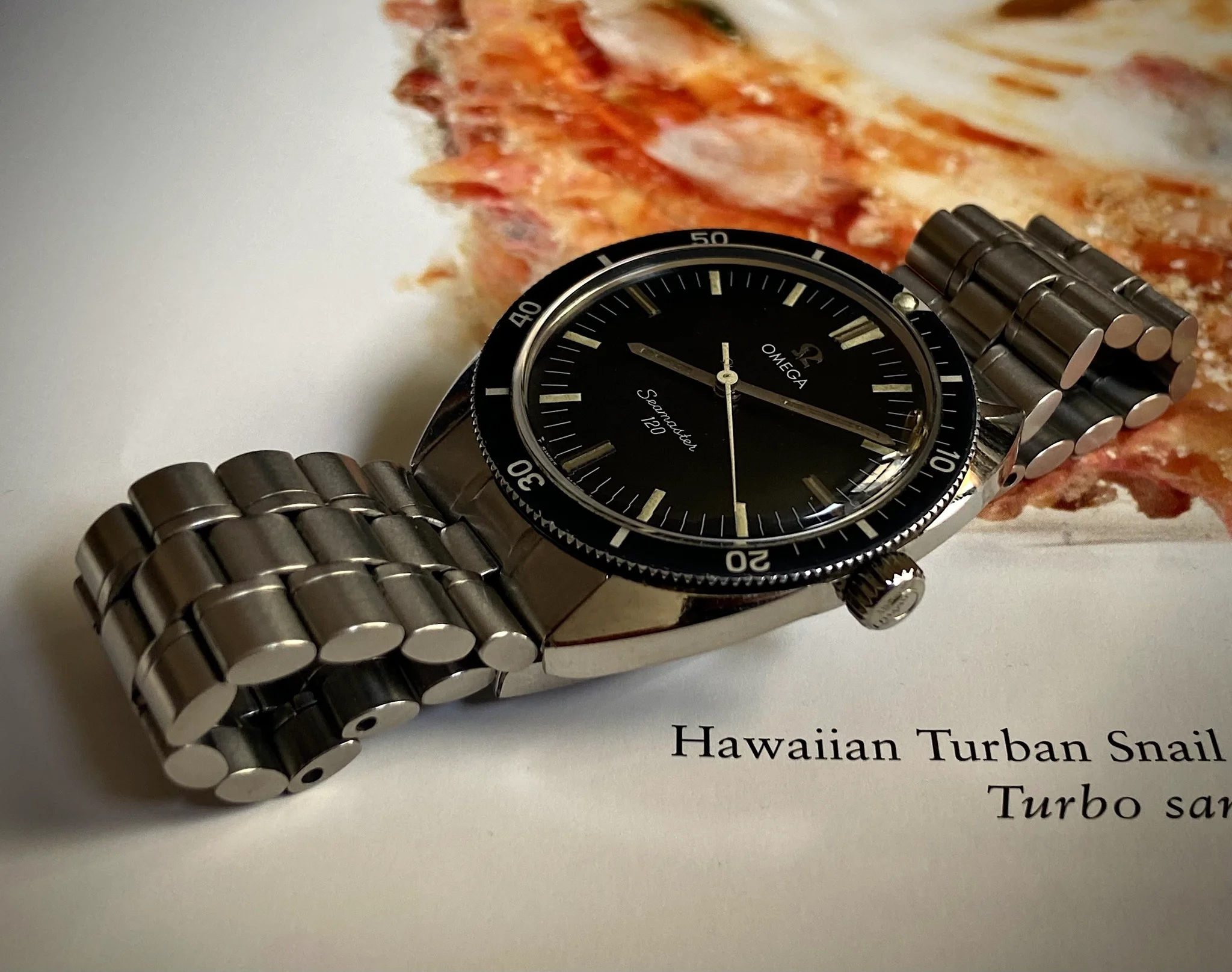

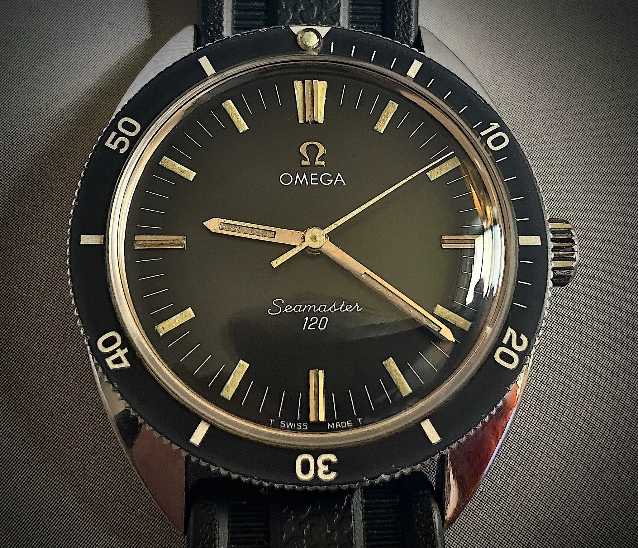

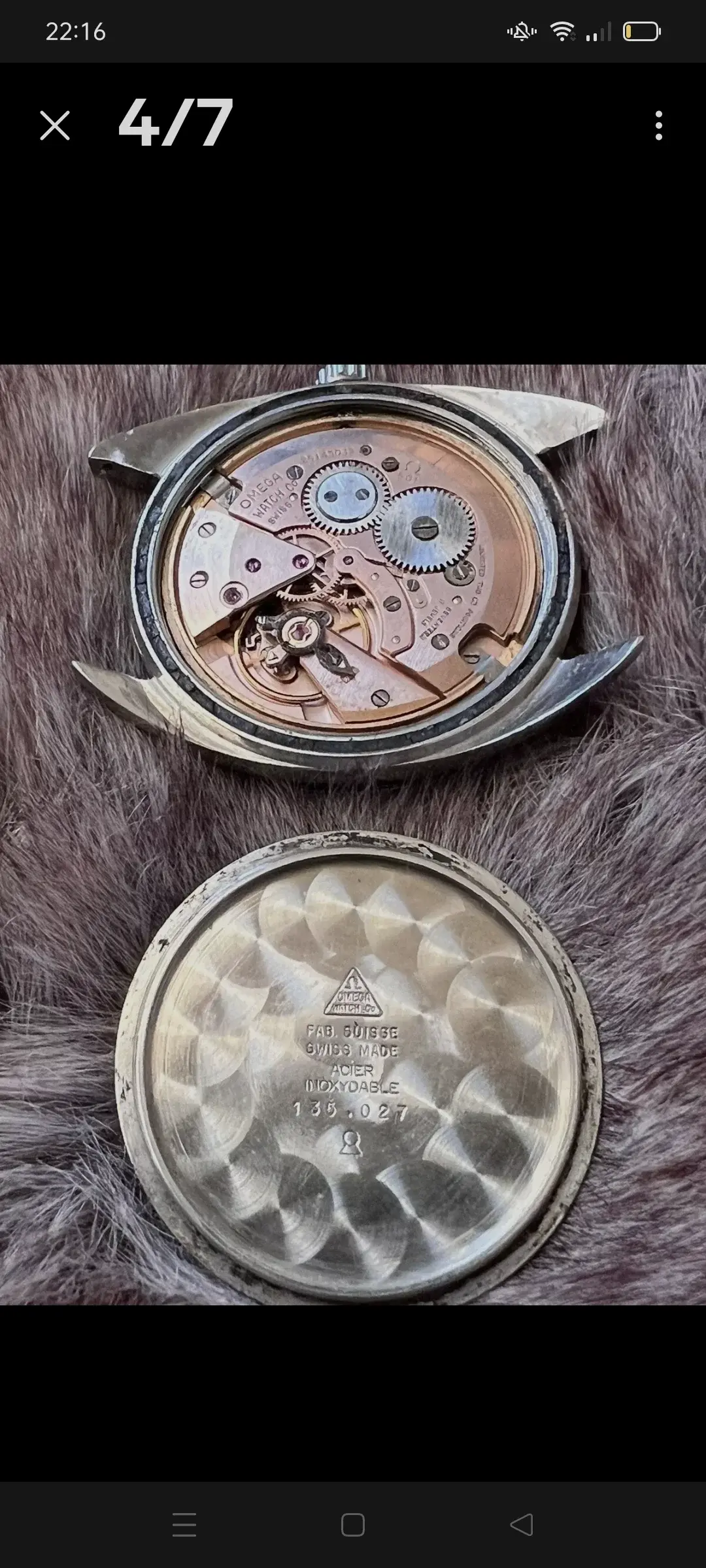

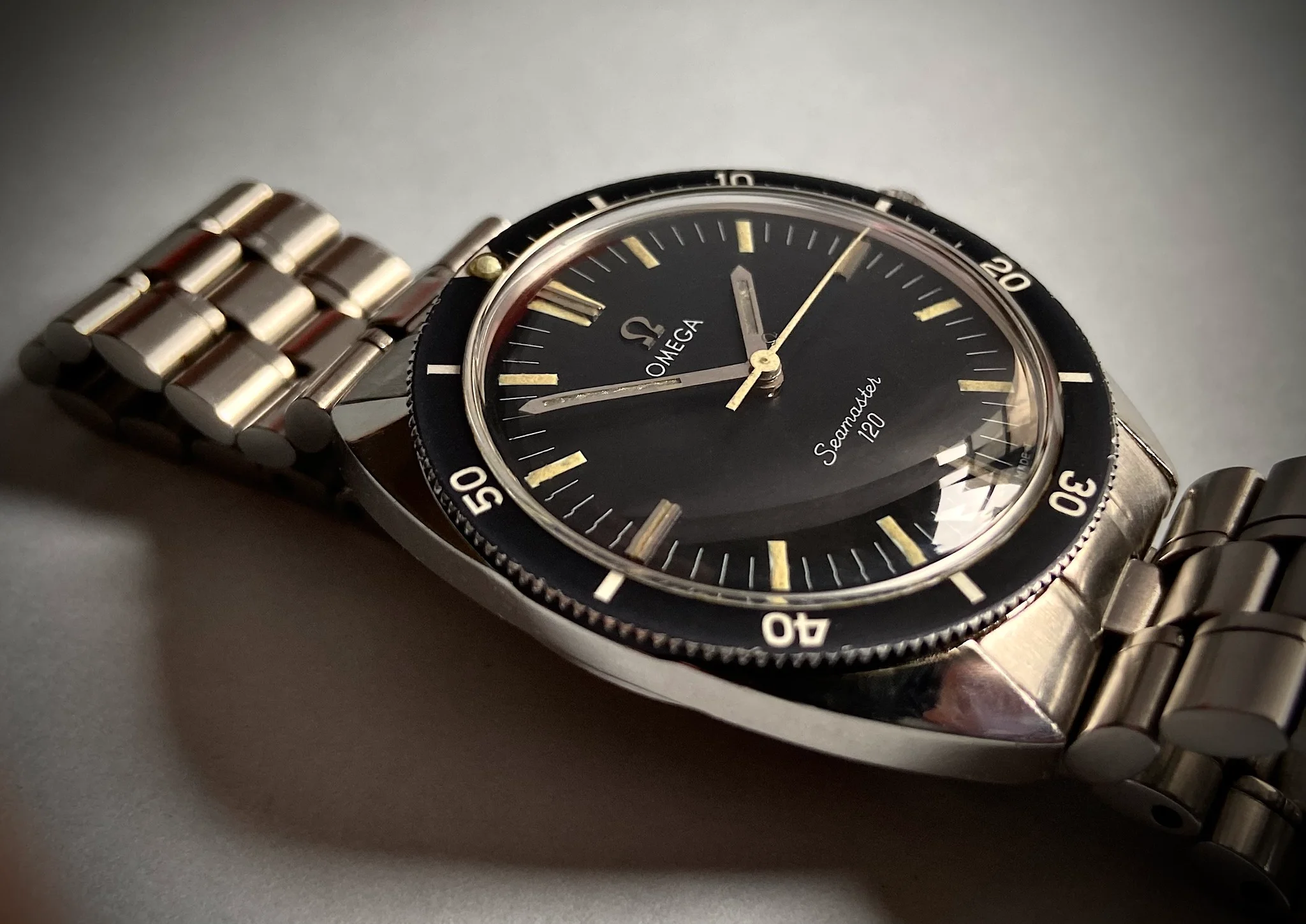

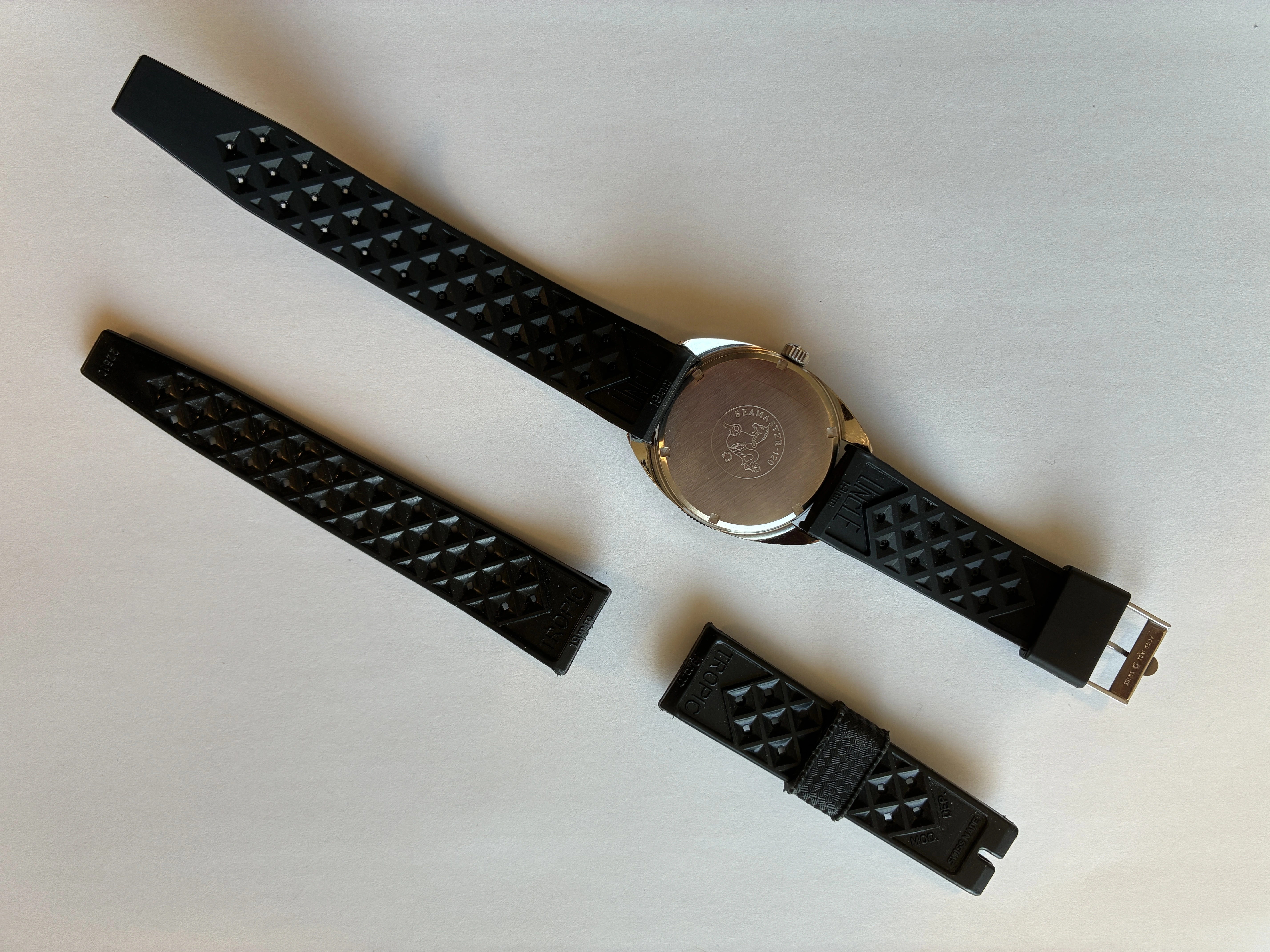

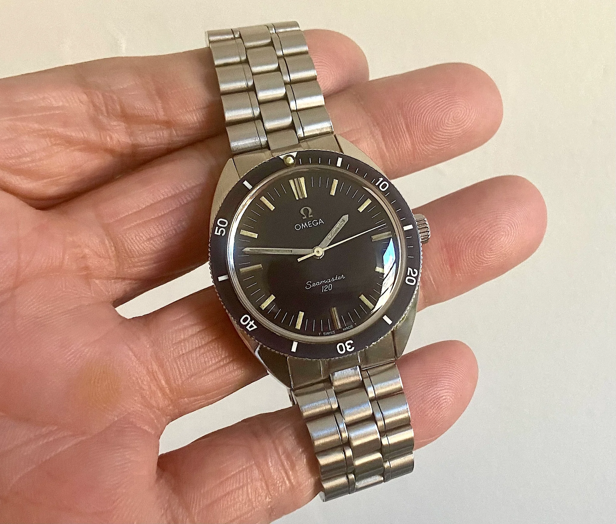

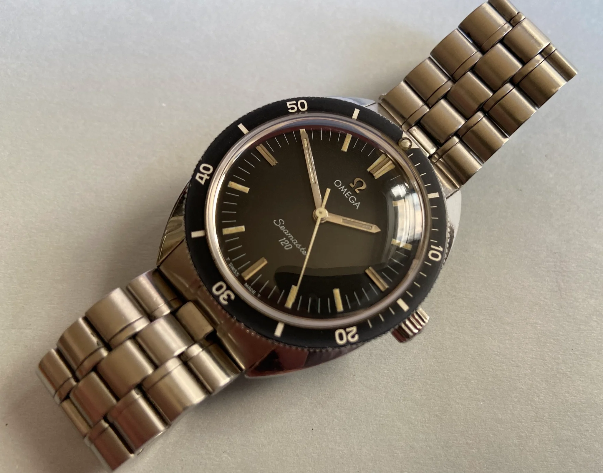

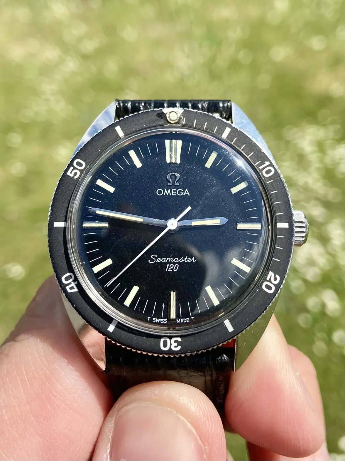

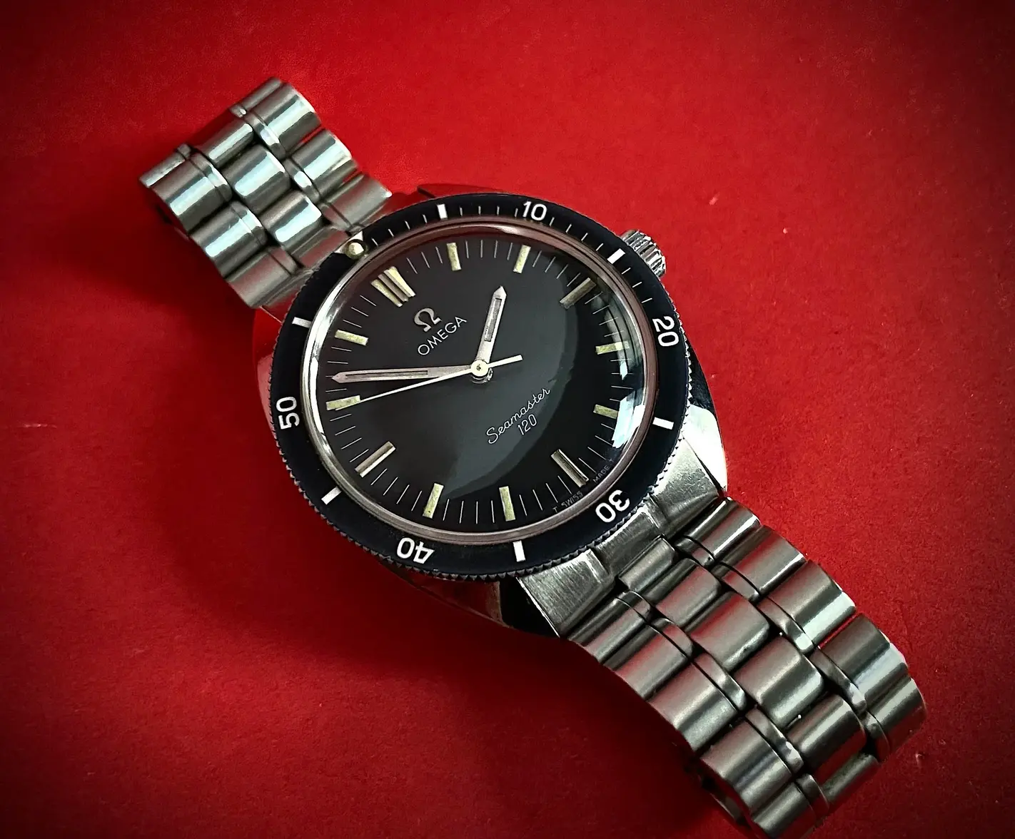

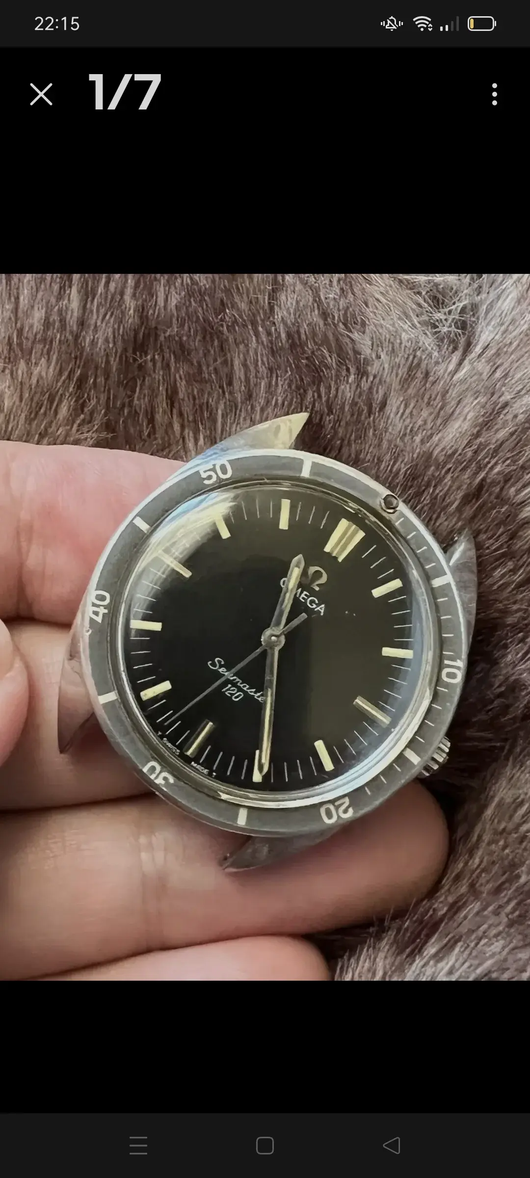

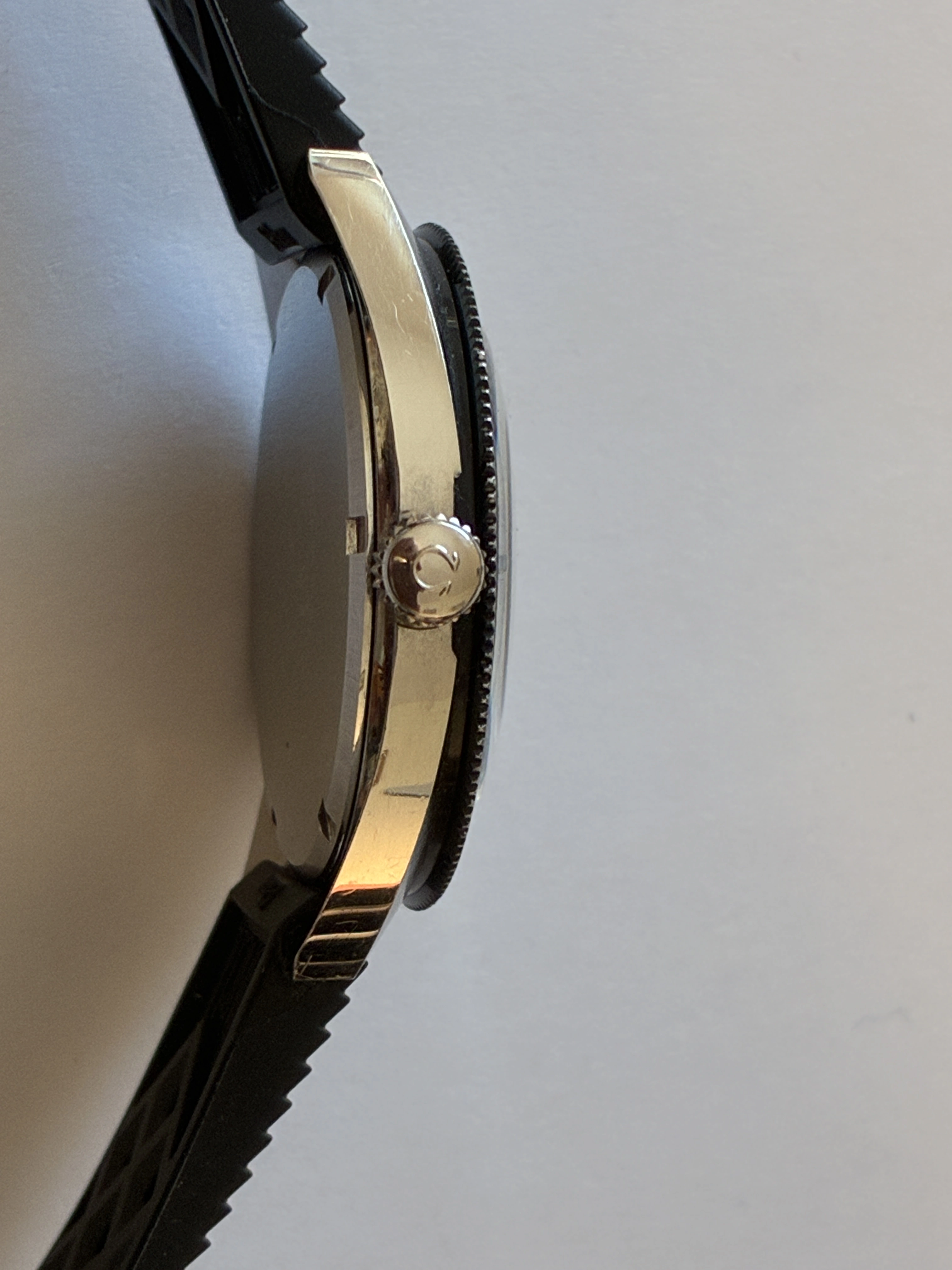

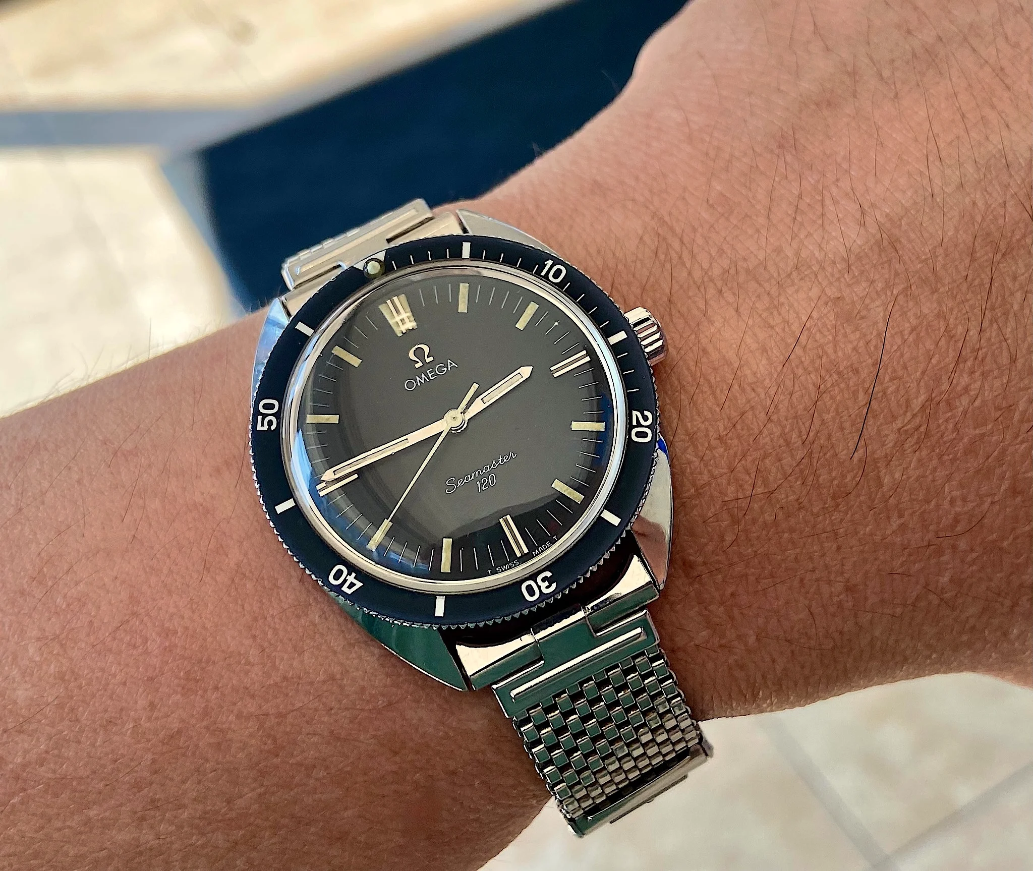

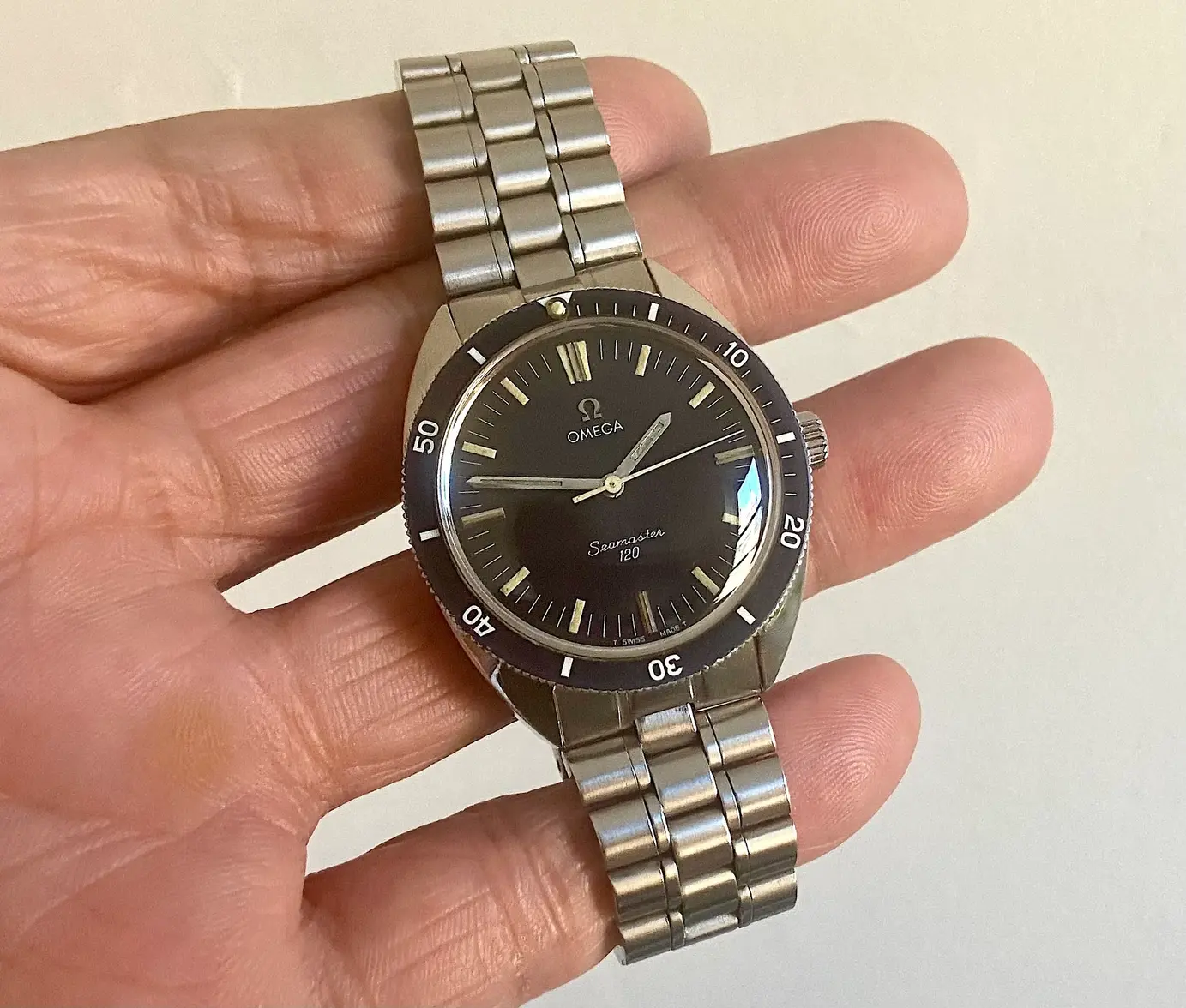

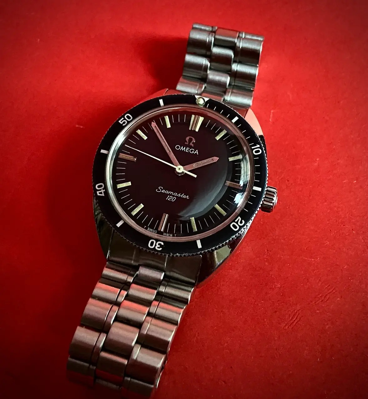

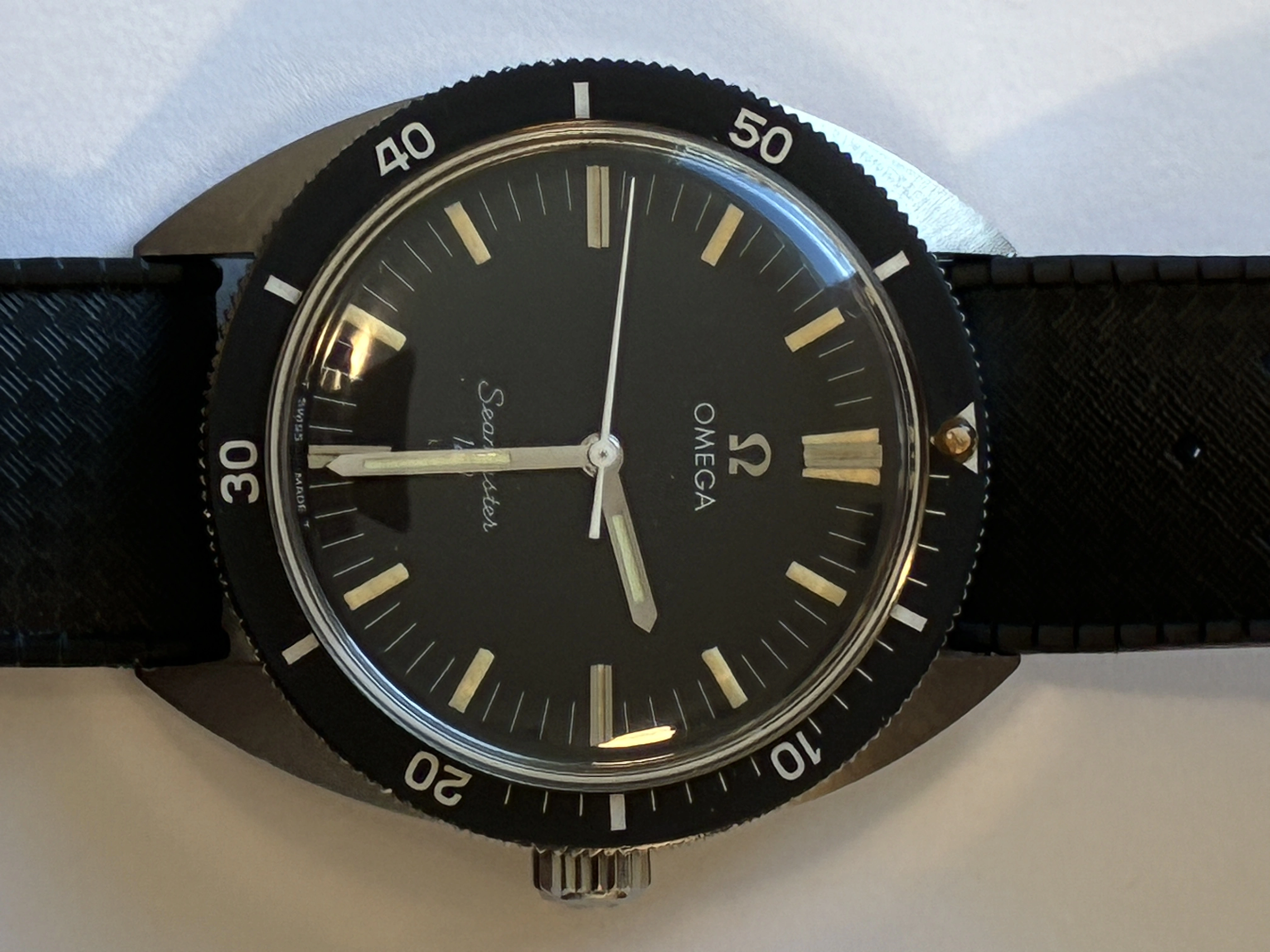

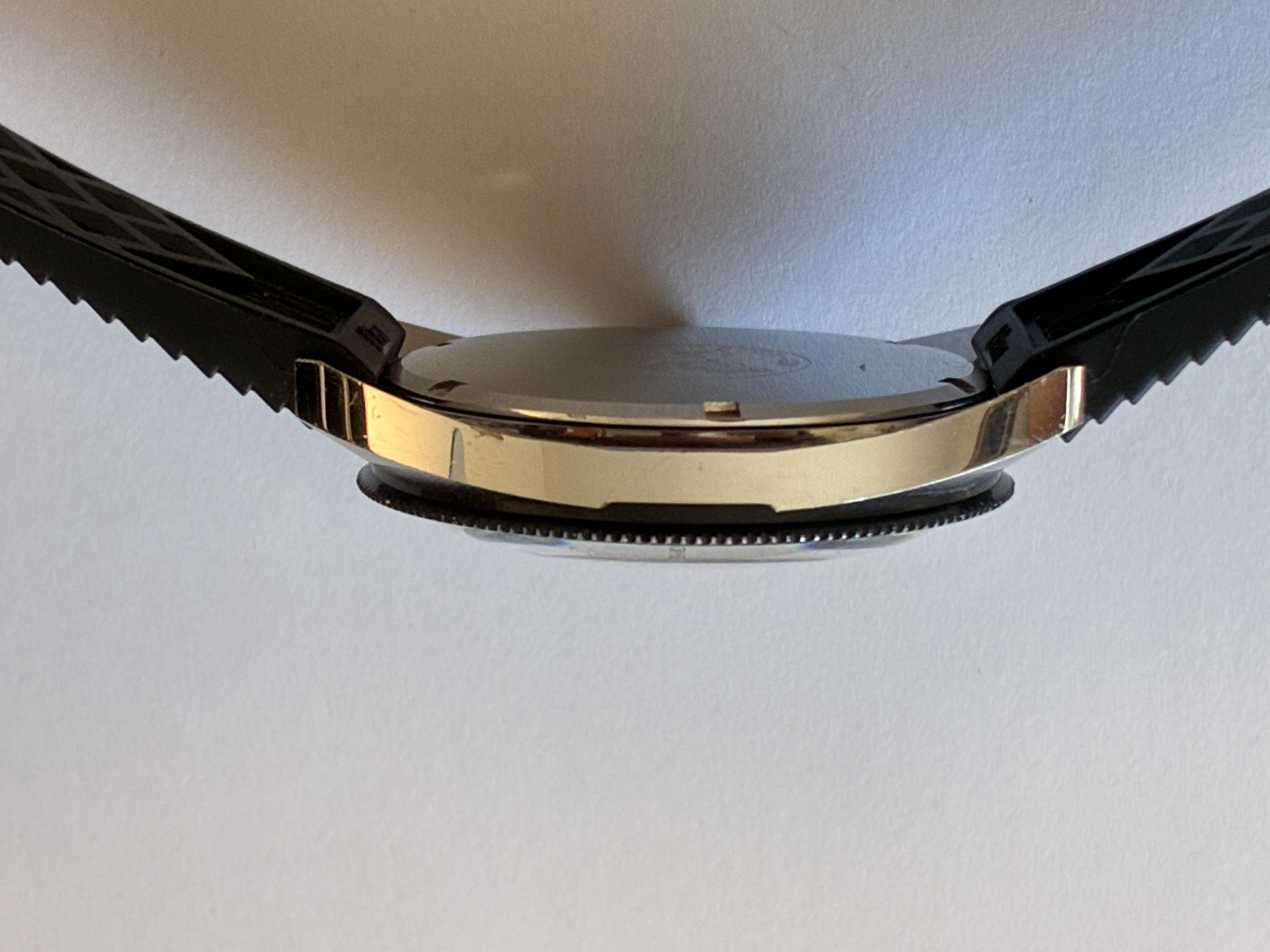

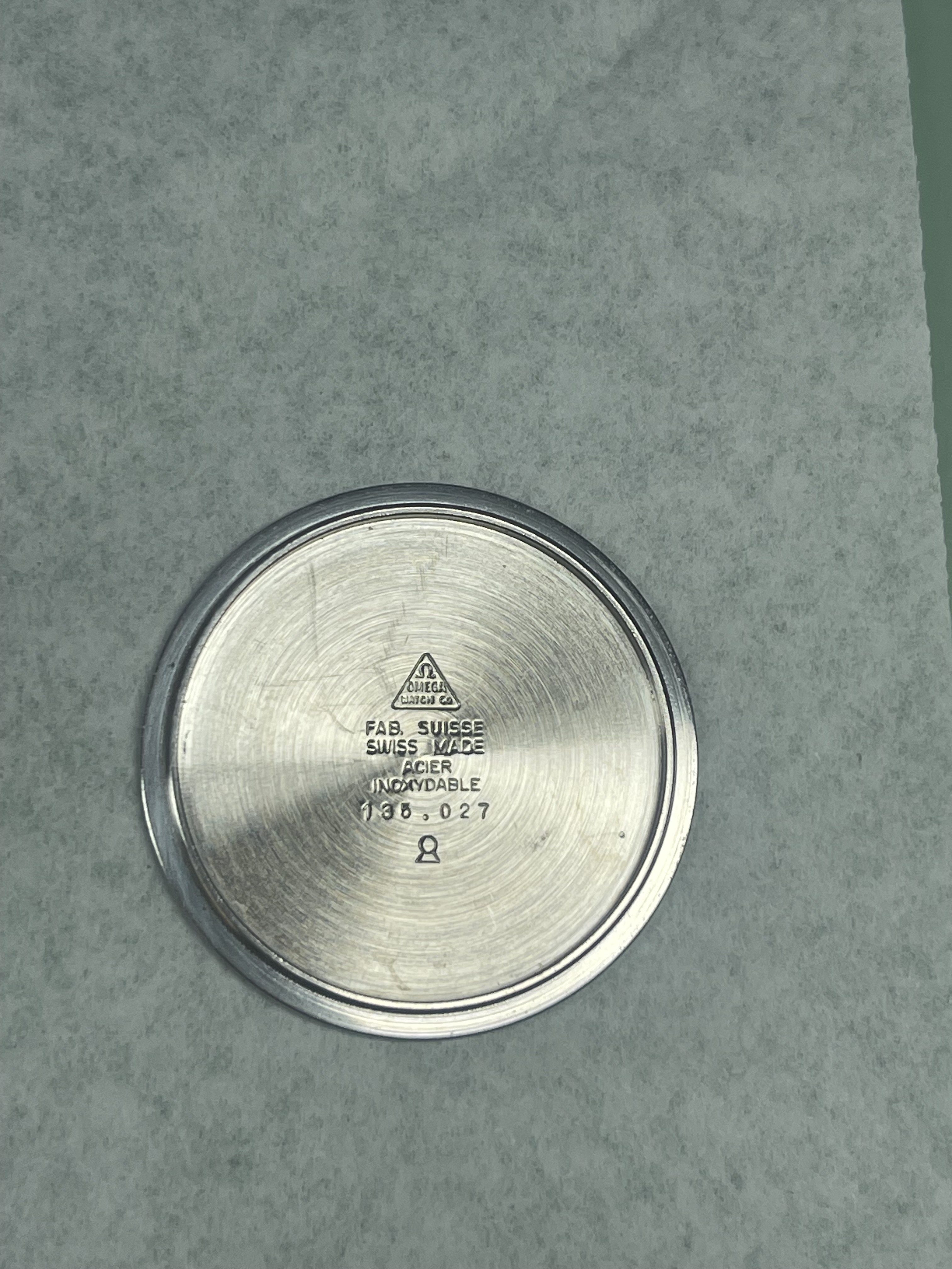

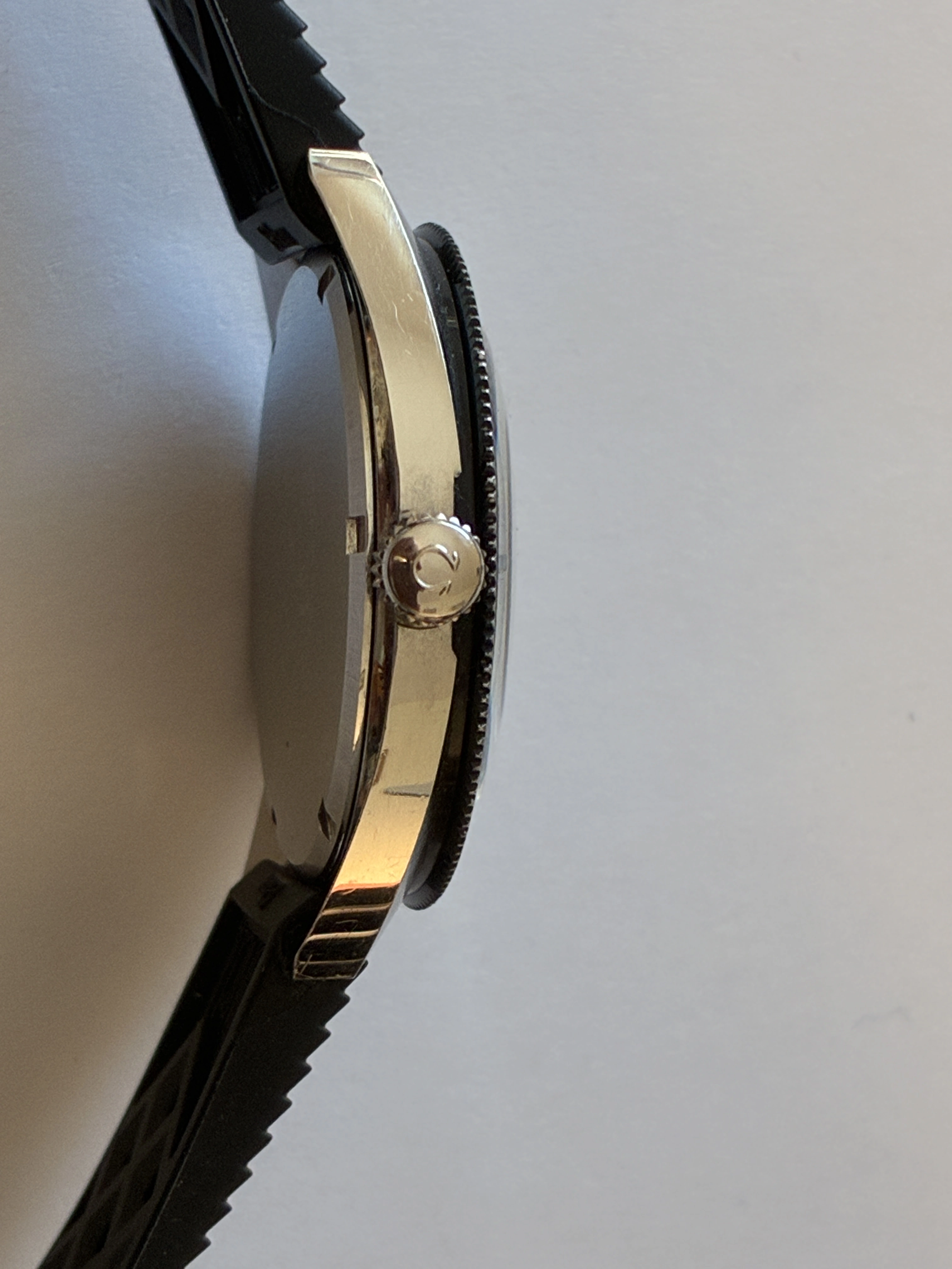

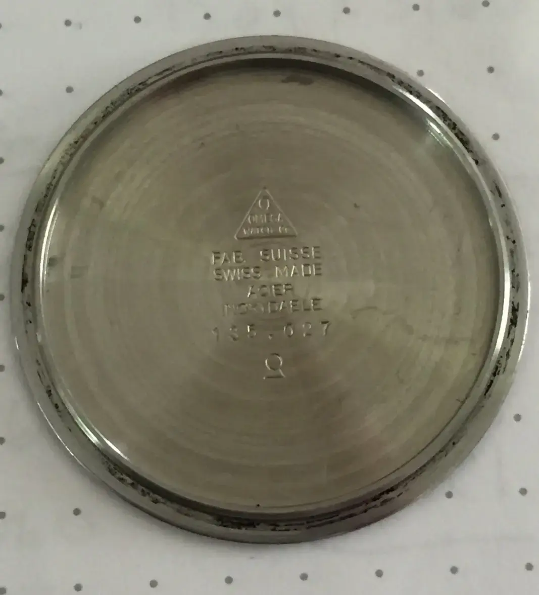

Here’s a few photos of my manual 120 (135.027) in almost new and unpolished condition. It came to me on a Tropic band with original Omega buckle. I believe both came with the watch when purchased in the 1960s. I removed the Tropic to preserve its unworn condition (it is next to the watch in the photo) and replaced it with a replica made by Uncle.
3,689
18,156
1967
Single crown Omega branded EPSA case ref.# 135.027
with Omega branded stainless steel bracelet made by JB Champion USA ref.# 1098 No.11 and 19MM curved end links ref.# 547.

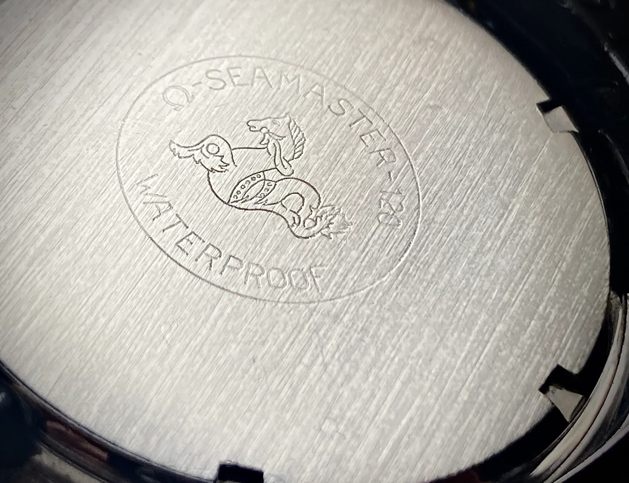

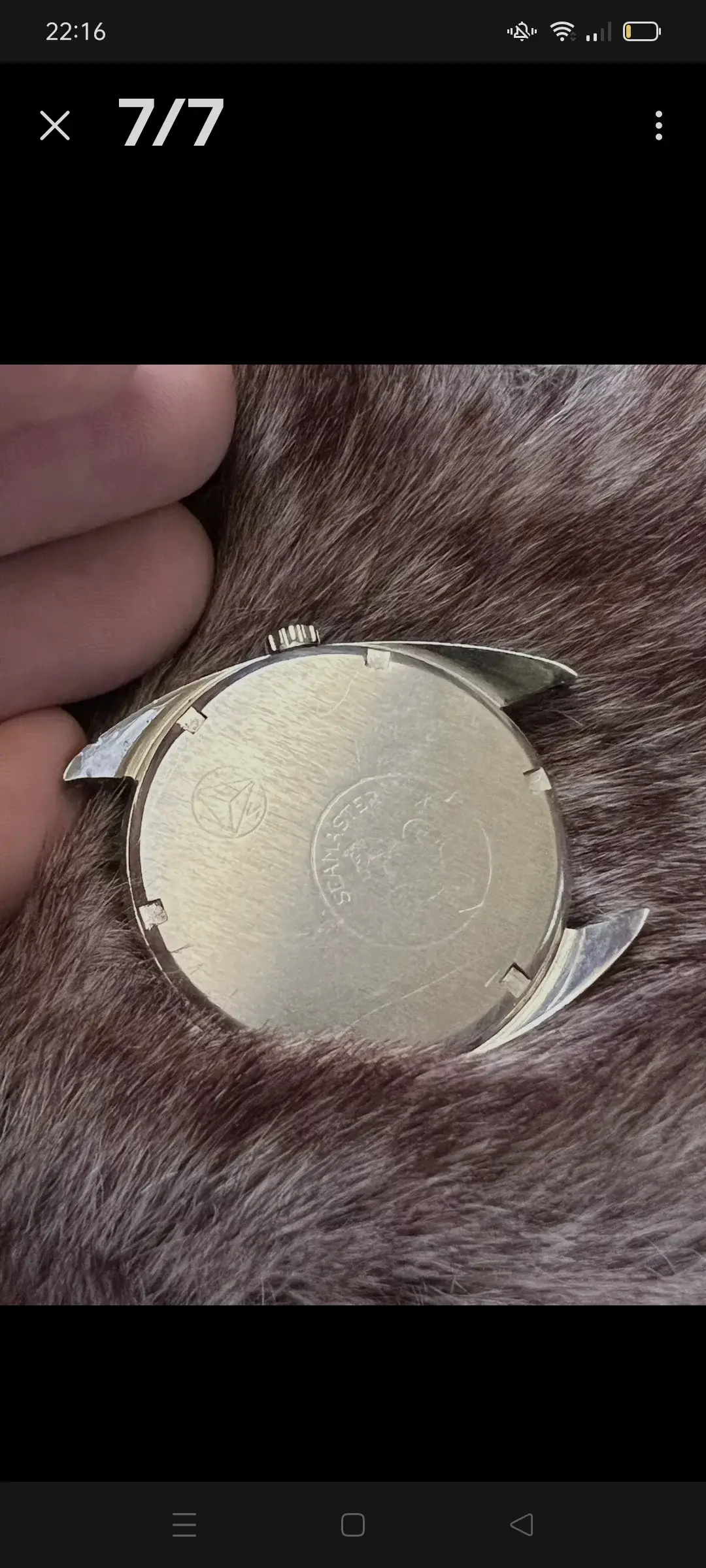

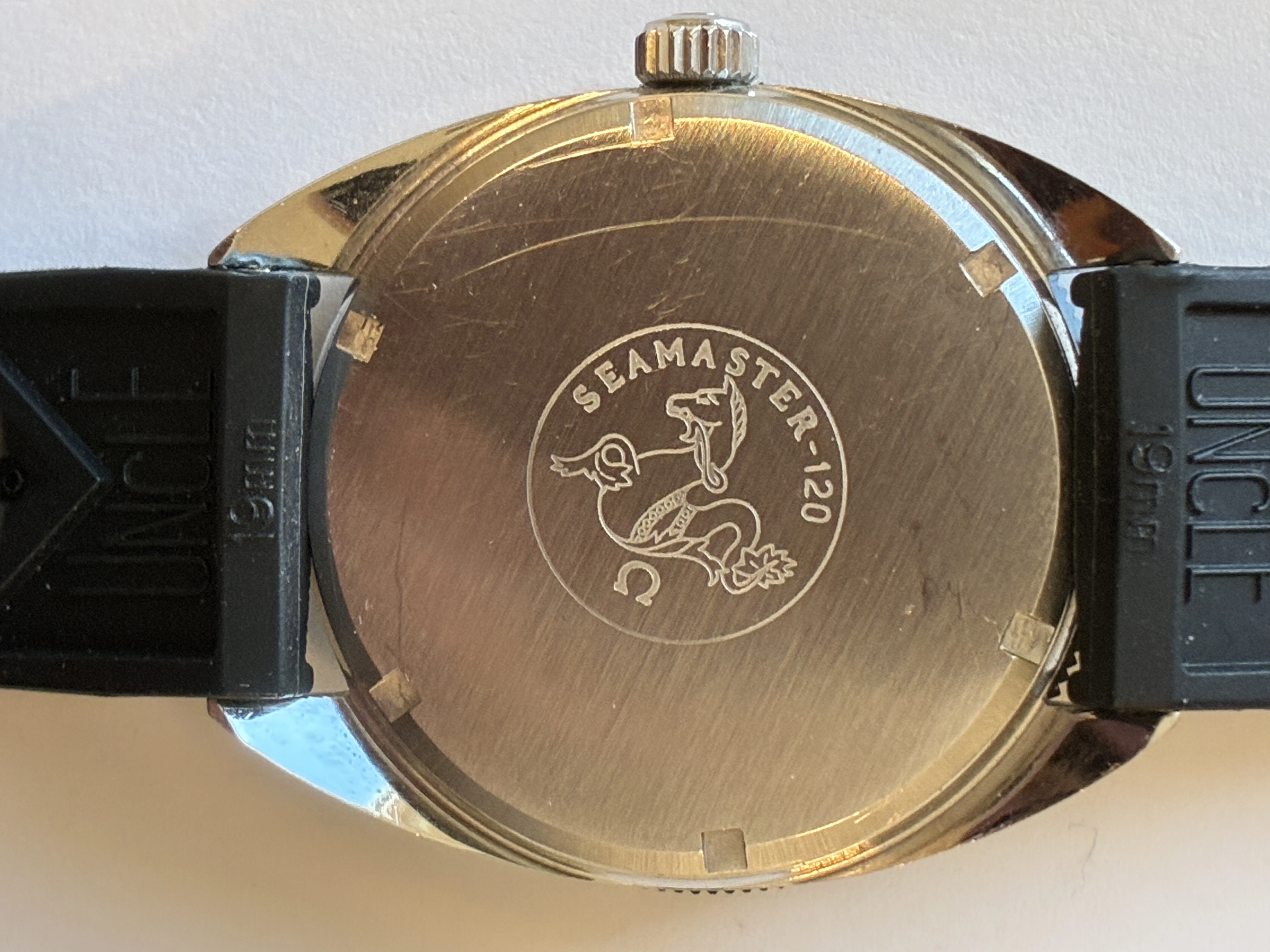

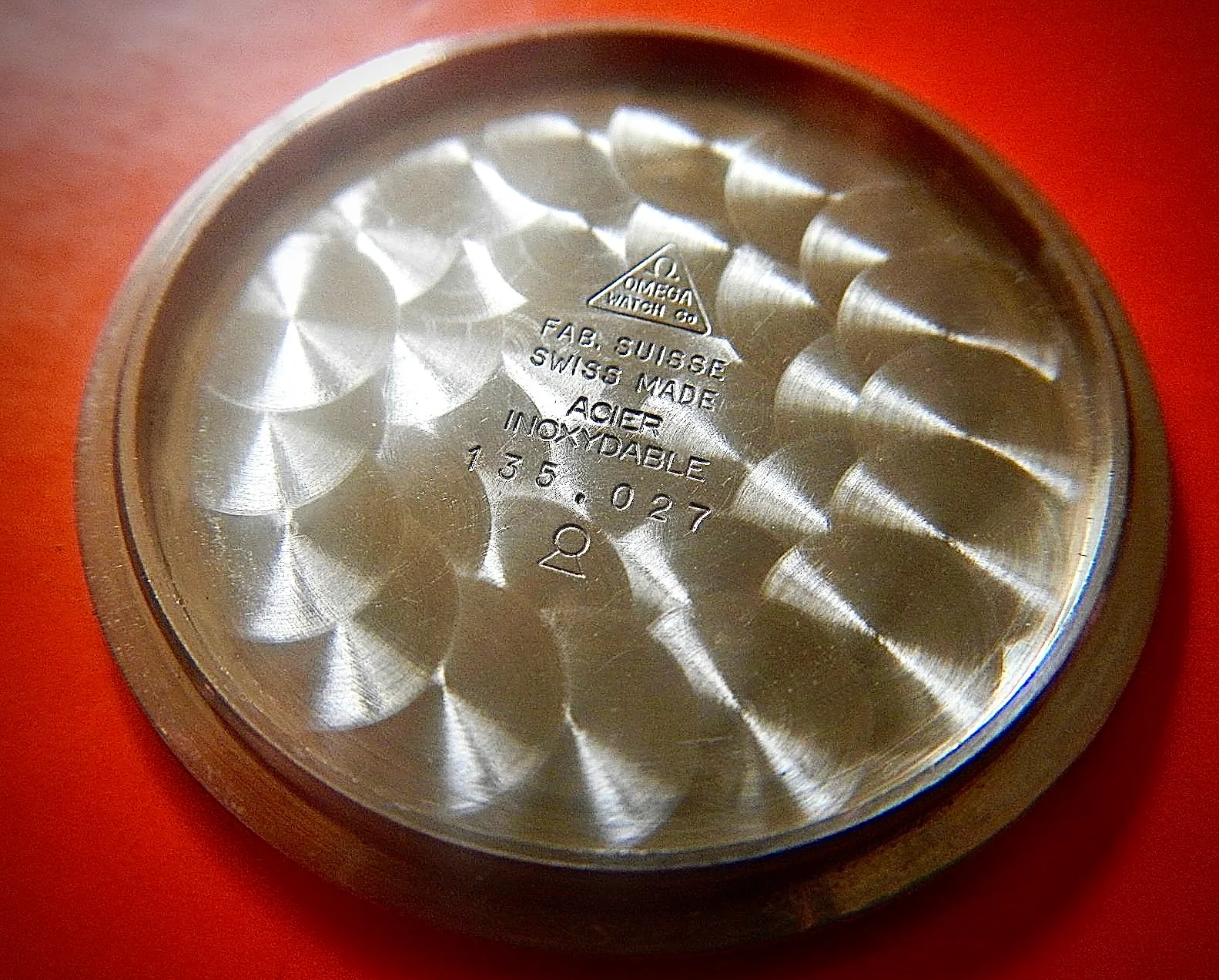

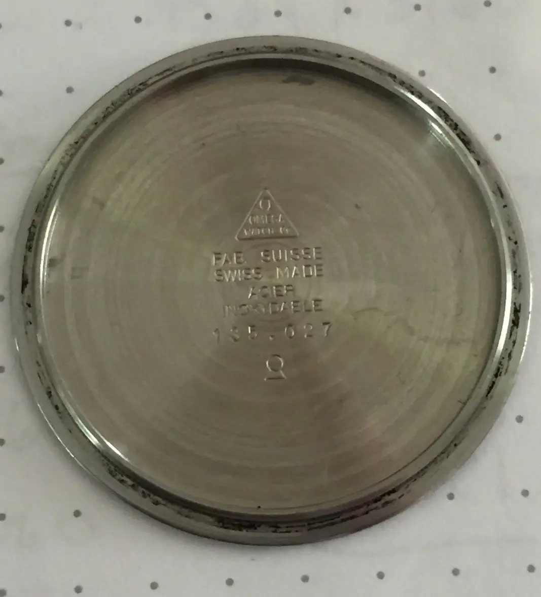

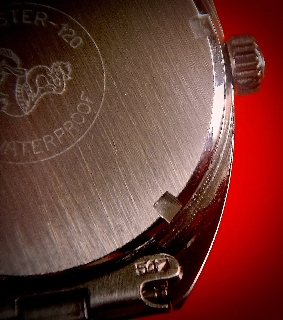

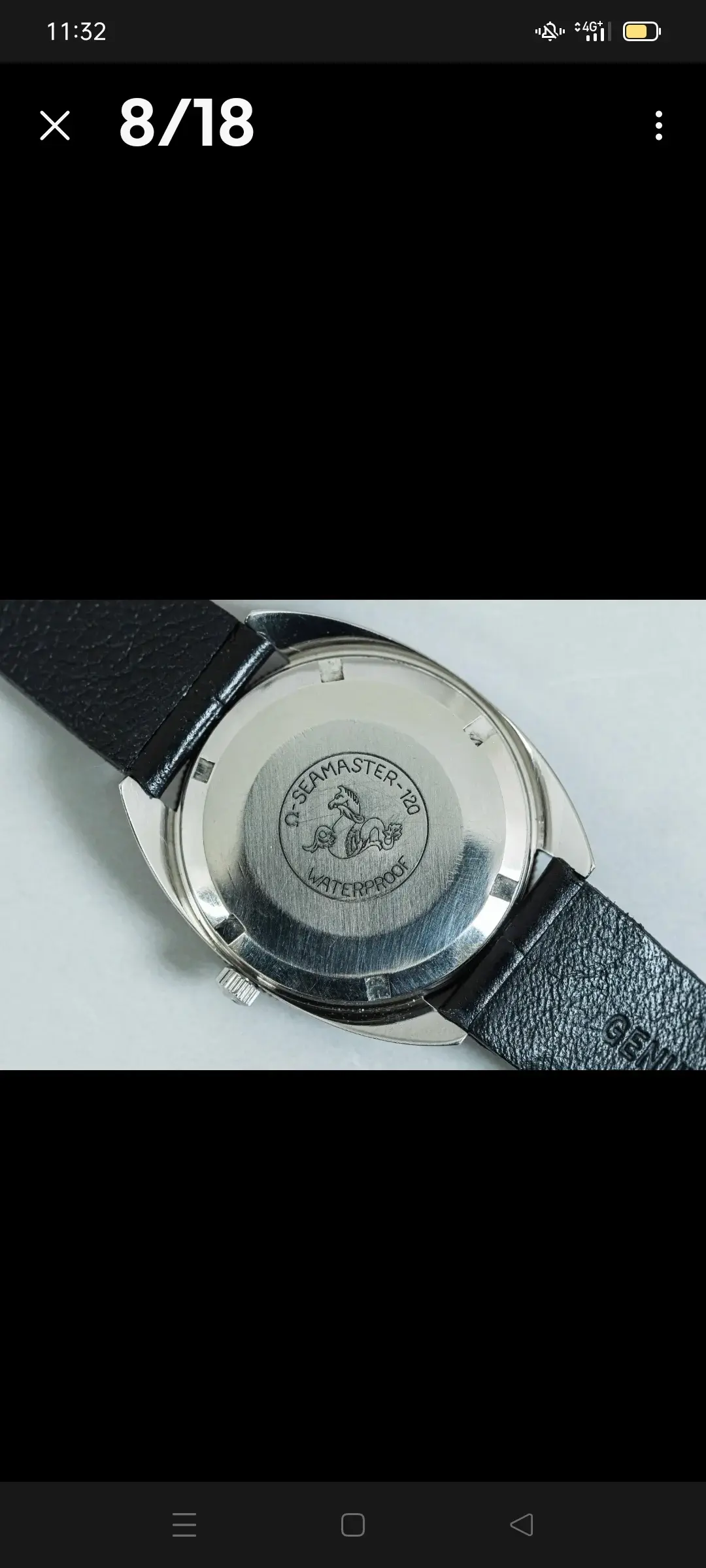

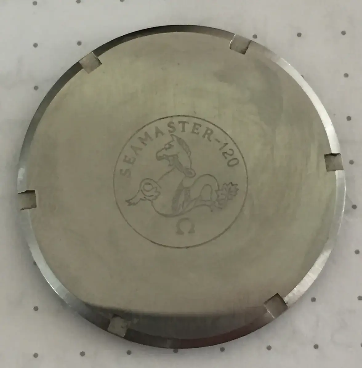

SEE PHOTOS below the case back for ref.# 135.027 should be ...
529
819
Not only the text, also engraving seems to be deeper than what would be correct. Just as described in the OP of this thread
3,689
18,156
Fantastic description on the Seamaster 120s hmmmcamu! Thanks for taking the time to provide that detail.

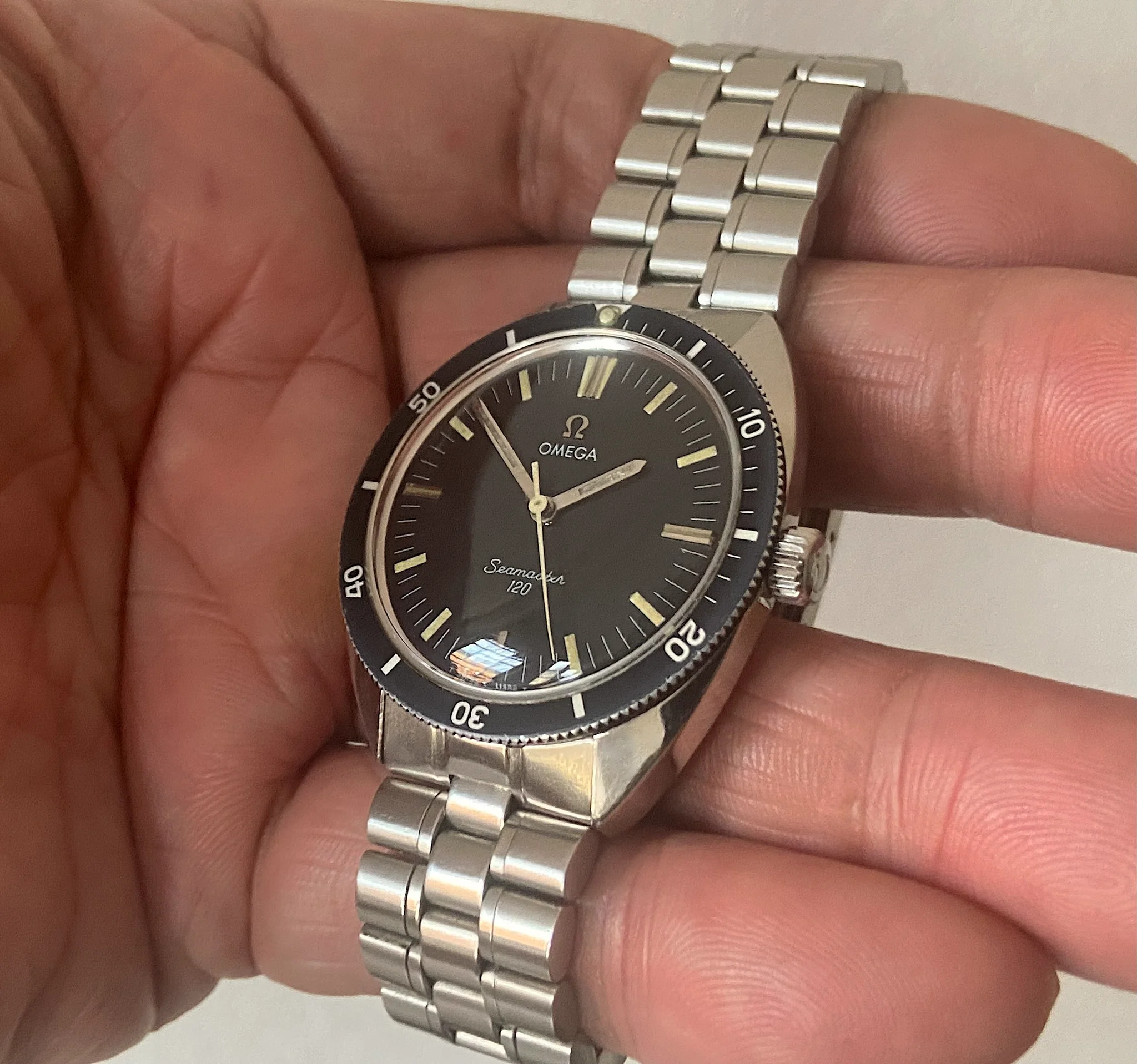

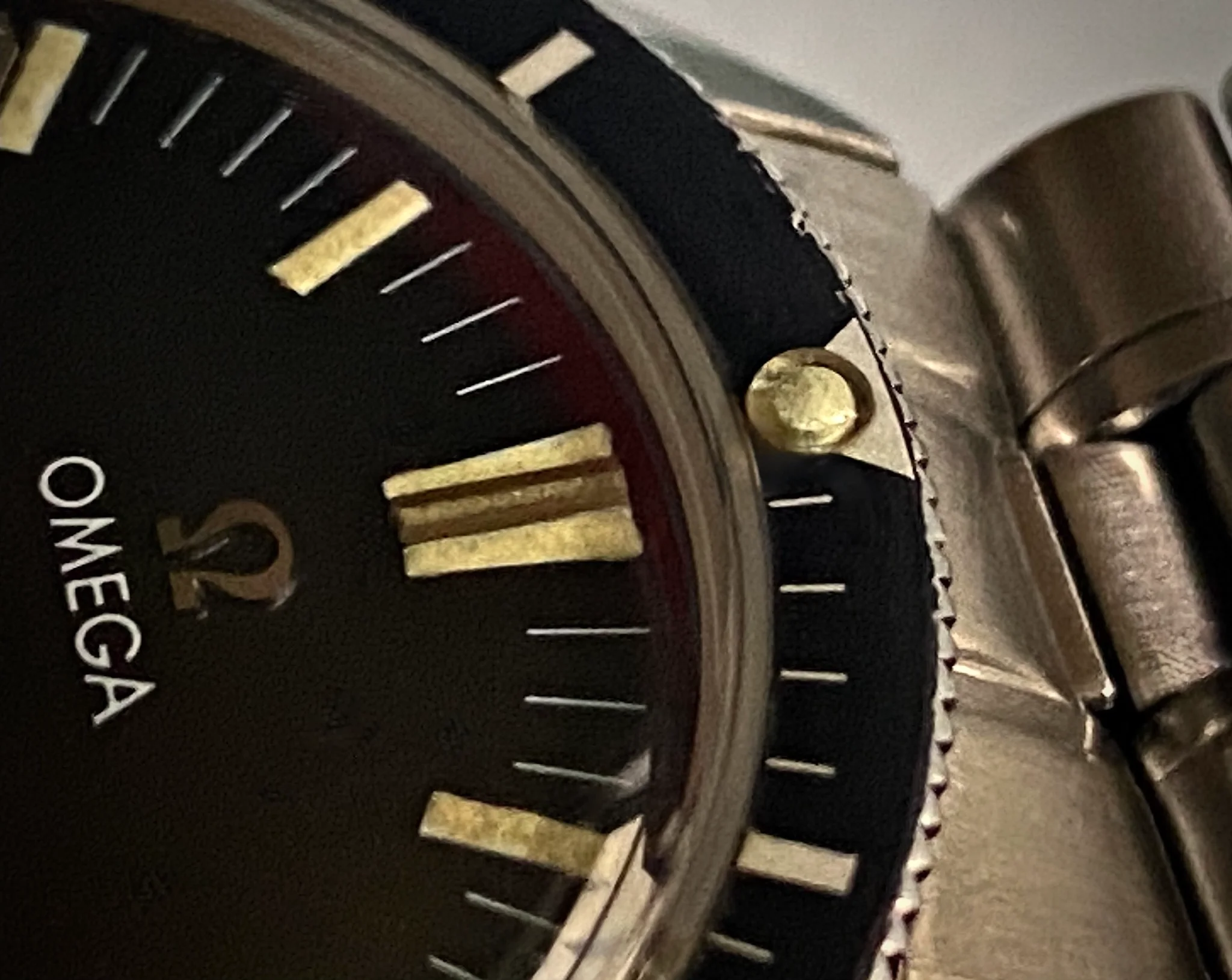

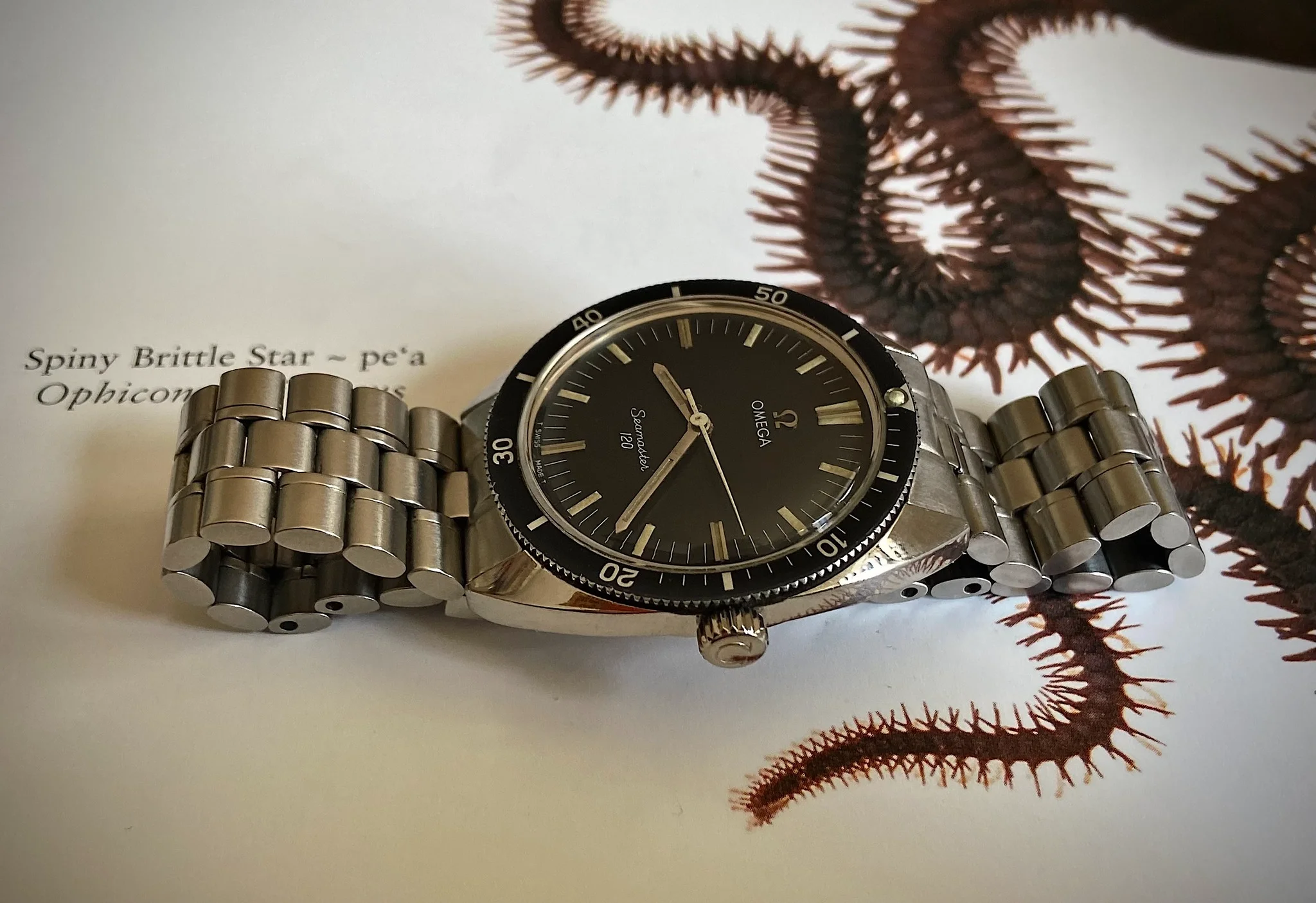

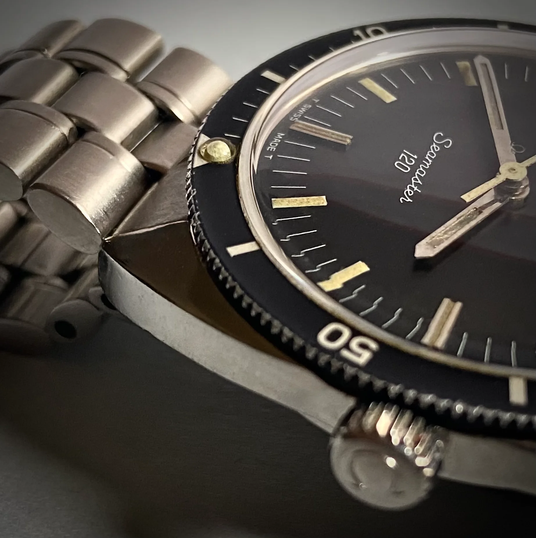

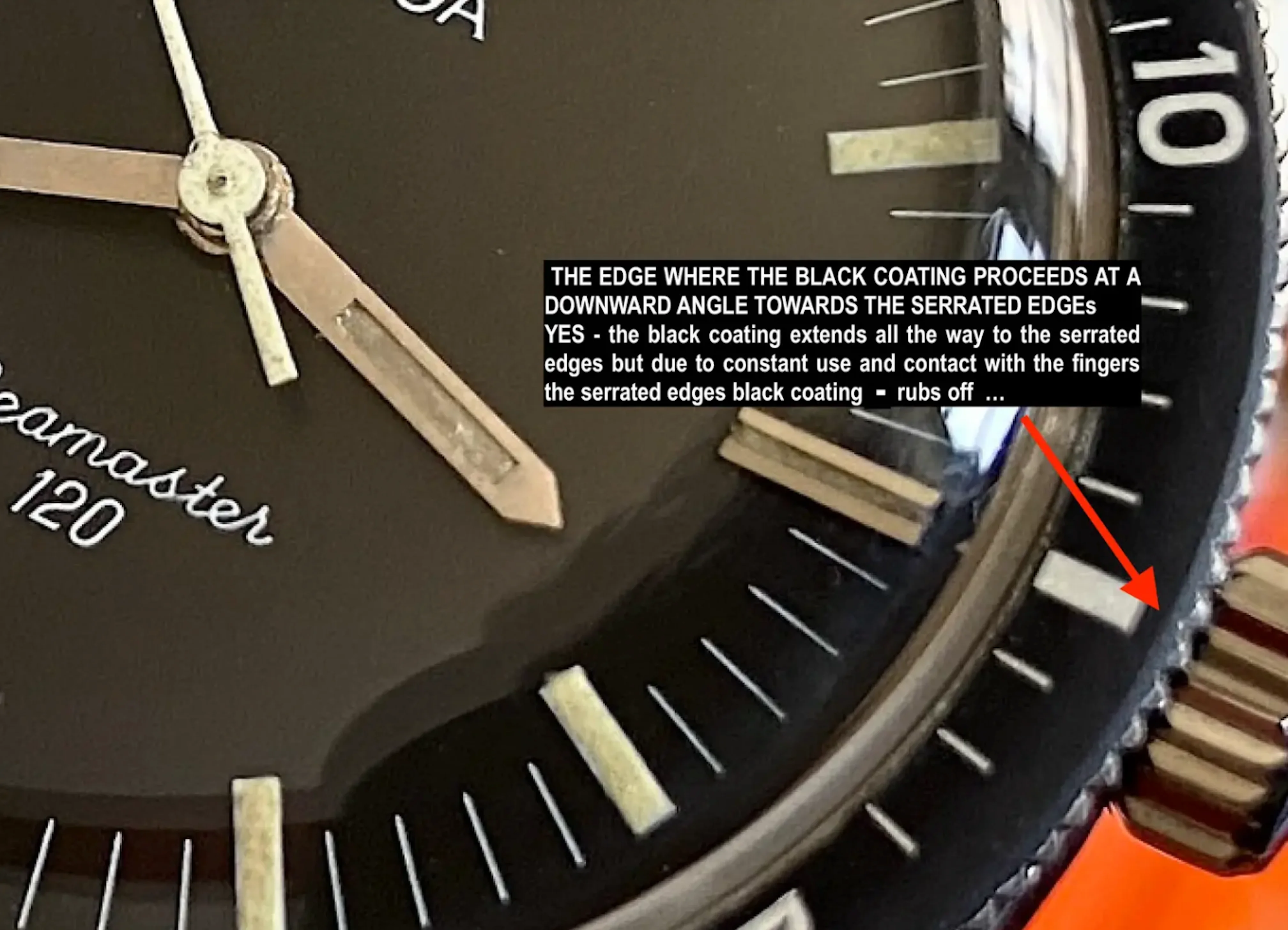

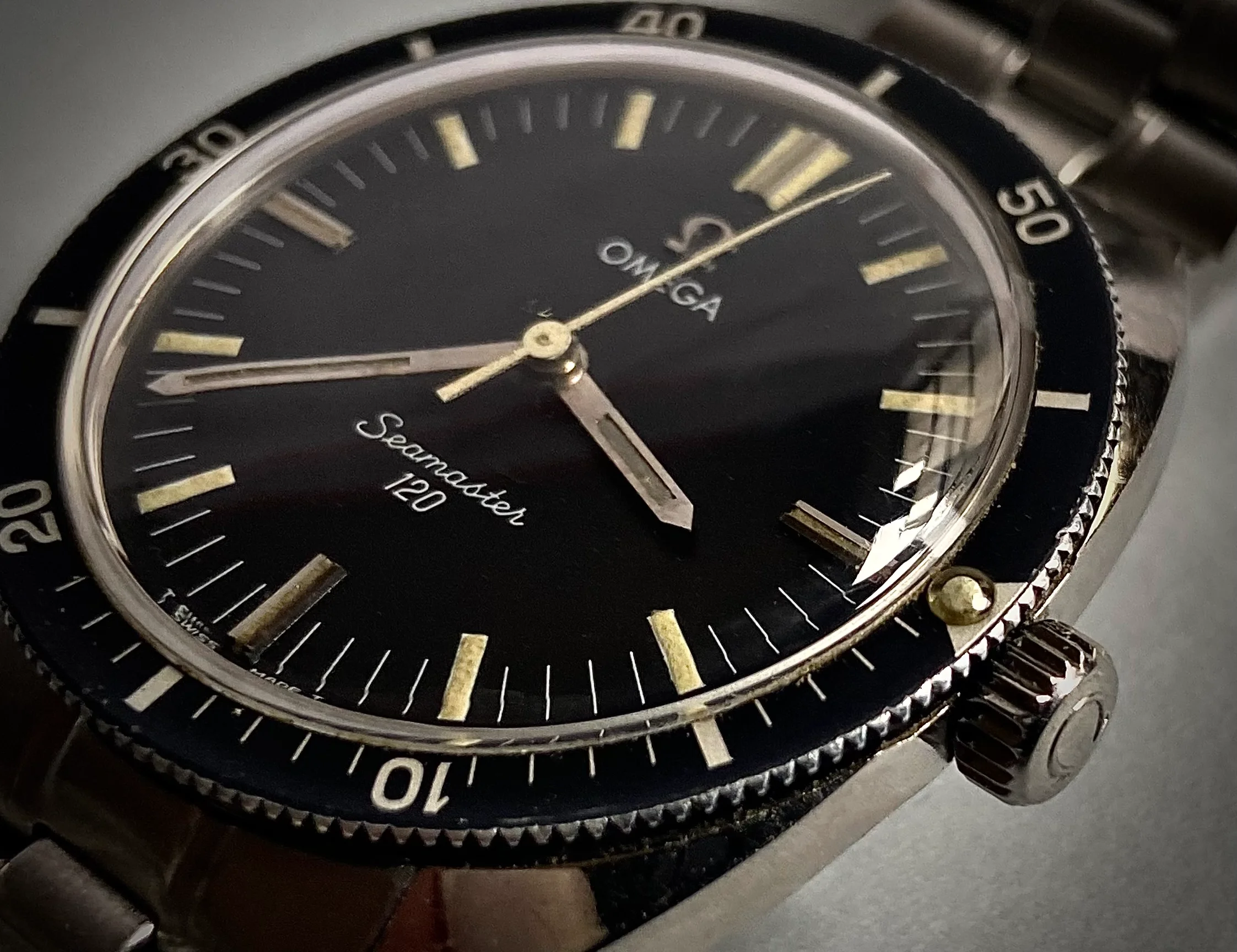

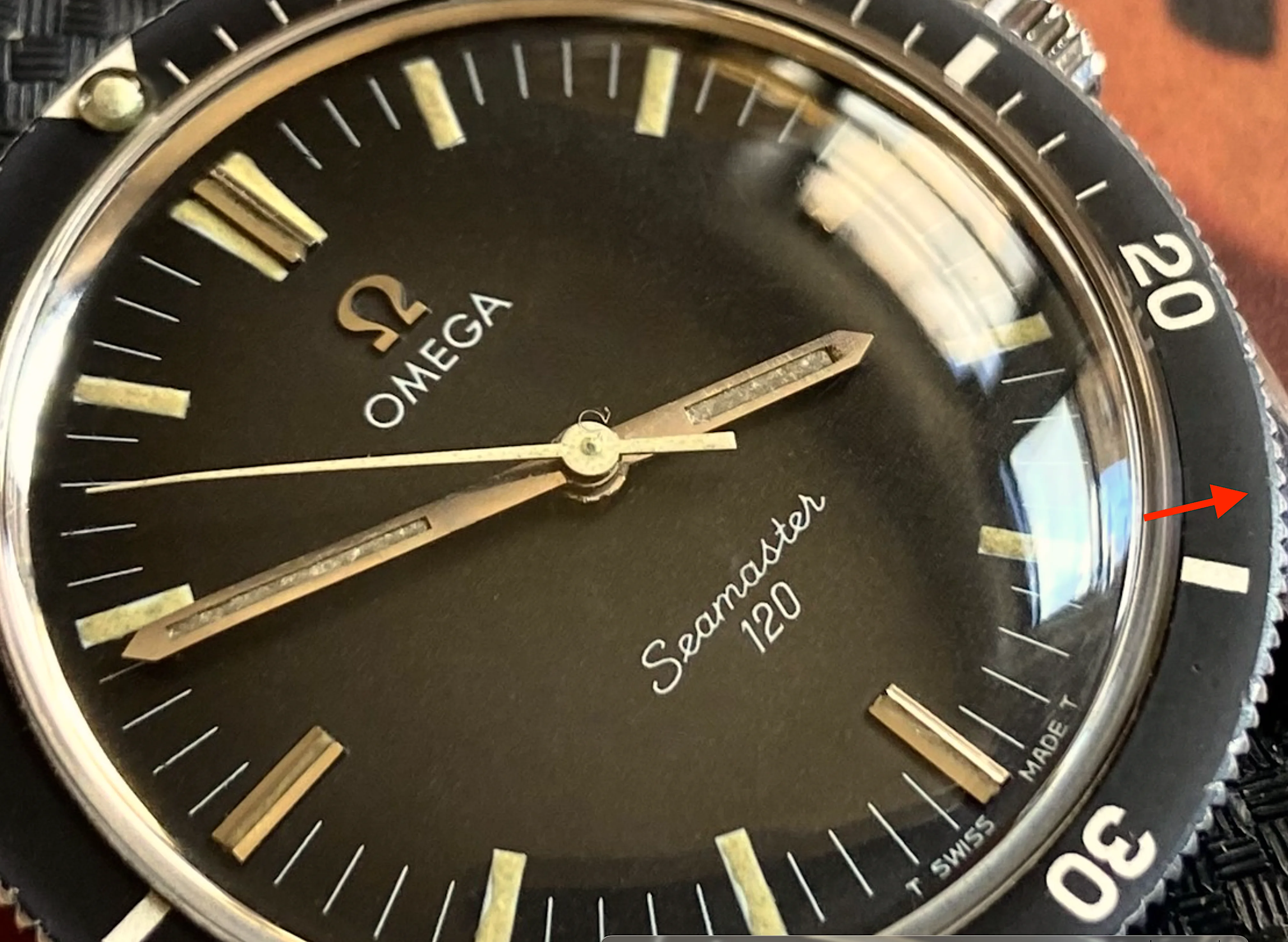

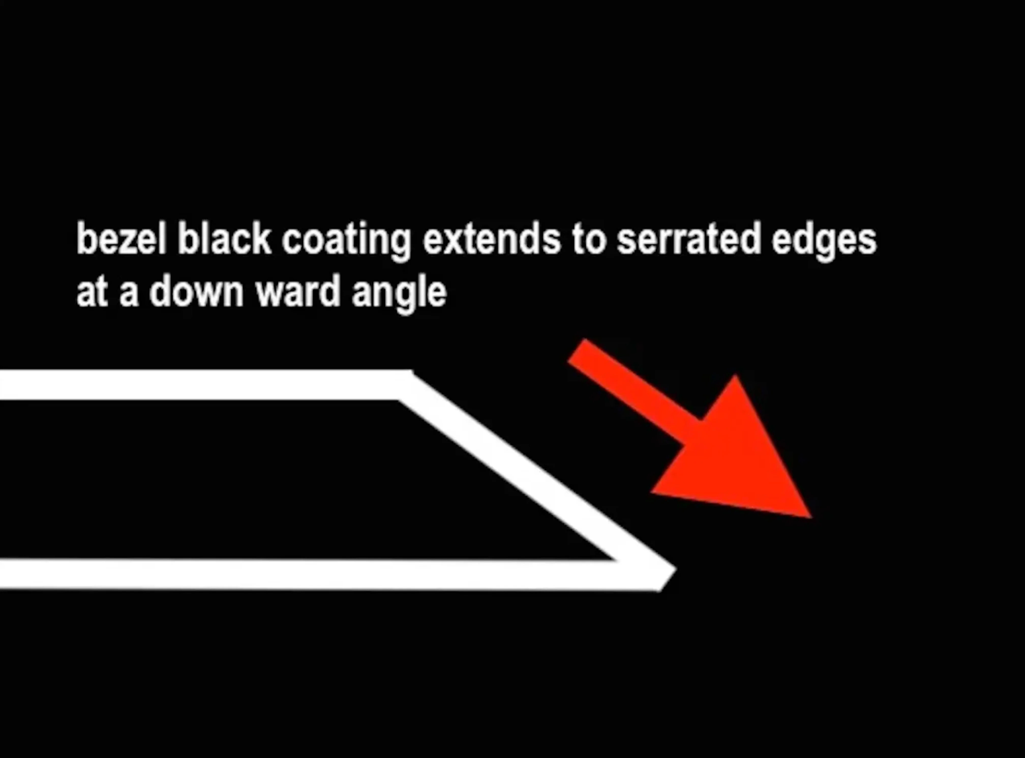

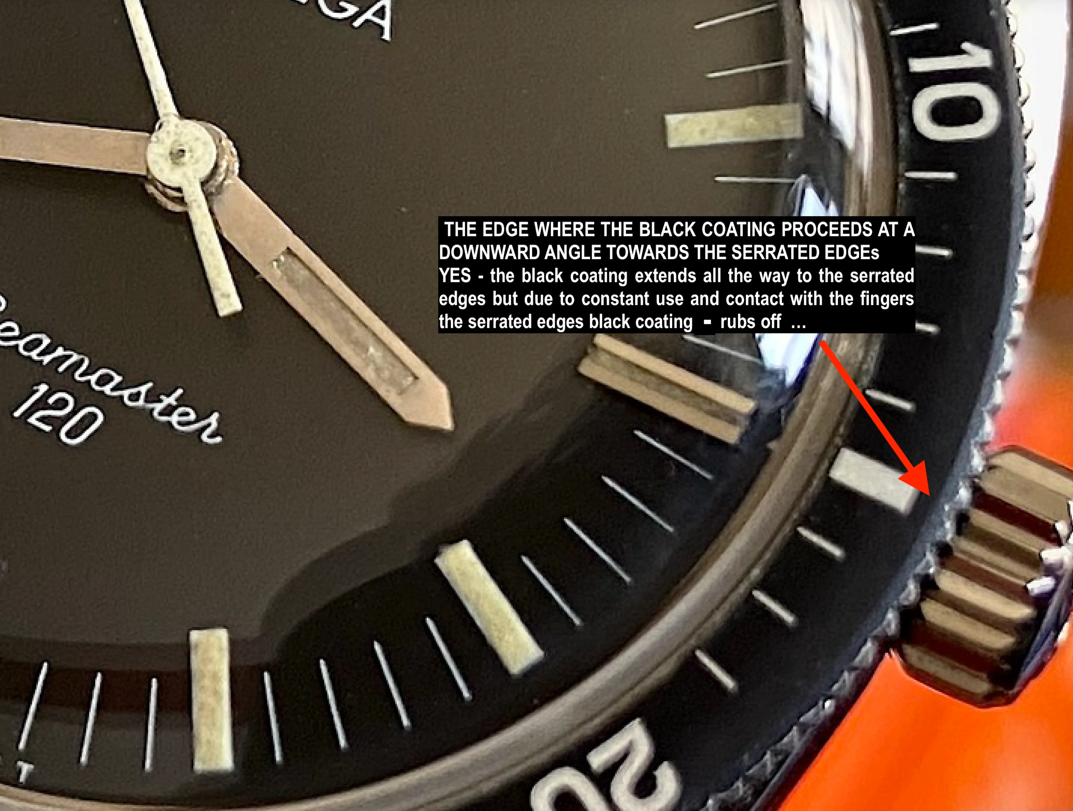

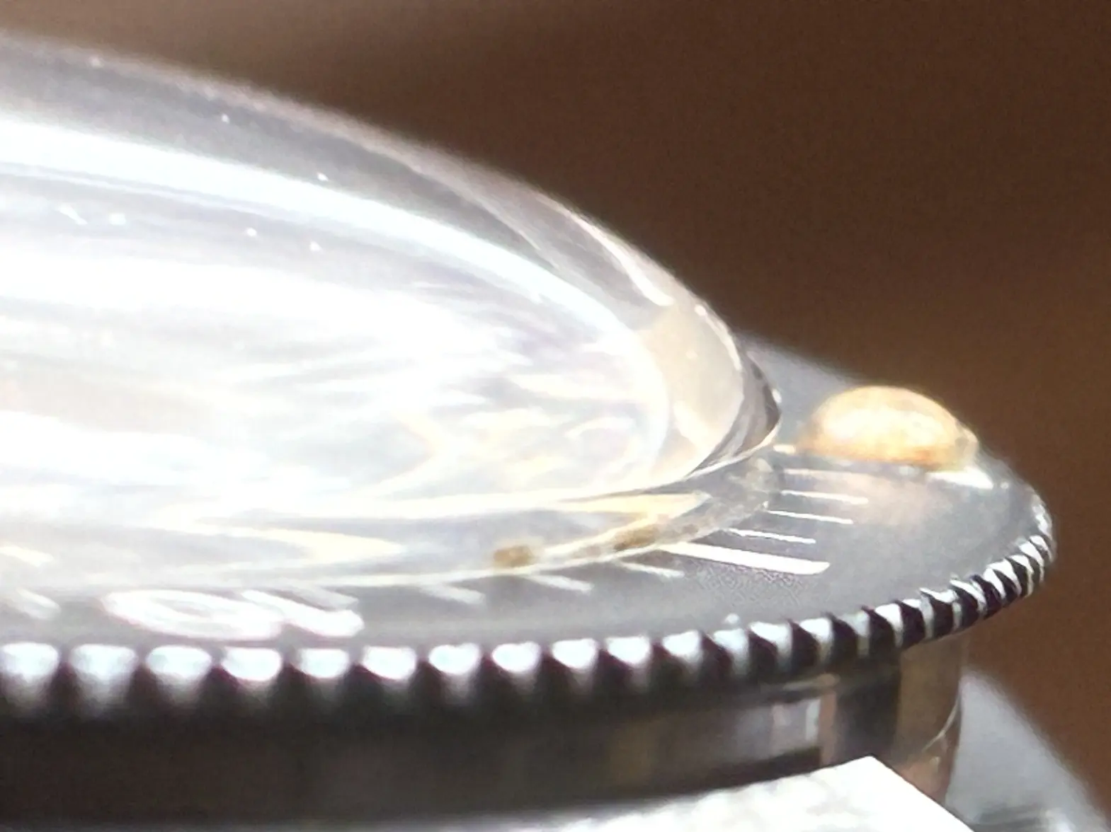

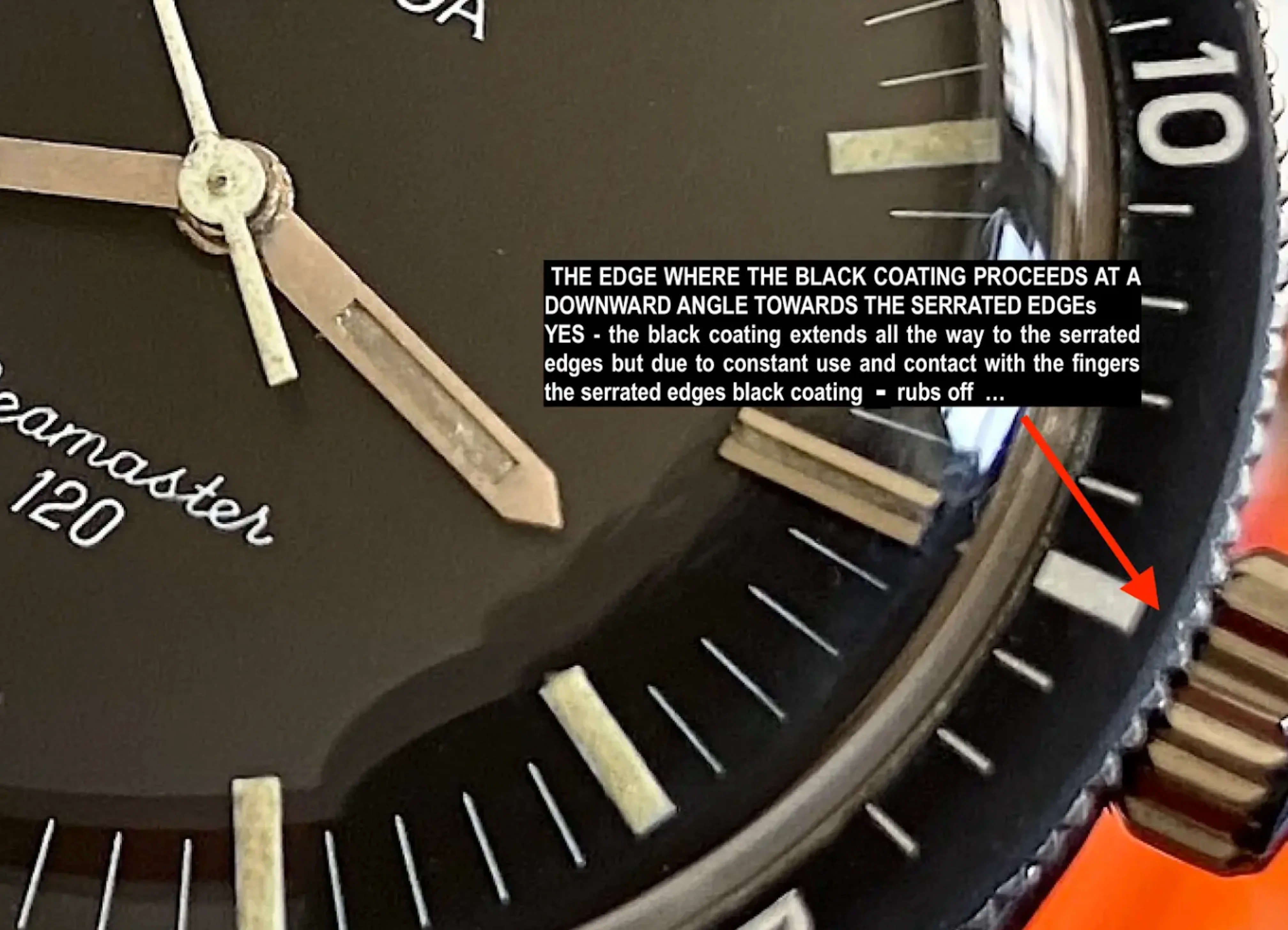

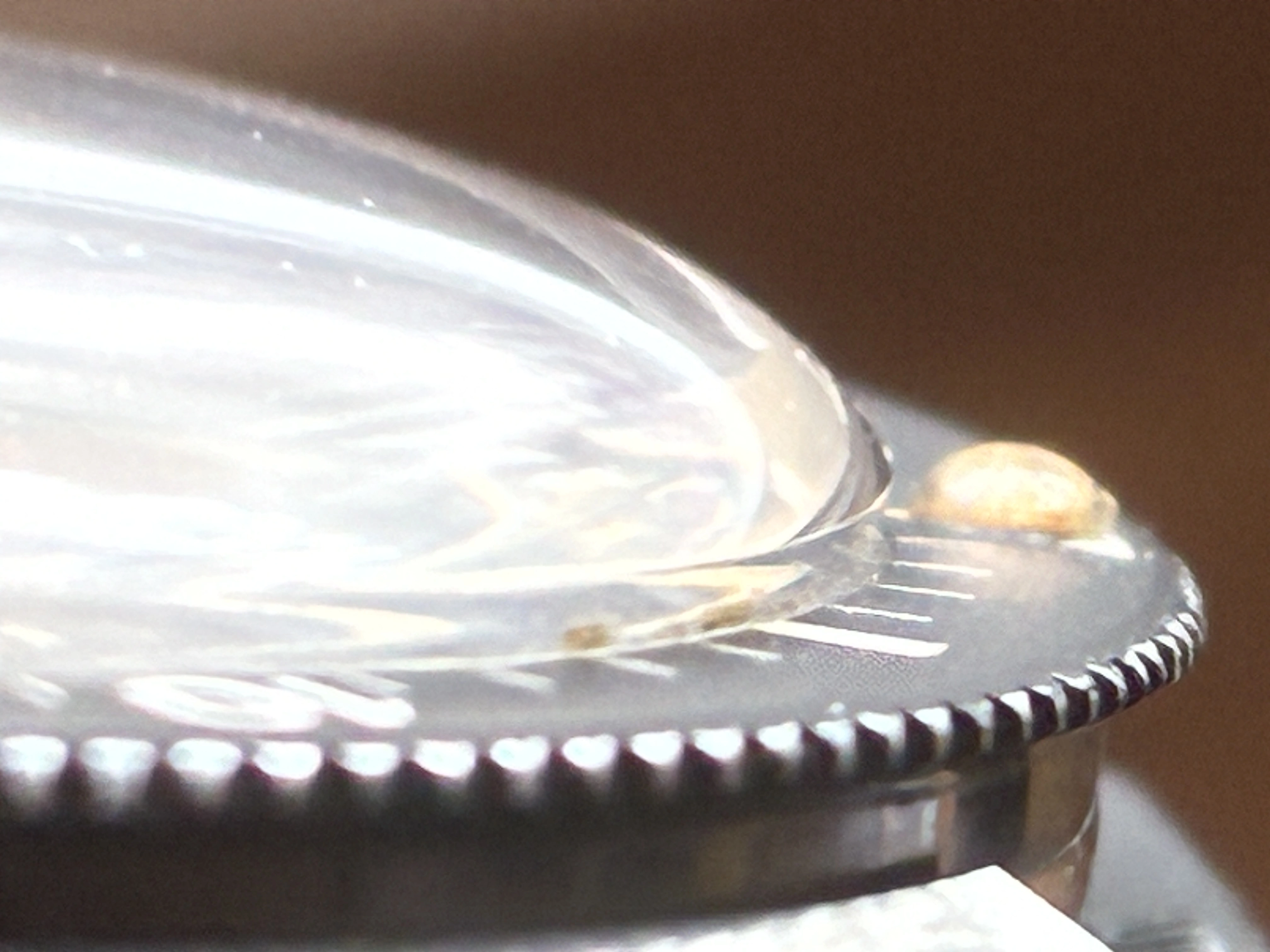

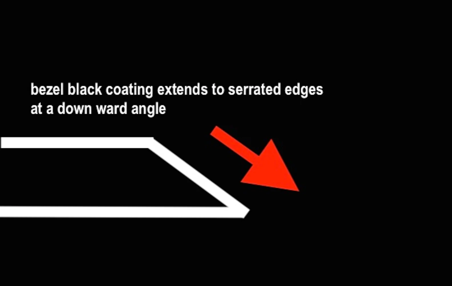

Your bezel is also off ...
Here is a close up of some of the area on my bezel that has some of the tapered matte black coating still intact
529
819

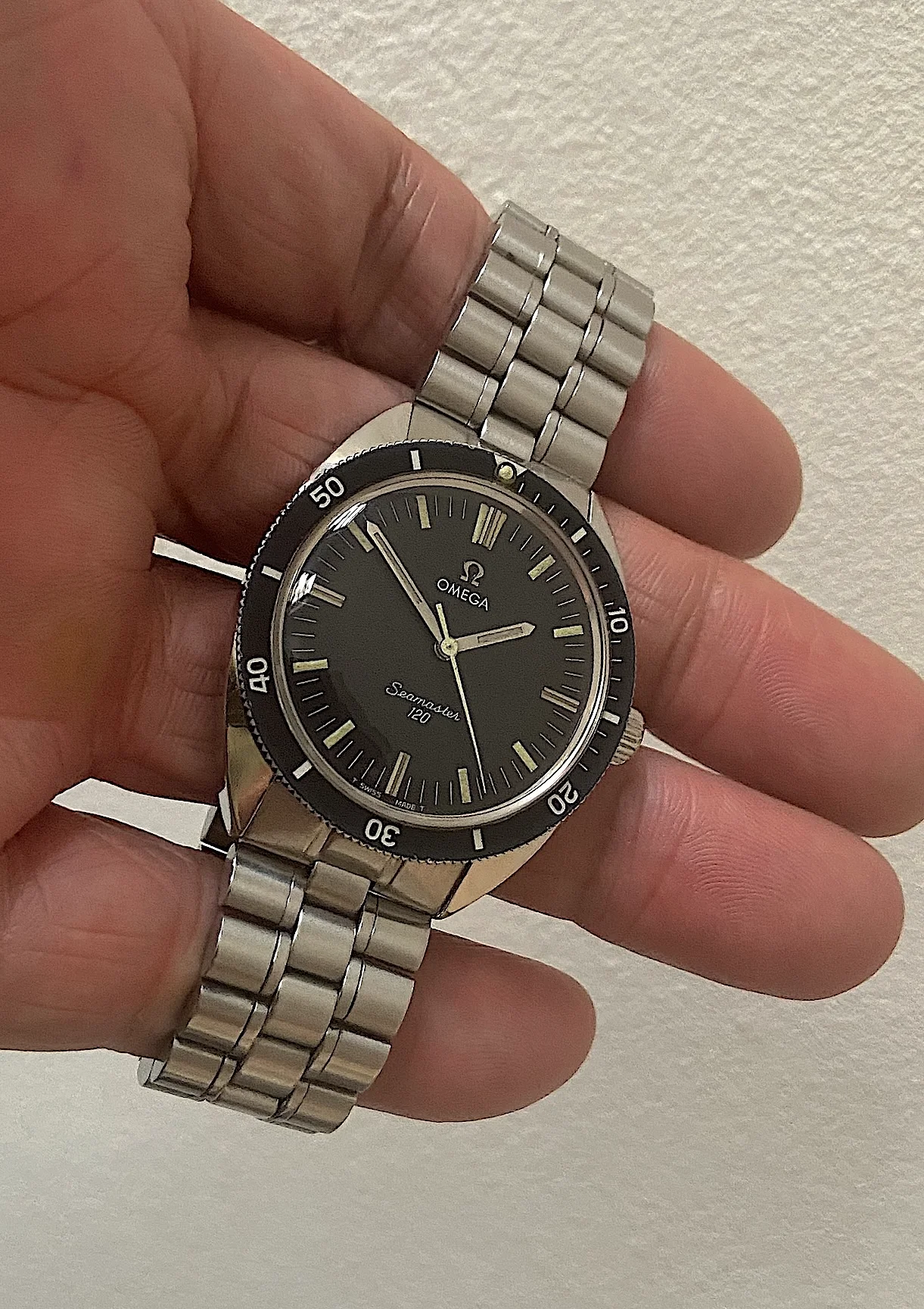

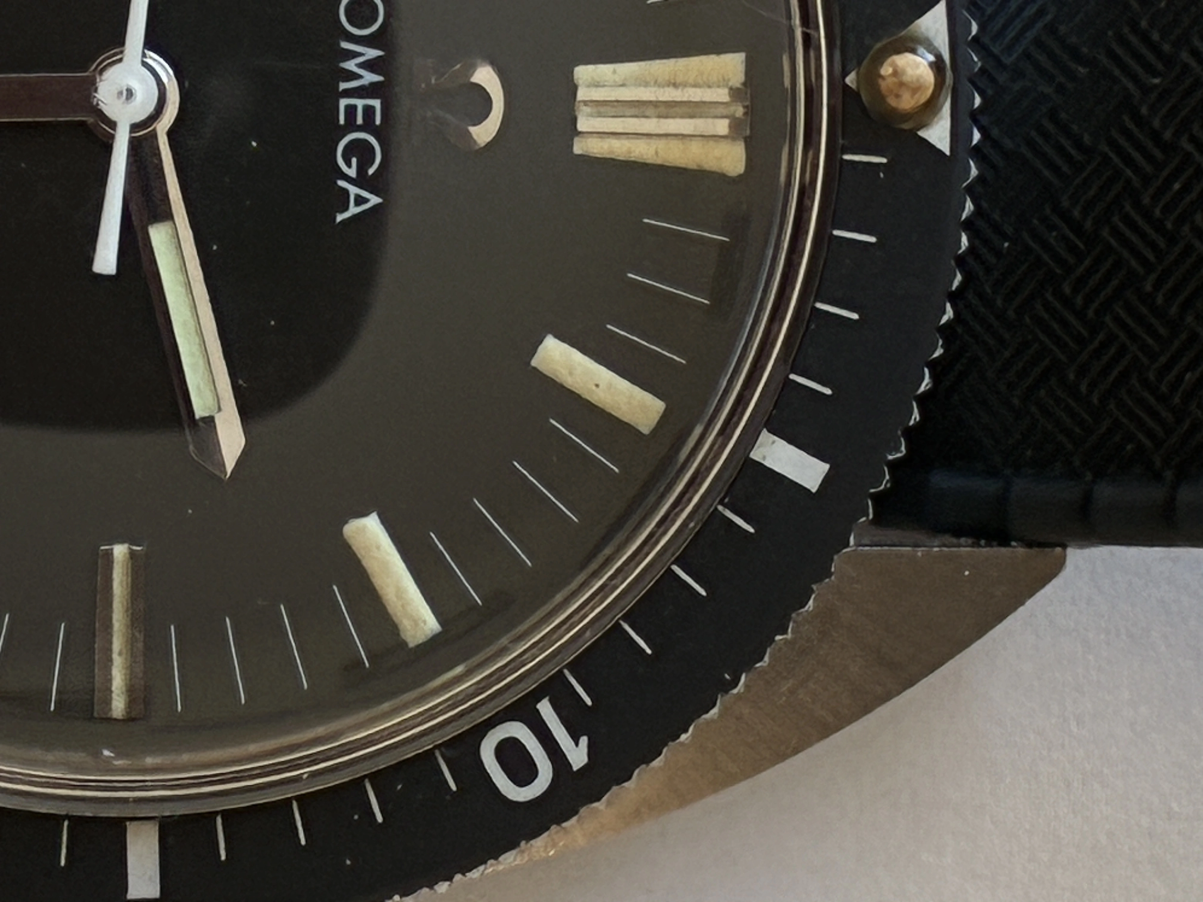

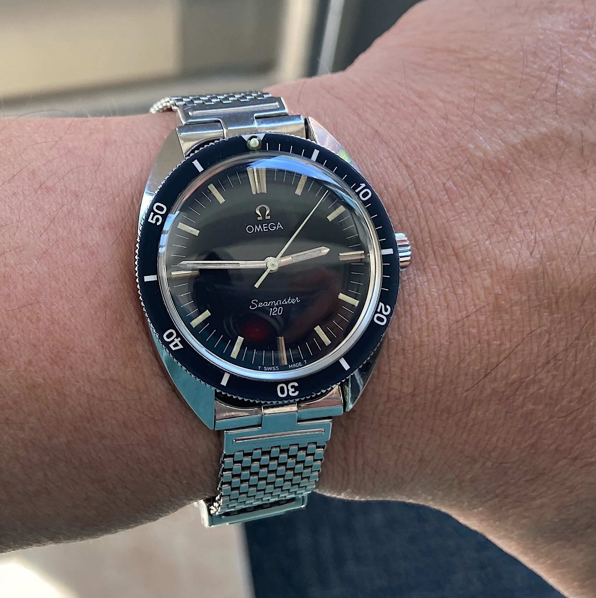

Interesting, to me it also seemed off but wasnt sure how to describe it. So the 'tooth' of the bezel should not have the coating?
THE SERRATED TIPS / TEETH were once coated black .... the black coating extends all the way to the serrated edges it does so at an angle / downward slope - towards it.
BUT due to constant contact with the fingers of the owner/user it eventually wears off. the black coating extends all the way to the serrated edges
323
1,134

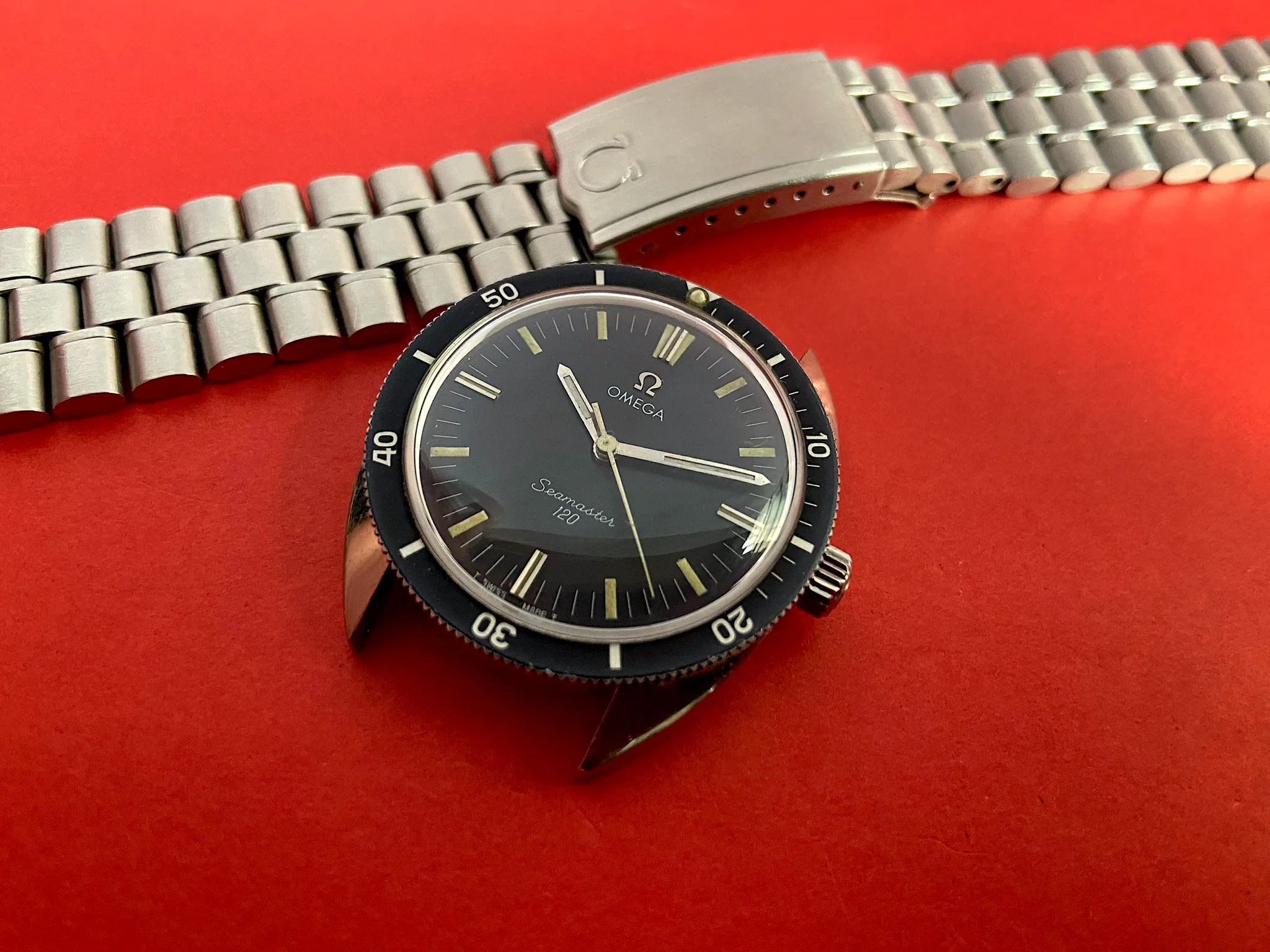

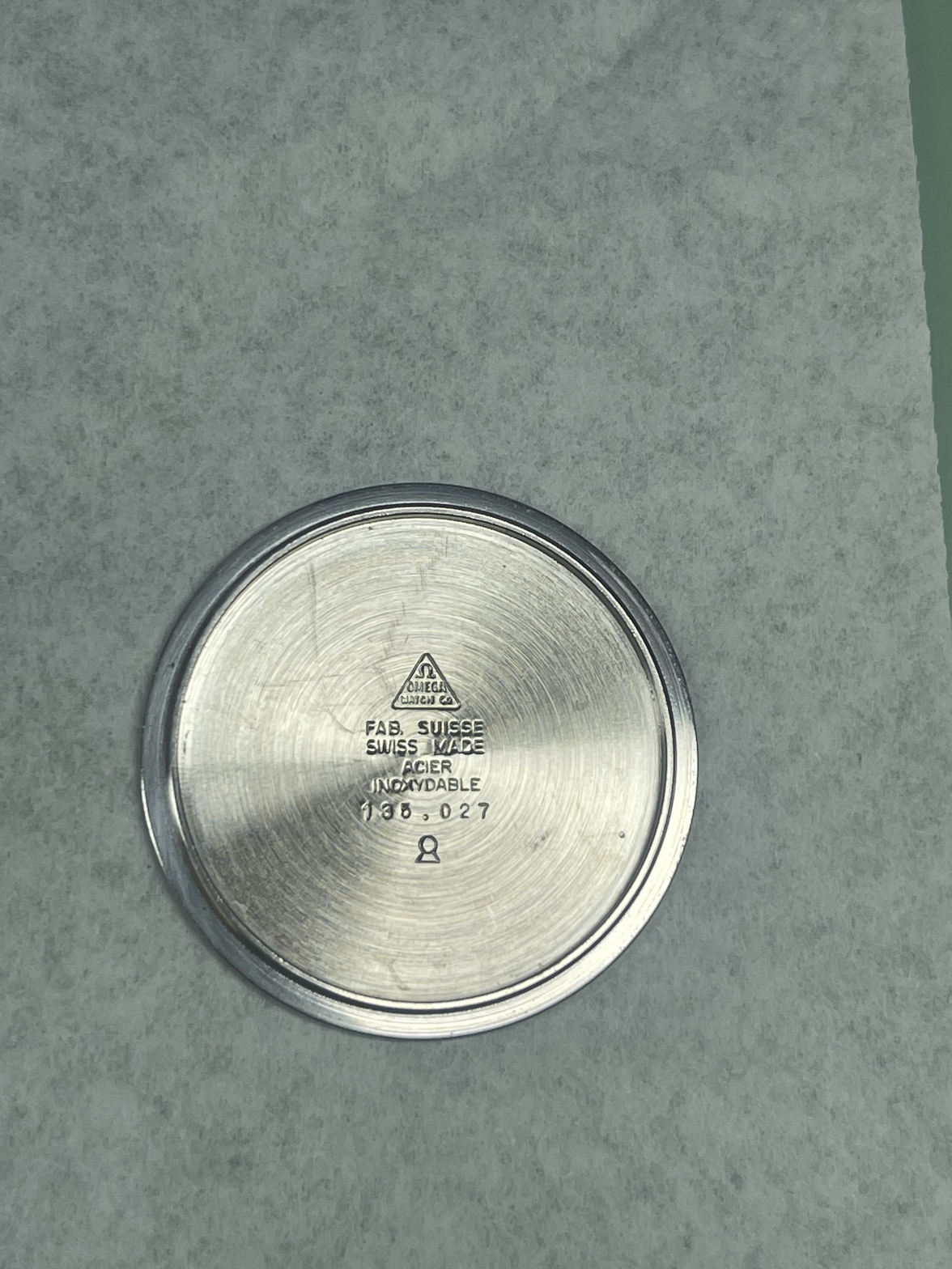

I very much appreciate a careful assessment of these watches by anyone given the fakes that abound for the Seamaster 120. After a long wait, I now have my 135.027 manual movement, no date, caliber 601 watch back from movement service. Compared to the Extract of the Archives from almost a decade ago, photos of the 601 movement number match this one and the Extract also identifies this watch was produced mid-year of 1970 and delivered to the USA. I also have been able to compare this watch from dealer photos of the watch when sold to the previous owner 10 years ago that I bought it from and it appears unchanged. The well-known dealer guaranteed and authenticated the watch at that time of sale to the previous owner, but I take that with a grain of salt given that the dealer is a seller. BTW, I have a more common case back on my 1968 166.027 I've also used as comparison.
With additional scrutiny, I see that my bezel serrated / teeth coating extends toward the serrated edges at a downward angle as shown above previously. Additionally, the bezel has the 144 notches / dents on the bezel as it should have, and the tritium pip (with aging) and font are consistent as would be expected given comparison with the rest of the watch. All case parts are consistent with condition and age also.

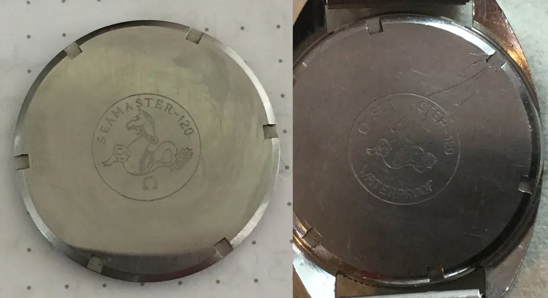

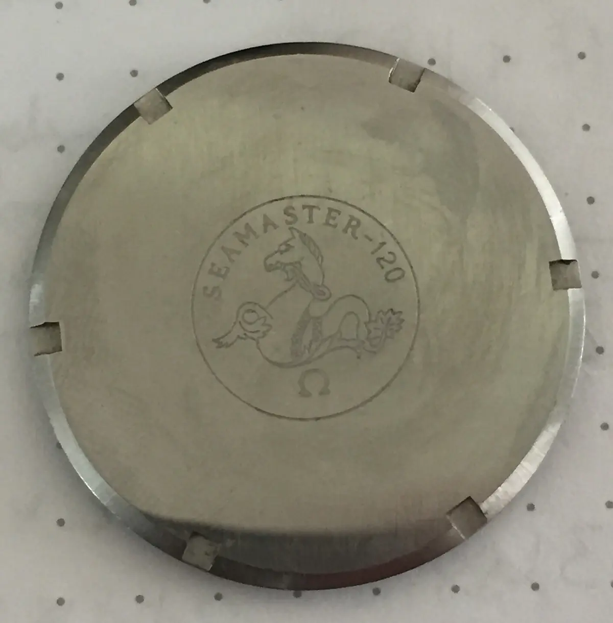

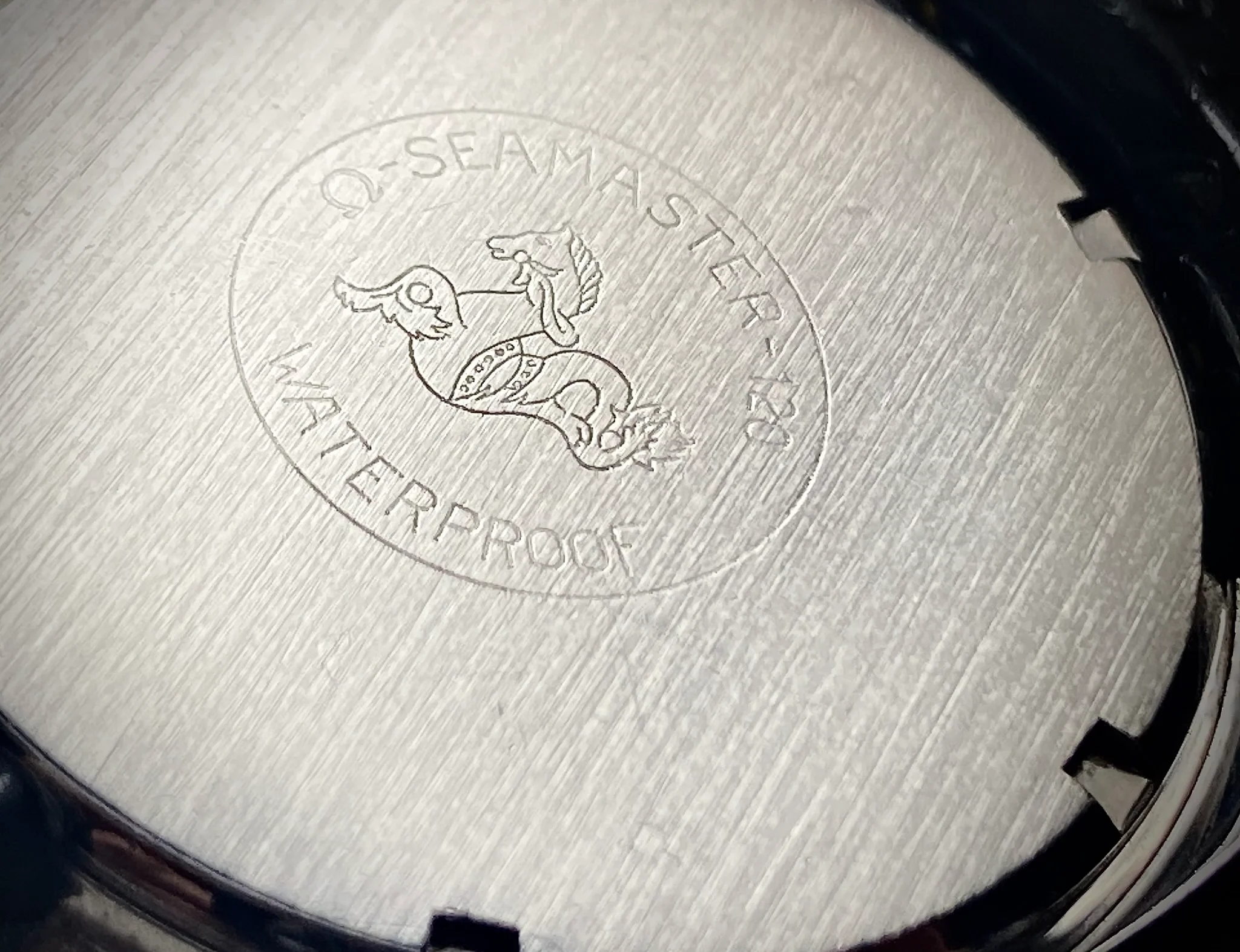

Derek John on page 24 said “Regarding the case back, I see that Black Sharie and Gemini4 had similar ones." Here is his response:
"After a long search of the Internet it would appear from the Omega archives that the case back on the left is for the 1970 production models of the Seamaster 120 for the USA market.” This is the one I have on this watch."
From my flat back case inside:
This is from my watch bezel:
Derek John's photo:
323
1,134

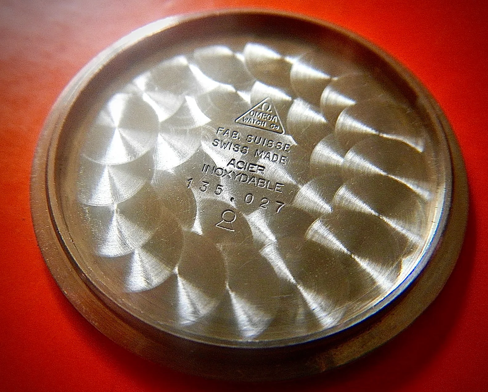

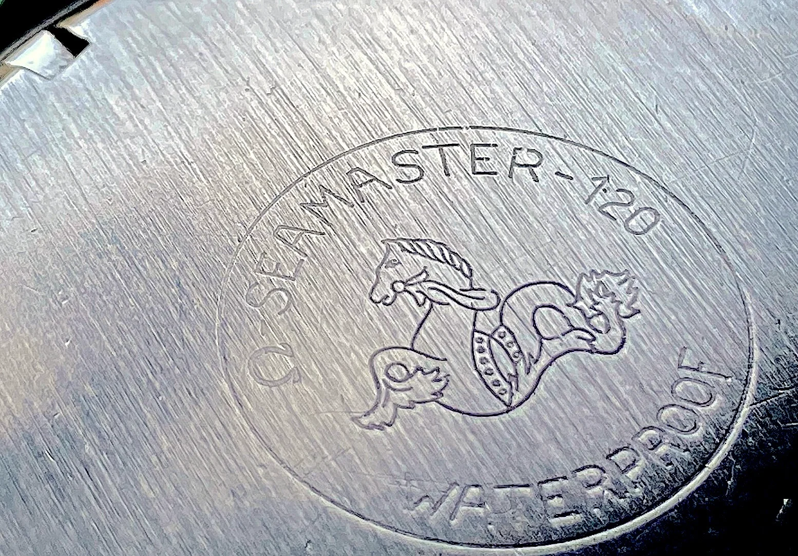

Here is a short follow up on the less typical case back found on later model Seamaster 120 manual wind, no date models delivered to the USA.
I did a quick internet search for the 135.027 model with the caliber 601. More specifically I was looking for the watches that had both outside and inside photos of the less common case back matching the photo example below and also included photos of the watch movement showing both the serial number and the number of jewels. Watches with 24 jewels would not have been delivered to the USA at the time these watches were produced; the 17 jewel movements were for the USA market. All examples I saw with my photo criteria had 17 jewels and none were 24 jewels. While the list below of examples are a small sample size, these do provide a little more information beyond Derek John's (page 24) statement that I referenced above. I hope this is informative to interested readers of this thread.
Case back common to all examples:
