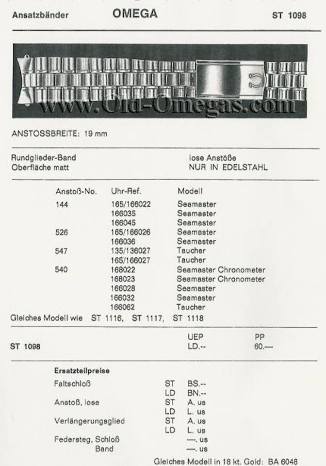

Thanks, I've seen that but according to this document the 547 links are correct.
Can anyone confirm if they have fitted 540 endlinks to a Seamster 120?

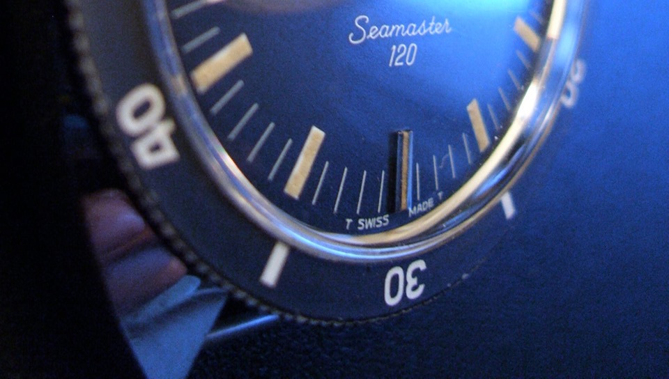

I think it’s important also to address the grey writing, while I cannot 100% confirm that the grey writing dials are fake, I can make a very educated assumption that an overwhelming amount of vintages pieces have white writing. This includes ones in great shape and ones in not so great shape.
All grey lettering dials appear on the watches that are labeled “like new” and “NOS”. The grey also appears on some very sketchy Etsy and eBay sellers who are labeling their fakes as like new.
So I would advise members looking for an authentic Seamaster 120 to read this thread and “Say Na To The Grey”.
Yeah, it's getting more difficult to tell between fake and service replacement parts. The grey writing along with almost all of the differences, from the bezel to the case and the dial (sold as the kit), alone are not exactly conclusive that all of that is fake. Remember that the "watchco" SM 300 is different to the vintage SM 300 in everything visible. It was easier with the old fake, but even the OP of this thread bought his fake SM120 and for a while thought it was all service replacement watch, until I pointed out the fake parts.
I have a 1067/532

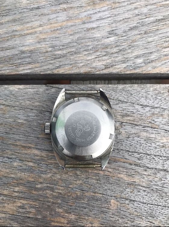

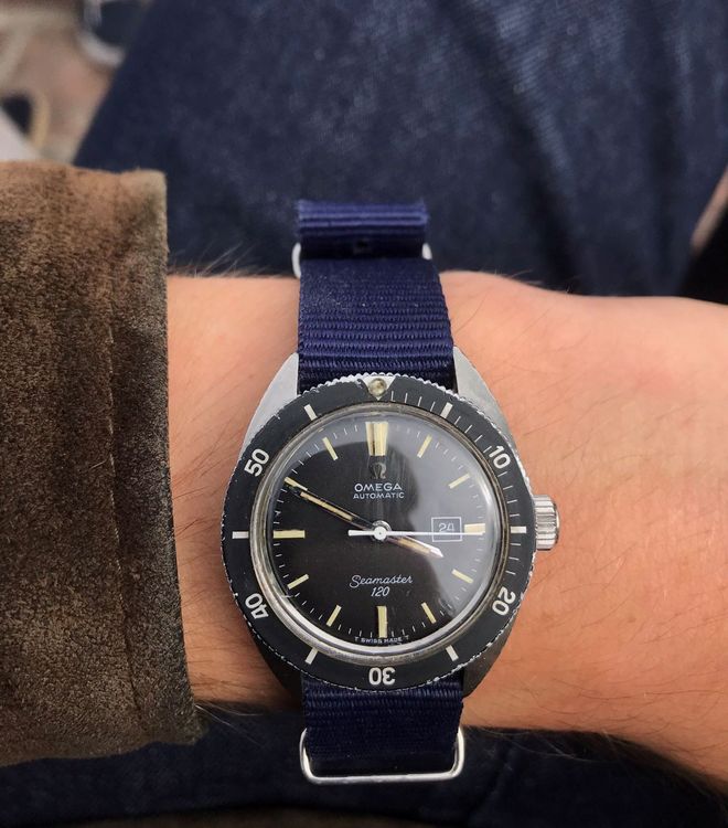

Hi Guys
I know, it’s not much. Just twi pictures.
What do you think about the dial and back of the watch? Anything suspicious?
Asking for a picture of the movement.

Hi Guys
Thx!
Nothing suspicious... but I think it is the women's version (small size).

Hi Guys
Thx!
Yep it looks like the small version which is worth considerably less and isn't really any good for an adult male.

Hi Guys
Thx!
ladies version .. looks all orig

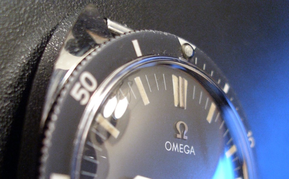

Beside the the lume pip difference in the first picture, nothing looks fake on this watch. You guys needs to study this model family more carefully.

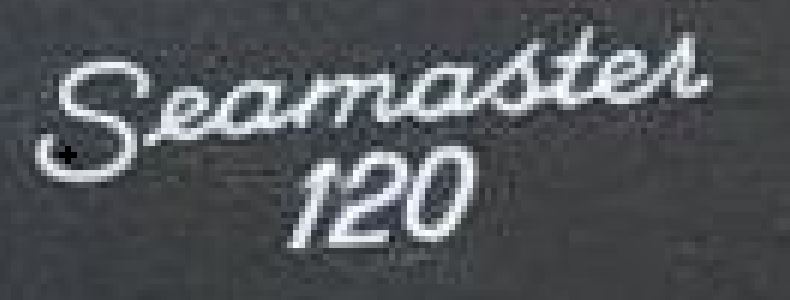

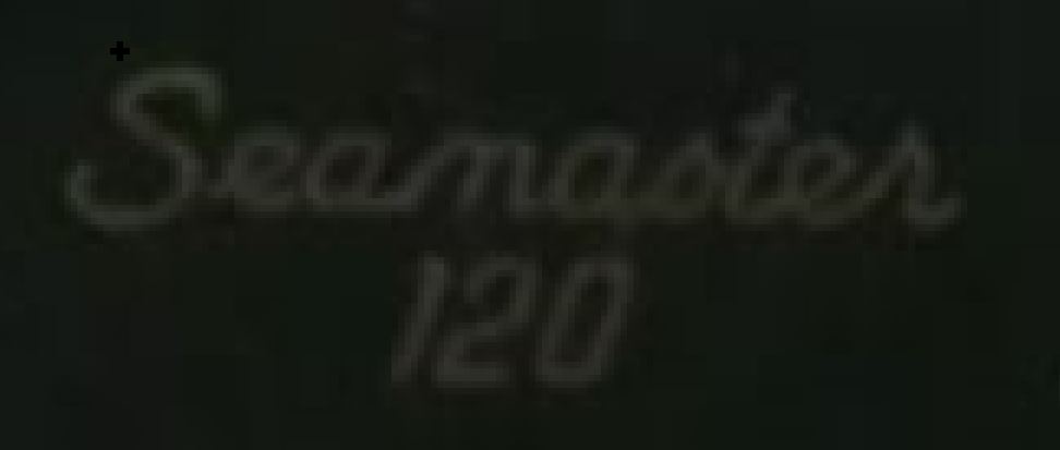

They've spelt the word Seamaster "SeaNaster" (small "n" ) on the green dial and bezel one, It's very close but if you remember doing joined up writing at school over and over again, there is no initial post to the "m" on the fake, and that's apart from all the other irregularities that you can see, spelling i'd have thought would be pretty important, the key thing the counterfeiters rely on is that we want to believe it's real, so we look for reasons to prove that, we're eternally optimistic about our latest watch-need, when really it's healthier to be sceptical until there's nothing left to disbelieve about it, the burden of authenticity proving should lay with the seller, but an optimist with cash is their best friend, and if the optimist is impatient then what more does he need, play the waiting game, with a little bit of "lots of interest in this one" just for good measure
in my opinion the real one, poorer resolution but still visible and proper "m":
And again my opinion the fake with the "n", slightly better resolution than the above photo so should be more visible
