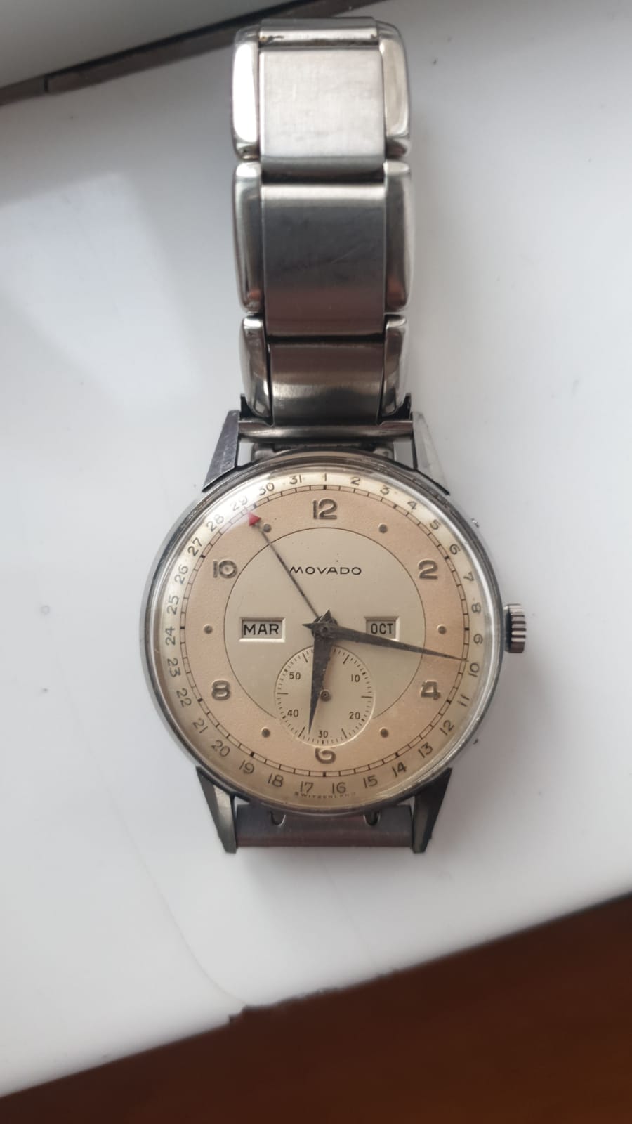

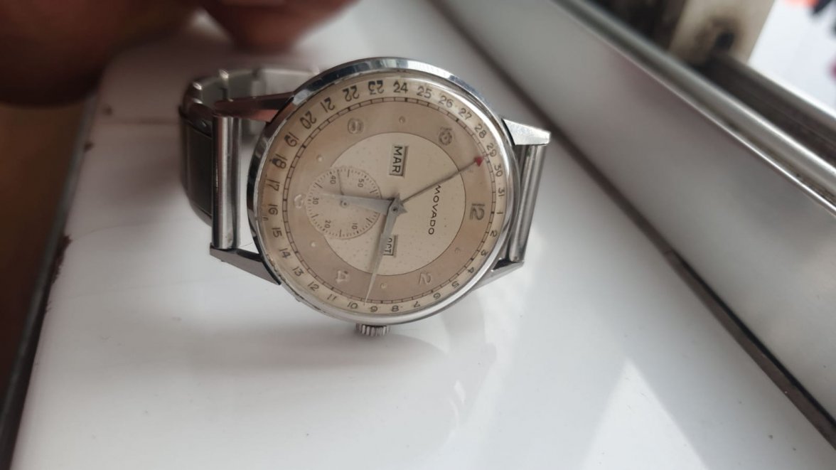

I love vintage Movados and I have the chance to get this one, not very cheap but price is reasonable . Do you think that the dial is original or redial ? I really appreciate your help. thanks, David

I vote original.
The dial has “Switzerland” spelled out on the bottom. Most rediallers miss this detail.

I vote original.

Thanks , hope more people give some comments as I’m a bit under pressure: buy or not to .... as I have another guy waiting for and don’t want to loose it

Looks fine - no evidence that I can see of it being a redial.

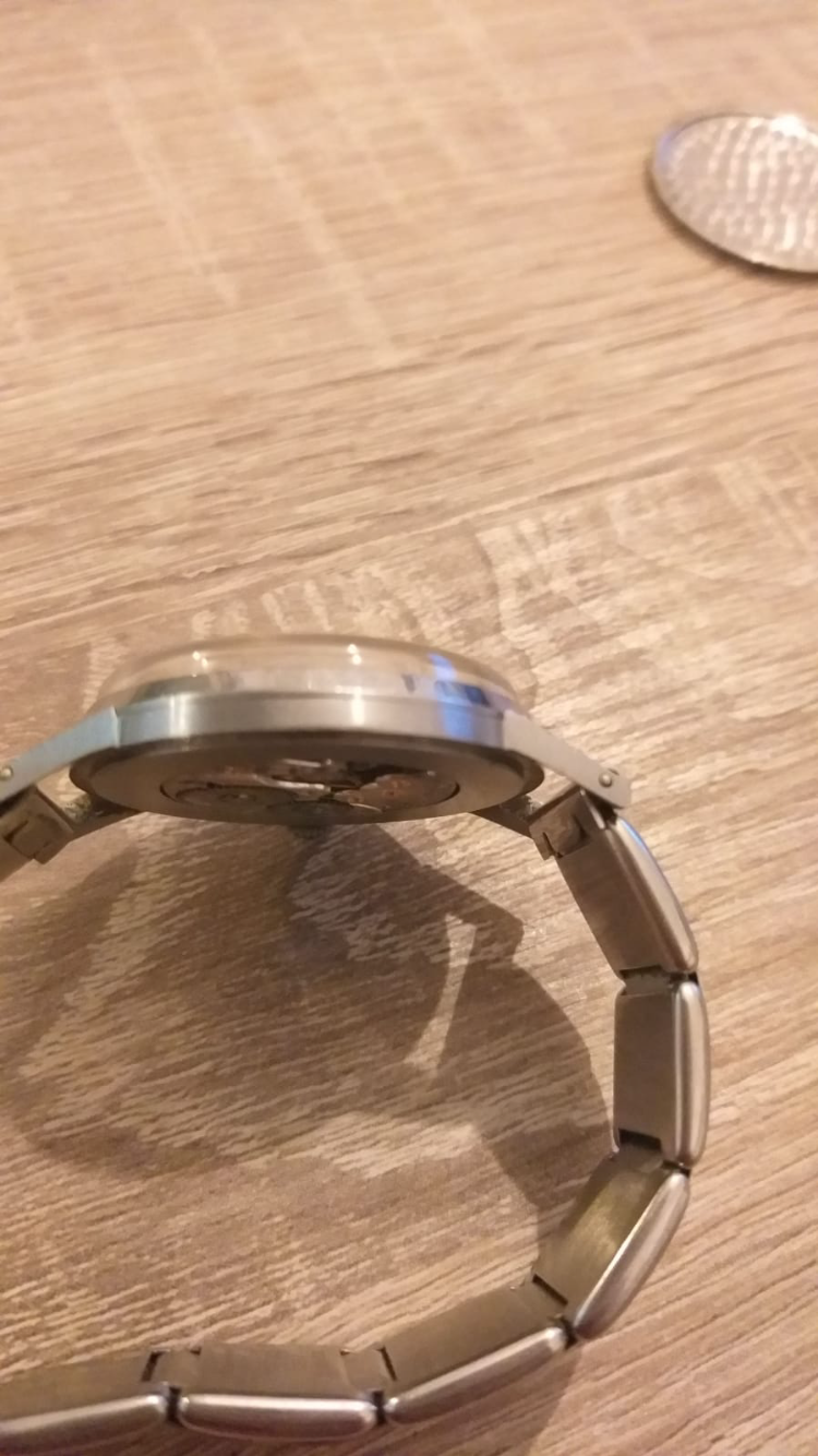

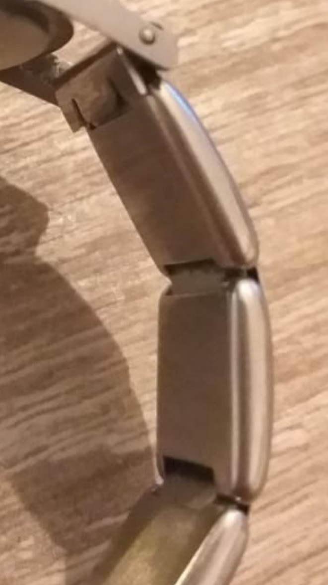

I’m sharing some pictures of the bracelet, see the part that is attached to the watch case, not very usual for me. What are your thoughts?

Looks ok to me. I think the bracelet may be a Kiefer-Cadman Expandro.

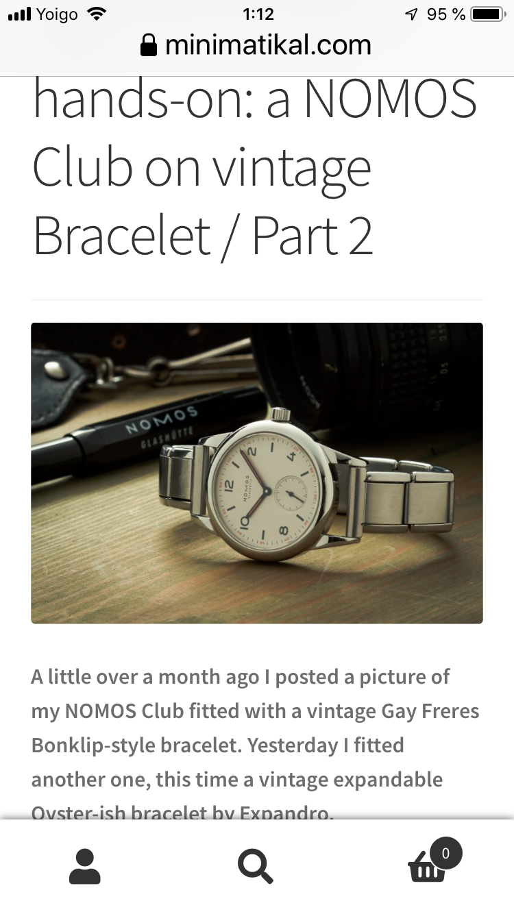

I just find out from internet that it is GF bracelet
See that picture

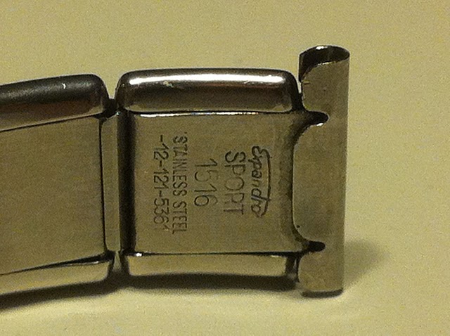

No, read that caption again, this is not the photo of the GF bracelet. It's an Expandro as I said.

I suppose so, maybe GF put their name on a bracelet like that, although that bracelet is generically called an Expandro and was sold under the "Expandro" name and several brand names, including Kiefer-Cadman, Henry & Cie, etc. Most likely it's not branded by GF, but even if it is, it doesn't add much value. If you put it on eBay it wouldn't bring $50 IMO. So just value the watch without the bracelet.
The more desirable GF bracelets are generally the "original" bracelets they made for specific watch brands and models (Eterna, Zenith, etc.).

Dan S, you are right . Now I saw the pictures of Expandro and the inner end links look like the one on the Movado. Thanks for your input
