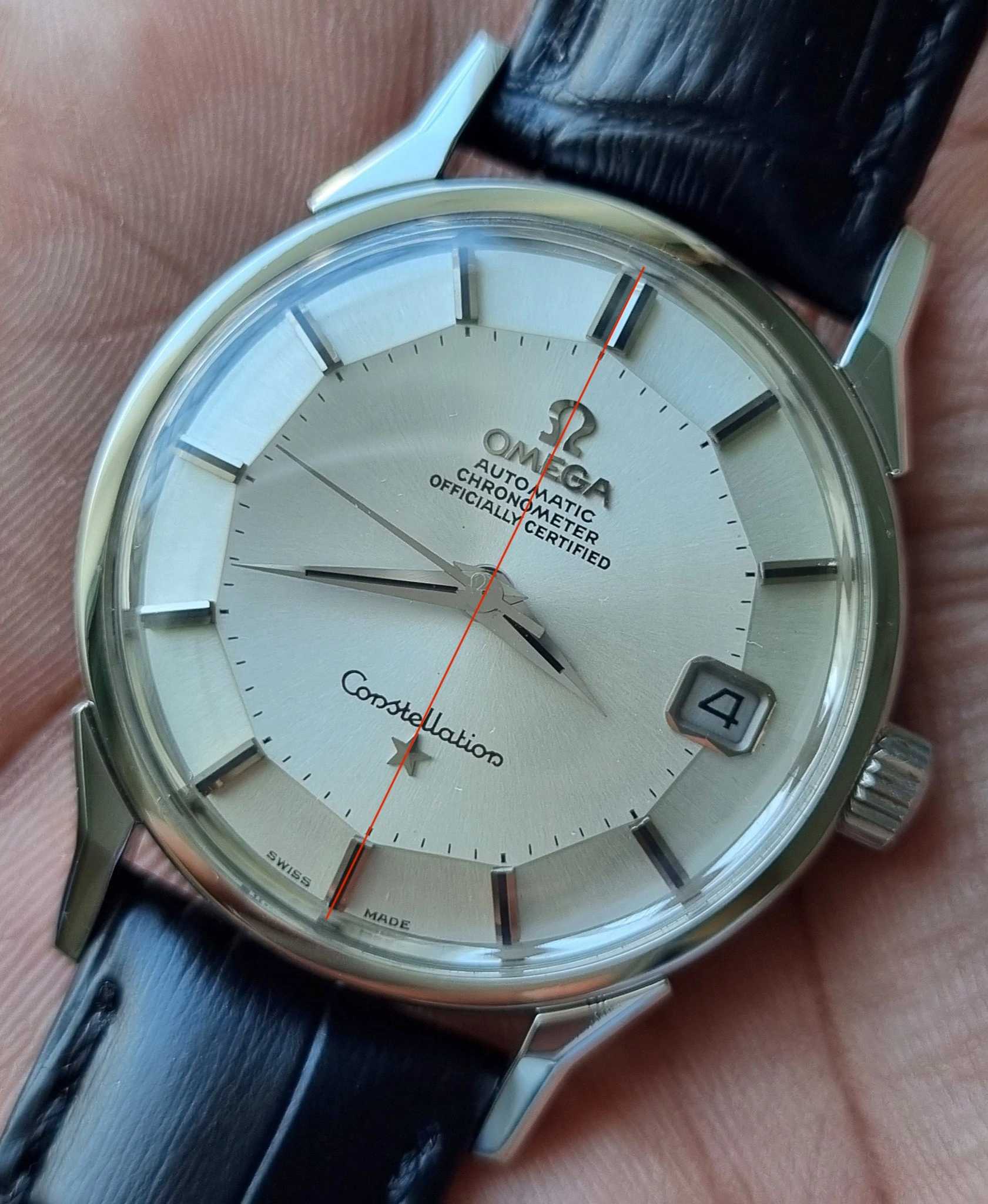

Do you think it's a redial?
53
13
I find this 168.005. I think it's a redial because the script is too thick, and the length of "AUTOMATIC" should have relatively same length of "OMEGA". Also, it seems to not pass the MOY test. I need help from people who have more experience to confirm/correct me. Thank you.
Sorry that there's no close up photo.

@taworn
The size (width) of the text does differ - likely due to different dial manufacturers.
Trawl through the 167.005/168.005 thread and you will see some narrower versions starting as far back as the earliest doglegs.
The font does look a little thick but I wouldn鈥檛 dismiss this dial out of hand because of this alone.
The watch has painted indices, so a later version - this may explain the overall dial style.
13,690
19,068
If this is a redial, it鈥檚 a very good one. However, the only way to judge this is by seeing in person.
The steel case looks like it has had a heavy polish. The sharp folds on the lugs have been rounded.
Do not pay top dollar for this watch.

@taworn
Yes, it did. Maybe, somebody commented then decided to delete it. So it may be an original. I'll check the thread thank you.
53
13
gatorcpa
I won't buy this one. Thank you for your recommendation. I also don't have much experience to see Constellations in person. So every time I do, I can't really tell if it's redialed and it's very small. Do you have any recommendation what to focus on? However, I can tell better if I like the watch or not in person.
18,330
27,698
Did a previous response disappear?
Yes they said it was an obvious redial, hence my prepping the popcorn.
