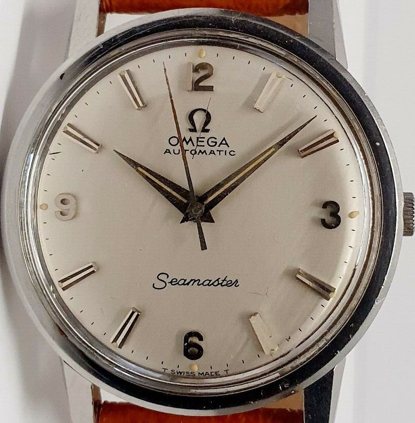

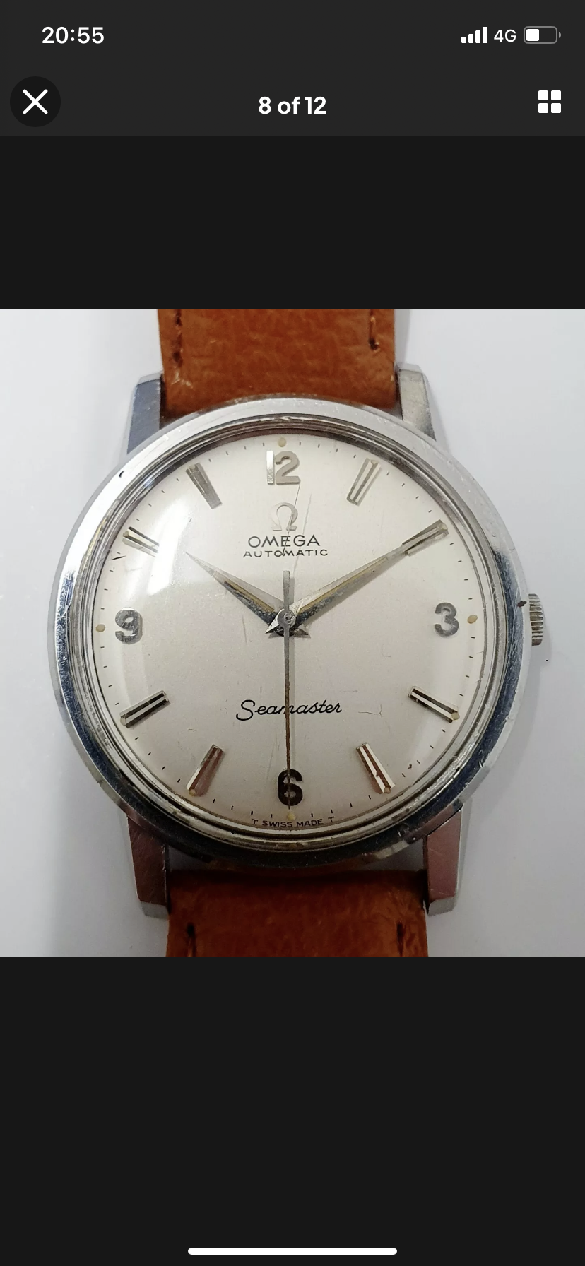

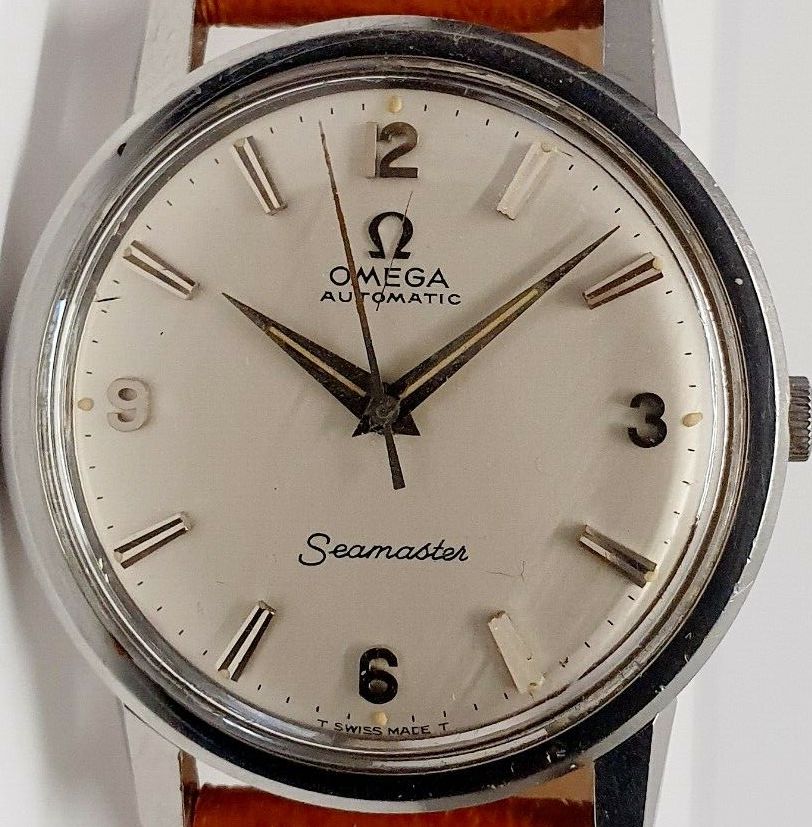

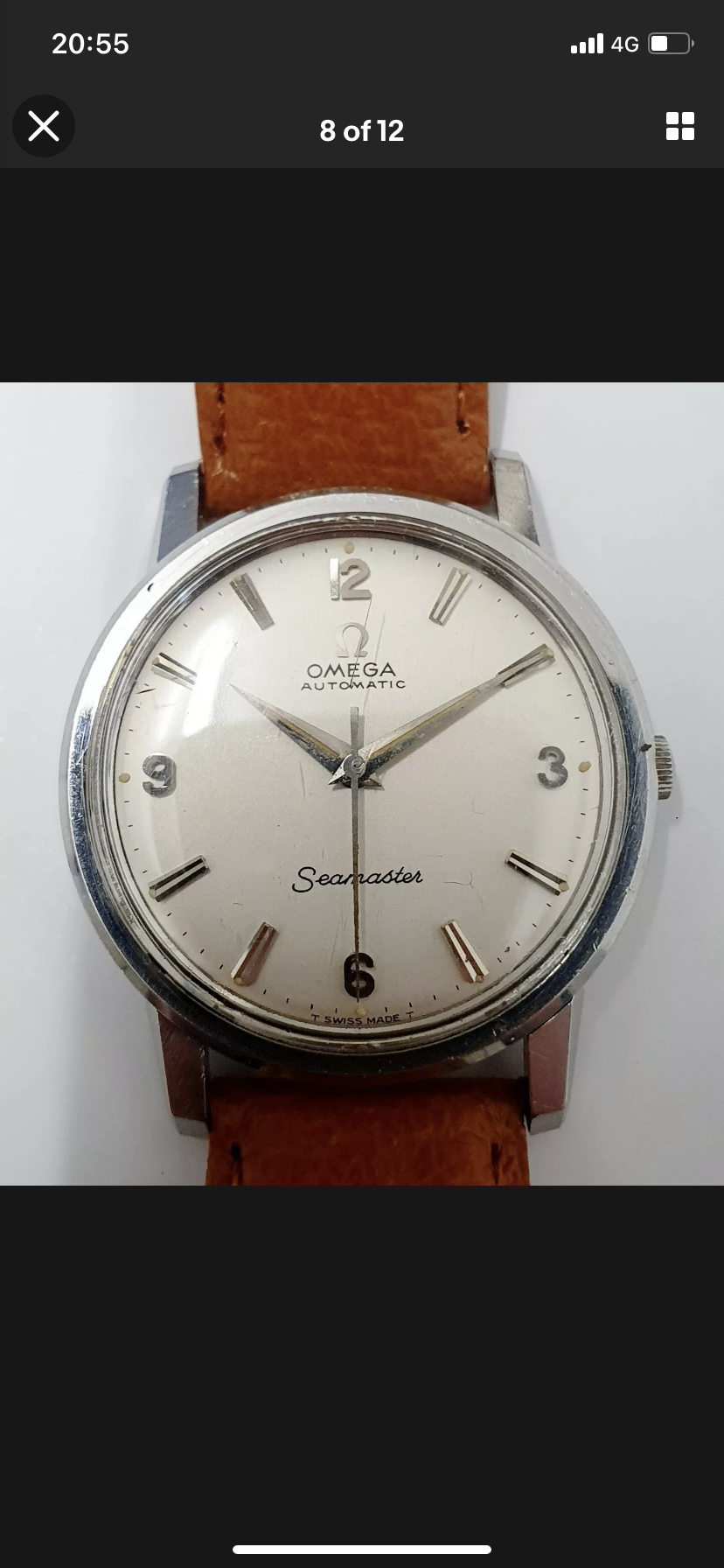

Just finished on eBay but it’s a redial right?
18,862
39,236
mmm lume @ 3
Crystal distortion, also known as refraction, when light passes through different mediums, like the curved edge of plastic crystals.
13,571
23,558
maybe so. The ‘automatic’ script in particular looks terrible. I was tempted to bid as I like the Arabic dials but couldn’t satisfy myself it was original.
1,120
1,792
Good move, I’m not convinced either.

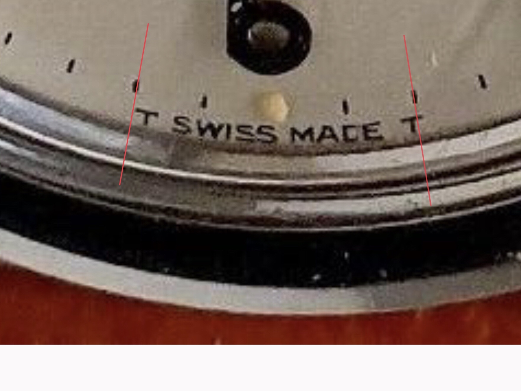

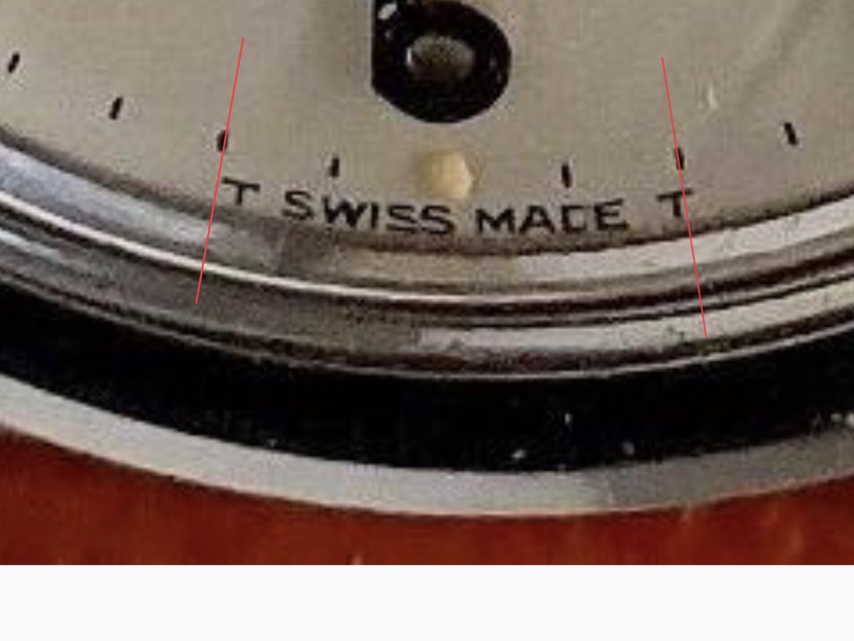

T Swiss Made T is way out of alignment with the minute markers.
1,589
5,749
Exactly …
2,684
3,168
I think the misalignment could be because of dirt, there's some dirt near the 24th minute marker too
