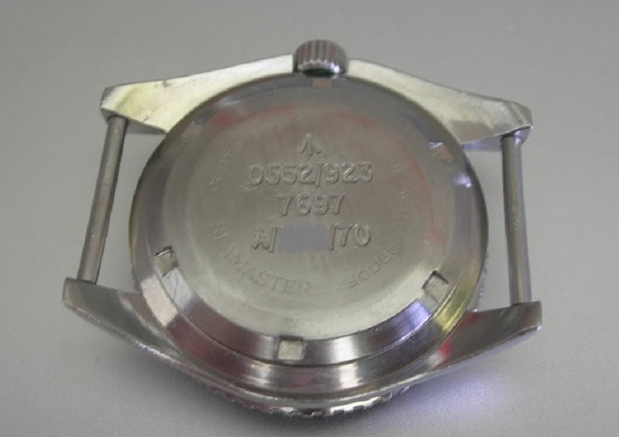

The Caseback engraving looks legit for a late 1970 Mil SM300.
However, the hippocampus and Omega Seamaster etc. writing do indeed look rather thin, but I think that could come from the slightly overpolished caseback. Definitely we need a good picture of the caseback inner side and a sharper closeup of the outer side.

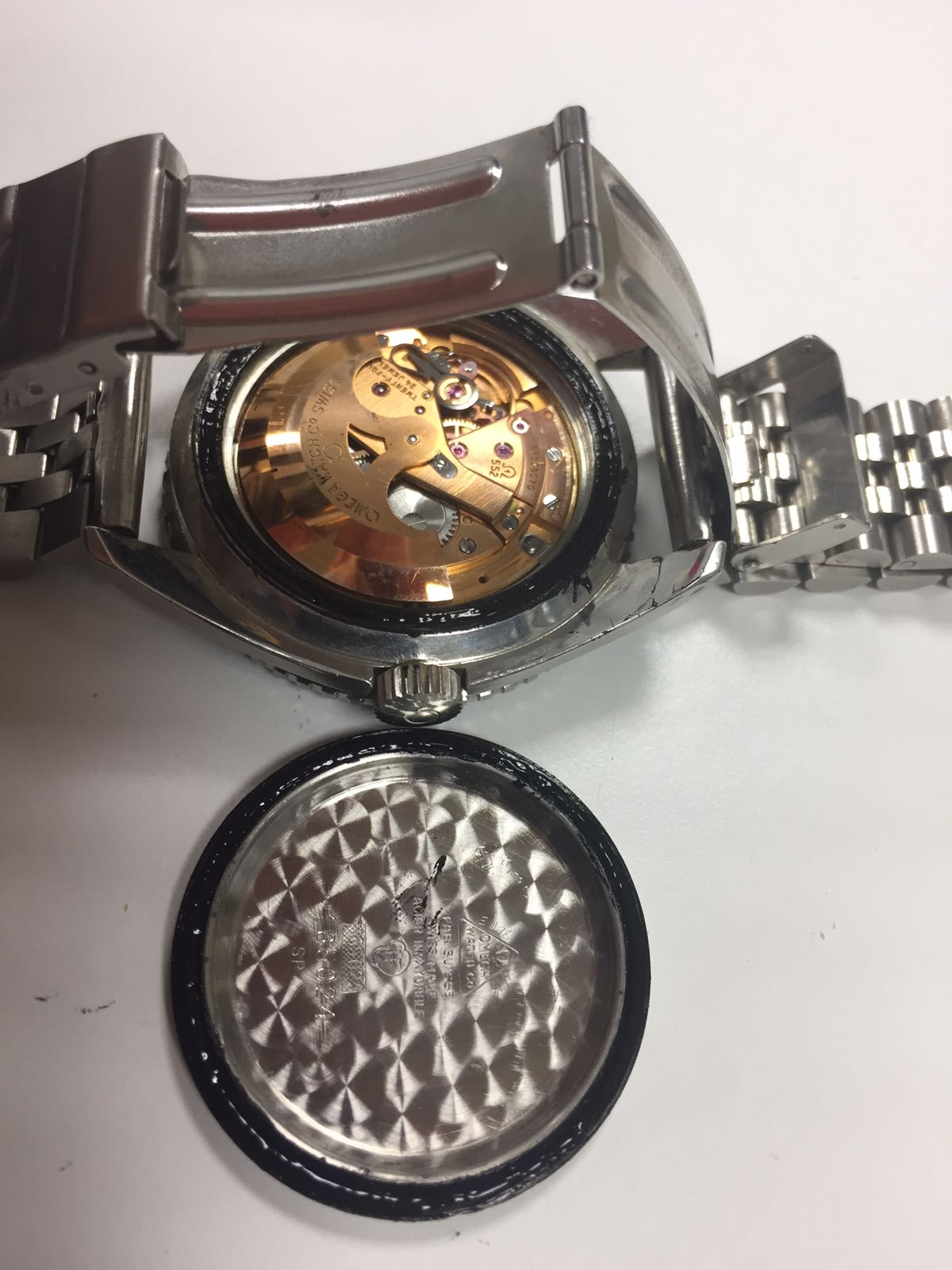

lots of information so much to take in and so much expertise in this field thank you! Our watch maker recorded the wrong calibre number, would you believe it. It's definitely 552, serial number 27508070. I will see if I can attach some images of the inside of the case.
I am not sure if the customer would want the bracelet removing, I am also going to be checking some provenance as it did belong to her uncle.
