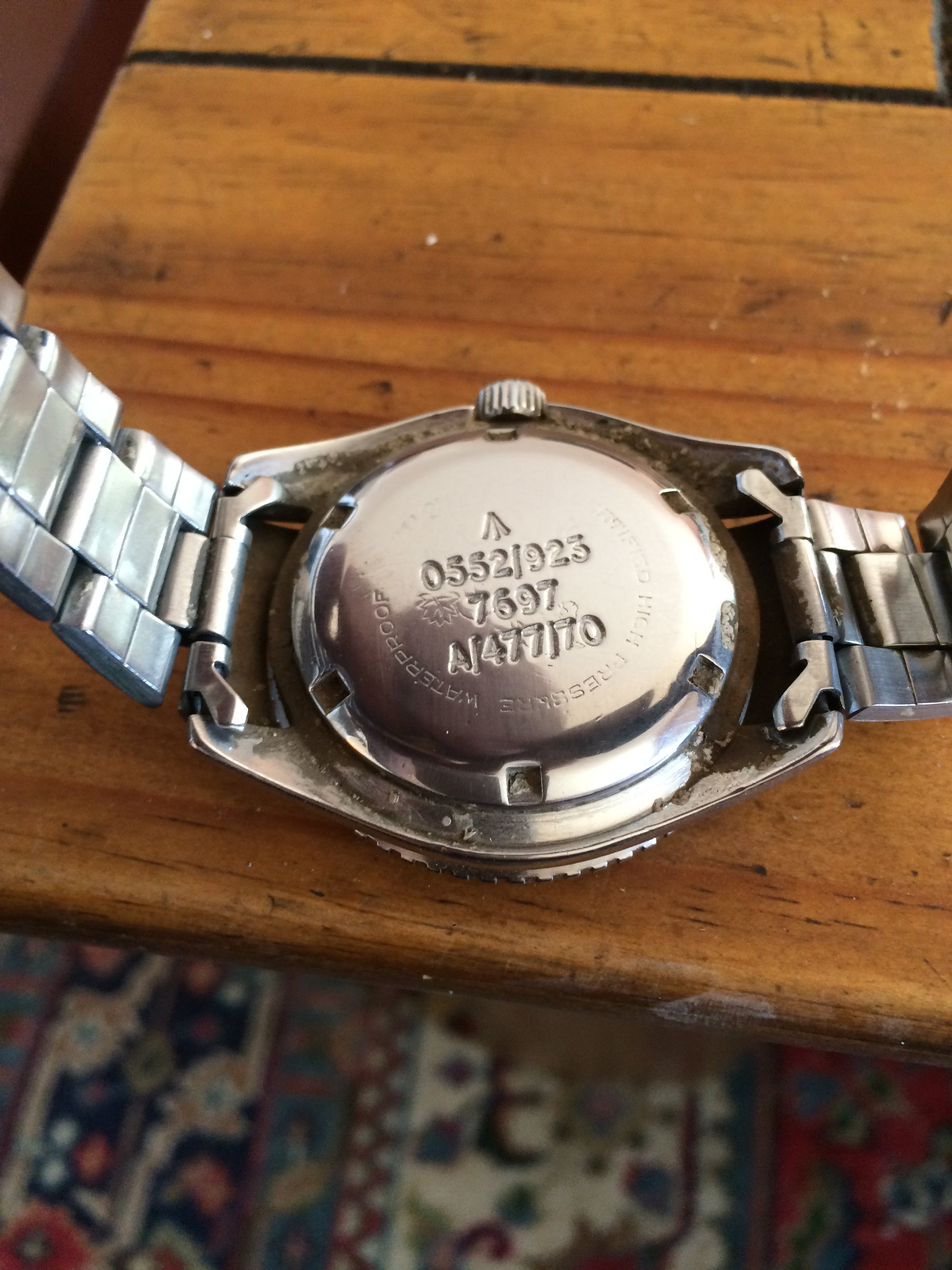

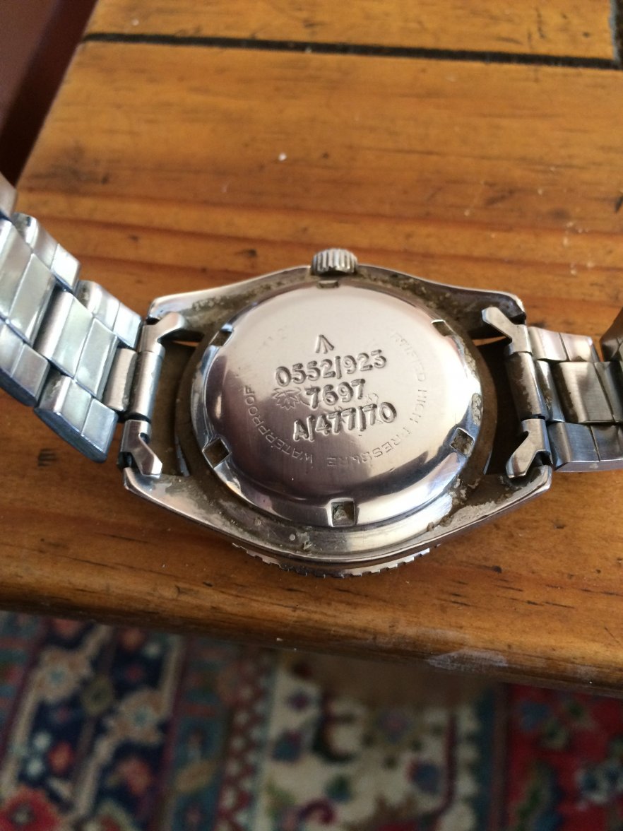

It's definitely 552, serial number 27508070.
Well, serial match the range 27.50x., seen on "many" 70 stamped RN300's, so properly ok in regards to movement being delivered to MoD or GoldSmith.

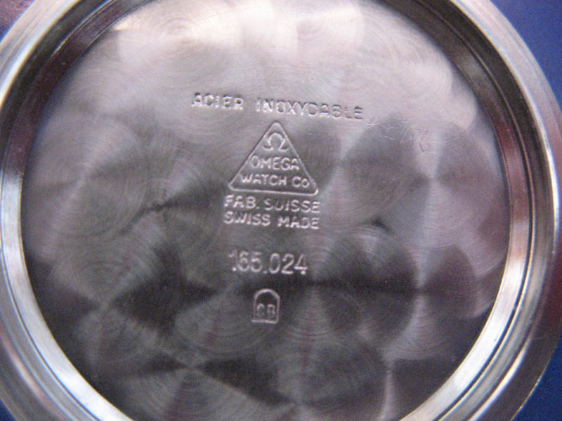

But I have a little issue with the caseback being a HF produced one (and the original reference no. crossed out also). I don't think I've ever seen a correct RN300 with a caseback that wasn't a CB produced one. Correct caseback inside markings pictured below.
And yes, again, these saw a lot of action and parts were exchanged heavily during service, but to me, a non CB caseback would lower the value. Not as much as a missing T dial etc, but still.

I am not sure if the customer would want the bracelet removing,
100% sure that the new owner does not want the bracelet 馃槈

There seems to be some black gunk around the seal??
That is the remains of the rubber gasket, shows it has not been opened recently and by recently I mean 15 years +

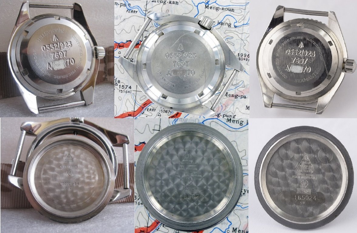

Well... it is correct that most MoD SM300 have CB casebacks, but regardless if Army or Navy issued. However, not all of them. Here we have three nice examples, all RN SM300 with HF casebacks, two even have exactly the same crossed out and re-engraved reference.
Source: put together from the MWR Forum and other sources I can't remember

-Caseback looks 100% authentic to me, outer and inner side
-Movement serial number is in the correct range for a 1969 production and 69 or 70 year of issue

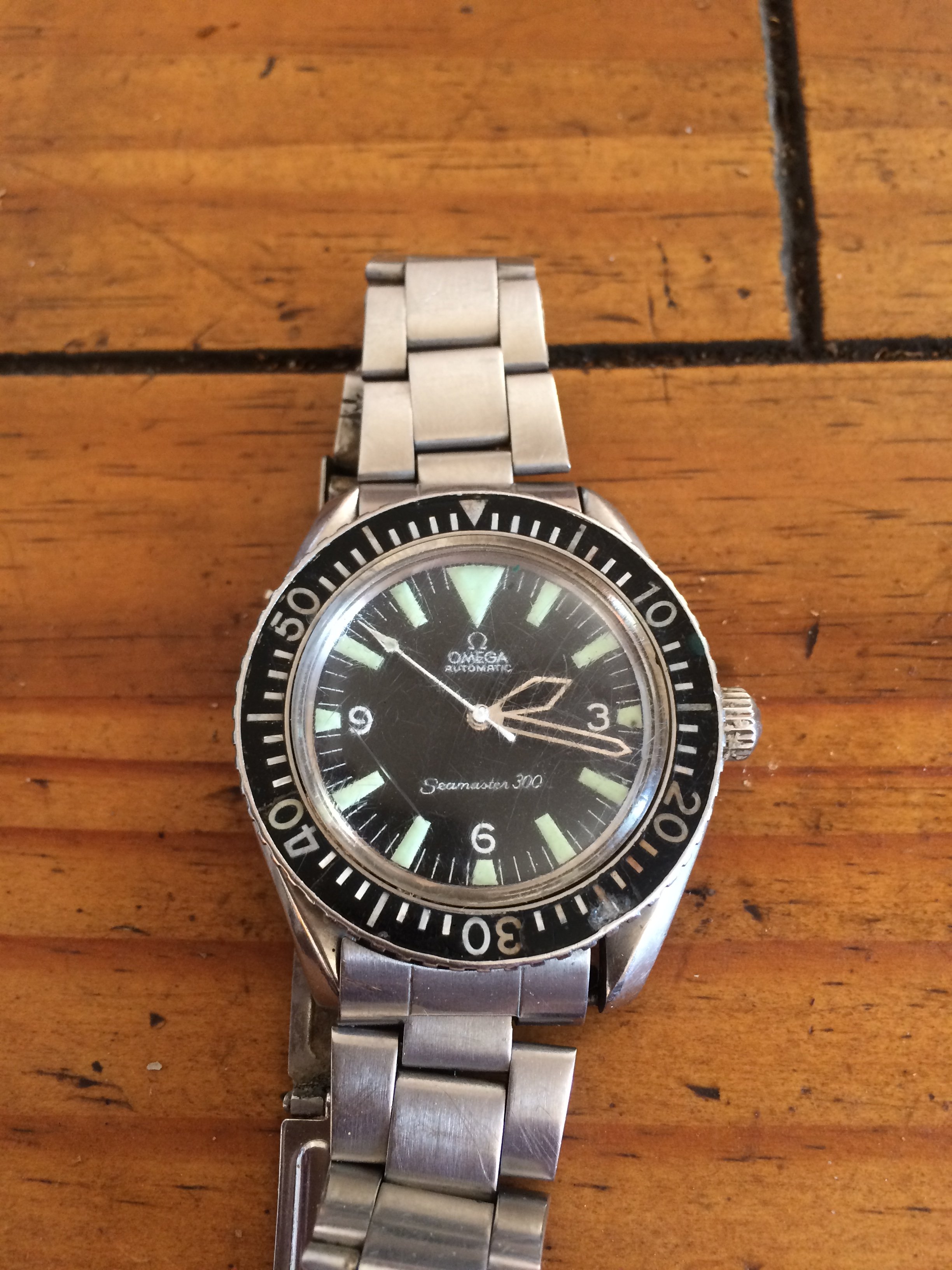

-Tell your watchmaker to remove that bracelet. Beside it's totally ugly it does not belong to that watch reference. And we have to see the (hopefully fixed) bars to get an opinion about the case itself. Could still be a put-together watch

And as Ash said, an 'Extract of the archives' will increase the value, even significantly when it shows "...delivered to the Royal Navy...". And don't forget to remove that wrong bracelet, the fixed bars must be visible. We still haven't seen them so far.

Hi all, very interesting thread. I am completely new to the form and would like some advice. The SM I have here does not possess the fixed bars but everything else seems to correspond as in the serials number inside etc. Also need to have the hands restored/replaced. Any advice would be welcomed, thanks.

Refinished Dial... caseback might be correct. 50/50. I might be wrong...

Yes I was told the dial was refinished by Omega about 8 years ago. How do I go about the military records search, any idea?

lovely pic!, yes I can see there are some circular markings. I will need to get back to you with the confirmation of the calibre and serial number etc.. and I should have a pic of the inside of the case and movement. Bit concerned that the crown is not screw down........ and no T on the dial.
