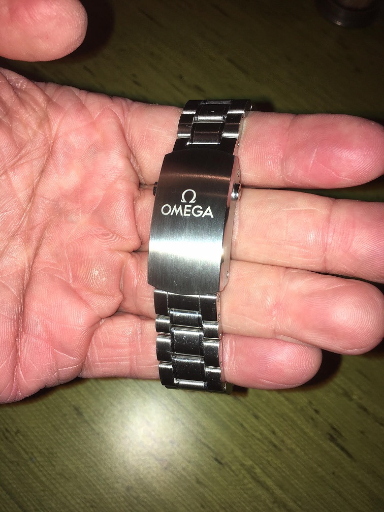

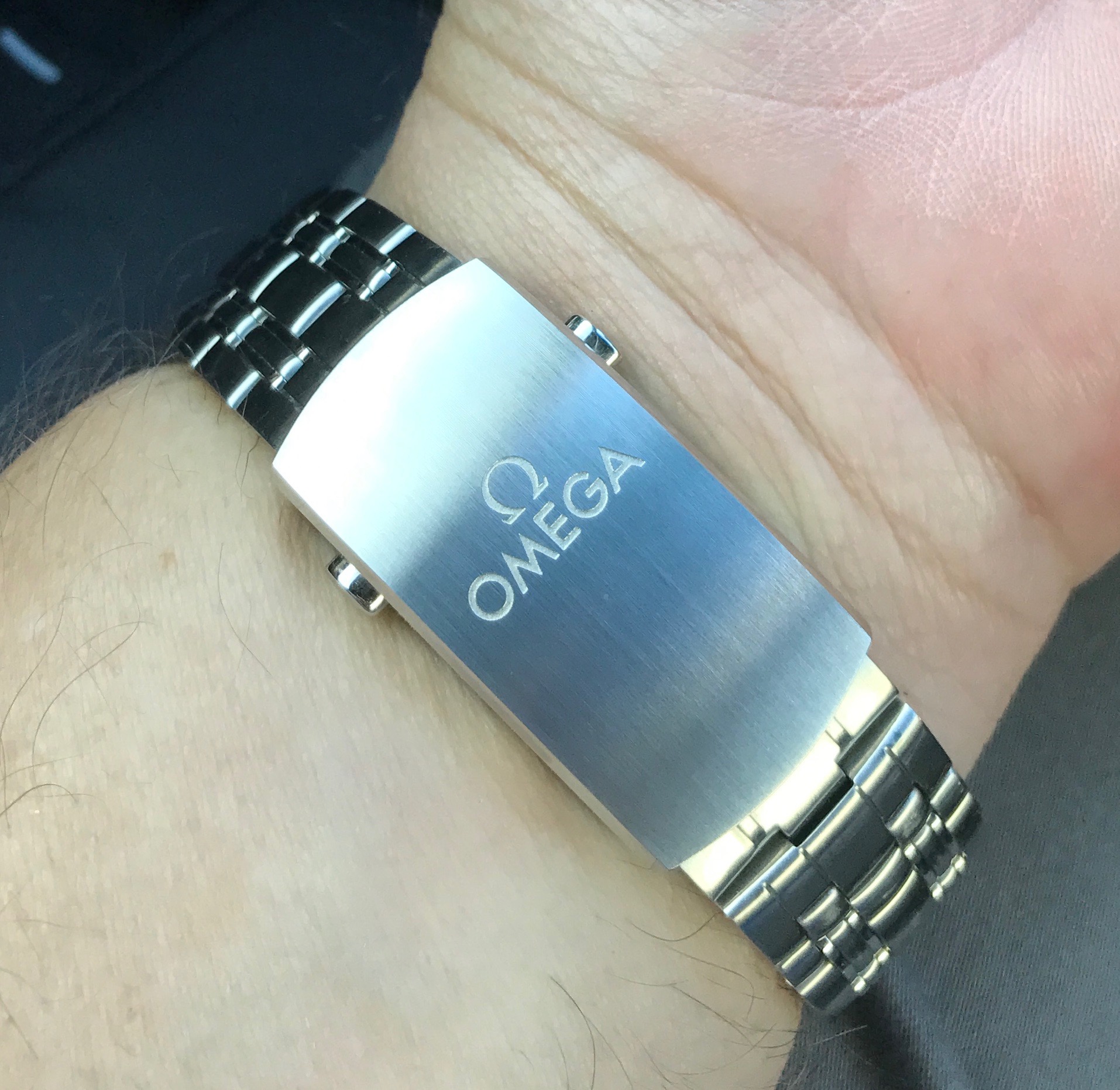

I no longer have the SMPc (kept the adjustable clasp), now own the exact same watch you asked about (Reference 212.30.41.20.01.002, below), but am putting on it the 1610/930 Speedy style bracelet instead. In my case, had to purchase the additional end link conversion pieces in order to make it work on the 1610/930 but on the Bond style it is an easier fit as you don't need anything else.

Hi. You just need to buy the 4666, 1154 or 1159 clasp and it will fit, the end links on her watch does not need to be replaced. The clasp will be a little wider than the one that comes with the watch, but would not look bad. The picture below shows the 1154 clasp installed in my former 212.30.36.20.01.002

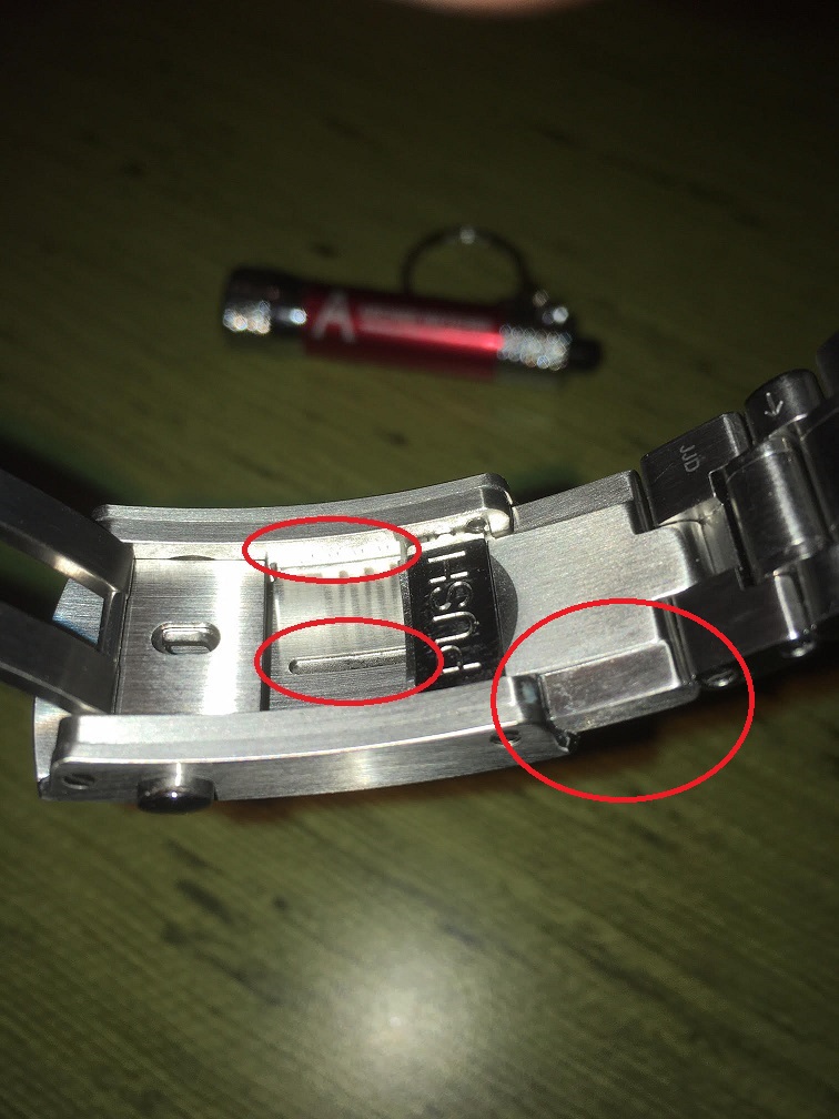

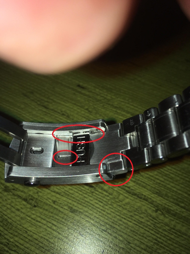

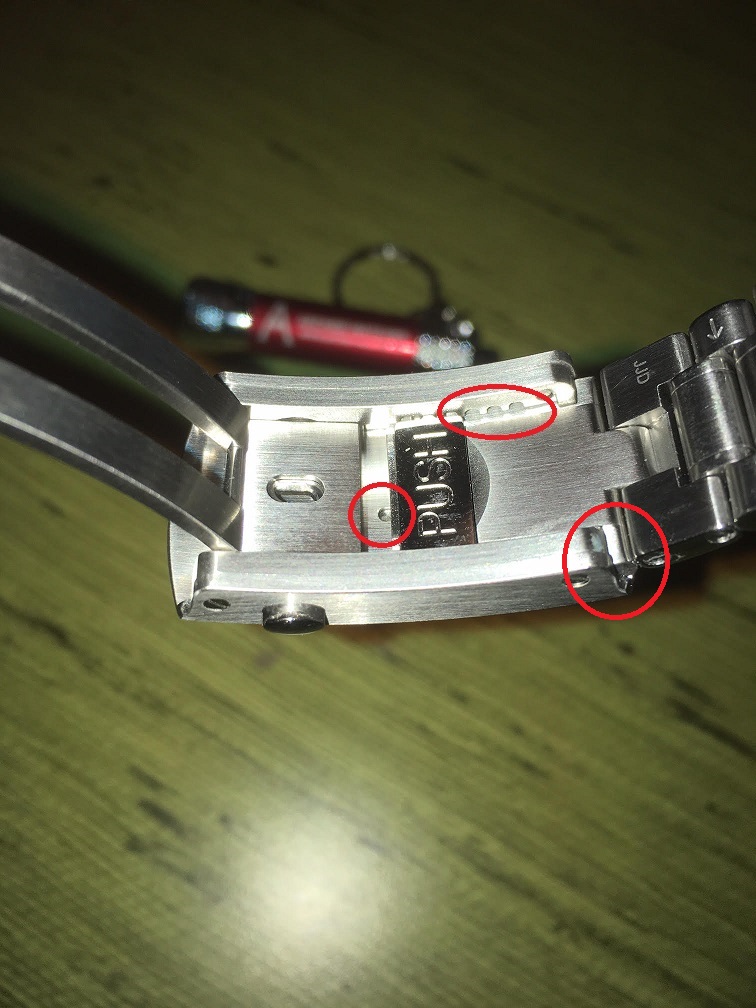

Already a ton of useful info here. I thought I would add a couple of photos. The camera flash obscured the notches, but they are visible in some of the other photos. These show a little of the adjustable settings:
