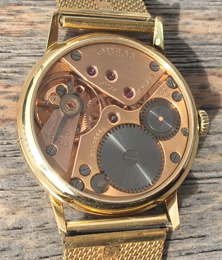

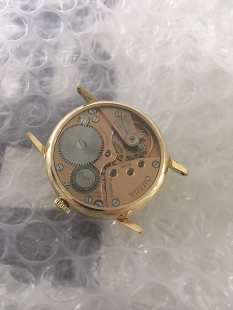

All, I know this is an old thread, but two years later...I finally got the back replaced on my 1964 caliber 269. 😀 It got stuck in the safe for a couple of years, but this fall, I decided to get a new back fabricated for the watch. I looked around for a 121.003 18K used back, but never had any luck. So I did use Peter Wuischpard at www.watchcaserepair.com to fabricate a new back. He did a fabulous job.
I lamented the decision of getting an 18K gold replacement or a clear back, which I've always thought looked cool. So, I had him create a crystal back. He made an 18K gold bezel...not actually 'the' bezel, but rather a ring that holds a crystal back, and then set in the sapphire crystal back. It cost $500, but far less than the $5000 that the Omega vintage repair facility in Geneva quoted me.. Including a picture.
18
11
Thanks, Paul. 😀 Added another picture in the sun with the bracelet on.
