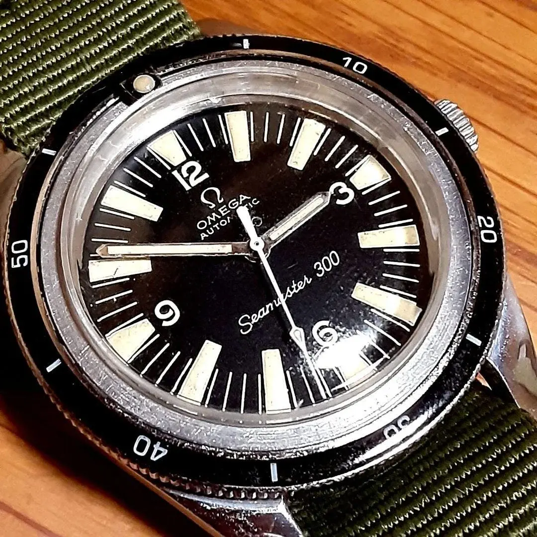

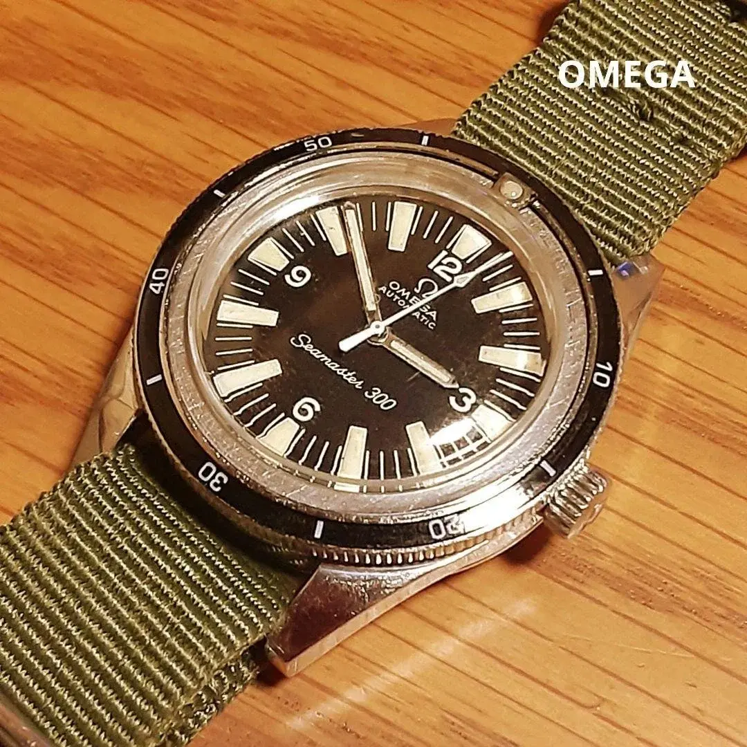

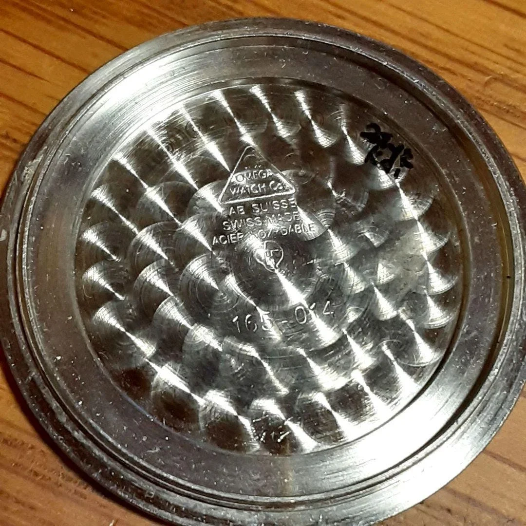

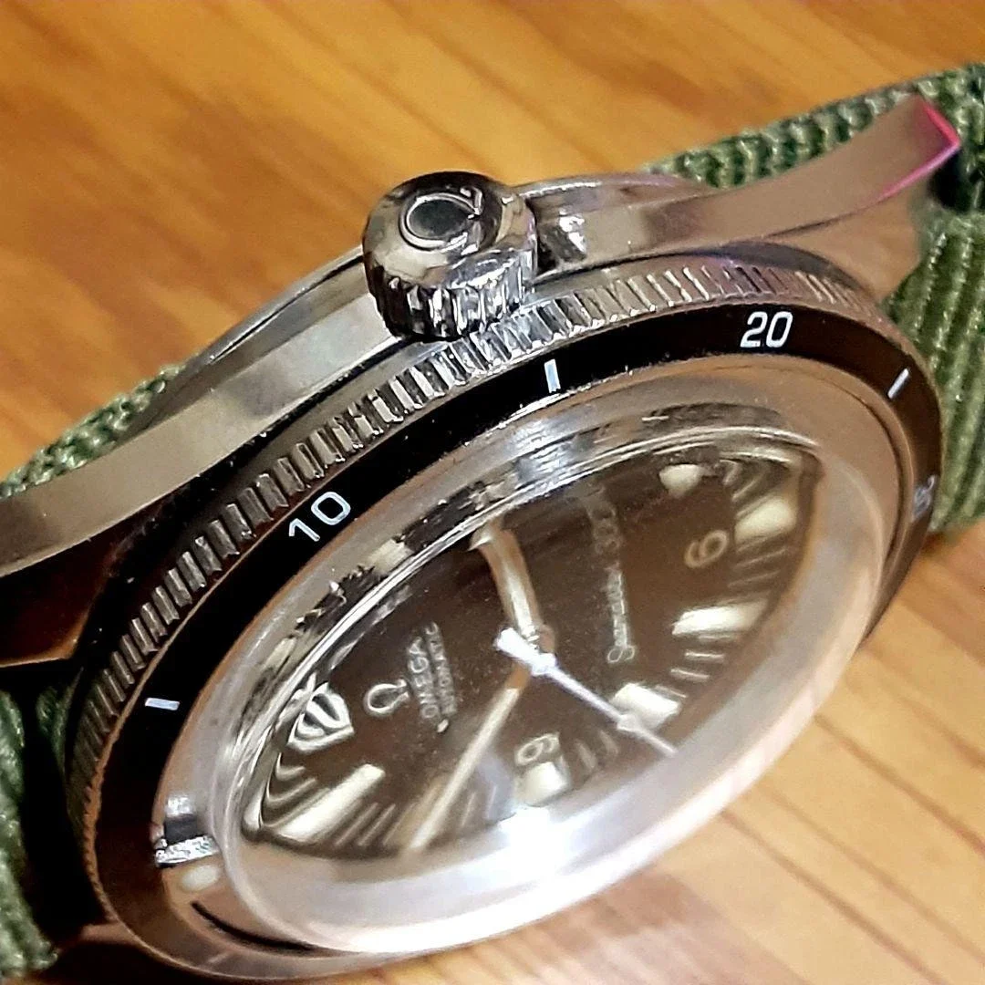

So now the question, which is regarding a specific sales post on Ebay: https://www.ebay.de/itm/388742028465 :
Might this be an original in this combination? I get really confused with so many new things, but here are my thought so far:

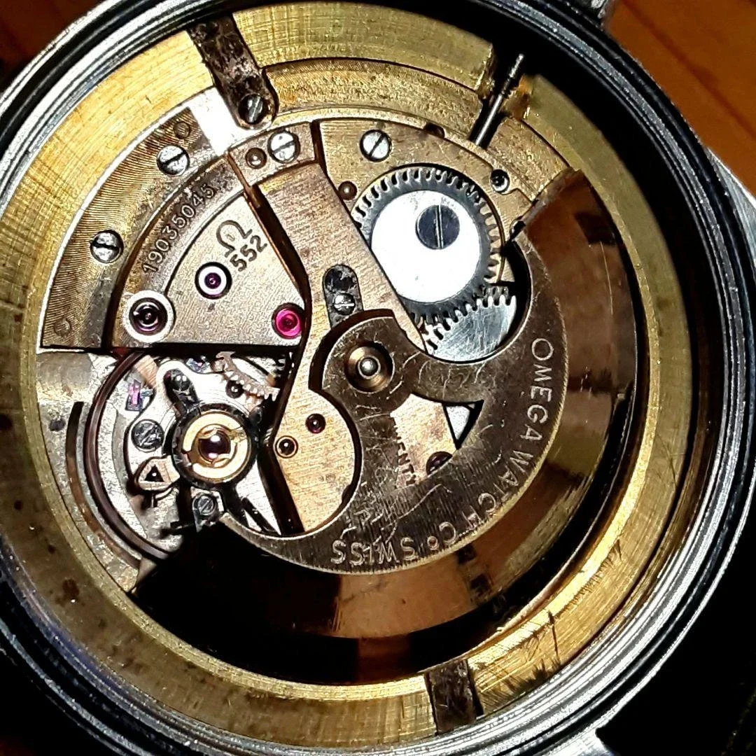

  • caliber 552 ist correct, the serial no. suggests 1962, which should be right for an early 165.014

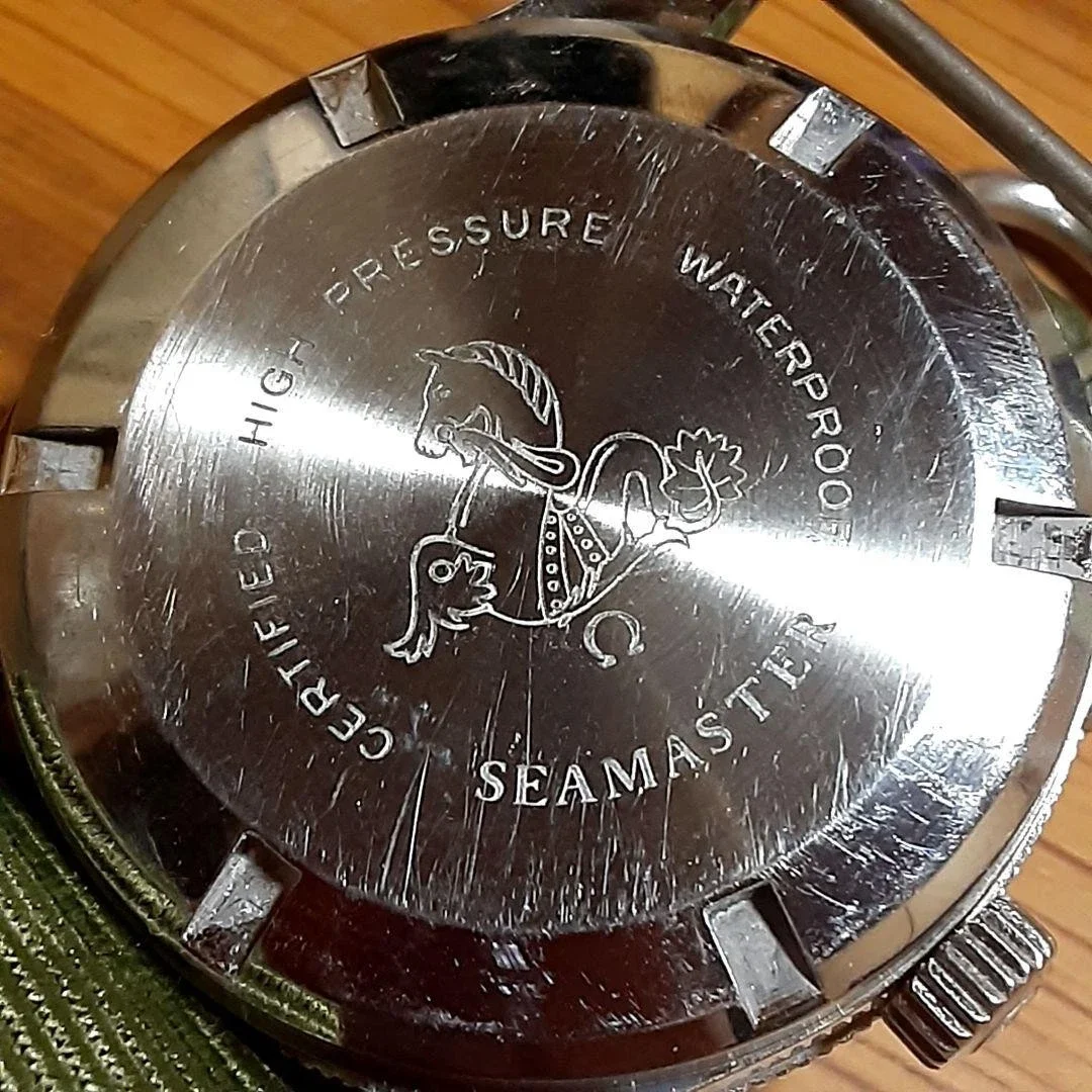

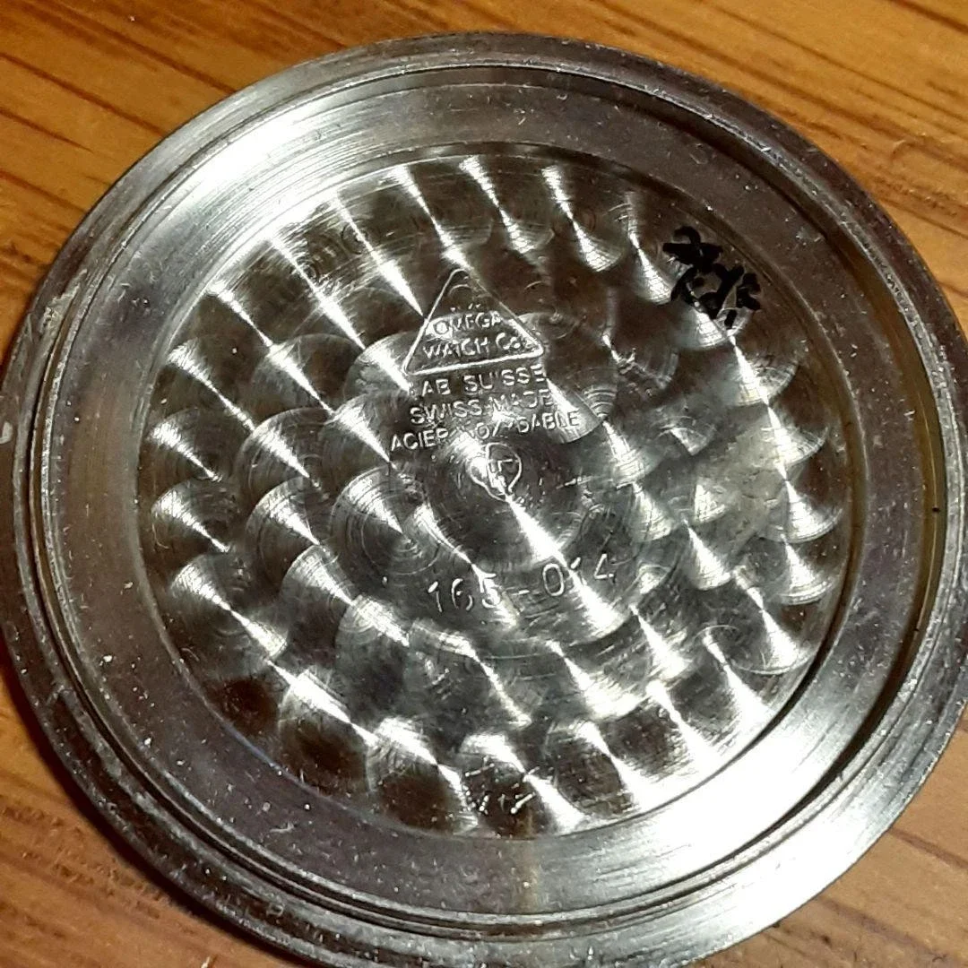

  • the case back has 165-014 stamped inside. Most of these I found have 165.014 and the year behind the dash. I first thought this was wrong, but it seems that in some rare cases the model no. is actually written that way (found a simlar case back photo here https://www.omegaseamaster300.com). Not completely sure though.
  • the crown should be a Naiad crown I think, but do all of them have that little Naiad star sign in the middle of the Omega logo? If yes, this would be a replacement crown (which would be fine for me).

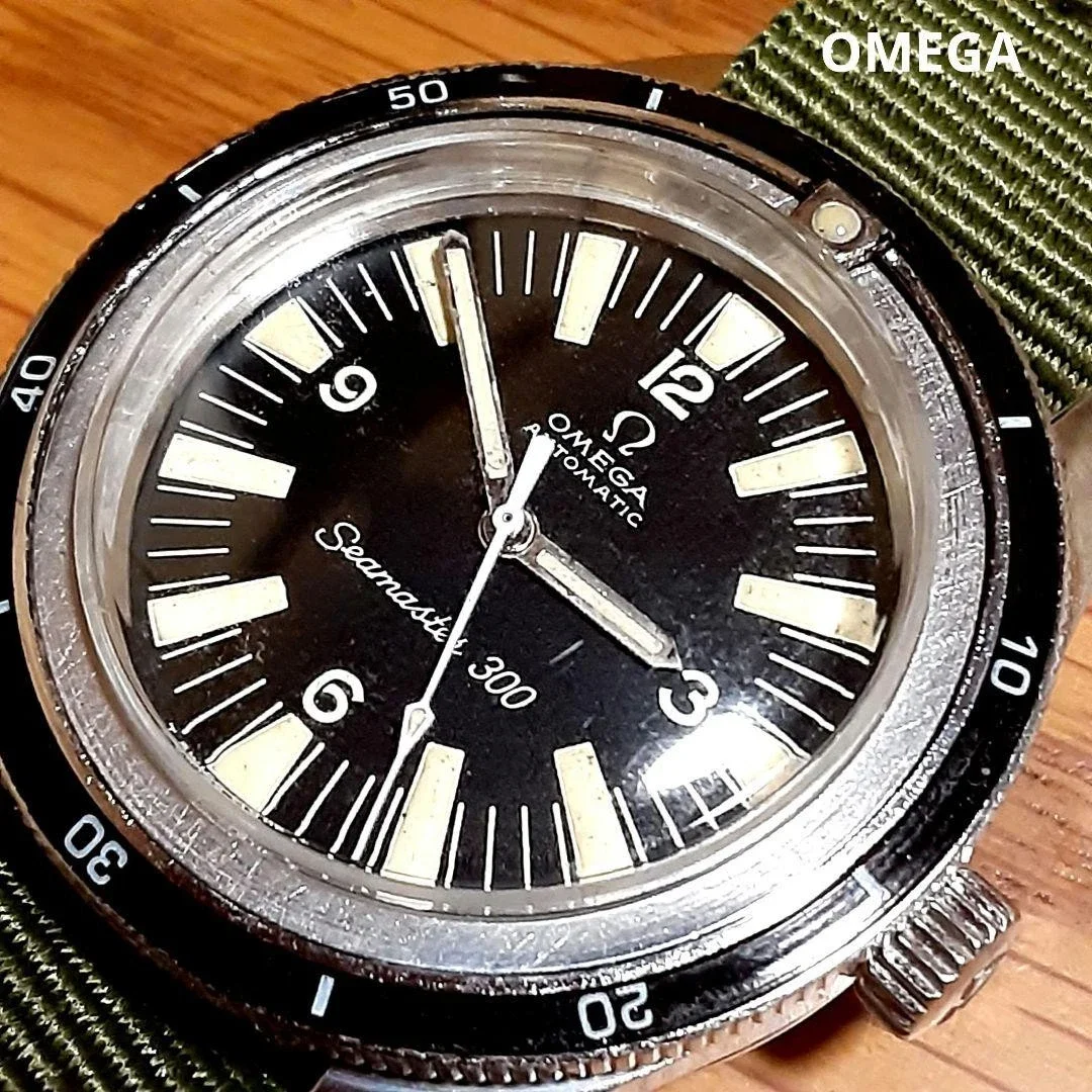

  • The biggest puzzle is about the dial. The hands could be correct (although I believe they suggest 1963 onwards), but didn't the open 6 and open 9 on the dial come later? I figured it might be a 1963 oder 1964 dial and hands with a 1962 caliber 552, which they had left over, but then I saw the "T Swiss Made T" (only partly visible on the first photo). Wasn't that only introduced with the 165.024?
So many questions and sorry about the detail, but I really tried to find out myself what was going on and am now stuck. I have contacted the seller and he said that it might original according to a friend, but he doesn't know himself. Getting more photos seems a bit tricky, too, and at least will take time (apparently it's not with the seller at the moment, but with a contractor that does the shipping for him).

At first glance, I'm skeptical of almost everything.

In short, all parts of this ‘Watch’ are fake - except the movement. Stay away.
Elaborating on each part would demand a long reply. I suggest you study more examples more closely.
13,313
23,118
Start with looking at the detail on the caseback.

Thank you, at least that was very clear and I will stay away from it.
Will also try to find at least some of the obvious signs myself - after all, I do want it learn. I’m glad I asked after mainly being suspicious of the dial (which I assume is one of the problems, too).
