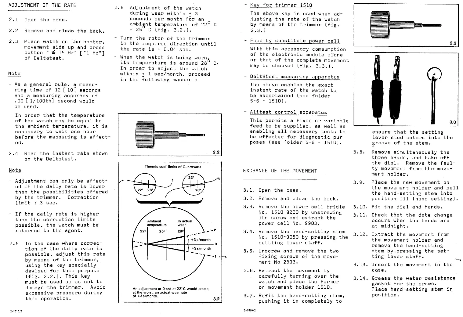

Hi all. I am wanting to get more information on how the movement speed can be adjusted. My 1510 is running very slow and would like to know what are the possible reasons and how this could be remedied. Based in Switzerland. Thanks in advance for any assistance! Alex

Moste possible reason is an elderly quartz but it can be many other things that you will only know when you have all the necessary special tools and equipment and most important you completley understand what to do with them correctly.
So your best bet is to get in touch with Omega in Biel.
I do not think Omega will help. In the UK Simon Freese has the most experince now I think = http://www.simonfreesewatchmakers.com/
You can also try @wristpirate as Simon is sometimes at his boutique Tortoise Watches now. https://tortoisewatches.com/pages/london-boutique
The main issue is parts now, but I guess adustment is different, although warranty becomes a problem. Also I know Simon has a lot on currently.
4,718
17,862
Reading back the thread it looks like for the UK Simon and STS are not servicing, maybe they would attempt an adjustment. Looking back at my old notes I found this if anyone is brave.....
