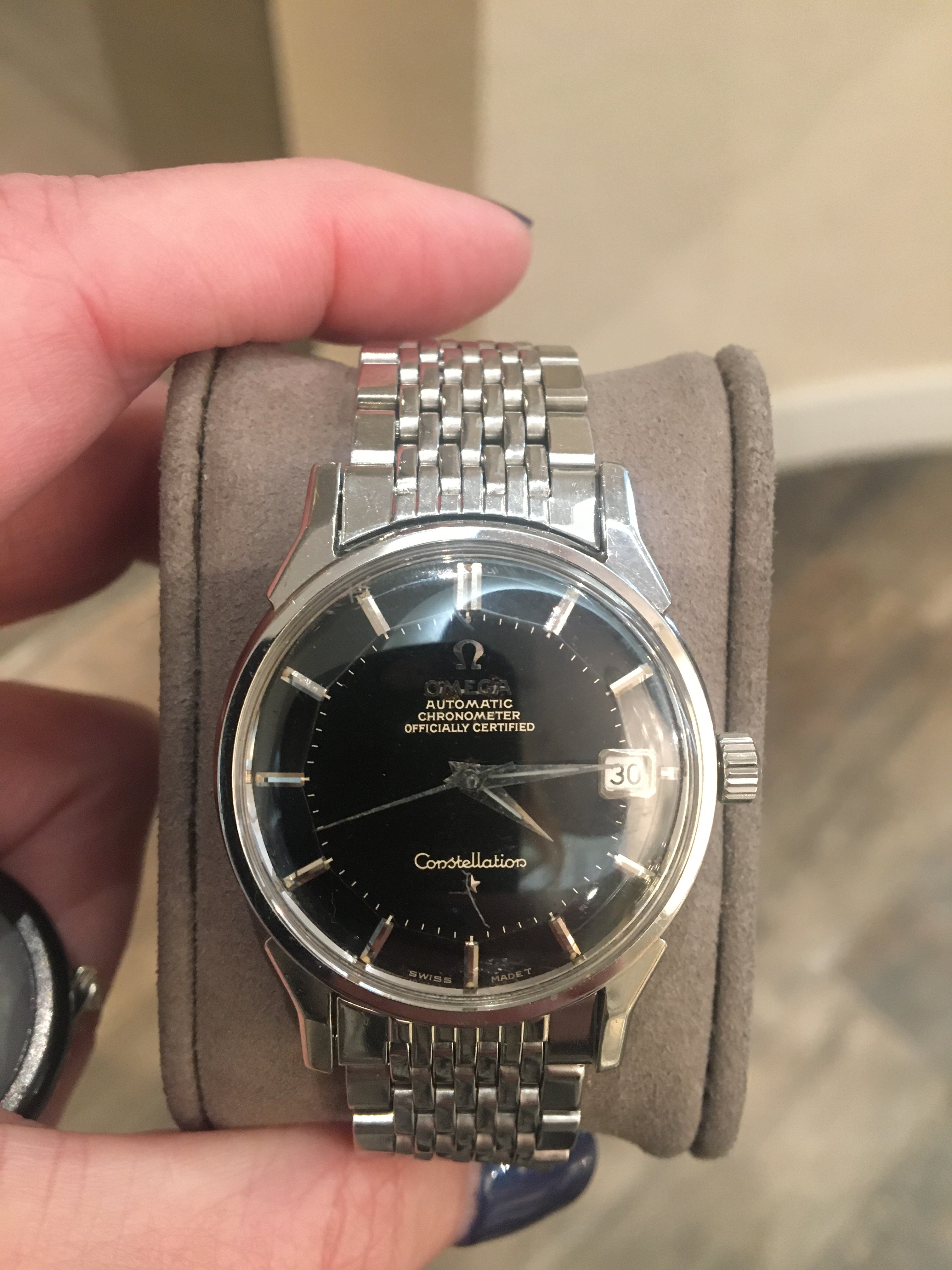

Hi, new to the forum and thanks in advance for any advice provided.
I stumbled across this yesterday and am wondering if legit and what I should look out for. This is the only picture I have to work with. The dealer says it’s 100% original.
It’s my first venture into vintage. Everything else I have was purchased new. Before I pull the trigger expert opinions are appreciated.

Looks like a redial to me, but others will chime in...

I think it is right. Have a look at Banner Roar's post on Monday -
14900 551 Constellation Black Dial
Comparing his dial with yours I cannot see signs of a redial (but there are others on this forum much more qualified to give you an opinion).
Personally, I would buy it - if you don't want it, please let me know where to follow up.

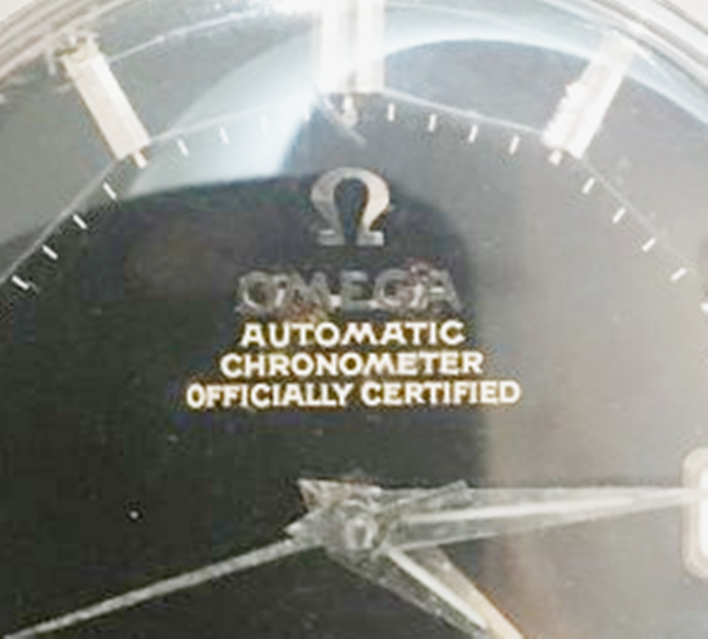

I think I might be seeing some serious dial damage under the applied OMEGA logo, near the M and the GA. Can you post a high resolution image so we can get a better look? I'm not saying it's a deal-breaker, but I think you want to know what you're getting.

I agree. A more detailed image please. Let's hope the 'damage' is a photo gremlin.
Just to clarify, my view on its authenticity is based on the fonts and minute mark placements appearing to exactly match Banner Roar's watch. Putting them side by side on my screen I cannot pick a difference.
It’s a black dial and so you have to be cautious but it would be more helpful to the OP if you posted what made you think it is a redial @OMEGuy, rather than just calling it out as a redial.
the picture isn’t great (and you do need good pics when assessing a black dial) but from what we can see, it looks correct to me.

Dial looks good to me, maybe some degradation by 'Omega' and the area slightly right and above ' Swiss Made. The case looks a little soft, but I'd buy it if the price was reasaonable

Welcome @JLN765
First off, you would get many more opinions if you posted this in the vintage watch section, rather than the watch review section.
black dialled Connies are very desirable, especially pie-pans, but are notorious for being redialled.
To that end, you need really good hi-res photos of the dial to assess it properly.
This one looks okay but I agree it seems to have severe degradation around the OMEGA logo.
The bezel is okay but the lugs are quite soft.
The BOR bracelet is a bonus.
The crown is a replacement.
ideally, you would want to see inside to assess the movement before buying.
From the dial and with the single T, it’s probably a mid to late 60s 168.005 with a cal 561or 564 movement.
cost is all important here.
If you desperately want a black pie pan you might be prepared to pay whatever the dealer is asking.
However, if it is cheap then you may just buy it because it’s an interesting watch.
(Unlikely if it is with a dealer)
hope that helps.

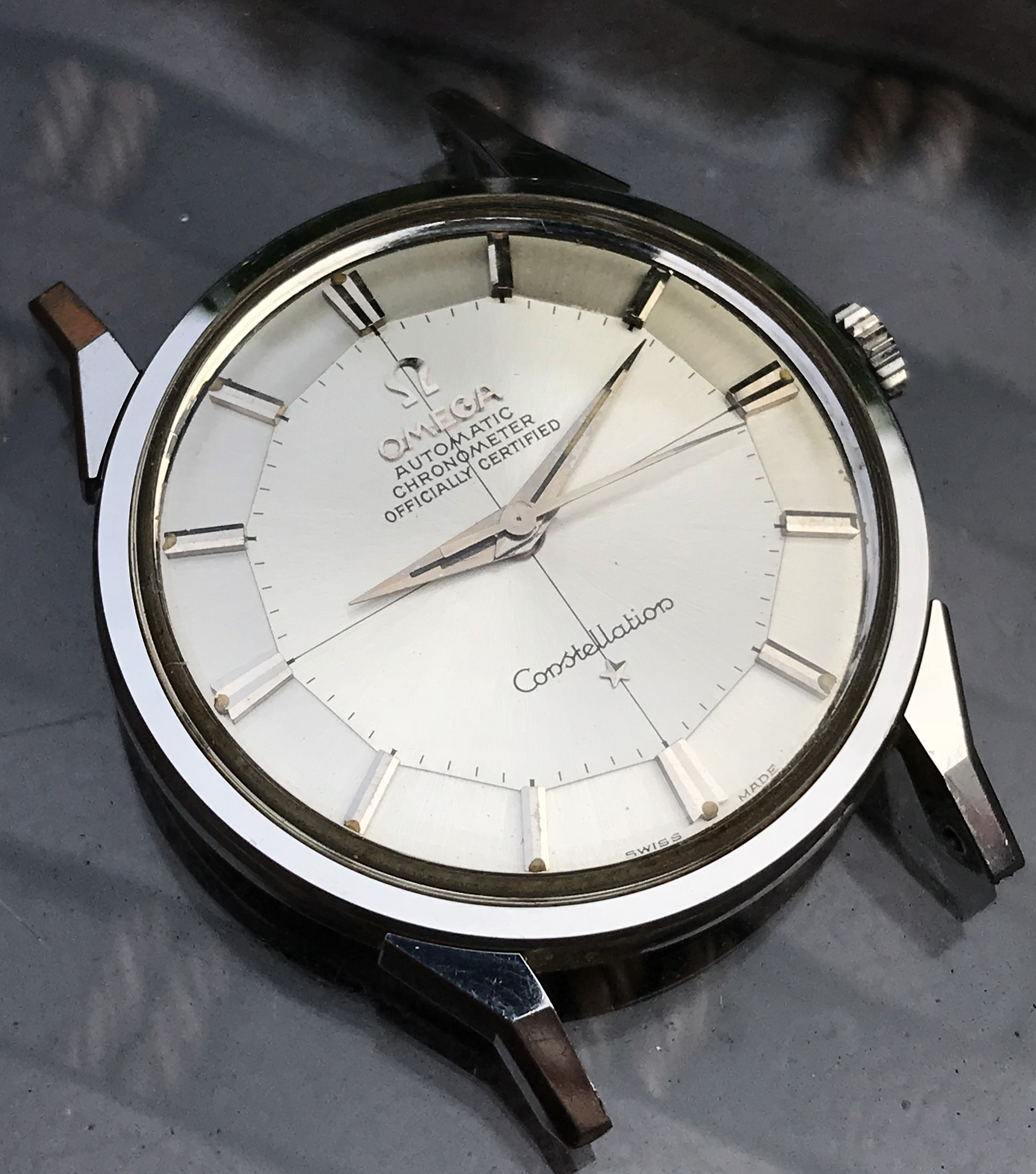

I can't comment on the authenticity of the dial but I would like to point the case shows some wear. The lugs shape on this model case is called dogleg, and the shape is prone to wear (mainly to heavy polishing during watch service). For comparison the one below has very sharp features. Now, if the dial is truly original and as nice as it appears to be in the picture then the case wear can be acceptable.

Indeed there's damage around the M and A, and maybe some near the center of the dial (where the hands are located). Kinda wonder about the condition of the movement.

I was judging by the clumsy "OMEGA", but, agree that the rest of the dial looks legit.

Thanks to everyone for the help and sorry for posting in the wrong place. I’ve been doing this on my phone while out of town for work. The picture was taken by the salesperson.
The seller is an Omega dealer (I bought my new Seamaster from them). They are asking $1500 for this. When I get home I plan to stop and take a much closer look.

For a professional seller, this is as low as you could wish for. I think this is very acceptable for a black dialed pie pan Constellation with a BoR bracelet, even considering the case condition and wrong crown.

A very good dome dial in a sharp case = $1000.
A good, black pie-pan in a mediocre case = $1500.
A very good dome dial in a mediocre case = $800.
A good, black pie-pan in a sharp case = at least $2000.
