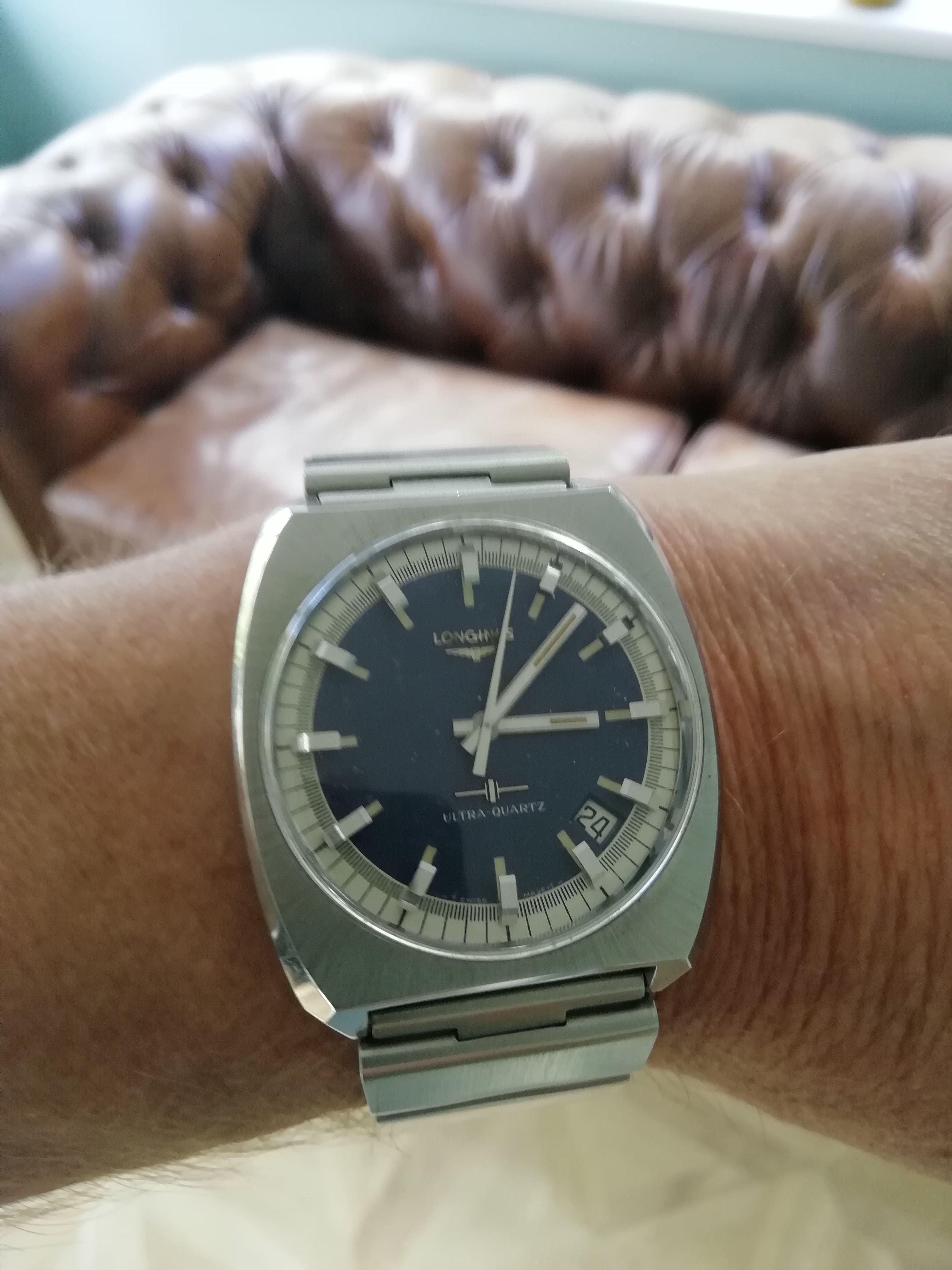

This HAS to be fixable!! The second hand is whizzing around just waiting for an invite from the others.
I would post a video but the forum won't let me
Since this picture the minute hand has started to move slowly 😀
Unfortunately backwards 🙁

You should stop trying to work it just in case something is blocking or impeding the movement of the other hands. It would be a pity if something fixable became not fixable as a result.
7,690
22,055
Silly question, if the seconds hand is whizzing around are you sure the others aren’t moving? Except of course for the minute hand that seems to move backwards 🤦
Ps maybe if you can’t remove the battery you can also disingage the movement by pulling the crown? Does it cause the seconds hand to stop moving?

Thanks @Syrte for tagging me in this thread. I received a message to my OF account from @Fled early on Thursday and I spent an hour or so looking into these calibres before sending a reply. Just to be clear to everyone, I certainly didn't make any offer for the watch. I haven't received a reply from Fled, although he seems to have followed my advice.
From a servicing point of view, parts are not available for this calibre, at least none that I could find. I believe Longines will offer to replace the movement with a modern quartz as they don't carry parts either. From the description of the issue (second hand moving but not the minute and hour hands), I suspect the train is working but the cannon pinion is not turning and this fault was one I turned up in my research. In the case I saw, the staking between the parts of the centre wheel had failed, probably caused by lack of servicing which led to the cannon pinion being too strong a friction fit on the second wheel - when the hands were set to time, the extra friction failed the staking. A new centre wheel is required and these are not available anywhere. A repair appears to be very difficult but, I've never seen one of these and have only seen a few pictures. I apologised for not being able to help and sent Fled to electric watches. It appears others did this afterwards as well.
I don't know what offers were made for the watch but, if it is not repairable, then it would be spares value only and I doubt that's much. Usually, it is the same parts that fail on every example of a calibre so, it may be that it has no real value at all.
In terms of people taking this work on, they are oddball designs and there is a lot to understand when you first strip something like this. It just isn't worth it when you will probably never see another and there is always far too much other work to do anyway. The best option would be for Fled to offer an amount for a watchmaker to spend a day or so making their "best efforts" to repair it. You might get someone to take it on if you offer £500 up front but accept that the watch may still come back in a non working condition.
I hope this helps, Chris
