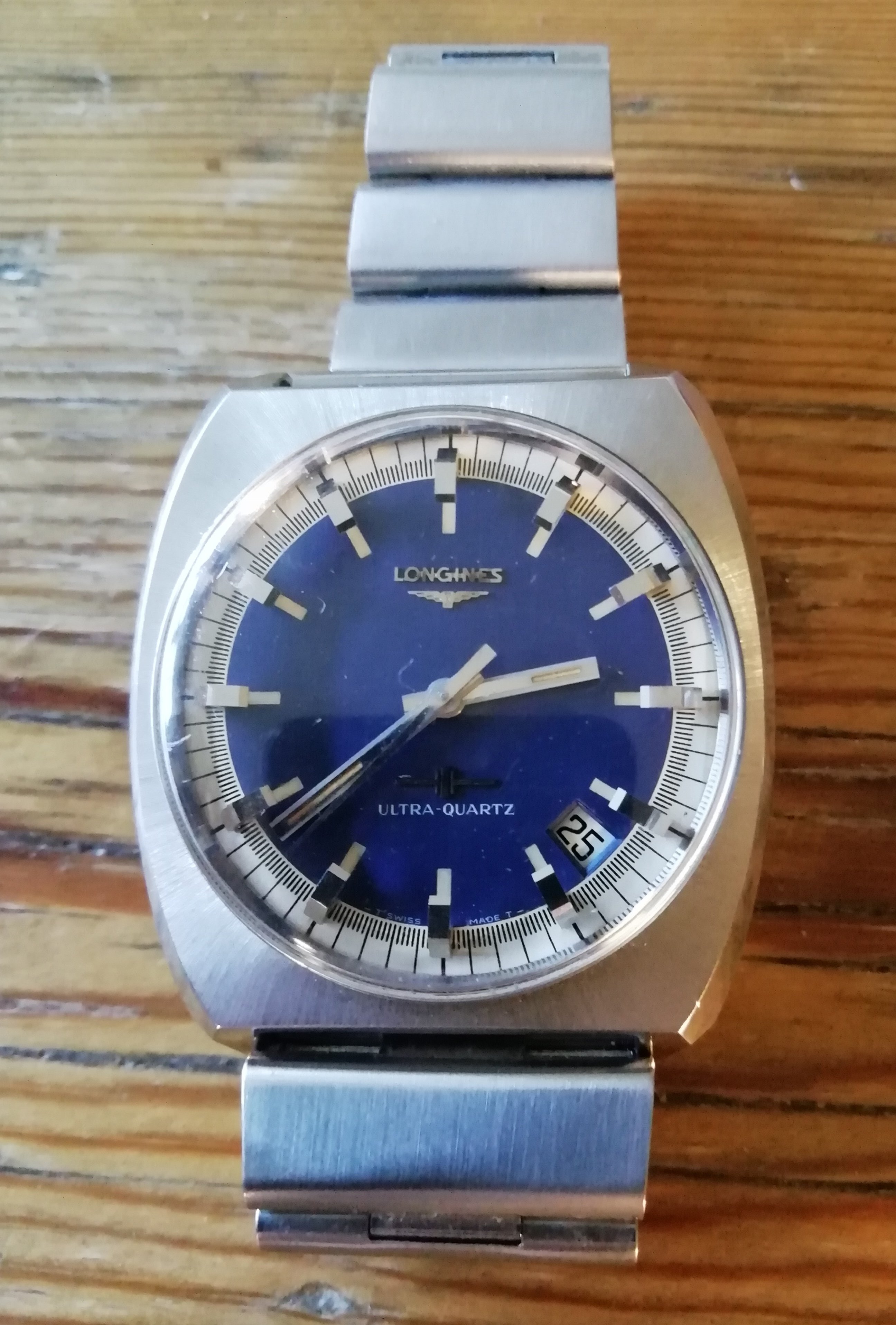

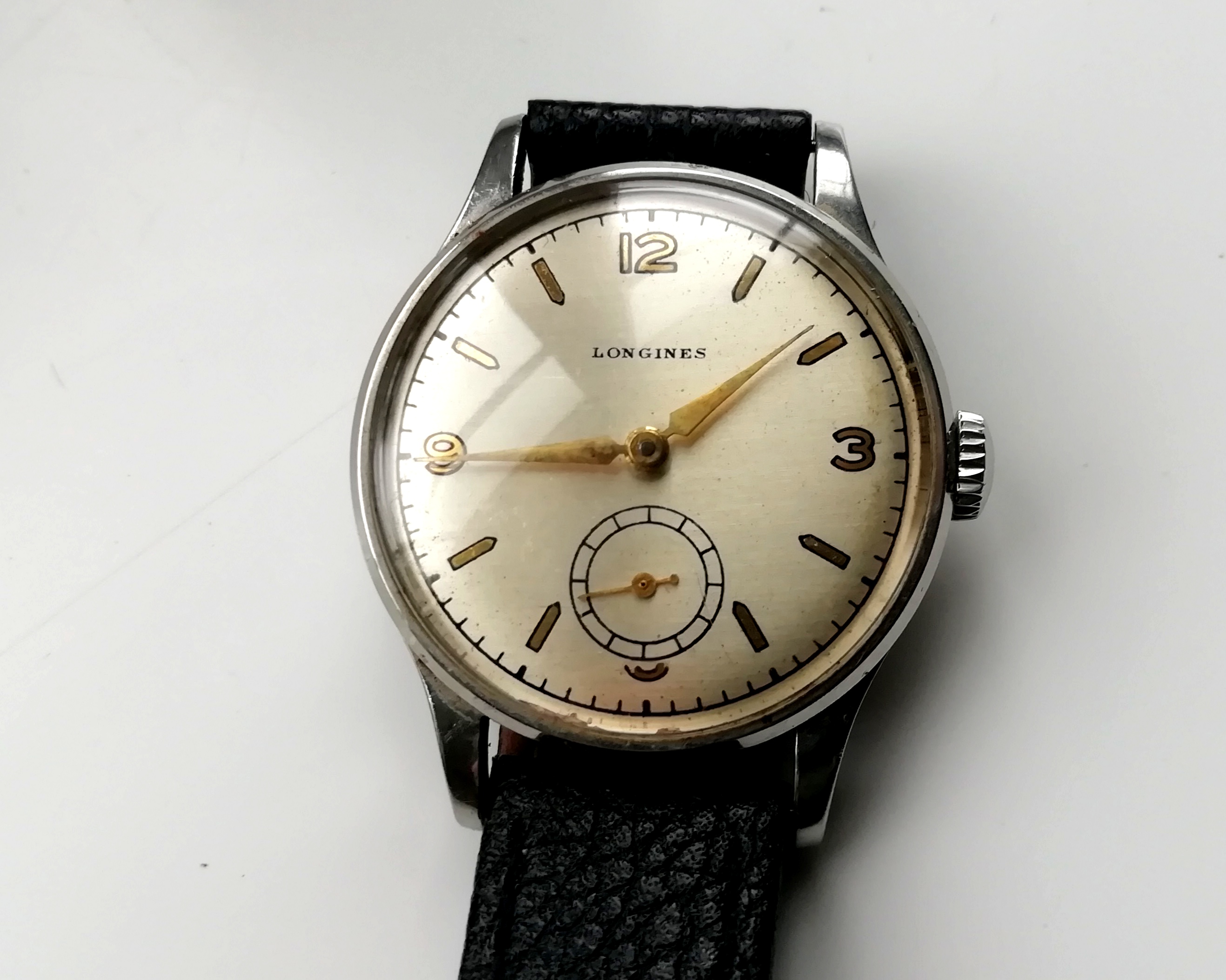

I accuired these two watches a long time ago. I am not a watchmaker and not confident to open them up. The first I wear often and love the design and amazing accuracy. The second I found in a cupboard I cleared out recently and tbh can't remember how or when I got it.
I got a local to put a battery in and it started to buzz. The second hand moves but slightly jerky, the others only move when I alter the crown.
Any information would be brilliant.

The first watch looks to be from the 1940's, though it's hard to tell, as the dial has been repainted sometime later. If you can manage to remove the caseback and photograph the movement, we can tell you an approximate date of manufacture, as well as the caliber (movement designation). I wouldn't recommend you do this yourself if you've never done it before to avoid risking damage. Maybe go to your local watchmaker.
The second Longines is from around the 1970's. It looks all original and the bracelet is period correct. Based on your description, and considering it's been languishing in a drawer, it may just need a service to start singing again. Though the movement in these are monstrous things. Somebody might have to recommend you a watchmaker, if you want to go to that length.

Why do you say the first dial has been repainted? To my very amateurish eyes it looks genuine. It also keeps unbelievable time, within a second or two a week.

It takes a long time to become proficient at identifying refinished dials, especially good ones. There are quite a few members on this forum who have dedicated the time and developed a level of expertise, and @Modest_Proposal is certainly one of them. In this instance, the dial of the watch in question is not so difficult to identify as refinished since the style and execution of its printing are inconsistent with original dials from the period.

Many thanks. So from that I guess it's tricky to date from this picture alone.
I will get a watchmaker to pop the back off and take some pictures. Would love to know its providence, refinished dial and all.

The second watch is a very nice and interesting example of a rare Longines watch with a movement created in 1969, and which is called, as the dial says « Ultra Quartz ». It is an insane movement you can see if you Google on the Internet - as Longines tells the story, they got it patented as the first quartz movement in the world and therefore beat everyone on the invention of quartz.
being able to manufacture it for mass production was a completely different story however, they worked on it for two years and the Japanese manufacturers beat them to the market.
The rest is history and the so called « quartz crisis » nearly killed the Swiss watch industry.
Because that intricate movement is like a complete electronic jumble, few watchmakers in the world are willing to attempt repairing it.
From what I was told even Longines watchmakers say they cannot repair it.
You need to find a watchmaker who specializes in electrical movements.

I did some research and honestly it looks a nightmare to fix. Although I am sure it's mechanical as it seamed to work for a short period after a battery went in.
My watchmakers won't touch it so I now have a dilemma, i just don't know what to do with it. Seems such a shame to put back into the drawer it came from, it's a beautiful watch.

You could also search for a watchmaker who’s willing to take it on but the cost may be significant.
Part of it is mechanical and part of it is electronic. Those were called electro-mechanical movements as far as I know.
Some collectors of course may be trying to reach out to you privately who may be willing to take on such a project. If so, make sure you don’t get scammed or fleaced. You’re not supposed to use the forum as a sales platform since you just joined, but you could sell it on Ebay and it will find its market at a fair price.

You could try electric-watches.co.uk, he did a great job on my Longines Ultronic. If I remember correctly he doesn't usually work on quartz watches but as this is a very early and interesting example he might make an exception.
Edit - the Longines 6512 is illustrated on his website so you might be in luck.
He has a great page on the 6512 movement https://electric-watches.co.uk/makers/longines/longines-ultra-quartz/

Thanks I contacted him yesterday. He won't work on mine, only his own. Too delicate apparently.

That's a shame, if he won't work on it it's not looking good but did you ask him if he knew of anyone else that might take the risk?

I've sort of given up on wearing this. Even if I get it fixed the cost and worry of going through this again, should it break, isn't really worth it.
So i will put it on ebay, much to my regret, failing that I will get a perspex case for it and put it on display in the lounge.

You could explore one last avenue which is to see if Longines would want it for their museum.
They do have a couple examples which I believe are functioning, and I heard that they say they cannot service them, presumably because they could not honor any warranty on them- but they might be interested in having it in its current condition?
You can easily contact their brand heritage department through their website and say you were referred to them.
Frankly even if it were working and repaired I’m not sure it’s very pleasant to wear. I’ve had a functioning one in hand, the constant vibration is so intense and distracting, the only practical use that comes to mind is X rated.
It really is a collectible and not a practical object.
