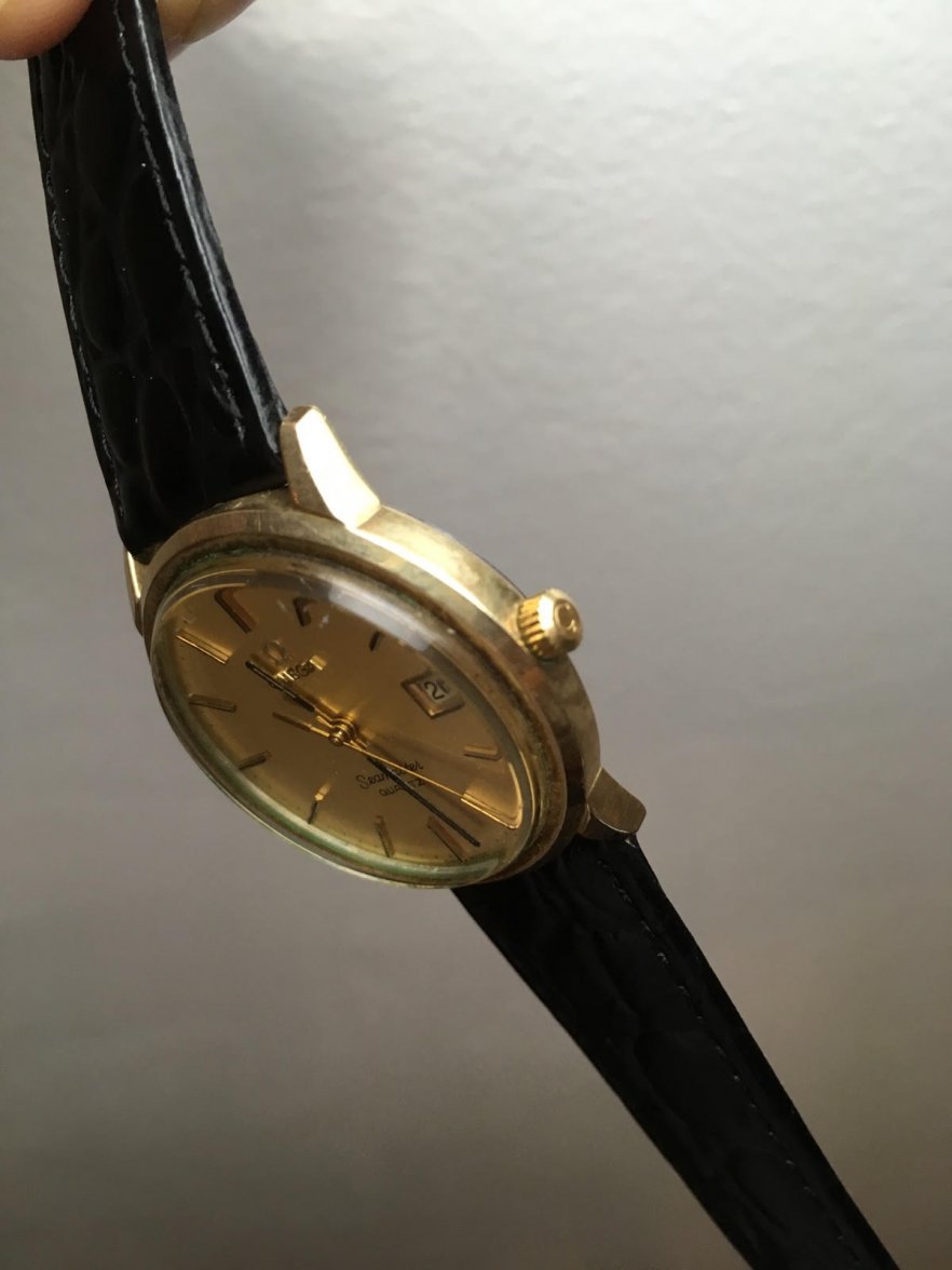

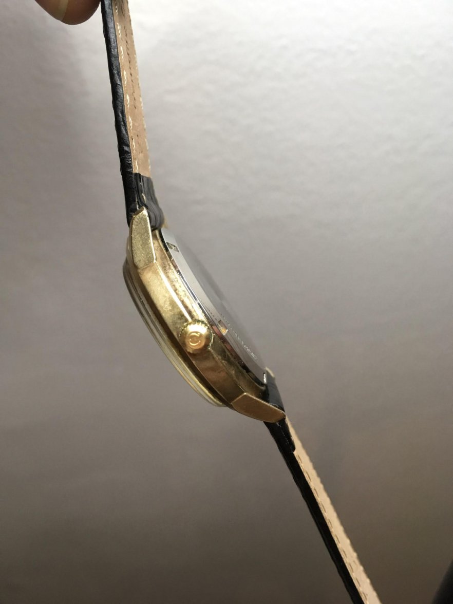

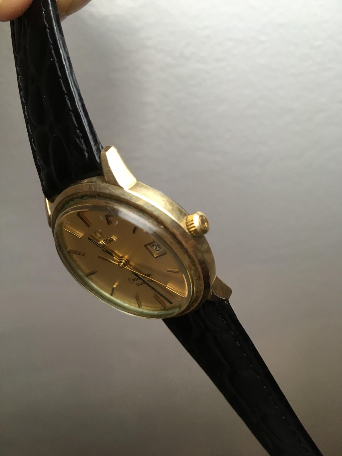

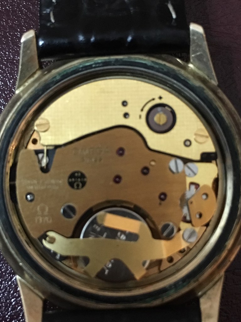

    While going through my deceased grandfather's letters and papers to digitally archive records I came across one of his watches. It is an Omega Seamster Quartz. It was pretty dirty, and I brought it to a old school watch repairman, and he cleaned it up, put a new strap on it, new battery, "oil-ed" it to have start to move. But I have one problem, I cannot set the minutes on the watch. I can pull out the crown and set the hour hand and date. The hour hand jumps (for time-zone change when traveling) and can use that to set the date (as other watches, especially seamaster's do). But the one pull out of the crown is it. I cannot pull the crown out to a second click to set the minutes or hack the seconds. I have looked on the vintage omega manuals online and have not found a solution. The watch does not have recessed button at the 2 o'clock position, or on the left hand side of the case. It does not have a recessed or protruding button in the center of the crown either.
    The watch repairman could not figure it out either. He stated that his experience was mainly mechanical pocket watches and wristwatches.
    I brought it to an Omega AD and they had a look over and were not able to figure it out either. The AD stated that maybe my grandfather had it fixed and the watch repair shop put on a different crown on it it was damaged. He stated that "back in the day" shops would do that all the time. Both the AD and Omega letter I received stated to send it in (to Omega HQ) for them to review it. But the cost of sending it through an AD, to Omega, for Omega to do a service charge just to look at it and then back to the AD would be way more than what the watch is worth.

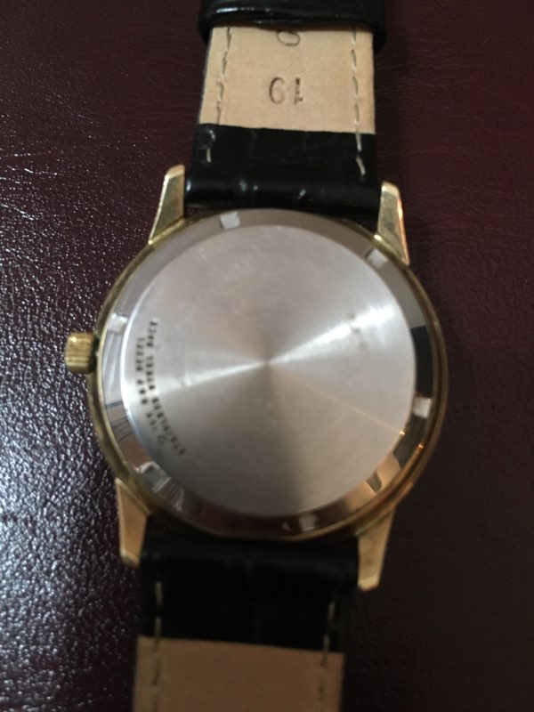

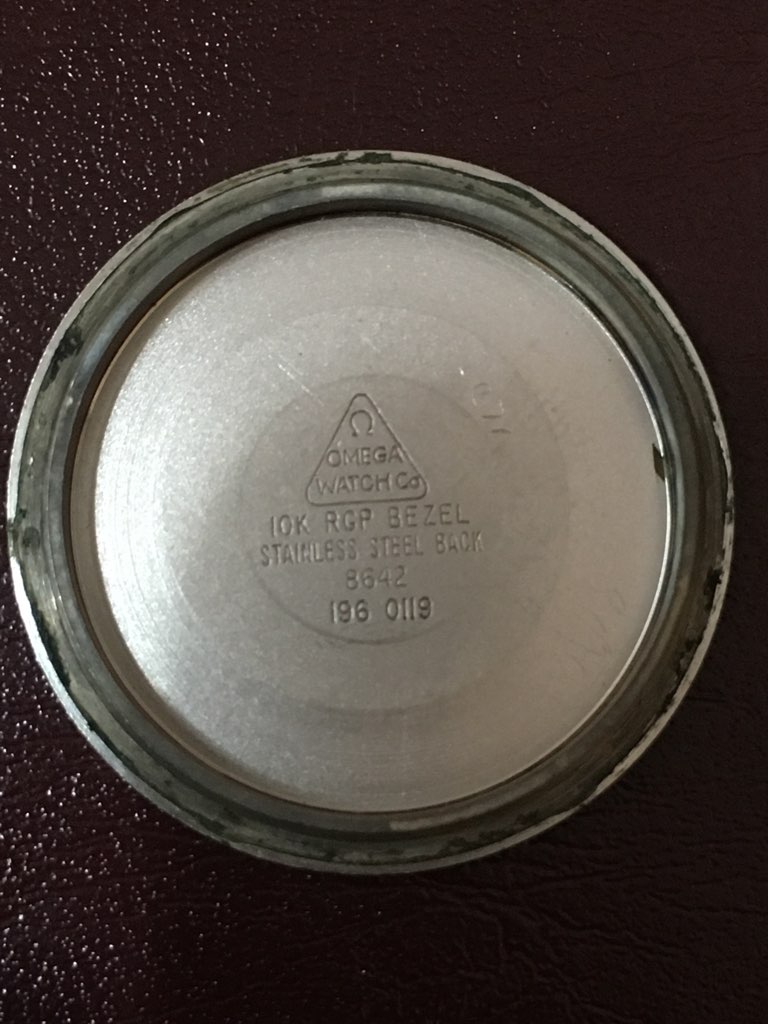

    Name: Omega Seamaster Quartz
    Model (back of case back): 1960119
    Caliber: 1370
    Serial Number: 43 691619
    Back of case: 10k RGP Bezel
    Stainless Steel Back
    I have attached some pictures to the thread, my apologies as the camera is from my phone. I tried to take some clear photos at different angles. Please let me know, if you would like more/clearer photos and I will dig out my out digital camera.
    Thanks for all of your help!

    Thus your dilemma. Now you know you need a different crown (and a different watchmaker). ;)
    Maybe someone here could point you in the right direction. A quick ebay showed nothing for the crown and maybe a stem.
    I checked my drawers and I currently don't have an Omega with a 1370 movement.
    Can you post a clear pic of the crown?

    You can always pull the battery and put it back when real minutes match the minutes your hands show. Then keep an eye out for a proper crown.

    I think even pulling out the crown to set hour hand stops the time. Pull out the stem, wait until the minutes line up then set the hour. The movement is very accurate so no worries about drift.

    Thanks, Please see below:
  8. Mark020 not the sharpest pencil in the ΩF drawer May 21, 2019
    4,736
    6,737
    Yup: wrong crown.
  9. tdn-dk May 21, 2019
    1,717
    14,548
    Need a crown like this cal. 1370 Omega, where you can set in the center of the crown.
  10. Magnix May 21, 2019
    402
    1,187
    It is allready clear it is the wrong crown, but sometimes they placed the replacement crown a little off the case so you can push it. Please try that.
  11. Archer Omega Qualified Watchmaker May 21, 2019
    26,463
    65,604
    Replacement crown for this case is 069SX43242.
    Cheers, Al

    From the dents inside the Omega, on the crown, it looks like someone was trying the push the crown in with something.

    They aren't discontinued, but third party suppliers can't order from Omega anymore. If you find a watchmaker with an Omega parts account, they can get the crown.
