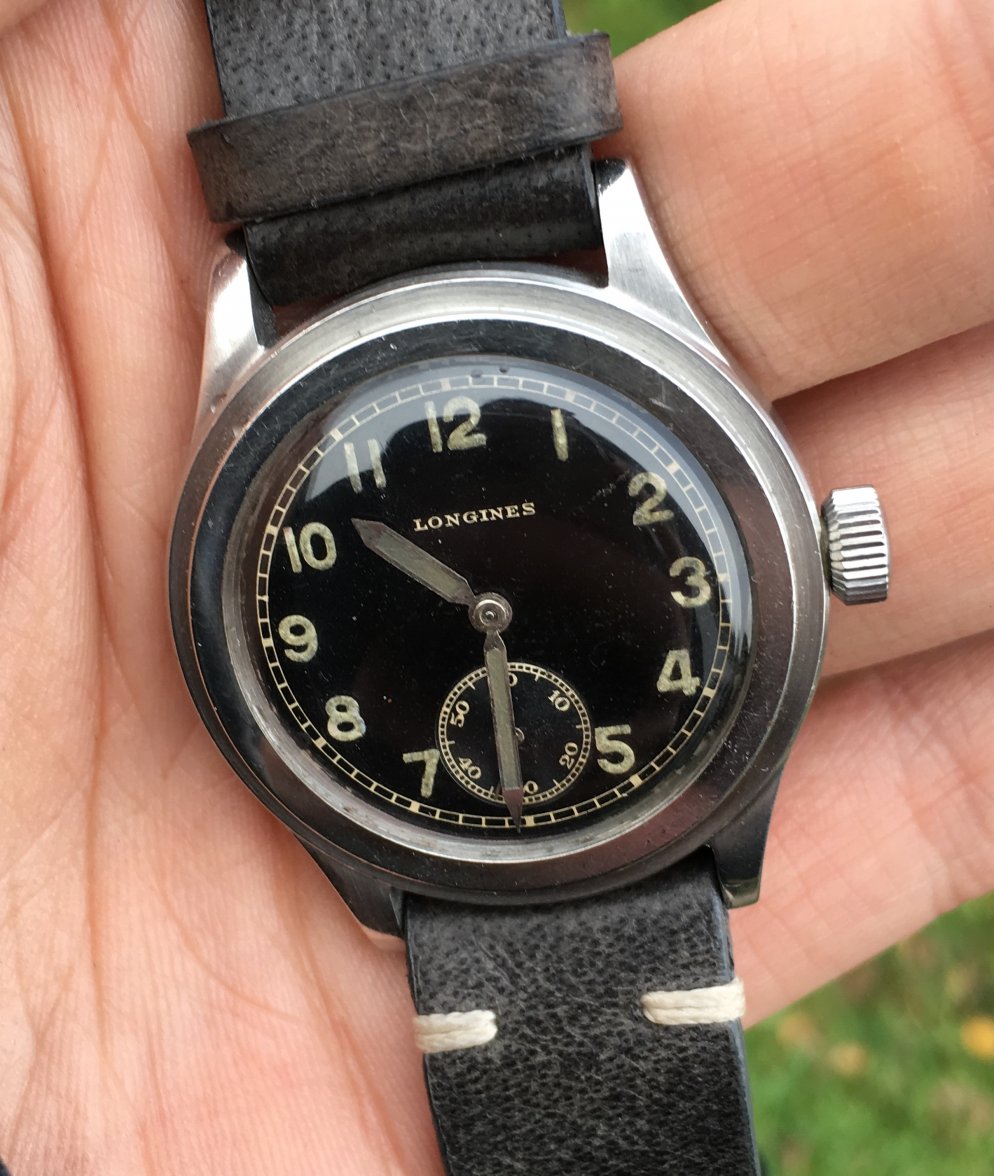

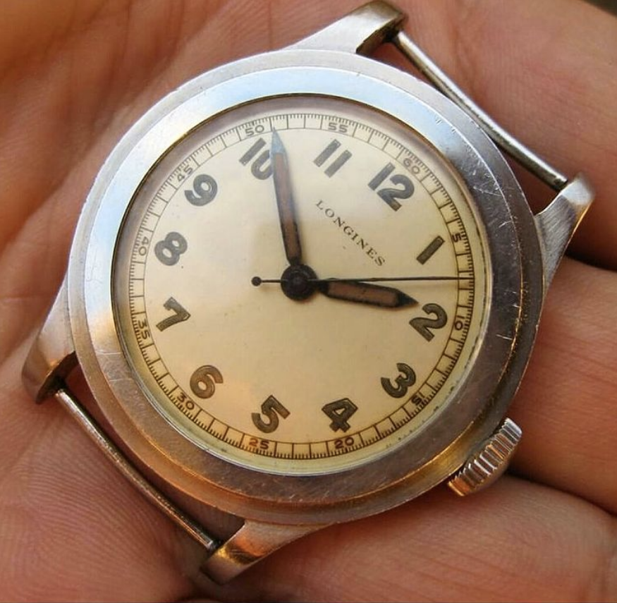

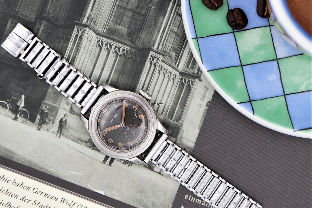

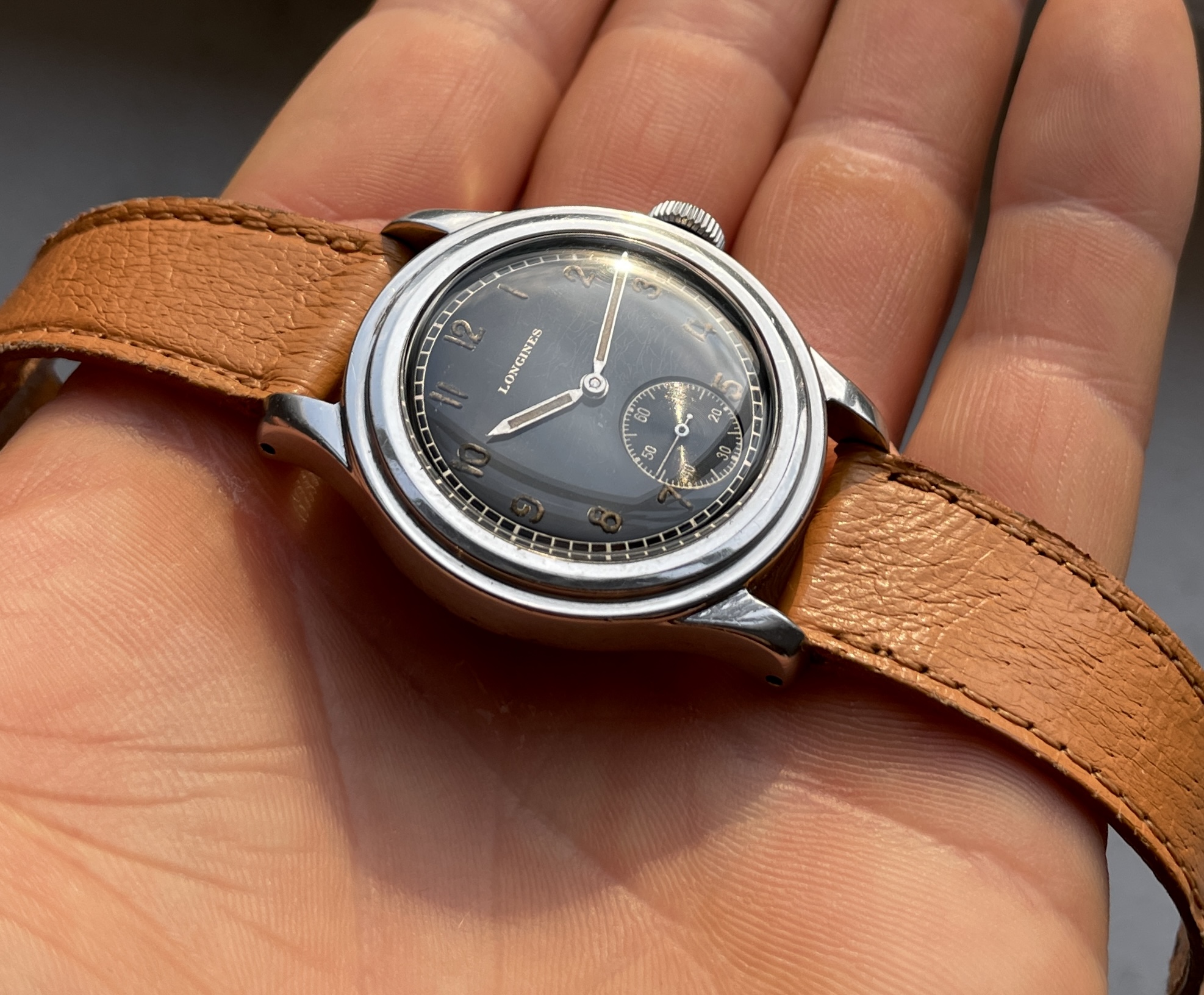

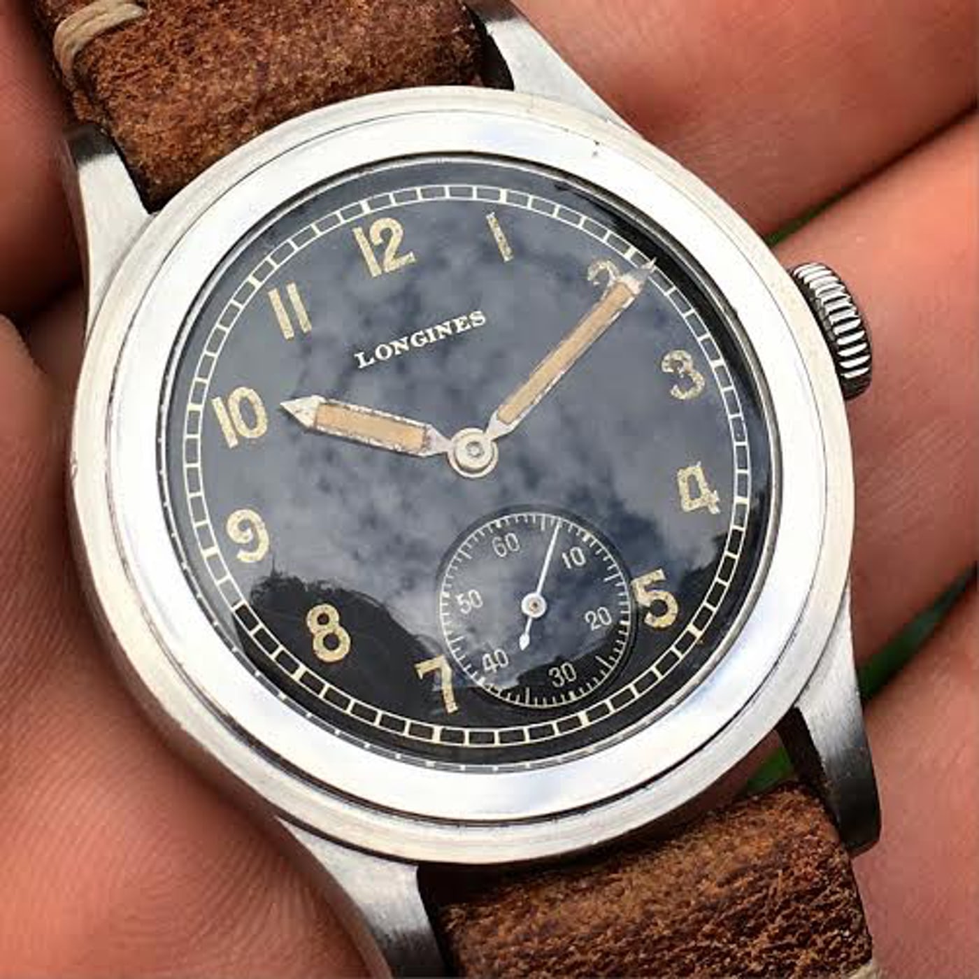

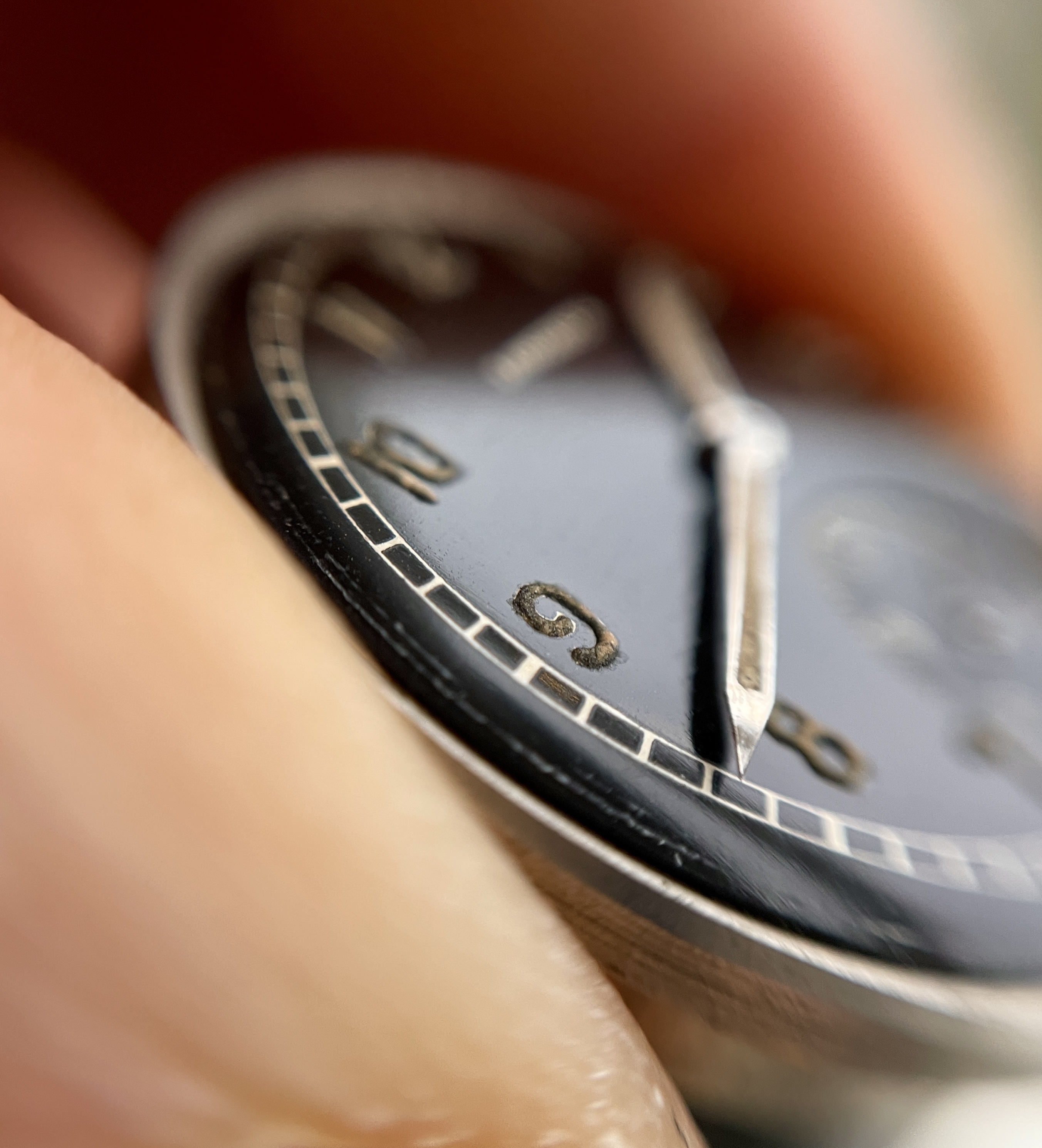

Distortion caused by crystals makes assessing dial curvature difficult. Additionally, my presumption that the majority of tre tacches have flat dials makes me biased towards seeing flatness. However, looking at these dials, only the black one stands out as potentially curved, to me.
Okey that is good since I've seen these type of dials on other Longines models, but clearly my eyes for details is not that good since I have a very hard time to see the difference between the domed and flat dials.

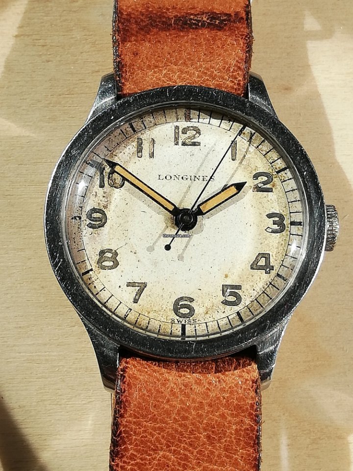

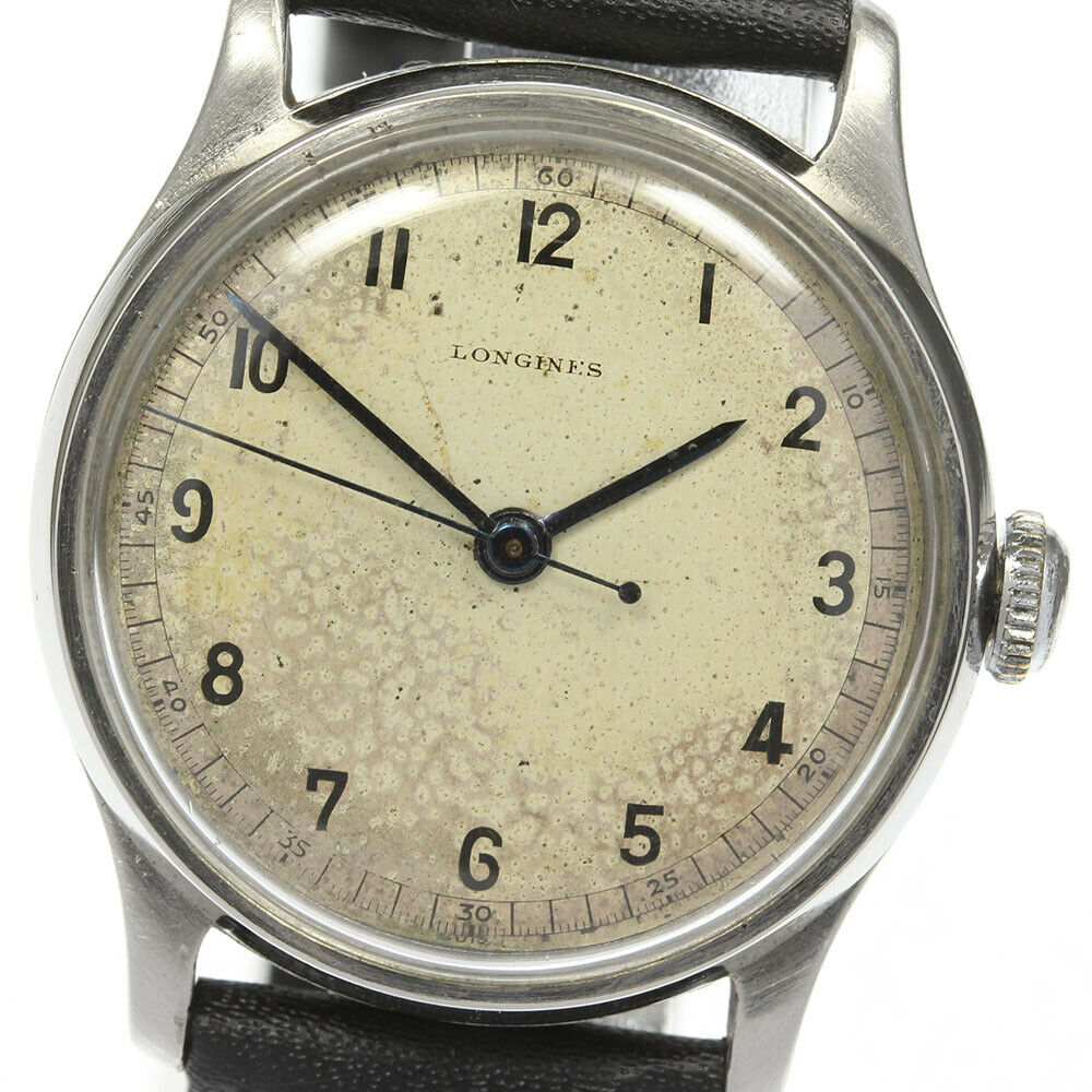

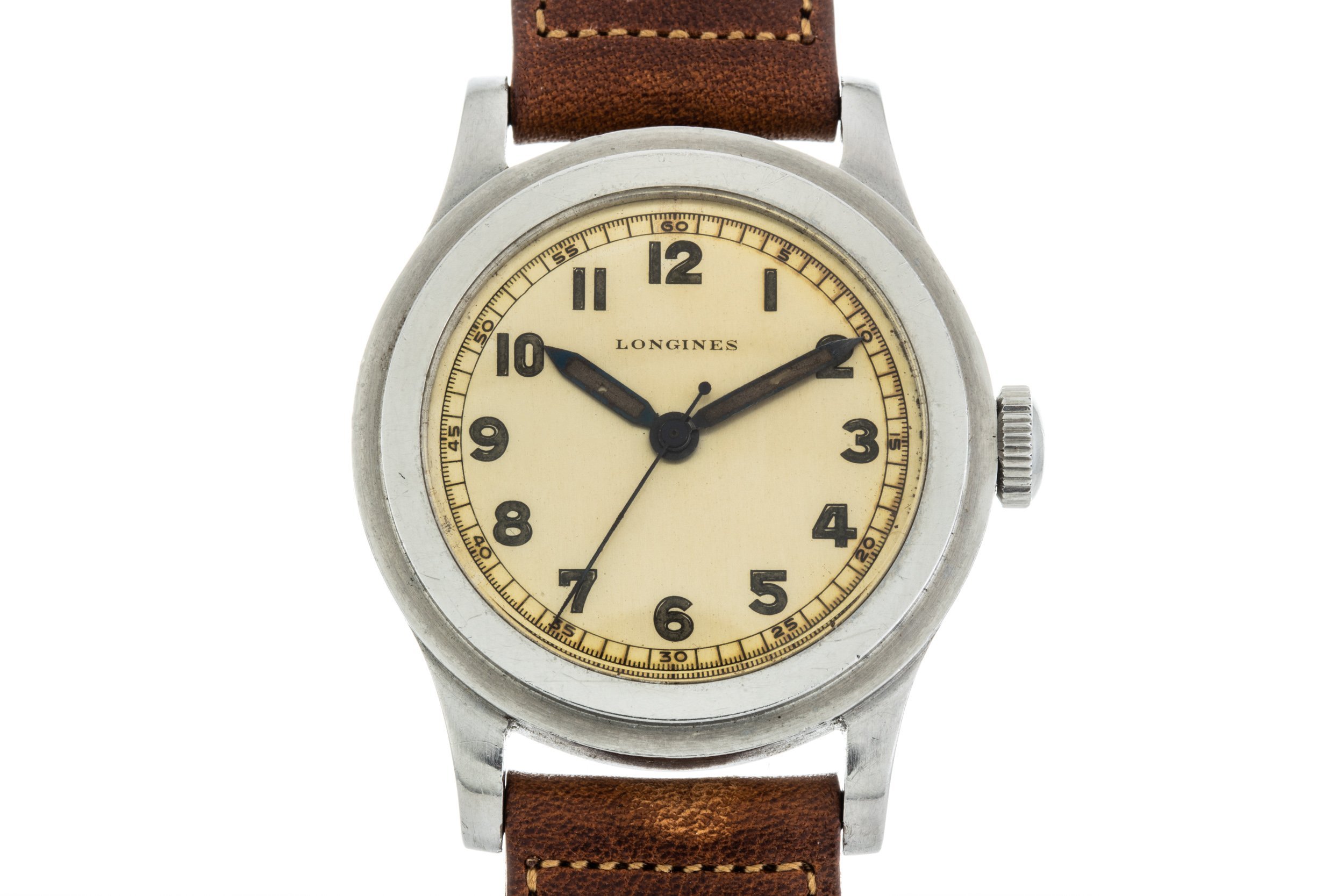

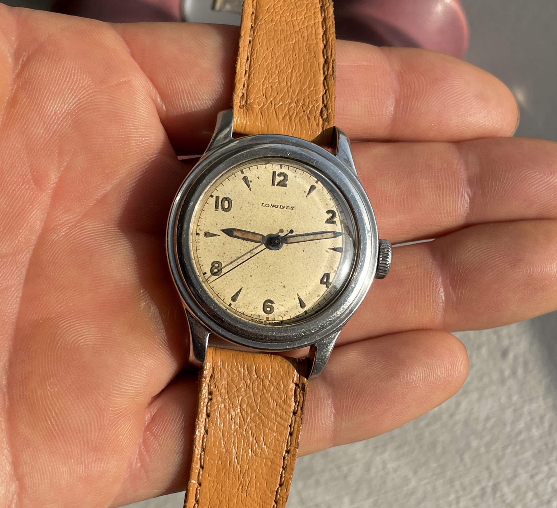

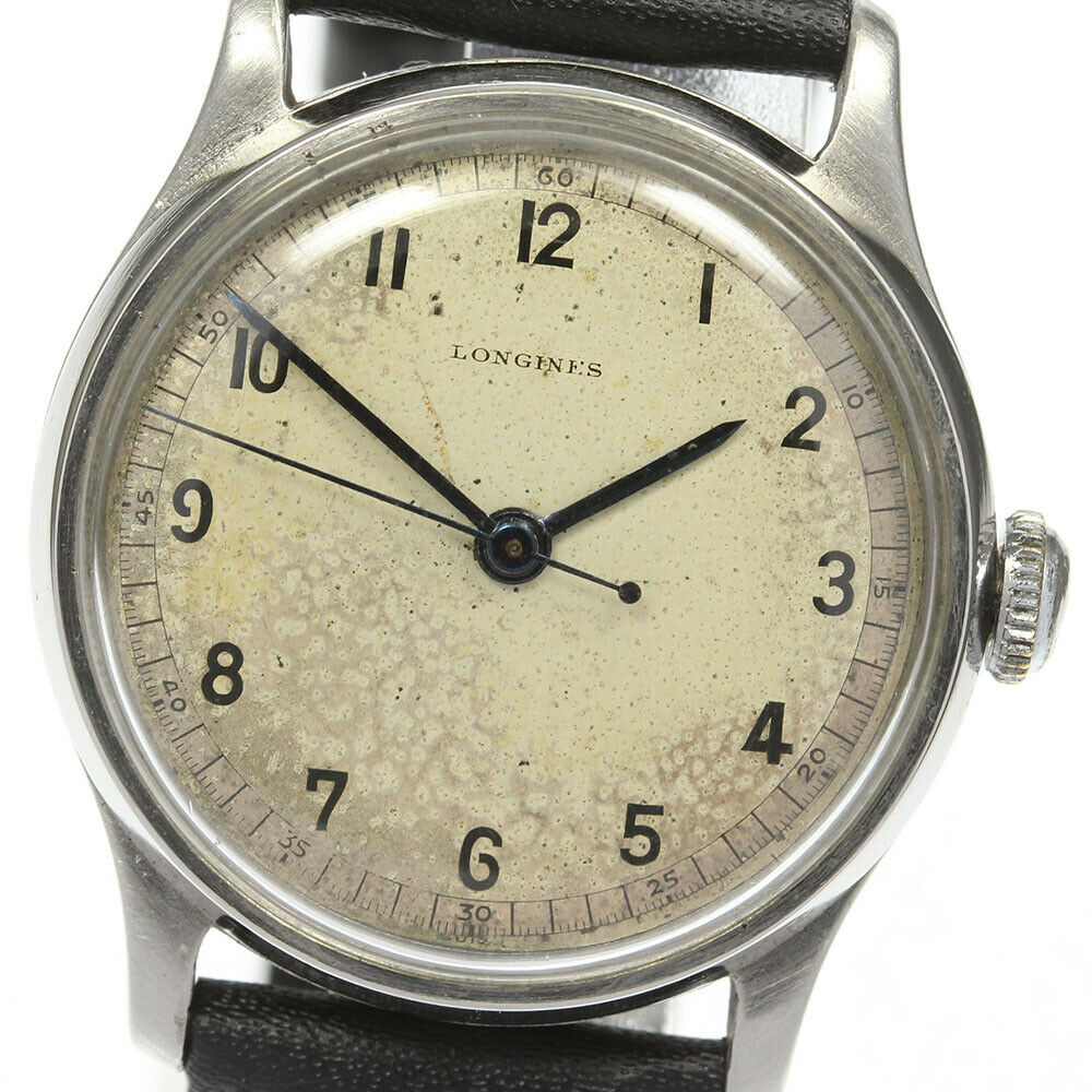

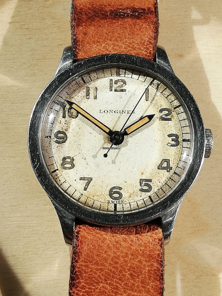

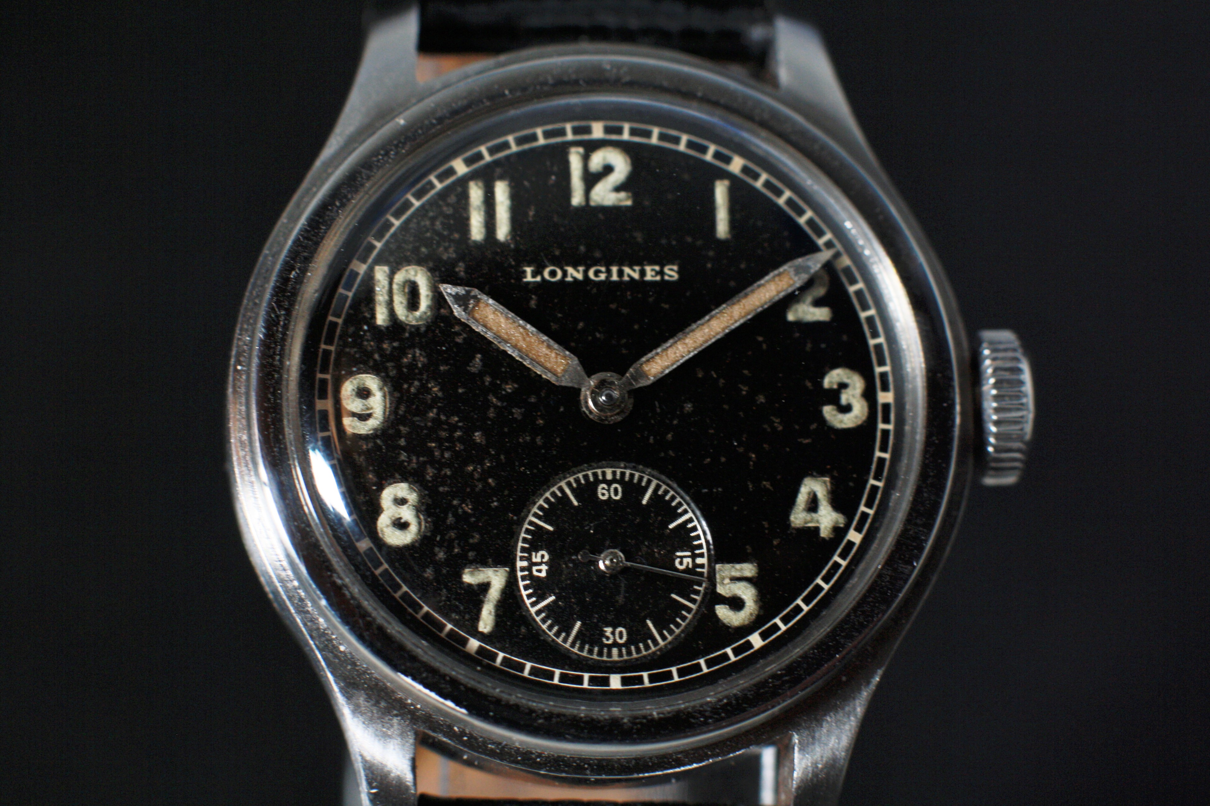

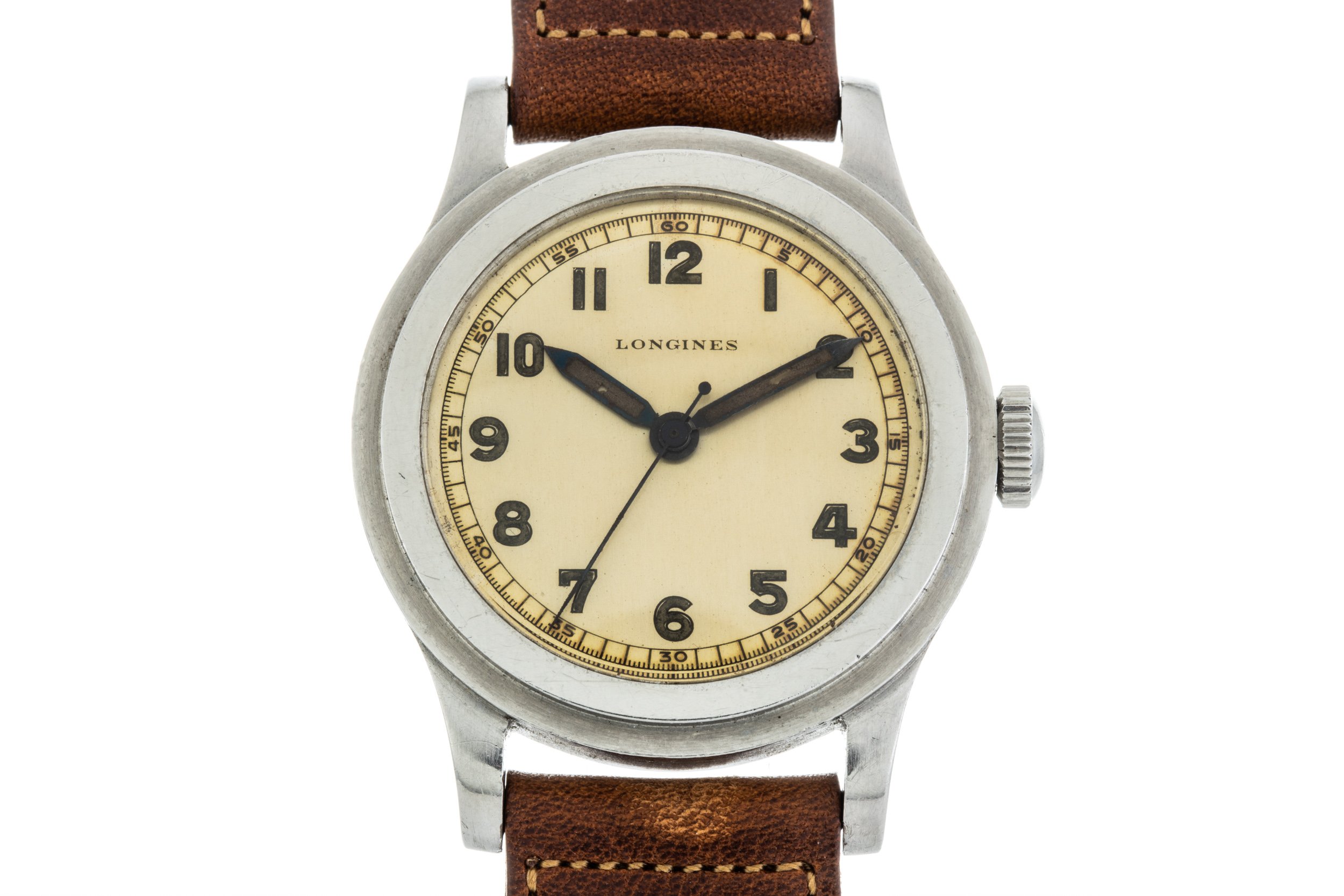

Here is two dials in the correct size, what about them and would they be wrong for my tre tacche case?
The font on the logo looks good to me, but the text on the minute track looks a bit sloppy and minute hand too long?
Font on logo okey, but minute track sloppy and what about the "swiss" on top of the track?

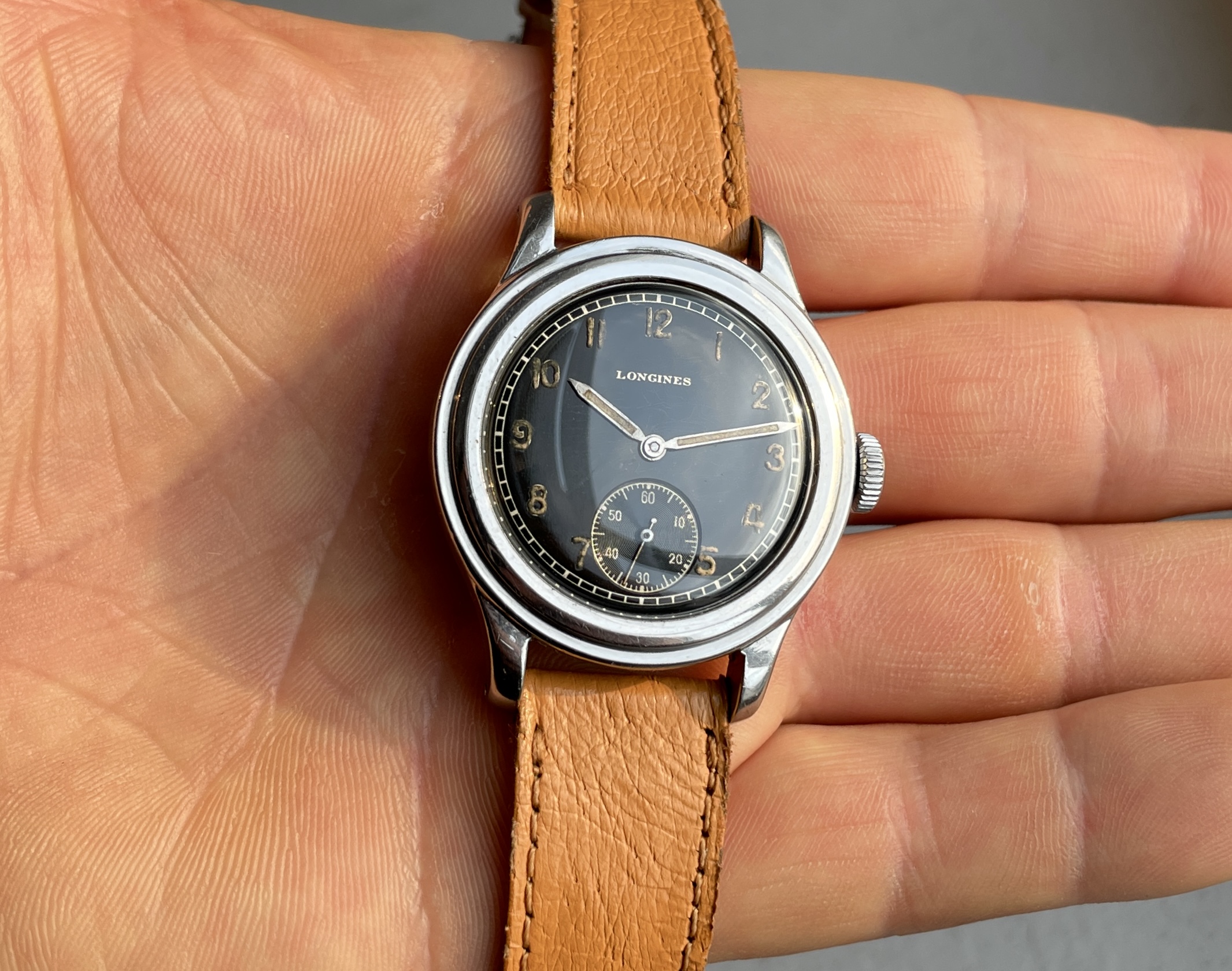

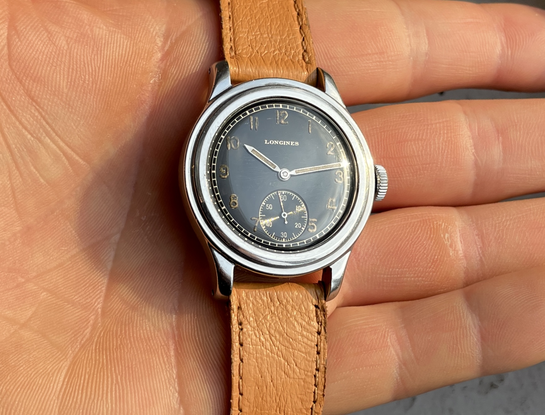

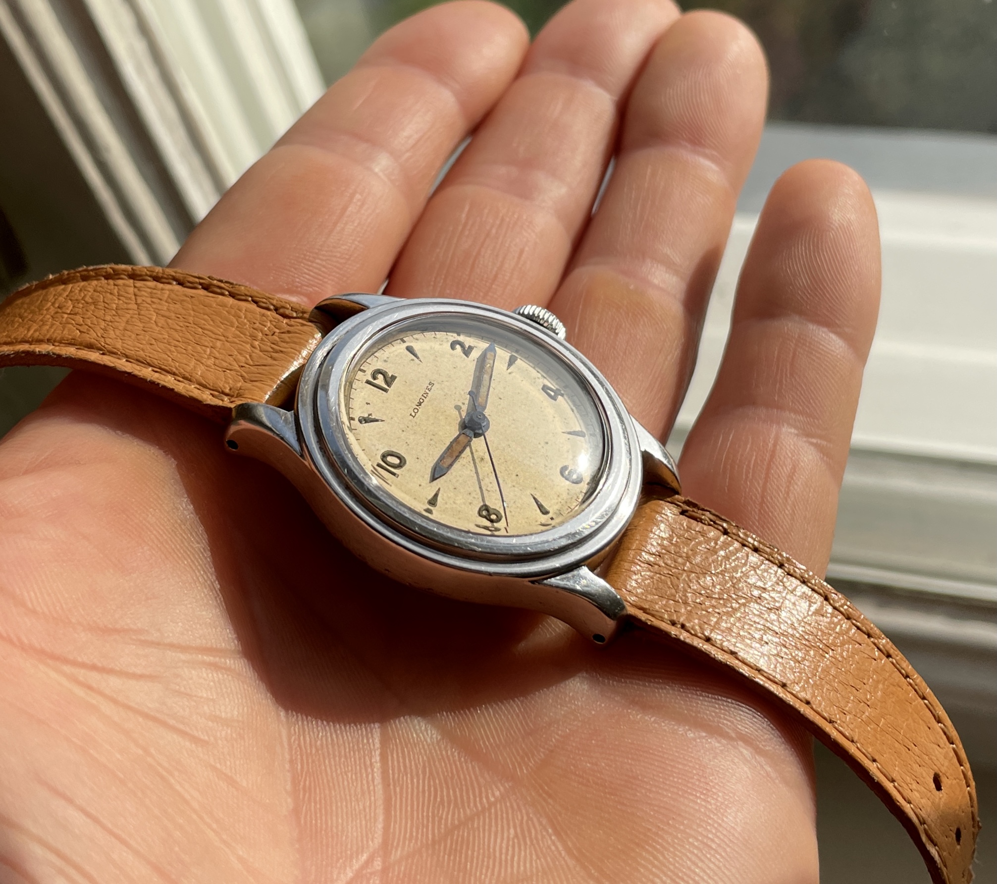

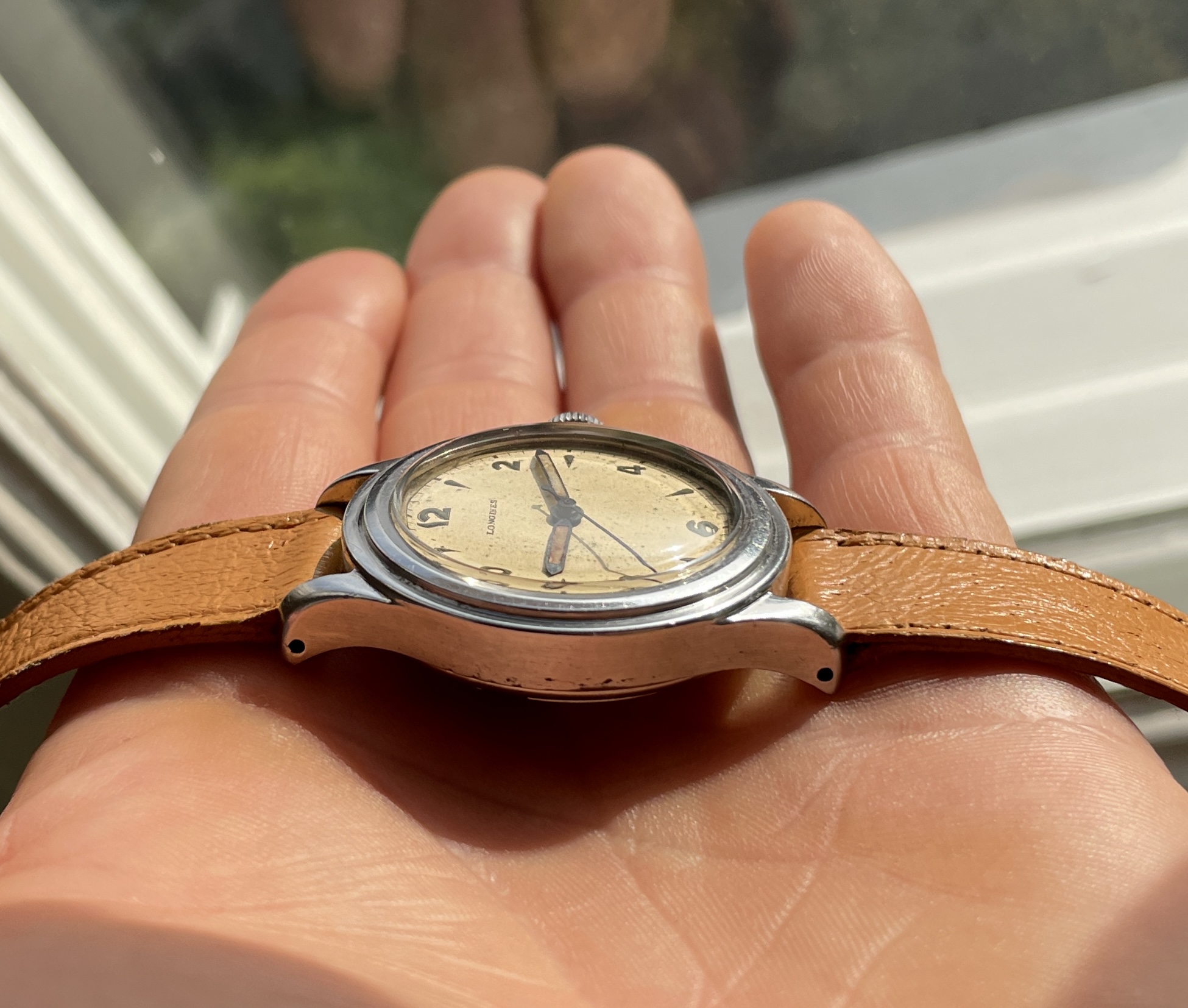

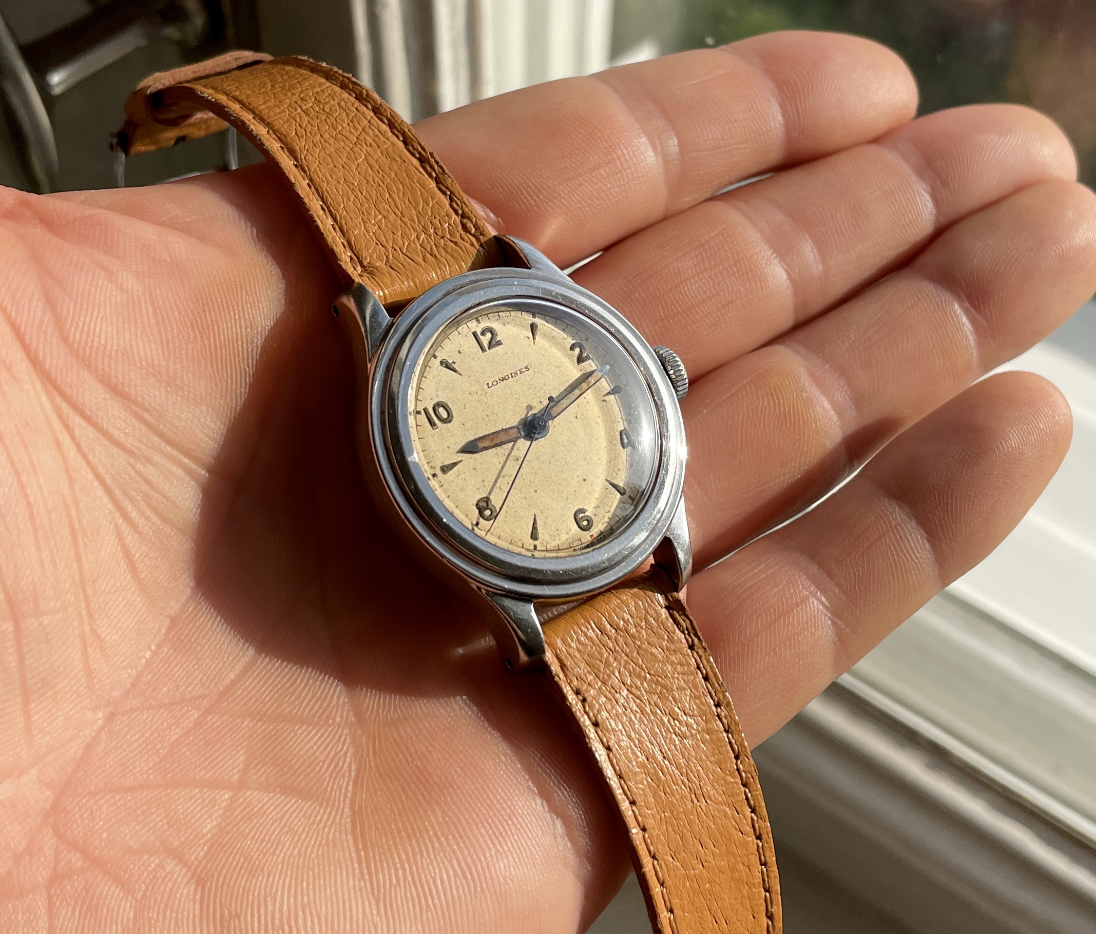

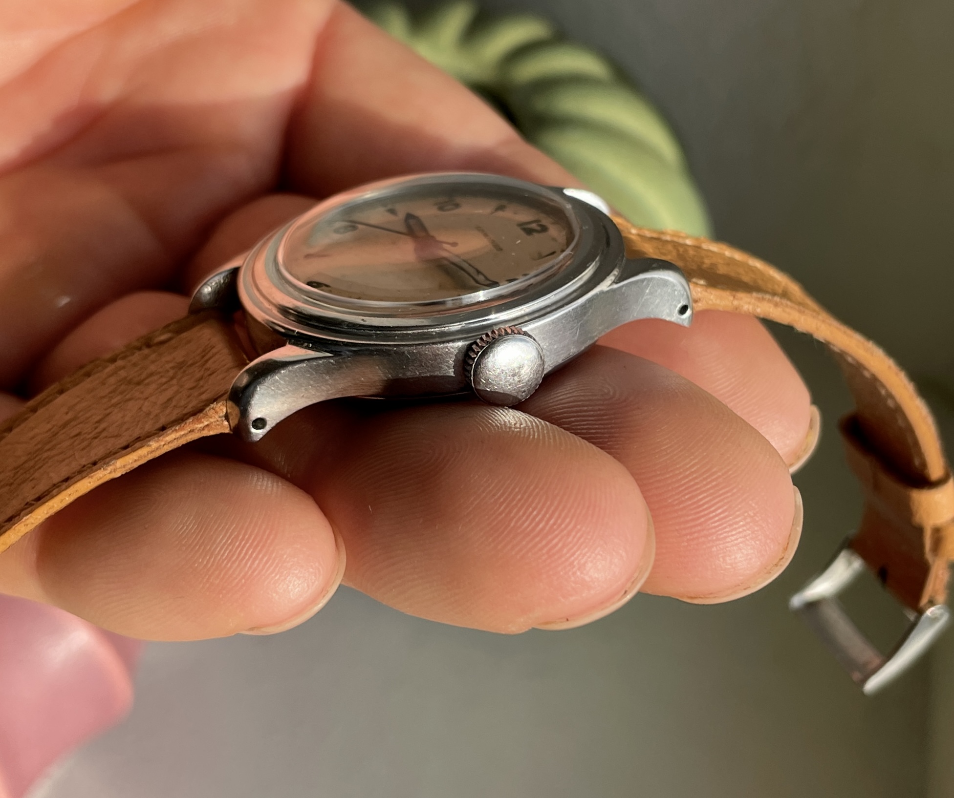

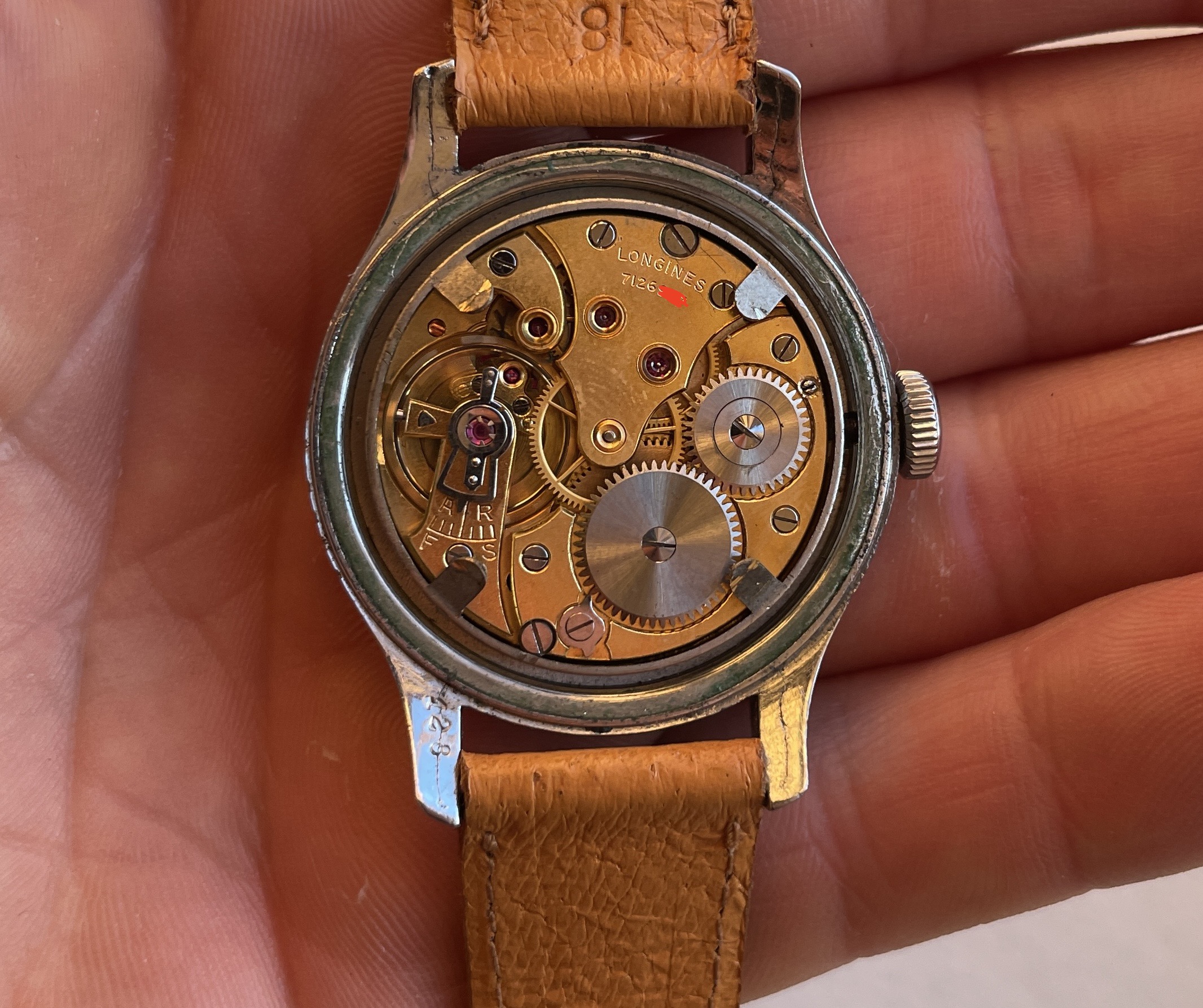

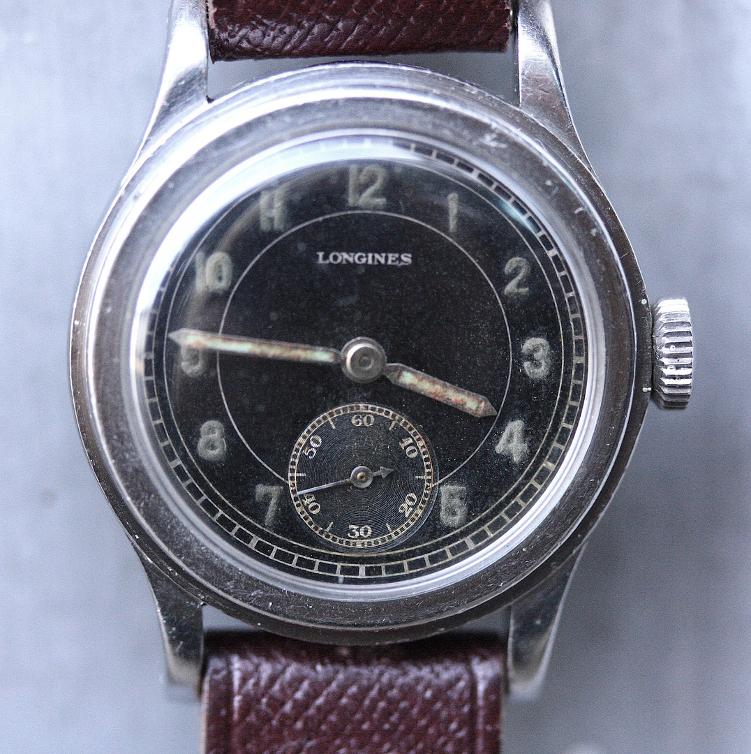

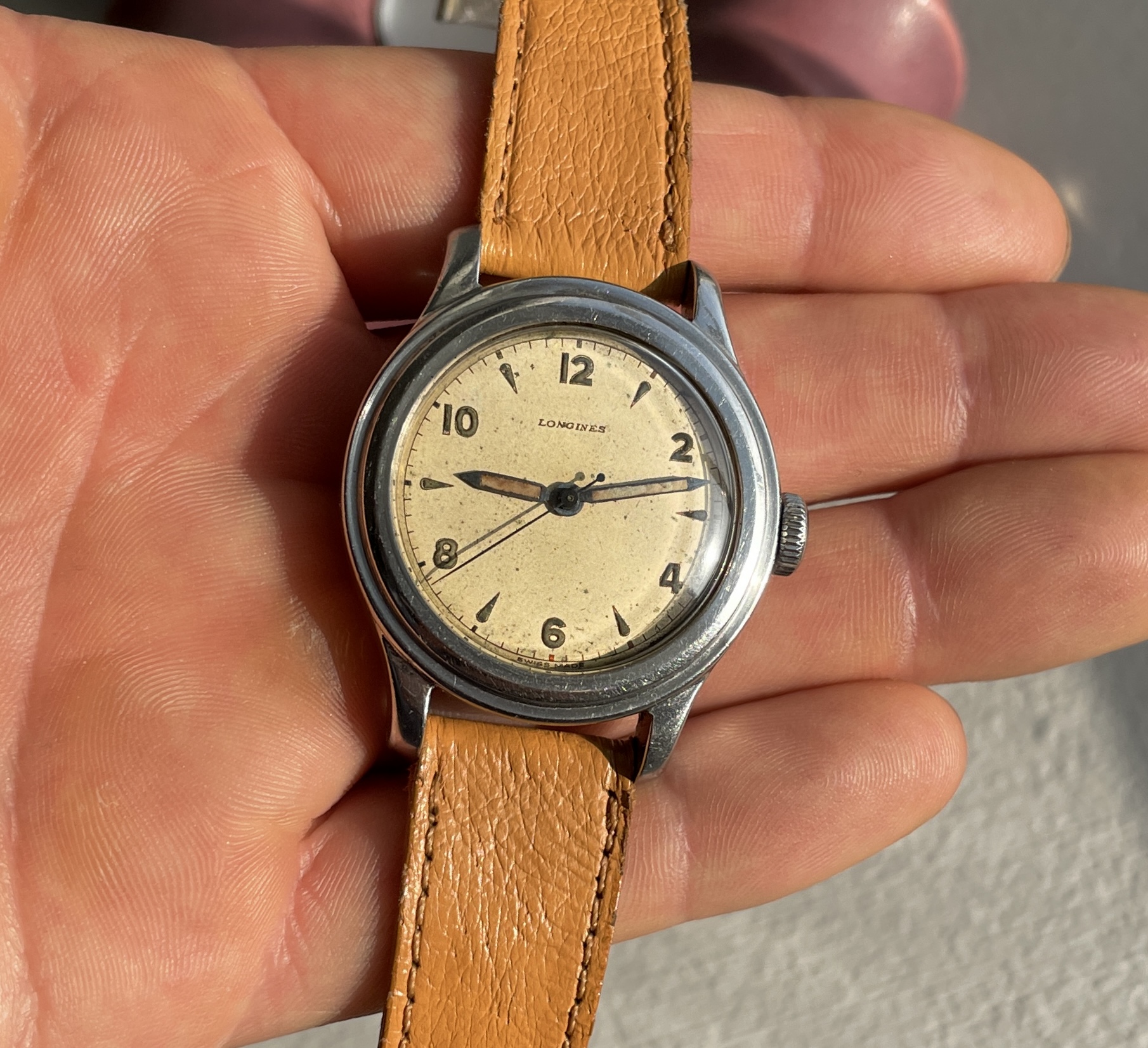

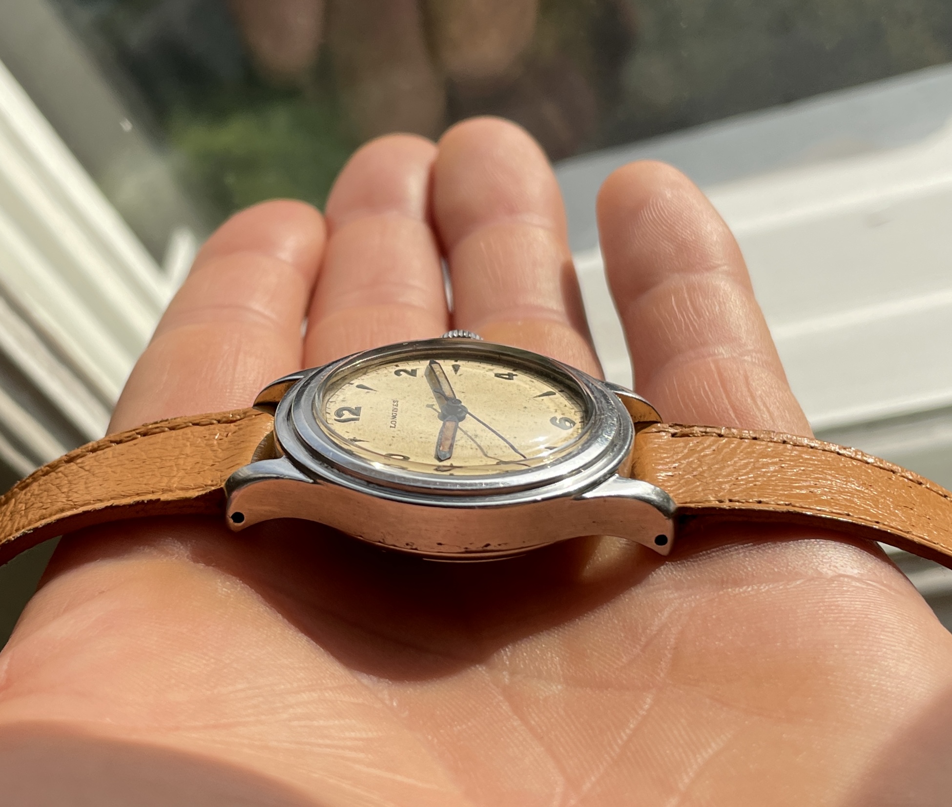

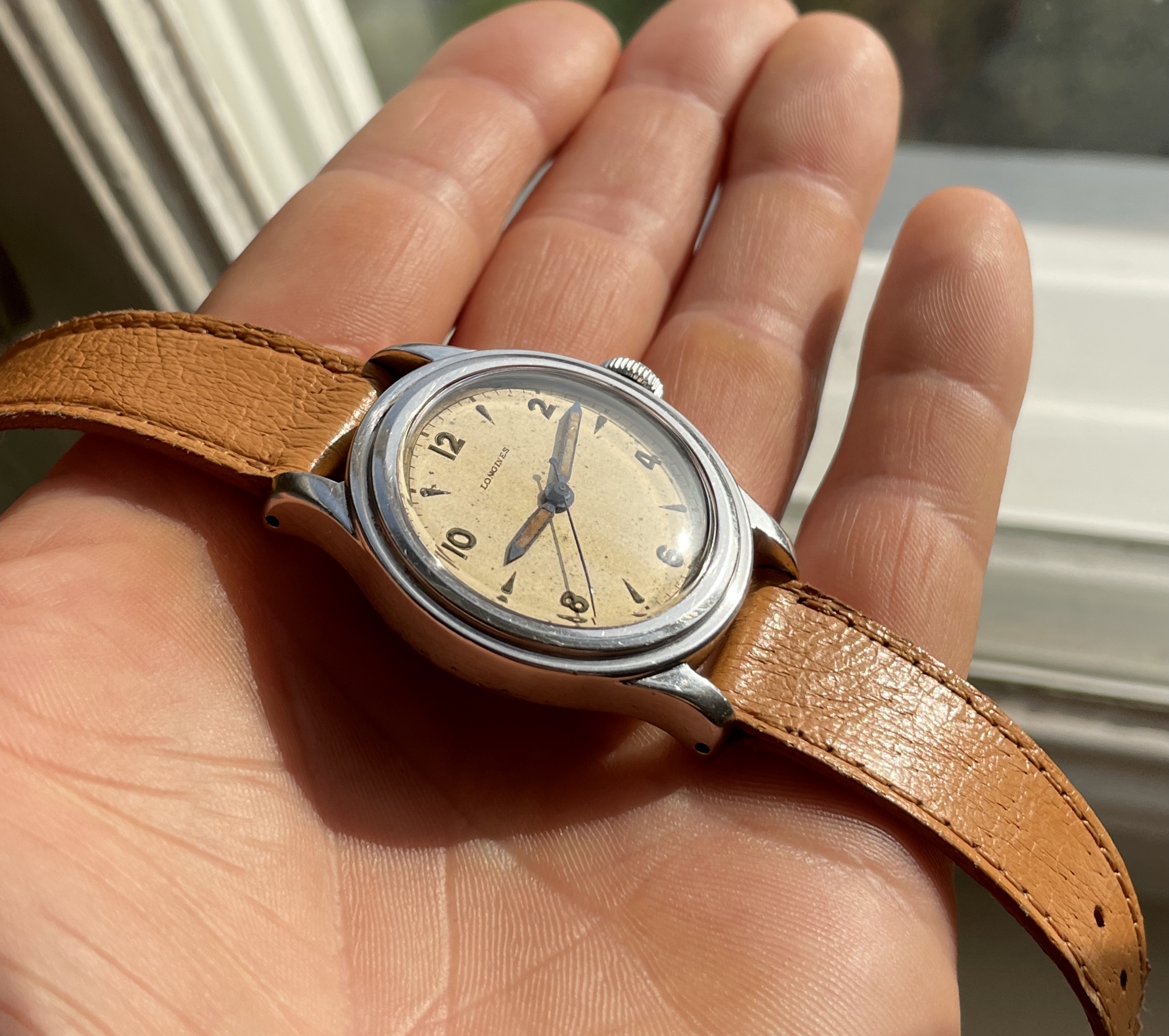

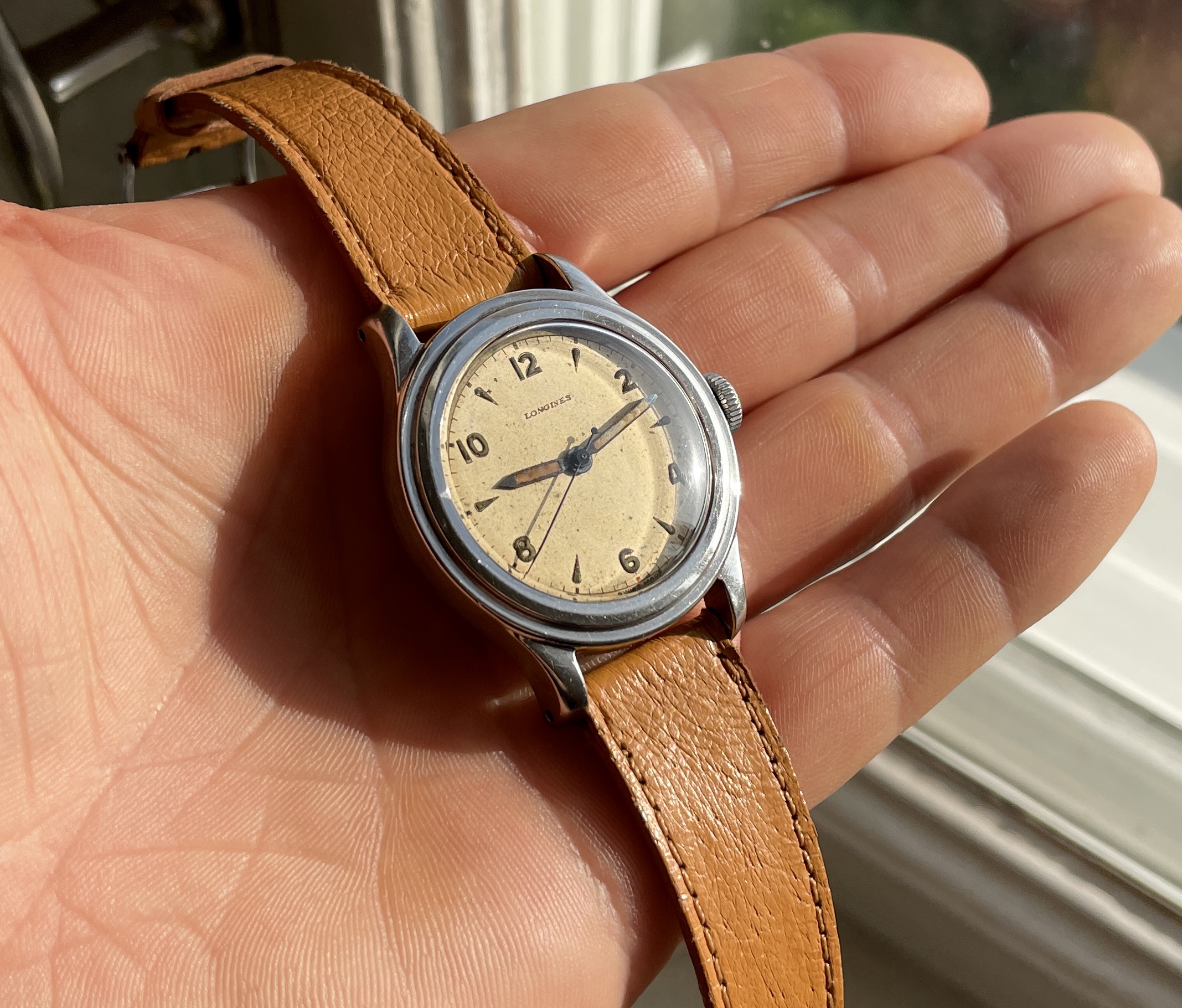

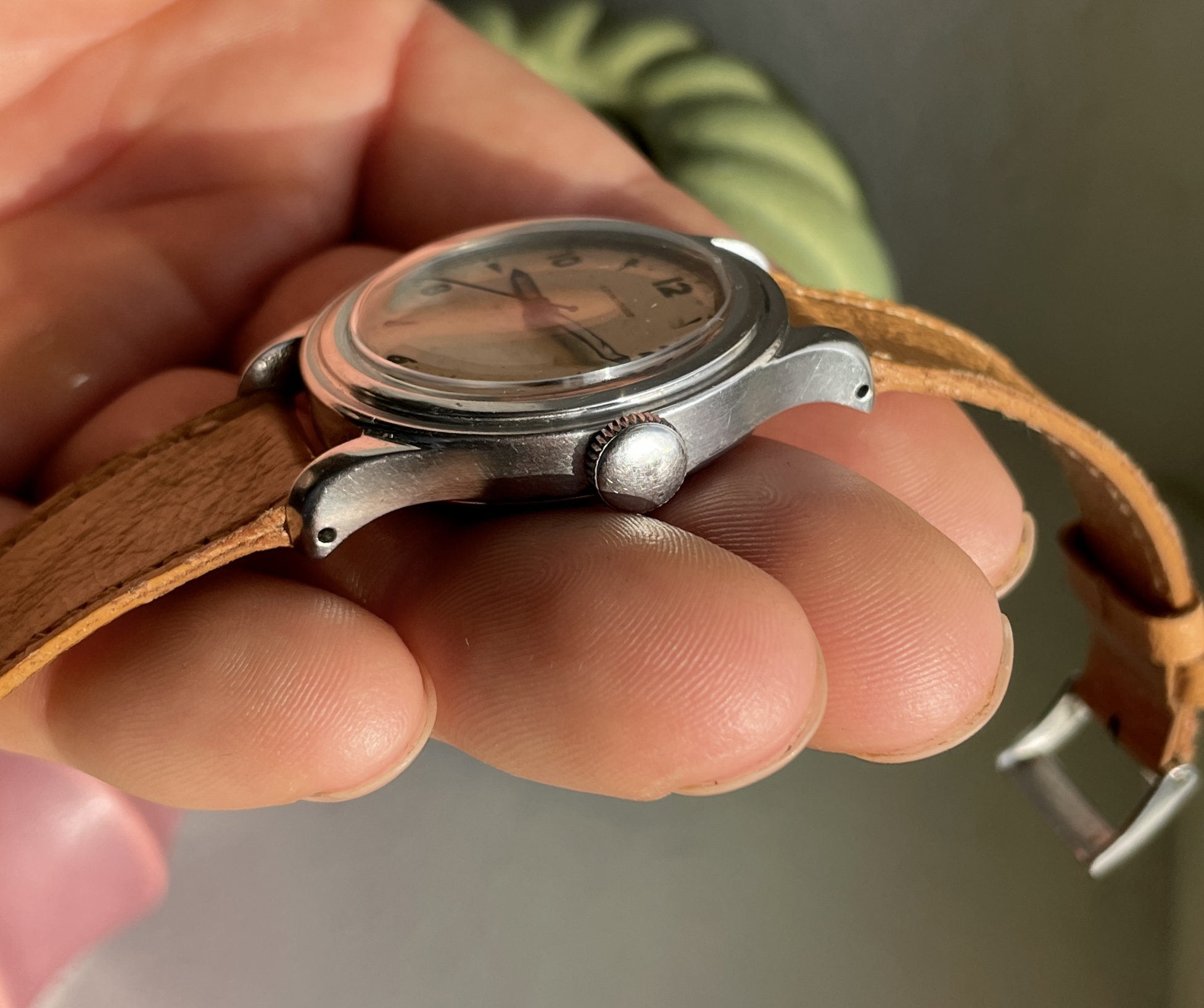

Also thought I should share some photos after replacing the glass and putting it on an old pigskin strap, really love the case on these!

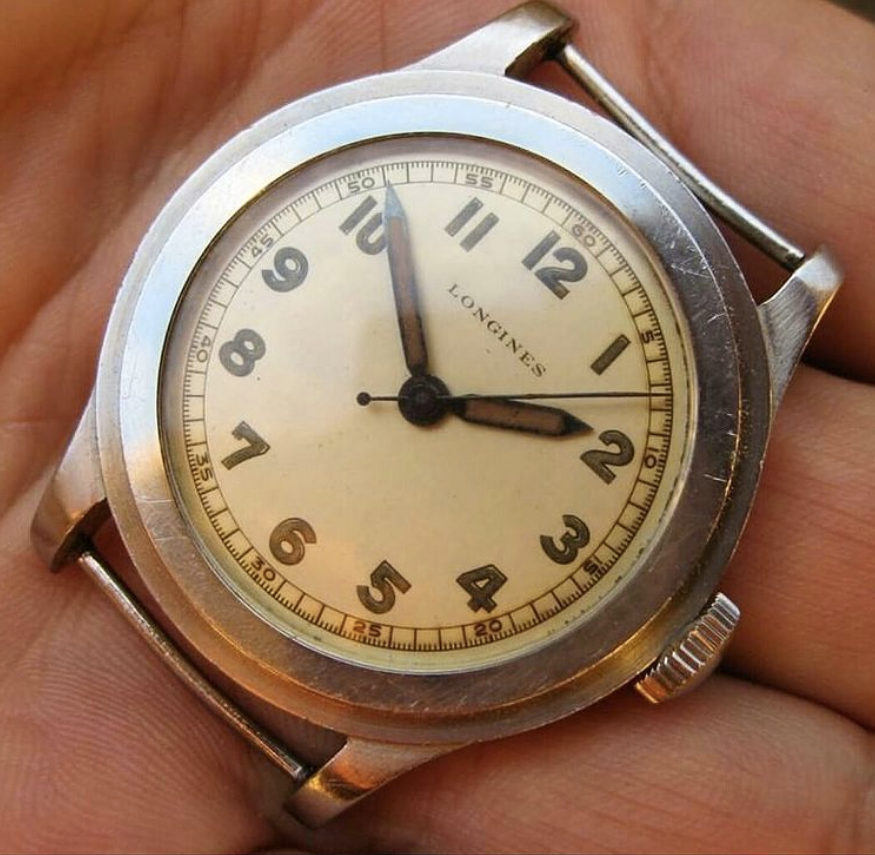

In terms of design, the first dial would be a pretty good fit for your tre tacche. As you have noted, most 35 mm tre tacches have sub-seconds so finding center-seconds examples for reference is somewhat challenging. I will say that most center-seconds 35 mm tre tacches I have seen have radium dials, and I imagine that yours originally looked similar to the one below.
The second dial would not be correct for a tre tacche. That style of dial was mostly found on American-market watches with the caliber 12L (same as 12.68N but with "12L" marking). The "Swiss" marking is okay.

I agree that most 35mm tre tacches have sub second making the center second version even rarer to find, from the top of my head I think I have seen at least one center second 35mm without lume. But as I stated earlier I wonder if the majority of the 35mm tre tacches you see nowadays actually started out with the dial you see in them today or if they where replaced with better dials from other models.
If it makes it easier to find a sub second donor dial I guess many that have walked down the same road as I do now they would have taken that shortcut. And if there is no 100% way to determine what dial/movement originally was put in what case I might take that decision as well.

Yea I agree that its not a particular bad redial, except from the logo everything else looks actually really good and fooled me. So I'm wearing it with joy until I hopefully find a donor dial, but something small just aches inside me when knowing its a redial unfortunately.

The one example I found that probably is most similar to mine (same reference number 4142, same movement etc) is this from Analog/Shift and fortunately they even show the extract from Longines in their pictures.
The only thing the extract states is that its fitted with a caliber 12.68Z, so either they don't specify which variant of the 12.68Z (sub or center second - 12.68Z or 12.68ZN / 12.68ZS). Or this was fitted with a sub second 12.68Z originally and now is fitted with a center second dial/movement and therefore don't match the extract.
https://shop.analogshift.com/products/as04407-longines-tre-tacche
If all extracts from Longines is this scant it really opens up the options for missmatching dial/movement configurations within the same case.
Third option: prior to the introduction of cal. 12.68N, Longines produced center seconds versions of the cal. 12.68Z.

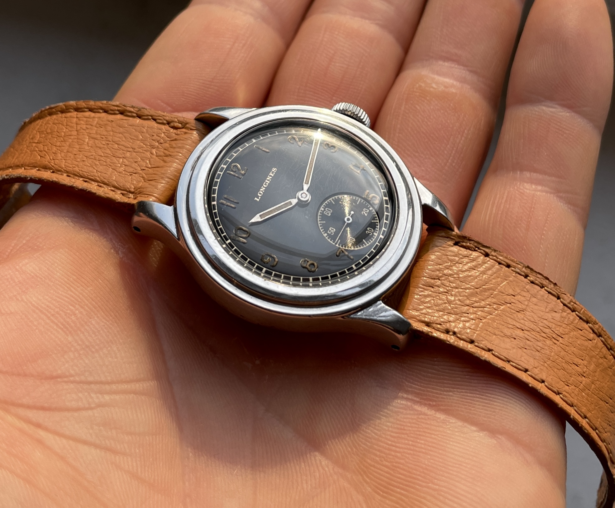

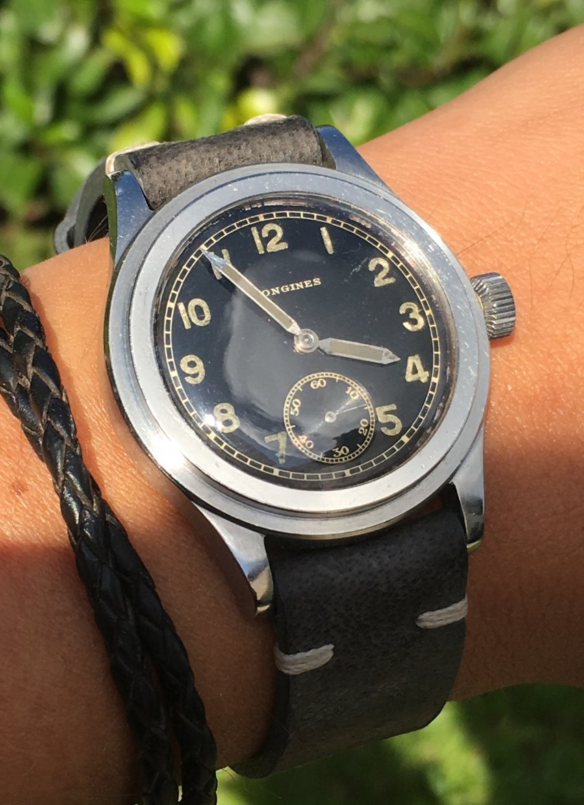

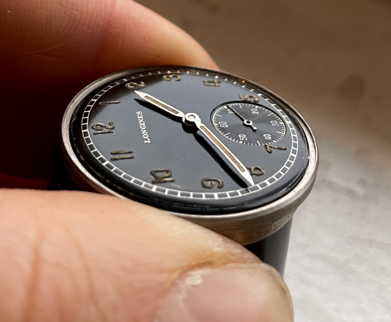

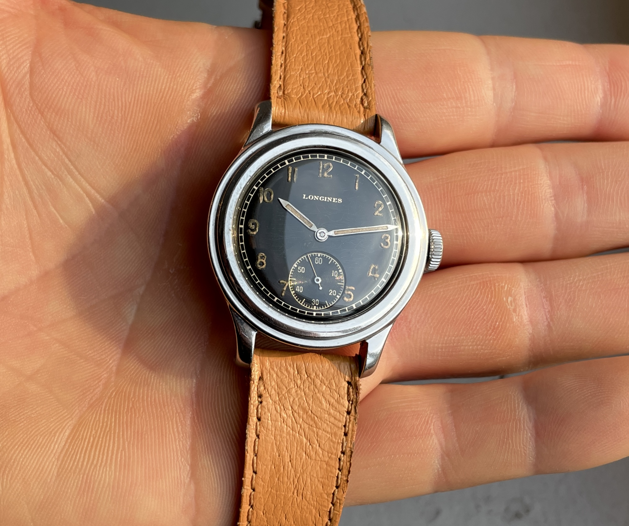

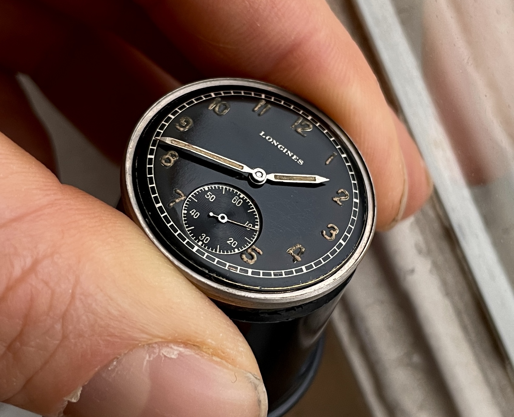

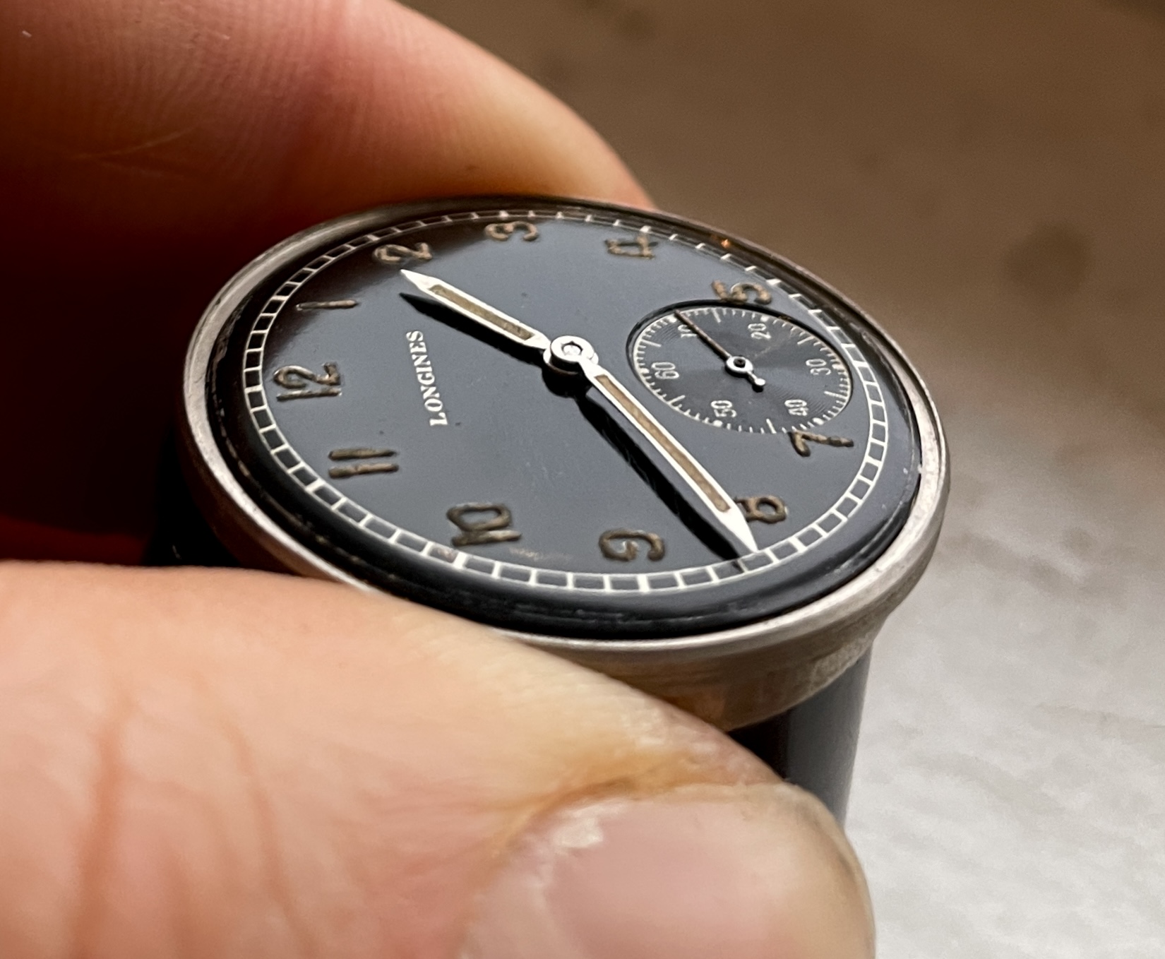

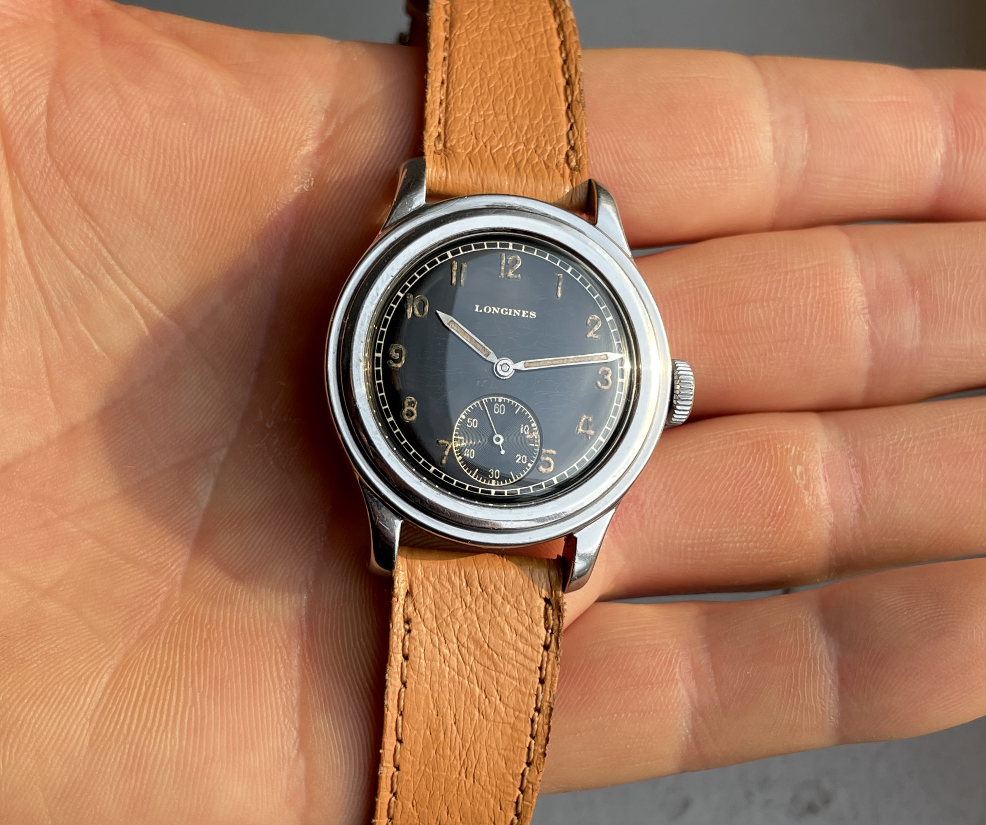

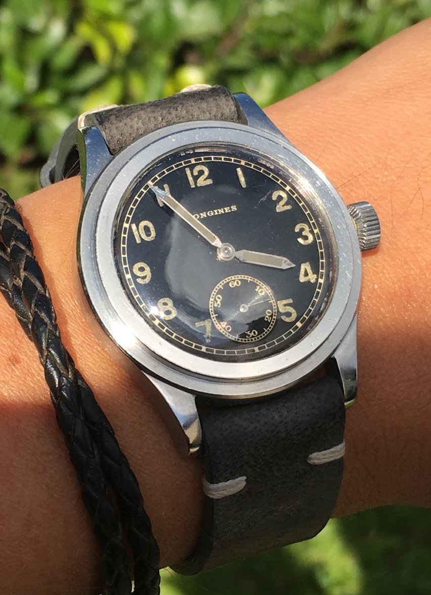

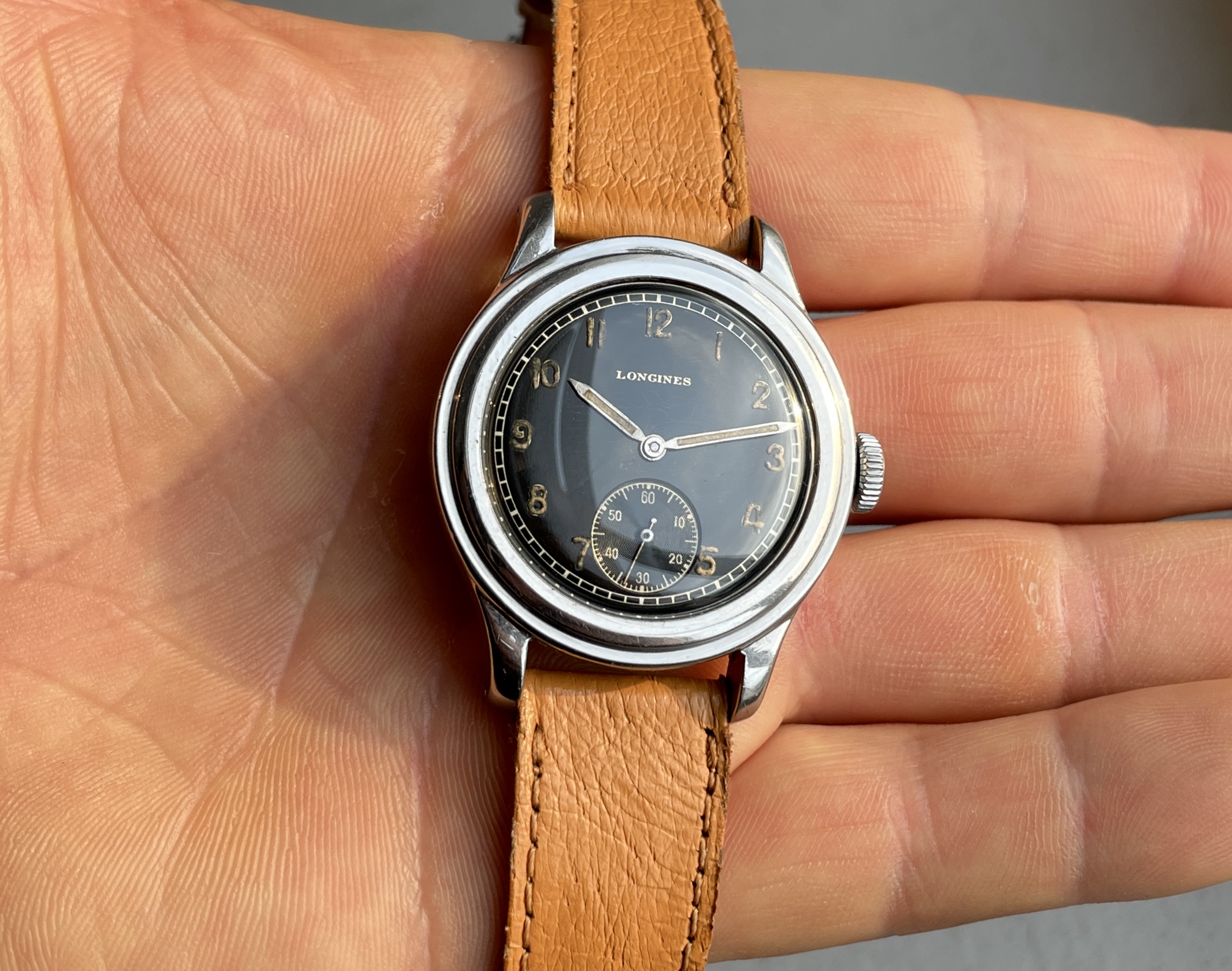

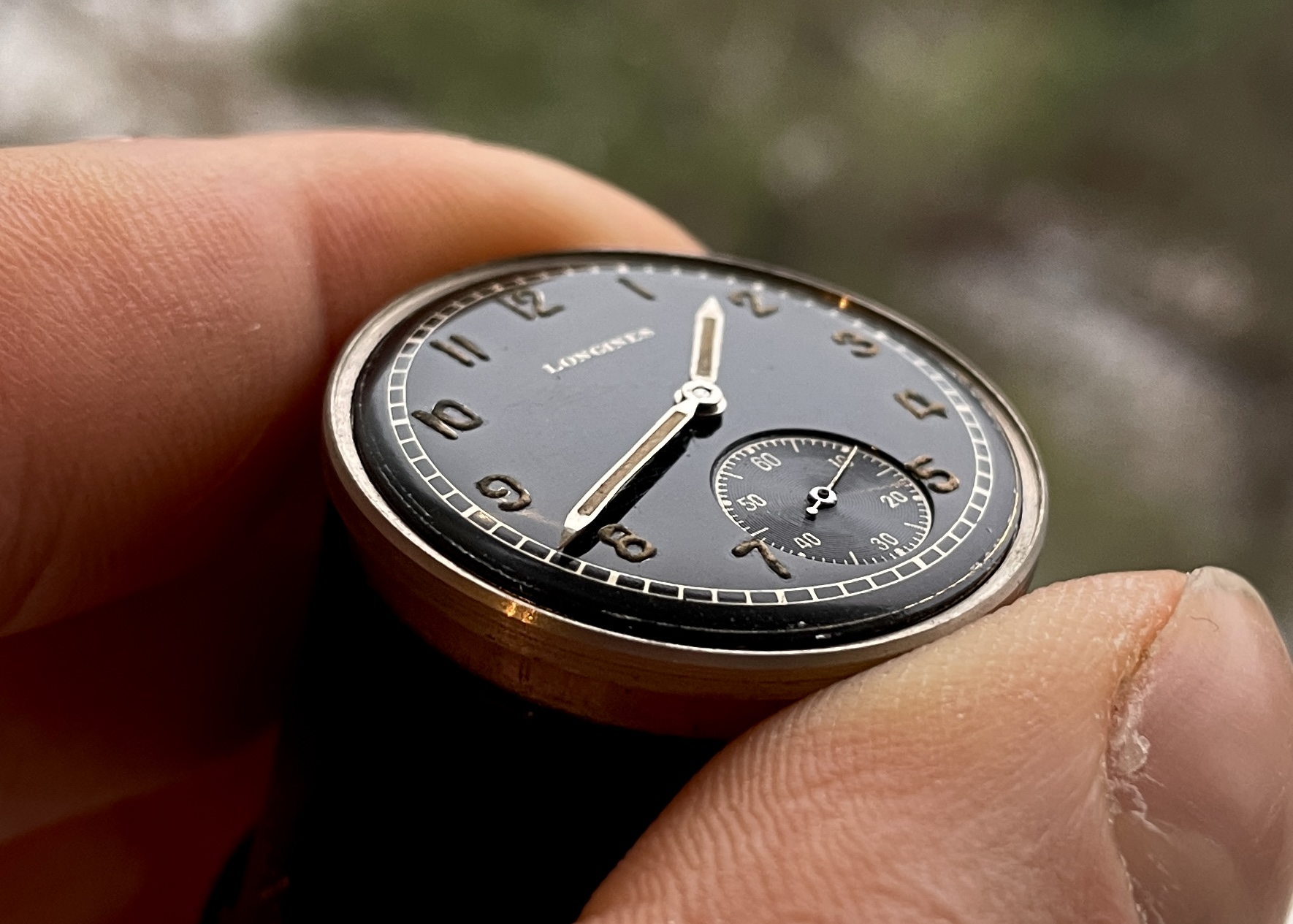

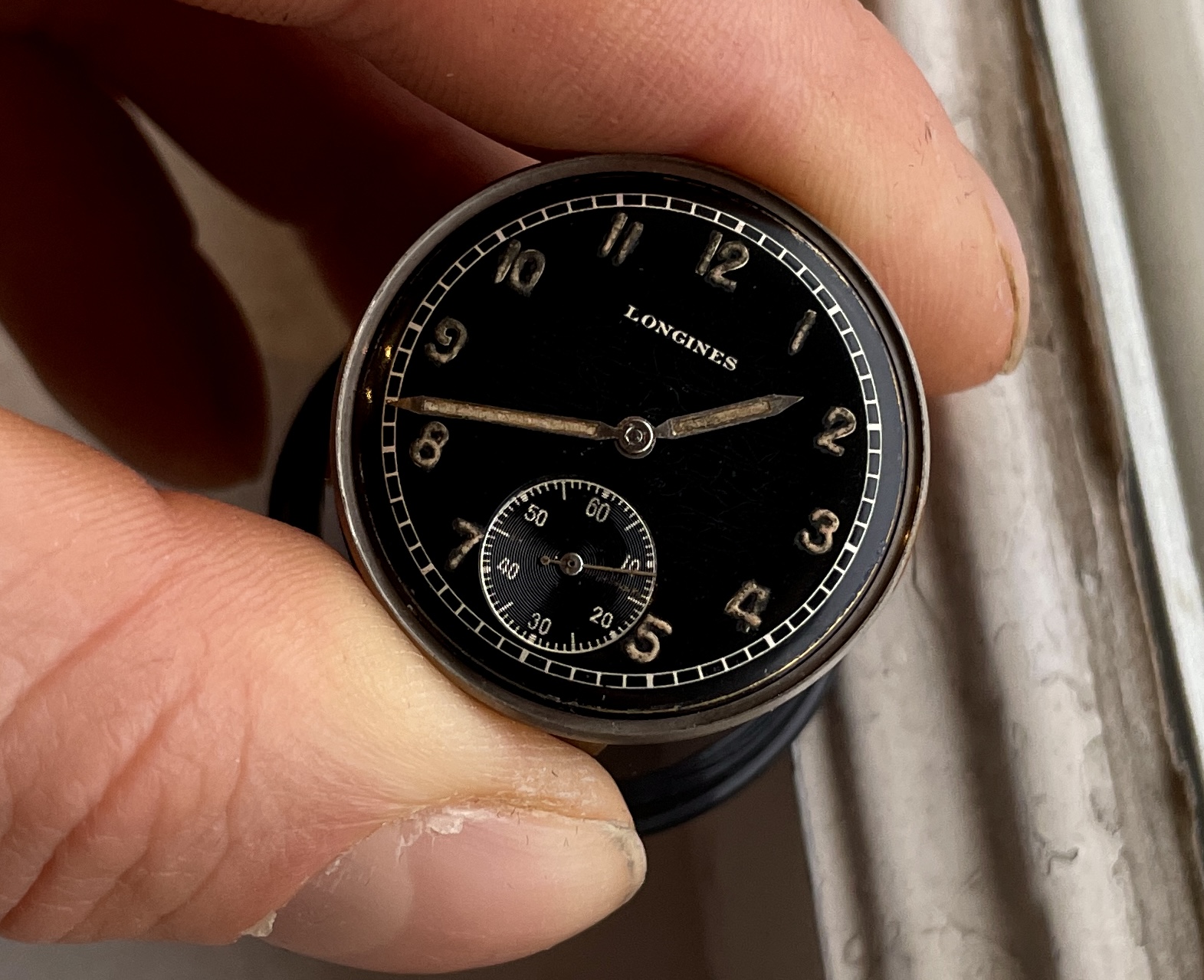

So I manage to find a very nice donor dial
Thanks for the update. I wonder if the donor dial is flat or convex? It looks to be from a later sei tacche. I would be curious to know the serial number of the movement that the dial came with. I think that the watch looks good, though I am not certain that such a dial would have originally appeared in a tre tacche case. You will see this combination (dial and tre tacche), but I suspect that most are frankens.
P.S. Having said the above, as long as you enjoy it, great result!

Dial and movement I suppose? Looks good, but it looks like you had to slaughter
a very cool Longines to get there😀
Yes the movement as well since this is a sub-second 12.68z, I indeed had to waste a pretty good Longines but I valued it higher to put the dial into this case which i prefer. Still having my eyes open for a centrum-second donor dial so if I manage to find one I still have the spare case to put this back into!
2,270
15,731

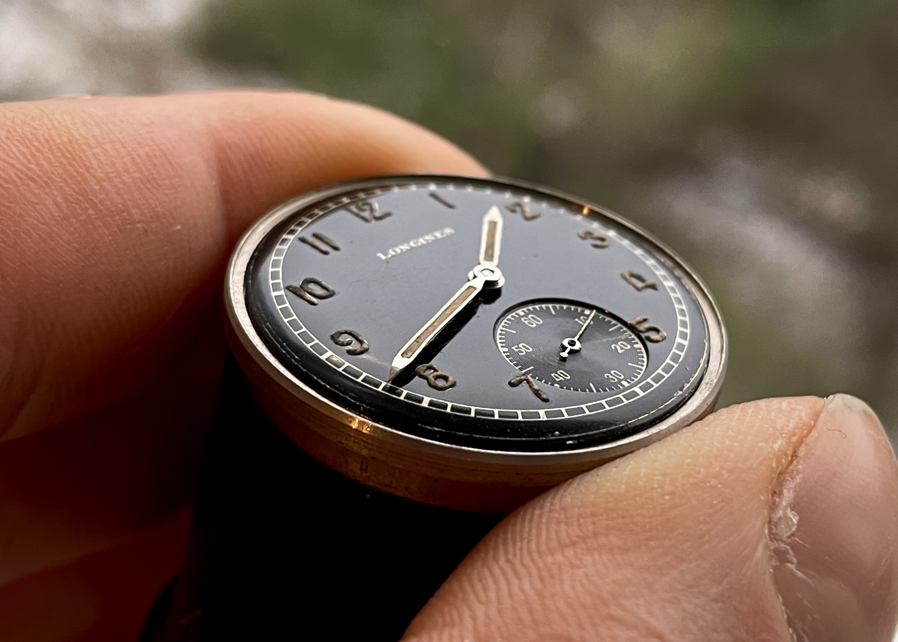

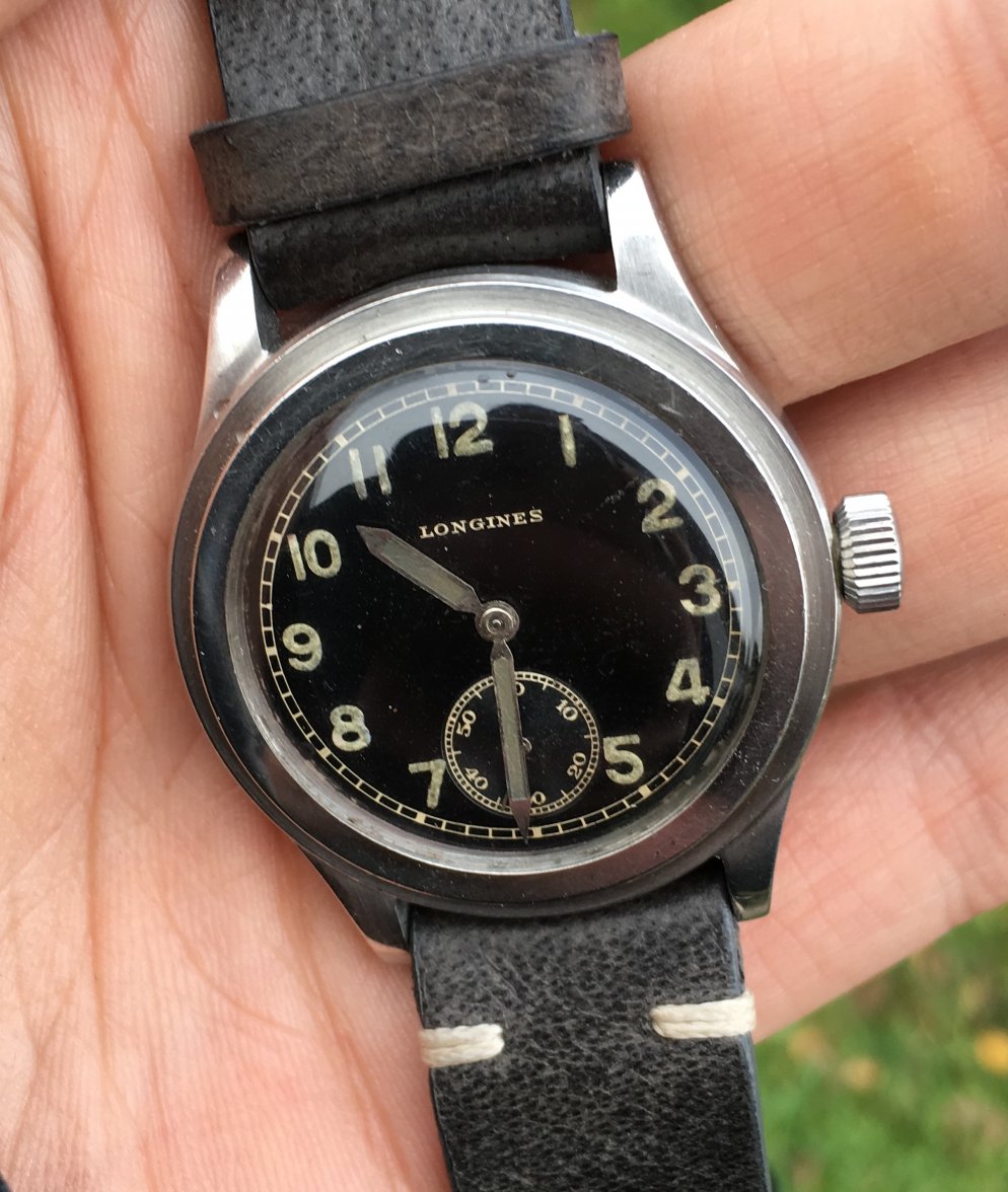

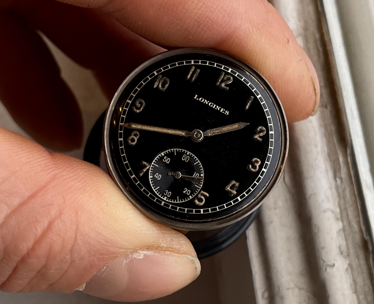

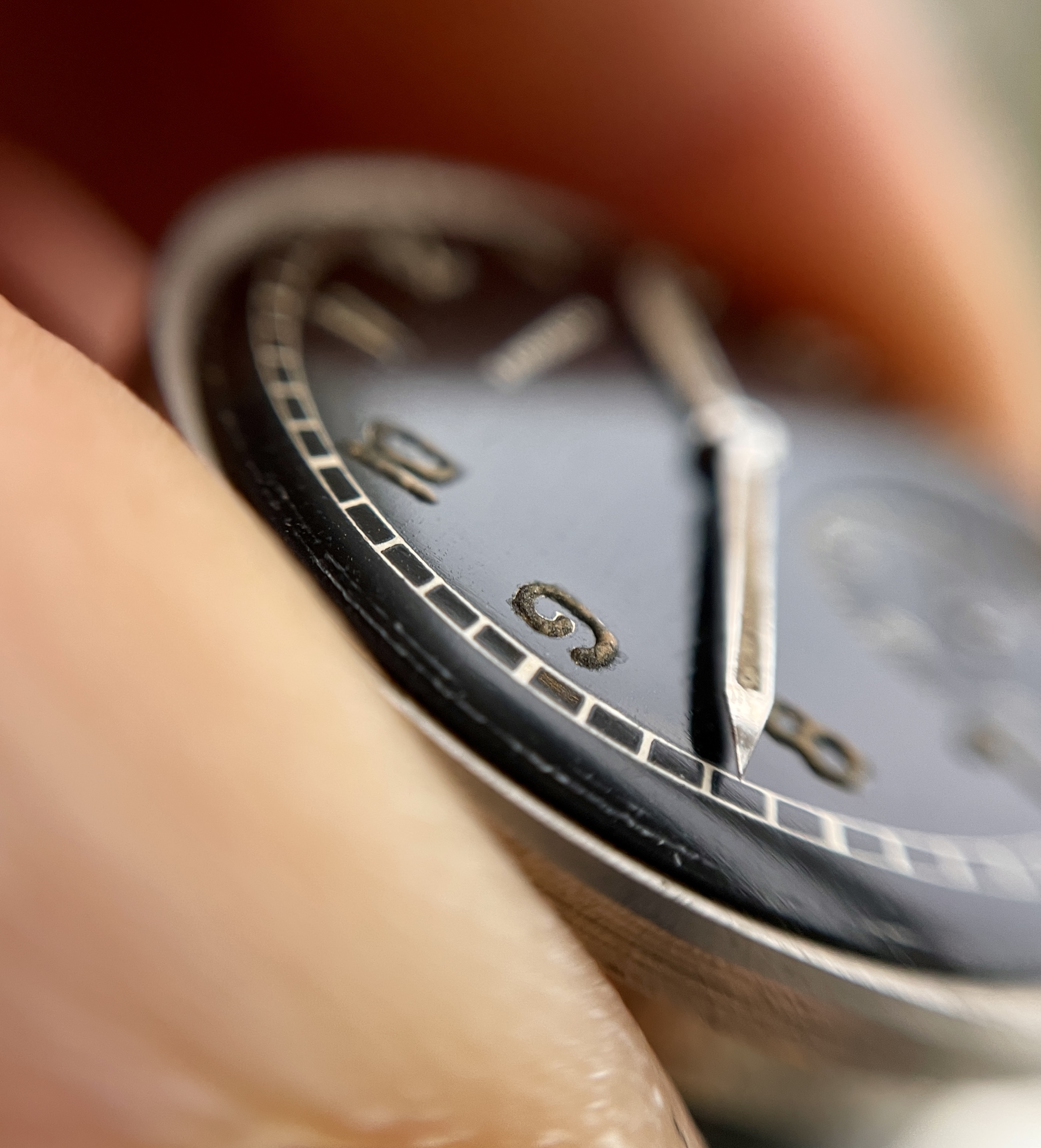

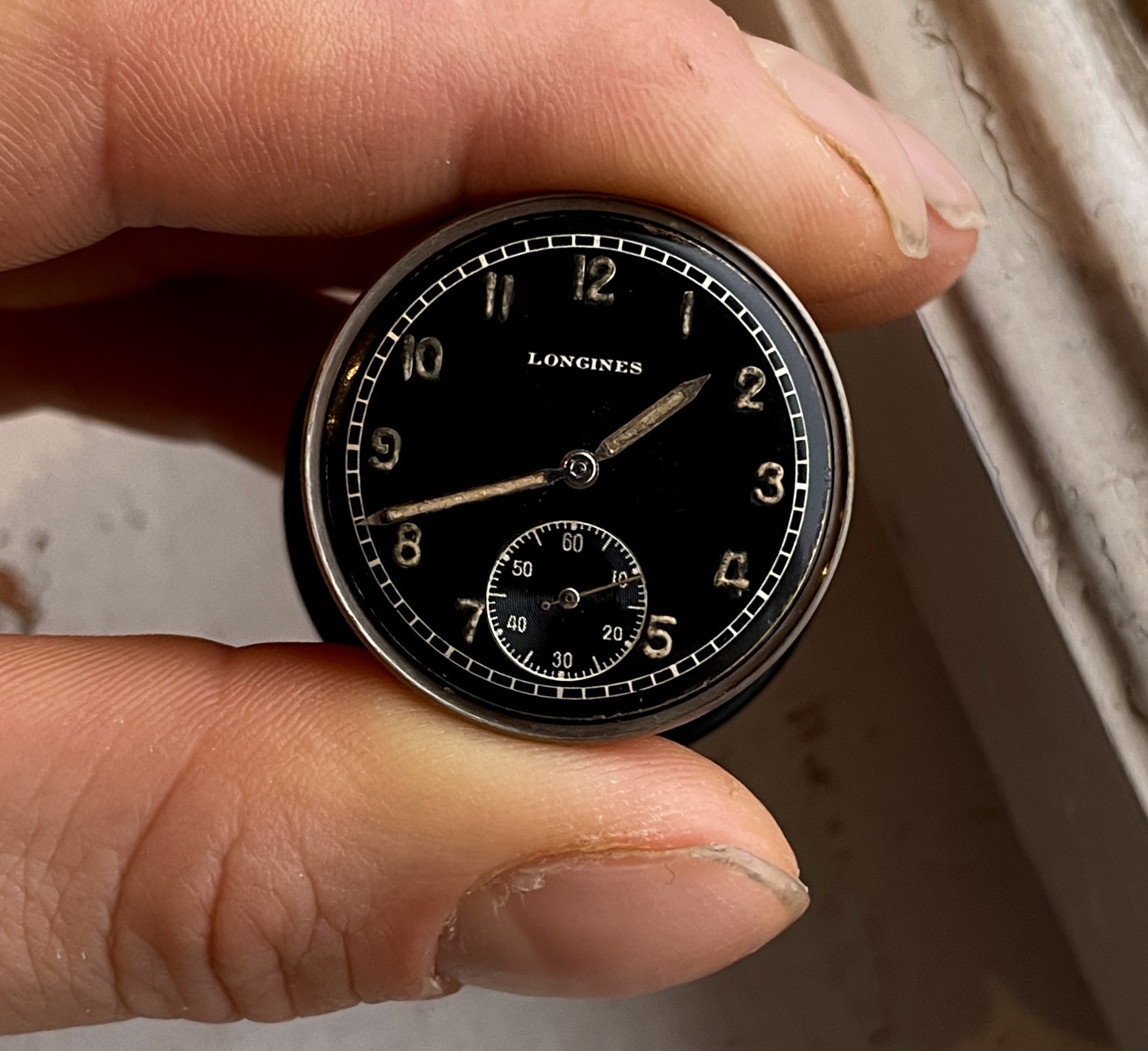

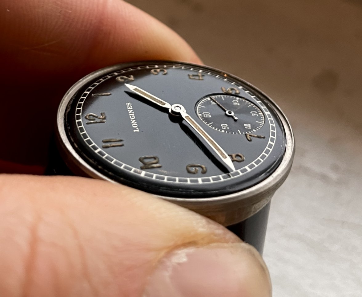

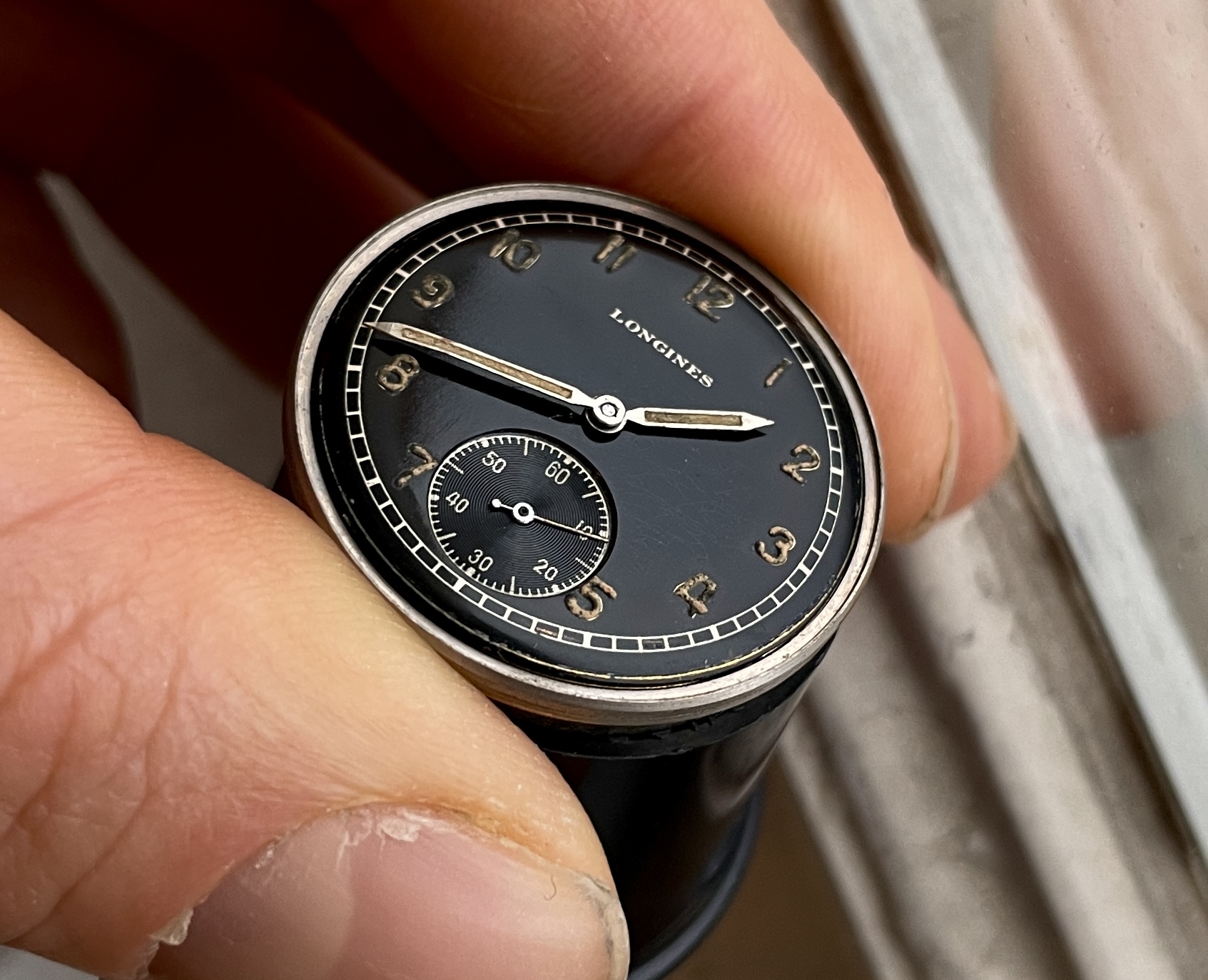

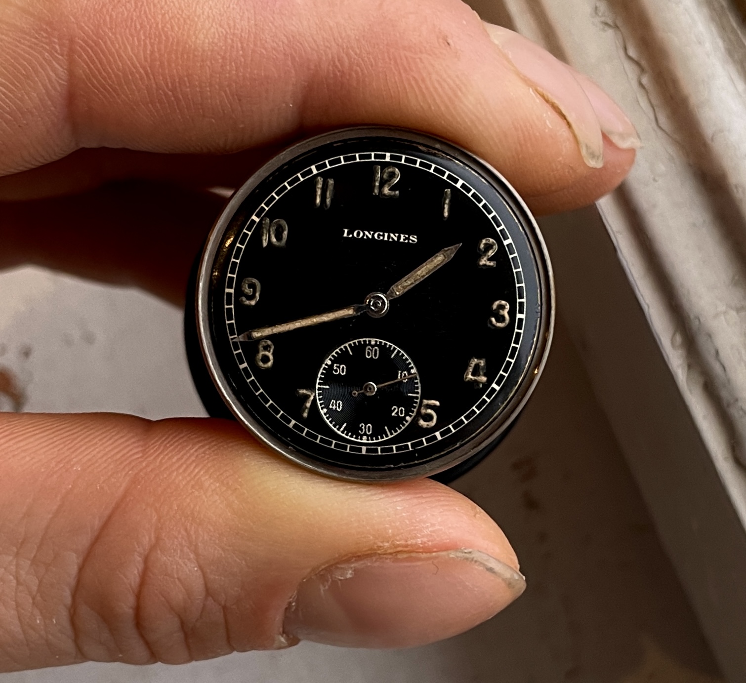

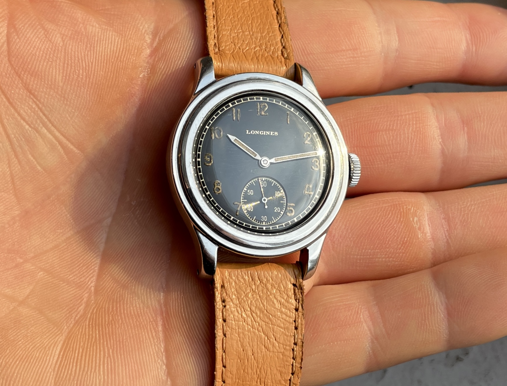

Does this look like a flat dial, maybe you can be the judge by these photos?
To my eye it looks like all the other black dials I've seen on tre tacches, but since I don't have the opportunity to study them up close and out case I can't compare them. I also don't had the opportunity to study a sei tacche dial up close. Are you saying these also are put together and would not come out from Longines in this combination or saying that the dial on mine is different?
The serial number is a bit later 1946 compared to 1943, but thats not of big importance for me since this serial obiosuly don't match up with Longines batch numbers in their archives anyways since it came from another watch.
322
858
First of all you have there a great looking watch with this black dial. But so far I study your photos it doesn't look as a flat dial to me more a convex one. If I compare my tre tacche (small size) with my sei tacche there is a difference between those two - so my tre tacche dial is also flat. And all the other authentic tre tacches I saw and found in net have the same flat dials. As @DirtyDozen12 explained, there world is full of watches put together with different parts of different decades. So you should be highly bewared of what you spend to a expensive tre tacche watch, maybe it is not what it seems.
