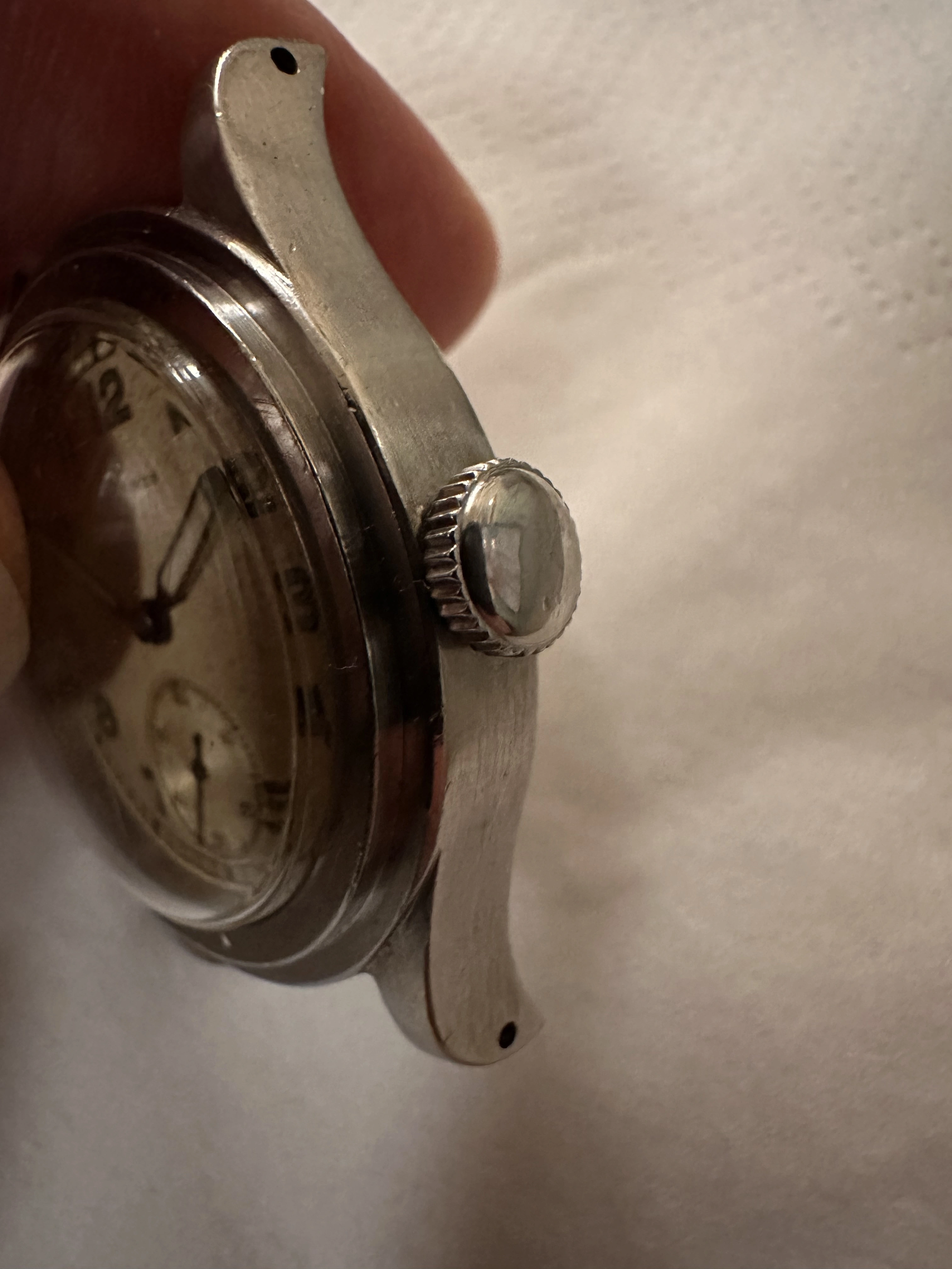

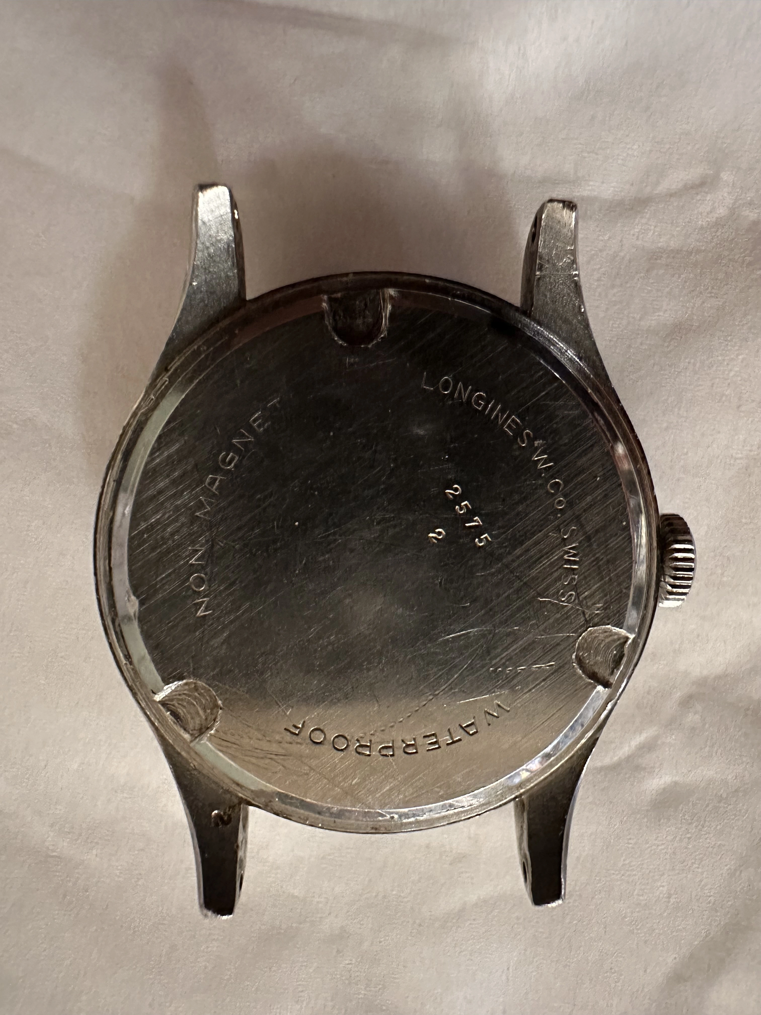

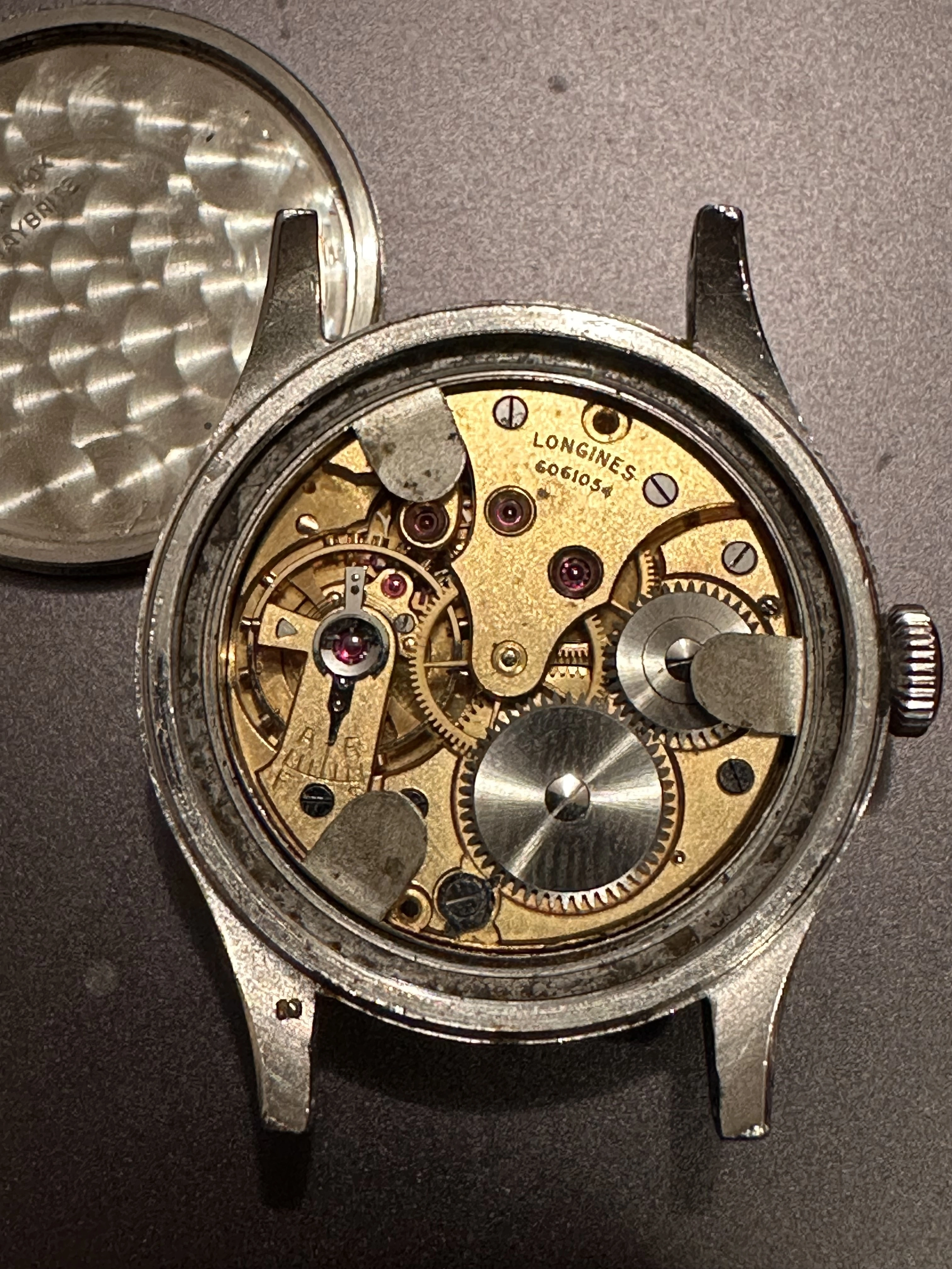

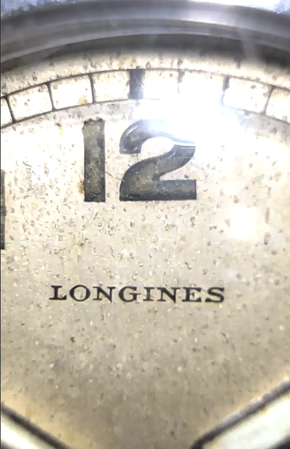

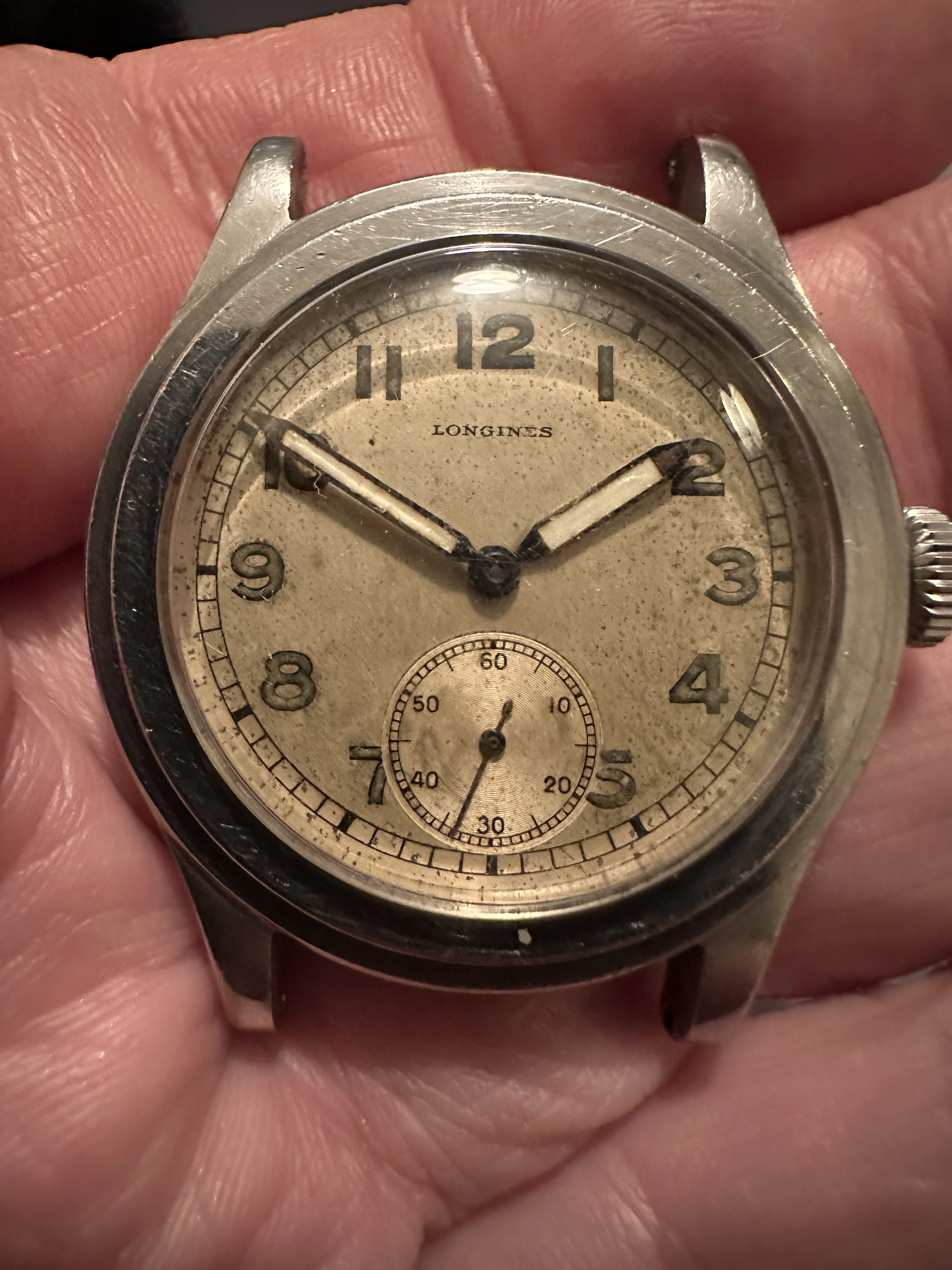

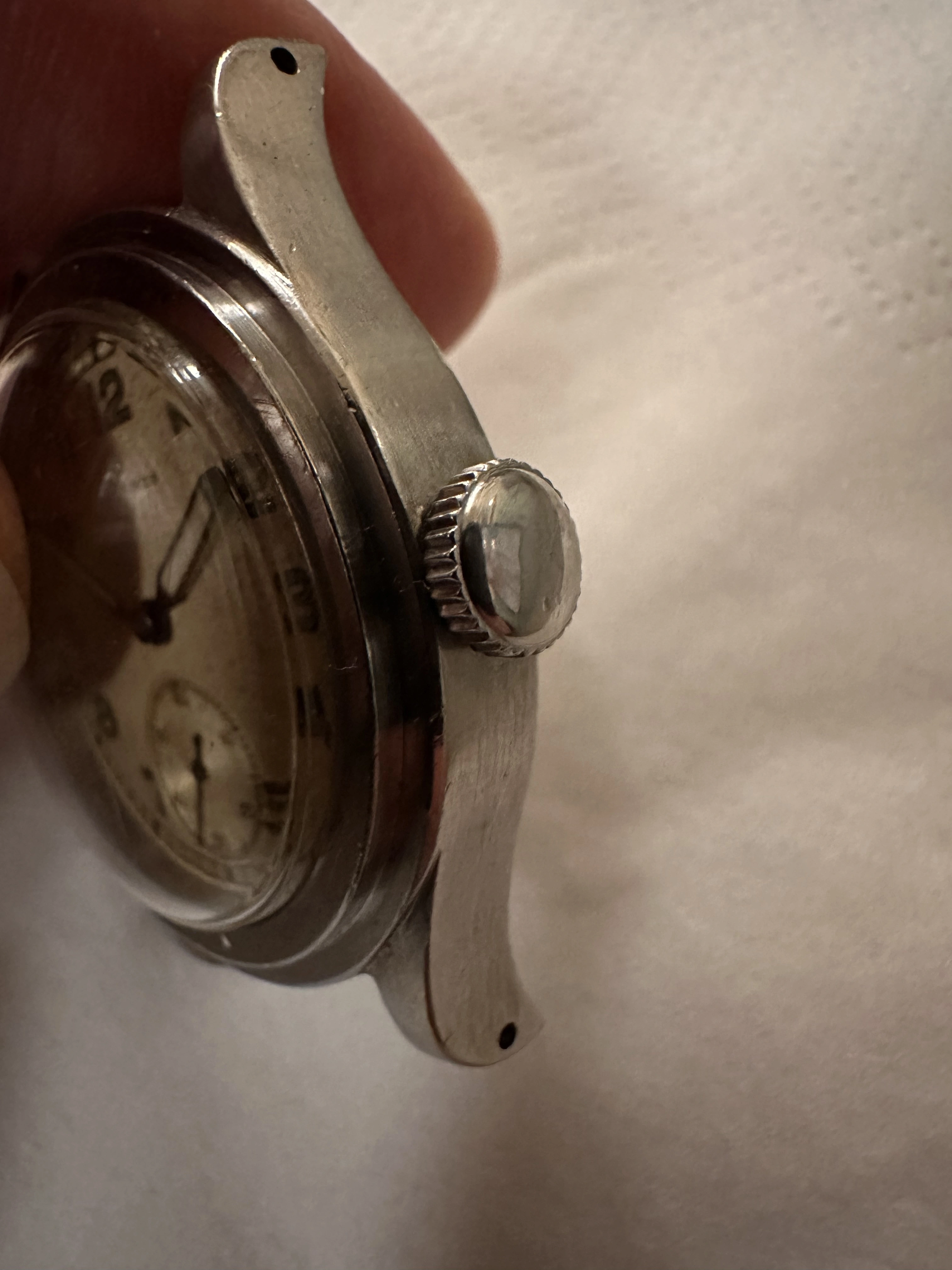

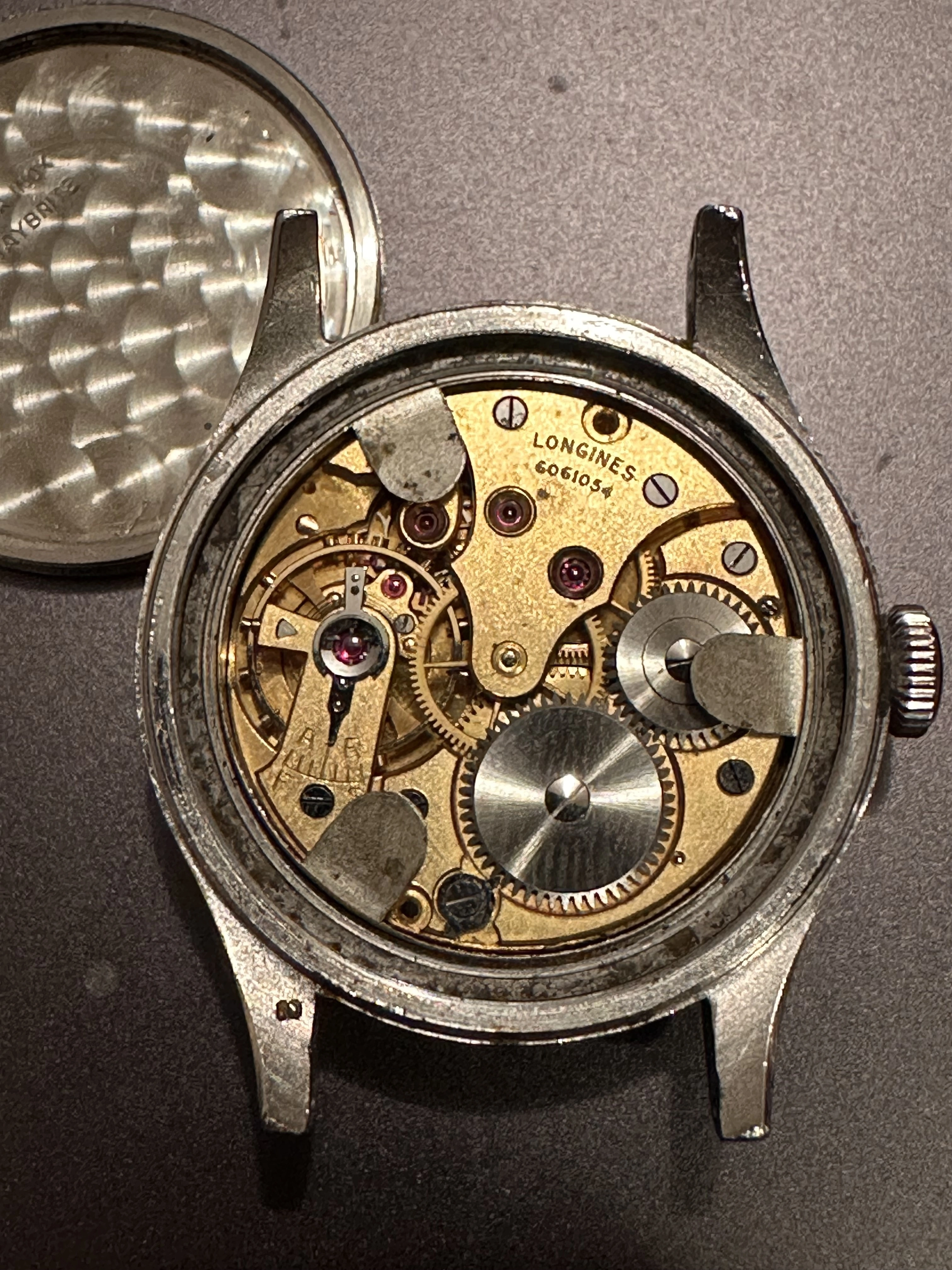

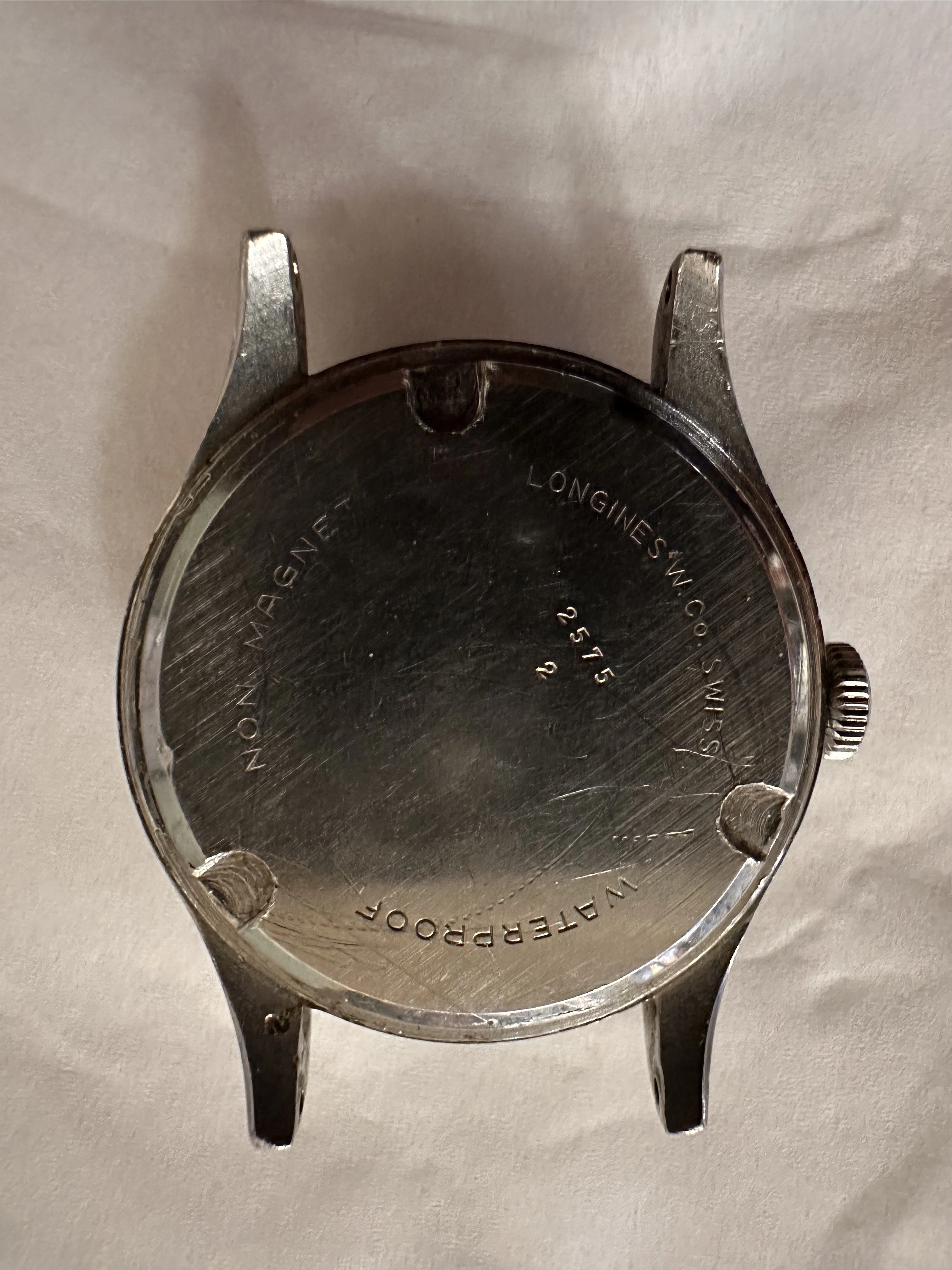

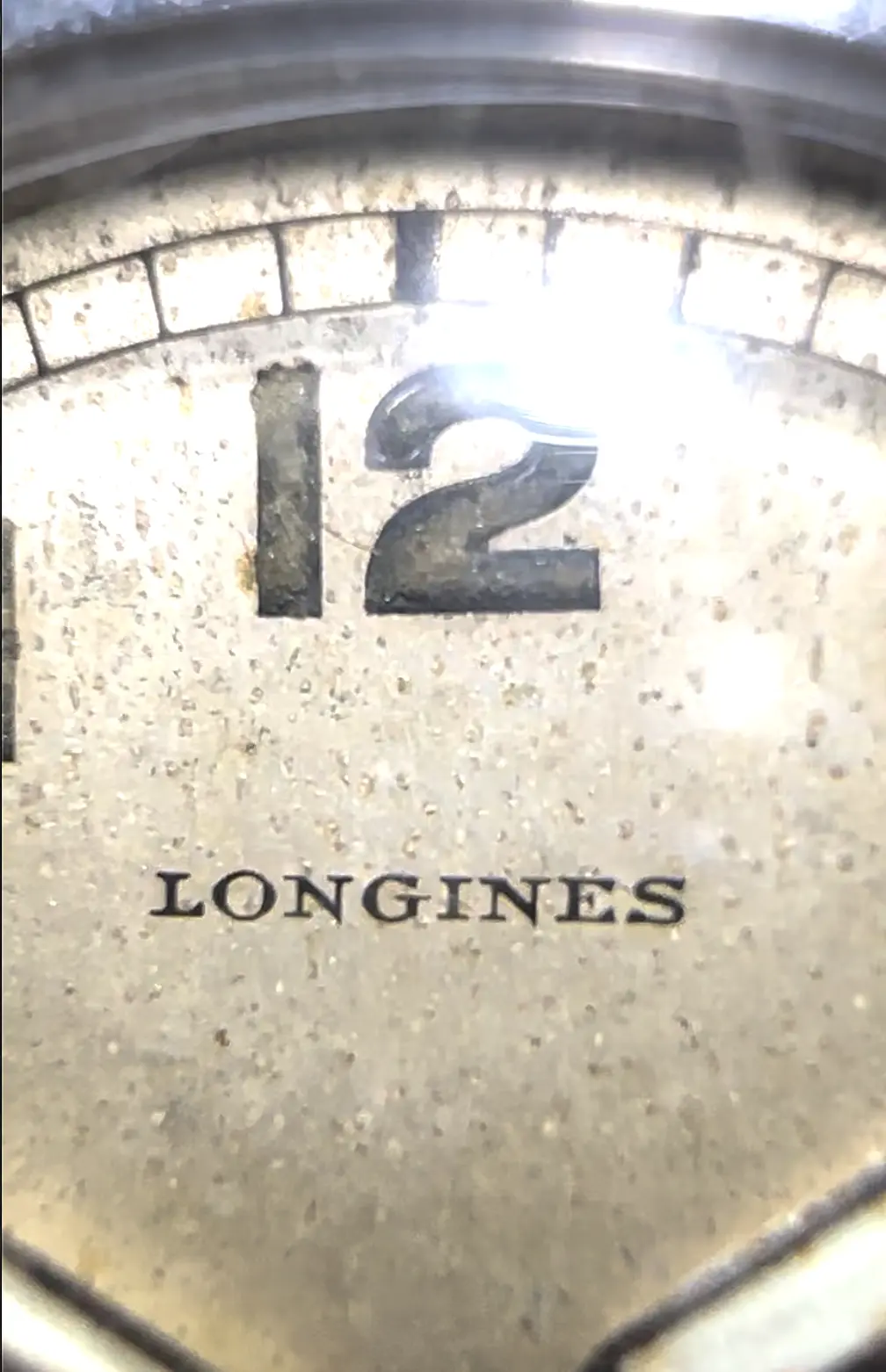

Hi all,
Just got this 35mm 1940 Tre Tacche, and while to my eye it looks ok, and so far I’m very pleased with it, would appreciate any observations from the experts, whether to not it’s good news.
Not running at present, needs retaining screws, I need to replace the relume with something less lurid, and the crystal is loose and needs replacing, other than that I think it’s ok, but welcome any insights.
Thanks,
Richard
6,904
10,769
IMHO legit and very nice
2,829
4,948
The dial looks original (not reprinted) and has the characteristic Fluckiger (ZJ) signature. The design also seems appropriate for the case, I think. Thanks for sharing photos.
82
171
Great info, thanks. As long as it's correct I'm happy, don't mind them showing their age a bit, and condition suits me ok.
