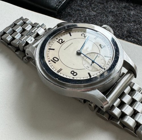

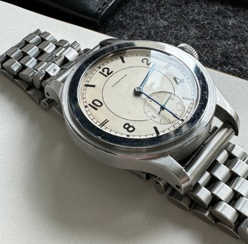

Hi all! I have been offered a glossy black dial 35mm Tre Tacche with extract that I'd love to own. I'd like to humbly ask for your help before I pull the trigger on what is to me a rather expensive purchase.
I currently own a white dial 35mm Tre Tacche (photo attached) and would love to add a black dial. I'm looking for any red flags anyone might see. Also, at around $9500, I'd also be interested in opinions on price.

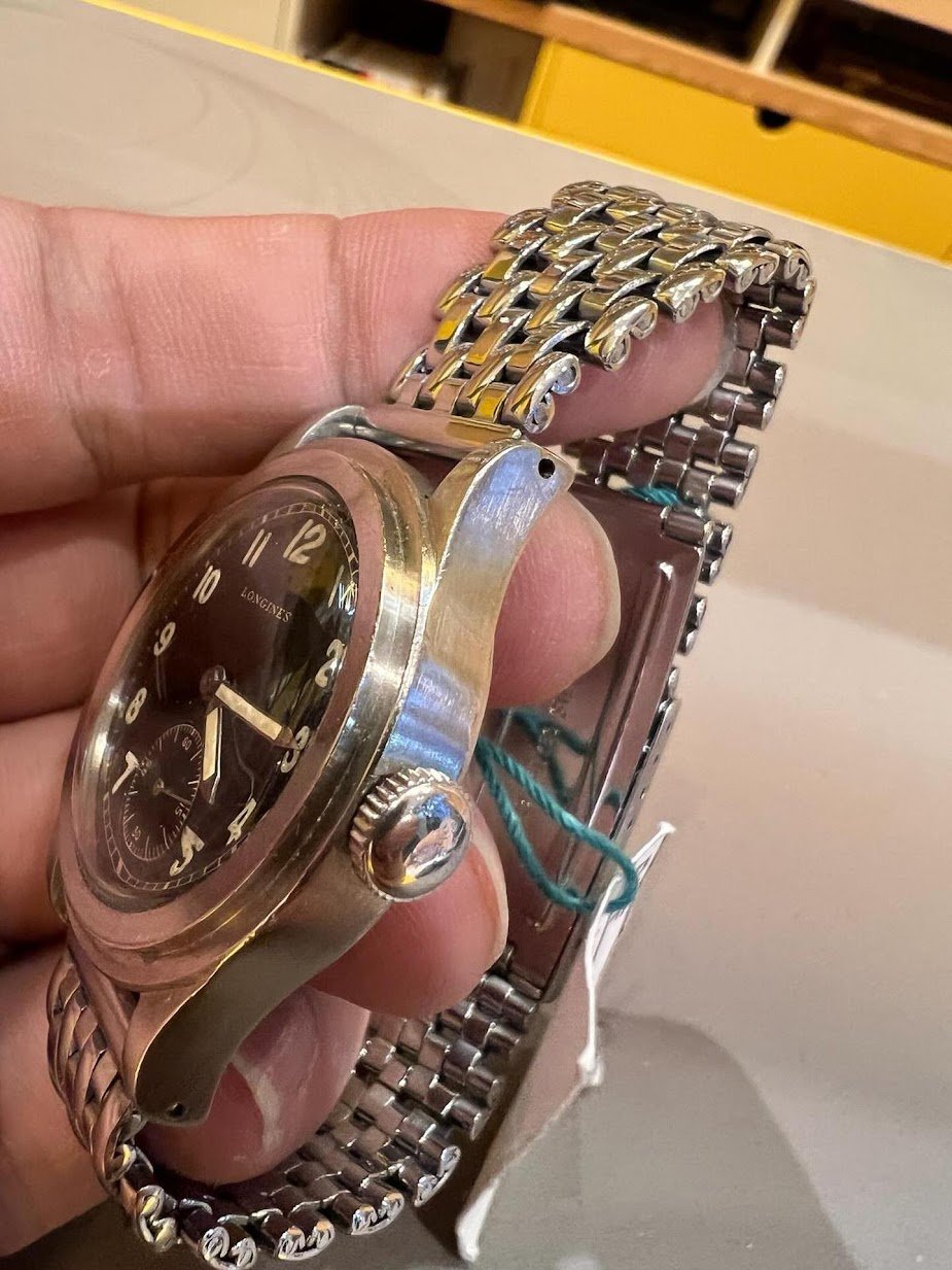

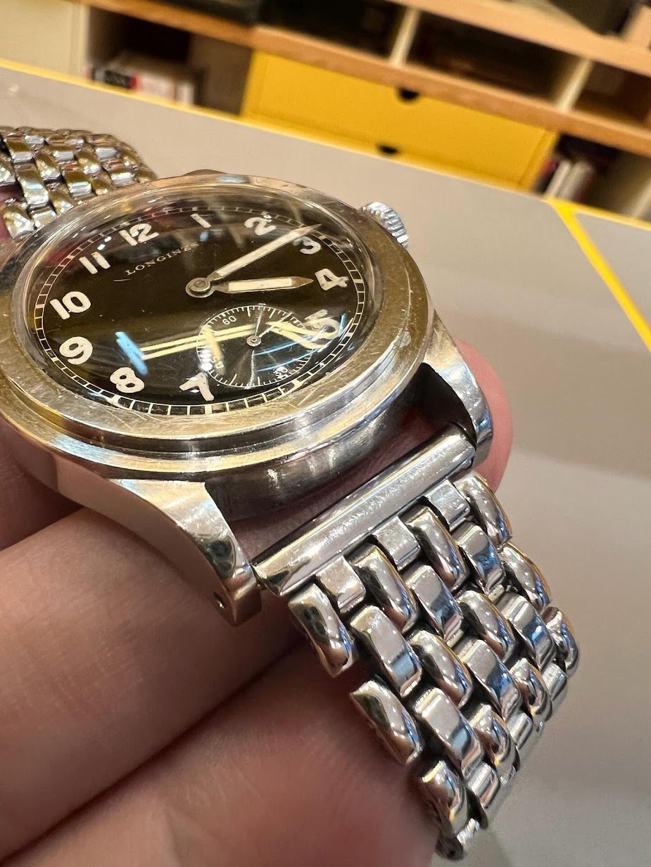

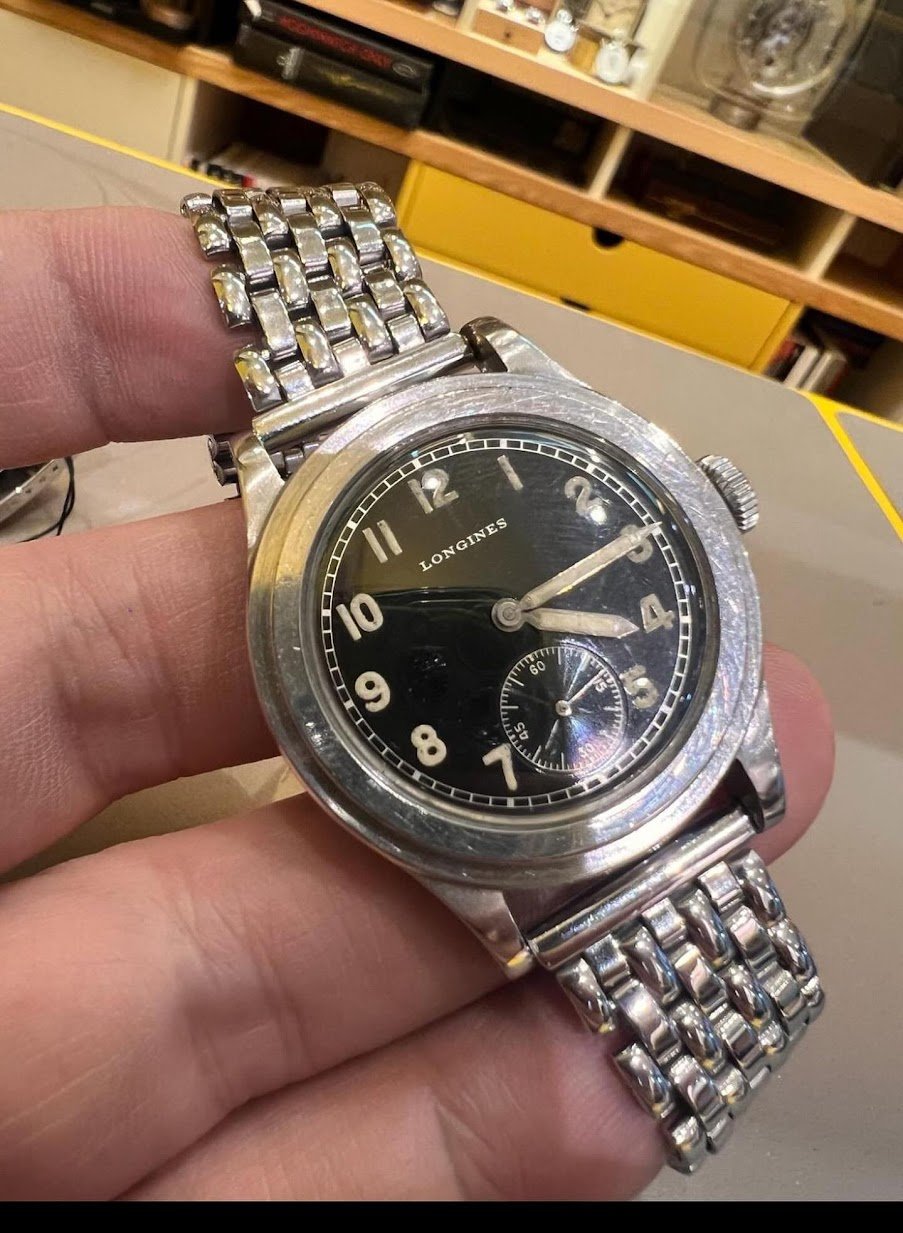

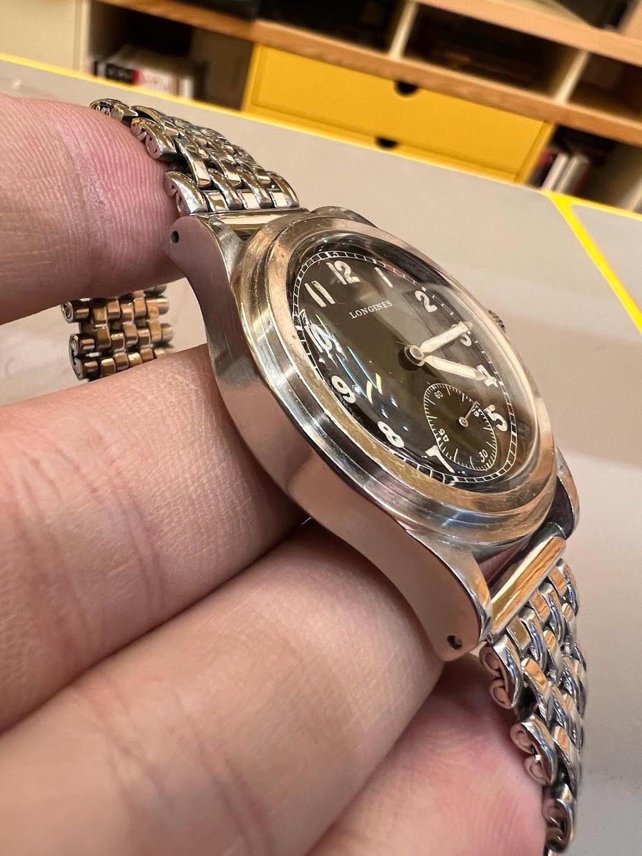

I’ll refer you to an earlier thread, below, where this subdial configuration was discussed at length as possibly being an indication of a convex sei-tacche dial being fitted later in the watch’s life:
https://omegaforums.net/threads/longines-tre-tacche-35mm.137899/page-3
It is hard to tell from the pics, but does the dial have downward curvature at its perimeter?
Thanks, this is great. I'm going to read through this whole thread and ask the person holding the watch, it will be easier for them to see. I'll let you know what they say.
I took a look at my sector dial TT and the dial is flat. It was also cool to see the logo treatments and compare them to both my TT and the one I'm considering purchasing.

The same watch was "passed" (i.e. unsold) in a 2022 Antiquorum auction:
https://live.antiquorum.swiss/lots/view/1-6OWIS8/longines
I don't know what the reserve was, but it may have been the low estimate of ~€7600
Even if the dial and hands are completely original (as claimed by the auctioneer), and I am not certain of that, I would consider the asking price to be well inflated.
