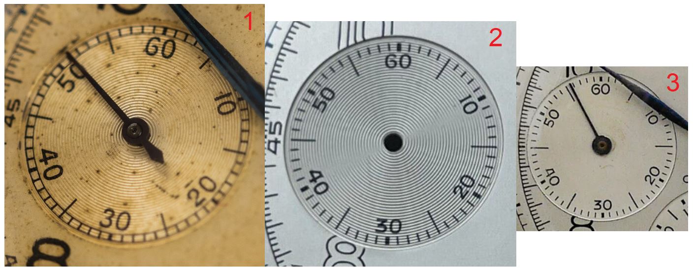

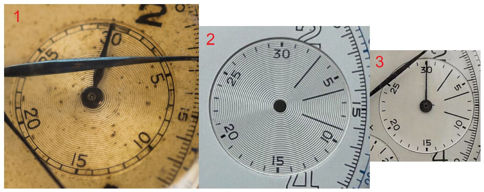

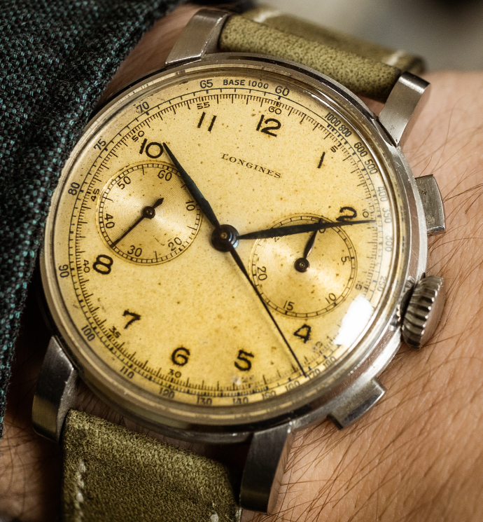

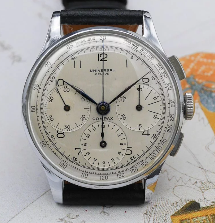

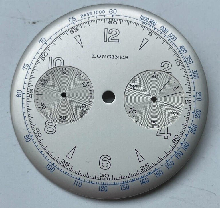

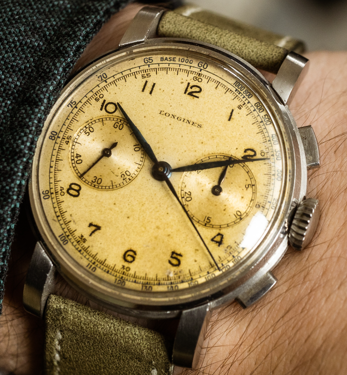

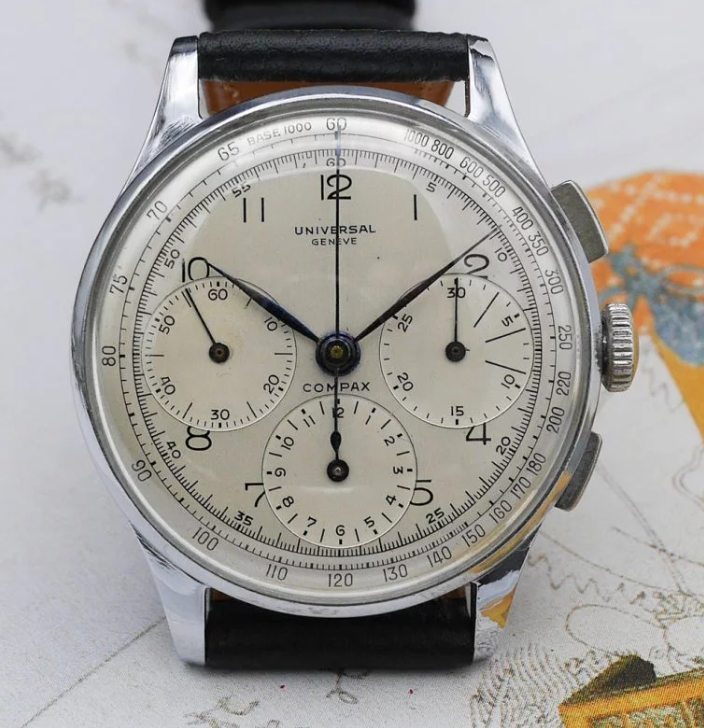

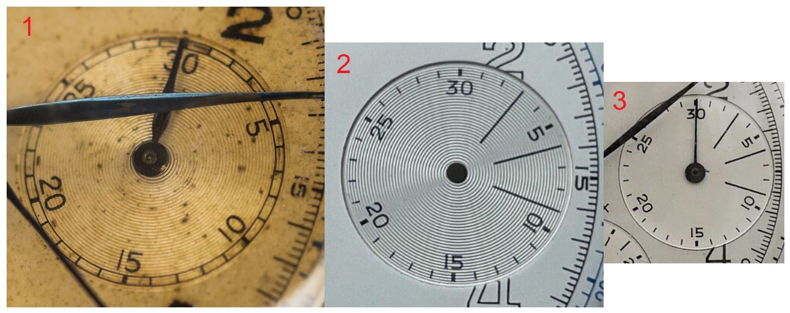

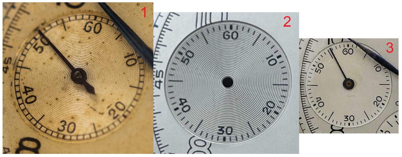

I have made a comparison (below) to illustrate what I meant when I wrote that the sub-dials of the "NOS" 30CH dial looked more reminiscent of UG dials. The comparison includes an early Longines 30CH dial (1) that has a similar overall design to the "NOS" dial (2). Similarities include the lack of a winged-hourglass emblem, a peripheral tachymeter scale in blue, and printed hour markers. The comparison also includes a UG Compax dial (3) that has a similar peripheral tachymeter scale and printed hour markers.
Source: https://www.bachmann-scher.de/en/so...cal-30ch-bj-1949-extract-unpolished-8336.html
Source: https://www.ebay.ch/itm/32565203655...XwcptkX4Vr/X+M6j/obVcEeQ==|tkp:Bk9SR97u7NCNYg
Source: https://sabiwatches.com/product/1940s-universal-geneve-oversized-compax-chronograph

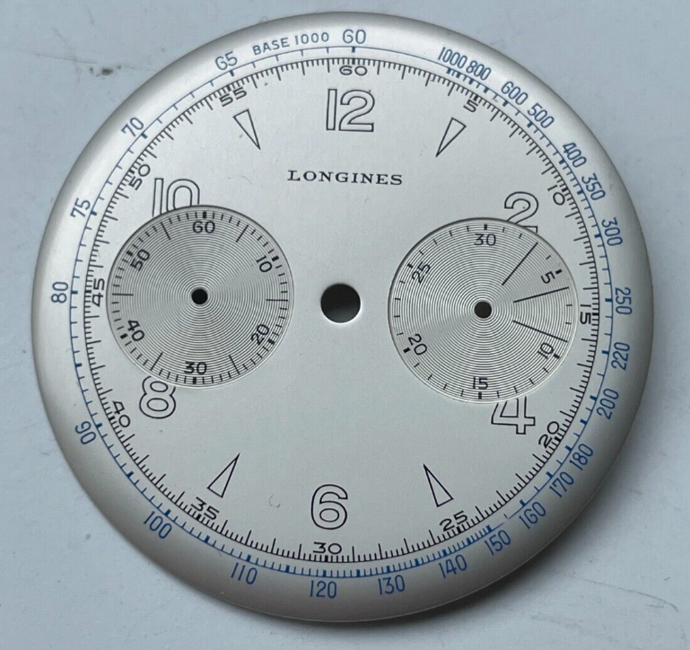

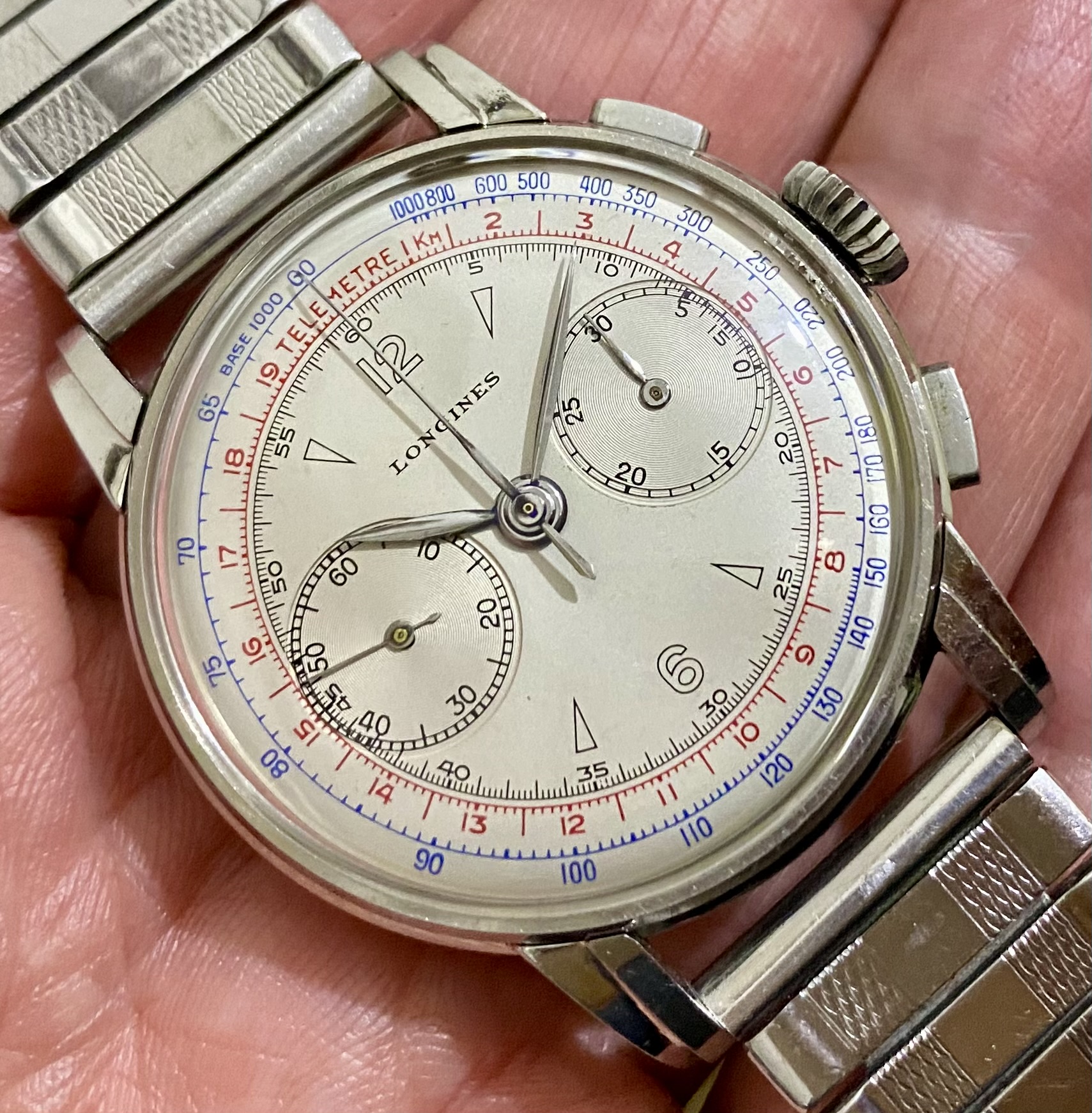

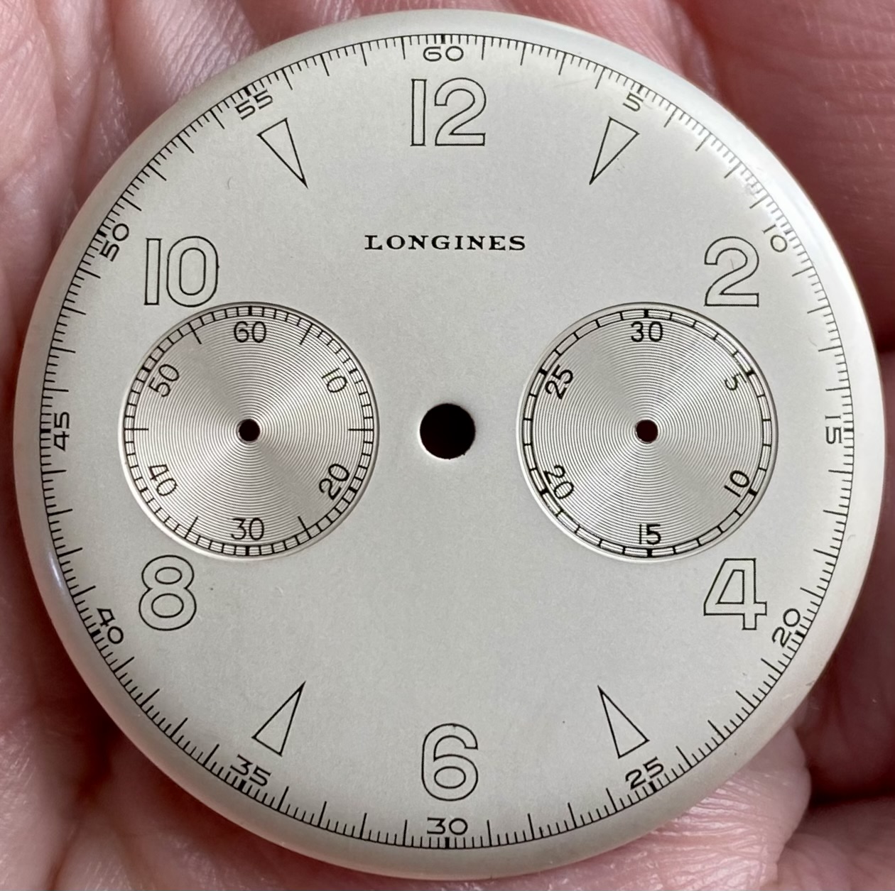

As an addendum to this thread, I am compelled to mention that I came across a cliché (image of reference) that I received from Longines years ago. It was for the 30CH reference 5965, and it shows a dial that is identical to the one I originally posted, even down to the 60 minute counter! I have yet to encounter a similar dial in the wild, let alone a 30CH with a 60 minute counter, but it seems that the dial is likely "original" in some sense.
26
15
Thanks for sharing that dial, I had not seen it.
Firstly, the design of the sub-dials is anomalous. I have never seen an original 30CH dial with similar sub-dials. The font of the numbers is not right. It looks more reminiscent of UG dials. The 'entirely open' design of the individual hash marks is also not right. By 'entirely open', I mean not connected to a printed circle. Early dials (no winged-hourglass emblem) with large sub-dials like these should have a closed track. Finally, the elongated markings at 3, 6, and 9 in the minute totalizer are not found on this type of 30CH dial.
Secondly, the design of the hour markers is anomalous. While there was arguably more variation in hour marker design than there was in sub-dial design (for a given size), these markers stand out as unusual. One would expect outlines of numbers to be paired with radium. Given that this dial is purportedly "NOS", it seems unlikely that any original radium would have been removed. Additionally, I do not recall ever seeing a 30CH dial with similar, printed triangular hour markings.
Thirdly, the seconds scale and tachymeter scale look very good. Maybe these were done using original equipment.
In short, this dial is anomalous in some significant ways. I am willing to entertain the idea that it was produced by Stern Freres as a spare dial, given the design and execution of the seconds and tahcymeter scales. However, I would struggle to view this dial as 'correct' in a 30CH as it is unlike any original 30CH dial that I have seen in a watch.

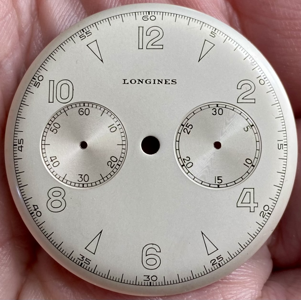

I agree about the sub-dials, and that it is a spare dial produced by Stern...👍 But, in my opinion, the design of the hour markers is not "so anomalous" for a Longines 30ch original dial...Very rare, but already seen before on the web...💪😜
2,829
4,948
Thank you for sharing that additional example with printed "hollow" triangular and Arabic markers.
