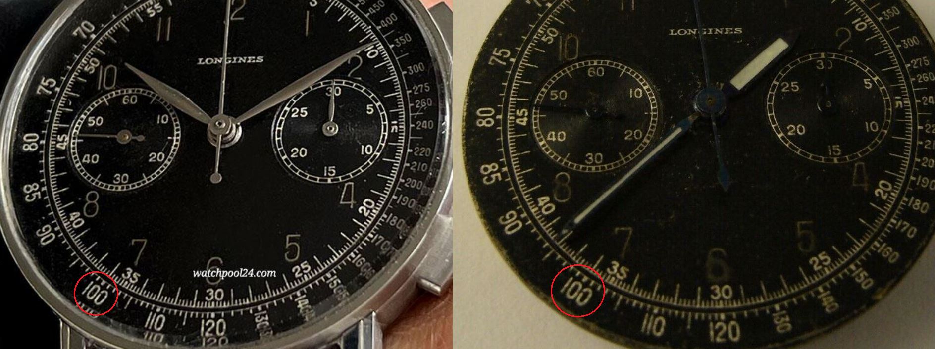

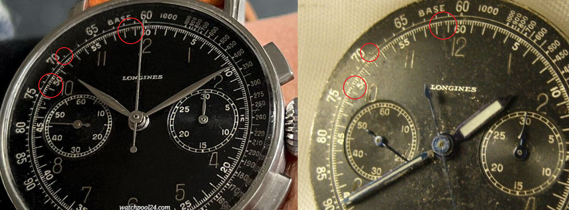

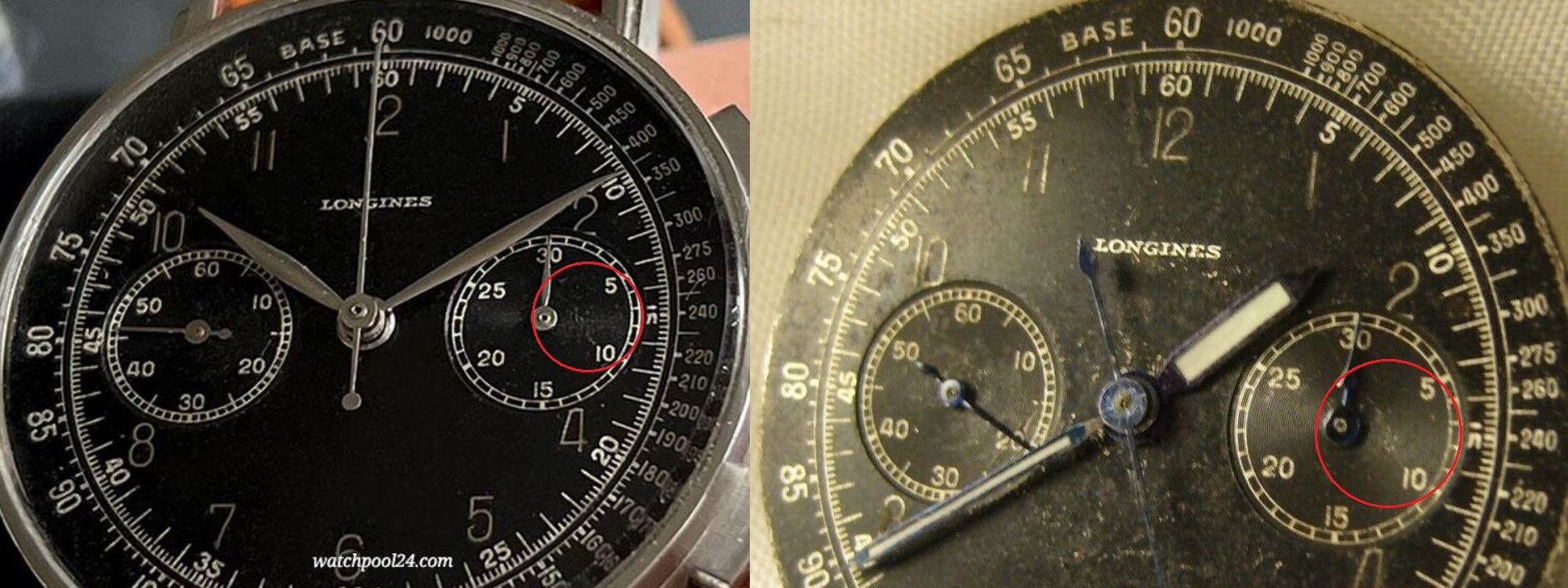

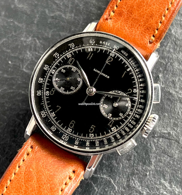

Someone recently asked me about the following 13ZN that is presently listed for sale. At first glance, I thought that the dial could be correct. I then checked one of my folders and noticed that a very similar dial and movement had sold on eBay in 2019. Given that black 13ZN dials are somewhat uncommon, I looked to see if the dials had any matching marks or deterioration. Further below, you will find two comparisons. The first highlights an imperfection on the right zero of "100" in the tachymeter scale. The second highlights deterioration on the minute sub-dial. To me, it seems likely that these are the same dial, but it would be nice to have better photos.
Source: https://www.watchpool24.com/en/30735233/longines-chronograph-4572-cal-13zn-galvanic-dial
6'039'xxx versus 5'770'063 (as per eBay description)

I think you are right
Agree. There are also tiny but matching paint losses on the zero on the « 110 » of the tachy scale.
An attractive looking watch in any event, but of course the price is the question.
Thanks for your input. I have not inquired about the price.

Agree, there is also a nearly vertical scratch on the running seconds sub-dial moving upwards from the "0" in "20".
Indeed!
Below are a few more matching blemishes, such as the 58.6 line of the seconds scale.
