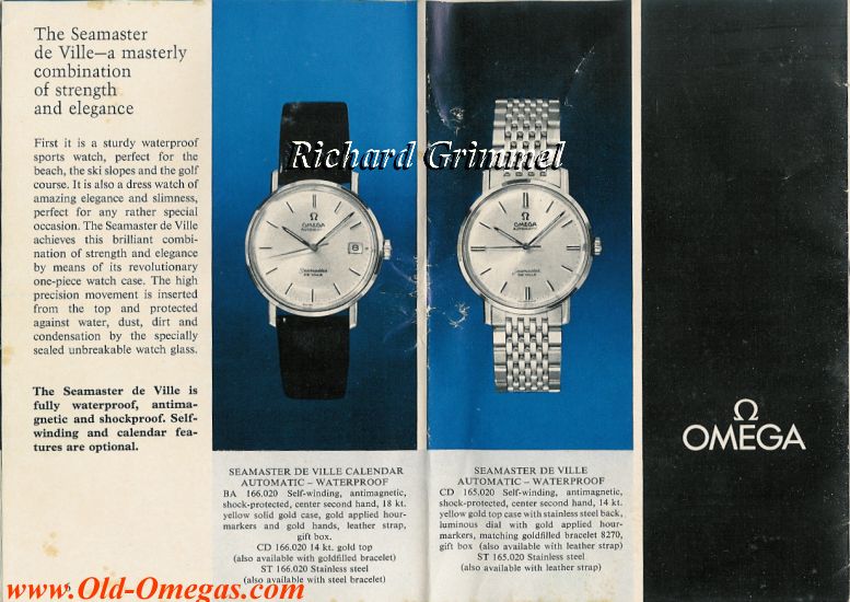

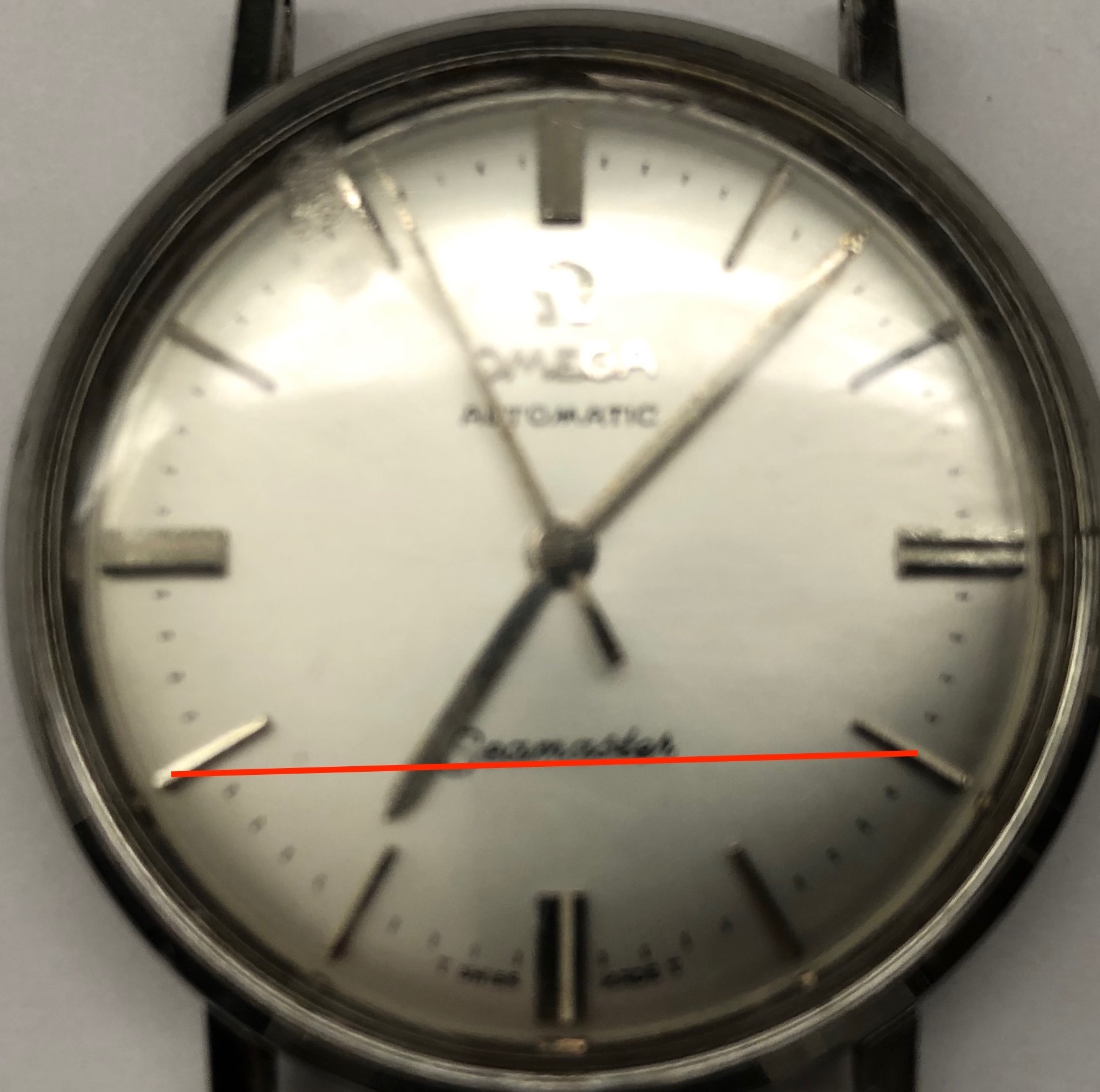

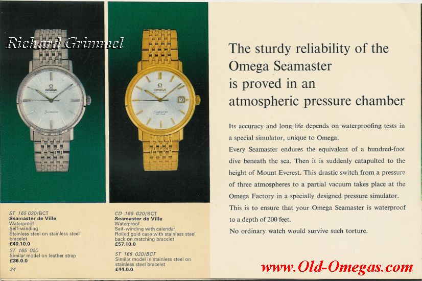

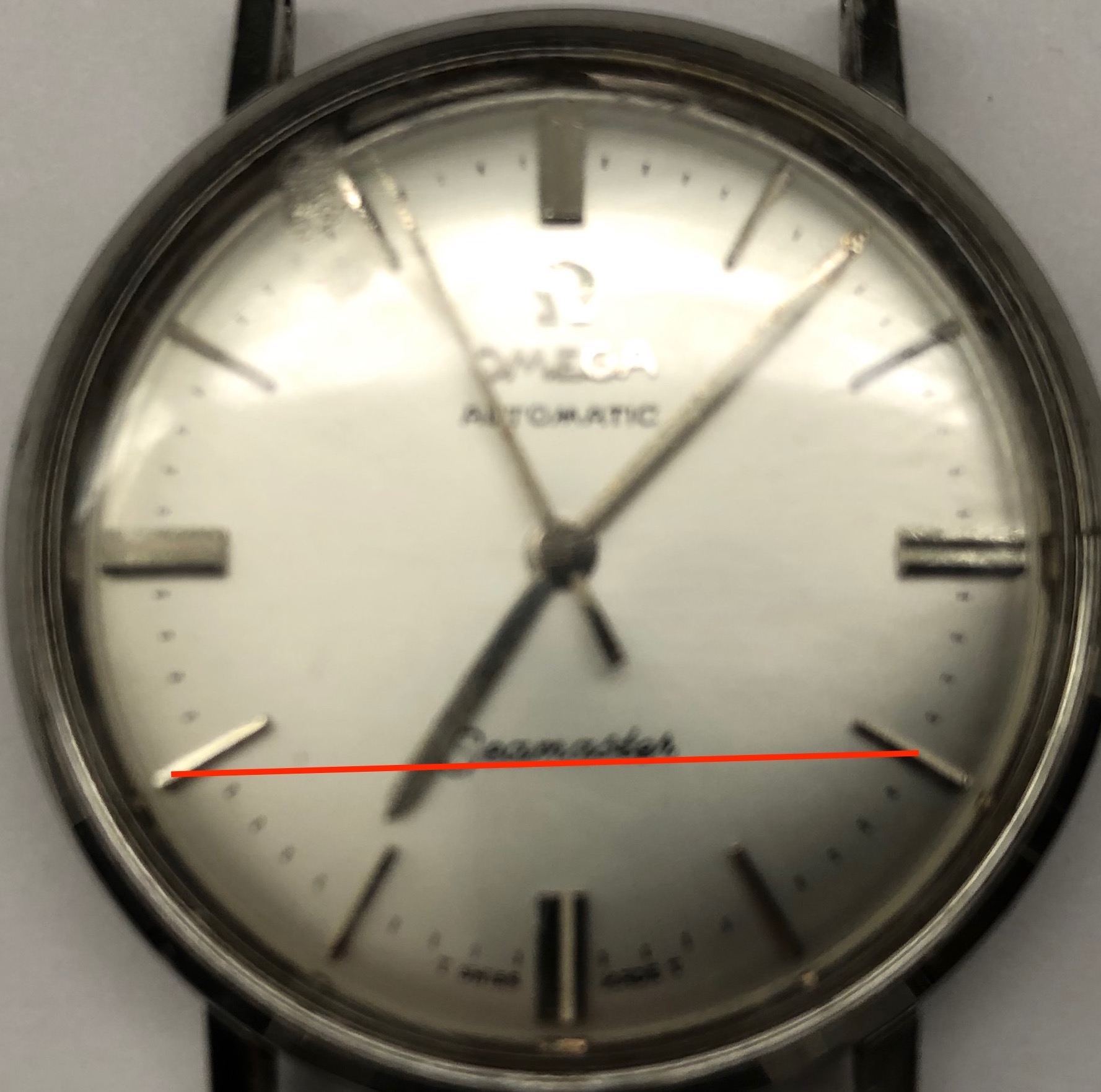

Thanks but mine has no 'de Ville' underneath Seamaster and double batons in the 12, 3, 6 and 9 positions.
This 1964-65 Omega catalog shows the one that I have.
http://www.old-omegas.com/pics/catuk64/p24.jpg
http://www.old-omegas.com/pics/cat64en/p6.jpg
The minute markers should be at the outer edge of the dial, as in the OVD, those catalogs, and all other examples. It's also uncommon to see T SWISS MADE T when the dial has no lume. An in-focus photo will allow the experts to better evaluate the rest of the printing (especially the typeface), but I also suspect that the dial has been re-done. For example, Seamaster seems crooked to me, but I realize the photo is poor. AUTOMATIC also appears to be off-center, extending to the left of OMEGA but not to the right.

Just so you have some info- the dial was refinished, probably when the hands were replaced- this was clearly done by a watchmaker in New Jersey.

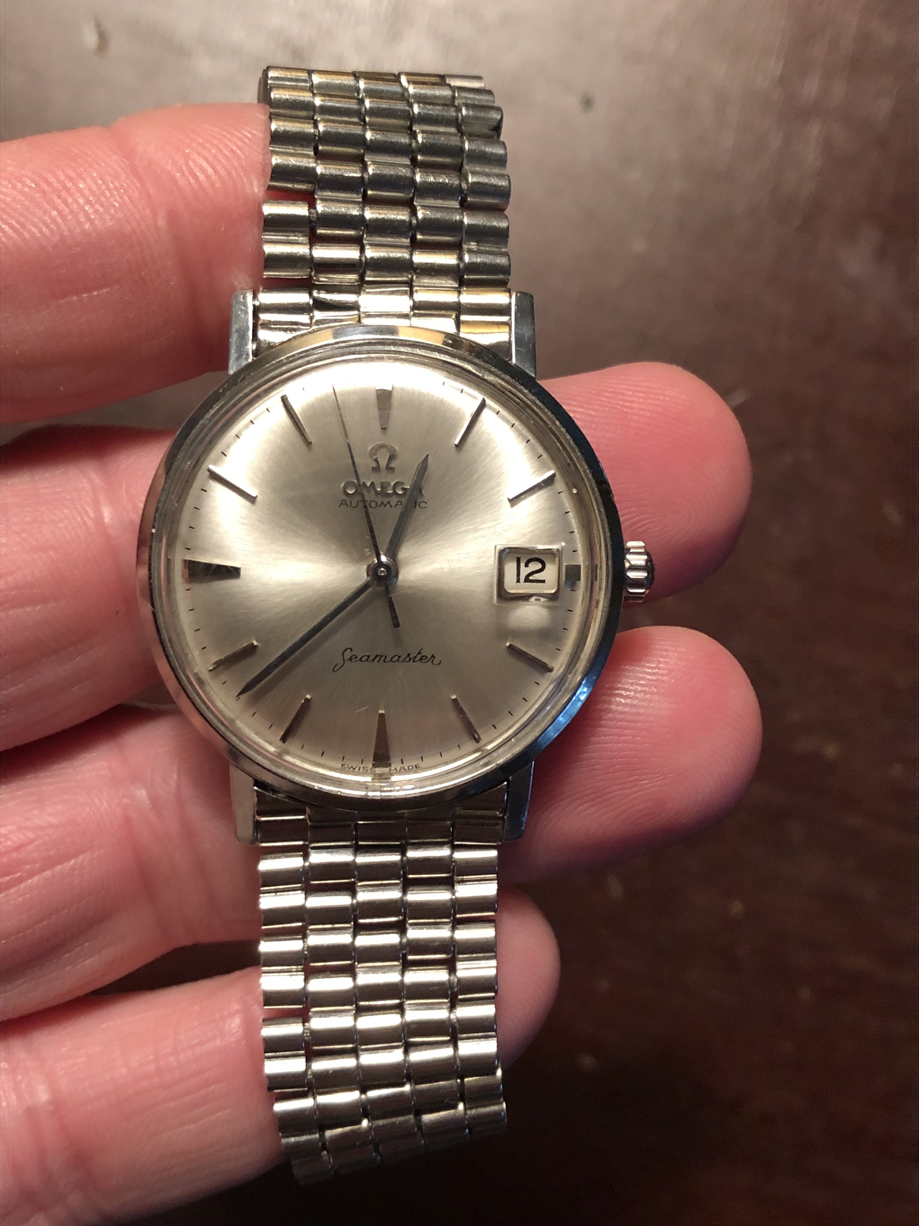

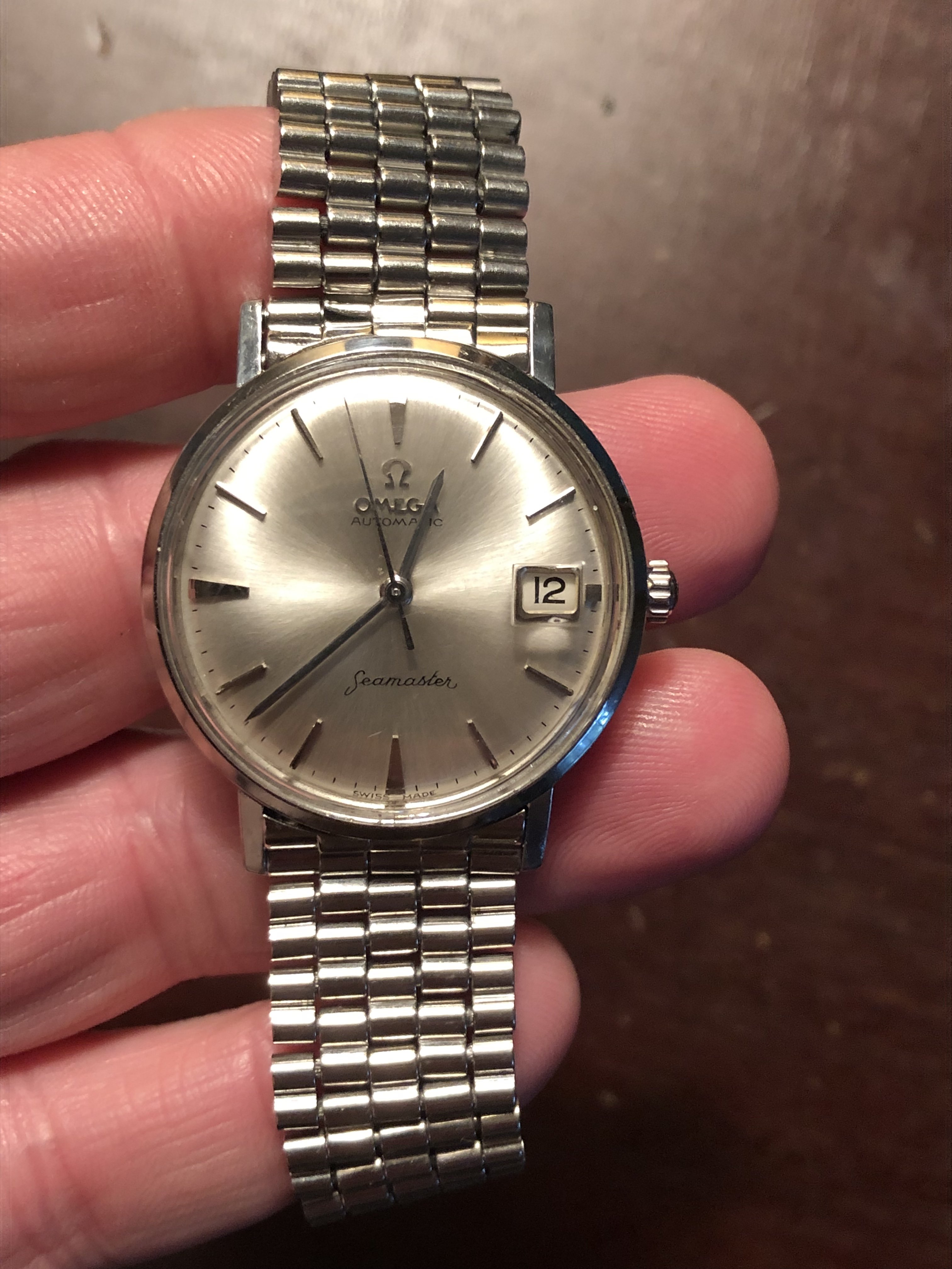

As pointed out, the minute track should be on the outside of the hour indices, not the inside (some earlier models from the 50’s had them on the inside like the Constellations. The Seamaster logo looks way too bold- the lettering is typically much finera- then there is the aforementioned “T” but no lume on the dial. The non- Deville marked front loader was typically only 1962- the first year of the front loading case for Omega (although with Omega there can be exceptions), from ‘63 forward the front-loaders were typically marked as DeVille. Here is a crappy iPhone pic of my unmarked DeVille- Deville on the correct factory bracelet- made only for this model year-1962
