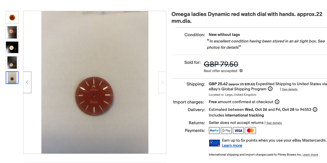

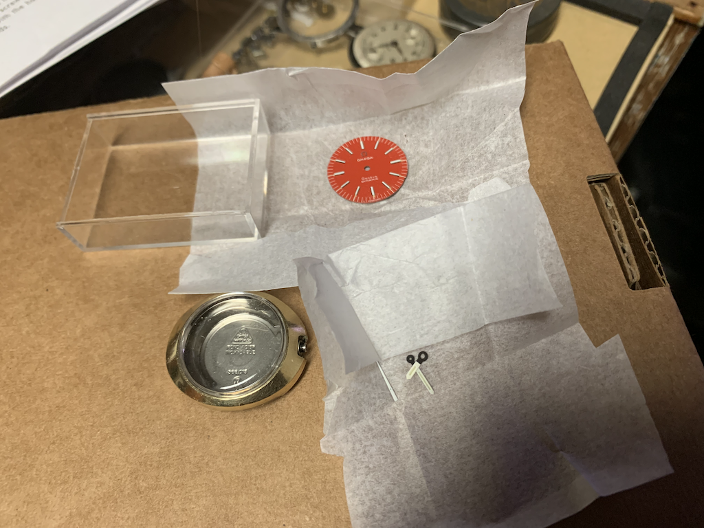

I just received the dial and hand set for my spare 566.015 case.
The seller accepted a BIN of 68UKP plus shipping charges as noted. Took forever to get here due to the UK postal strikes. Just arrived late yesterday. I ordered it when the pound hit rock bottom.

Sweep hands for this model are going to be hard to find. Why I took a pass on your watch in favor of the one from Moldava. oFrie does list the regular hands, but no sweep. I have a seamaster 566.001 with an incorrect sweep. oFrei did have a sweep for nearly 40USD. When I went to double check the listing, it was no longer online.
I would encourage you to see if you can make a sweep hand. That is the sort of thing I would try to do. I did start to make clock hand with my CNC years ago, and just found it. There is a book called 21st century watchmaking, by the same guy who wrote the Esembl-O-Graph books. I keep meaning to write a review of it. I bought a spare lathe and all the grinding attachments. Diamond hone etc... Like many of my projects this ballooned into yet another big project. Grinding and polishing takes a lot of time and patience.
A hand could probably be ground out of an old piece of broken mainspring. Matching the tolerances of the stamped part is going to be really tricky.

Well, all I can say is well done you and I'm disappointed. I also offered a bid on the red dial and hands as I thought they would be a good investment and way to go for the money and make the watch appearance like new. I offered a little more than you, but did try and include postage which I thought was excessive. That's the Yorkshireman in me. I will follow your progress and look forward to seeing it finished.
As for mine, I have just about GB £100 in mine which I'm happy with and I am enjoying the challenge. I will continue to see if I can add the sweep hand but I am also now pondering making the rear mount for a bracelet fixing although my wife is now looking at the different coloured straps she can get, so that's a bonus.
I did not realize BIN offers were competitive. I made the offer on whim, as I was looking for the ladies 566.001 hand on oFrei. That one uses the 681 movement. I simply offered what it would have cost from the materials house.

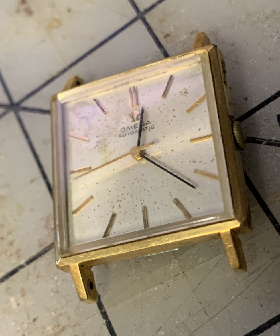

So with all my current passion for this watch's big brother, I decided to look at these again. Also assisted by mad impulse buying of estate watchmaker lots.
I got the courage to open the Moldova watch and it was NOT a 671. Turns out it was a 630. More research. The base caliber here is 620. 630 is the sweep variation, 670 the automatic, 671 auto sweep through the 684 I also have which is lots of jewels date and everything.

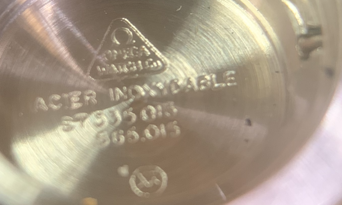

Case wise the 535.015, 565.015 and 566.015 are identical. Some even have the multiple number stamped inside.

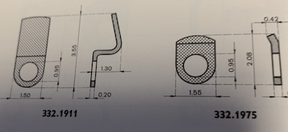

I have been missing the case clamps. In the 67x/68x lot listings were some 620.1911 clamps. 620.1974 might be a bit closer to the Modova clamps, but t he differences are subtle. Probably to clear the cutouts.
By chance I found my GF 620-3/1 parts list binder has 'Brides des fixation 1961' in the first part. This though only goes as far as 1961. I wonder if the base digit '6' is a decadel reference. The 3's seem to be from the 1930s, the 4s from the 1940s, 5 from the 1950s ans so forth, until like piano roll numbering which stop in the 1930s the numbers just keep counting semi randomly. Back in the day many companies had 30 year plans, so the corporate decade may not be the same as the civil one.
Ordering case clamps is a crap shoot anyway. The charts say 332.1911 should fit case 2576/2577 for a 351 movement. What I actually get is closer to 470.1911 or 332.1975. Packages are opened so the markings are invalid. And I have watches what do use the stubby ones.
