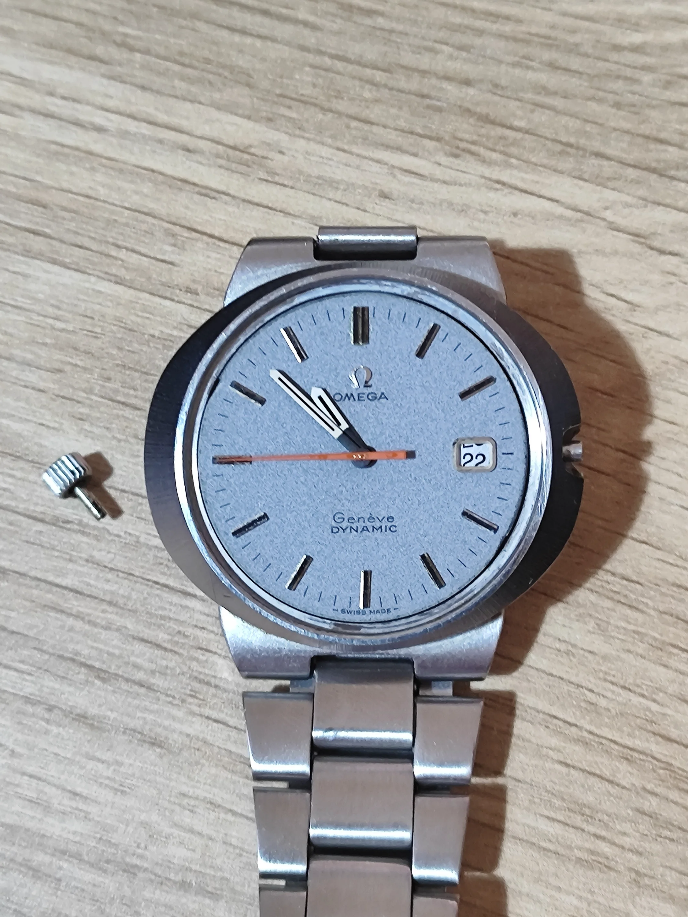

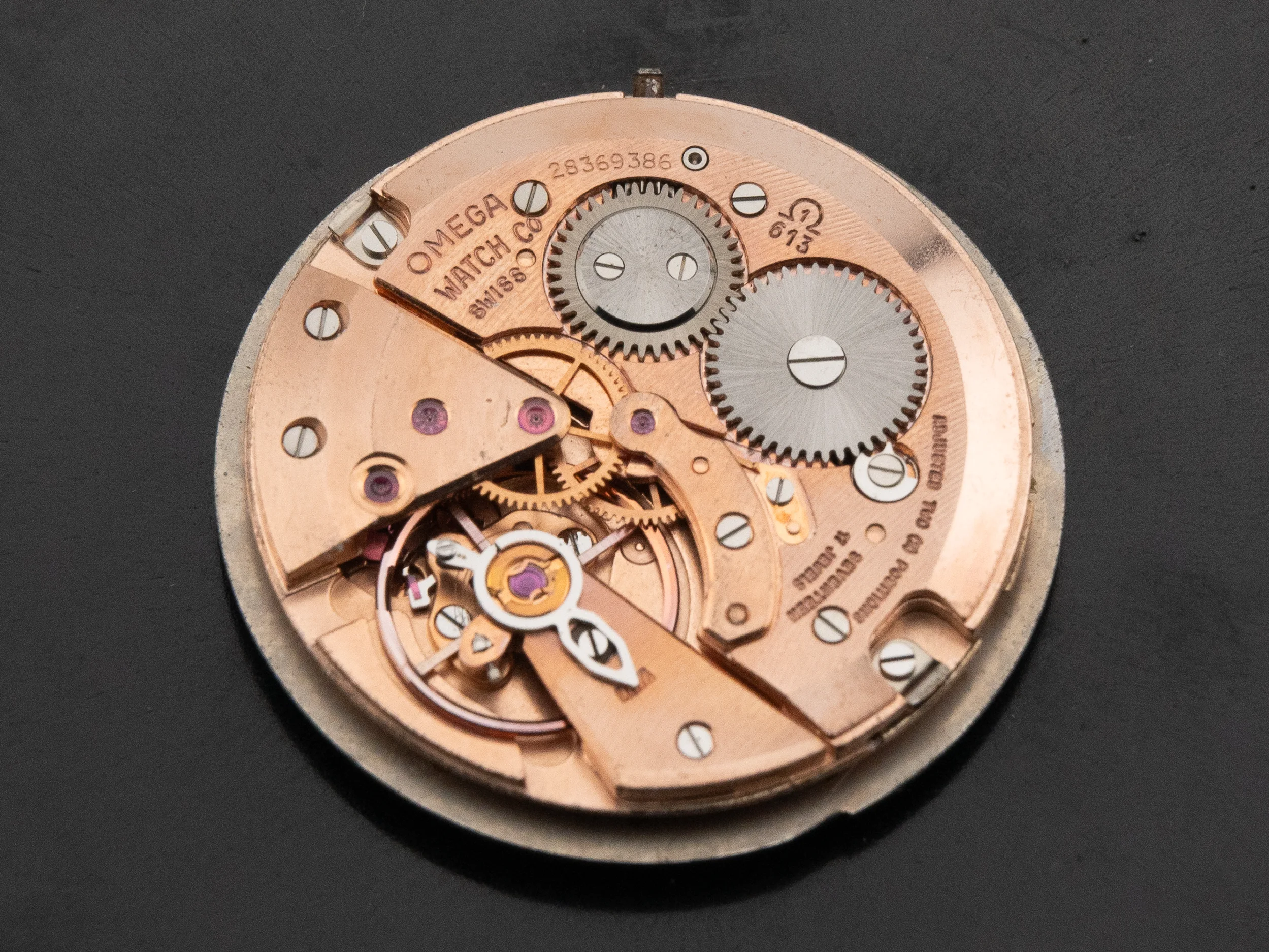

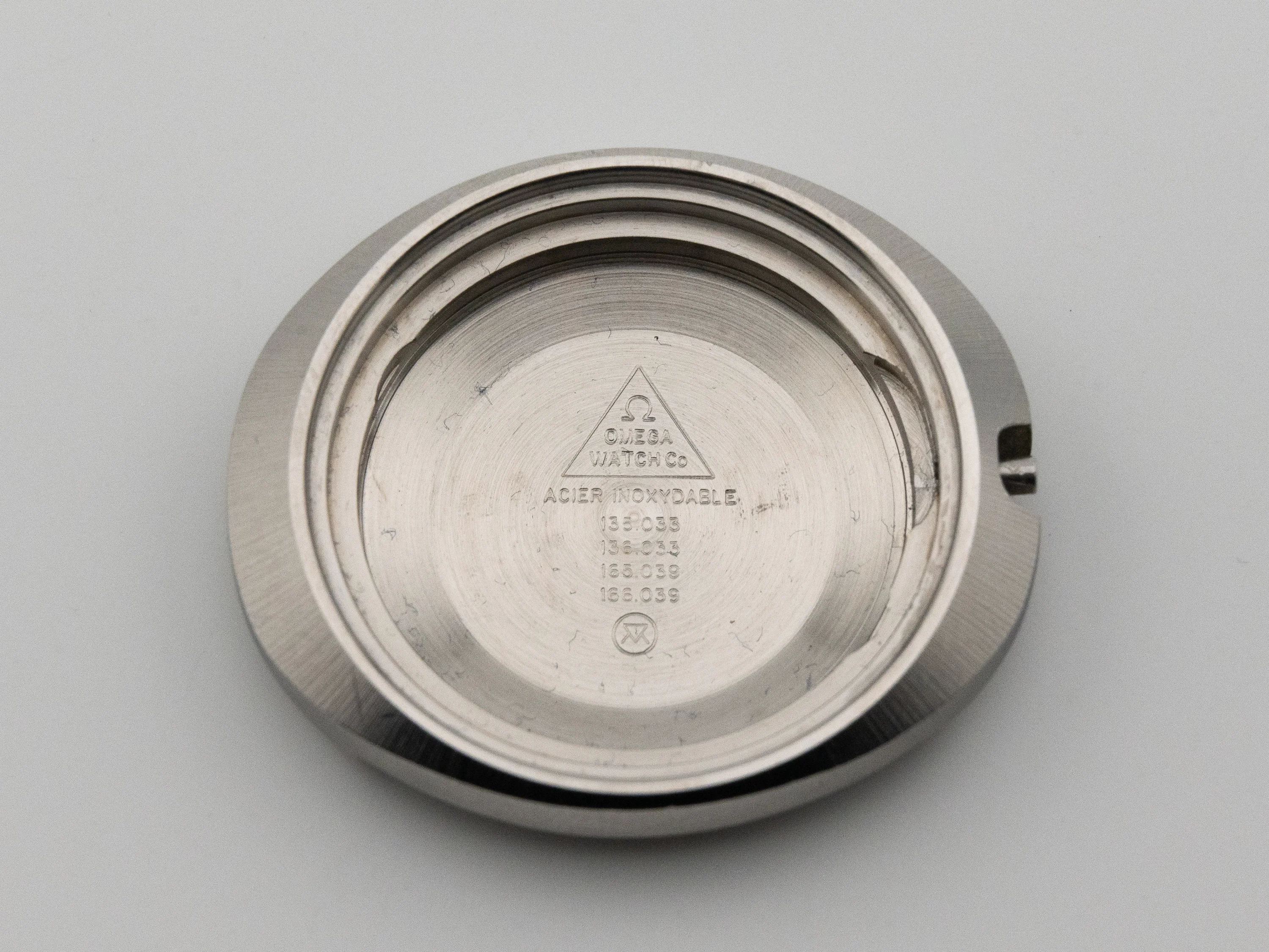

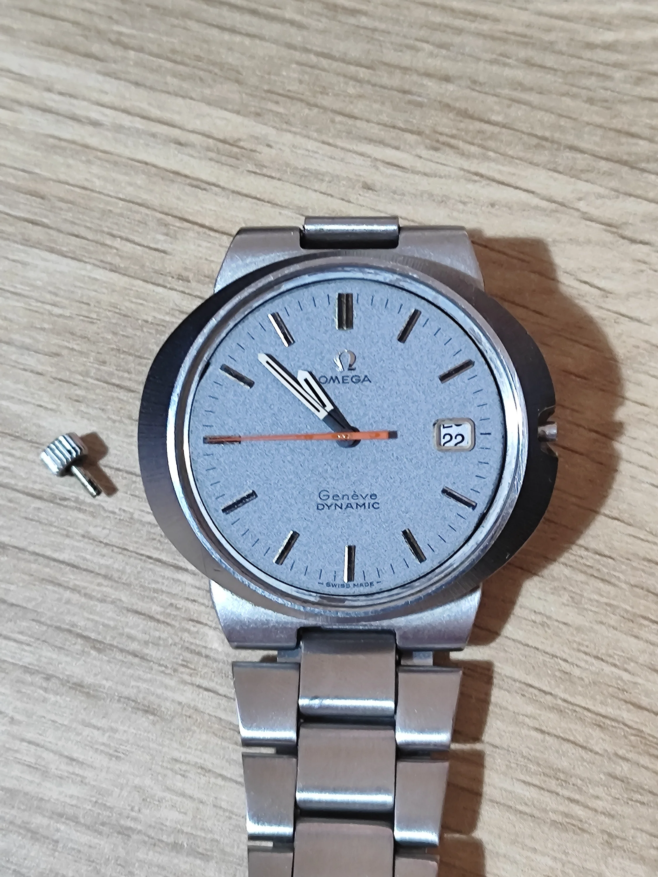

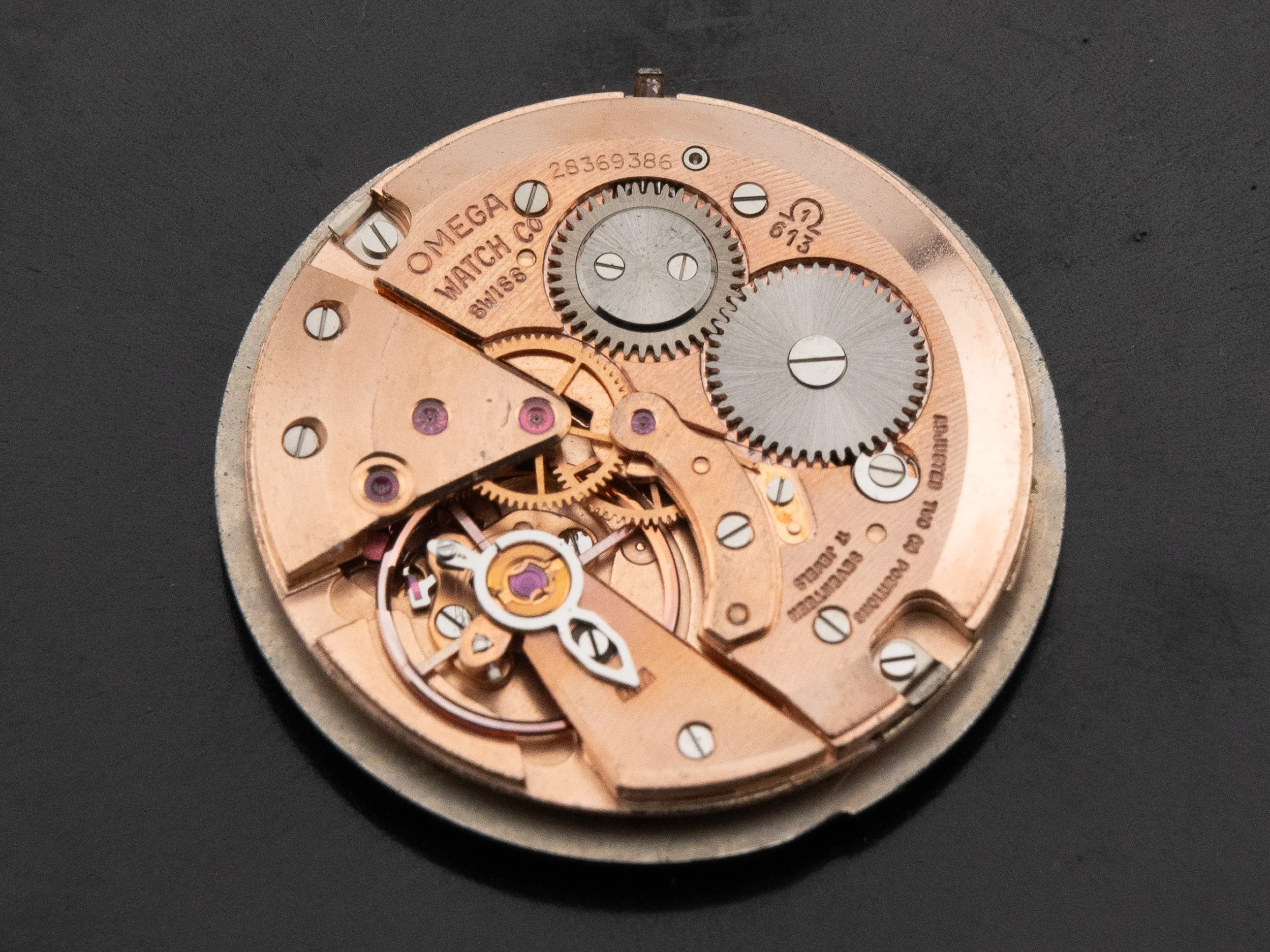

Hi all. I recently got an Omega Dynamic, I believe it to be reference 166.039 with a manual wind cal. 613. I'm trying to open it up, so I can check and photograph the movement, but no luck.
I've opened a few top loader Dynamics, Cosmic, and De Ville, so I wasn't expecting any holdbacks. Pushed the crown to the 2nd position (date advance), removed it, and pushed the "male" split stem into the neutral position so it would clear the tube. Tried rotating the dial counter clockwise but it doesn't budge. Must have tried for almost an hour.
It does feel like the stem is blocking it as maybe there's 1mm of movement both ways. The stem is pushed however and probing with a thin tool, it does seem like it's clearing the case tube. Not sure sure what else may be blocking it. I'd really appreciate some advice, maybe something I'm missing, before throwing the towel.

You do have to turn the dial. There are two notches at 10 O'clock and 4 O'clock. I use pegwood. It is super easy to scratch or damage the dial. The case clamps fit into slots in the case. If the stem is not pushed all the way in it can bind. There is also a plastic half moon shaped seal around the stem. Sometimes this turns to goo.
Any rust or corrosion will make it difficult to turn the watch.

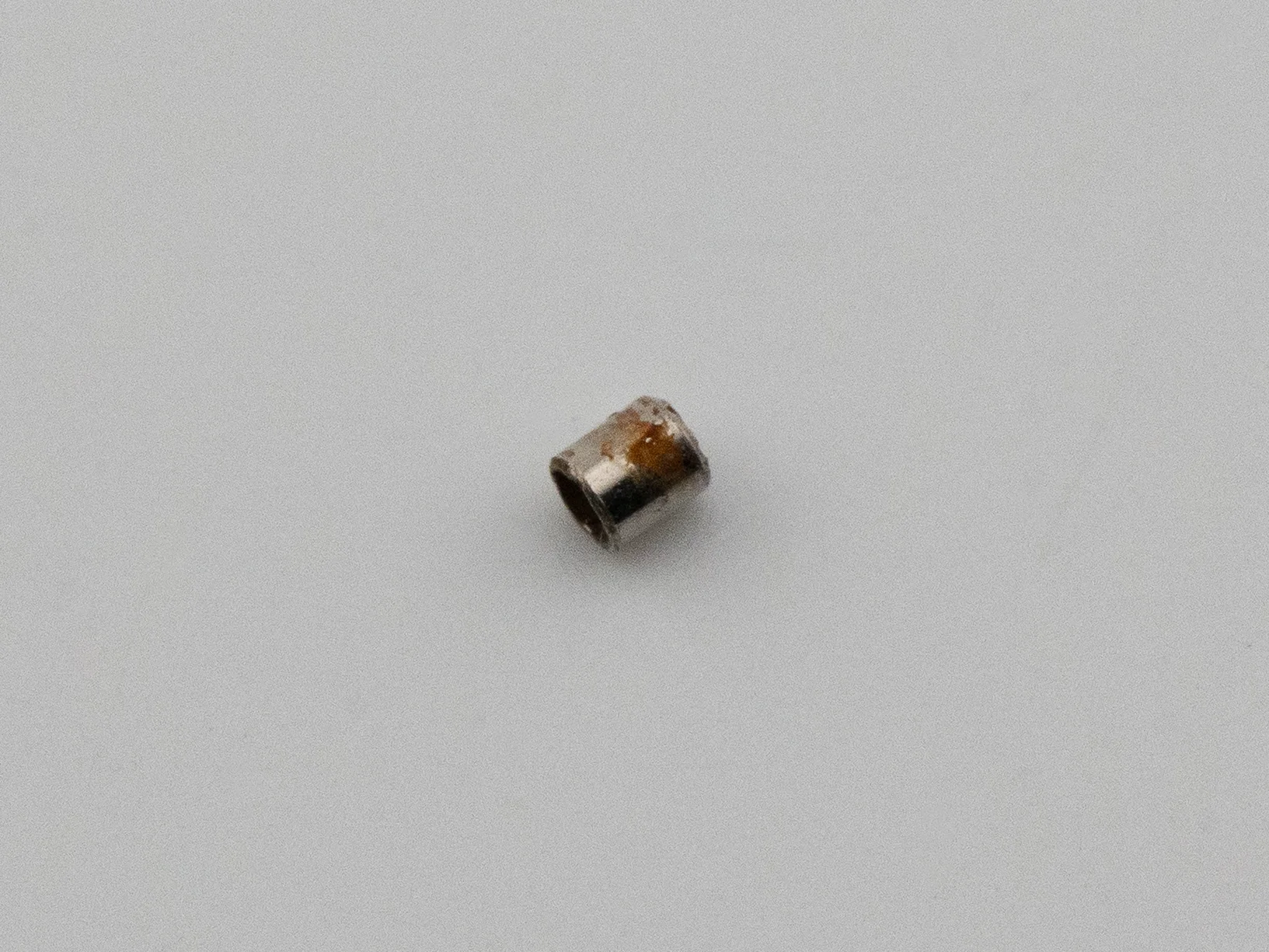

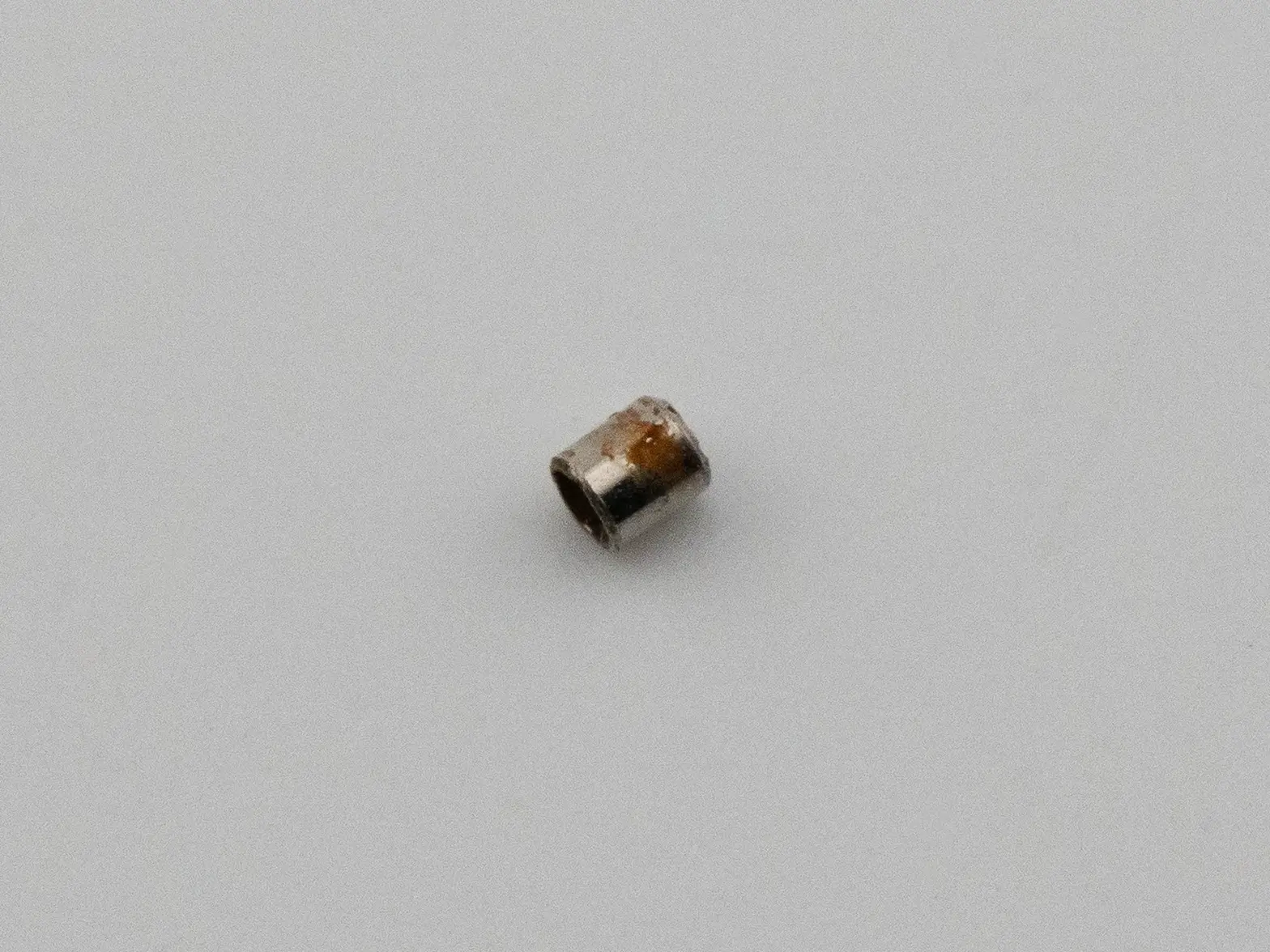

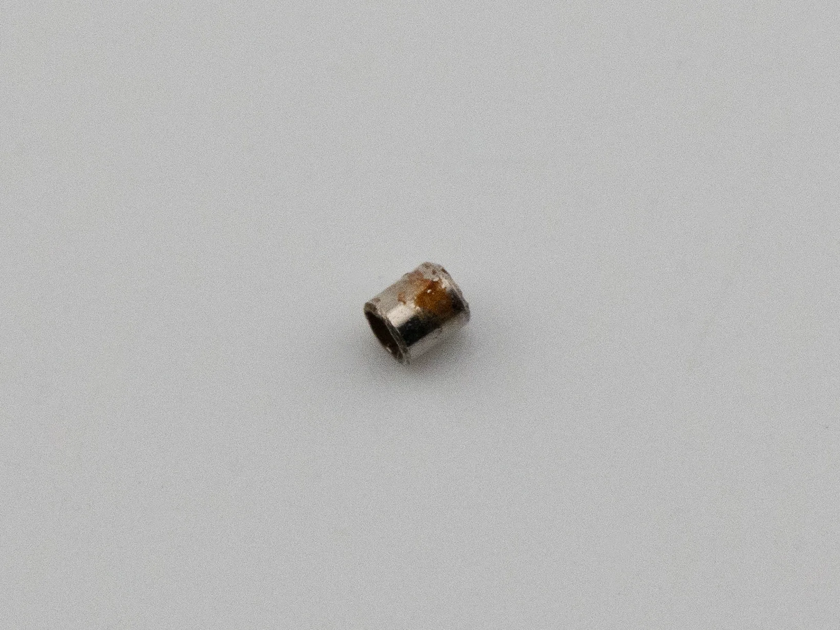

Gave it another shot and managed to finally open it. There was a tube between the movement and the case, where the stem went through. I imagine it was a snug fit to the pendant tube, blocking the movement from rotating. With some force and persistence, the tube detached and the movement turned freely.
Not sure of the purpose and if it's supposed to be there or something a watchmaker came up for whatever reason. Anyway, the issue is solved. Thanks to everyone for the input.
It is not supposed to be there. My guess is that this is something a watchmaker came up with in place of the proper plastic wedge. The wedge helps keep the two parts of the stem from coming apart by restricting their sideways movement.
