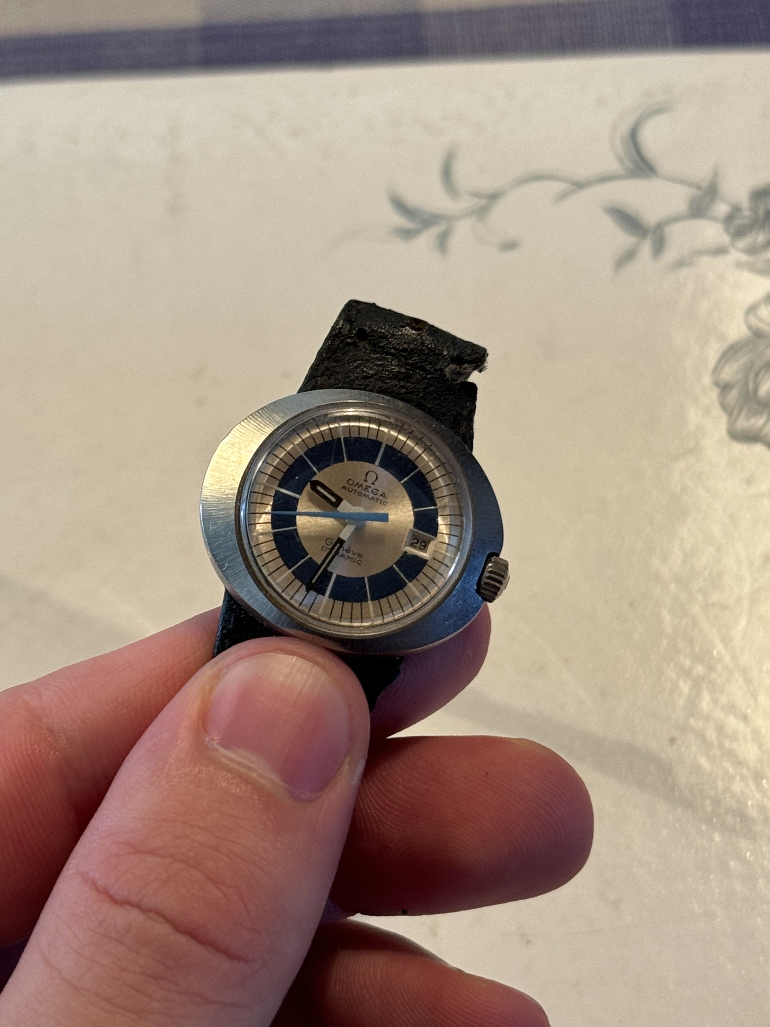

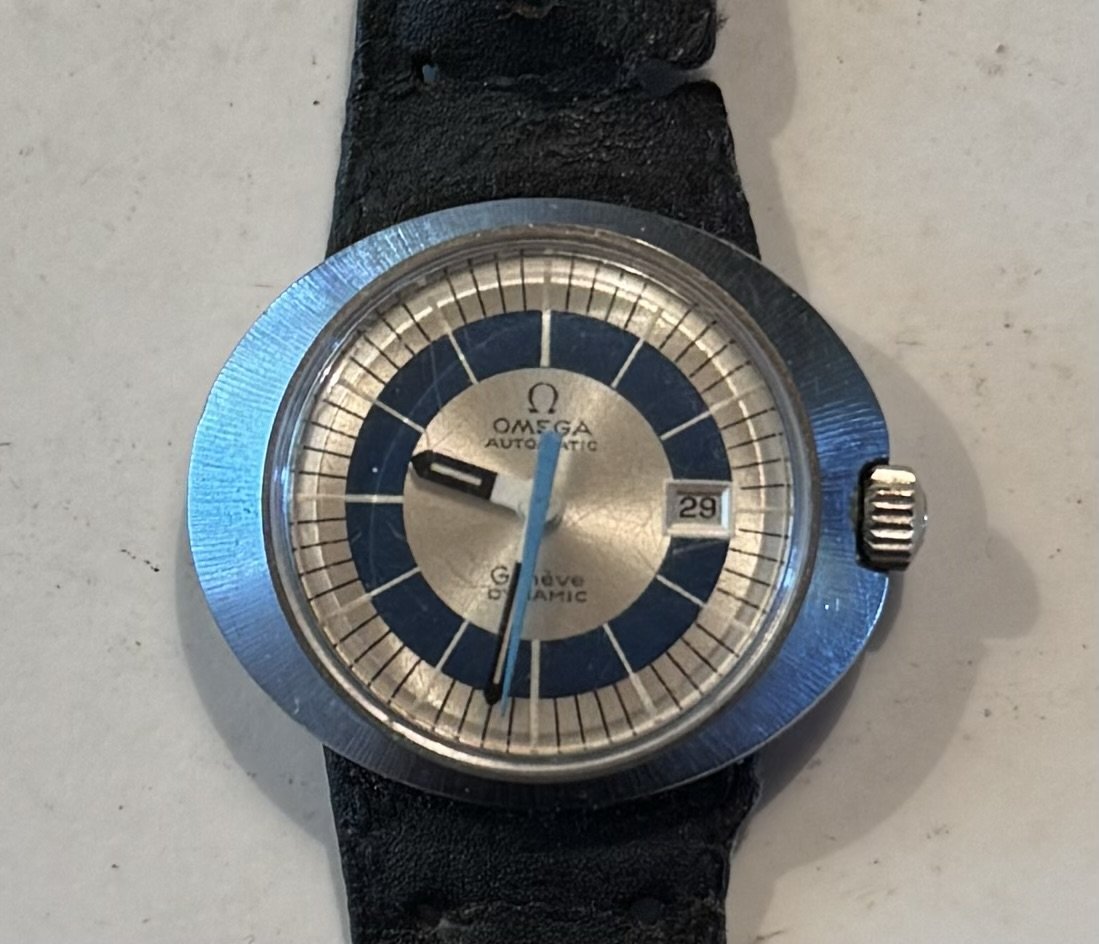

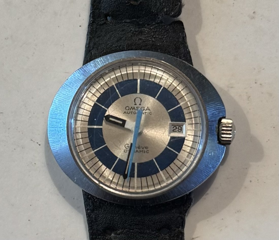

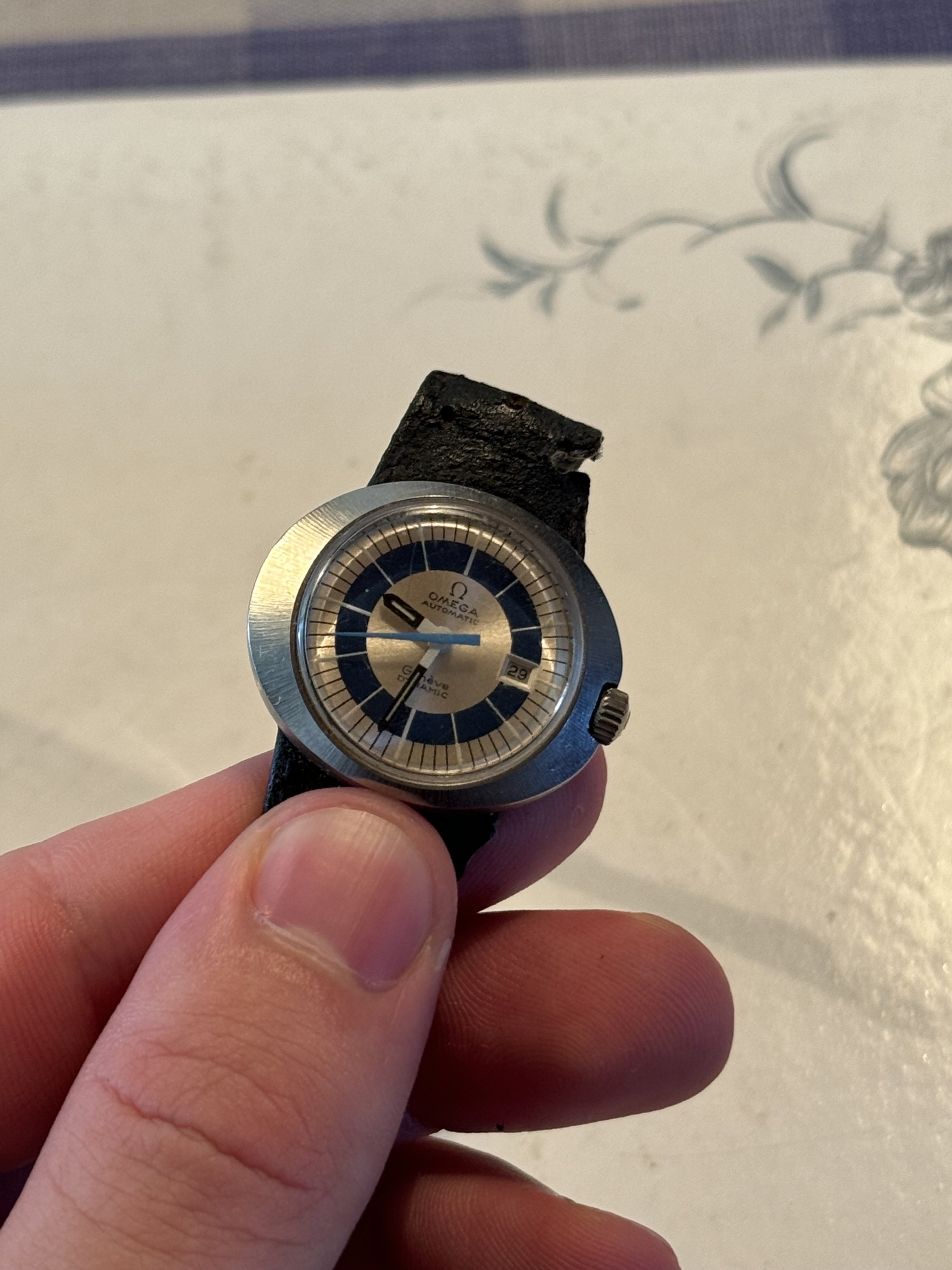

I’m new to this community. I’ve been tasked with finding a new strap for my grandmothers Omega Dynamic i ladies from ca 1970.
This is the watch, ladies size and approximately 30mm big.

Often the case has multiple numbers stamped in it.
535.15
536.15
565.15
566.15
My 535.15 cases came with a no date non automatic 630 movement which is somewhat rare.
566.15 is most common which is a date movement automatic. 671 or 681 depending on the jewell grade.
Automatic only no date would be a 670 or 680.
Date variations take a taller crystal than the non date. There is a special tool for removing the crystal.

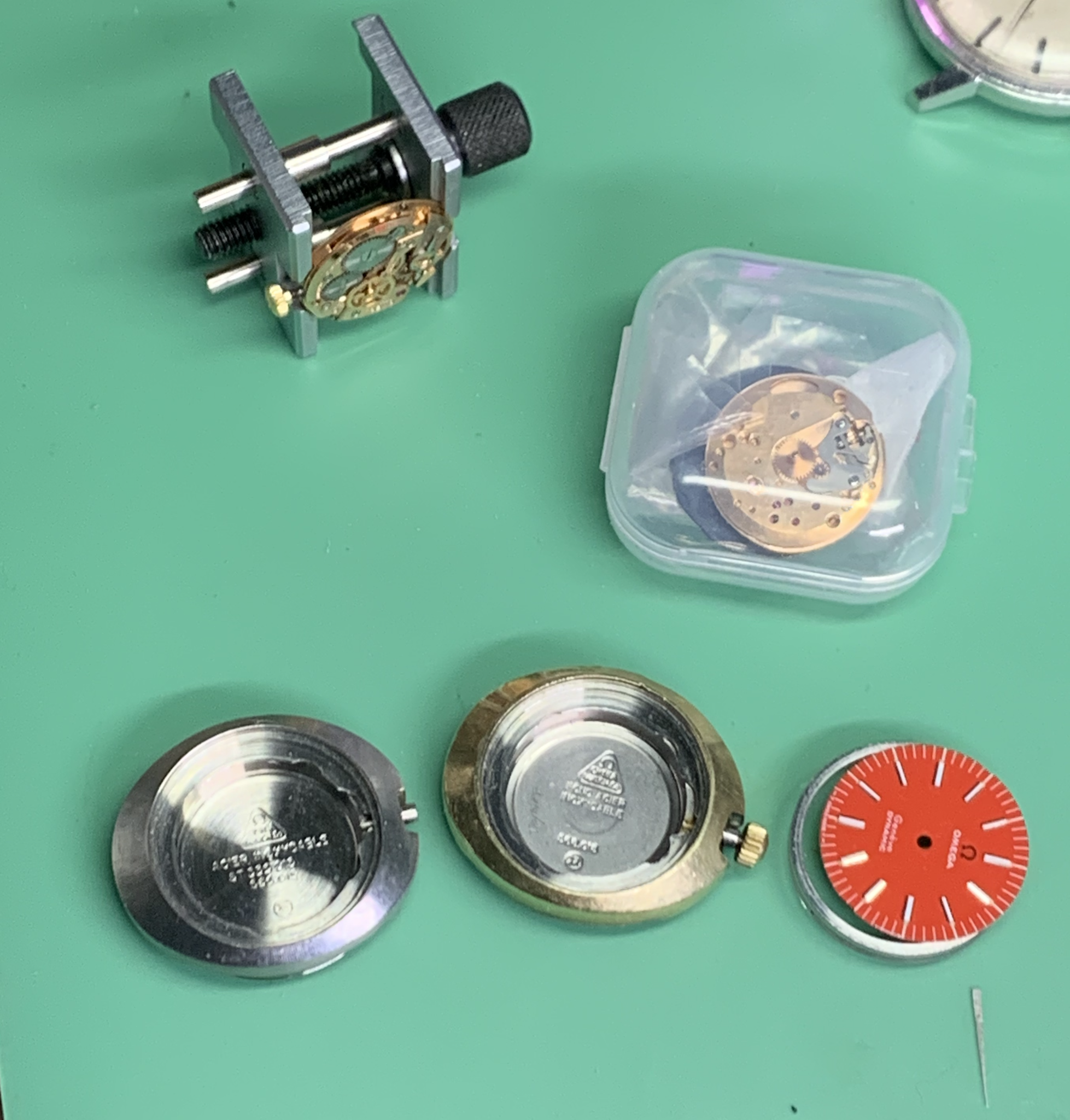

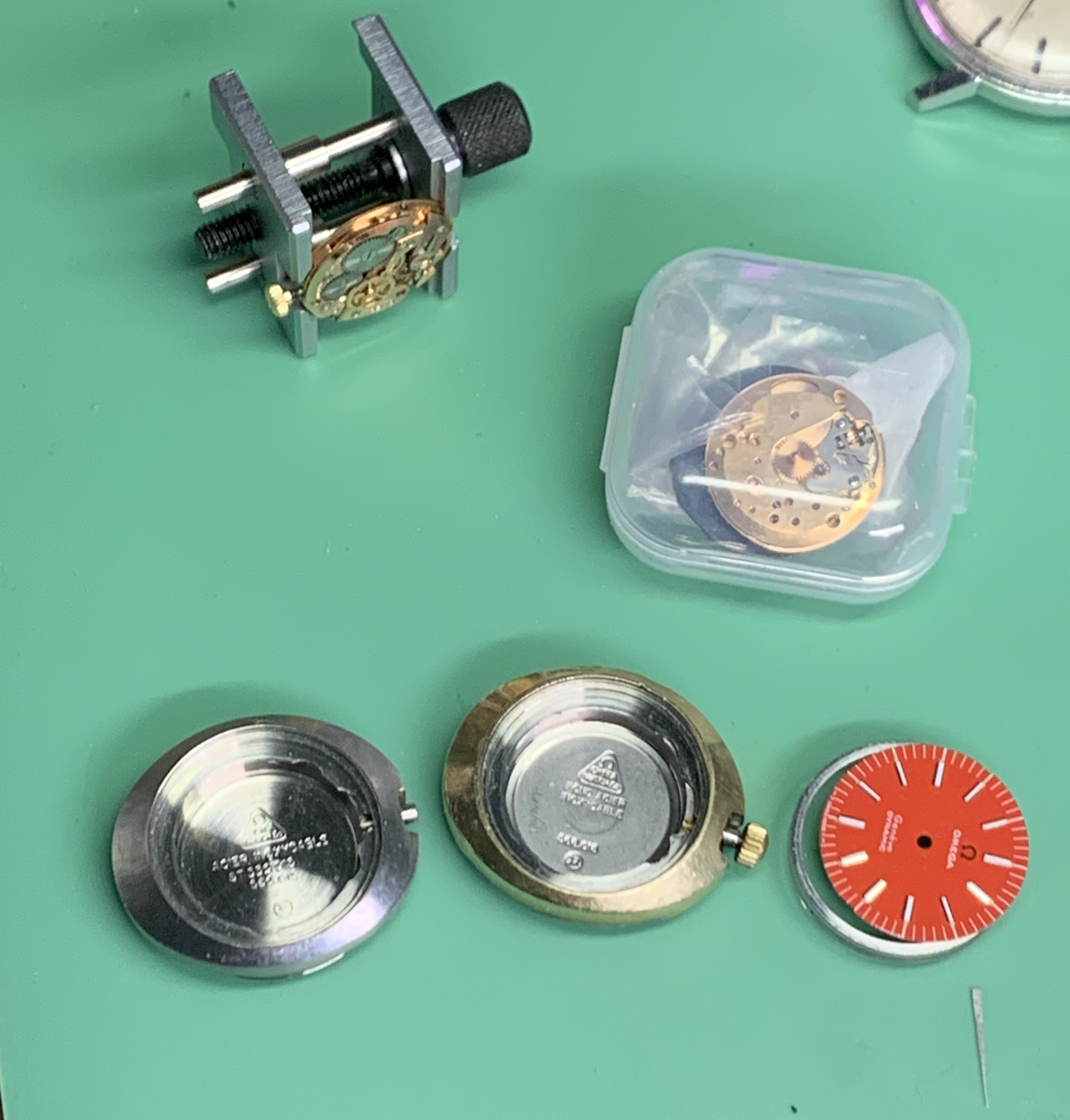

I have two 535.15/630 apart on my bench at the moment.
