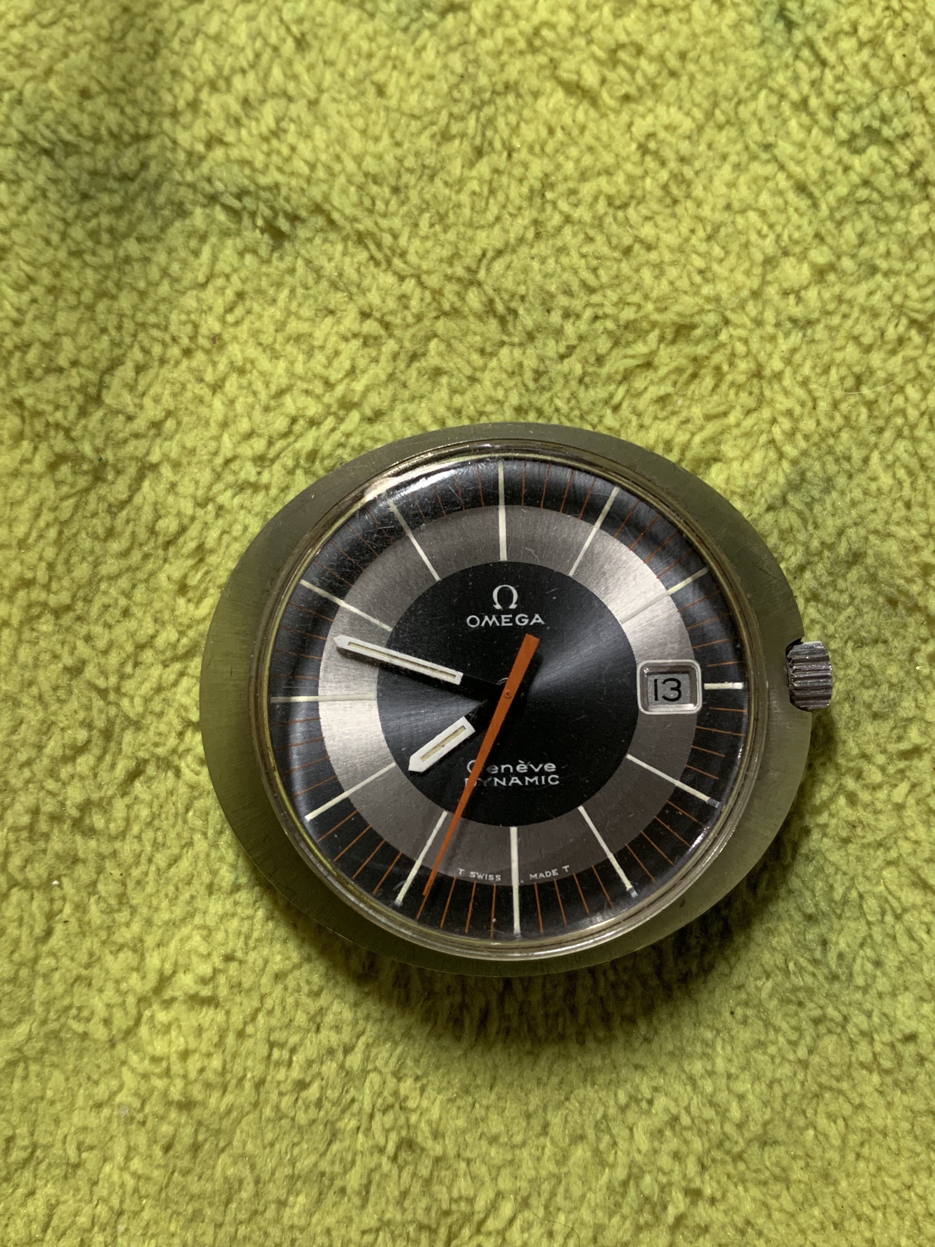

I recently got this as a non runner. Easy to explain why. The inner stem is missing. My guess someone just pulled it right out years ago. Movement looks untouched. And it does run fine when wound. Unfortunately the crystal (original) is broken and missing a piece. The blue wedge is still in place which is encouraging. So the question is
1. can anyone assist with the ref for the split stem please, movement side male for a Cal613. Do these share the same stem with other 600 series movements.
2. Are original crystals with chrome tension ring available or are there any aftermarket alternatives?
Many thanks again to all members of this fine forum.

Turns out, the stem question is not that easy to answer via the internet. My "go to" check is always Julesborel.com.
This usually helps with movement part interchangeability. Not this time. 🙁
Hope that someone else can come and save the day.

Apparently the manual wind dynamics are a safer bet to service due to discontinued spacers that often are a bugger to deal with on the automatics. A cal 613 was a good choice.
63
23
Can you look up the casenumber (on the inside of the case), I can find the original part numbers for you. Makes it easier to find the correct parts.
The glass is still available with Omega I think.
I do not think there is a “replica glass available. It needs to have the special edge so you lift it out of the case using the dedicated Omega glasslifters.
