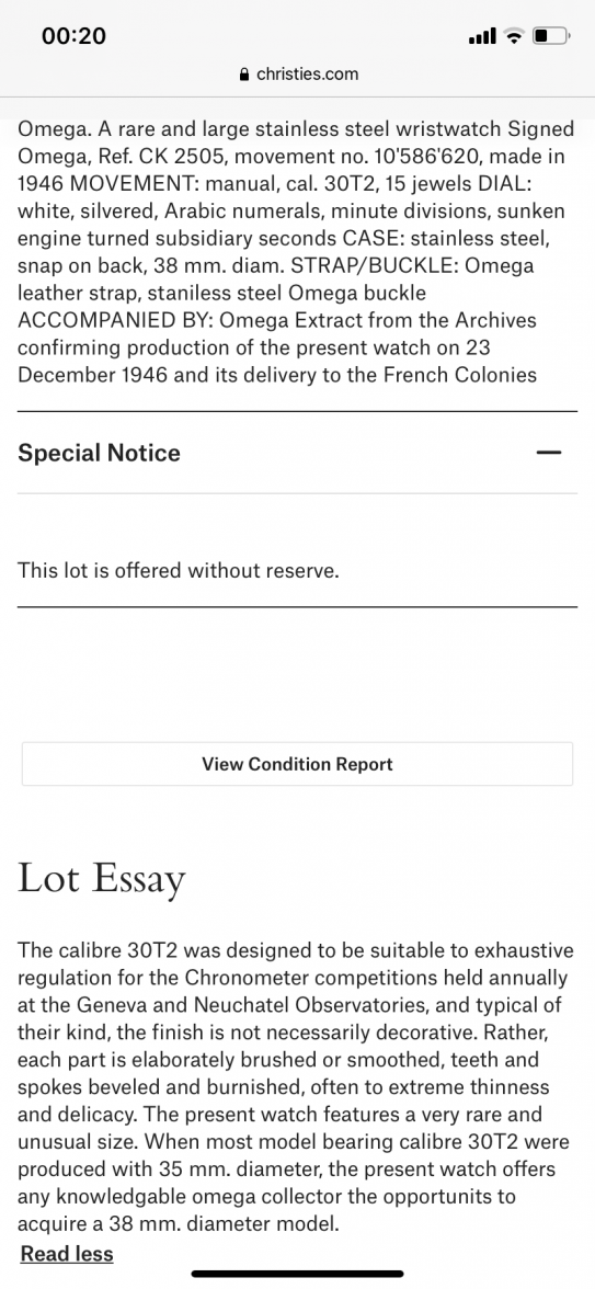

I came across the following sale whilst researching this. Can I draw your attention to the Lot Essay write up below where it states these large cases are rare with 30T2’s fitted and as previously mentioned they are usually fitted with the 265 cal. Please see attached.

As far as rarity is concerned, I would not base my analysis on sellers add. As per your watch in particular, it seems rather uncommon but I prefer to wait pics of the movement and the back before making any further comments.

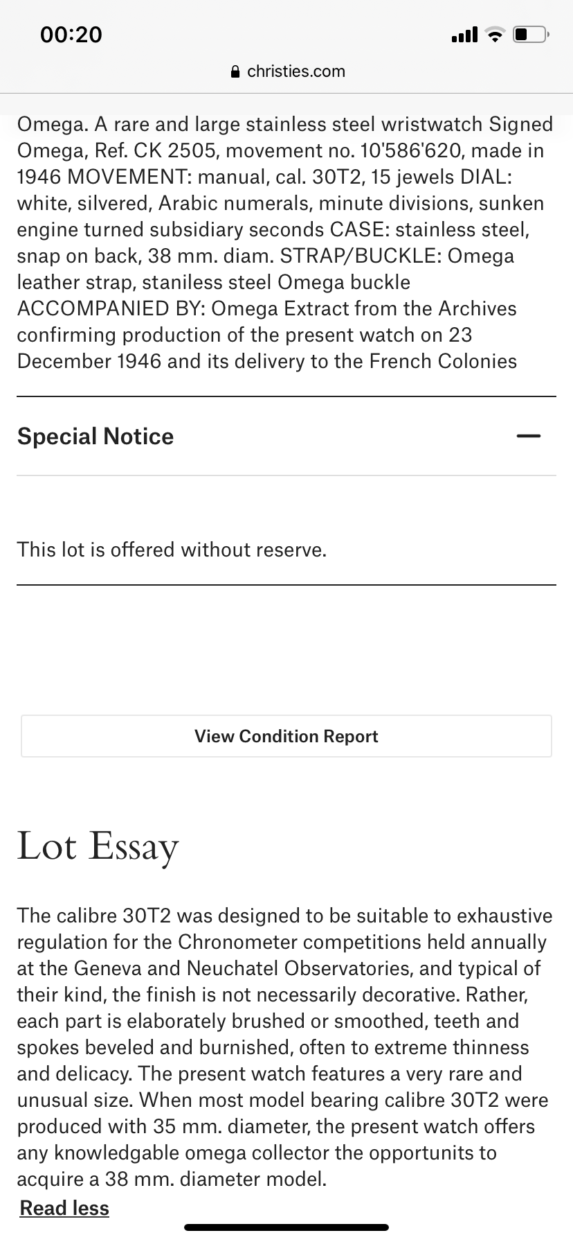

I would take that auction sales essay with a grain of salt . I think you are reading too much into it. Also I have seen many people refer to all 28x and 26x as 30t2 ....... just lack of detail... better to say 30 mm omega movement in general....
You have a nice watch , now we need to wait on your photos of movement and inside case back to make a determination.

I can't see the auction write-up, but 30T2 movements in jumbo cases aren't terribly uncommon, 2505s often came with 30T2 movements for example, despite what the OVD says.
Of course, the more qualifiers you add, then the more rare it is. So if you are asking about 30T2 movements in rose gold jumbo cases with both Swiss and French hallmarks, then yes, that is probably fairly uncommon. But so are a lot of other things.
