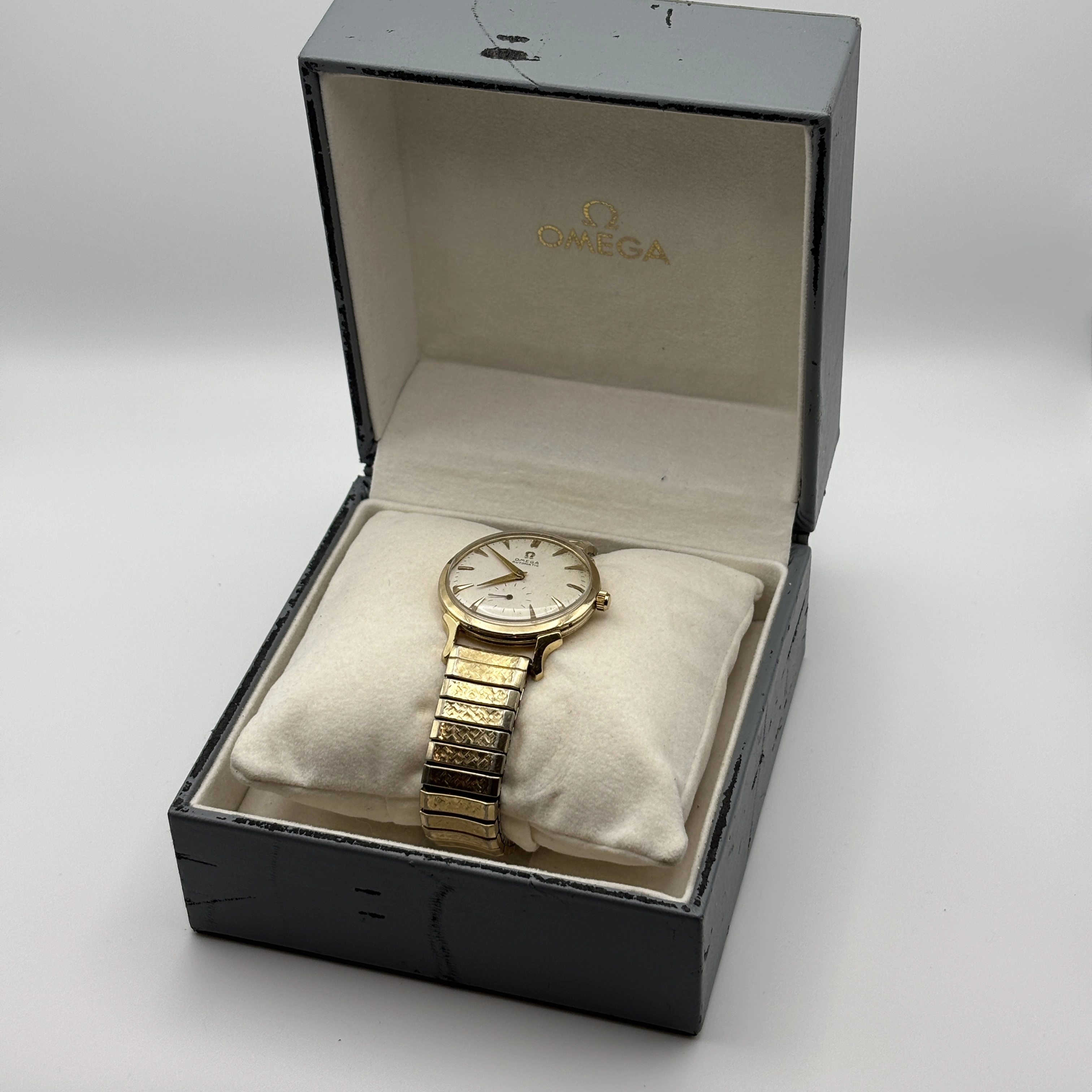

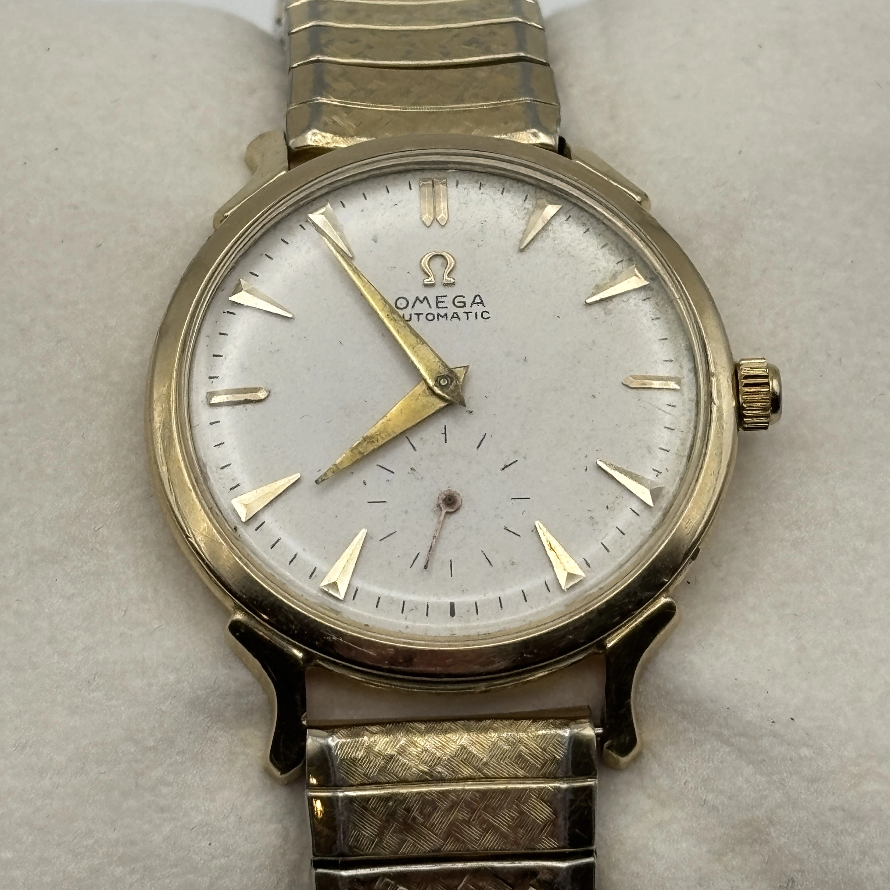

Is this worth servicing before selling?

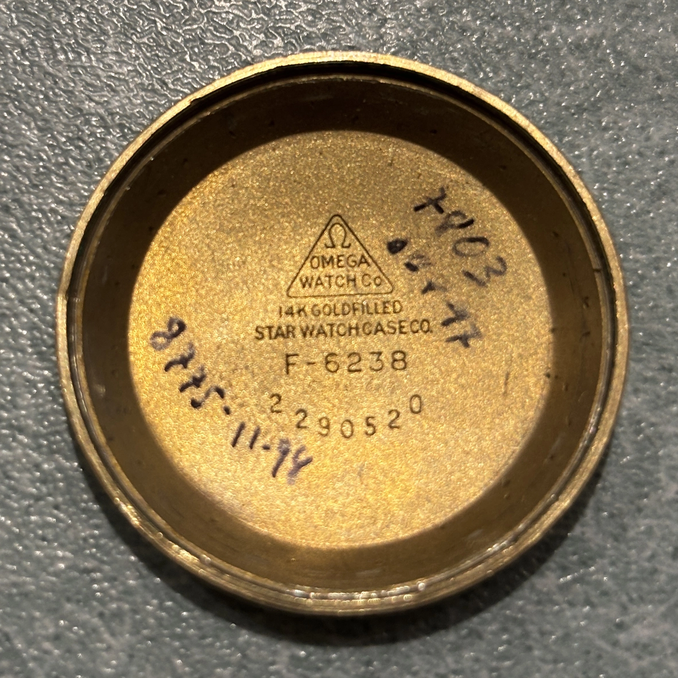

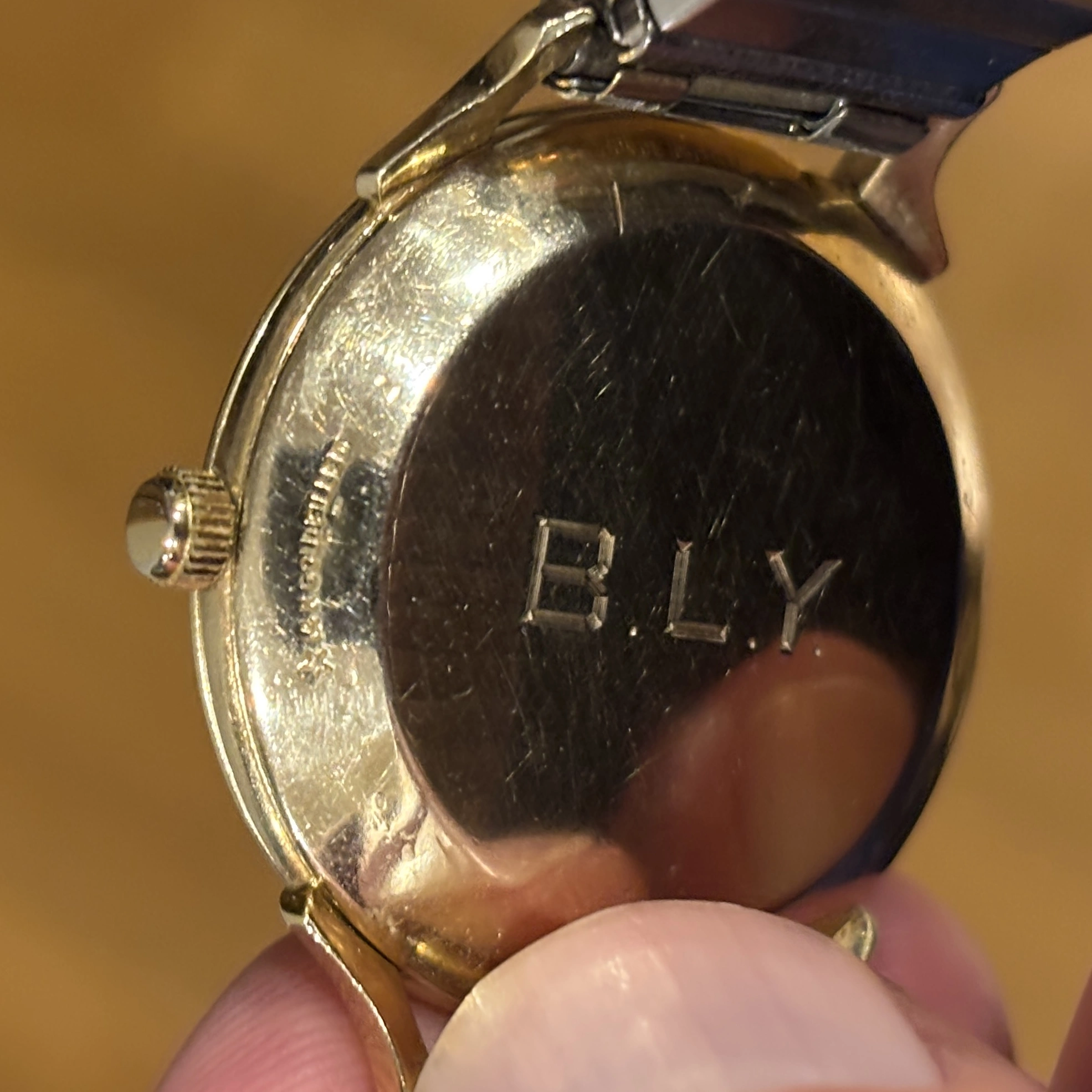

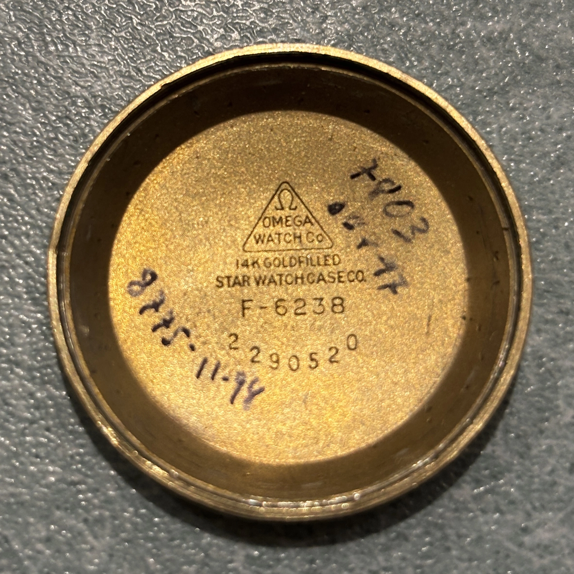

I have this vintage Omega F6238 automatic bumper, 1950, 14K gold filled with gold Seidel expansion band (s/n 12813226 if anyone cares). It came down from a relative, and I don't want it so I looked on eBay to see what they're going for, and it looks like anywhere from $300-$1000. BUT... this one is monogrammed. So it's going to be on the low end of the range at best.
I wound it and set it earlier, and was just going to list it when I noticed it had lost a few minutes in just the past hour. Soooo it clearly needs a clean/oil/adjust at a minimum. Sigh. I do not know any service places so would be searching in the blind, but it sounds like I'd do well just to break even.
What would you do? Would you service it first and risk being underwater, or just sell it saying nothing more than "it runs"? Searching through eBay listings, I don't see any that mention how well it runs or whether it's been serviced. But I don't want to be a deceptive seller.

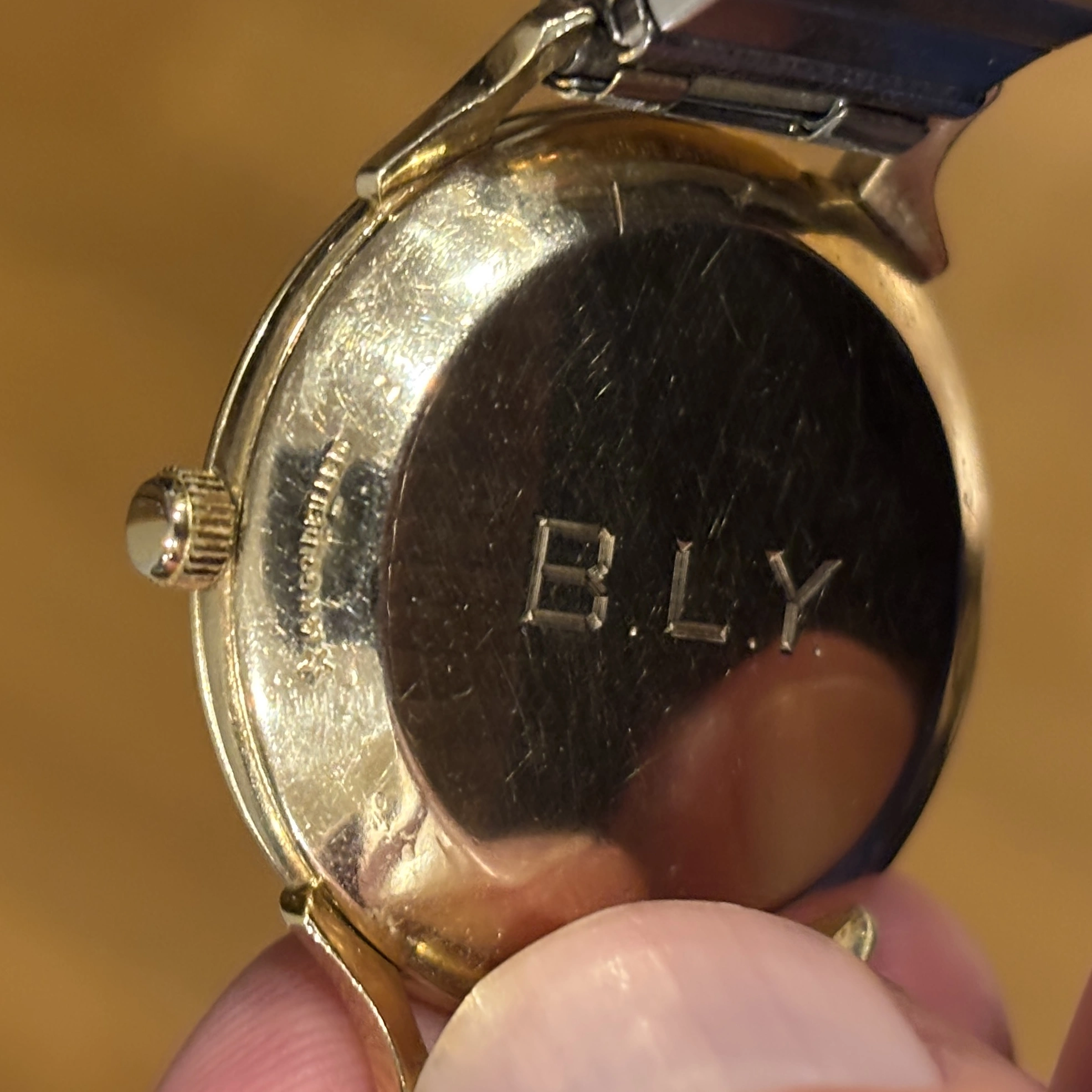

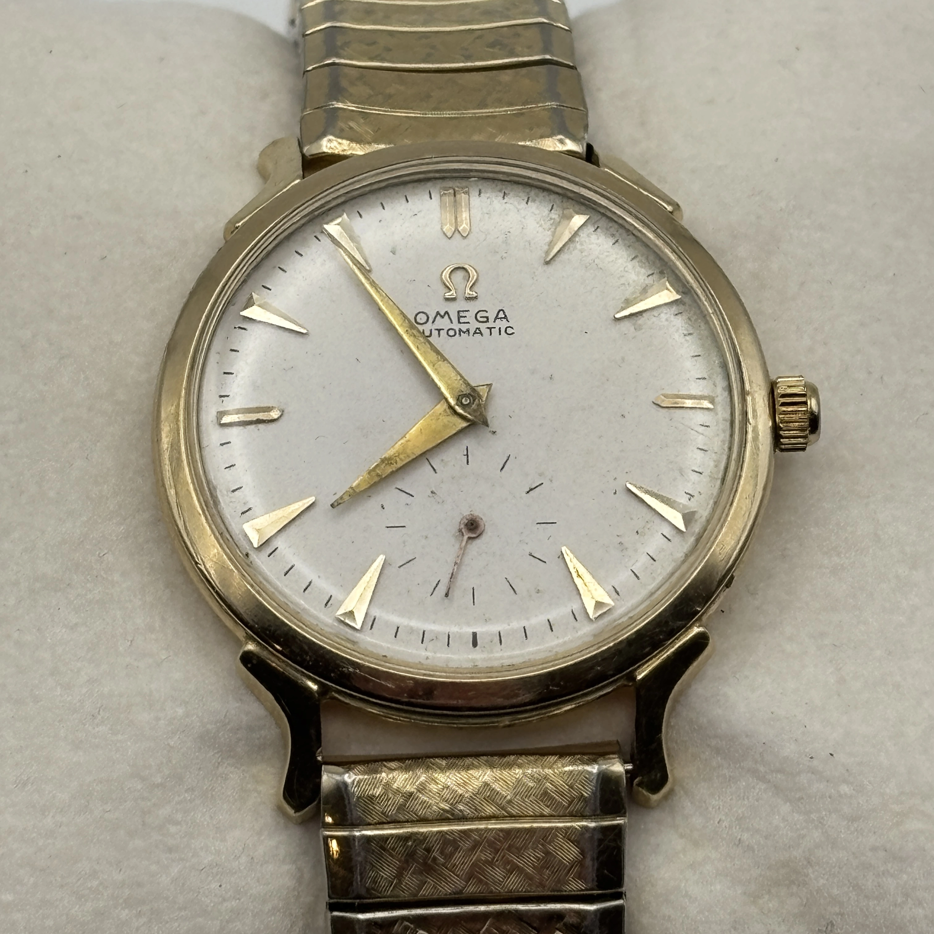

Good research, I'd agree based on a few things. That dial looks suspiciously like a redial/refinish, and the hands don't look quite right, but I'm not familiar with this reference enough to answer definitively. Either way, both are in fairly rough shape, and a service doesn't really improve those. The case looks reasonably nice at least, though the movement is rough (which WOULD be fixed by a service).
However, a service is going to be a minimum of about $300 + parts, and at least the second hand is in need of a replacement, and a non-Omega part makes it even closer to the low-end. I'm guessing you'll need a few, so you are probably talking closer to $4-500 for a service.
At that point, it is probably going to be worth $3-500 at most. So in the end, you'd be lucky to get your service-cost back. IMO, not worth it when you could probably get $200+ for it if you listed it as an auction right now.
IF it were me (as you*), I'd list it honestly on ebay: "runs, but runs slow, needs a service". Else you risk an ebay return, which can be expensive.
*If it were me, me, I'd just treat it as a project, and try to do a service/track down parts myself, and spend a bunch of money getting it to be something I'd be willing to give as a gift.

Due to the poor redial and incorrect hands it will be at the low end of the market unless someone wants a 6238 case or the movement.

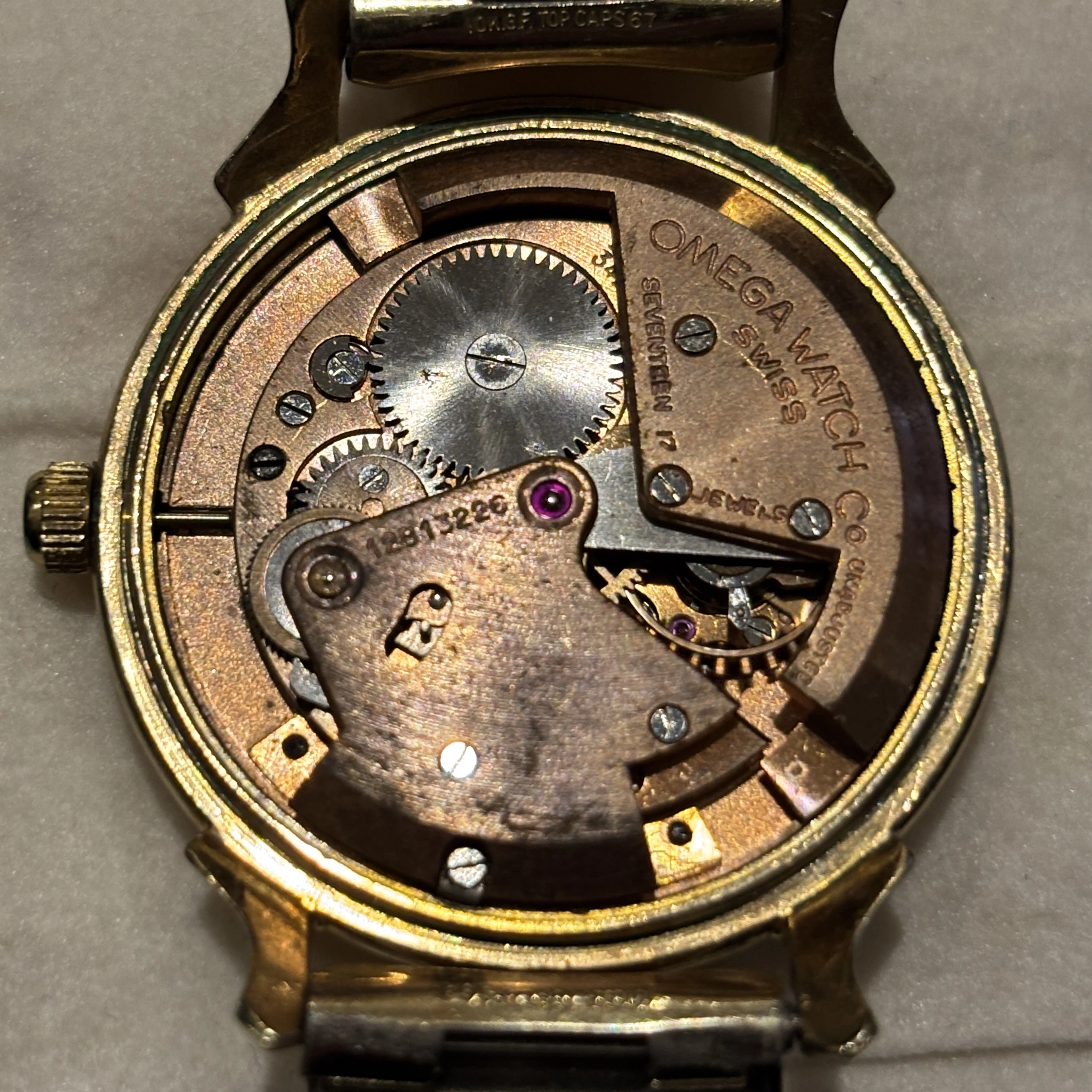

Sell it on EB , no reserve start 1.00, Omega automatic watch, early 1950s , running but Service history unknown , as is. 14k gold filled case.
Movement caliber 34x. If you move the rotor you will see number.

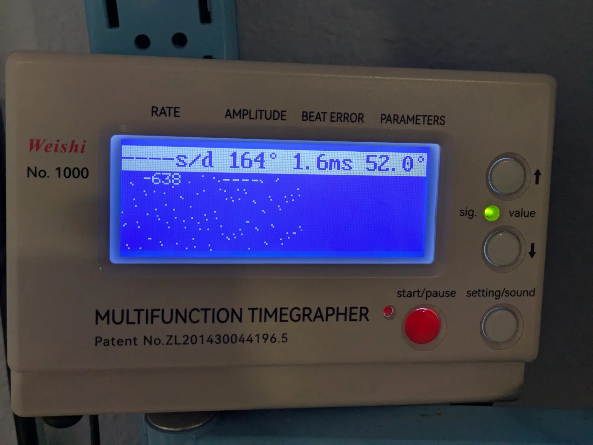

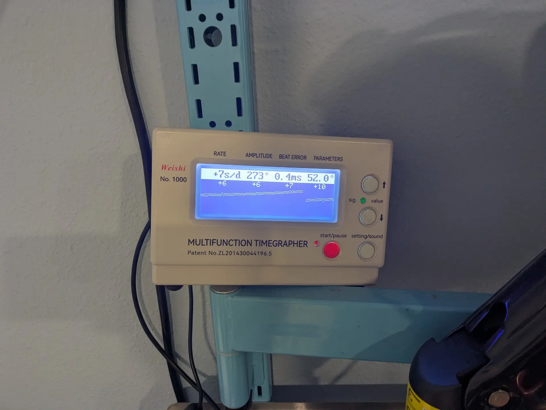

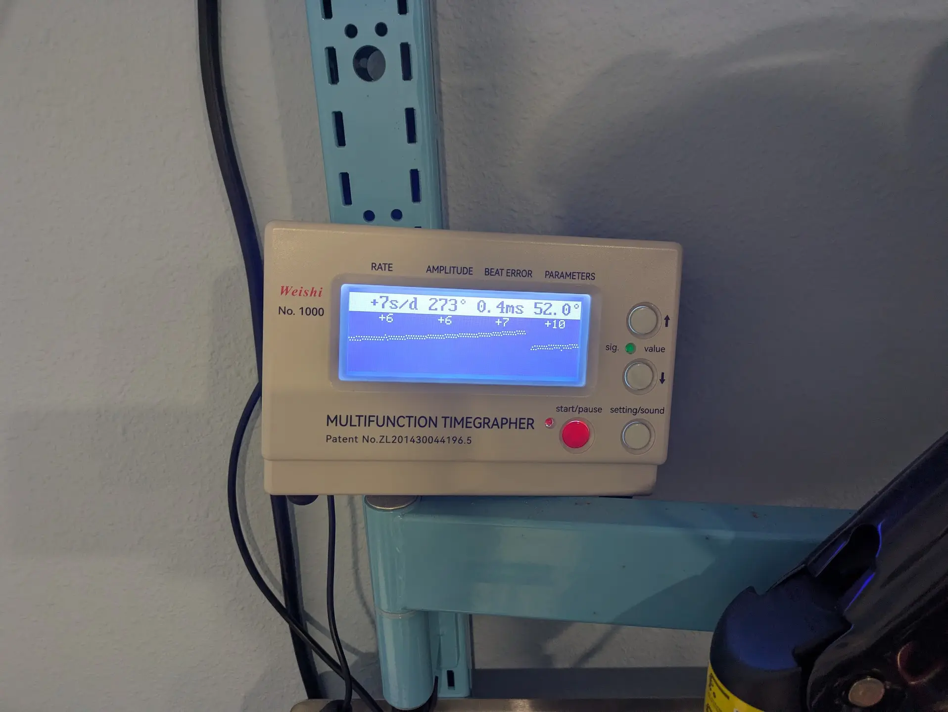

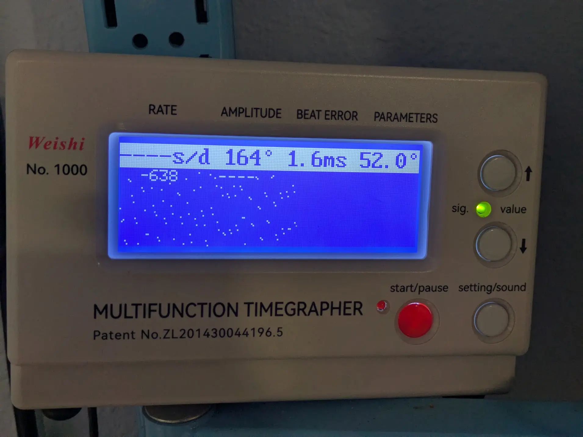

SO just got this. The dial isn't awful looking, but definitely a redial. I might be looking for one once I figure out sizes/etc on this one. The hands themselves are pretty ugly, the second hand is bent on its pivot (poked upwards), and were kinda mainhandled in. So I'll need those too.
The timegrapher app on my phone was not very friendly to this, it was a snowstorm.

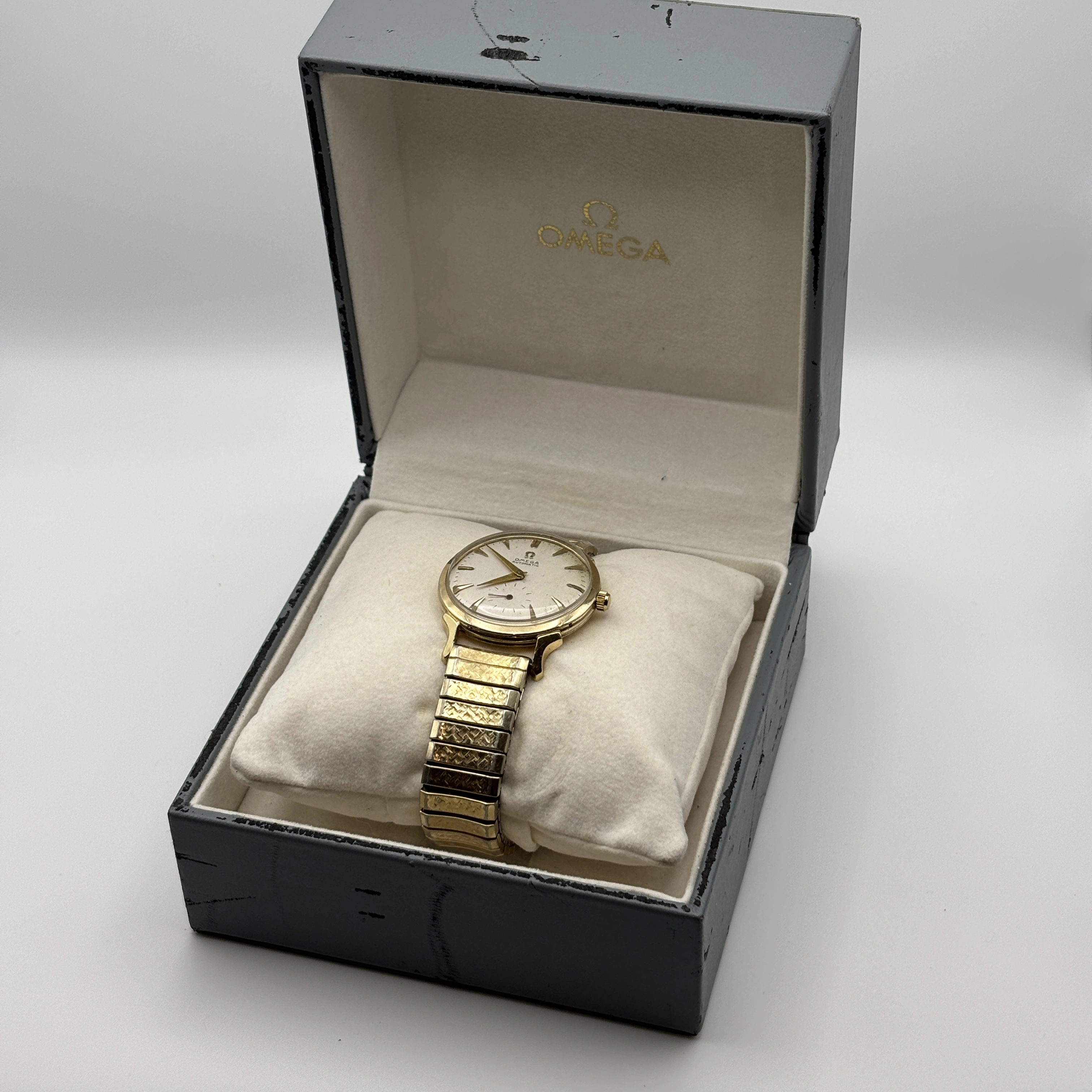

On the bright side, it arrived quickly, the case is a 6/10, and it came with an older Omega presentation box that isn't too bad.

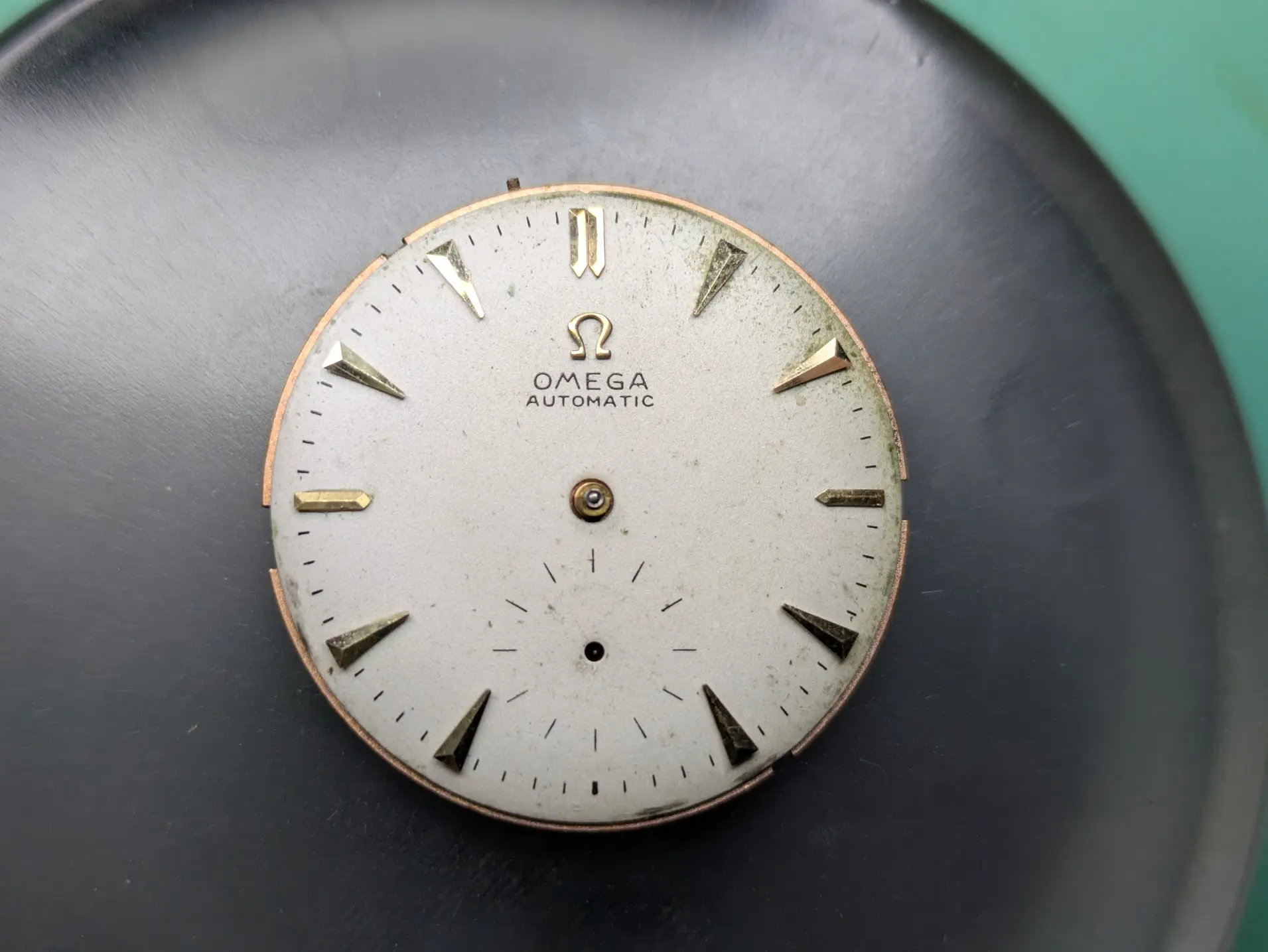

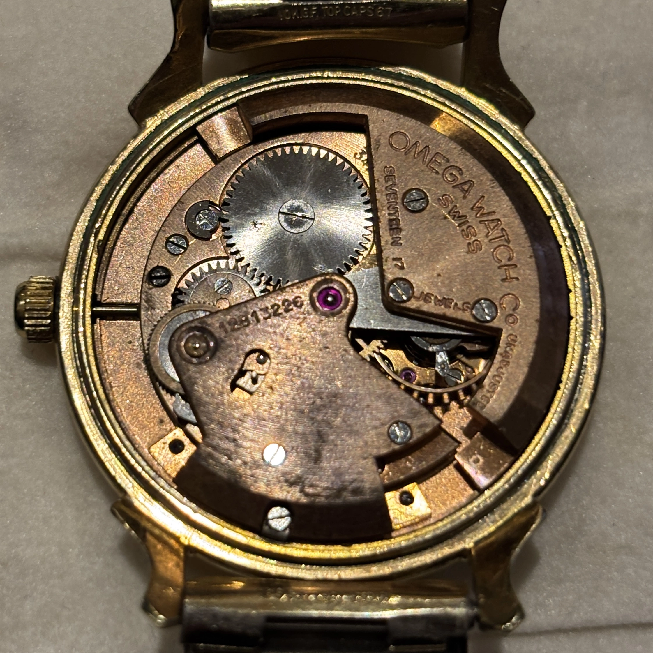

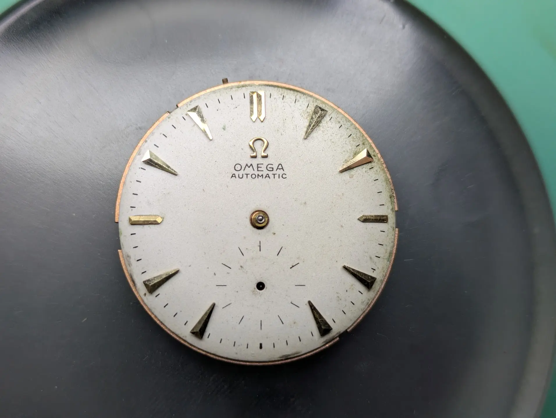

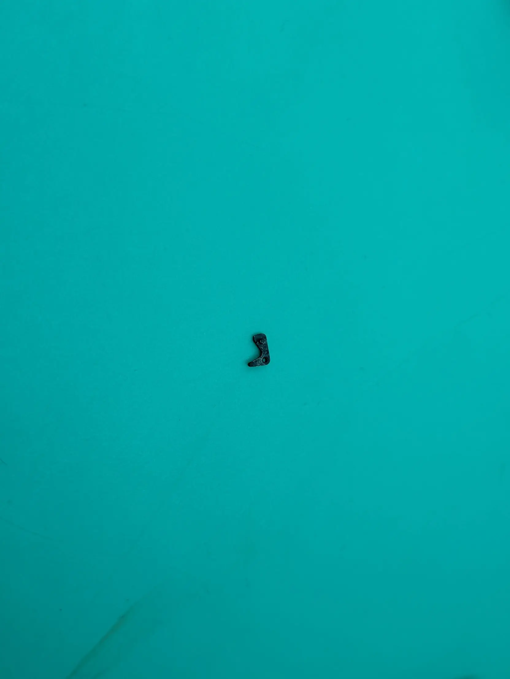

Alright, FINALLY got this guy apart! It made it to the top-ish of my queue, so I figured I'd share in case anyone is interested. Put a full wind in it, and the results are bad.
The hands are pretty bad, look pretty generic and the second hand doesn't match at all. I'll probably replace it. On the other hand, the dial is actually decent. The markers are all even/equal/etc, but the text is uneven. I might just roll with it and keep this as a bit of a 'beater' :

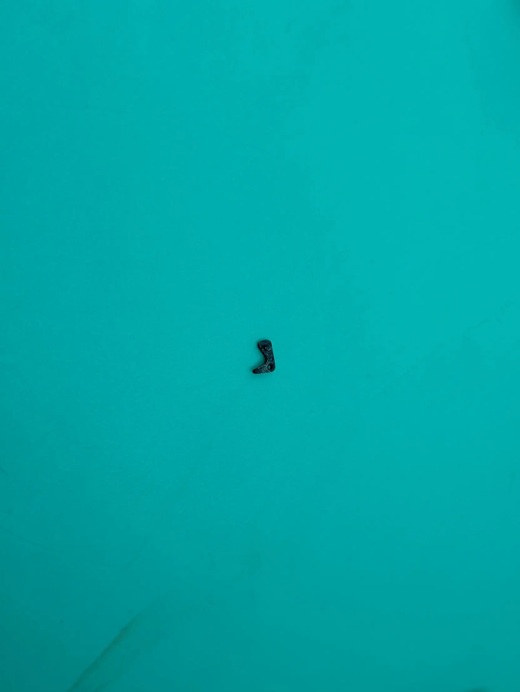

Movement itself is PRETTY dirty, but I DID find something odd. Setting lever plus a few screws are BLACK! I've never seen that before!
It came apart pretty easily, and other than a mainspring (the last coil is broken off) it doesn't seem immediately like it'll need anything. Its one of a few movements that I have in my 'next to service' list, so hopefully I'll get it cleaned up well enough soon!
2,842
4,537
Steel turns black like that when it is in contact with some de rusting agents like evapORust. What may contain citric acid. I think excess ammonia in cleaners can do this as well.
The black is an iron oxide which is fairly stable. I think it is called hematite which I just looked up. Basically this is iron ore. The black rocks on mars are made of this stuff. I think the red variation which is common rust is less pure or has more oxygen in it. This is also what gives blood it's red color, that turns black when dry.
Has interesting magnetic properties. I got a jar of it from Home despot. Called cement coloring. Can be used to develop magnetic patterns on things like credit cards and such. Should also be useful for making recording tapes and stripes. My plan is to see if I can use it to revive some old APS cameras.
Usually it polishes off. The resulting iron seems darker even when it takes a mirrored finish. Might be that it leaches out some of the carbon in the steel.
A lot of my rust rats have parts this color, especially the chronographs. Not uncommon to find the winding setting mechanism as you show. My uneducated guess off the top of my head is that something acidic may have leaked in through the crown.
