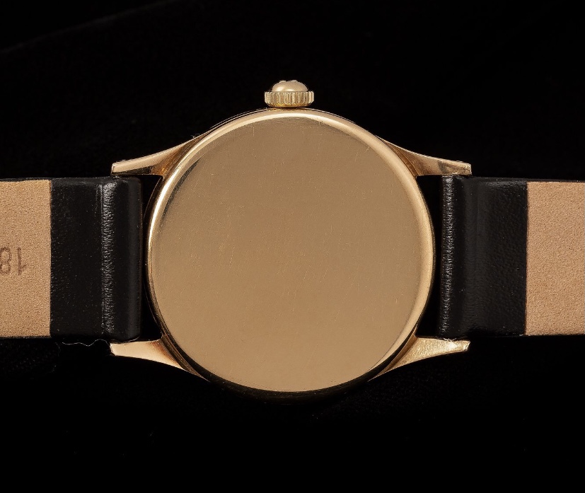

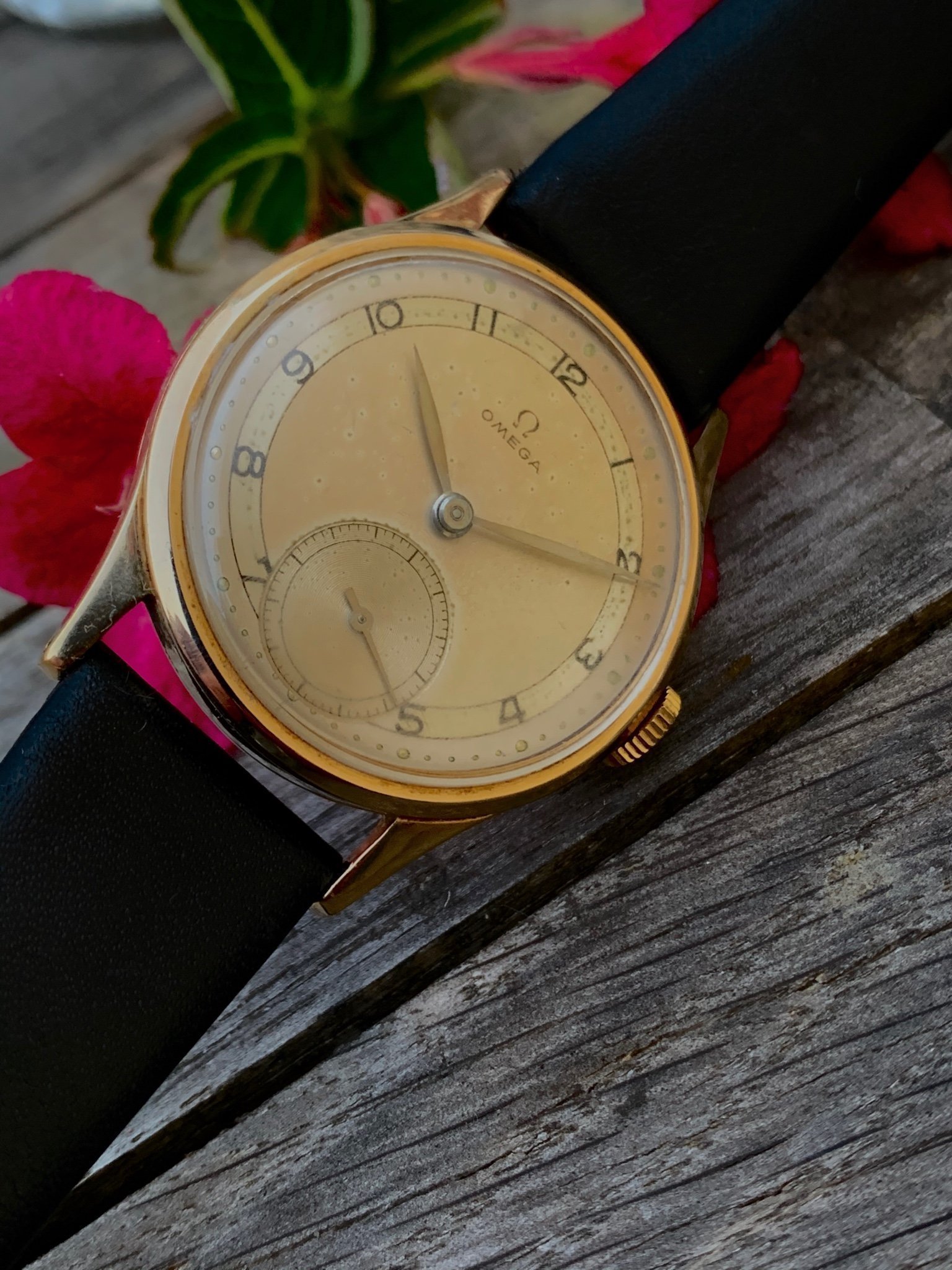

Won this beauty from Sweden with a modest bid. Seller claims 14k case, I have not examined the photos for hallmarks.
As you can see, the case seems to be locally sourced, without any reference. If this is the case (no pun intended), will I get any useful information from an extract from the archives?
522
2,355

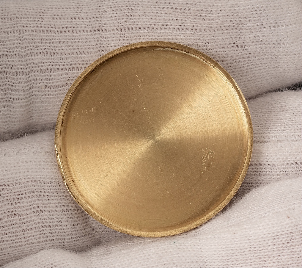

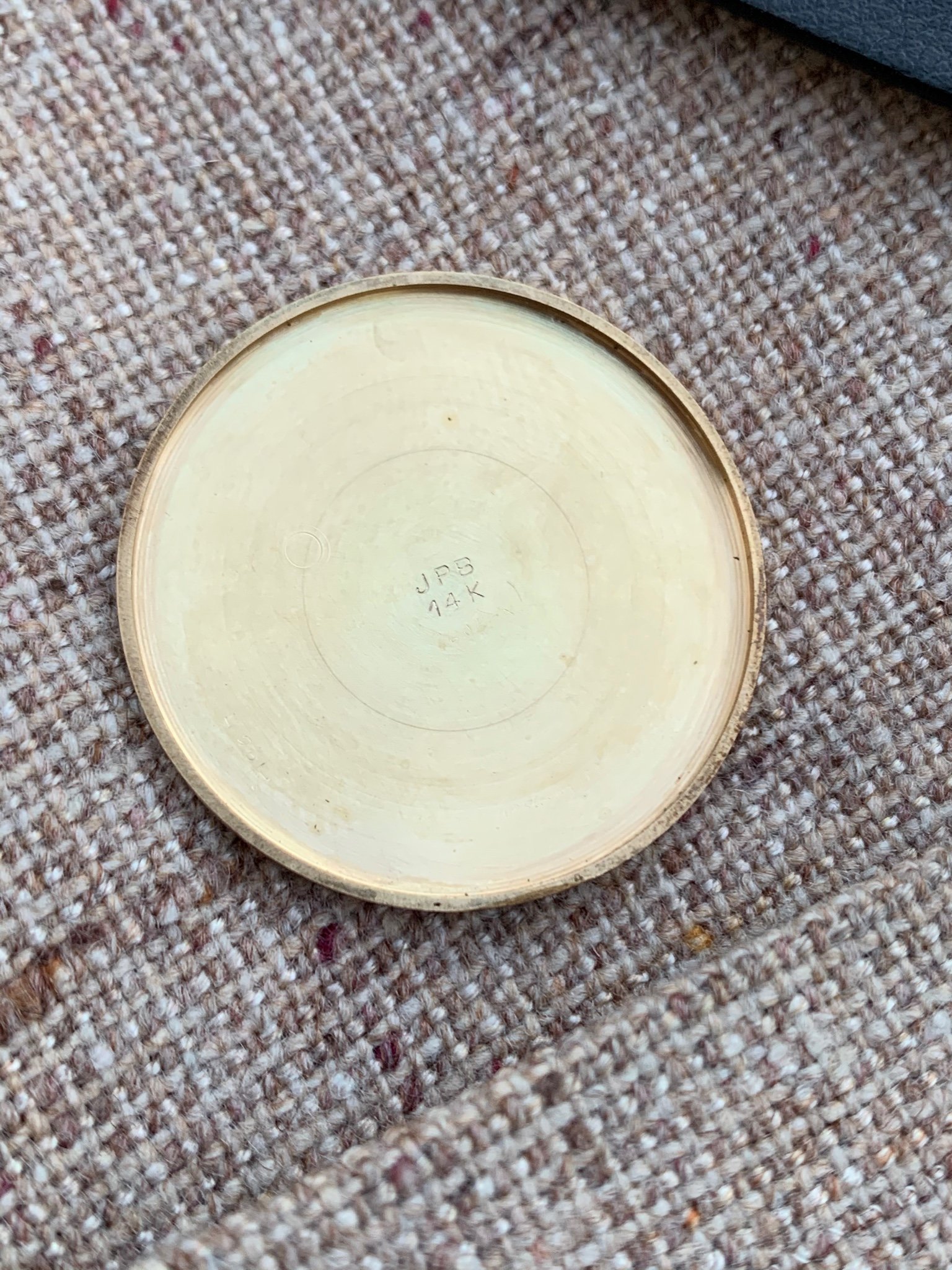

Its a case for Swedish market made for omega agent J-P Brandt you can se the initials JPB in backcase.
2,270
15,731
I did not have the courage to bid because of no gold hallmarks, even though the case is made by J-P Brandt my feeling was there should be gold hallmarks still. But I have little knowledge in this area.
I examined the case carefully on the suprisingly high resolutioned pictures and only proof of it being 14k gold is the thin ”14K” marking below JPB on your picture.

They dont cary hallmarks belive it has to do whit wartimes.
Production vas fairly big and they show up freqwently on Swedish market allways whit the same dial.
1,719
7,387
Thanks for your help, @Skrotis and @hejsam ! Now I am more confident in receiving a non-tampered watch.

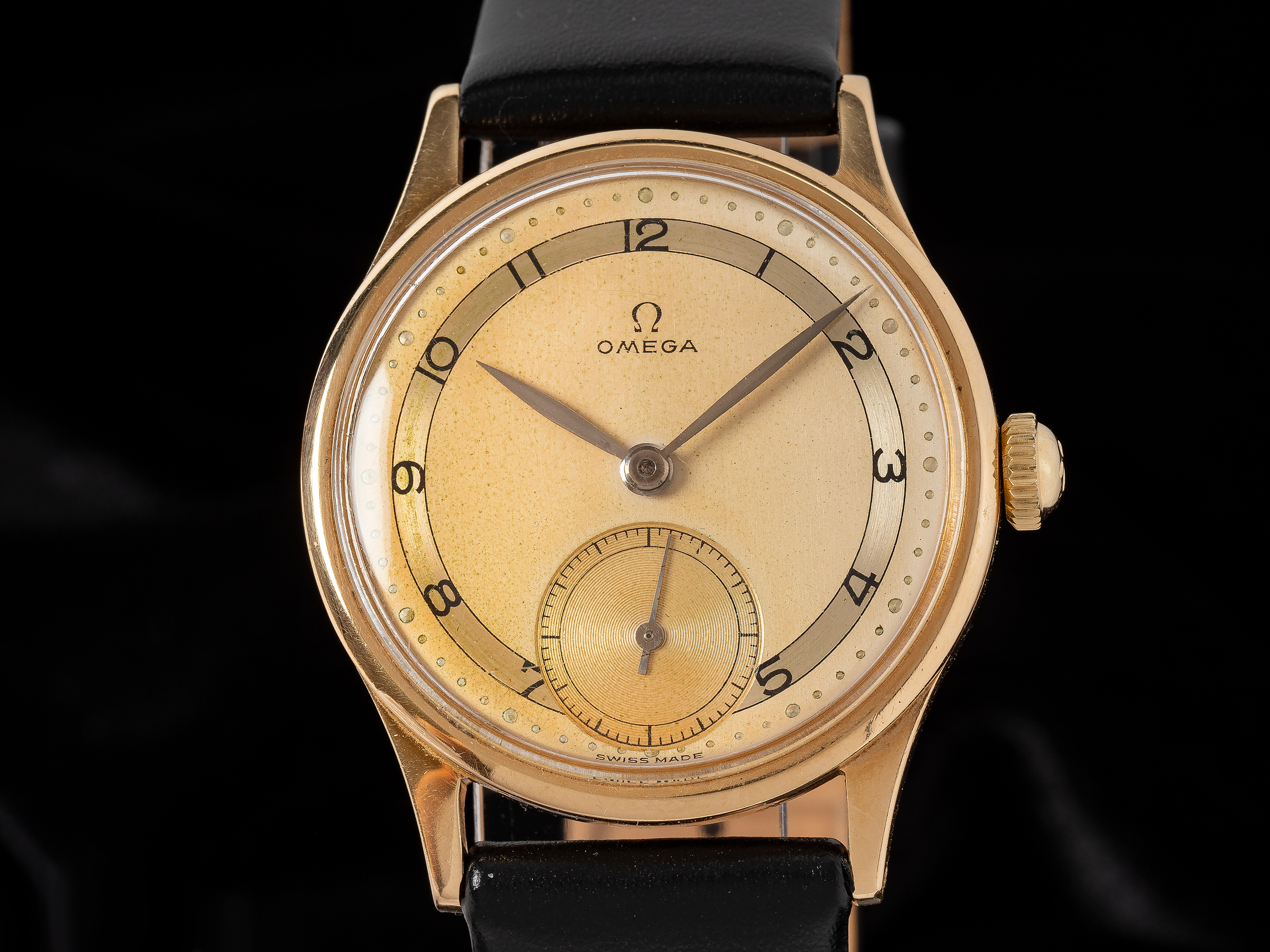

Nice looking watch. Another late 30T2 with an 11.1M serial number

I have seen a few of these watches with flat crowns. What do you all think was correct - flat or bowler?

Dang (but thanks) - I think you are right. OTOH, a flat Ω crown with close to original dimensions should be possible to get.

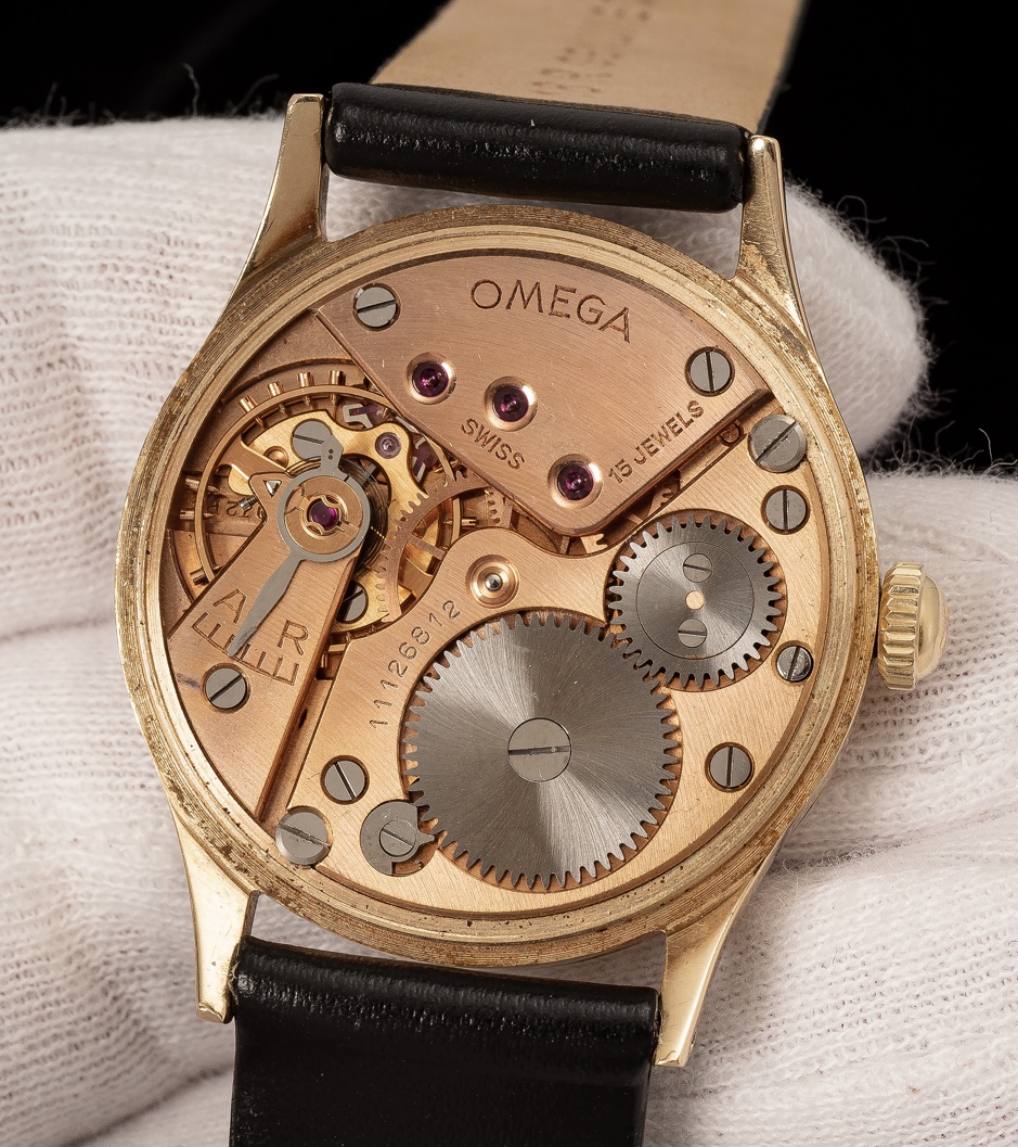

Here are some additional high resolution pictures...

Are these hands steel? I was watching this auction, but refrained from bidding because I find it highly unusual that a gold cased watch would have steel hands.
Perhaps its the lighting, and perhaps I am misinformed but I have never seen a 30T2 where the hands don't at least match the numerals, or, indeed on a gold case not also be gold. The only watches where the hands do not match the numerals as far as I am aware are blued hands, where the numerals are black.
I do think the watch is stunning nonetheless, and sold for a price similar to what I would have bidded up to, had I been convinced that it hadn't been played around with. My personal conclusion was that the dial is original, as are the original hands, but perhaps not an original case, although of course I could be wrong. I would have bidded, but was not confident to do so at that price.
If any members here have any other experience with steel hands in gold cases, please enlighten me 😀

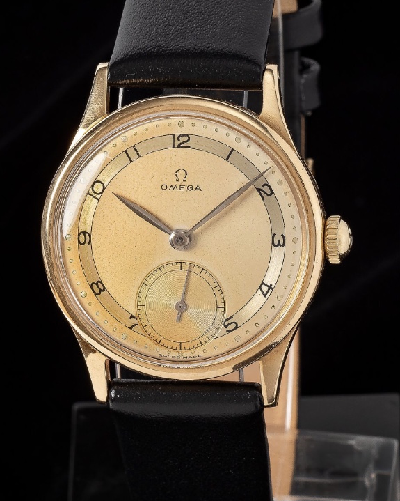

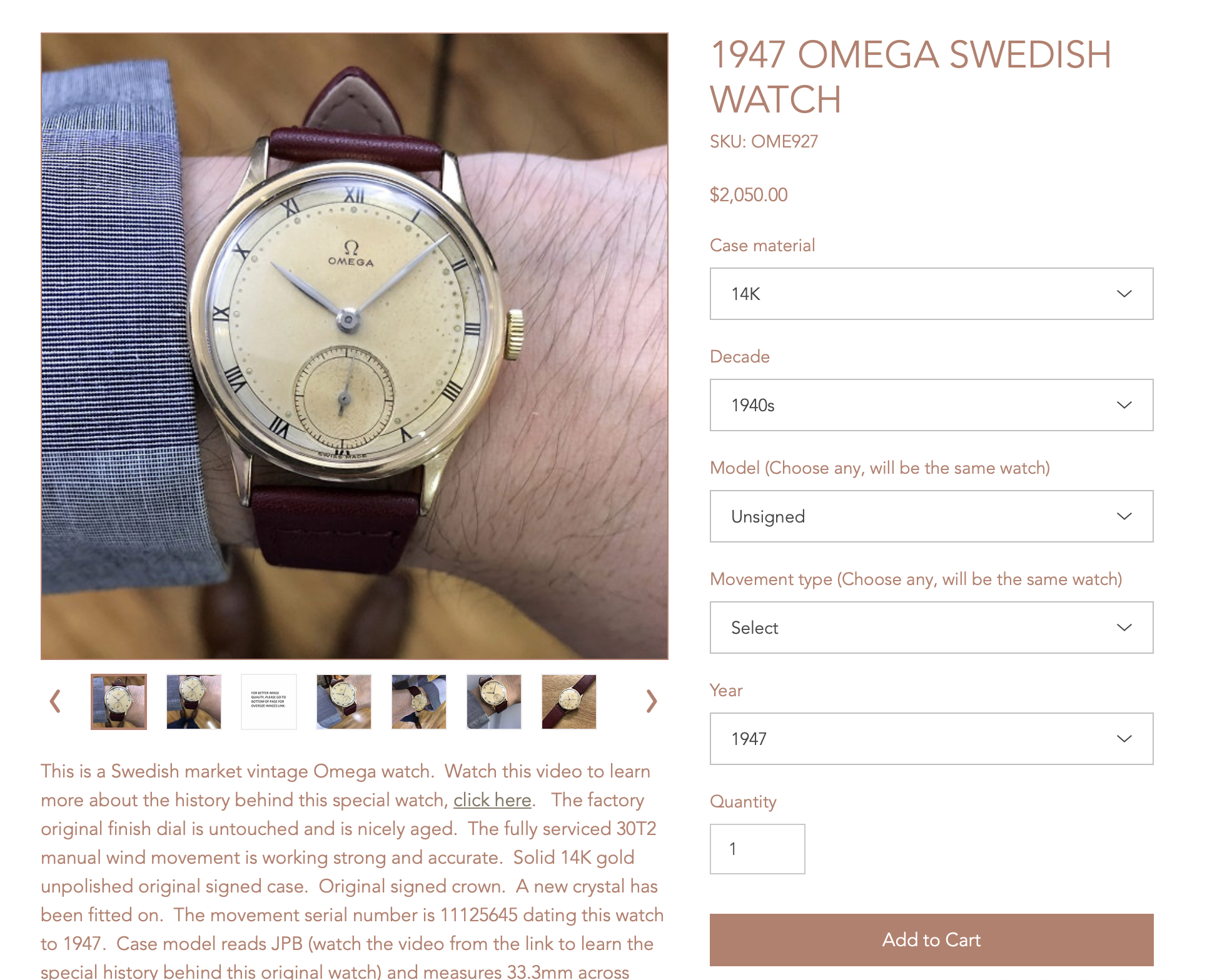

I asses the watch as all genuine. Just a replaced crown. Here is a picture of a similar one. The case is marked JPB as mentioned which was the Swedish agent for OMEGA.

Another similar model with steel hands (chrome or nickel plated?) and flat crown.

Perhaps they did exist - in which case, congratulations! It’s sure a stunning watch which I am certain will provide you much joy ☺️
1,719
7,387
Thanks! Yes, it may only be 33mm, but I have matchstick wrists, so it will look fine. Just gotta find a replacement crown at some time.
