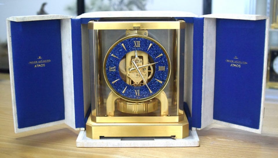

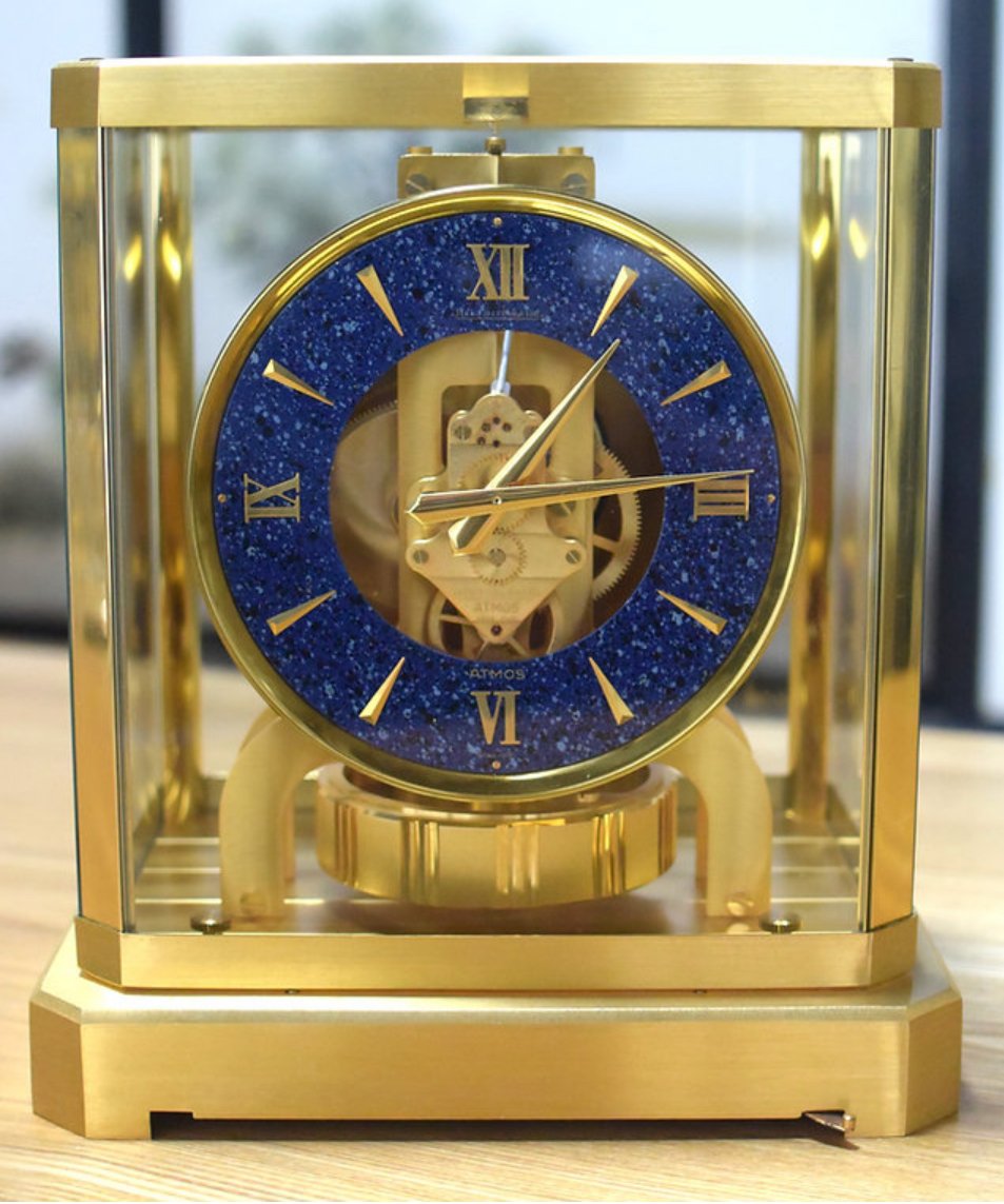

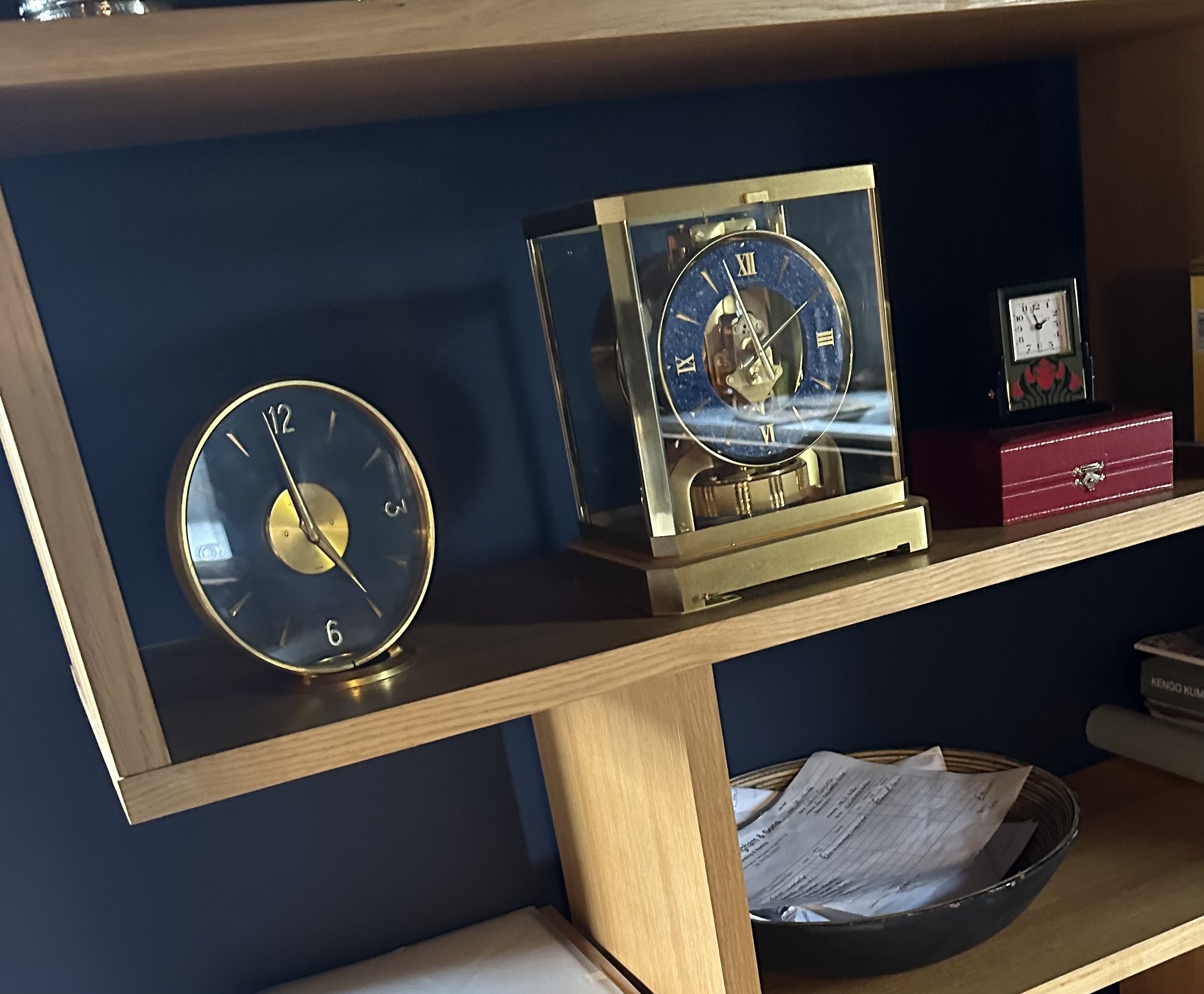

Got this recently, nearest thing to perpetual motion.
Ref 5911 from around 1980, cal 528
Lapis Lazuli dial, quite mesmerising.

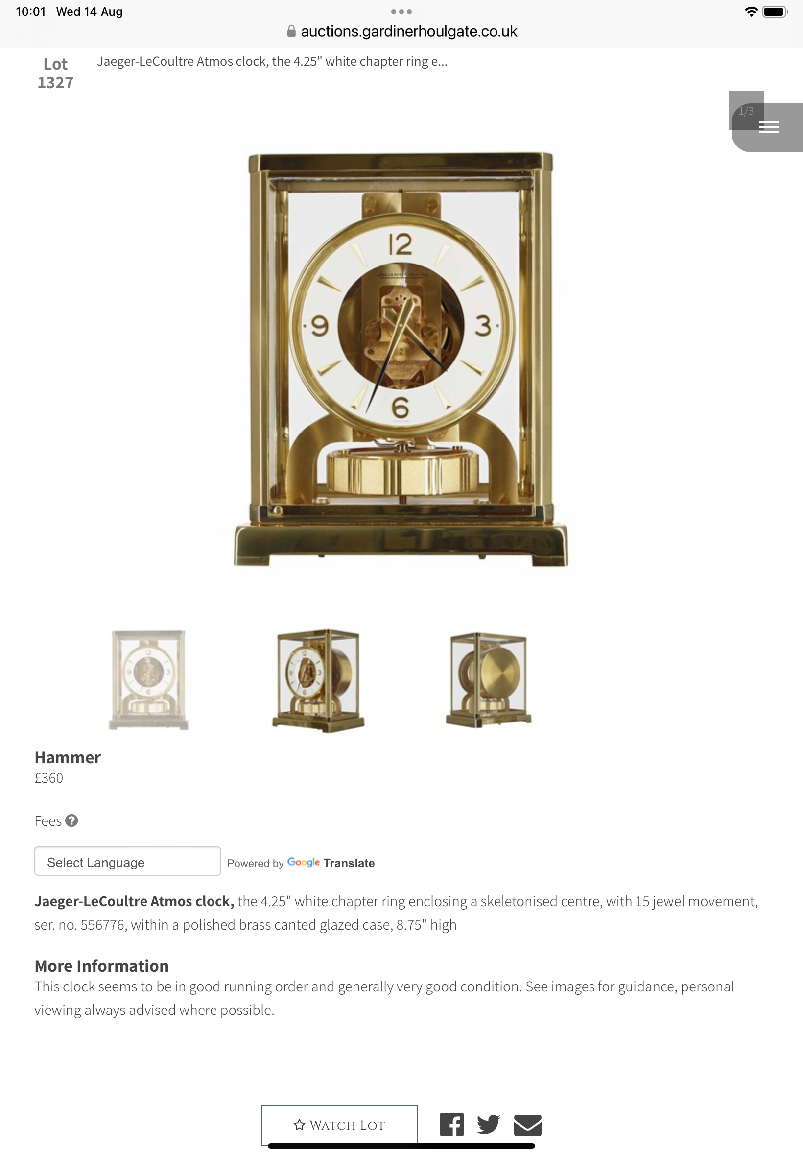

The other threads peaked my interest in Atmos clocks. Especially the part where I can pick one up from eBay for a couple hundred bucks and get it serviced for a $1k. New ones cost $11k+ so this seems like a bargain in comparison.

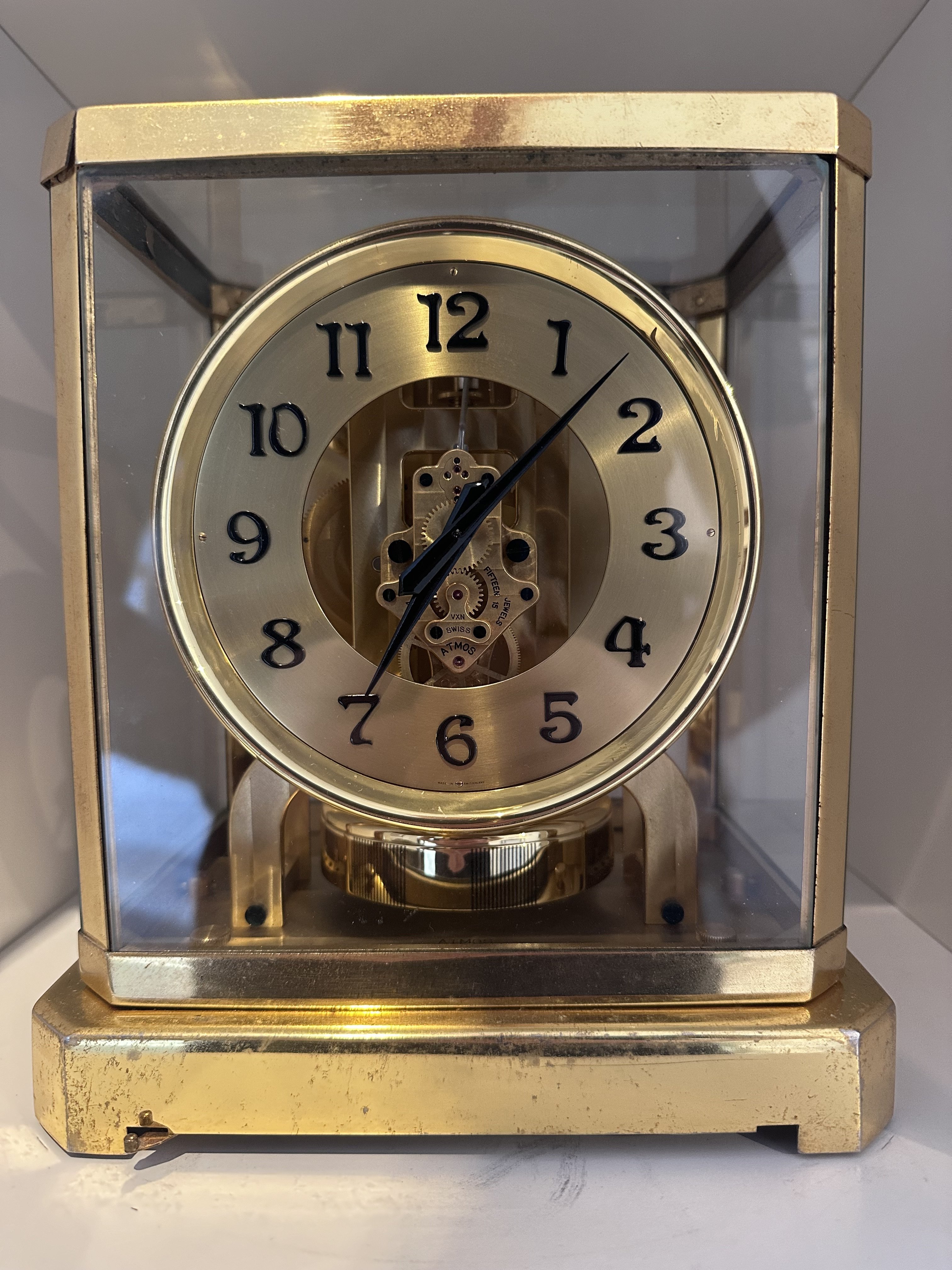

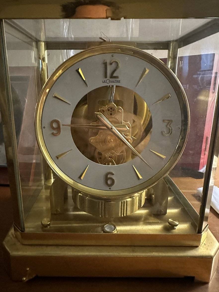

Bought her years ago and always worried during our four moves, two international, due to how fragile they are said to be. Has worked great for the past decade but starting to lose time (1-2min/day) and randomly stop. I’ve leveled it twice and it is on a relatively vibration free bookshelf with minimal foot traffic on the first floor.
I’ll try another leveling, but perhaps it’s time for a service .

Bellows could be shot, they will eventually fail. Mine has the original bellows since its construction in 1963....it's hit or miss on how long a bellows will last. But all Atmos clocks eventually need service. Your's is a very early example, so it could be anything at this age.

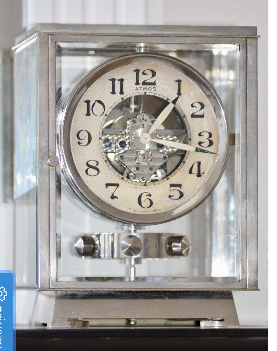

Is this an early Atmos II? From the early to mid 1940's?

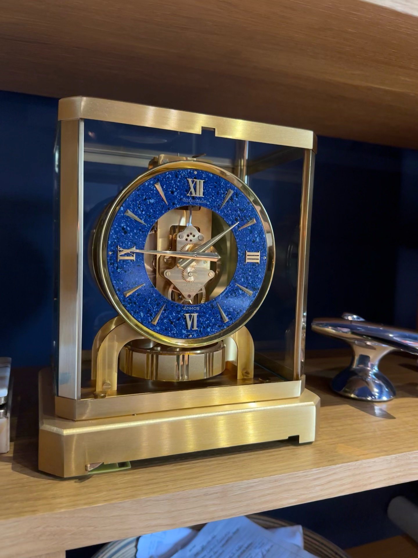

Do you know if my own (the “Lapis”one above has a dial that is actually made from Lapis Lazuli stone?
They are actually described as so by Jaeger in their literature but several I have seen for sale have “Lapis” in commas to denote they are actually not.
The seller of mine told me none are Lapis from the factory but some sort of enamel and that mine was original from the factory.
It’s multicoloured with gold flecks. No fissures or faults.
I own a few stone dialled watches so kind of know what to look for. I would say mine is not stone.
I have no idea. It could be vitreous enamel on copper or a colored glass or natural stone.You could ask LeCoultre in Switzerland.
7,800
14,405
Due to the large surface area of the dial I suspect it is a lapis lazuli finish rather than a thin rock veneer. It is fairly easy to achieve a lapis-like finish via enameling. If it is real lapis lazuli you should be able to detect lines where it was pieced together.
