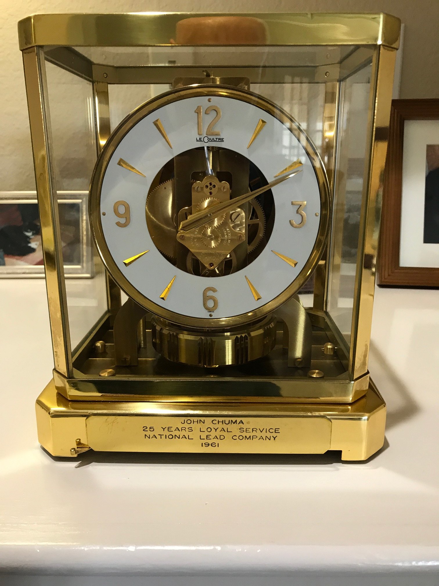

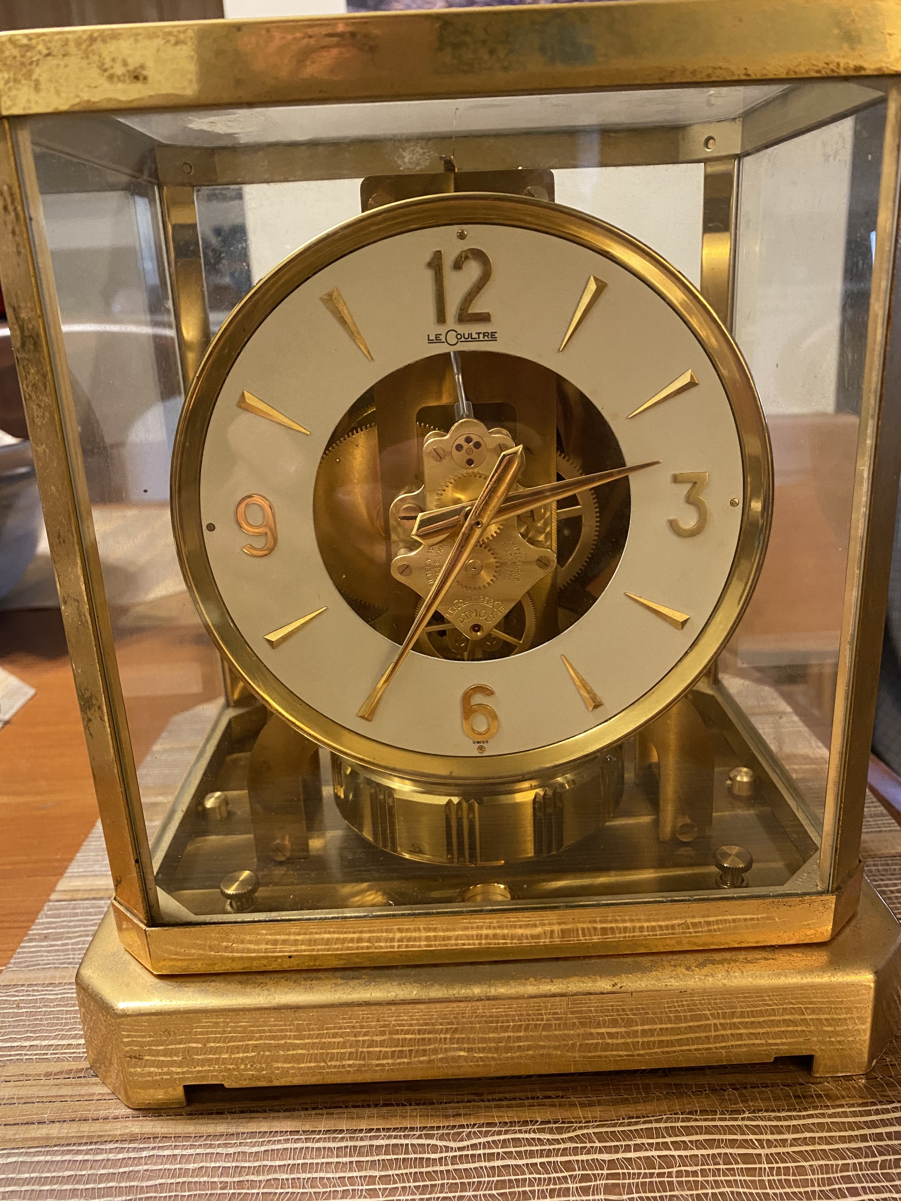

This was recently given to me as the family watch enthusiast from the estate of a deceased relative. As I’m a watch guy and not a clock guy, I know very little about these clocks other than that they are still made by Jaeger-LeCoultre. As best I can estimate from what I know about the deceased, this was probably acquired in the 1950s. It is in poor shape and doesn’t work. At a minimum, it would need to be rebrassed and have a full mechanical service. I can’t imagine what JLC would charge to service this - if they would even touch it. Worth fixing or do I have an impressive looking paperweight here? Any insights/info that anyone can offer would be greatly appreciated.
Thanks.
3,819
16,171
There’s a lever somewhere around the base of it that locks the pendulum in place prior to moving the clock. I understand that it is very bad to move these things without that lock on as the fairly heavy rotary pendulum is suspended by a fine wire.
there are specialists who work on these things and many of the critical parts are readily available if needed. The whole thing is powered by changes in the barometric pressure so there’s a large metal bellows inside. I had a friend who rebuilt one of these and he showed me the new bellows before he installed it, quite the cool piece of engineering.
i’ll see if I can find the name of a service center I was saw advertised in a clock reference guide.
were it mine I get it serviced and cleaned and enjoy it. Once set up and running right they’re quite accurate and reliable.

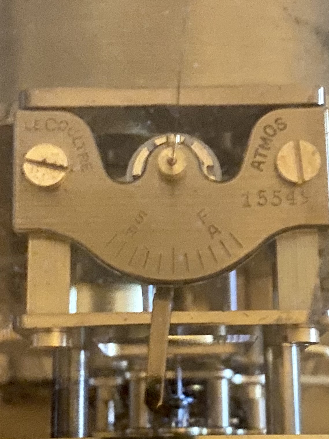

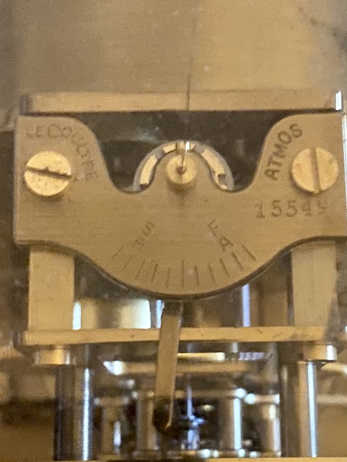

Thanks. Just located the serial number and I was off by a decade. It was manufactured in the 1940s.
13,685
19,062
Jaeger-LeCoultre will service these, but as you might guess, it’s incredibly expensive. The cases were plated in 24K gold, also very expensive. You are looking at several times the value to get it running again.
The original Atmos clocks of the 1920’s were powered by mercury and barometric pressure. Once the dangers of mercury were better understood, they switched to a temperature driven system powered by ethyl chloride, which boils at room temperature.
There is a simple formula for dating Atmos clocks made in 1954 or later. Take the serial number and divide it by 20,000. Add that to 1954, and you should be within a year or two. Your clock is right around 1954, maybe 1955.

Thanks, gatorcpa. I guess that I have nothing to lose by seeking an estimate. No question that it would be a beautiful family heirloom once restored.
