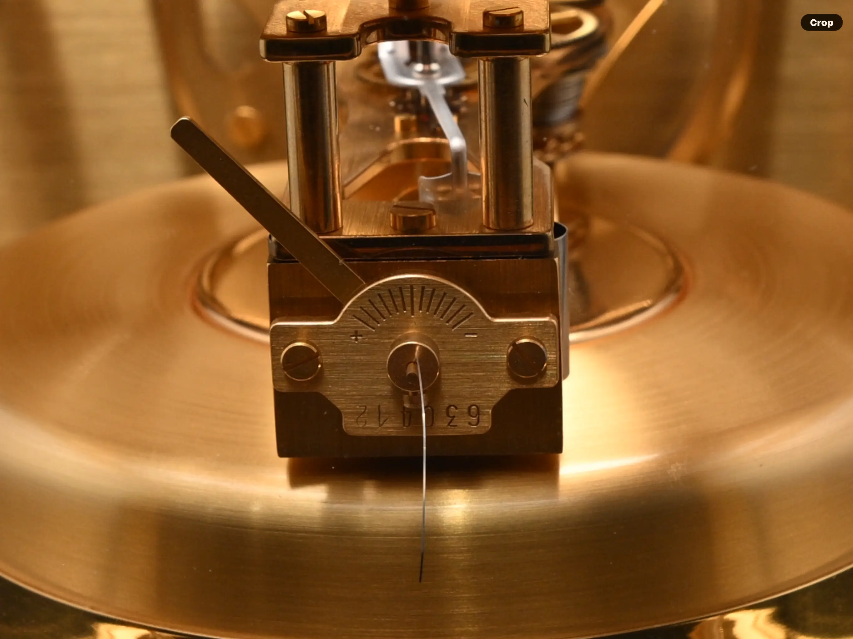

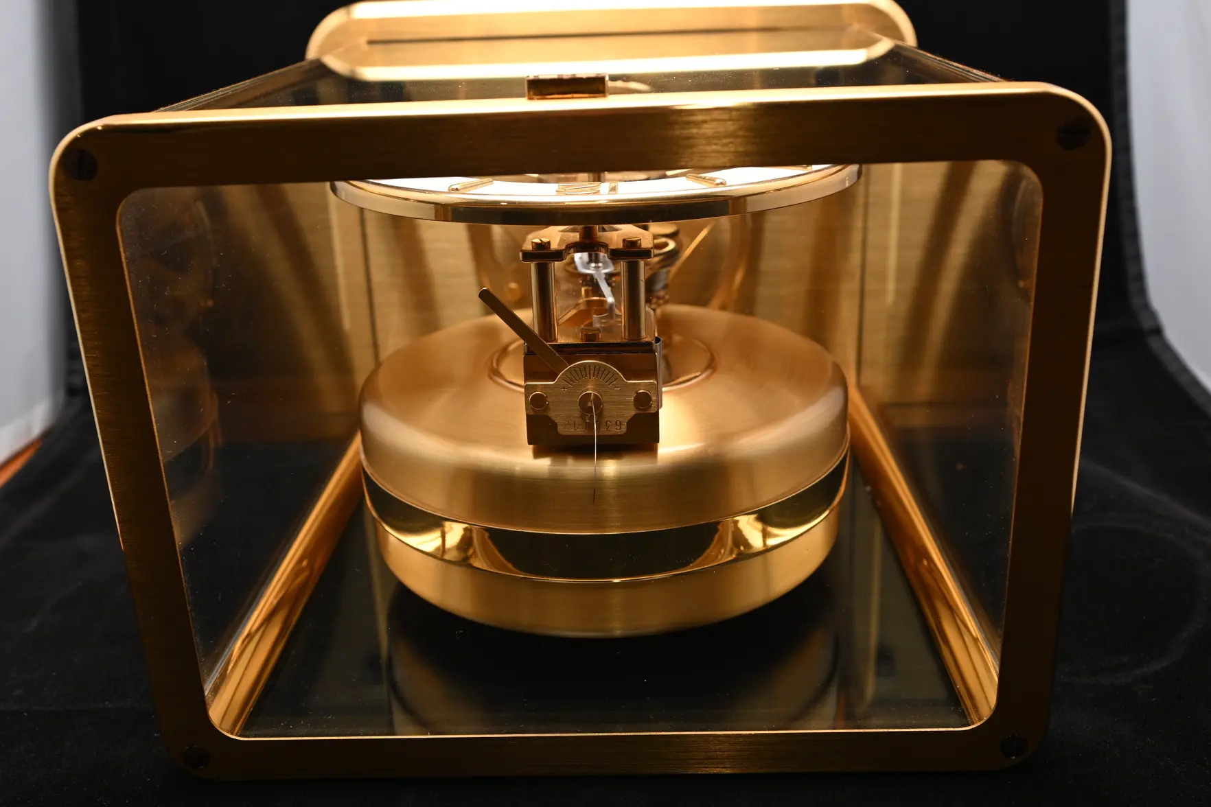

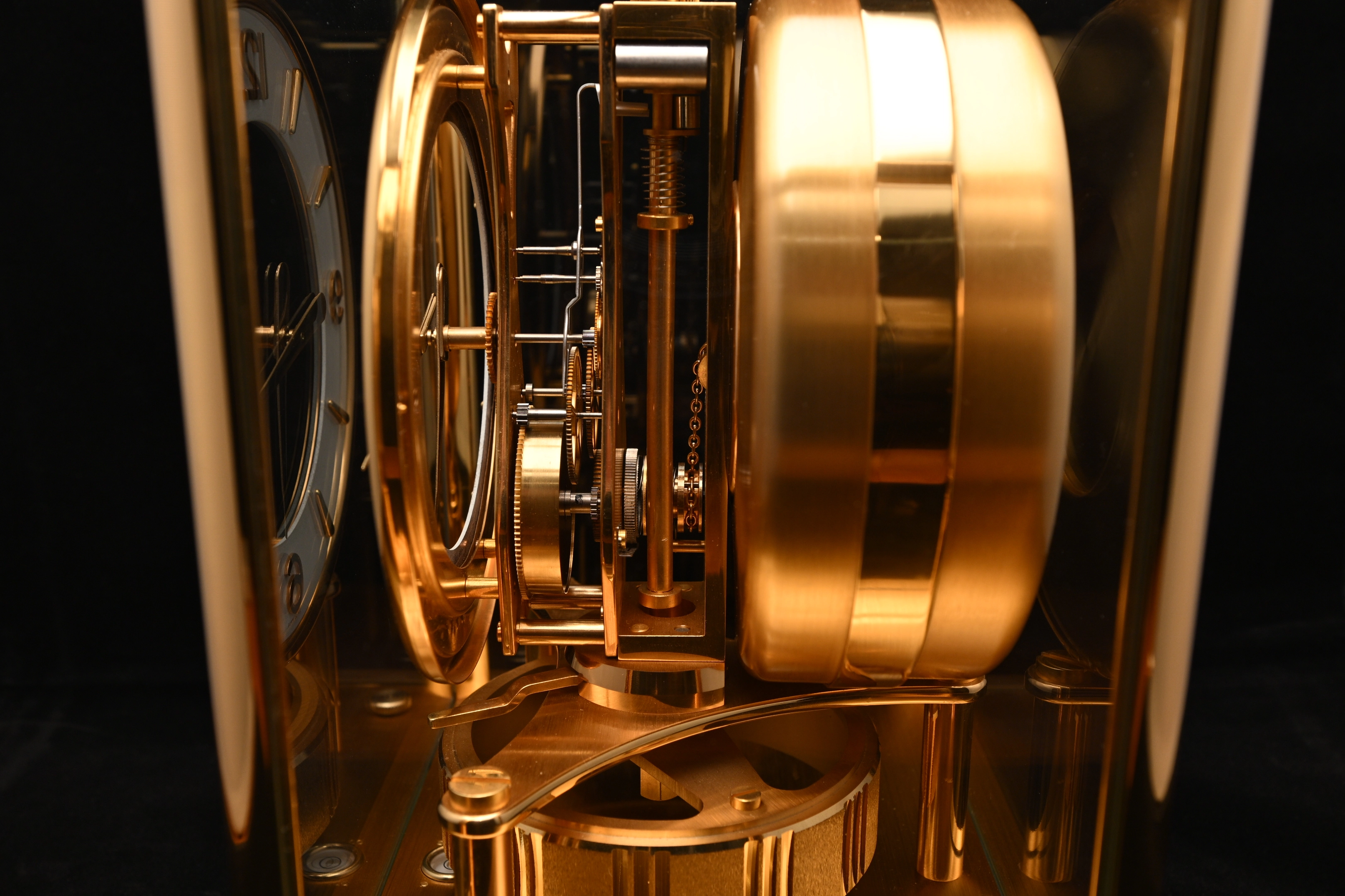

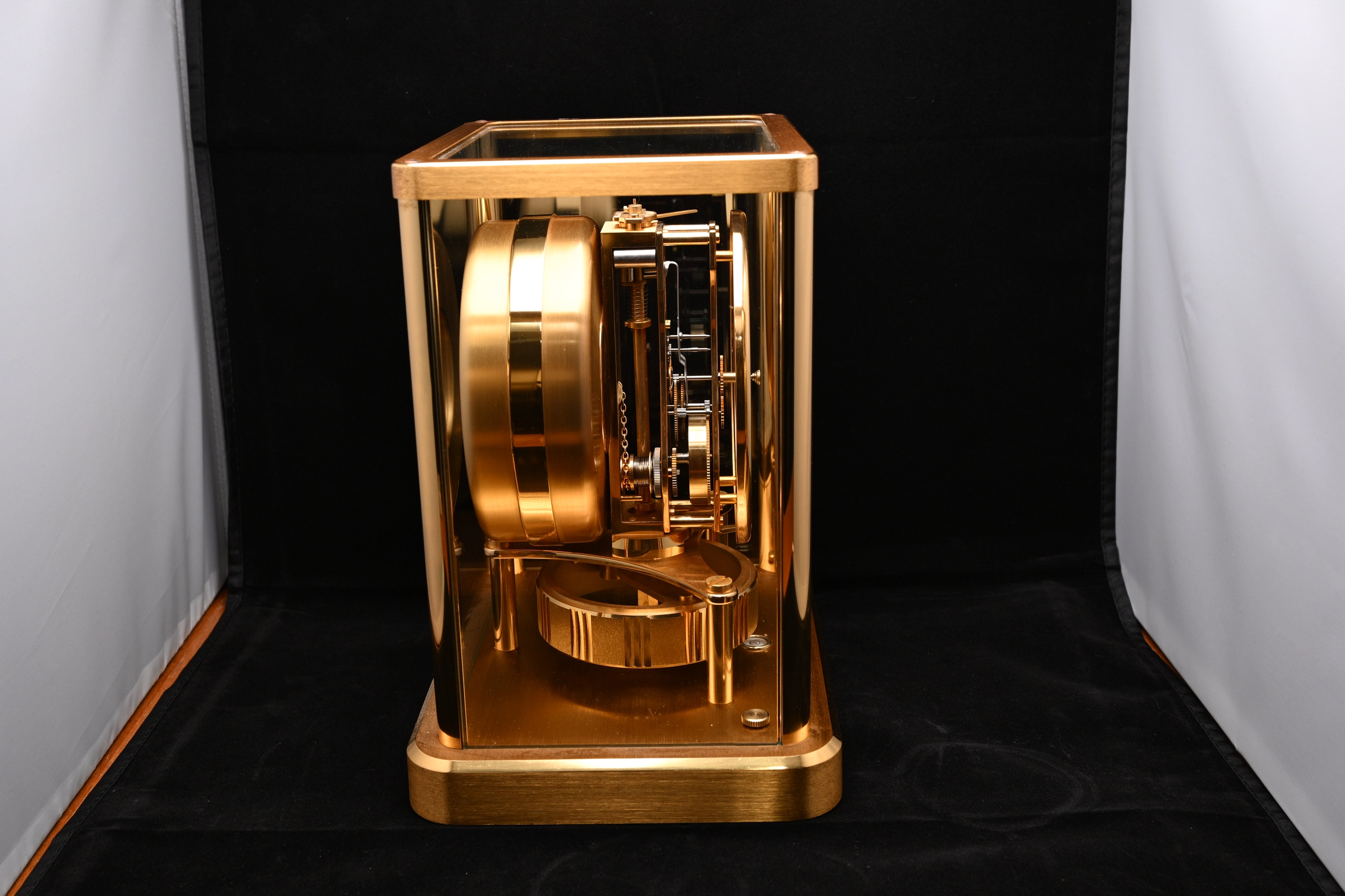

Used Atmos clock. Runs slow and cannot adjust to run faster. I’m thinking something is wrong with the pendulum spring. Has good amplitude. Looks like it had a front plaque. Have references here and am a seller on eBay. Please feel free to ask questions. I would like to do a face to face in Portland Oregon if possible, but can ship for $100. I have shipped lots of these over the years and it is always expensive.

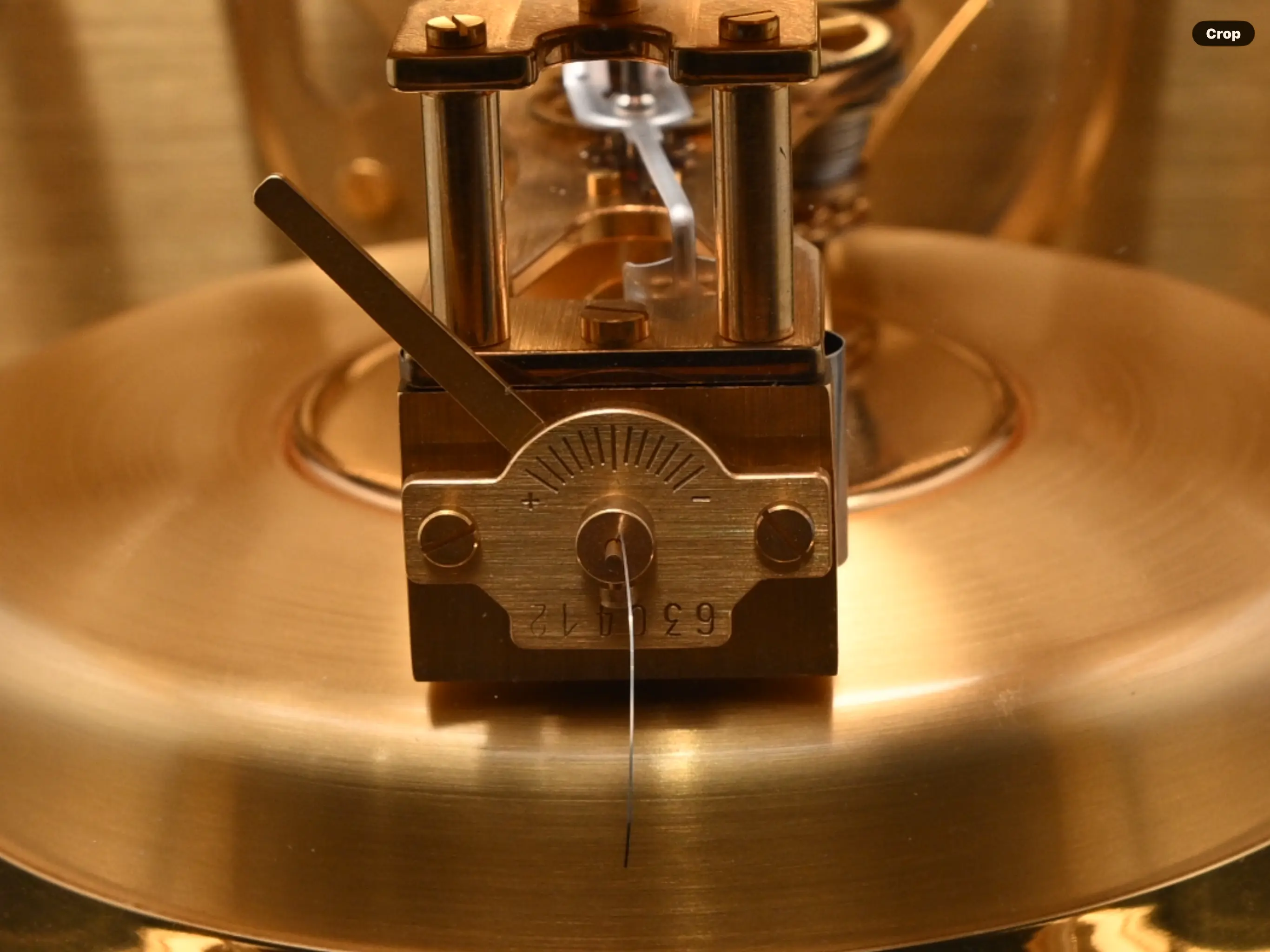

You want. 540s are more difficult than the rest. I’m not touching it.

Doesn’t seem to work on 540s
Oh, hrmph. This might be a 'adjust weights' sorta one then, the FB group (Atmos Clock Repair Group) can be really helpful, lots of knowledgeable guys there. IIRC there is still the 2nd adjustment on that (the collar that he mentions after talking about the weights i that video) as a 'coarse' adjustment thatyou can do.

Can’t help but think at one point it must have run properly. It is like 10 minutes a day out at full adjustment.

It's the correct coarse adjustment for the 540. Although as you've said, if it doesn't work it may be another issue 😟.

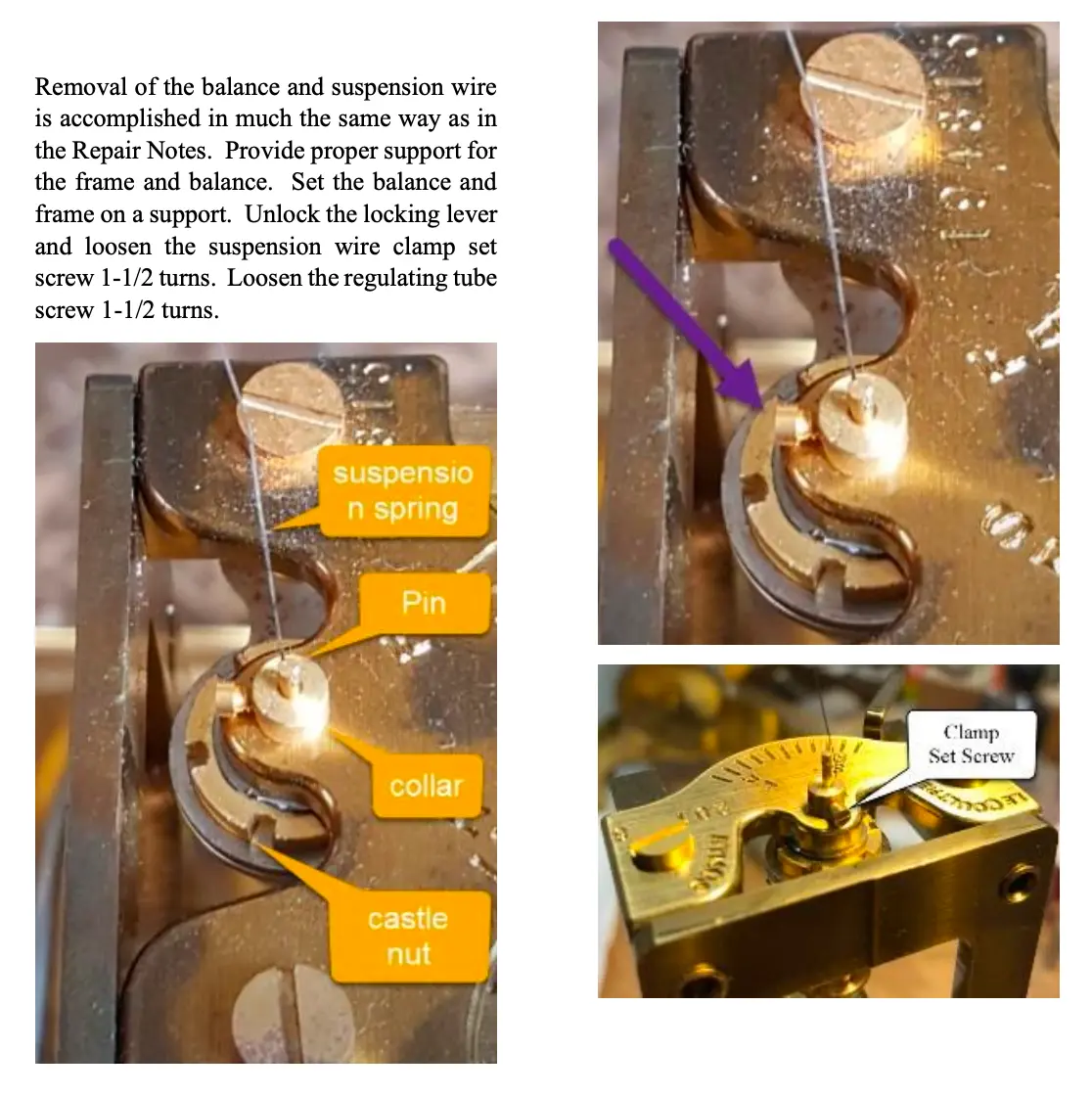

540s don’t have the castellated thingy.
18,853
39,212

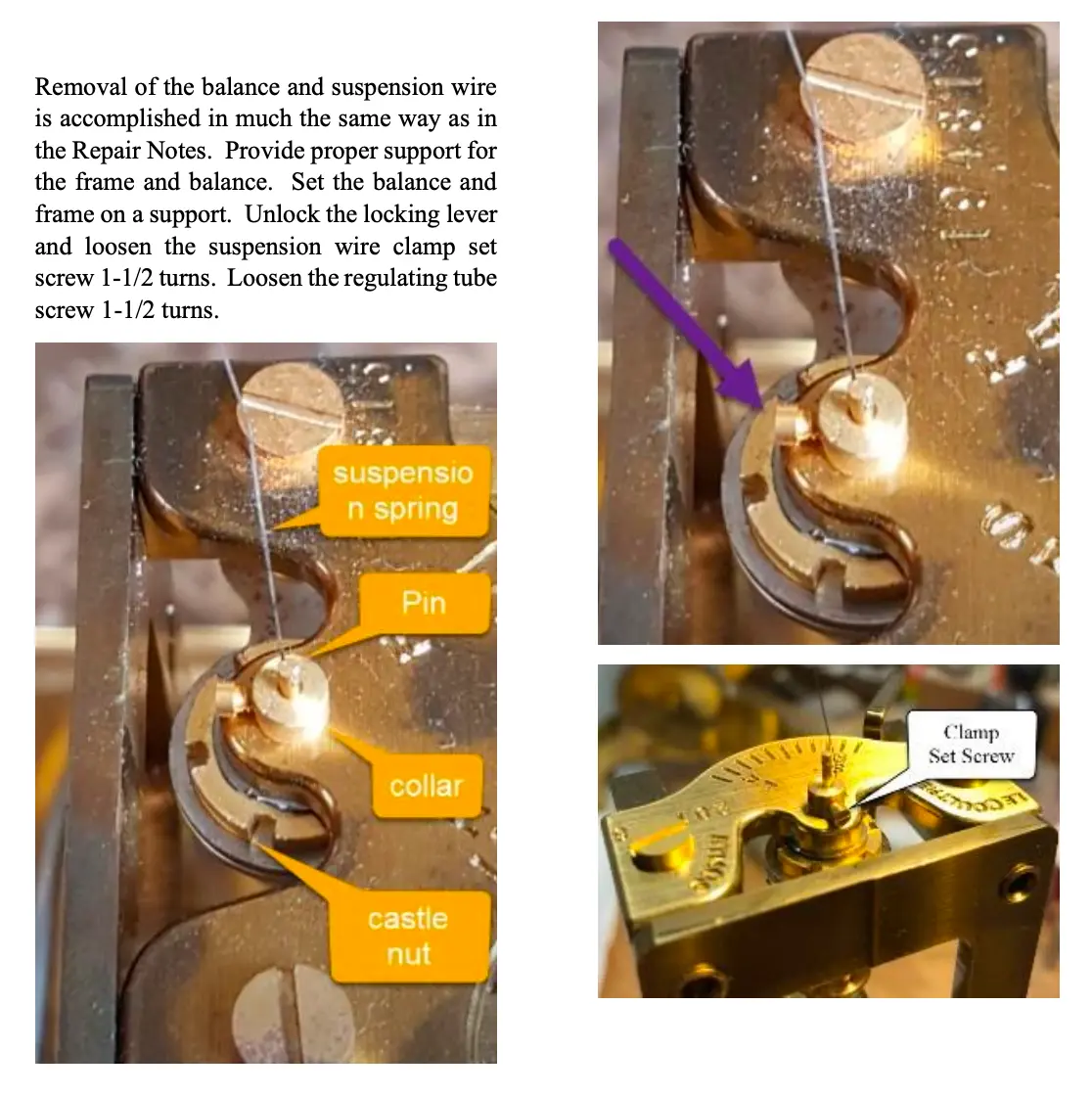

My service manual is obviously incorrect then.
This is the section on replacing a 540 suspension wire, the author must have used their stock photos.
4,112
7,072

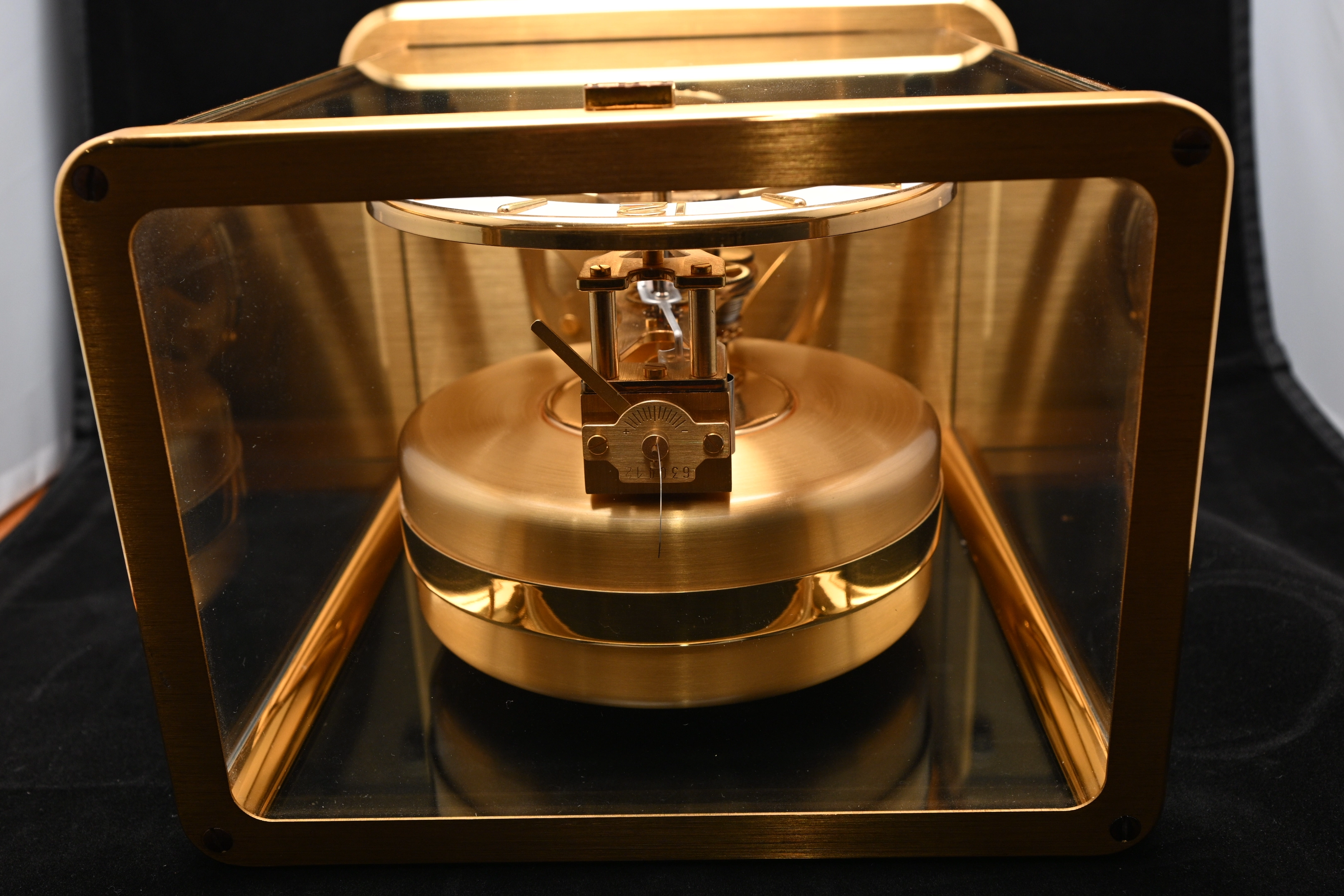

I have considered locking the pendulum, loosening the spring clamp and pulling the wire up a tiny amount. I have no issues messing with the earlier movements , but if I remember correctly 540s require an unobtainable tool for setting up the spring and the spring is not readily available.
18,853
39,212
Indeed, the procedure looks quite complex, I don't think I'd try it, even though I did service a 526-5 a while ago.
