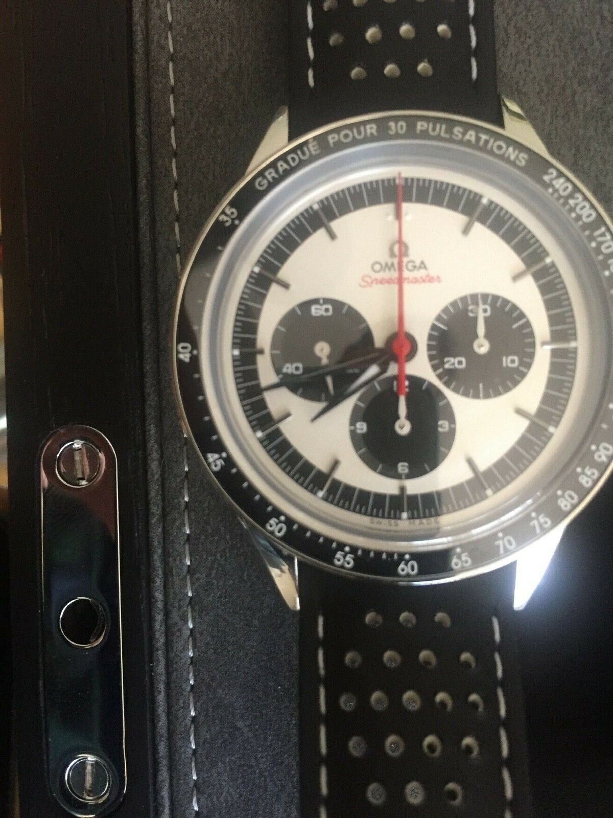

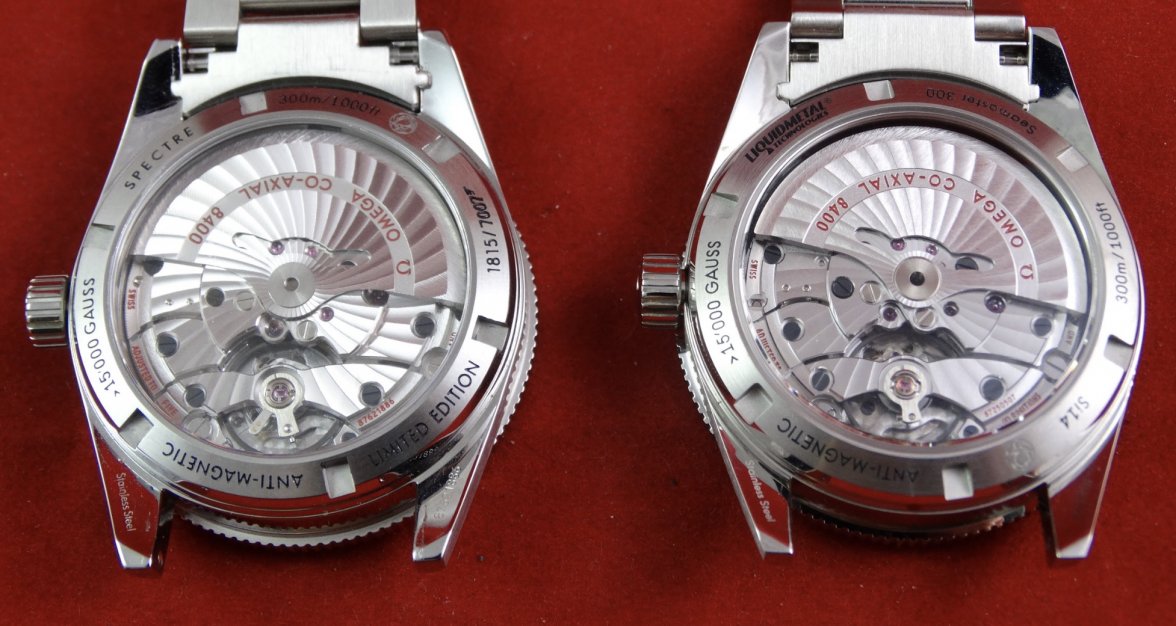

The fake is really really well made. Always look for completely full sets, not only the cards, but the paper of the limited edition and other goodies.
Consider fake is sold with steel bracelet and nato strap. Fake Cards can be bought.

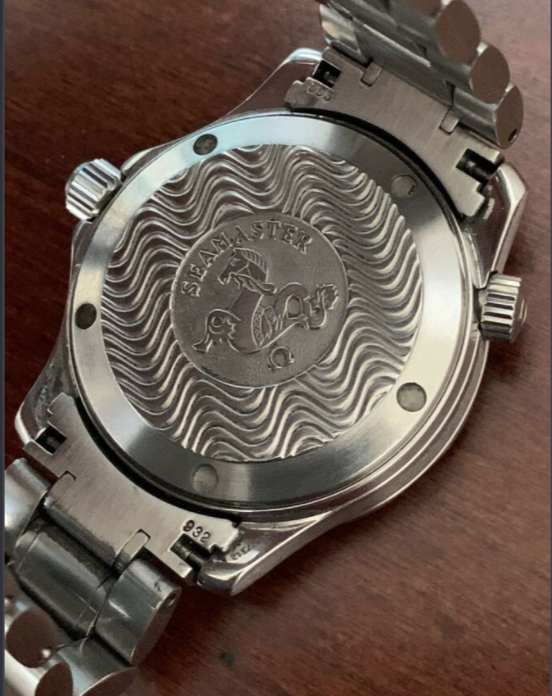

check the picture, where you can find a real seamaster 300 (not spectre) and a fake spectre
when I bought that fake spectre (by the end of 2018), I found almost 10 fakes on CHRONO24 (that fake watch was lunched at the summer of 2018). Fortunately I get my money back after 2 months
when you see them both, it’s easy. But not if you see only the fake watch
Is it still the case then that they fakes have the second regulator?
82
736
the only differences i see is this, can you confirm that your 300MC looks like that too, Thanks
Yes, that is the same.

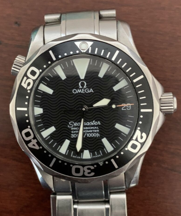

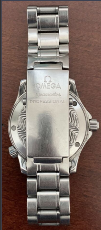

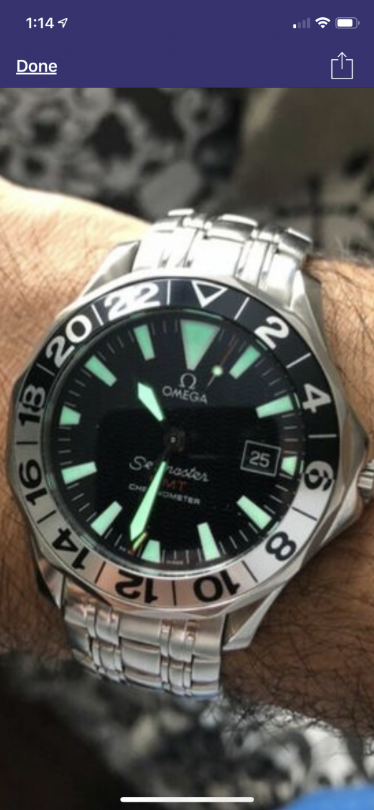

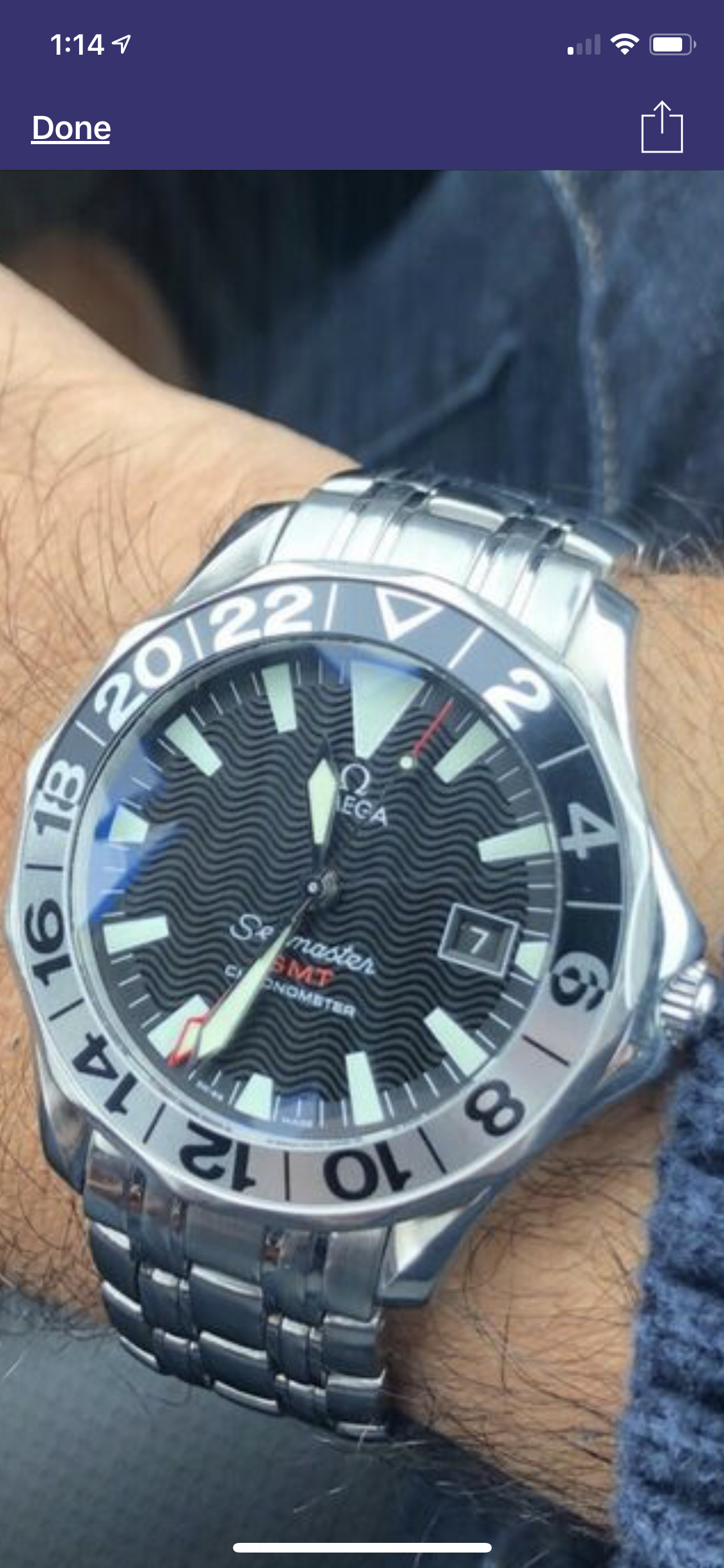

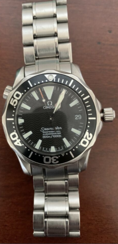

Is this watch Authentic ? (pre purchase question)
priced at $2000 CAD
Looks real to me, as long as the hands are silver (and just reflecting the color black in the photo). The serial number on the tag matches the one on the watch case, the helium escape valve position is correct, the second hand red tip is faded as expected with a used model, and the lume pip on the bezel looks correct.
283
199
Yep, its just a reflection it is sliver.
I appreciate it. thank you.

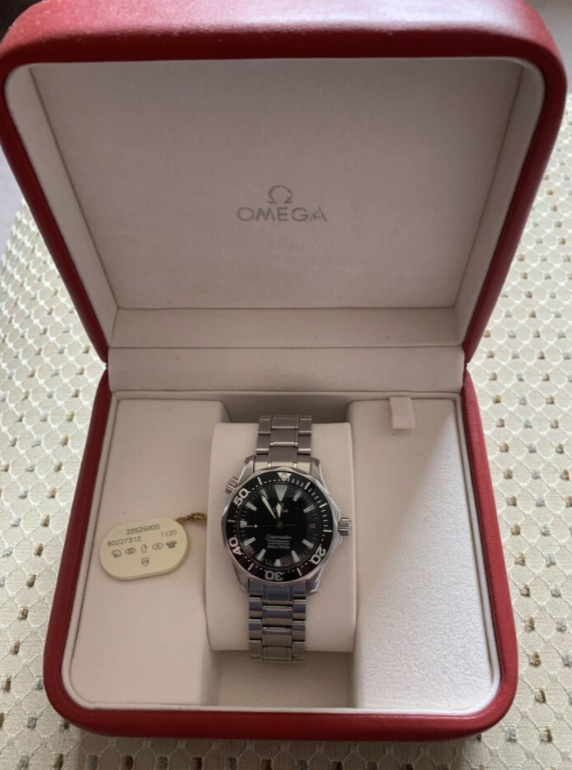

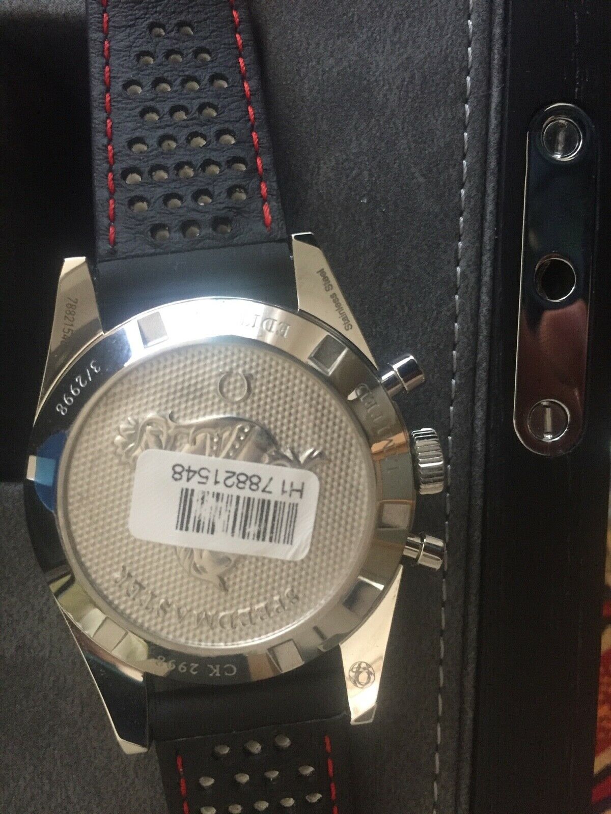

Hi everyone! Looking to buy a CK2998 and wanted to get your collective wisdom on if it looks legitimate to you or not?

You do know this is the smaller mid-size version of the 2254.50, right?
Looks legit, does it come with all boxes and papers? In the end it comes down to how much you like it and the cost. I wouldn't pay extra for the low number.
Yes, it comes with box and papers. Out of interest, why do you suggest I don't pay a premium on the low number? Thanks again!

It just doesn't make a difference to most collectors. Sellers will often try to tell you a lower number is more valuable. It's a sales tactic.

Got it. Many thanks for the advice!

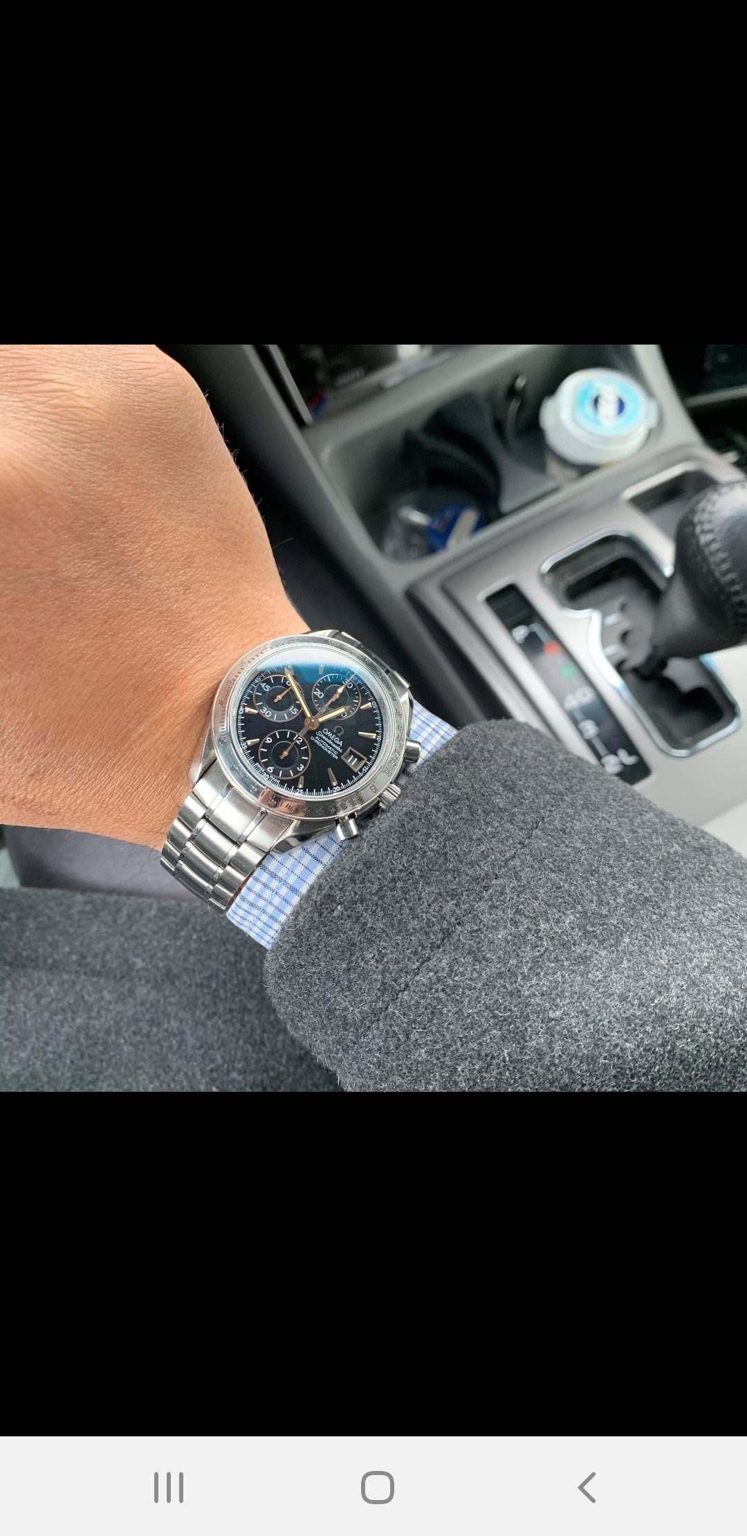

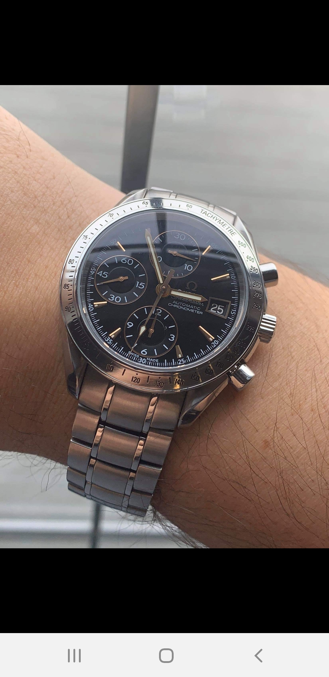

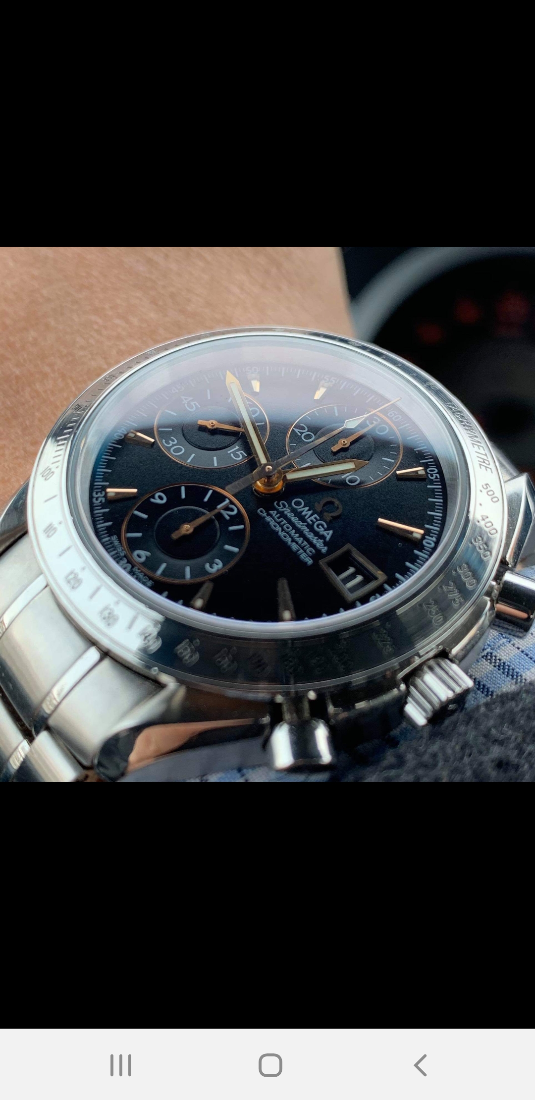

Hi guys,
I'm debating buying my first Omega after swapping & chopping my way into the price range.

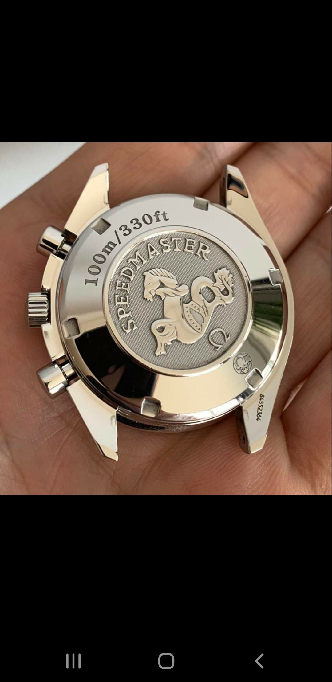

I am debating buying this for $2450. The seller says it is a "Special Japan Only" Speedmaster. What do you think?
2,808
8,340
Hi guys,
It looks like a genuine 3211.50 to me. It looks high quality without anything suspicious. What other provenance is the seller offering, like serial number with matching warranty card, etc?

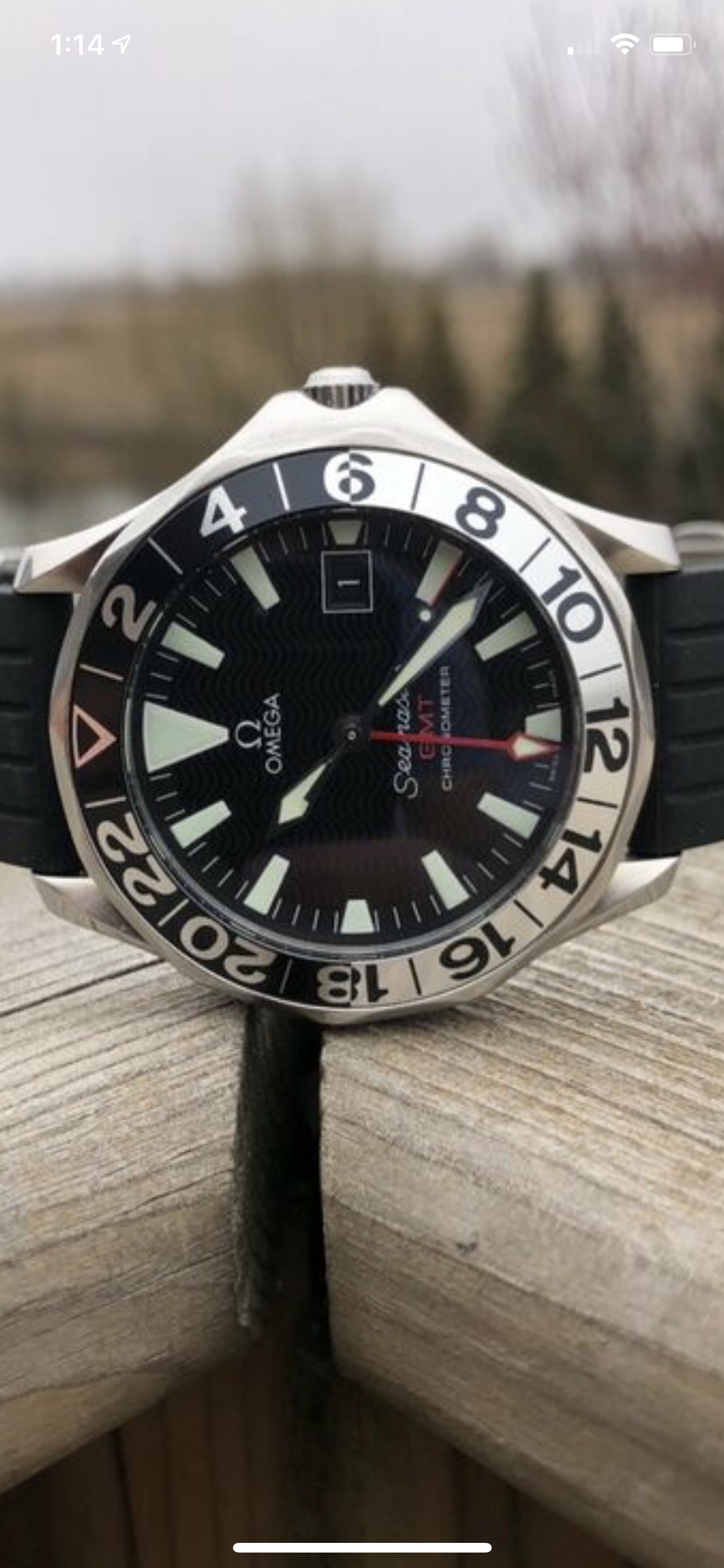

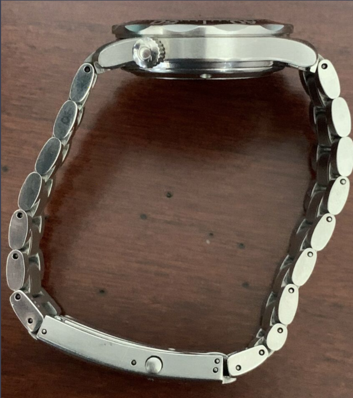

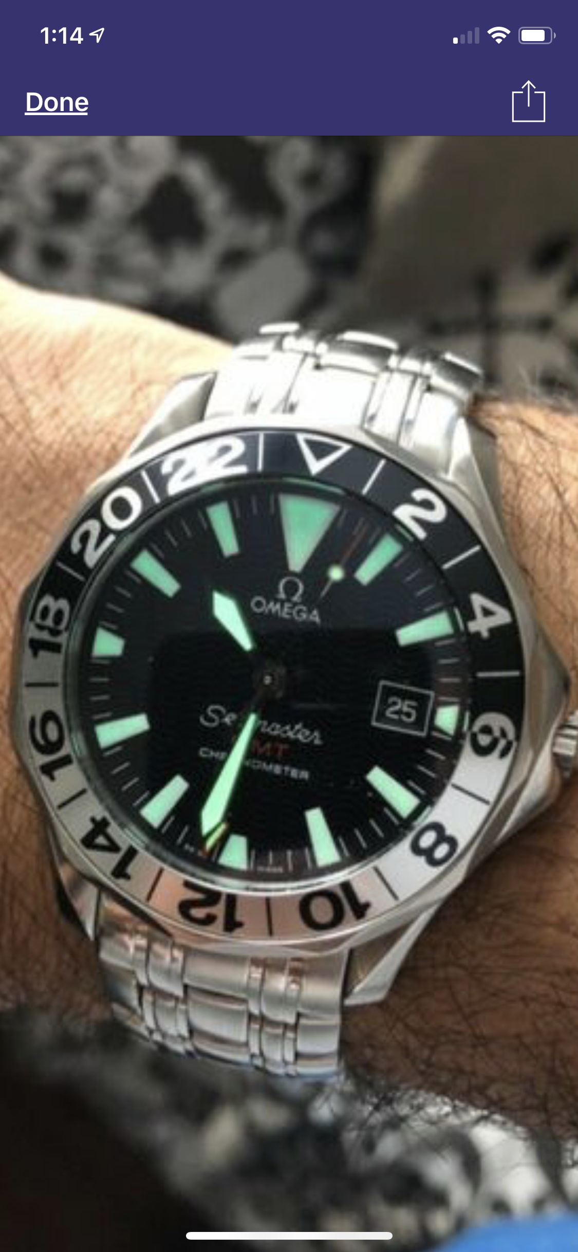

Hey experts.
I missed out on the mid size 2252.50
I am now aiming towards this 50th anniversary. Seamaster 41.
2534.50 GMT.
Does it look legit from the photos i have so far?
Thanks guys/gals
can ask for more pictures if needed.
(looking for authentication because of course no jewelers are open .
469
999
Fake on omegamania and omega watch owners group on FB...

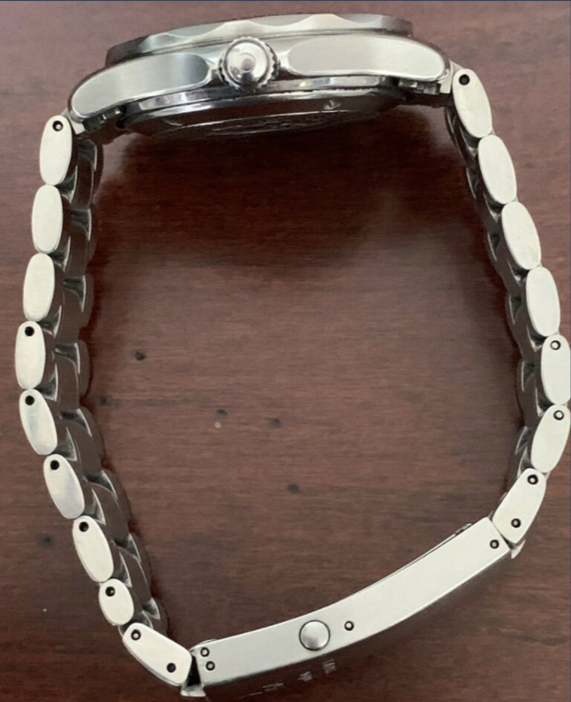

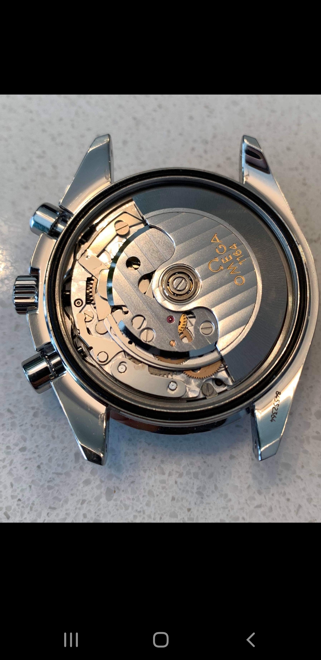

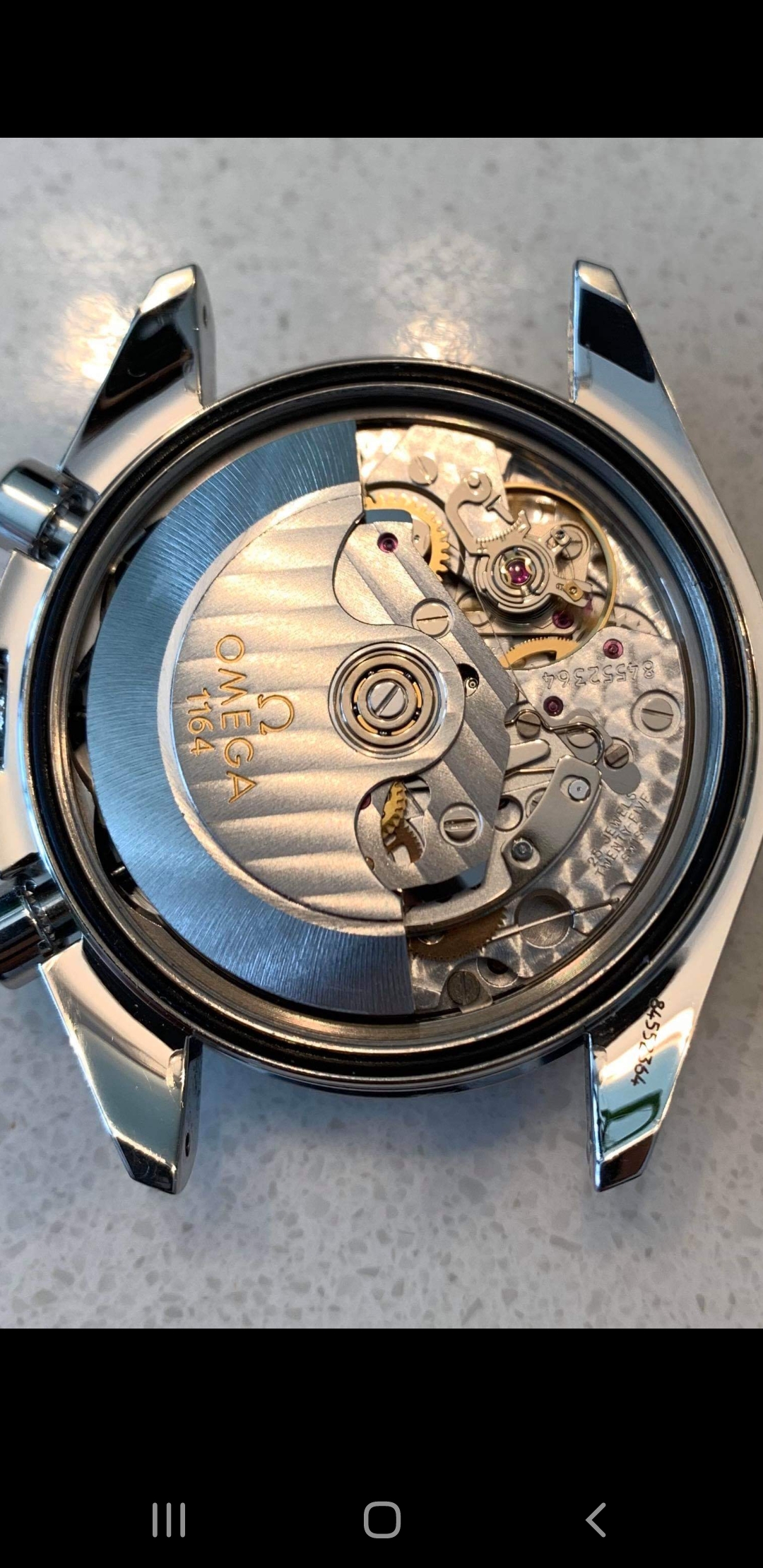

I just got these photos too. Apparently it comes with papers but I dont have a photo.
What do you think?
2,808
8,340
What do you think?
Real.
I haven't seen them fake such good pelage finish of the movement before, or fake the 1165 movement itself yet, and the SN on the case matches the movement as well. The 1164 movement is based on the Valjoux 7750 but with some changes, that the fakers don't tend to do.
